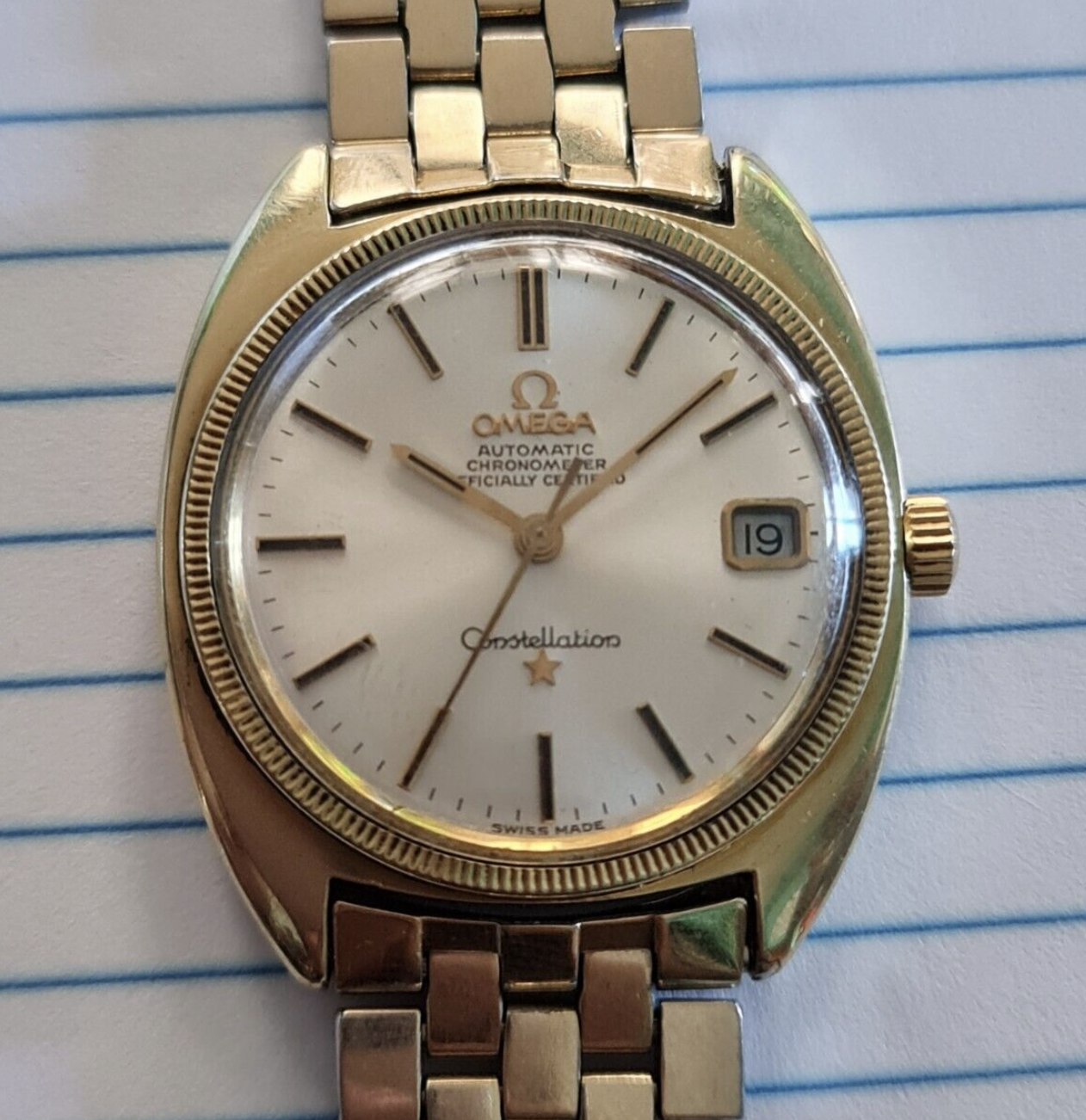

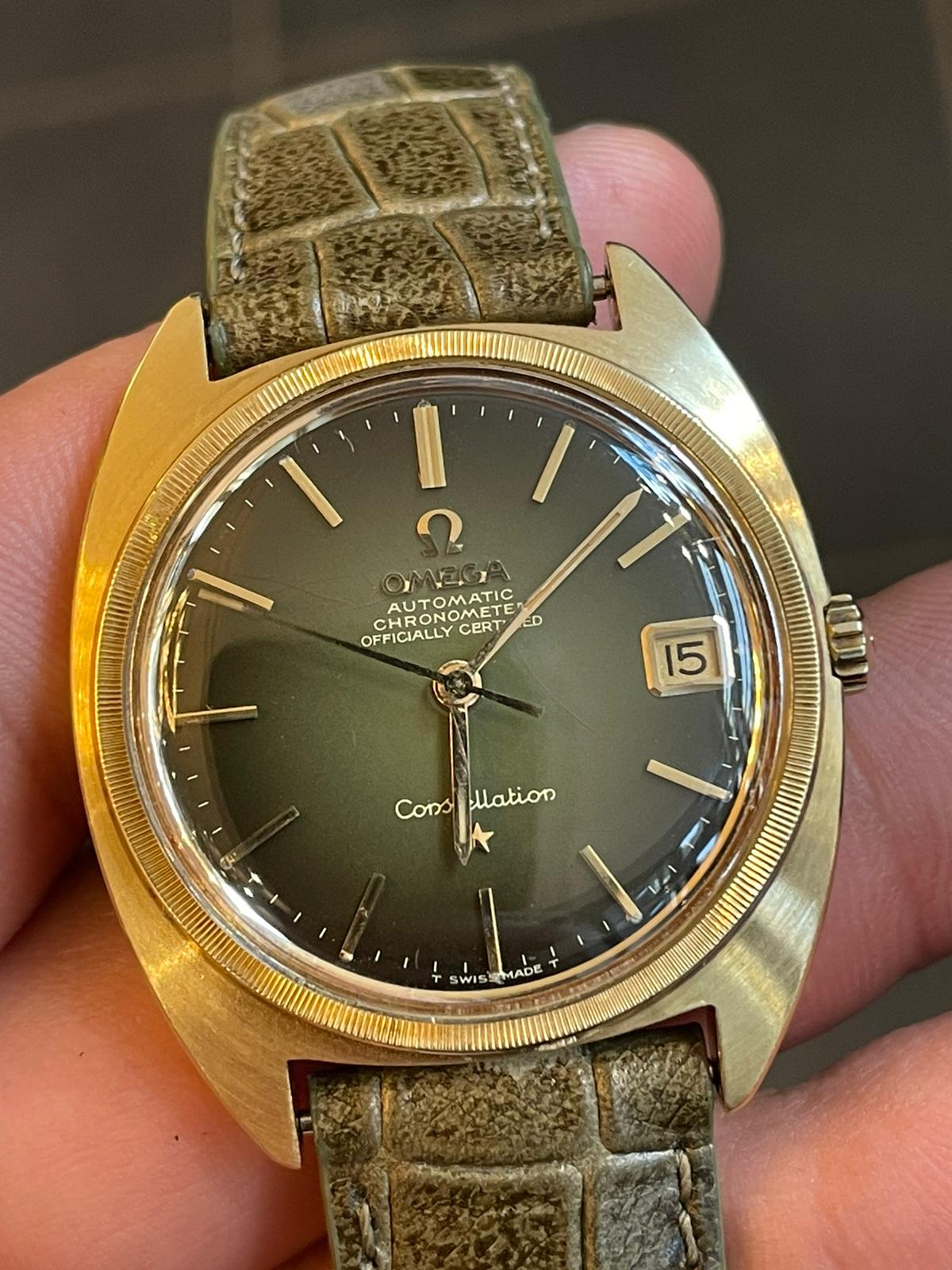

I have my sixth c-case is on it’s way. The precieus five somehow couldn’t stick. Some stayed for years and so e for weeks, but every time I sold one I kept looking at them.
This will be my last one, I guess. Only a WG c-case on a bracelet would be better, but those cost a kidney nowadays.
yes, this one is solid 18k.

Congrats! It looks so much better in person, sellers photos were very worrying
Thanks! They were indeed. 😀
I asked for some extra daylight pics before wiring the money.

@flowert Can you please confirm the reference number of your new watch? Thanks!
Sure, it’s a 168.017/168.009 from ‘67.
I’m not really sure what the 168.009 means as an extra reference number, but it seems those are the gold ones.

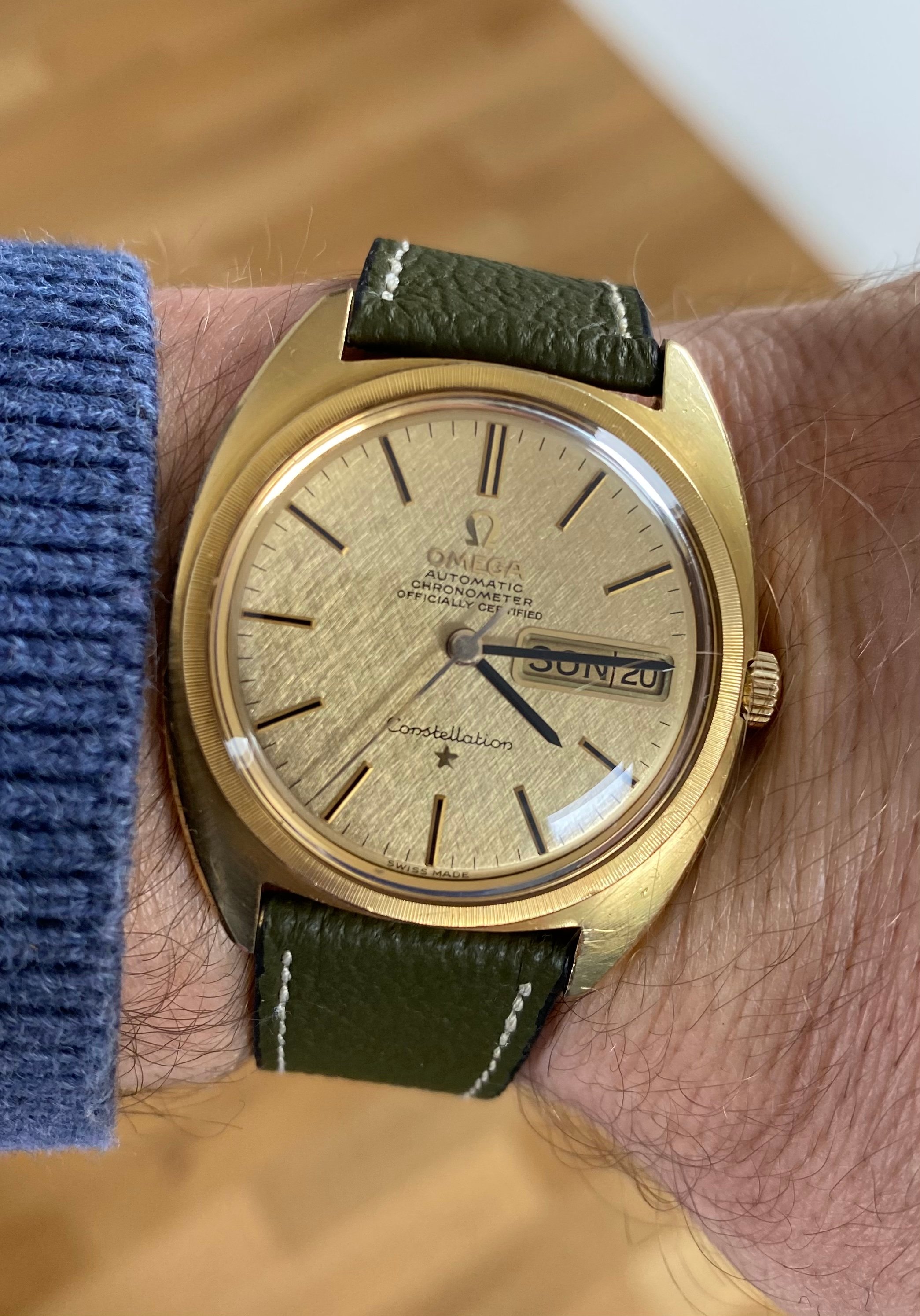

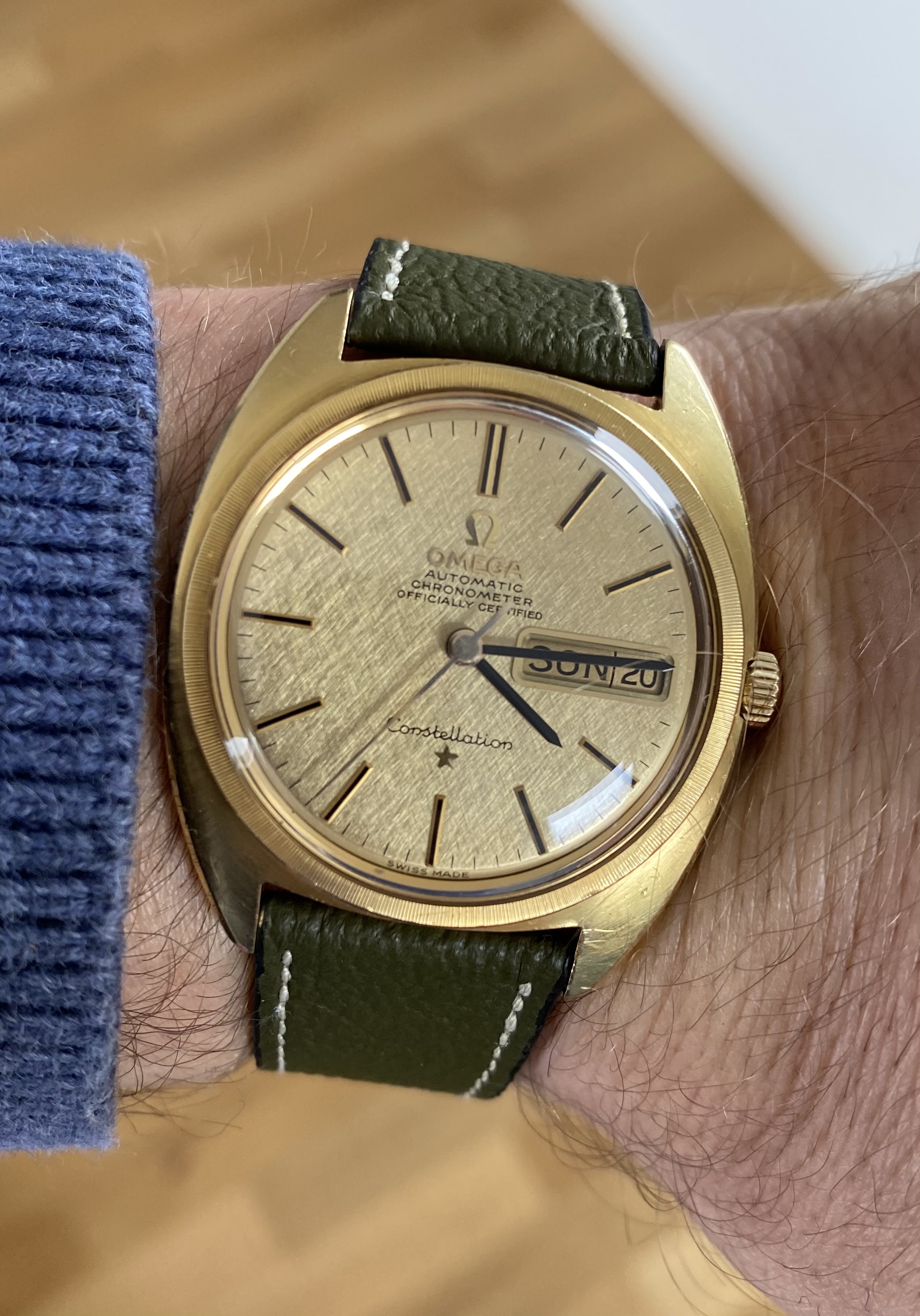

Today I wear my golden 168.019. Spend the day with 3 sick children on the couch, nothing can happen to her ;-).

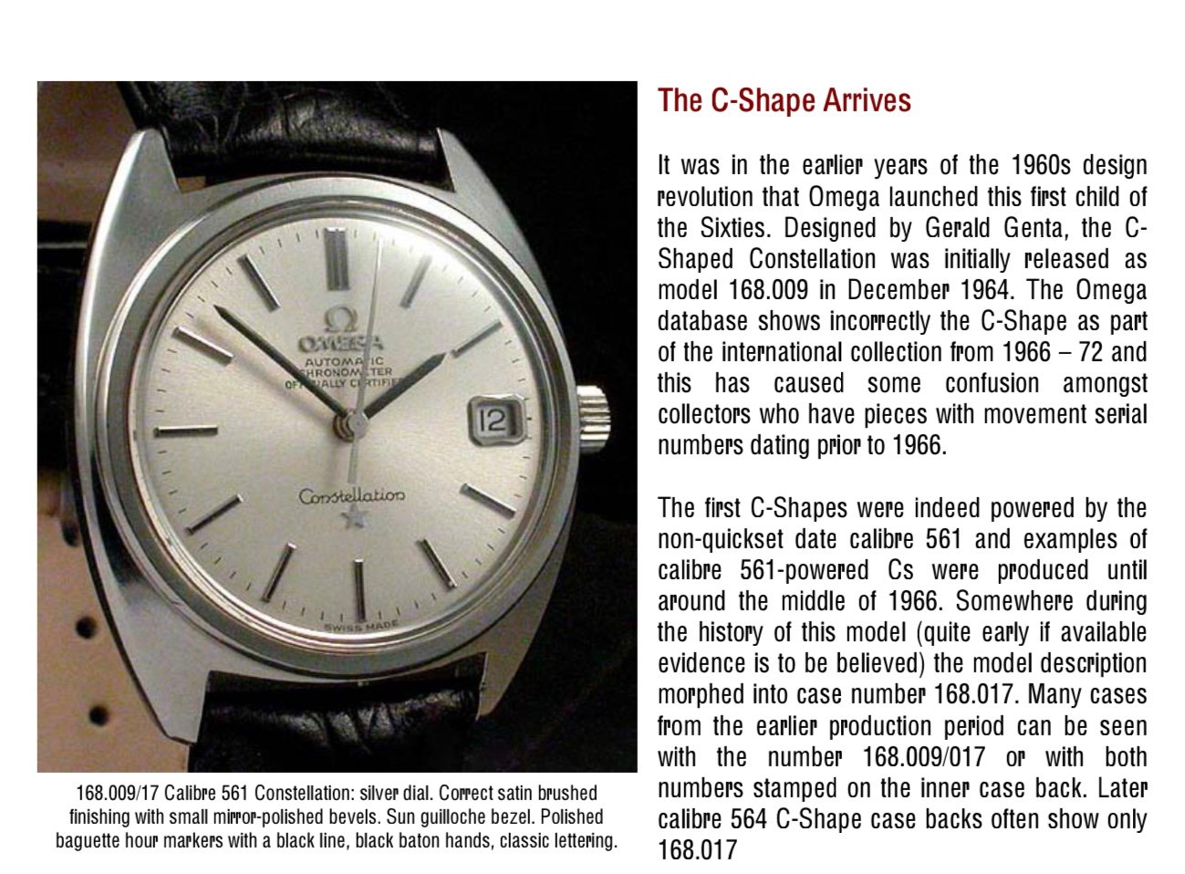

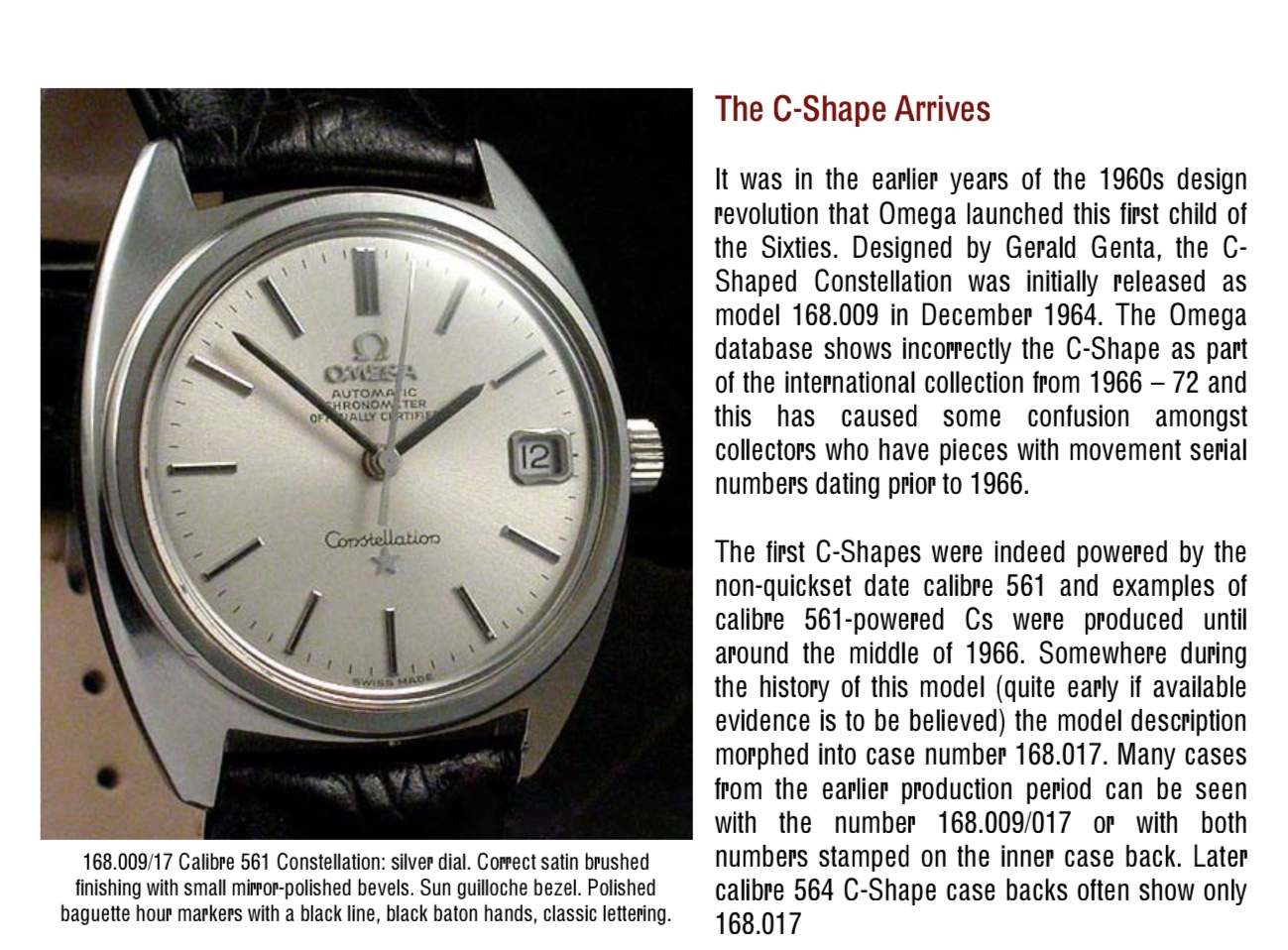

An excerpt from Desmond’s essay on C cases explains the double reference case back.
2,684
3,168

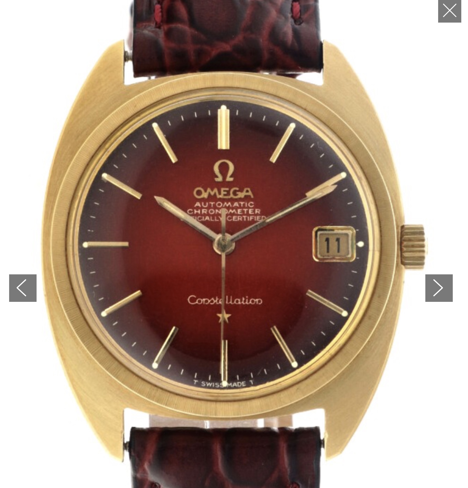

A lot to unpack there, but I think there's a bit more clarity now, still I wish I could find a 1964 168.009, maybe they released it but didn't actually sell them? In any case, it's time to start checking the serials of some early gold models

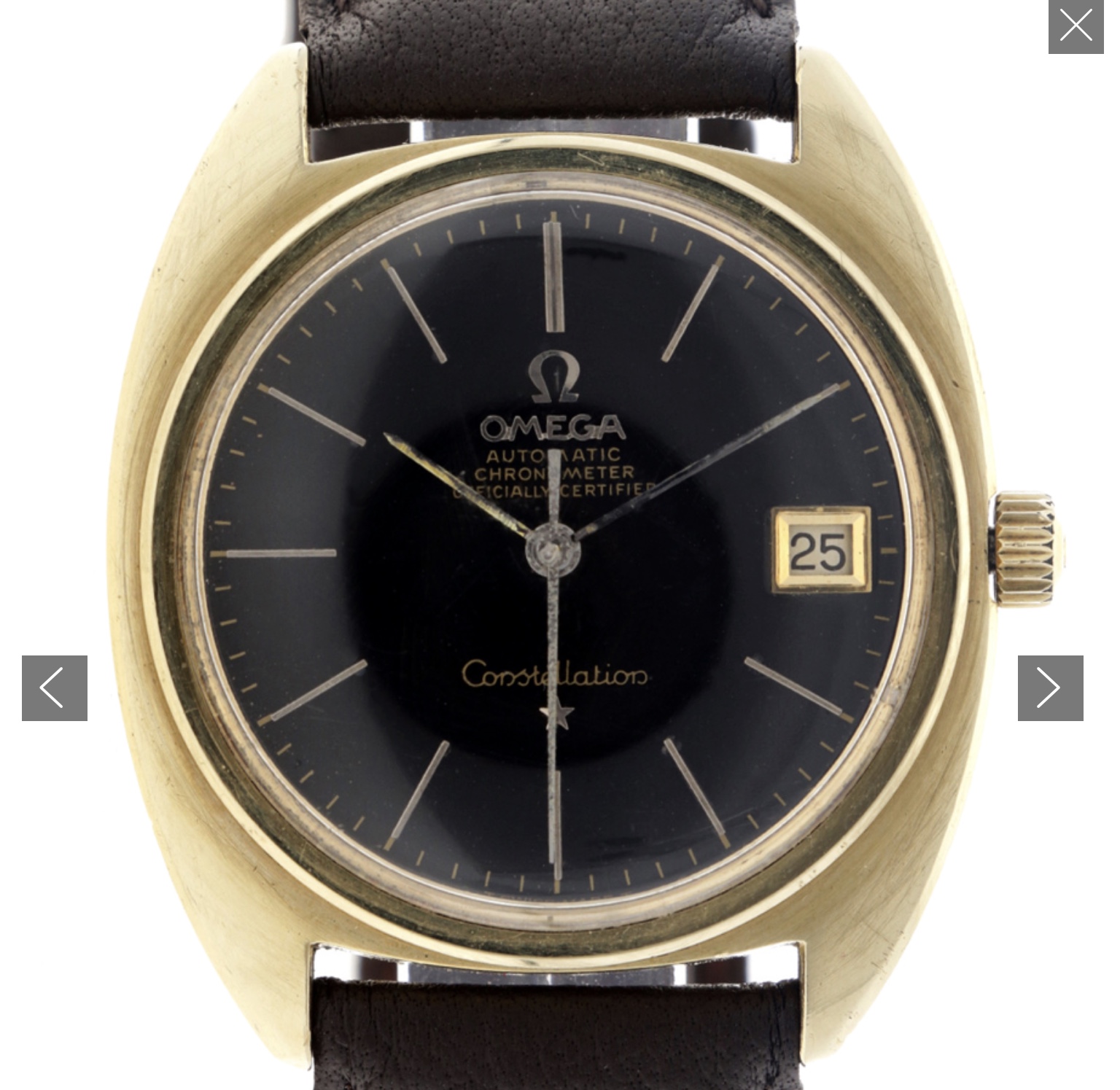

The dial in the photo is more interesting though, I always assumed that logo is a service dial's logo?

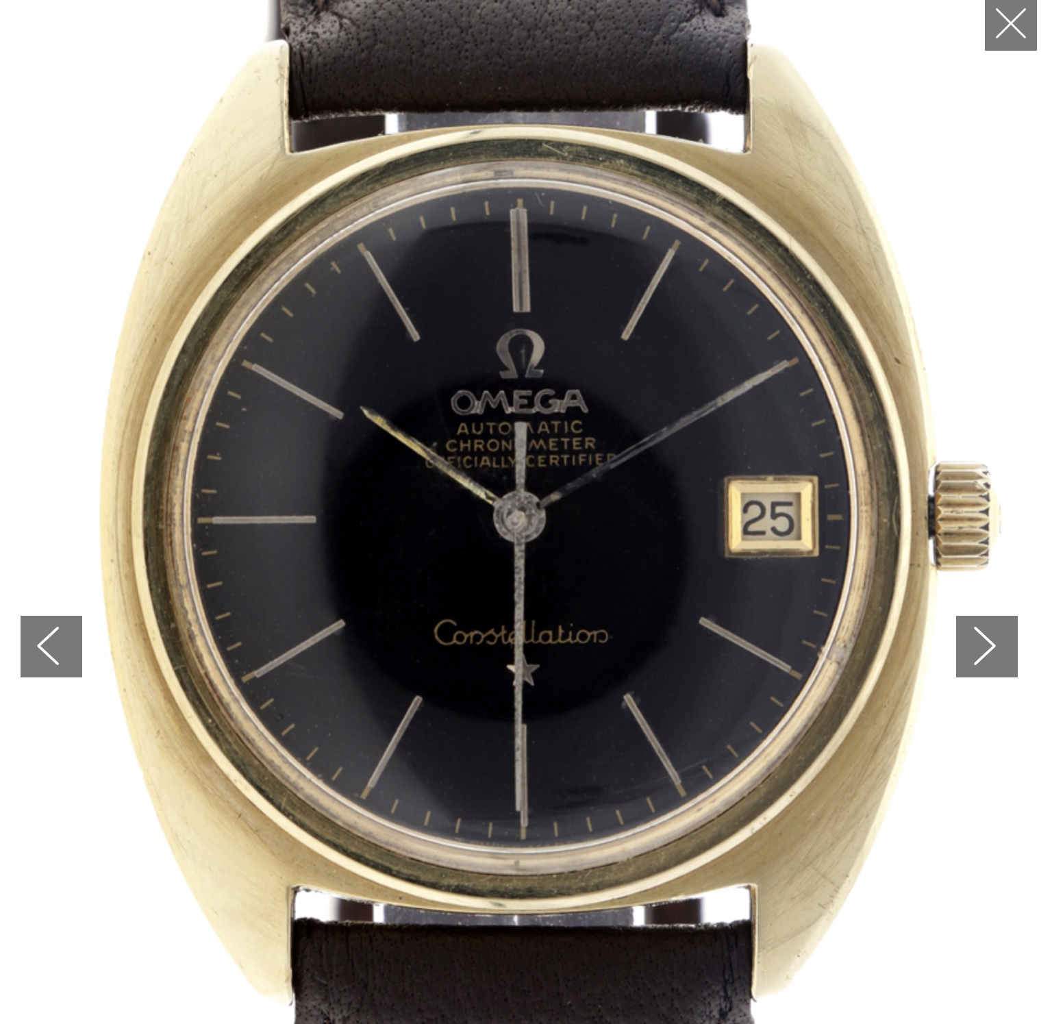

This one is currently on auction in eBay, again a weird fat logo:

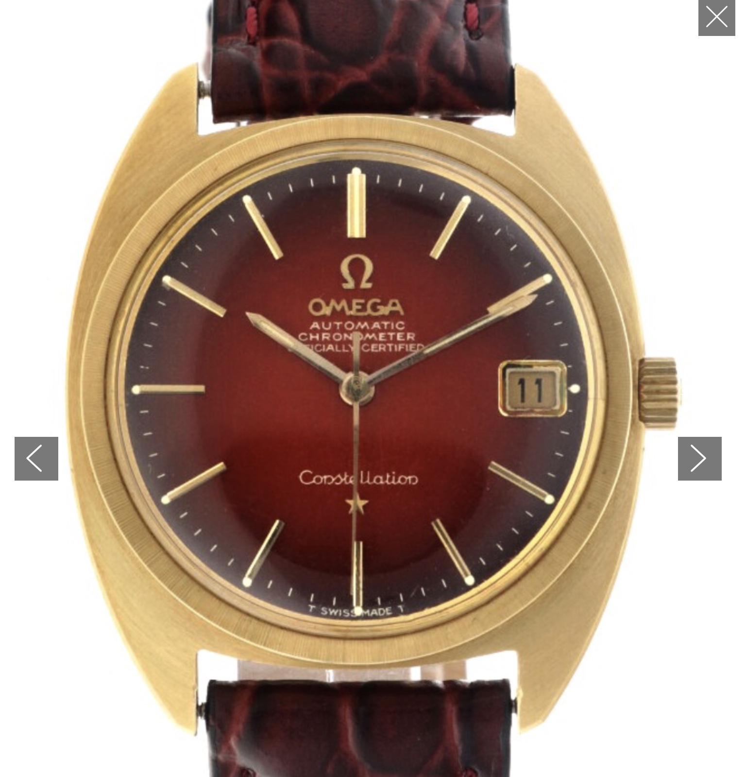

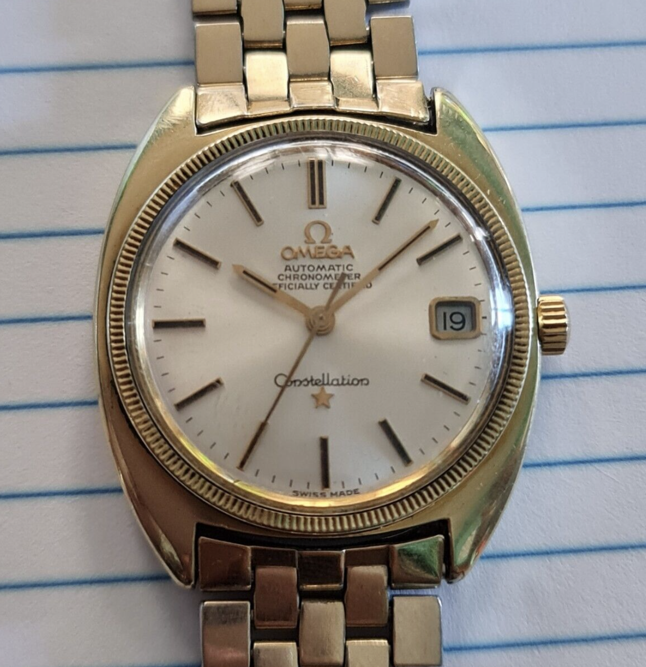

A couple of Constellations up for grabs at auction in May that might interest you C case devotees
18k with special dial
https://www.the-saleroom.com/en-gb/...aign=auction-alert&utm_content=lot-image-link
Gold cap with black dial

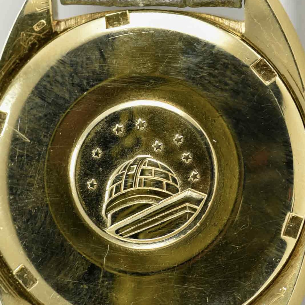

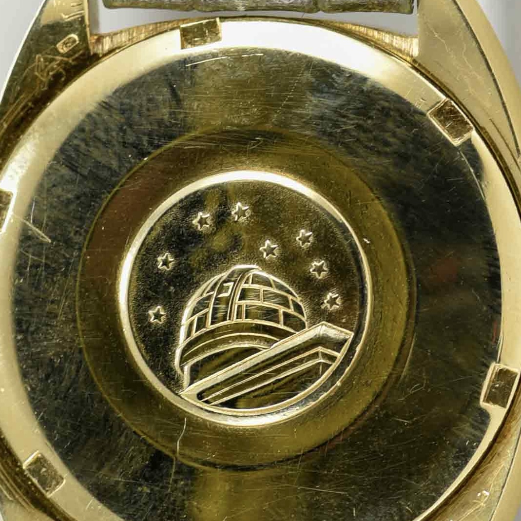

A couple of my amateur observations. It’s rare to see an enamel dial without cracks, although they like to hide in pictures. This one appears to not have any cracking. Also, no brickwork on the observatory on this one. Most C-cases I’ve seen have the brickwork. Does anyone know when the bricks started? I’m guessing after the early 009/017s. Or maybe it’s another gold watch only difference.
On the second one, no “O” on the rotor indicating an original rotor apparently. This came up in another thread recently and now I keep looking for it. Only found one other since then. I don’t see service markings on either case back but those like to hide in pictures too.
Originally, only gold watches had brickwork observatories.
SS and gold cap had plain observatories.
Omega in their wisdom decided to switch this, around '66-ish
So later gold cases had plain observatories and SS and gold cap received brickwork observatories.
However, there are some anomalies to this rule.
This might help
http://users.tpg.com.au/mondodec//Constellation medallions.pdf
This might help
Thank you! I guess I need to go read all of Desmond’s site before asking any more questions. ::facepalm1::
60
416
Interesting read. The one I have incoming does have the brickwork, so there even is variaton among such small numbers.
