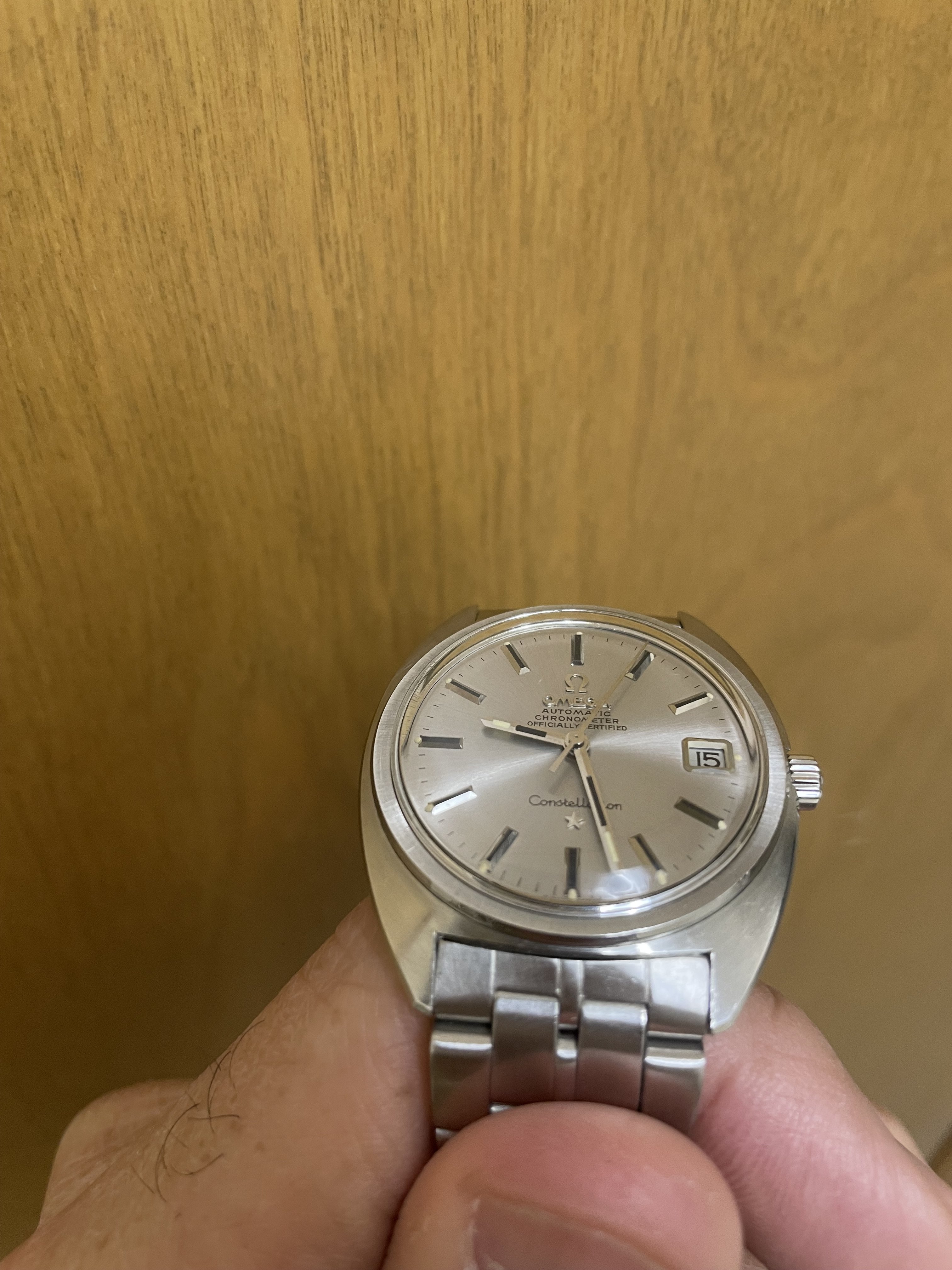

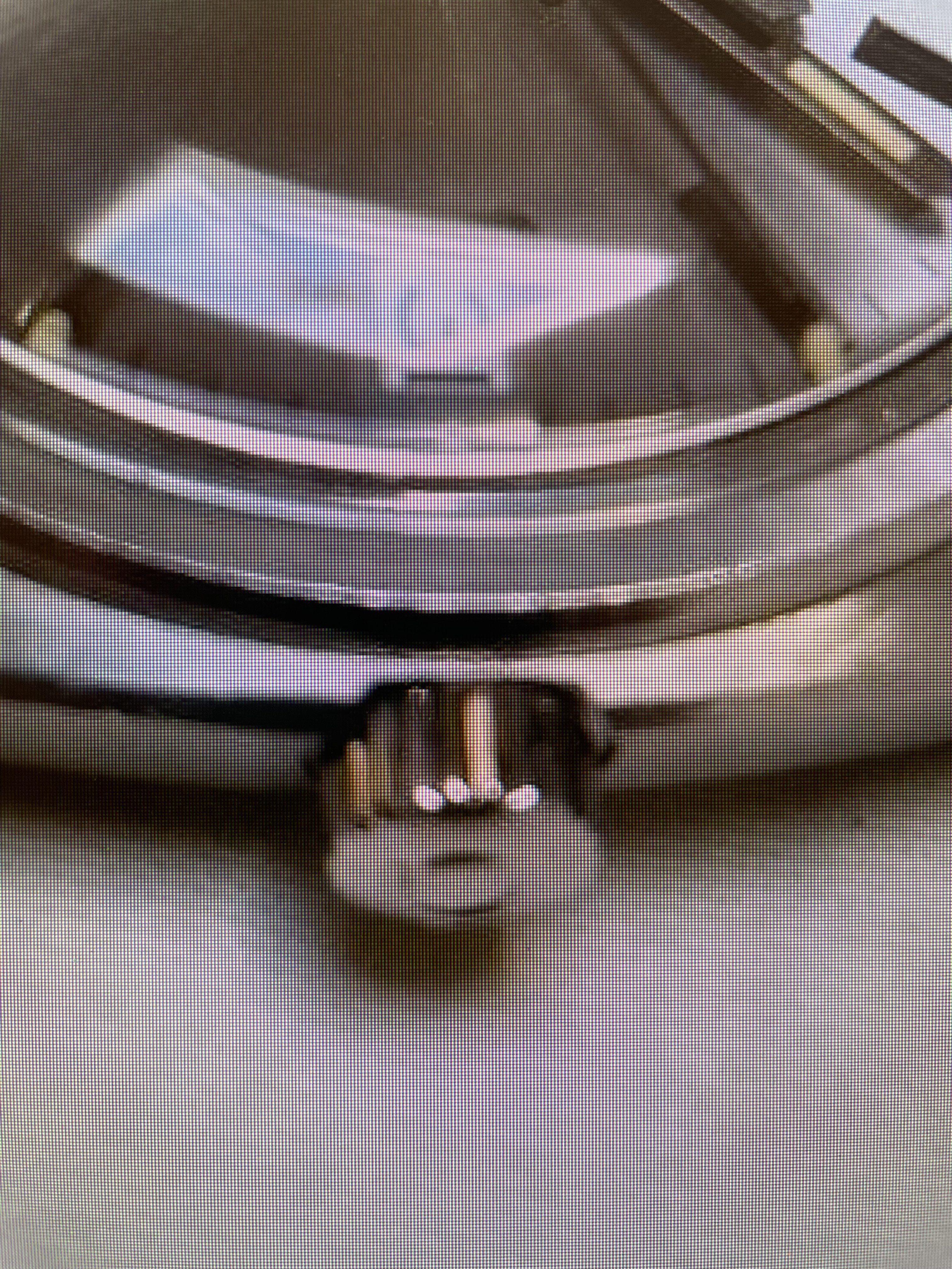

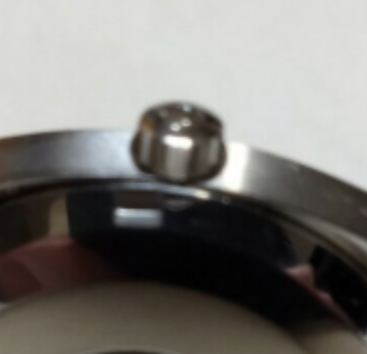

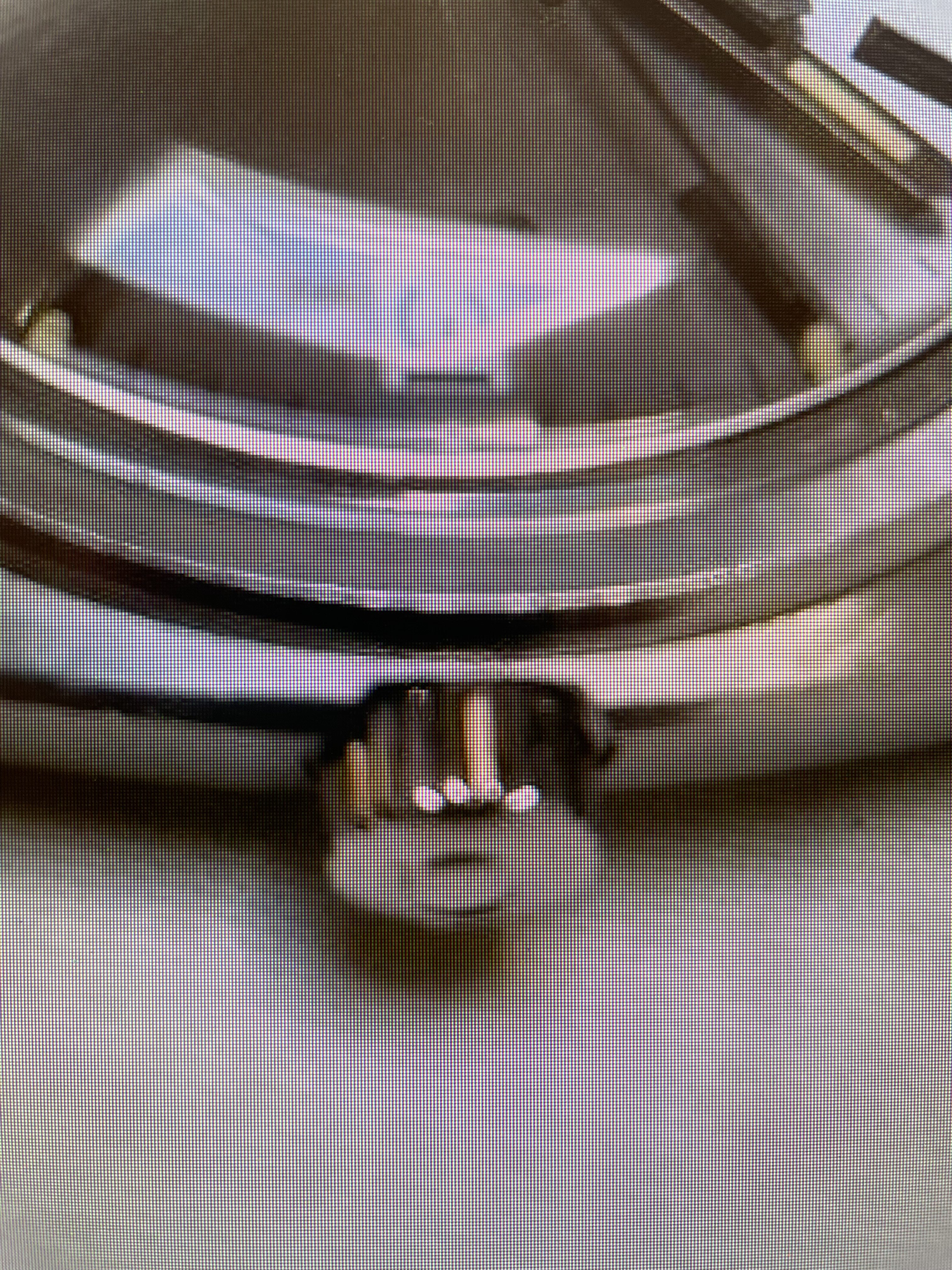

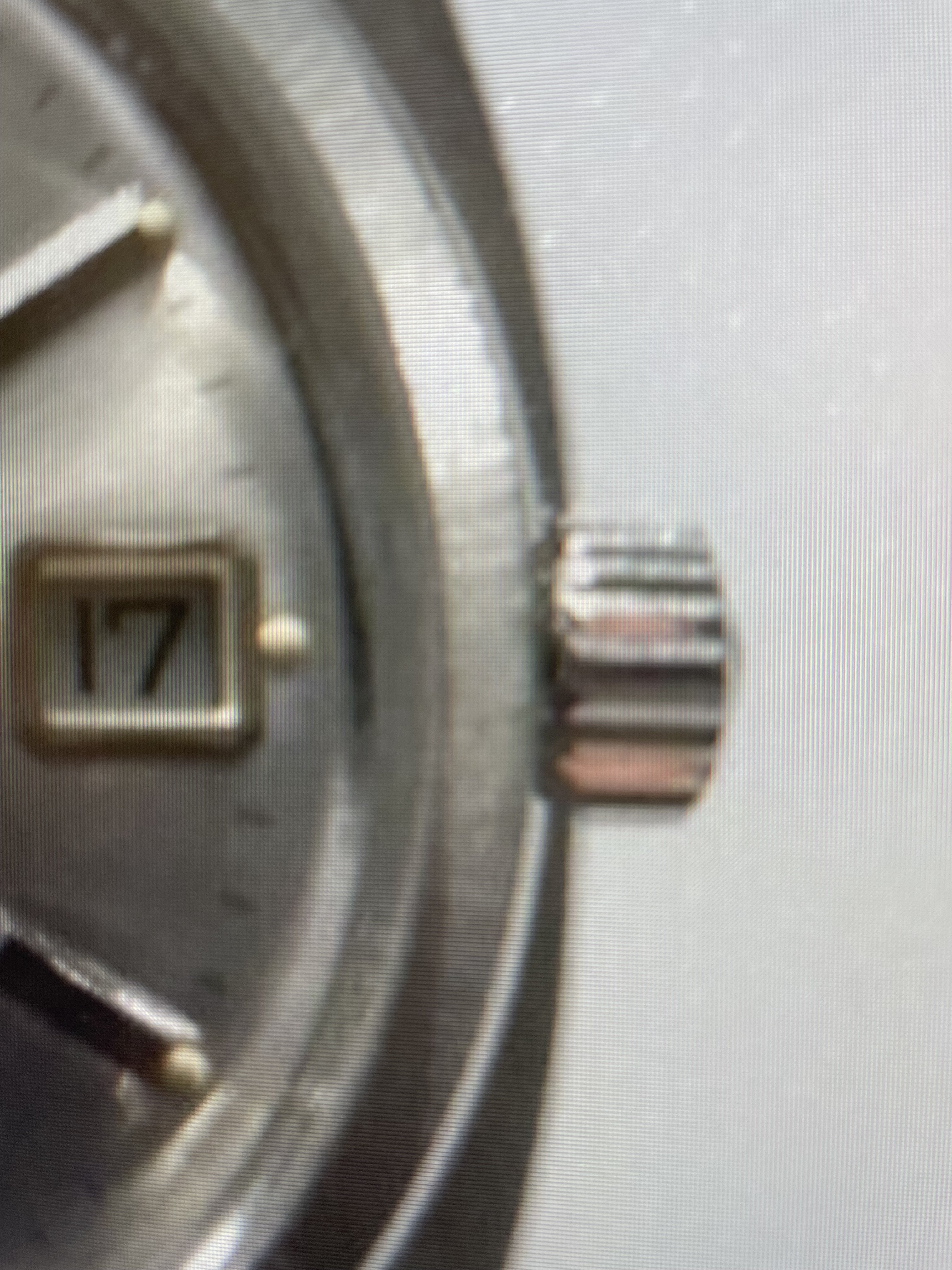

Just pulled the trigger on this one. A few photos from the auction.
Maybe it’s the photos but it looks like two different crowns? One looks scalloped and more rounded compared to the other.
444
878
I noticed that too, but I think its just a camera focus issue, focus was on the observatory.
306
1,922
(I have 5 tonneau ‘70 watch...)
Hi from Italy...

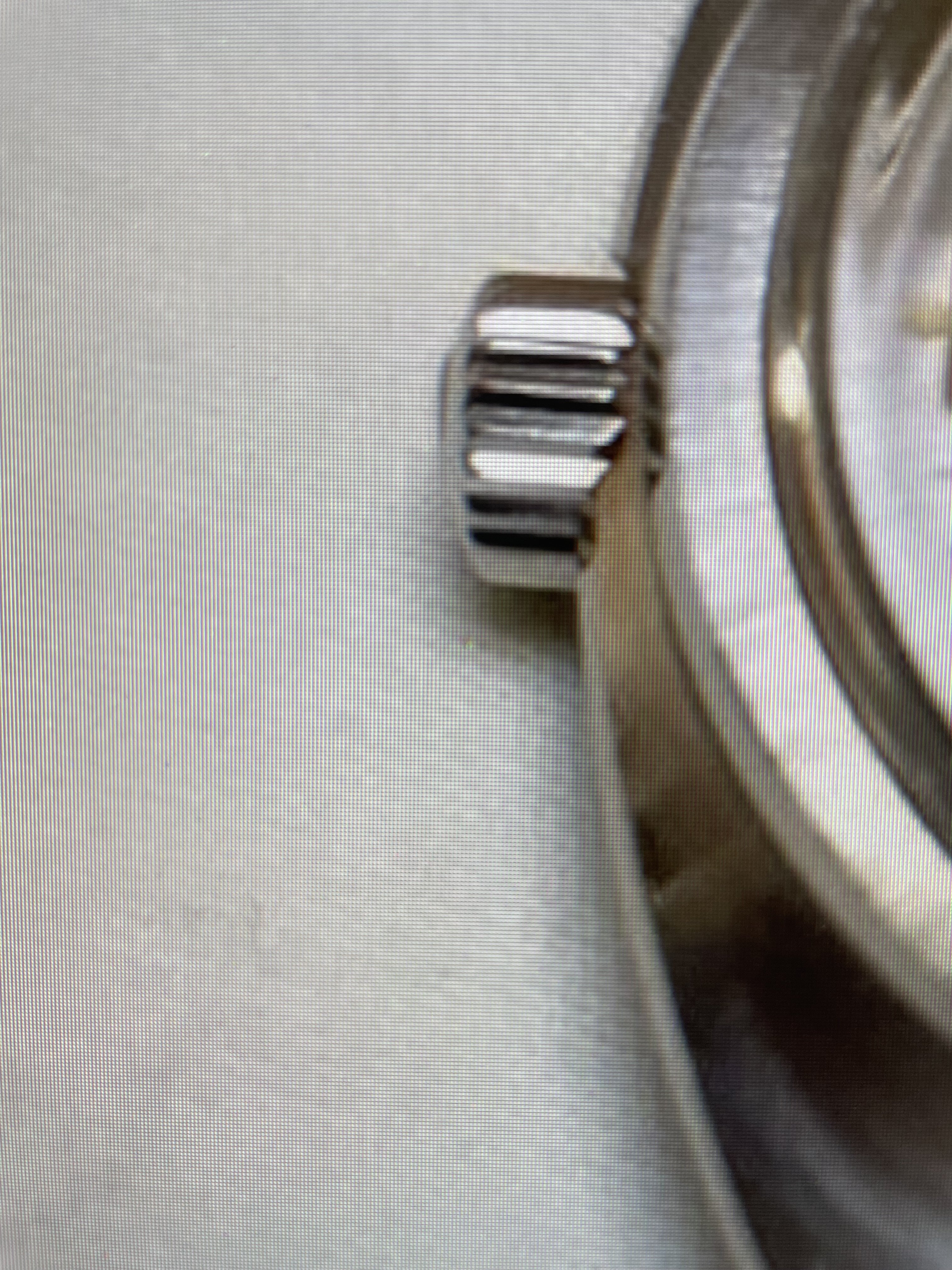

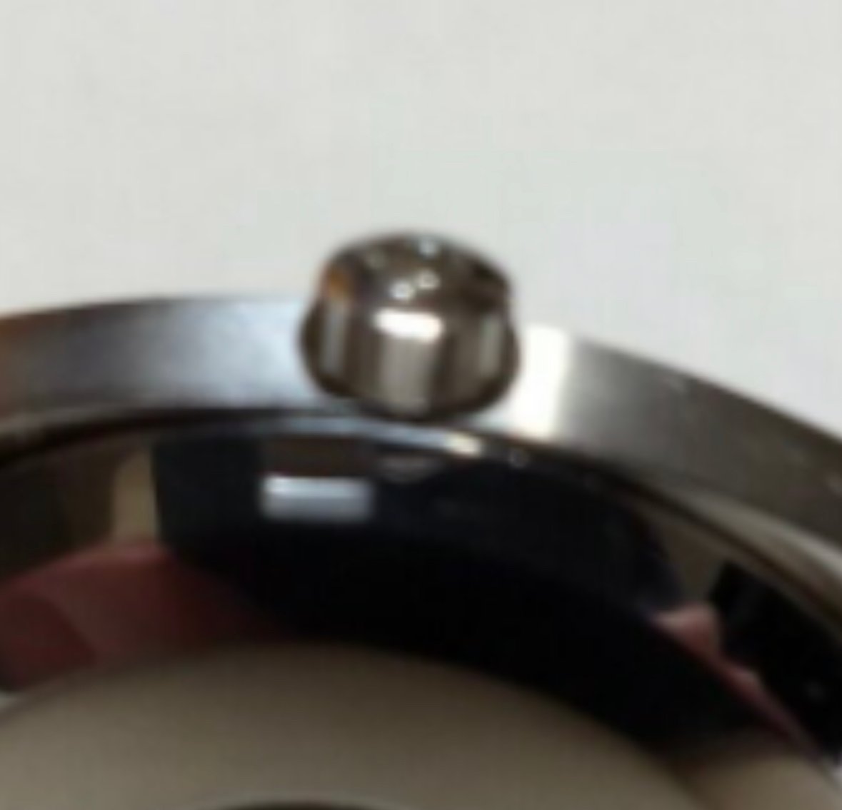

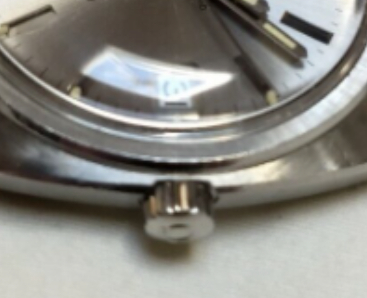

The photos on this post can be misleading and like noless says, on most of the shots, de camera is focusing not on the crown. The quality of those photos don't help either, as they are basically a snip of the actual photo in the auction. I guess, I will have to wait until the watch arrives and I am able to inspect it closely.
For now this is as close as I can get when I zoom in the auction pictures and take a photo from my computer screen. I do see the crown having a little bulge at the Omega logo portion. Below the photos:

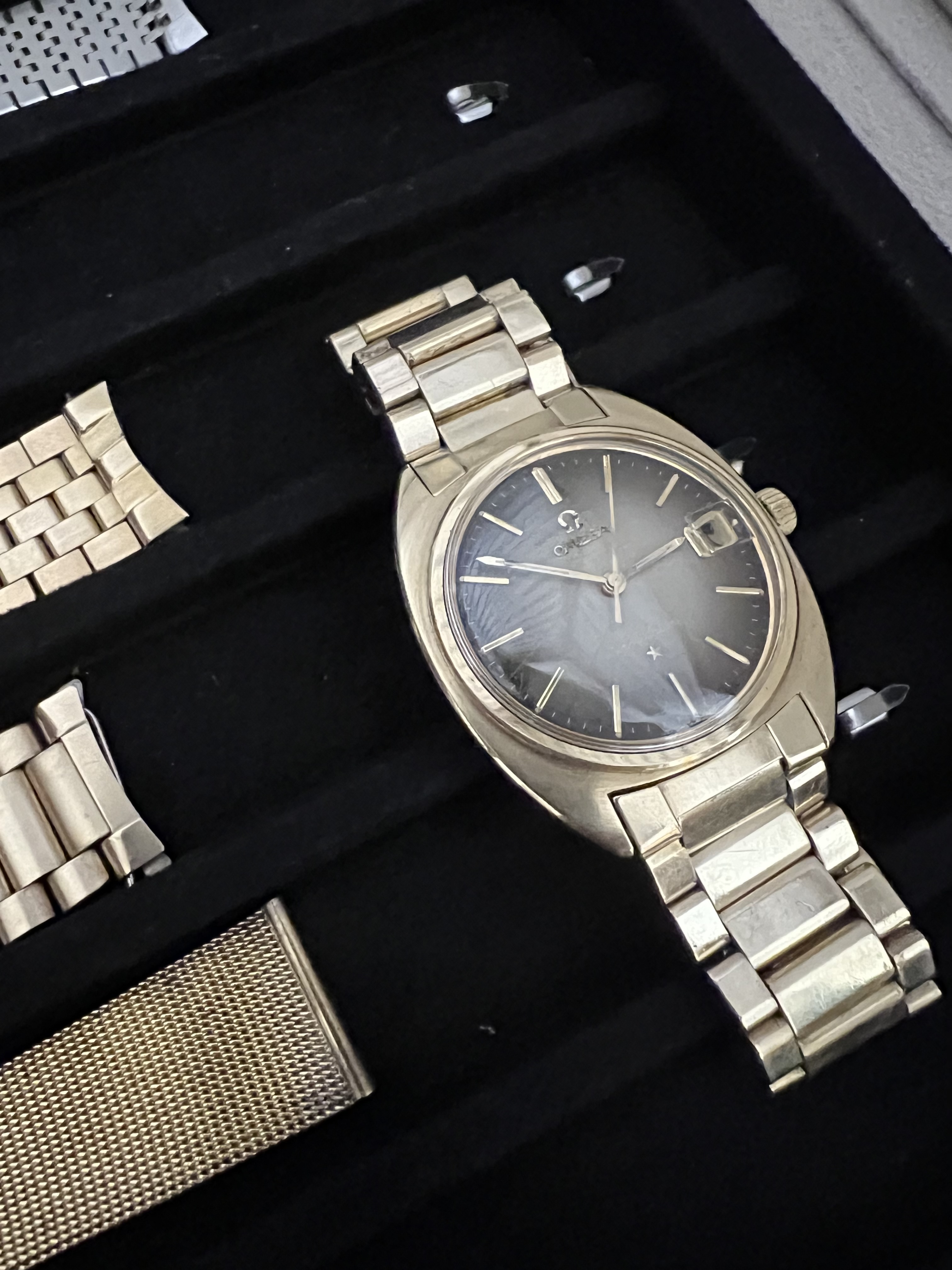

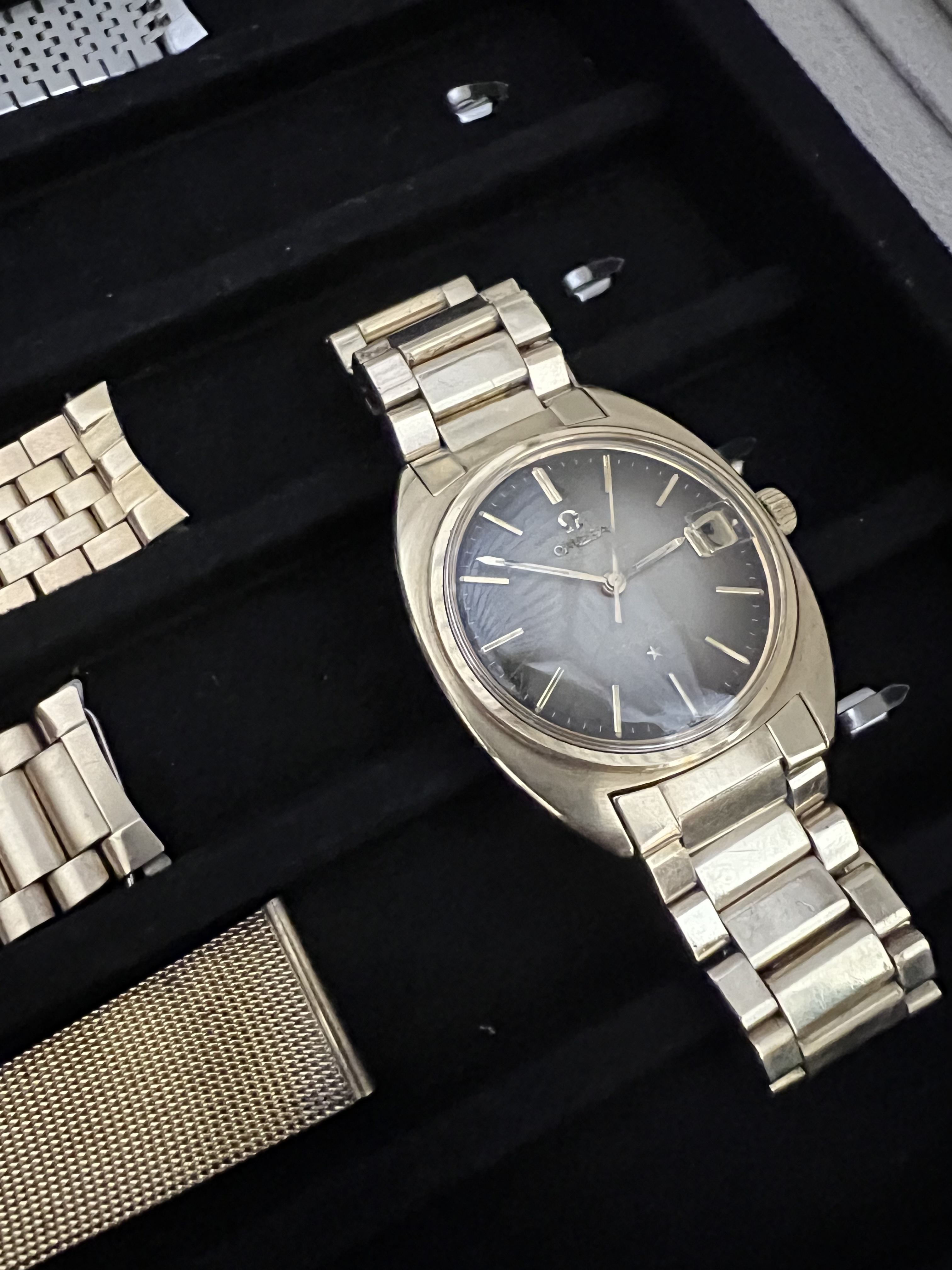

A gold coated 1175 on a C-Case, really want one of these in steel yet they are tricky to find undiscovered
Endlinks are 78 instead of 77

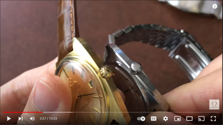

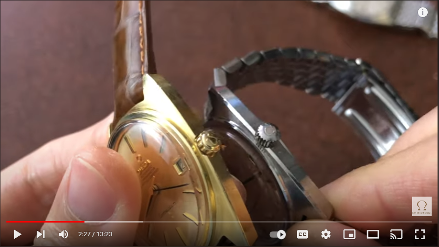

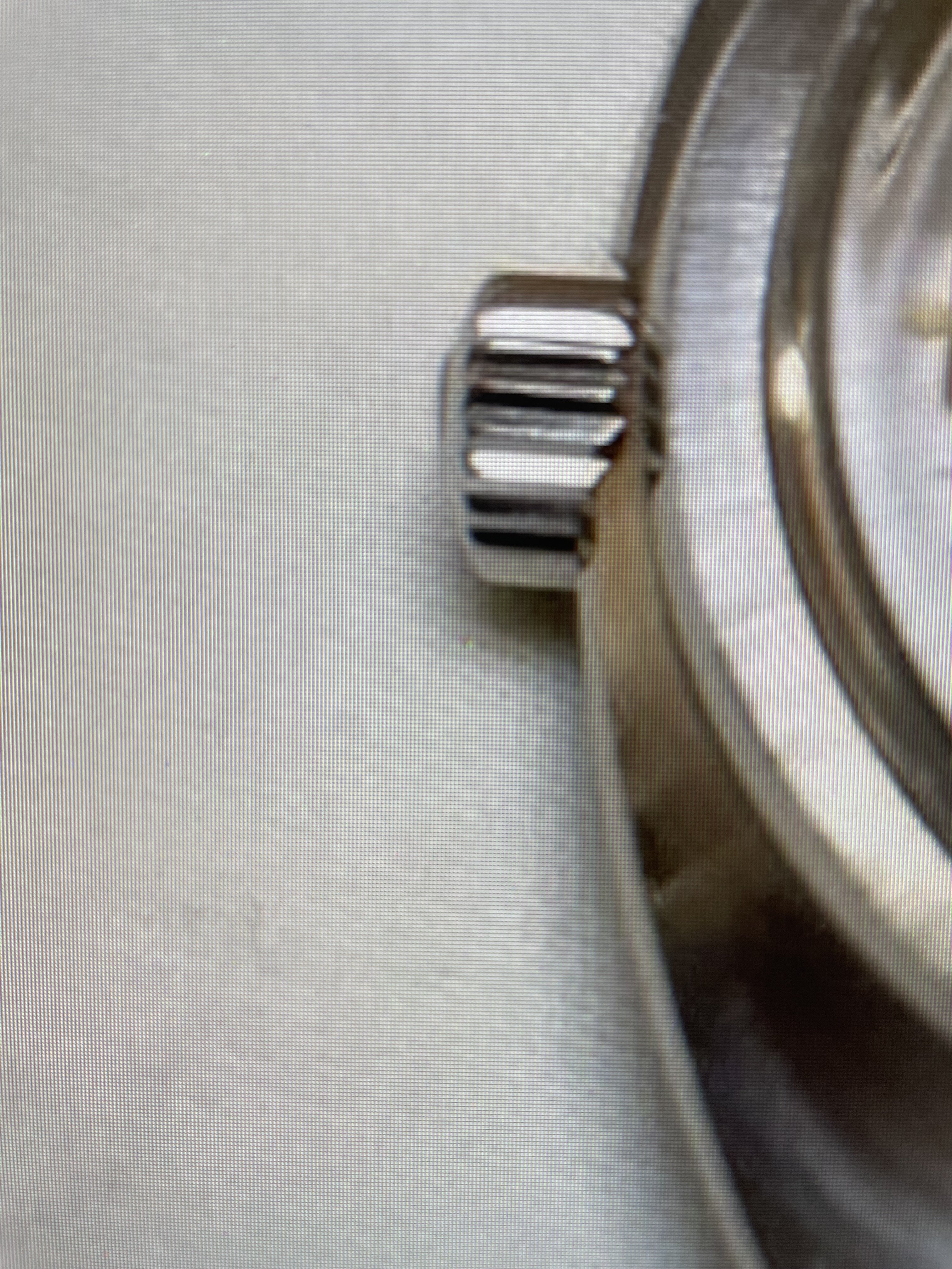

I found this video on youtube which around minute 2:27 talks about the crowns. I believe the crown my C-Shape has is the one on the right. I should receive the watch sometime this week and will verify.
For those interested here is the link to the video:
I don't know how well versed on the C-Shape is the youtuber that produced it... but I'll share it anyway.
444
878
He doesn't mention anything about how many watches will have service crowns which are a slightly different shape.
Its a matter of taste as to how much that matters to you though. Personally I will take a crown that actually seals over the correct but no longer sealing crown...

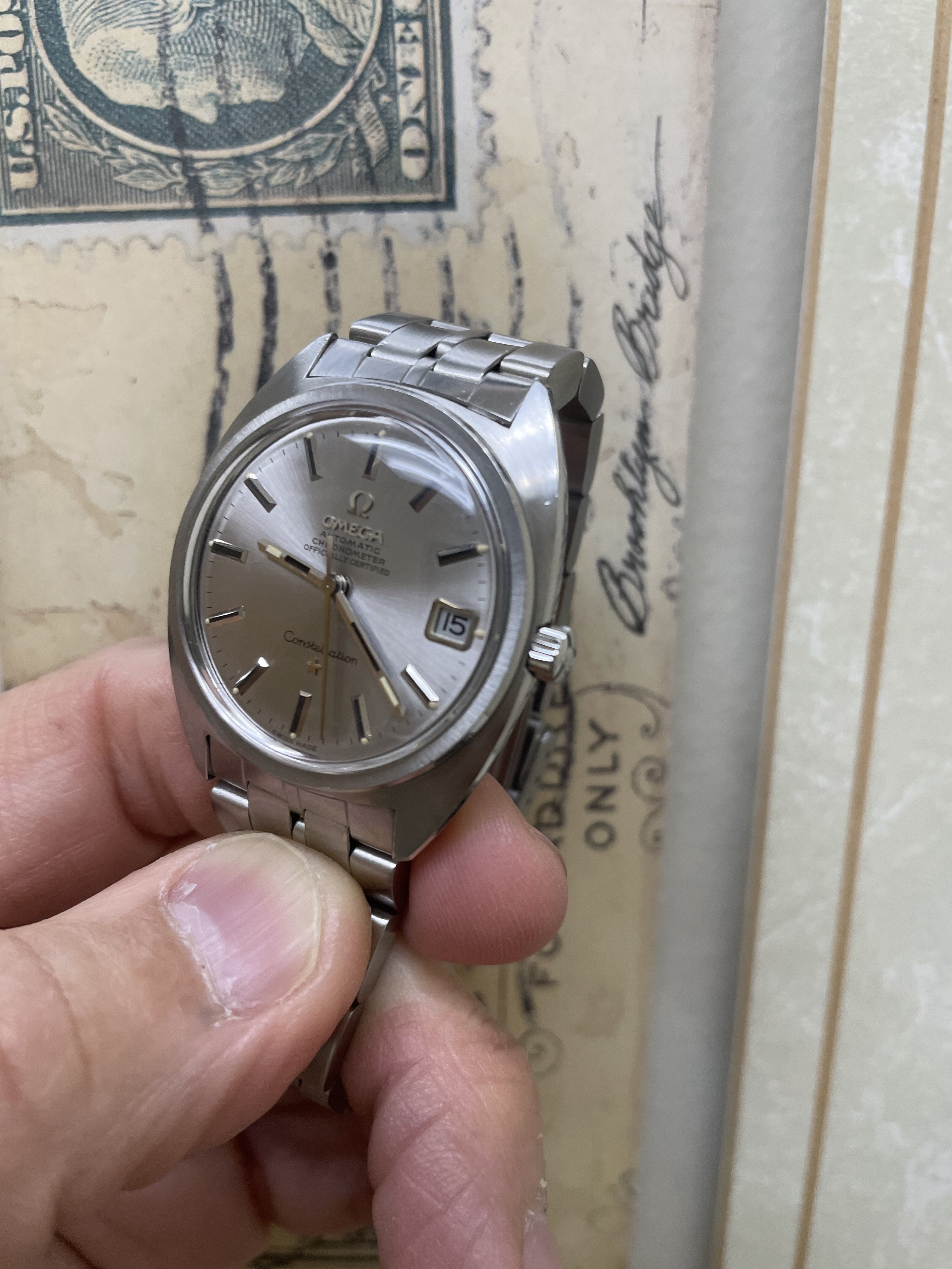

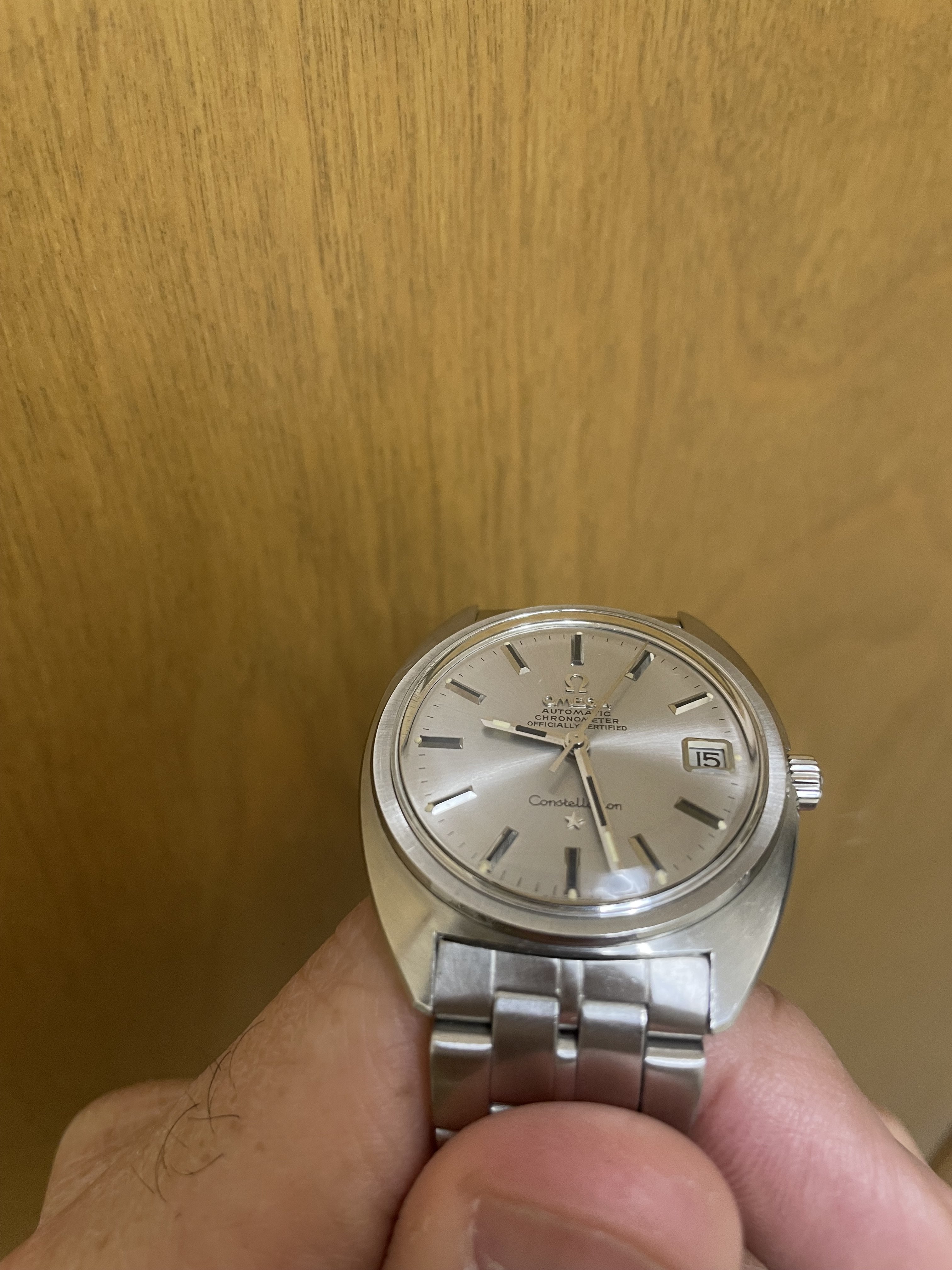

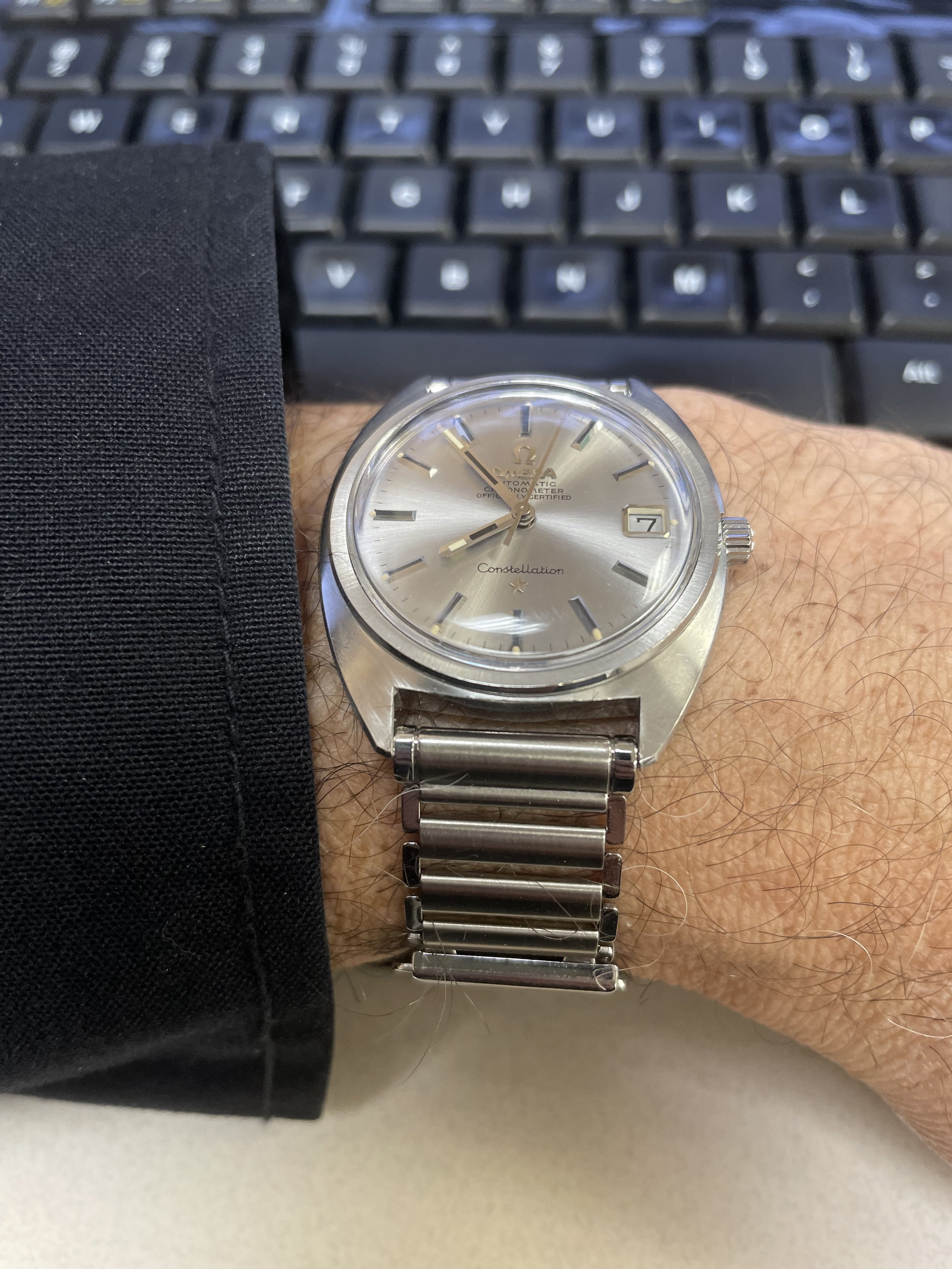

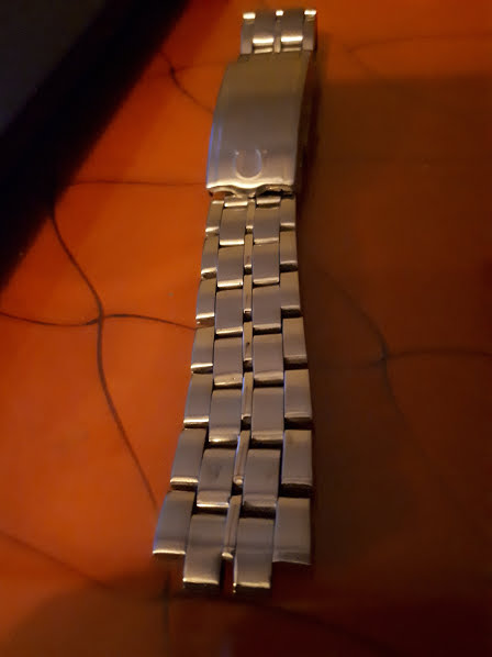

I'm afraid I have no idea of the terminology around straps, so can't answer that question directly. Here is a pic though:
I believe that bracelet ref. number is 1172

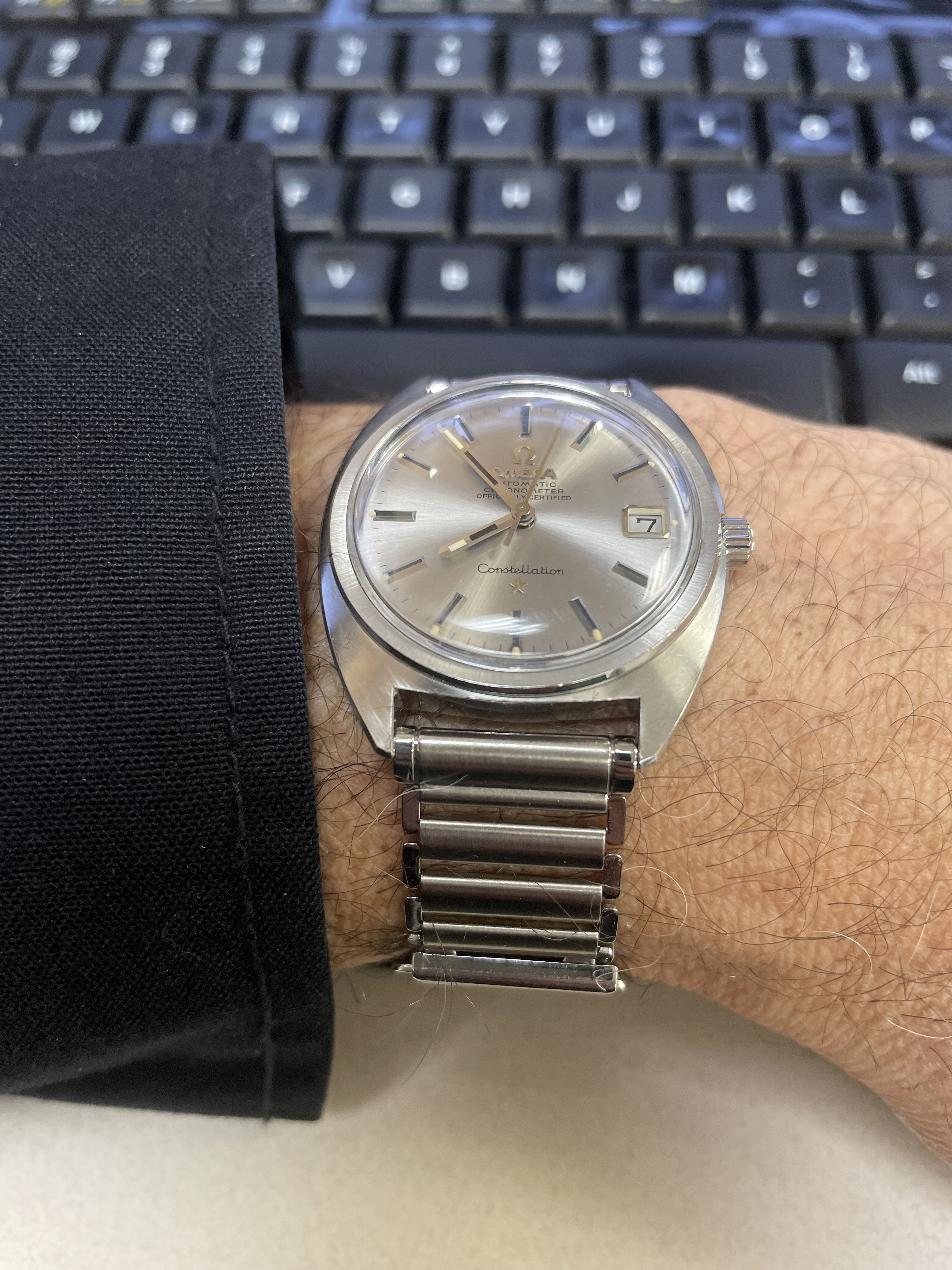

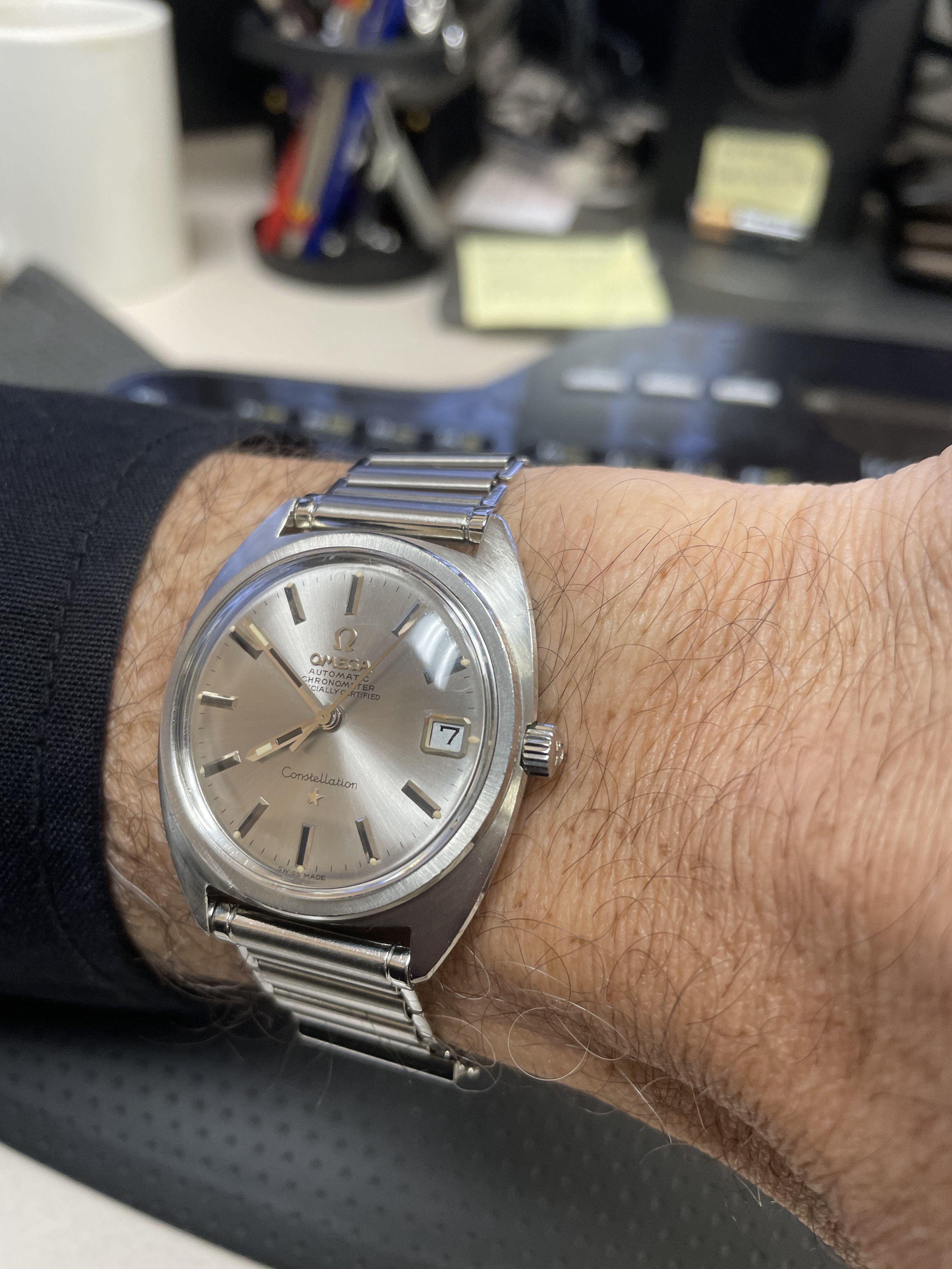

The bricks bracelet looks great on these, but that beads of rice pairing is a nice change of pace. Is that an Omega 1037 with 570 end links?
Edit: now I see that’s a 1068/620 for the 19mm lugs.

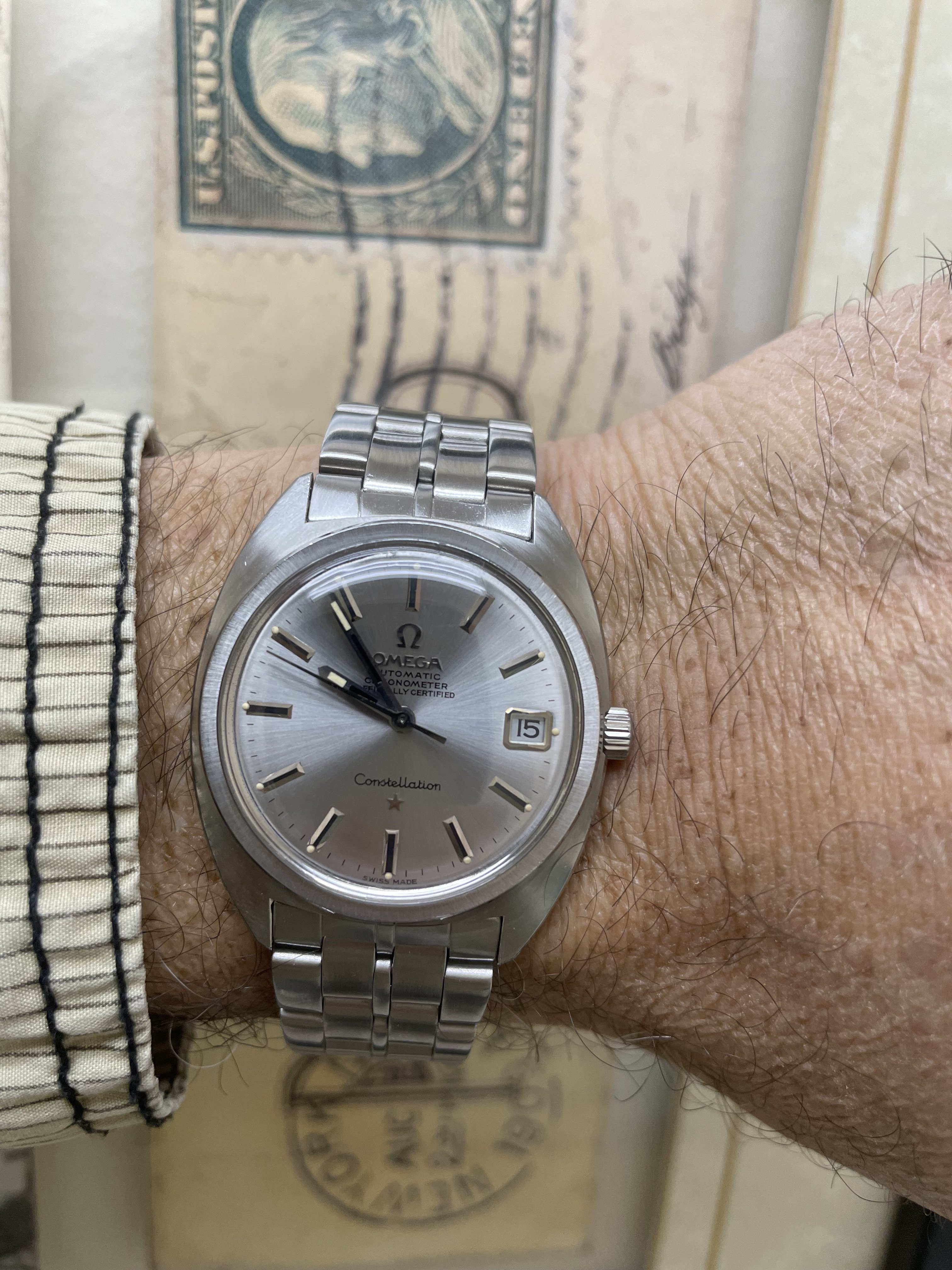

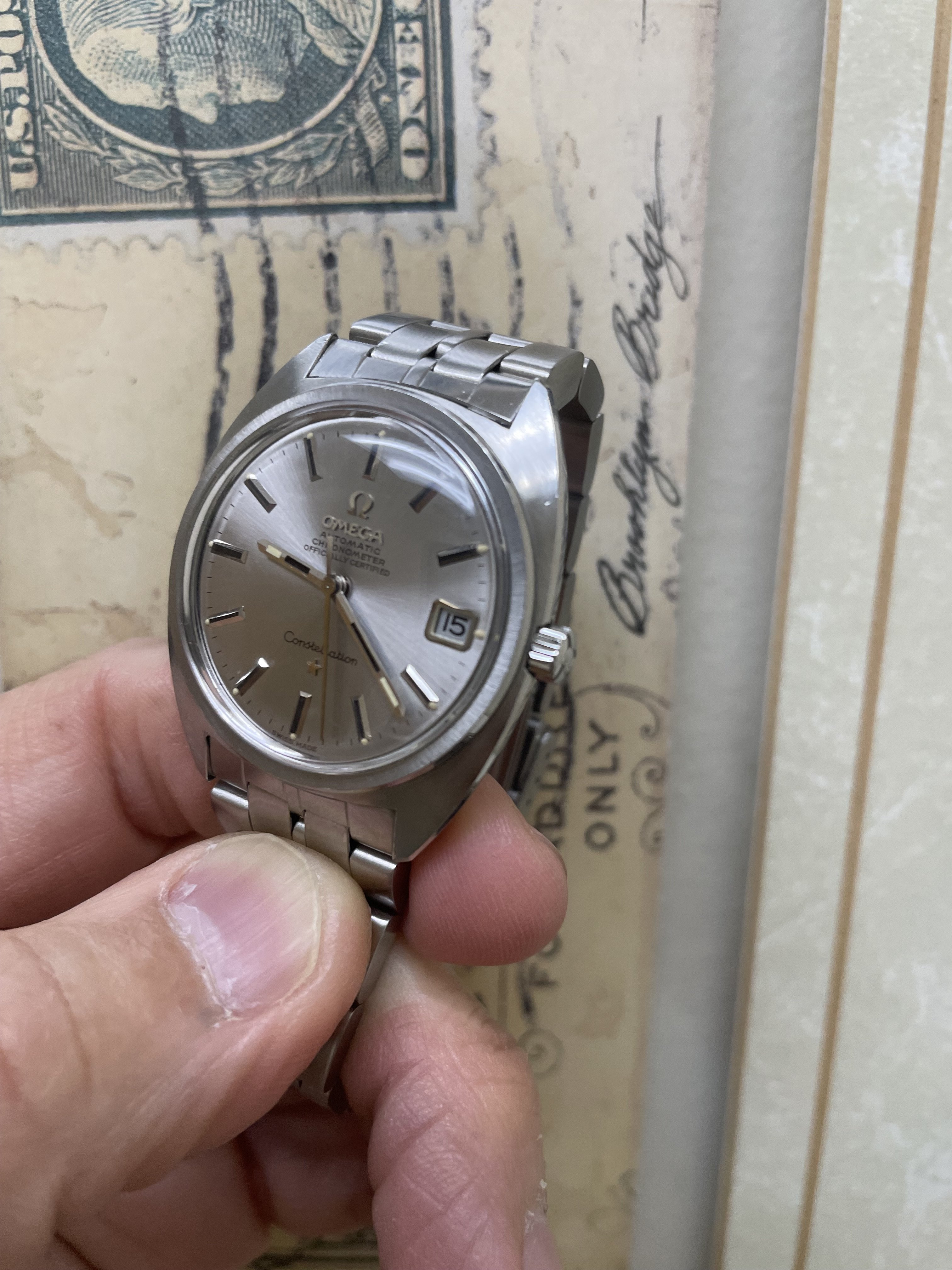

Installed the 1172-515 bracelet that arrived this week...
Great example, it looks fantastic! Nice pickup!
