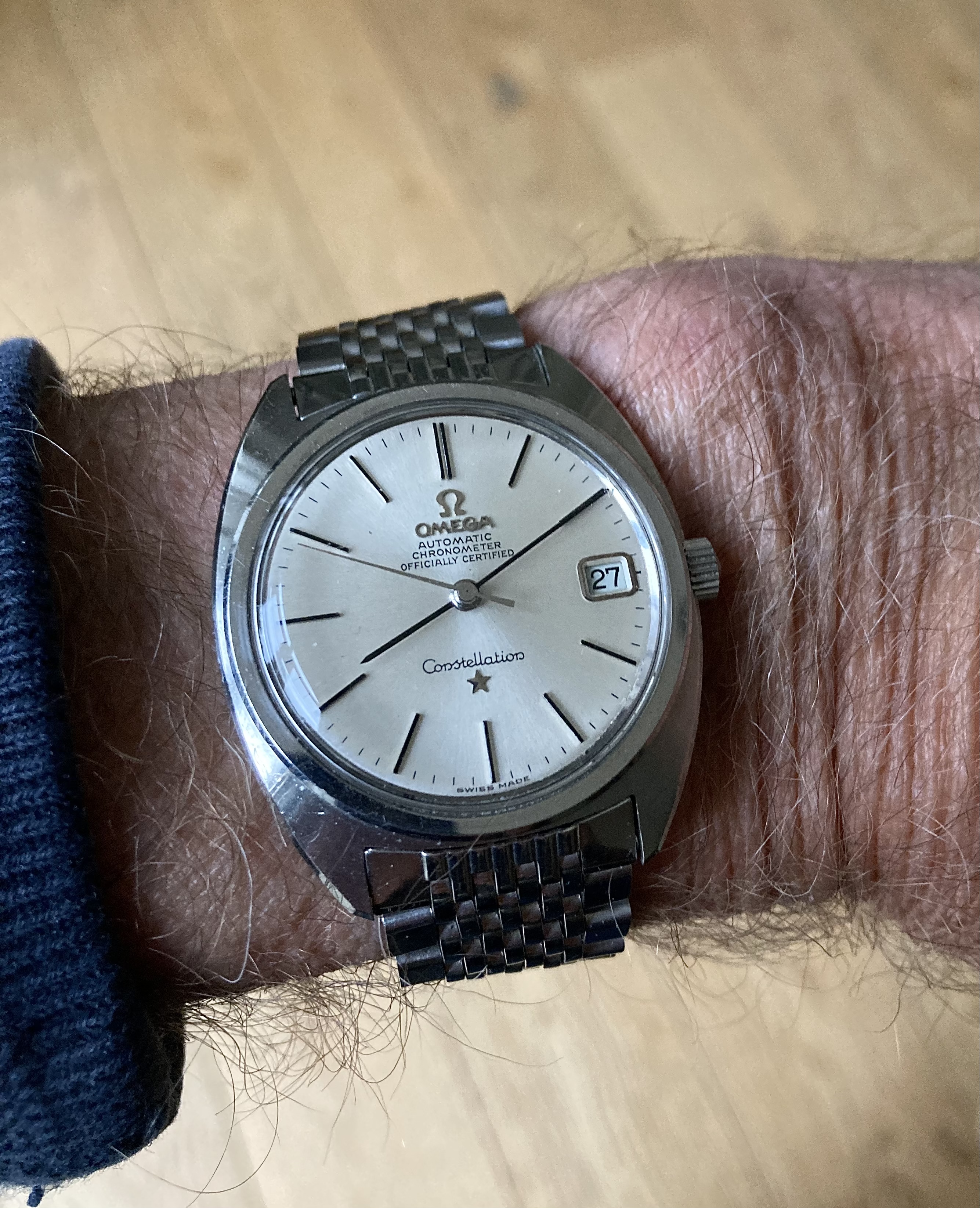

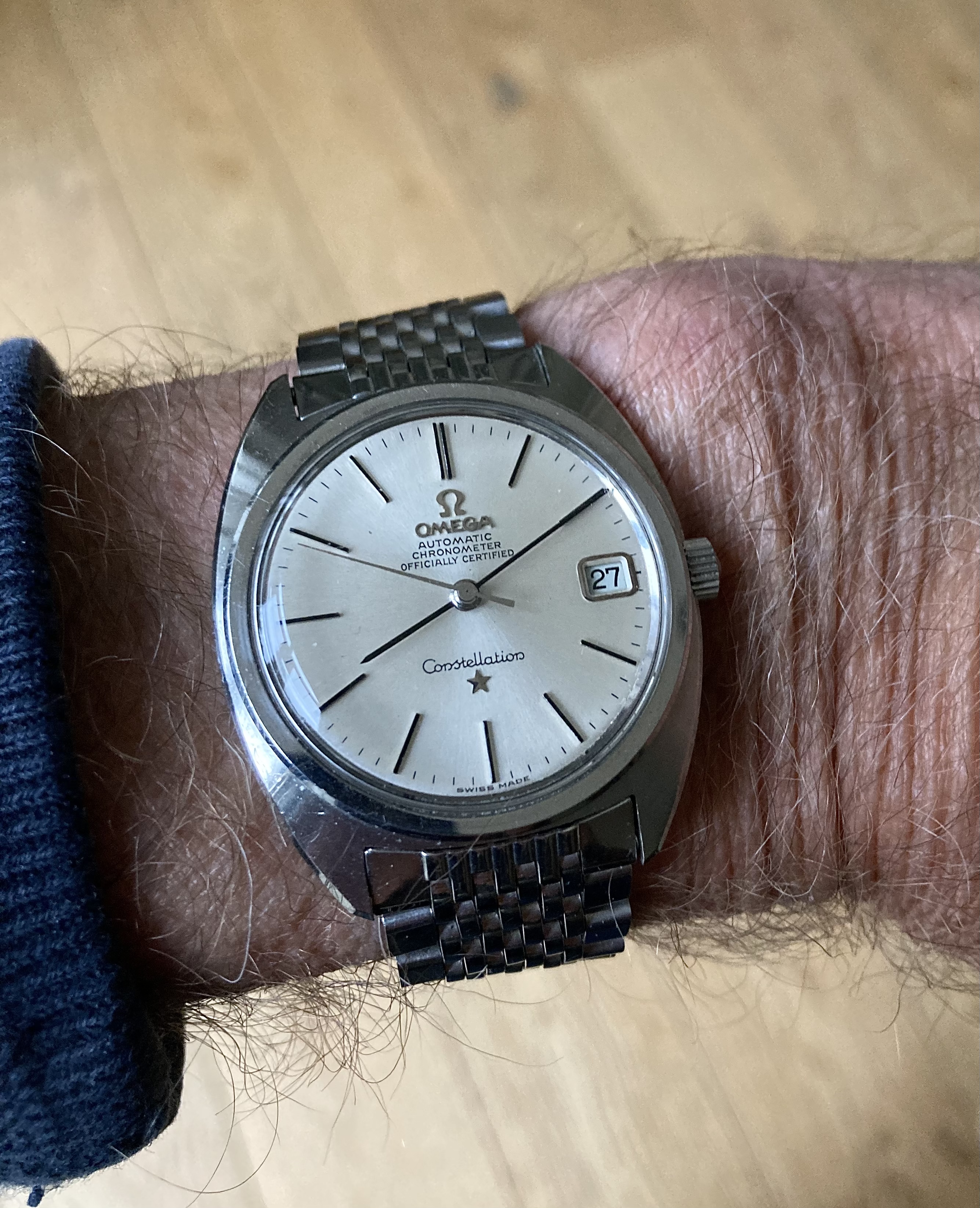

My own example has serial number 31936153 and has the "transition" type dial, i.e. with the old layout (Omega at the top, Constellation + star at the bottom), but the new font (straight final "n" in "Constellation" etc.). I've also seen 1970 numbered watches with the old font however, including (oddly) at least one that has a serial number higher than mine, in the 32 millions. But there were also c-cases with the 751 movement made in 1970 that had the full new style layout and font (Omega at the bottom, Constellation at the top, no star), before the transition to the 1000 series movements, right..?

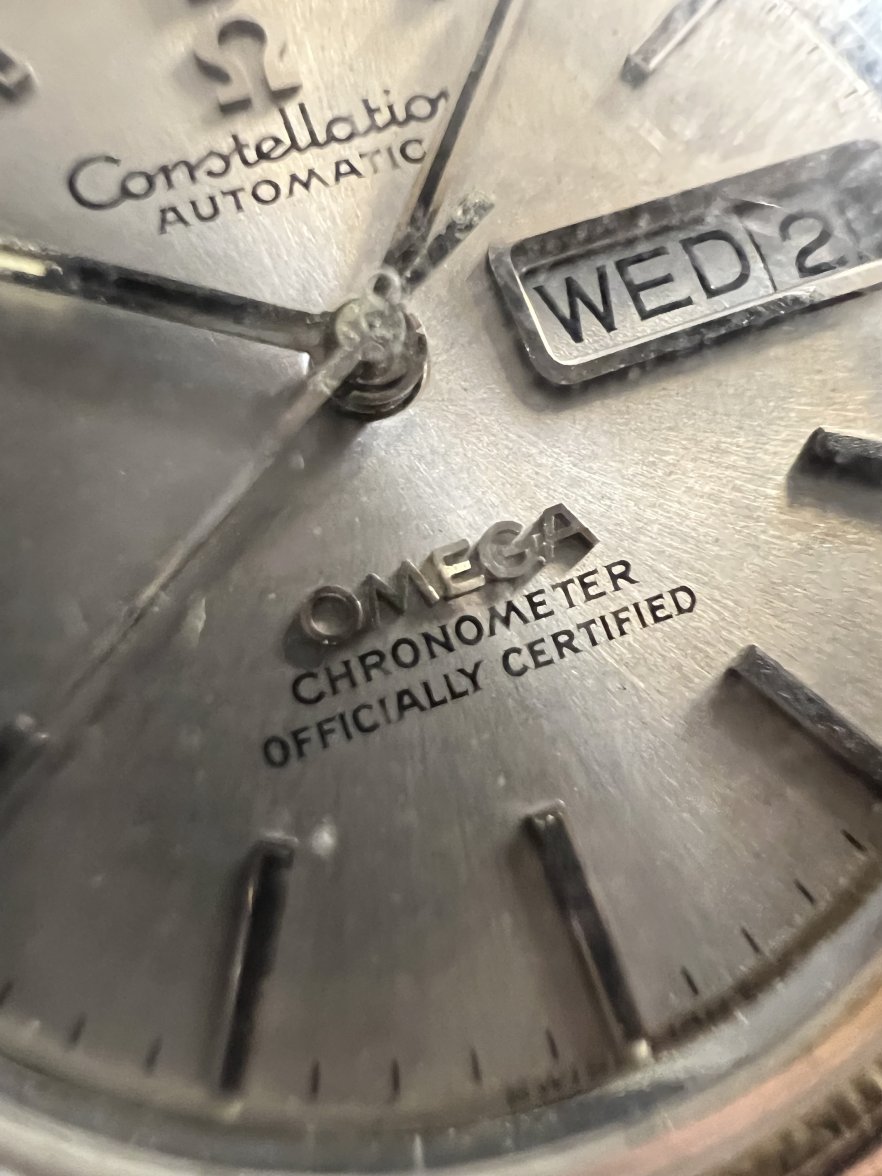

Nice observations @Neeb - There's also 2 straight "n" fonts, the last one I believe is the long "C" straight "n"s - which @Archer said was used on service dials - so my theory is, this was the final form of the traditional dial and probably why it's in stock, this is all assuming they are old stock
It'd be pretty surprising if we can come up with any meaningful serial patterns other than year ranges, so far it seems very scattered to me, the only clear cut is 1966 to 1967 when new models were introduced
I’d be very grateful if someone could post a picture of the service dial style (long C, straight n). Sorry, I know there are some in this thread but they are very difficult to find because you can’t search for strings (only words), and there are an awful lot of hits for both “service” and “dial” 😁

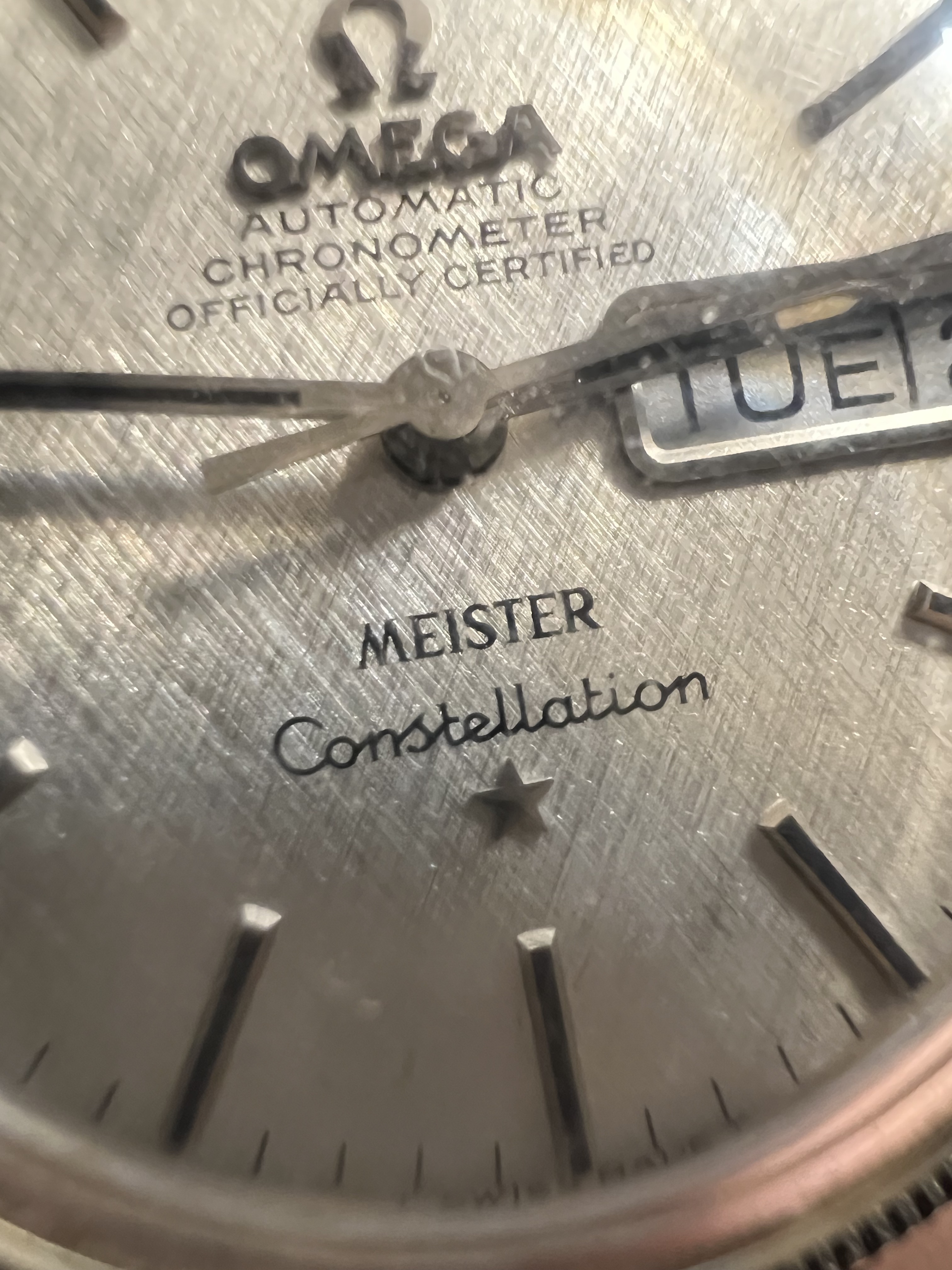

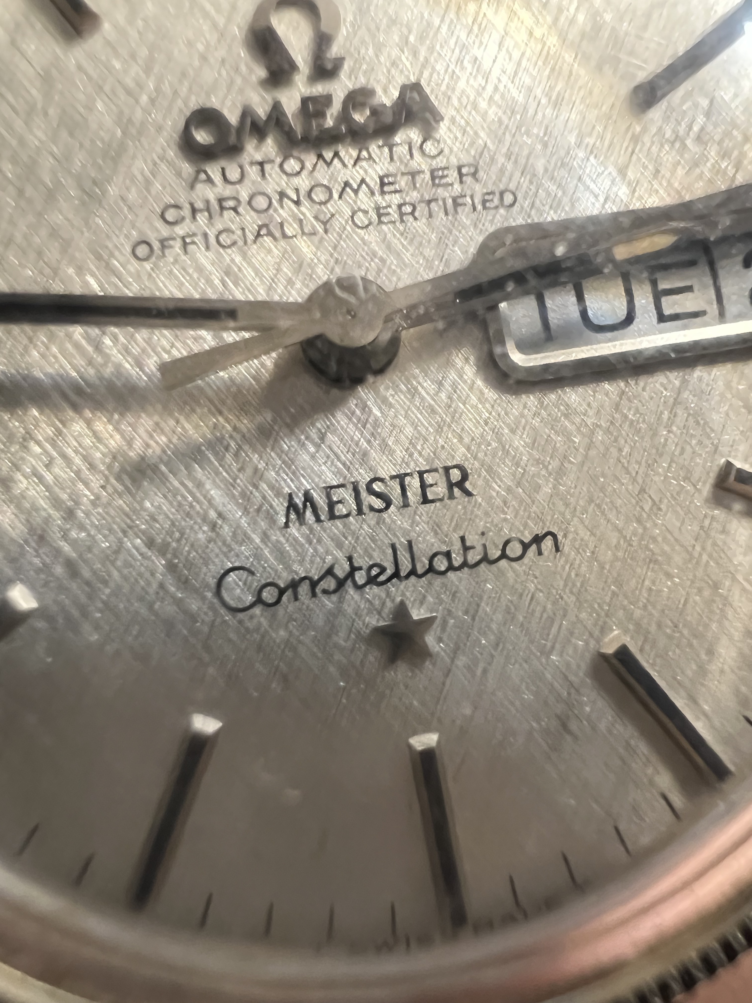

Just the straight "n"s on a linen dial is I think very uncommon too, I only have this Meister one, but it's pretty common on gray dials and other 168.017 dials
Edit: By the way I never opened 75% of watches in my collection, but slowly taking a deeper look at them, logging their details, I'll let you guys now if there's a consistent relation between fonts and order of serials - quite curious whether any regular 168.029 exceeds the newer style dials but I'm pretty sure they will

My 168.029 is identical to yours (except for not being Meister branded).

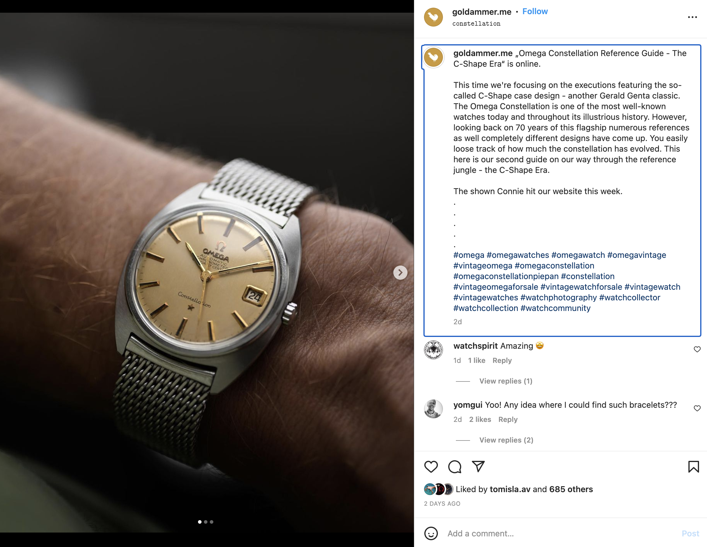

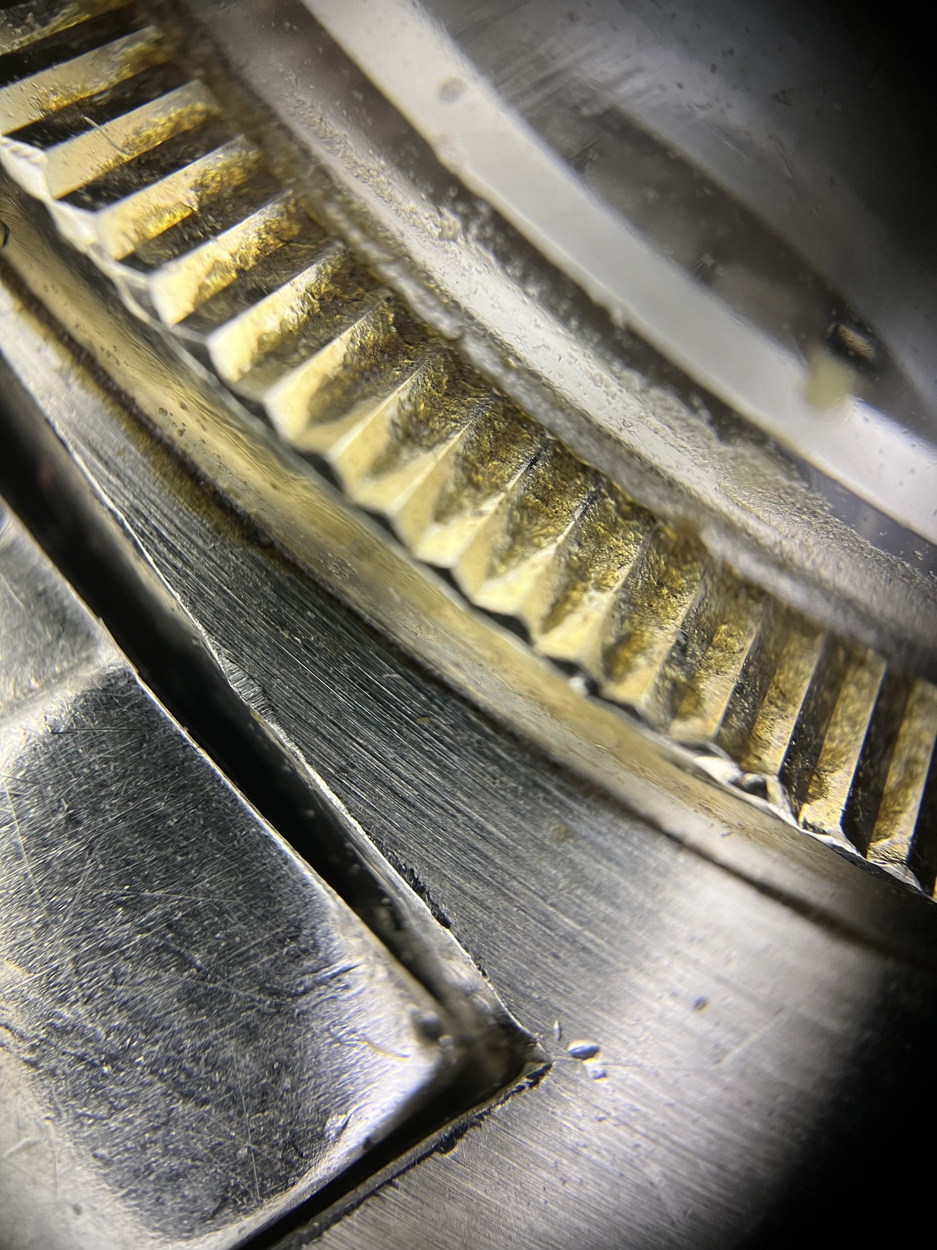

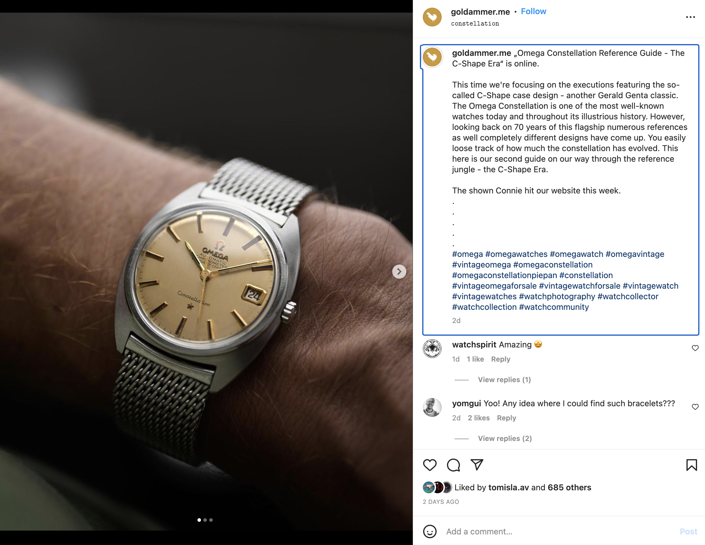

Unfollowed these guys after they shared a half ass article on C-Case's, their main example is a Frankestein watch with a dial from a bigger Constellation with bigger hands that they are selling, quite a wonder it can even function inside the C-Case, you can see the hand almost touch the crystal - and I suspect to make it work, they used a very loose crystal with no armor ring, quite a wonder in fabrication
A general warning to avoid Goldammer

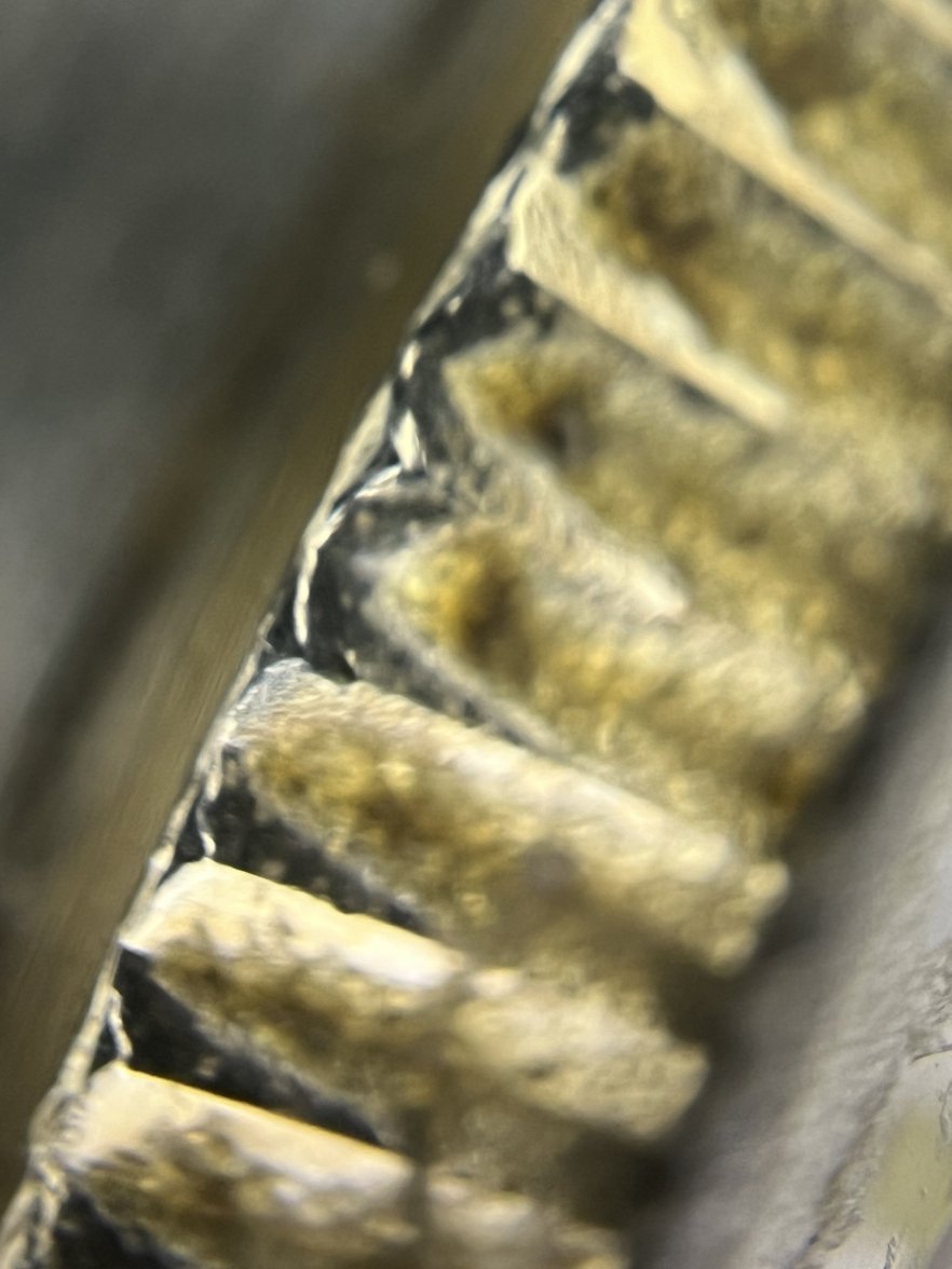

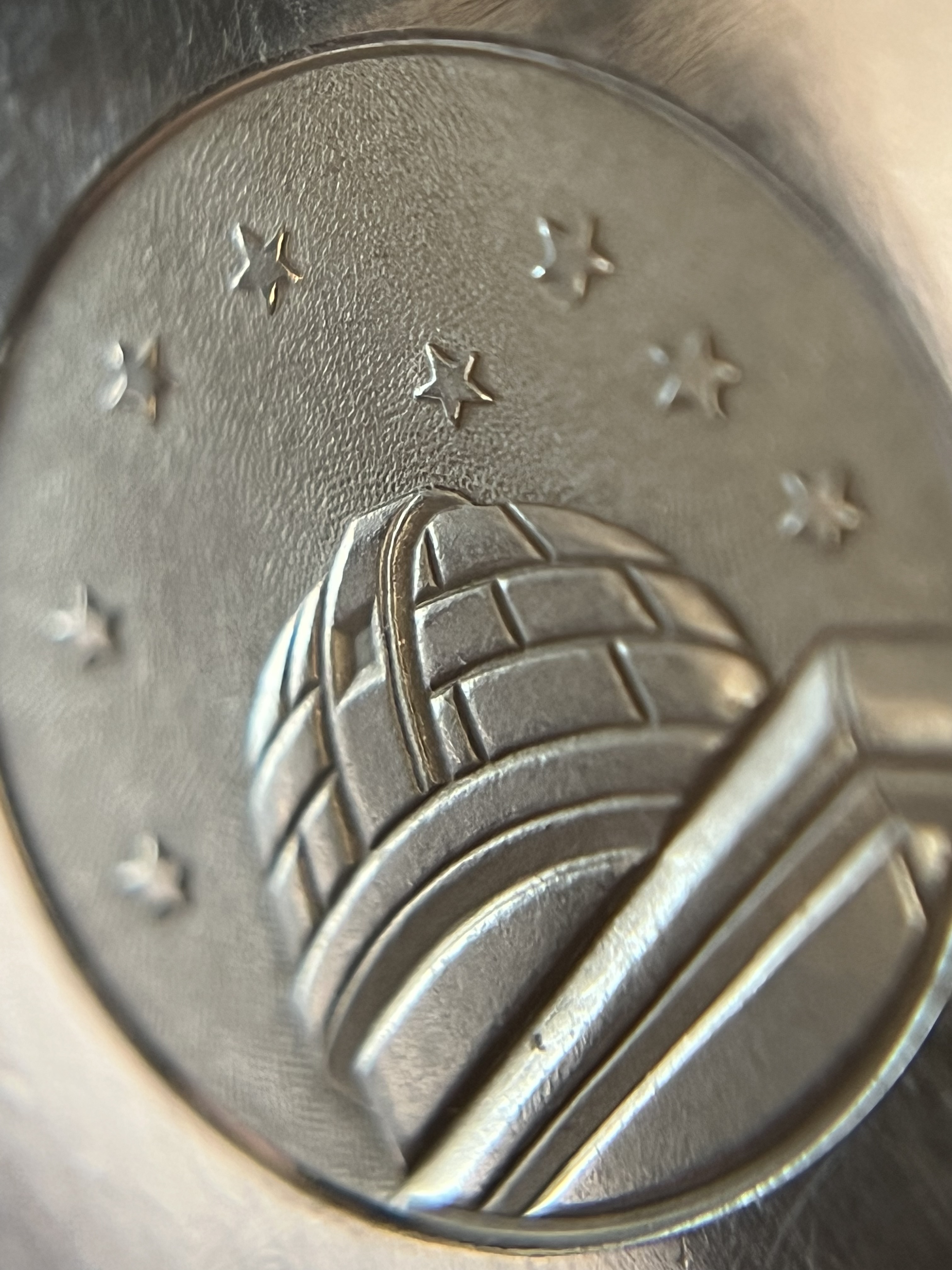

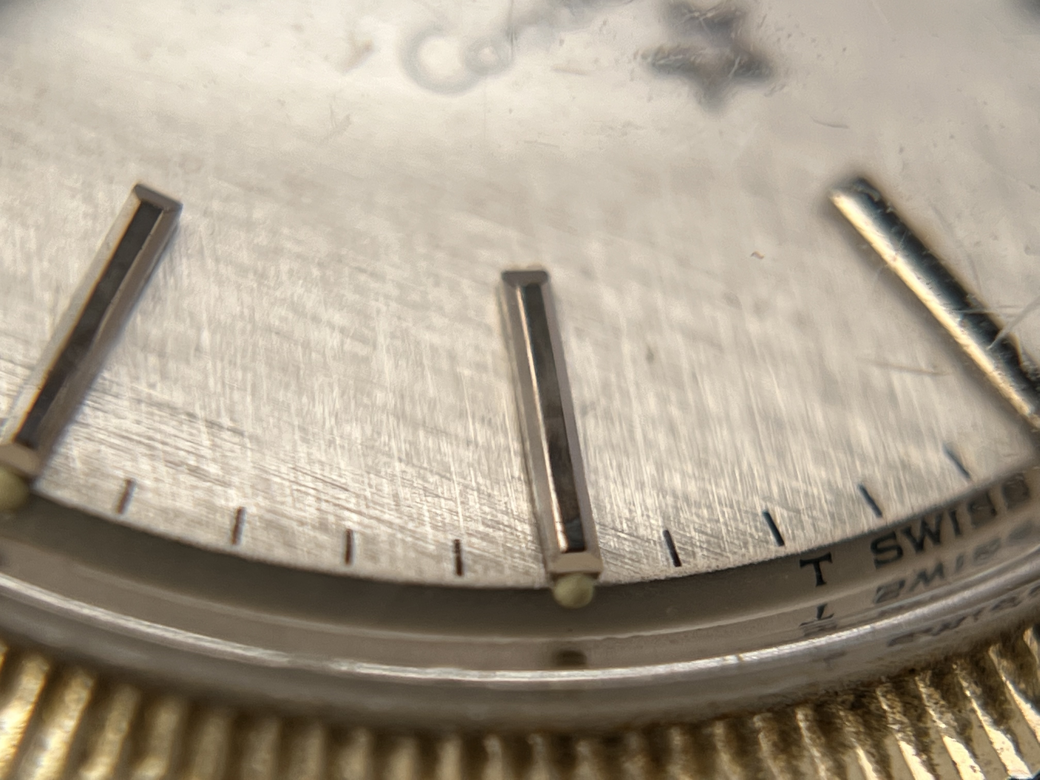

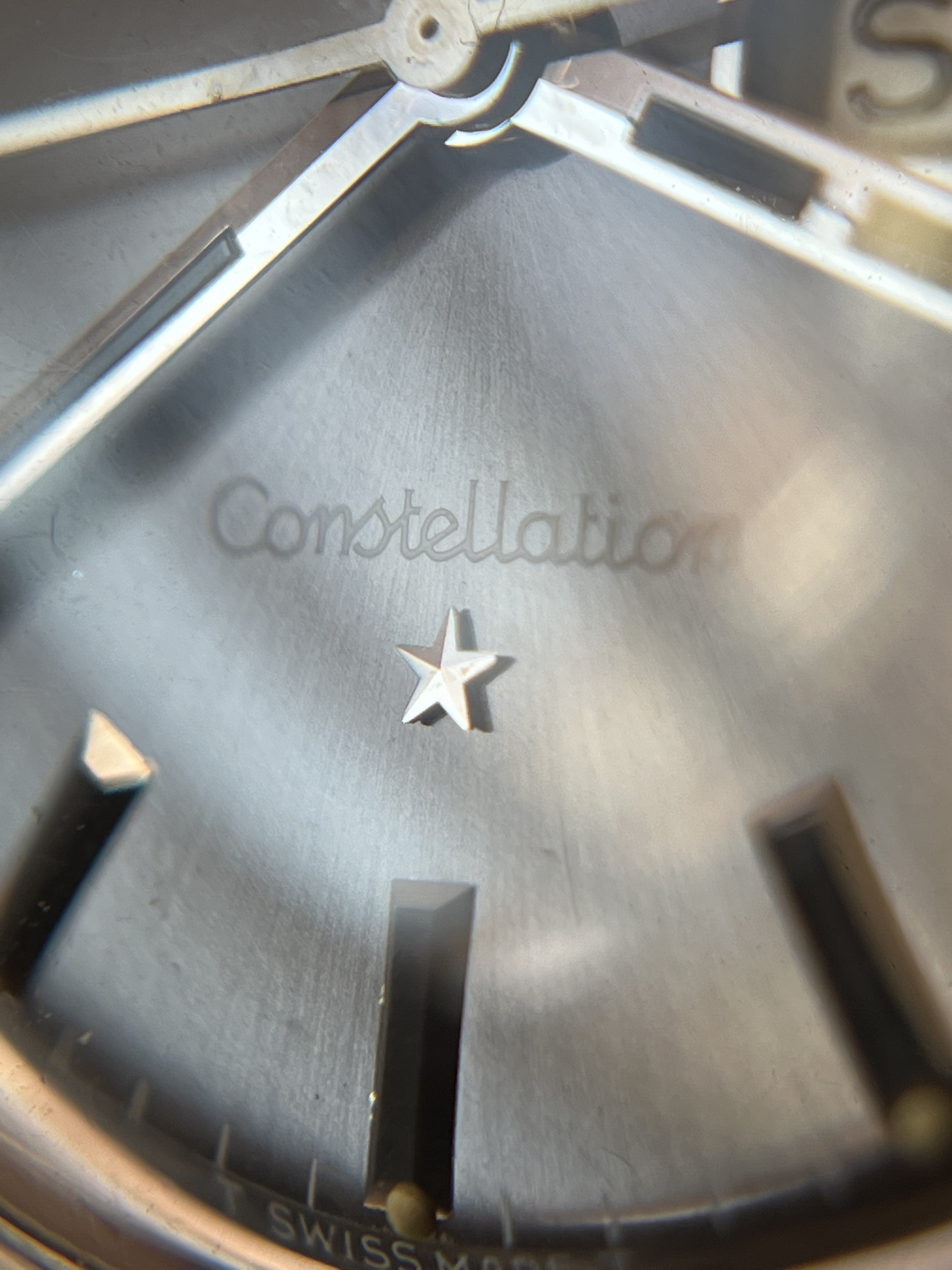

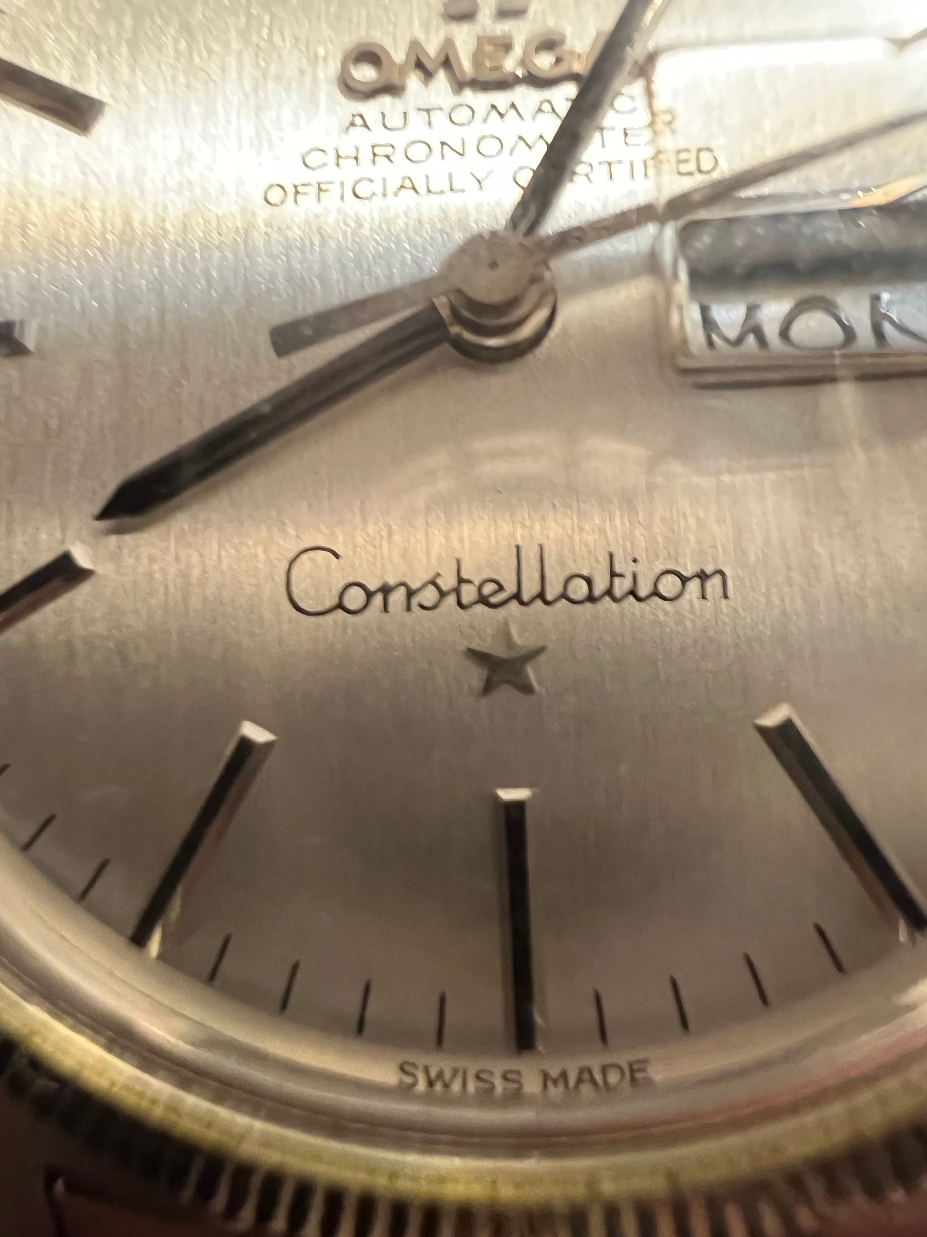

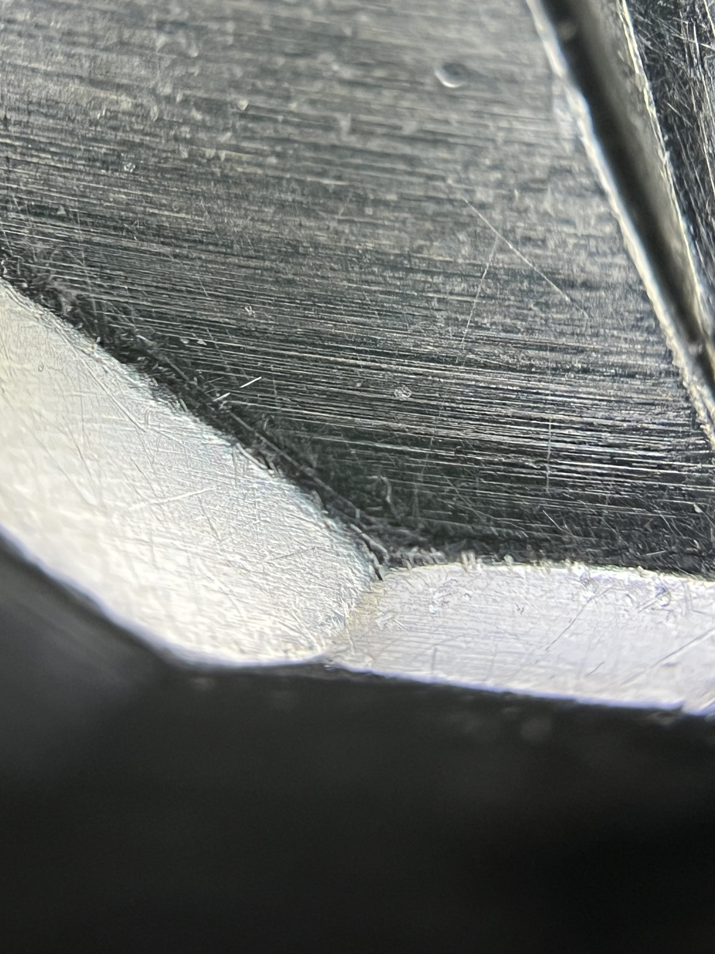

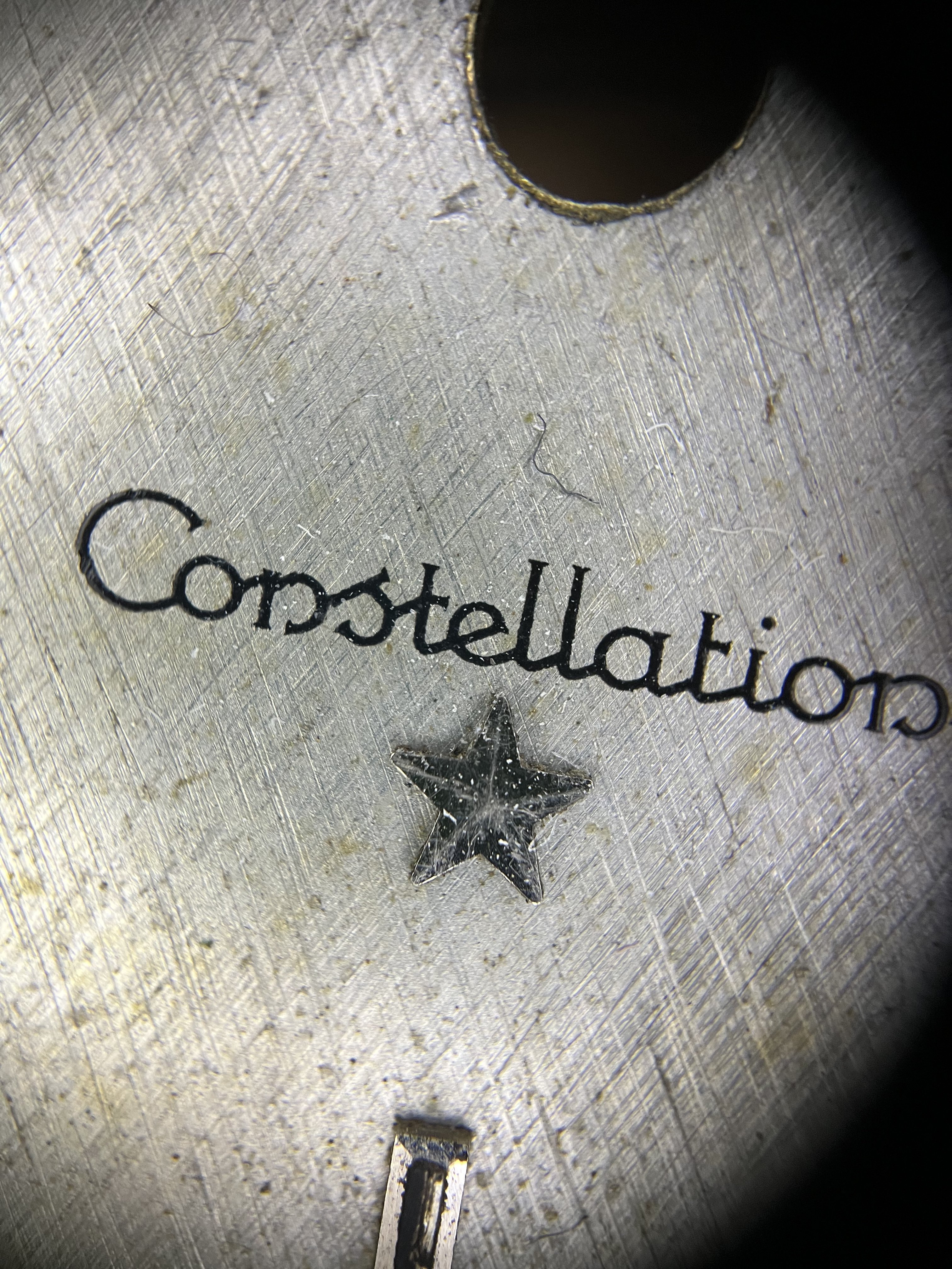

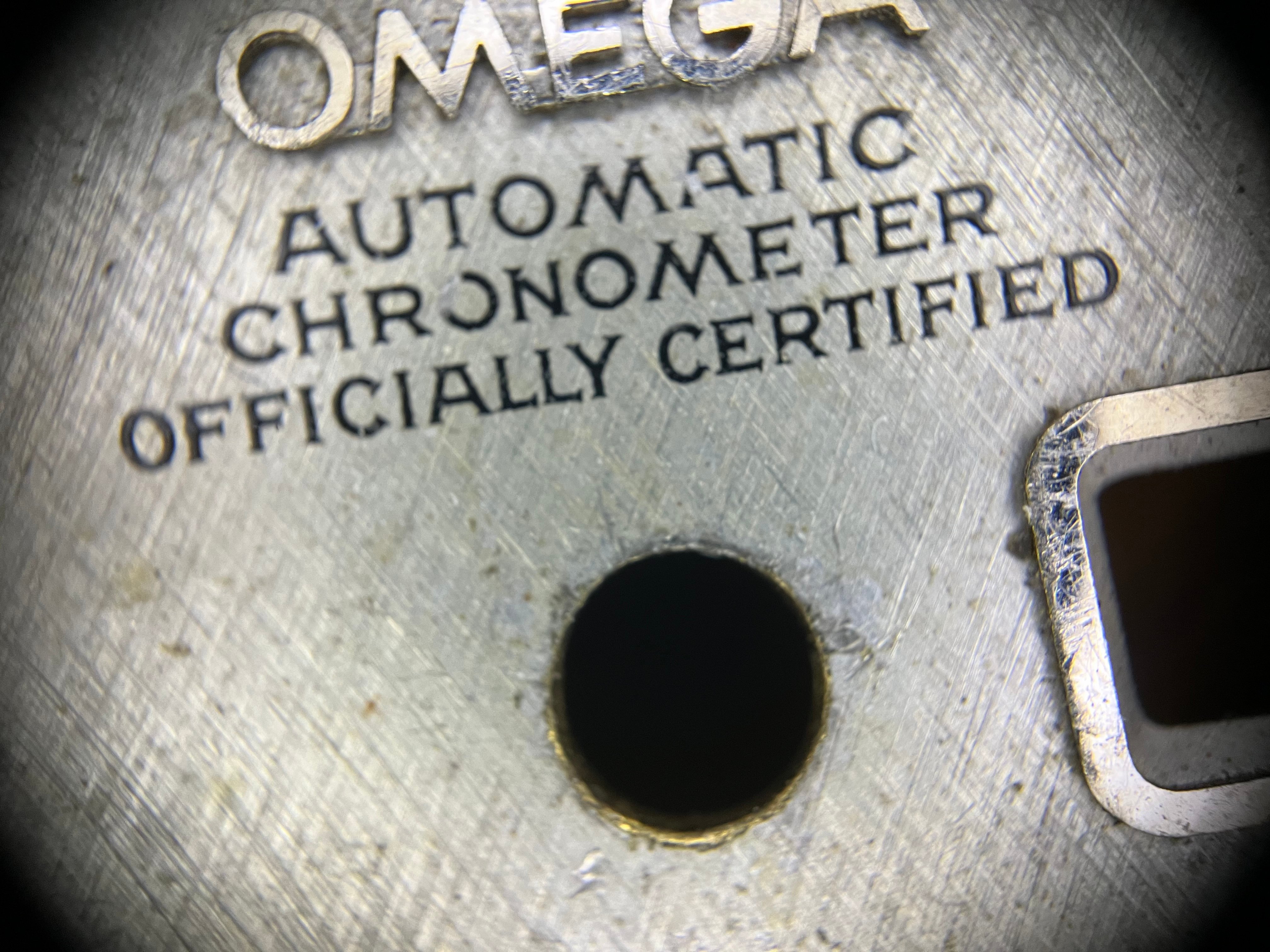

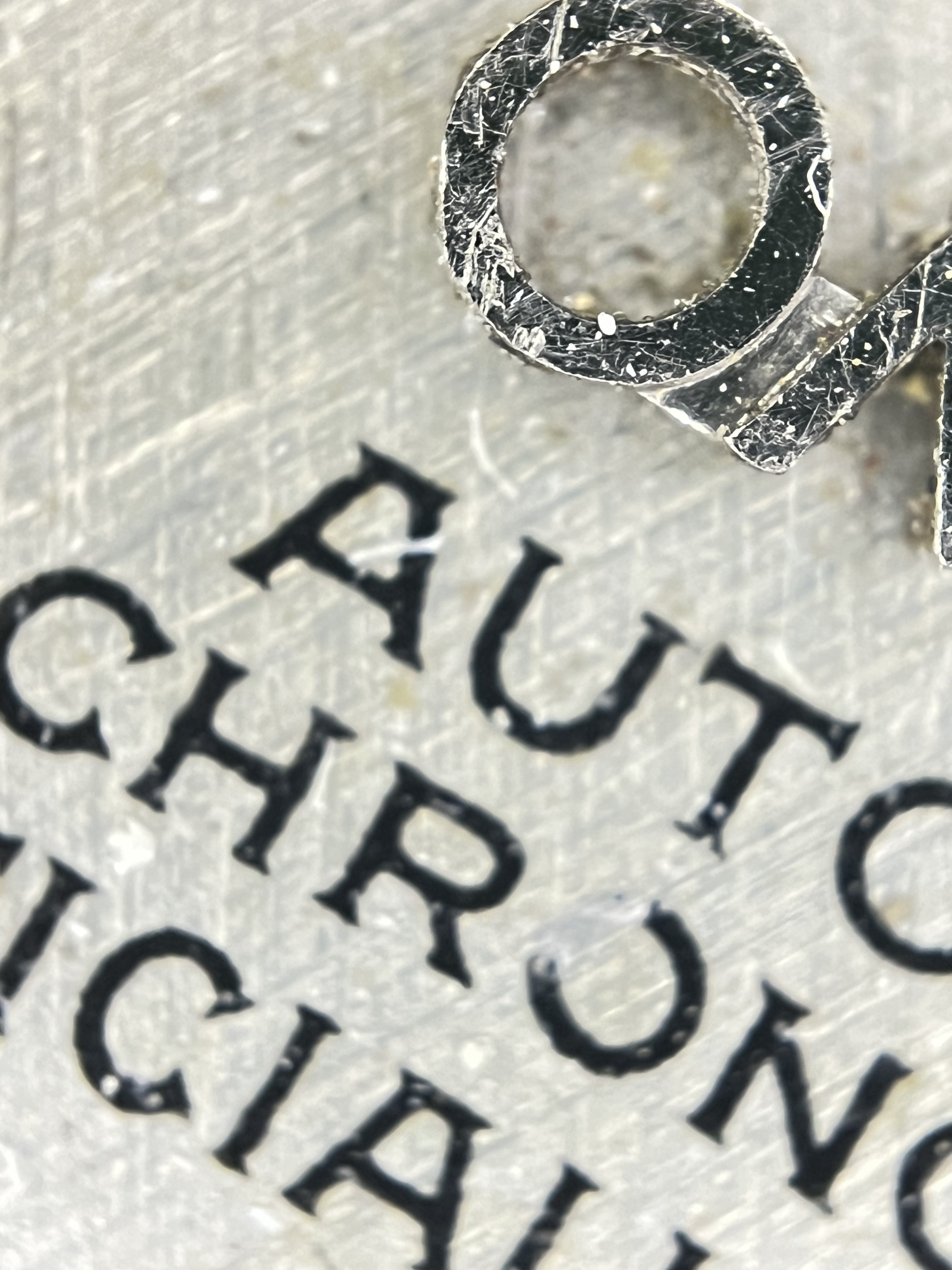

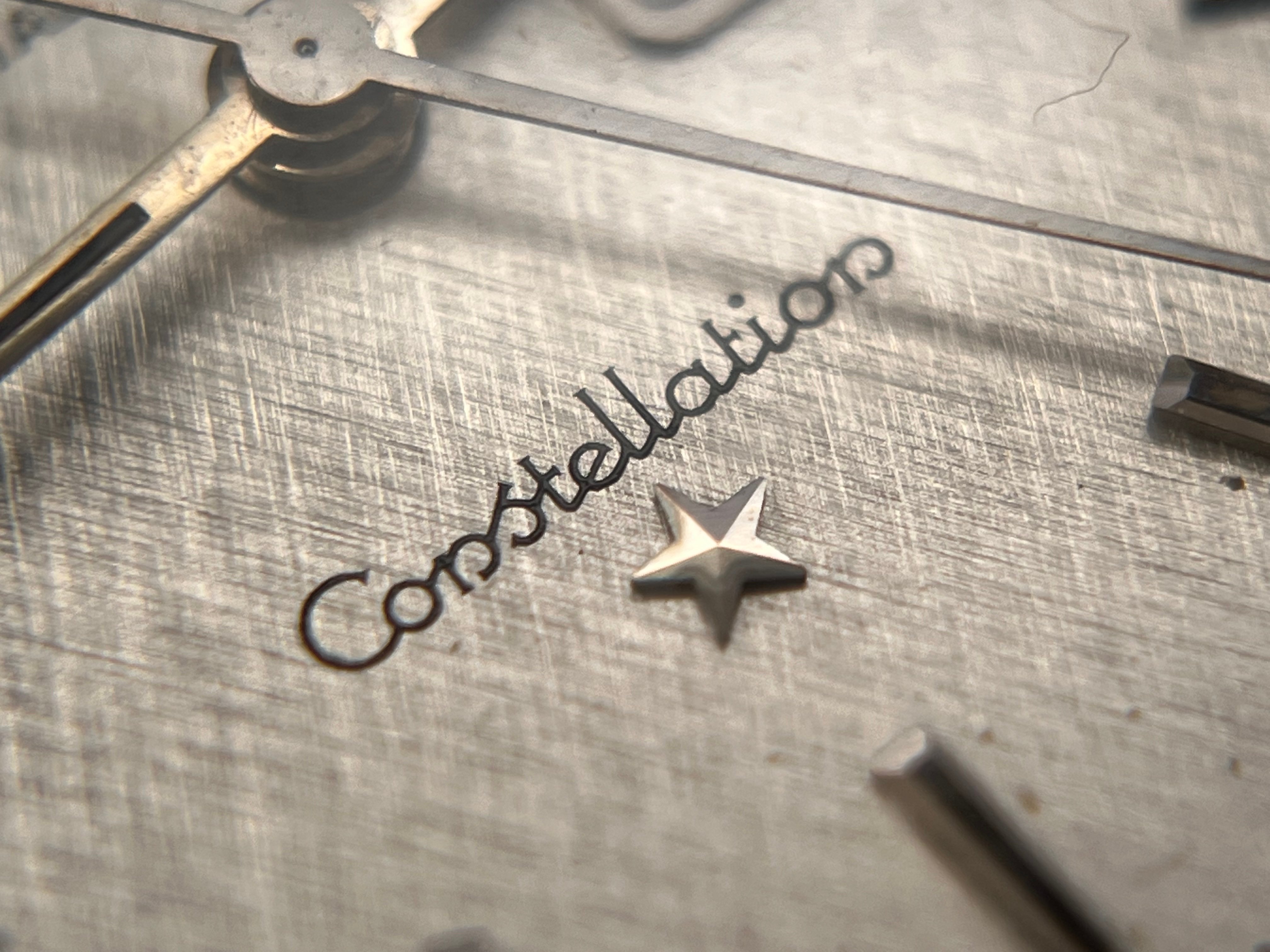

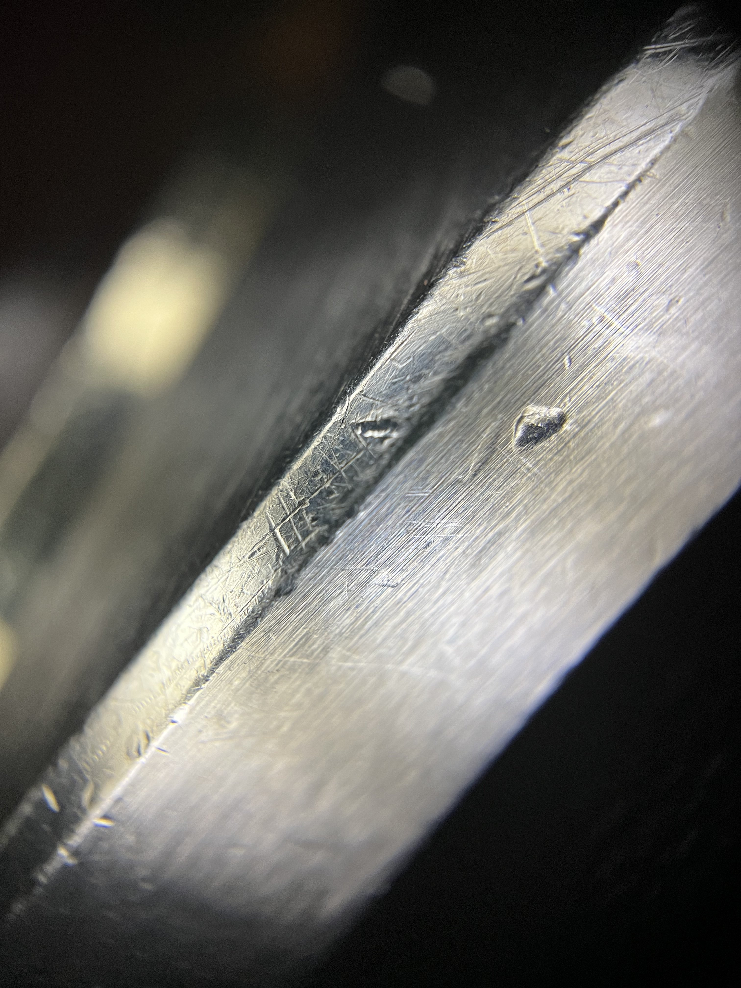

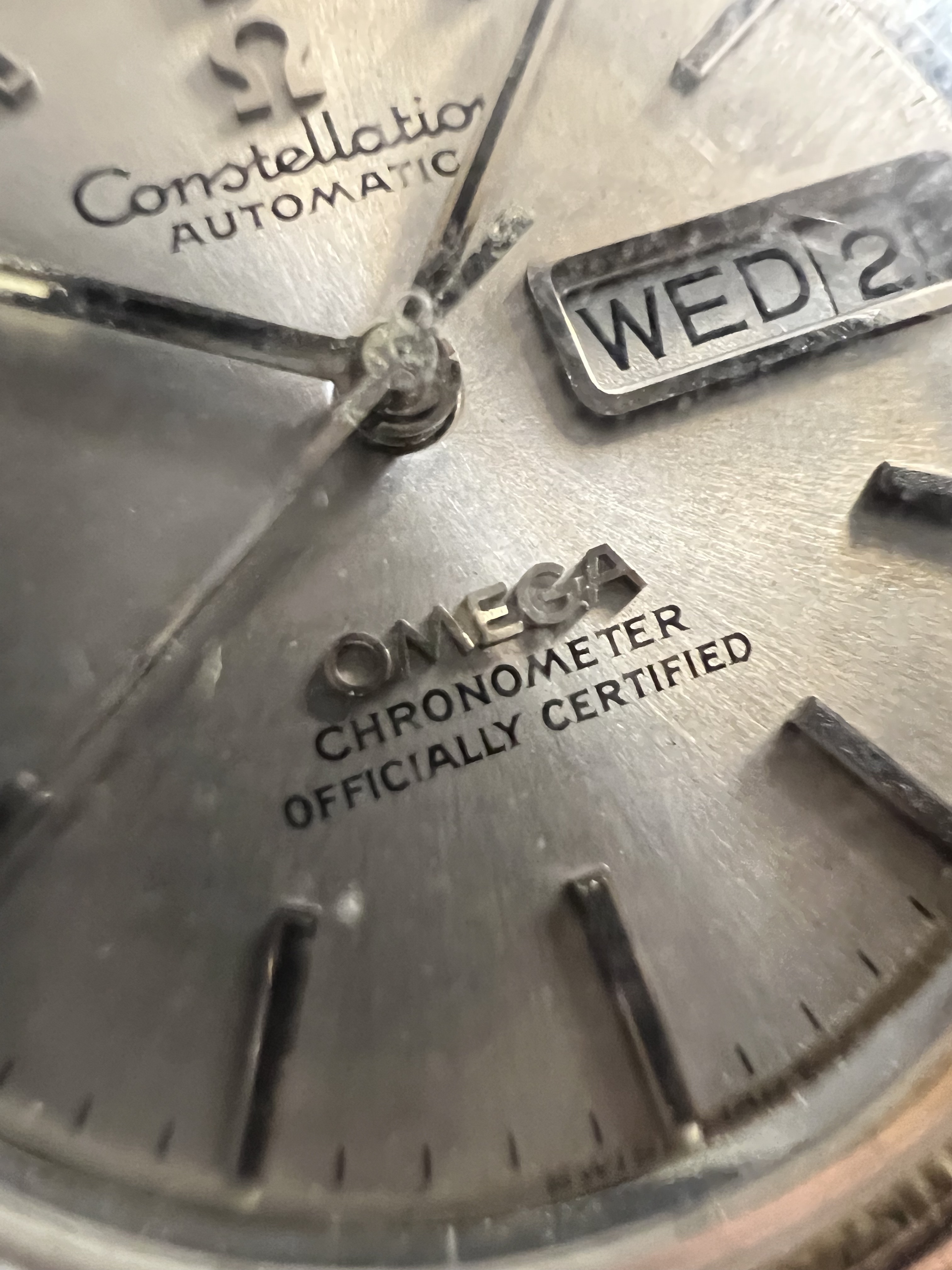

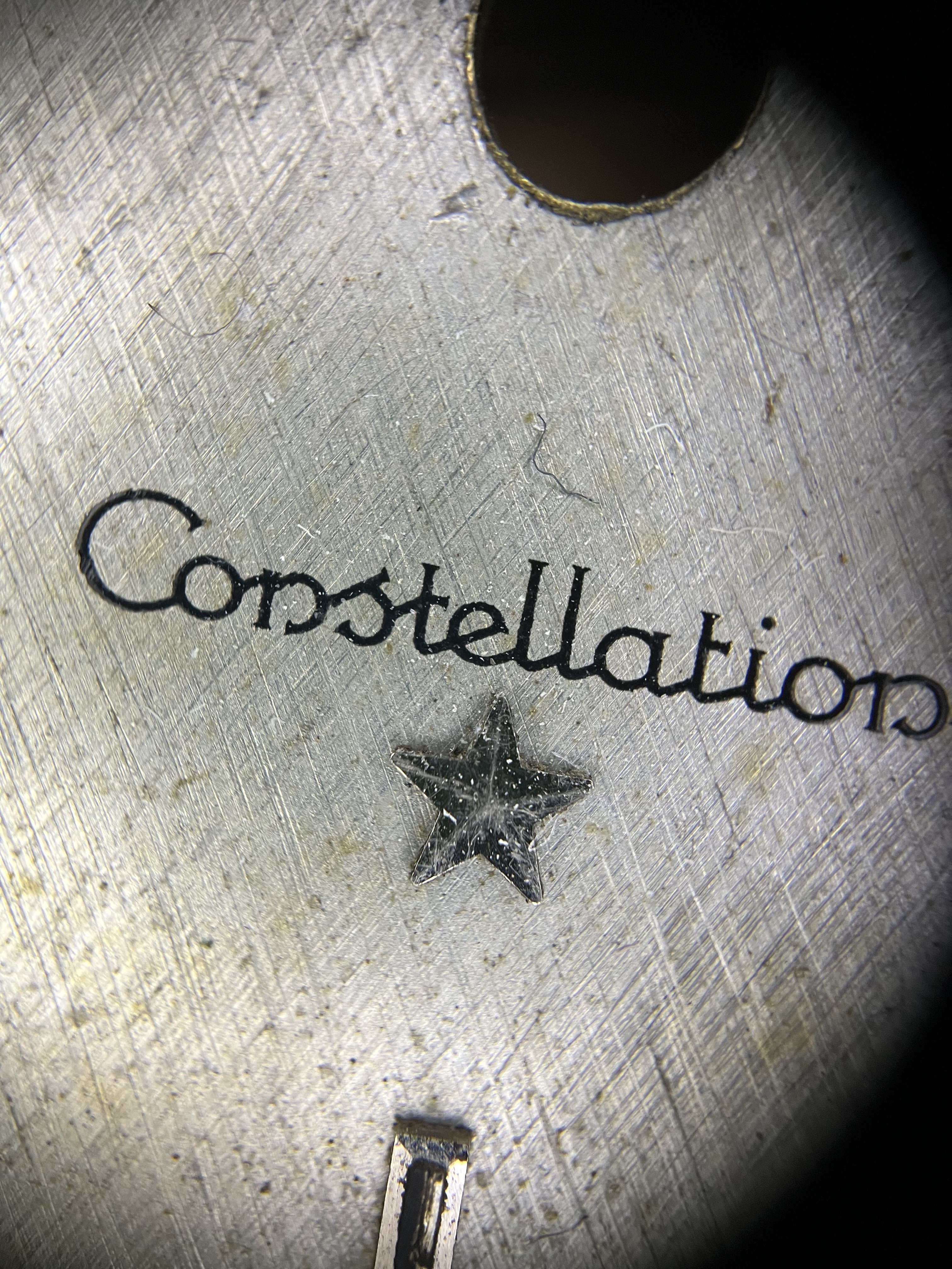

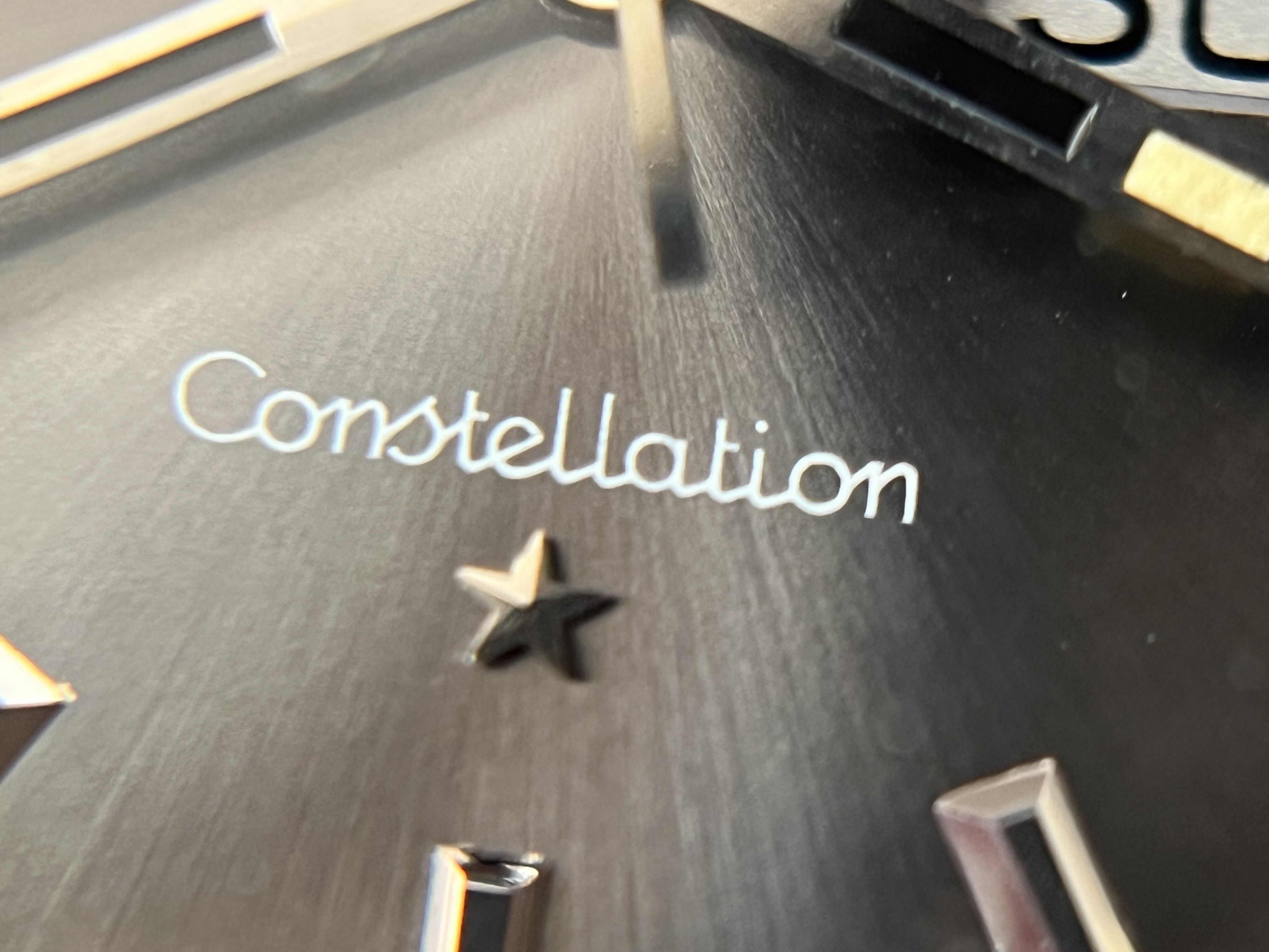

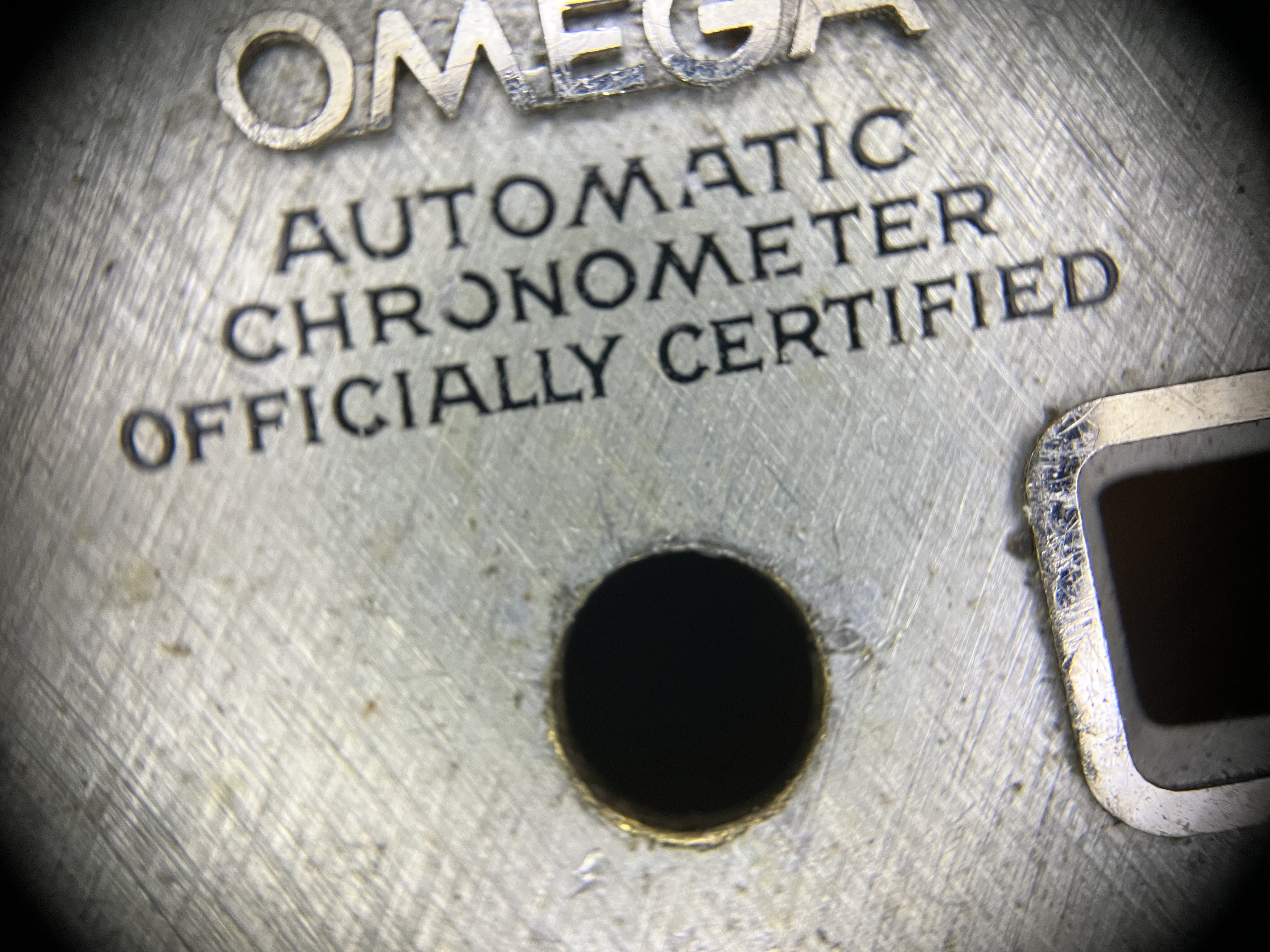

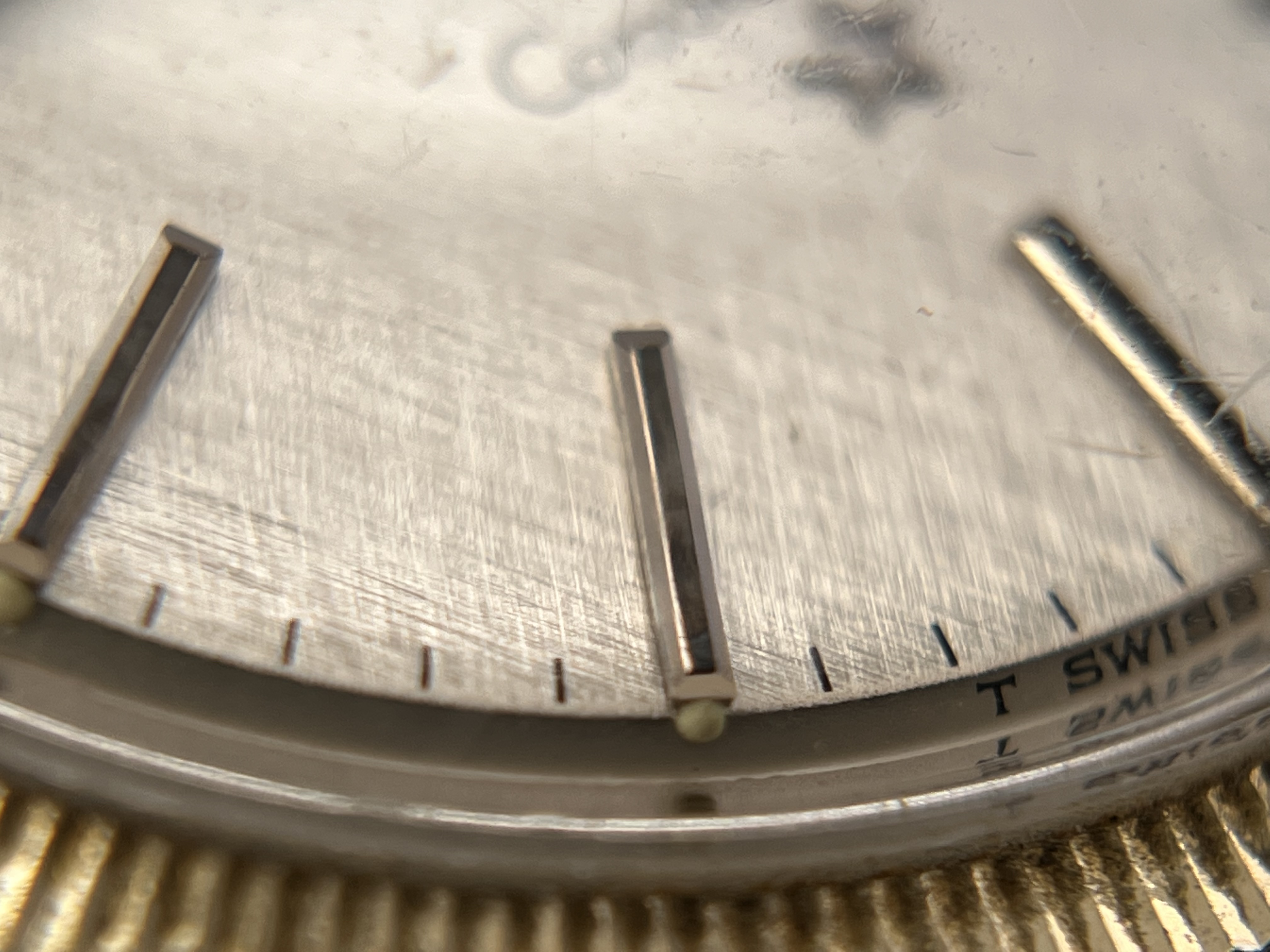

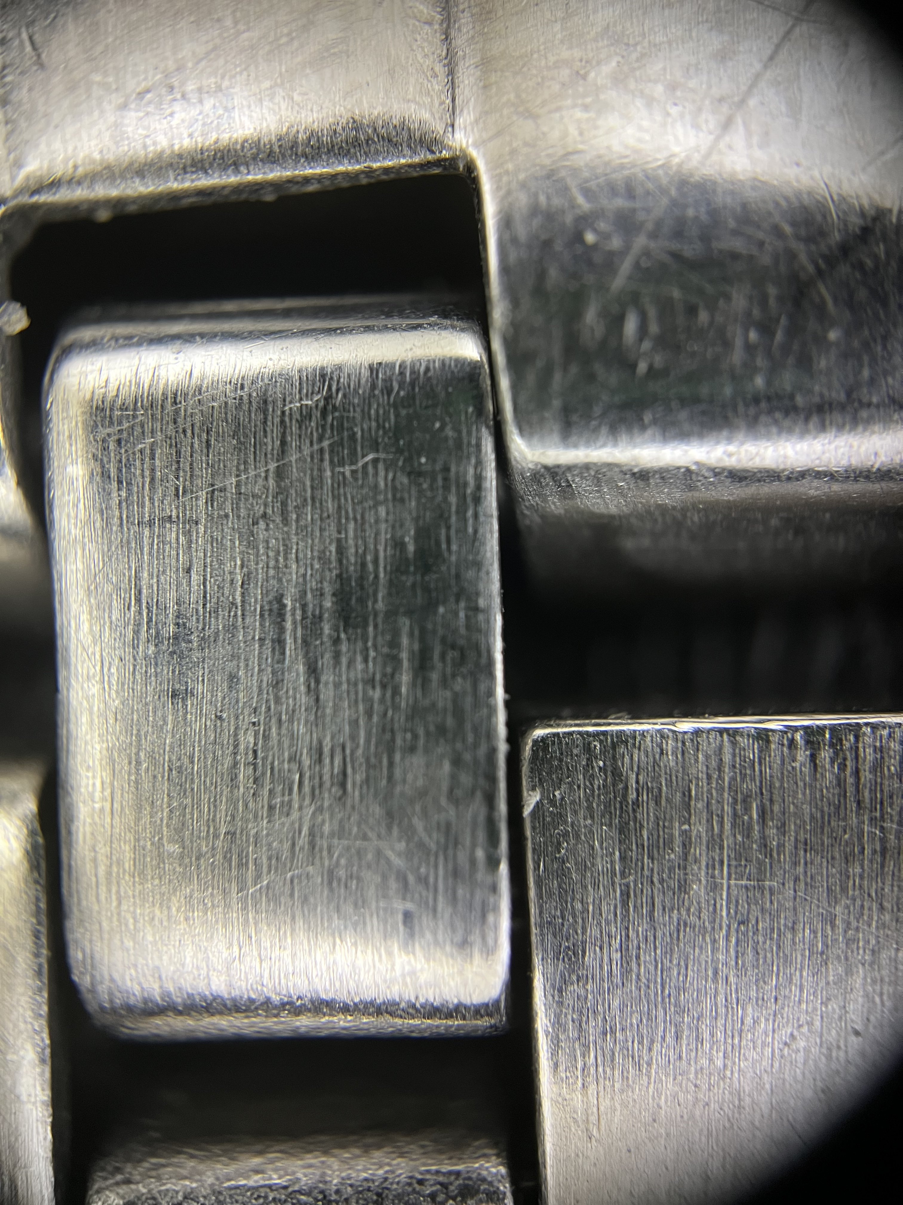

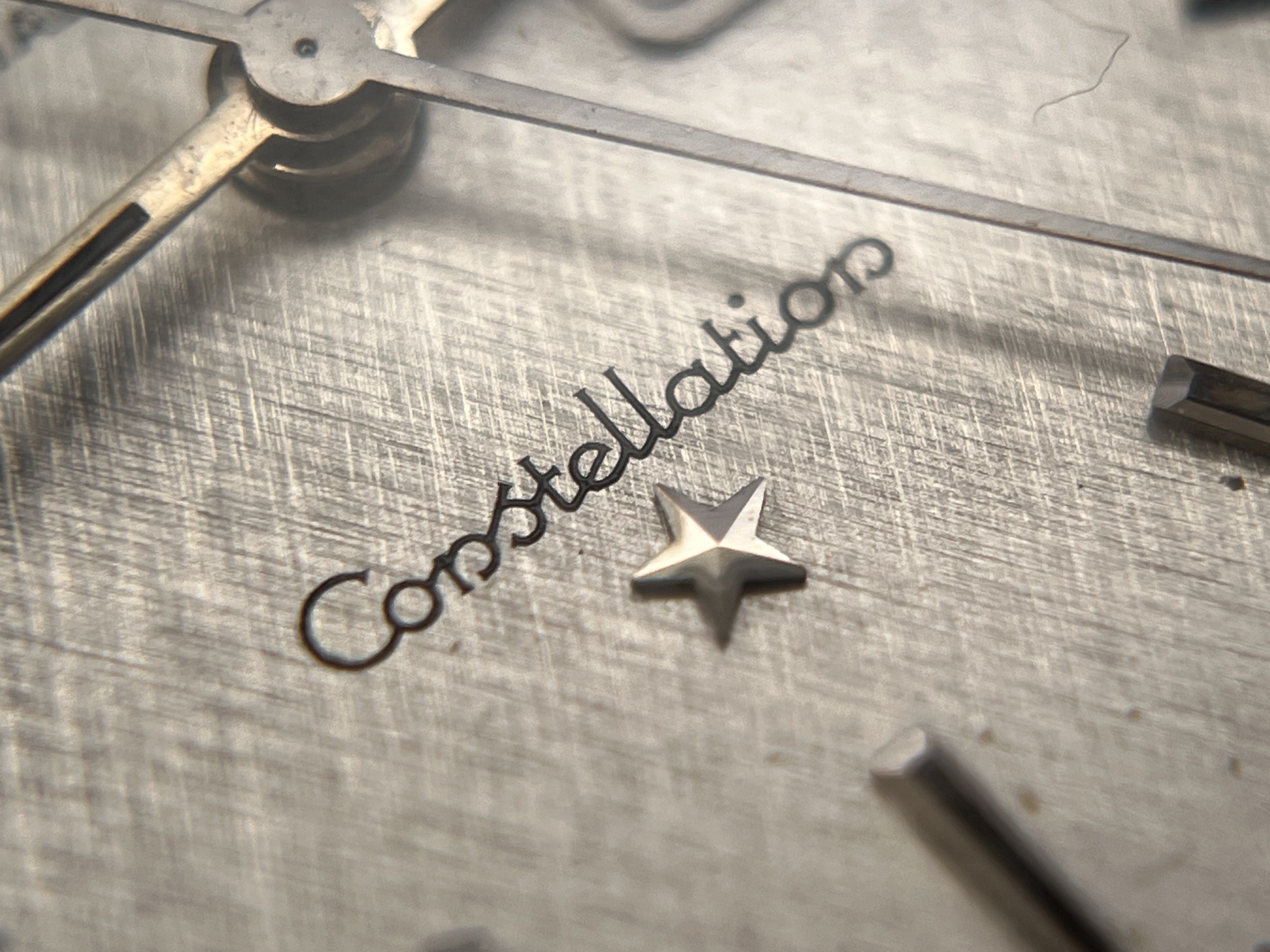

Some microscope shots, dial is a loose thrash dial

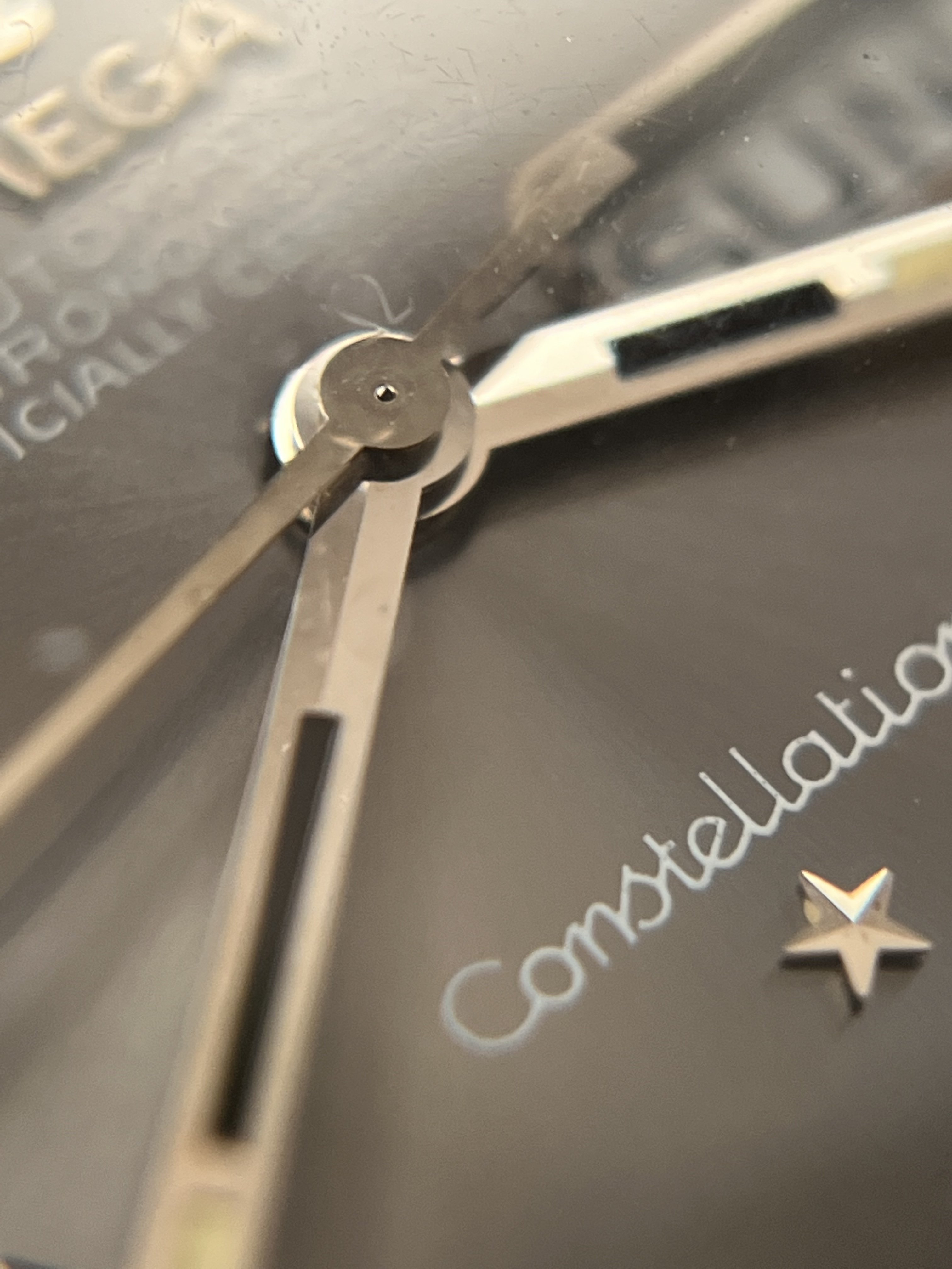

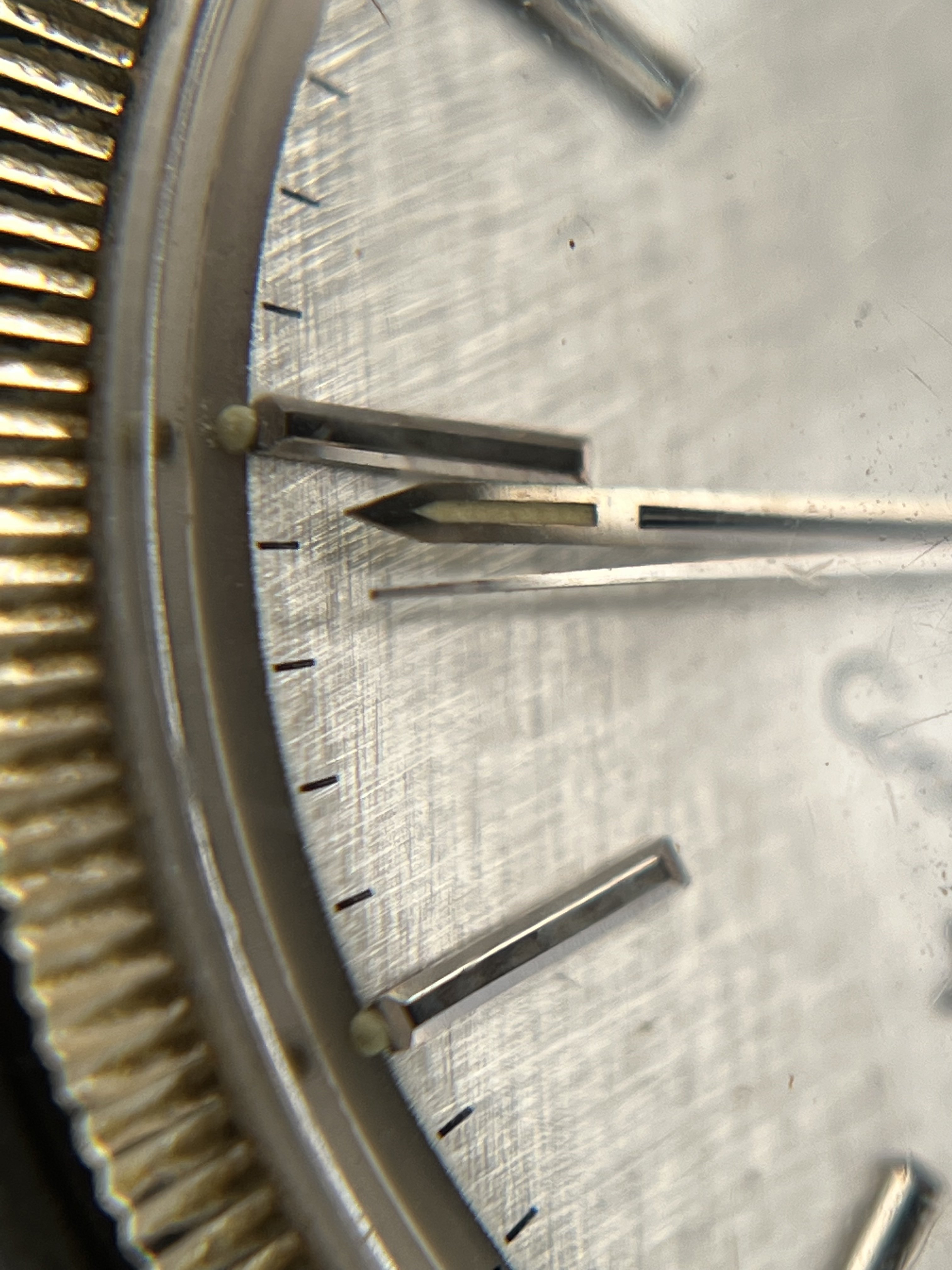

Those microscope photos are awesome! Do you have any of the hour markers? I'm trying to figure out the paint vs onyx insert question. All my examples (four) seem to have a painted black line and not onyx inserts. I guess they go with the painted baton hands? I have heard onyx insert markers mentioned and I wonder if those were just for the variations with dauphine hands.
edit: I see just the top of one in the photo with the star... that looks like that's an insert and not paint. hmmm...

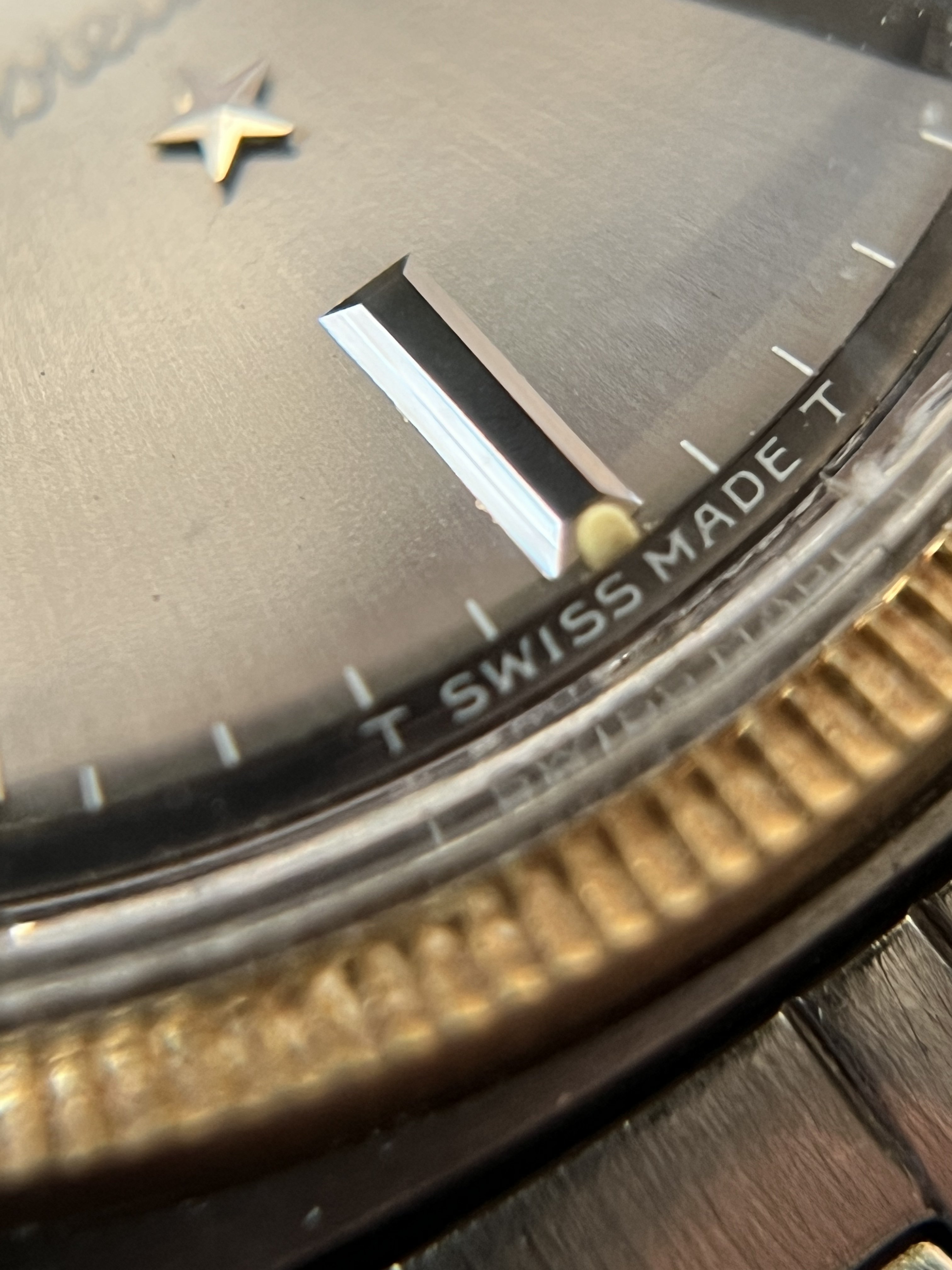

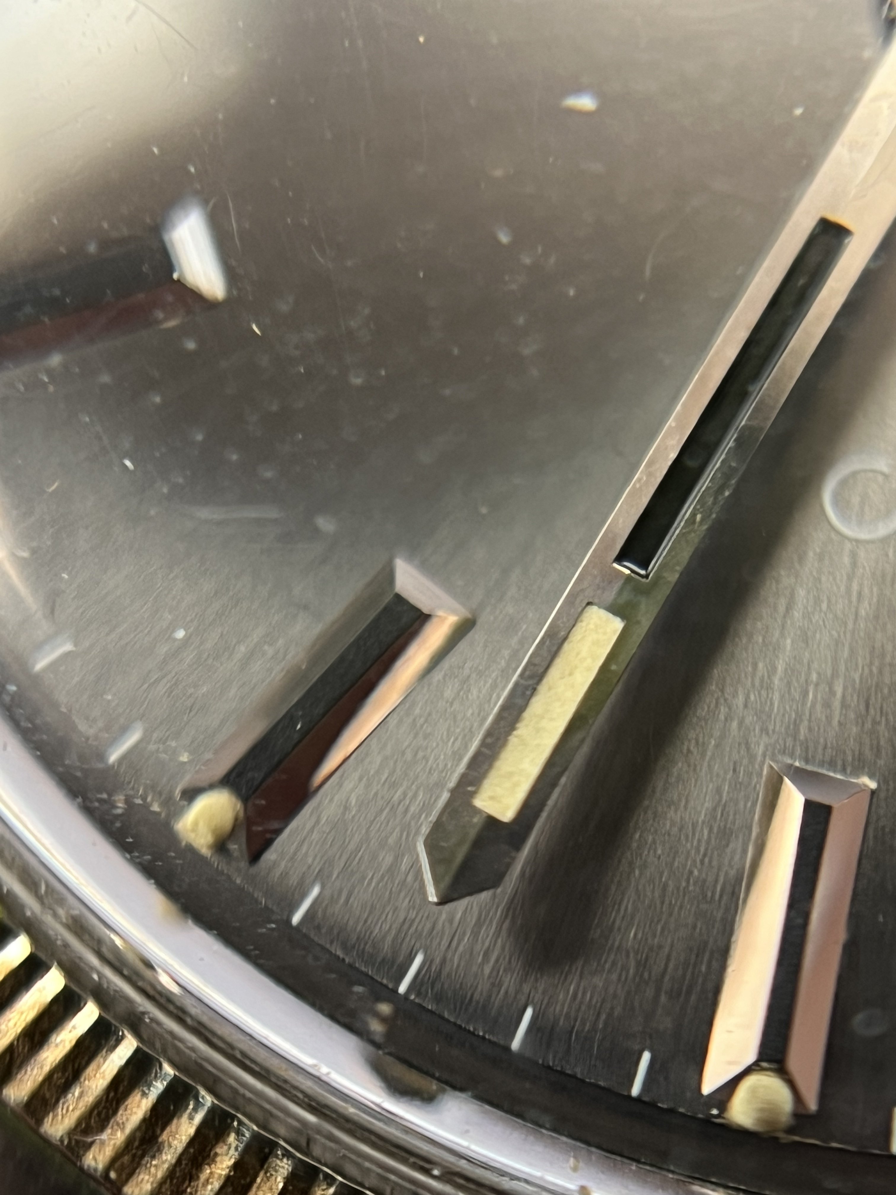

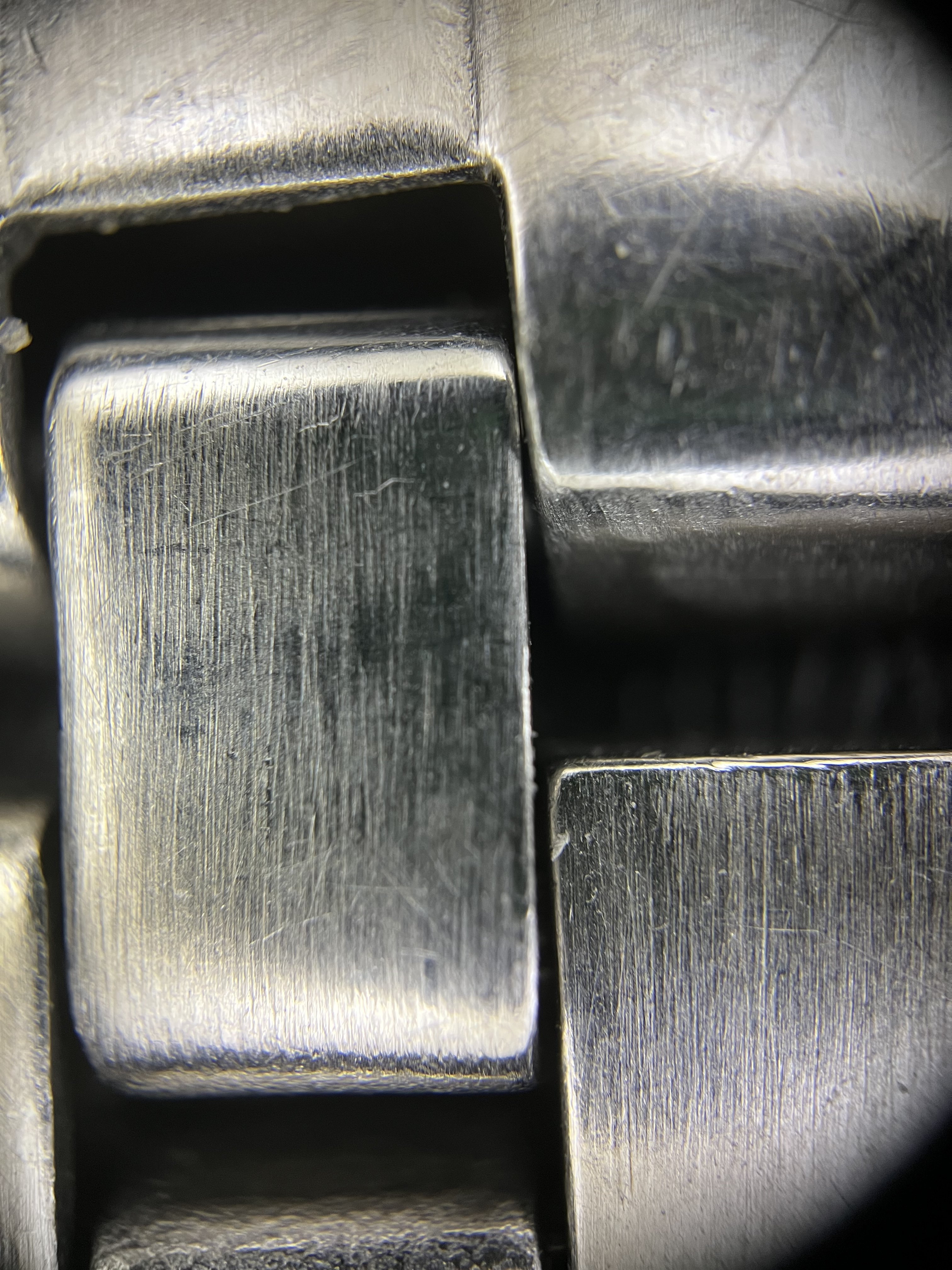

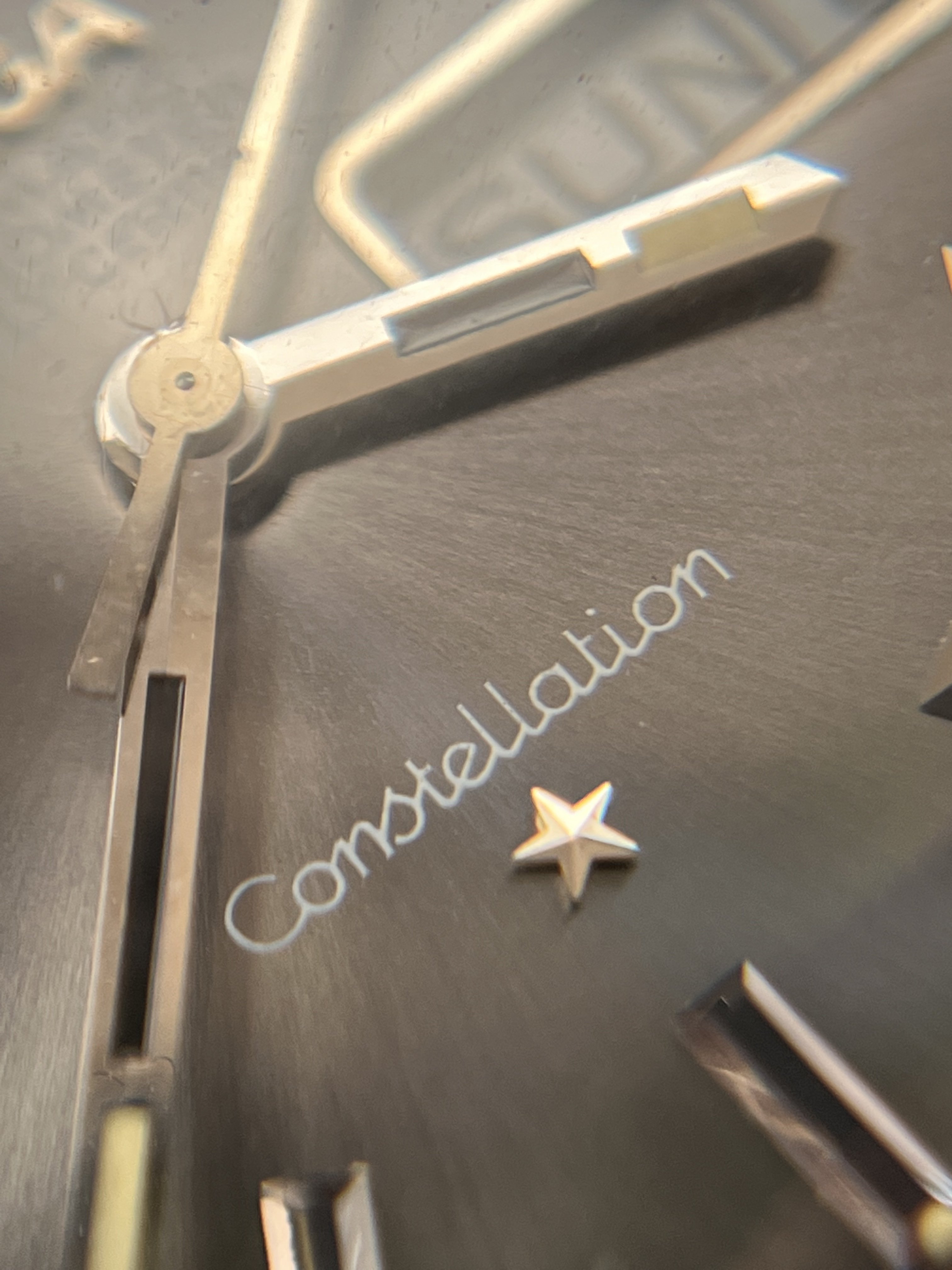

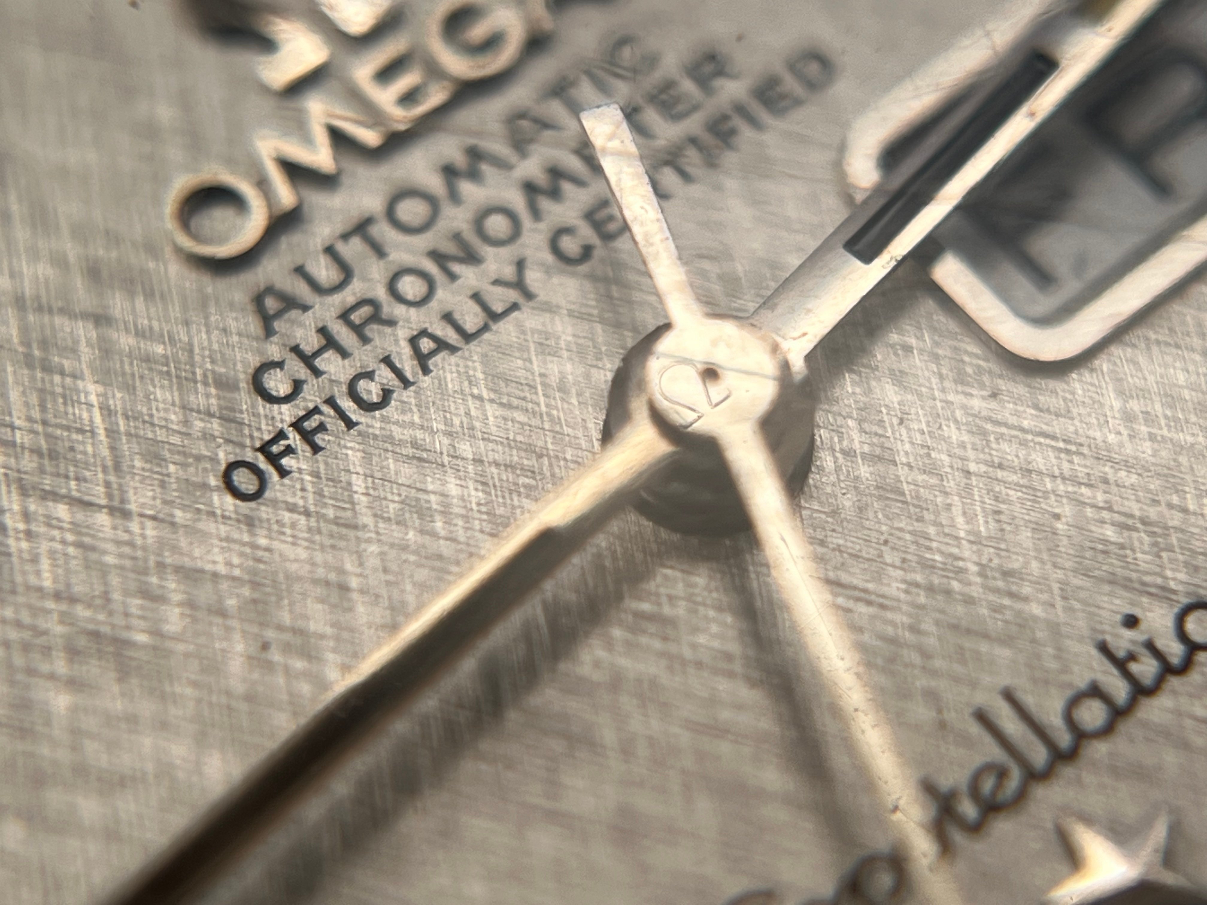

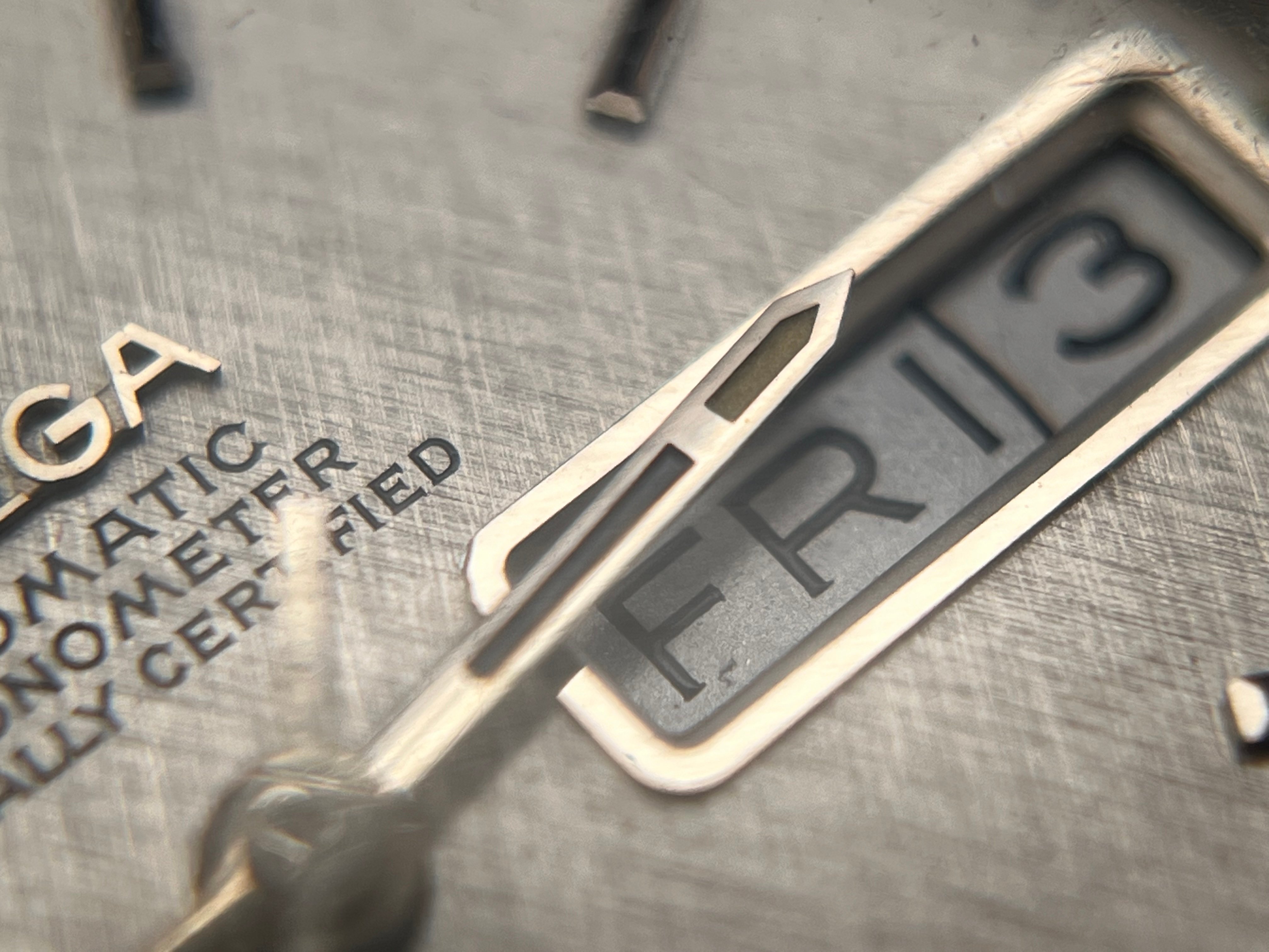

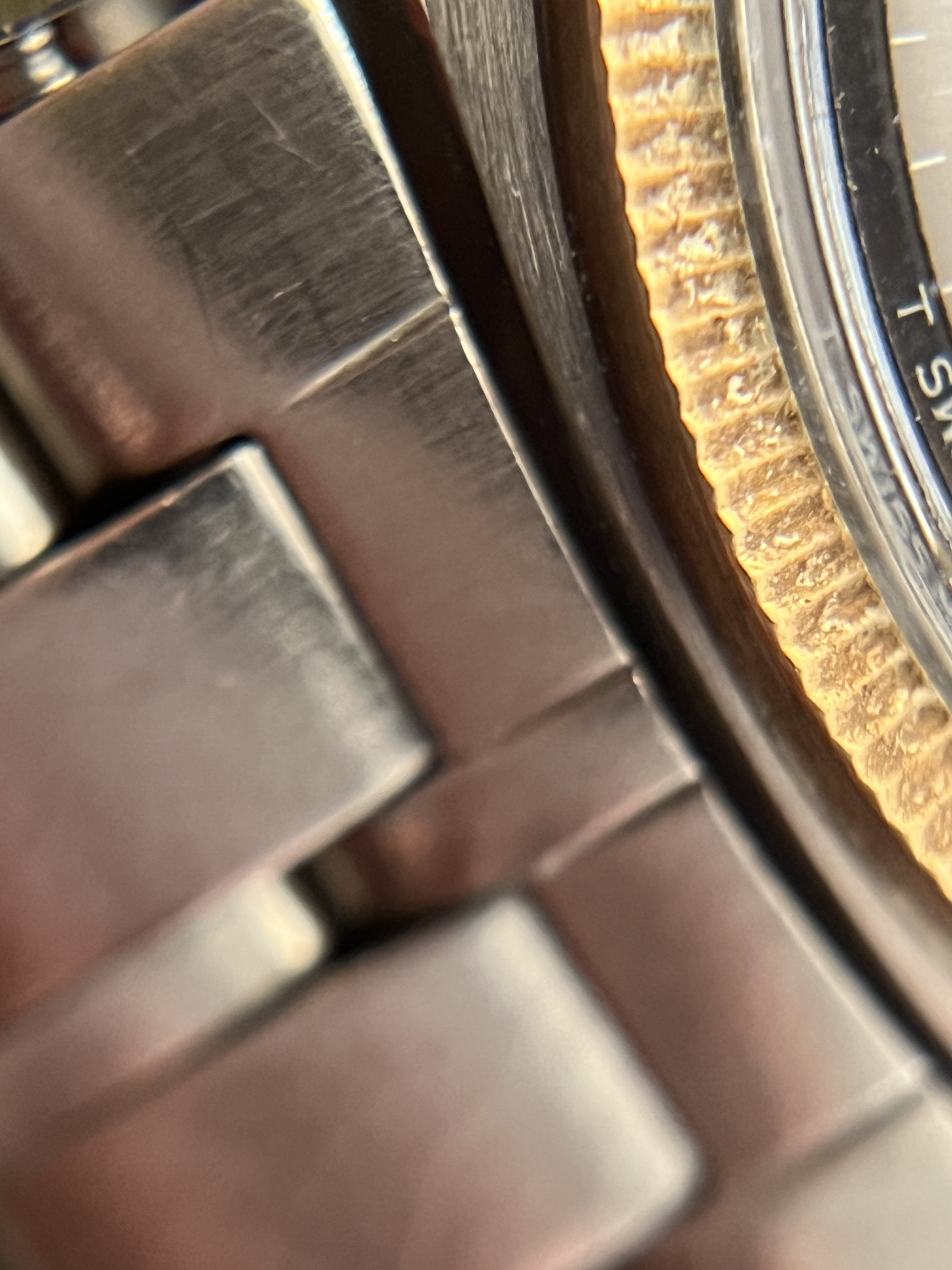

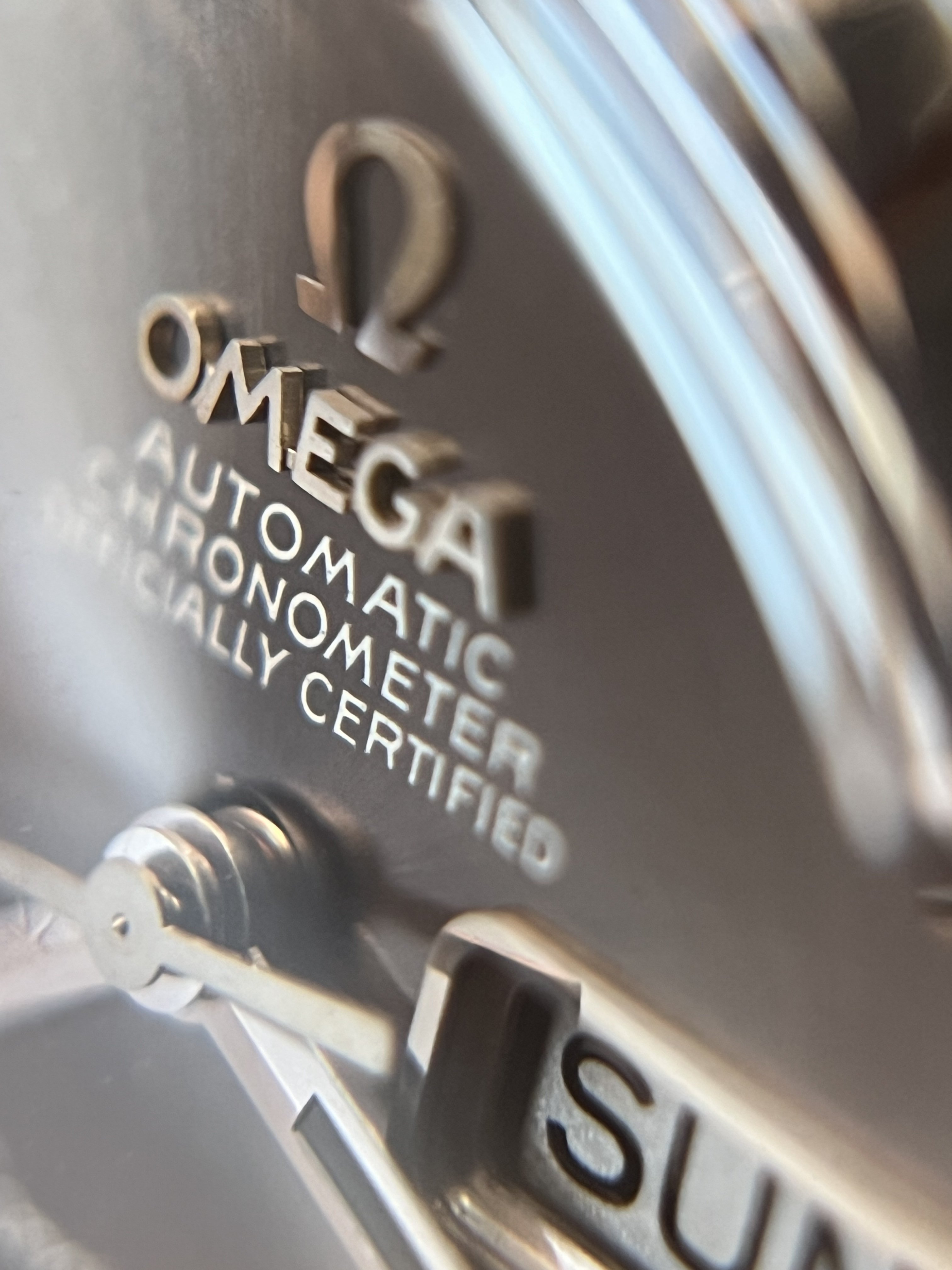

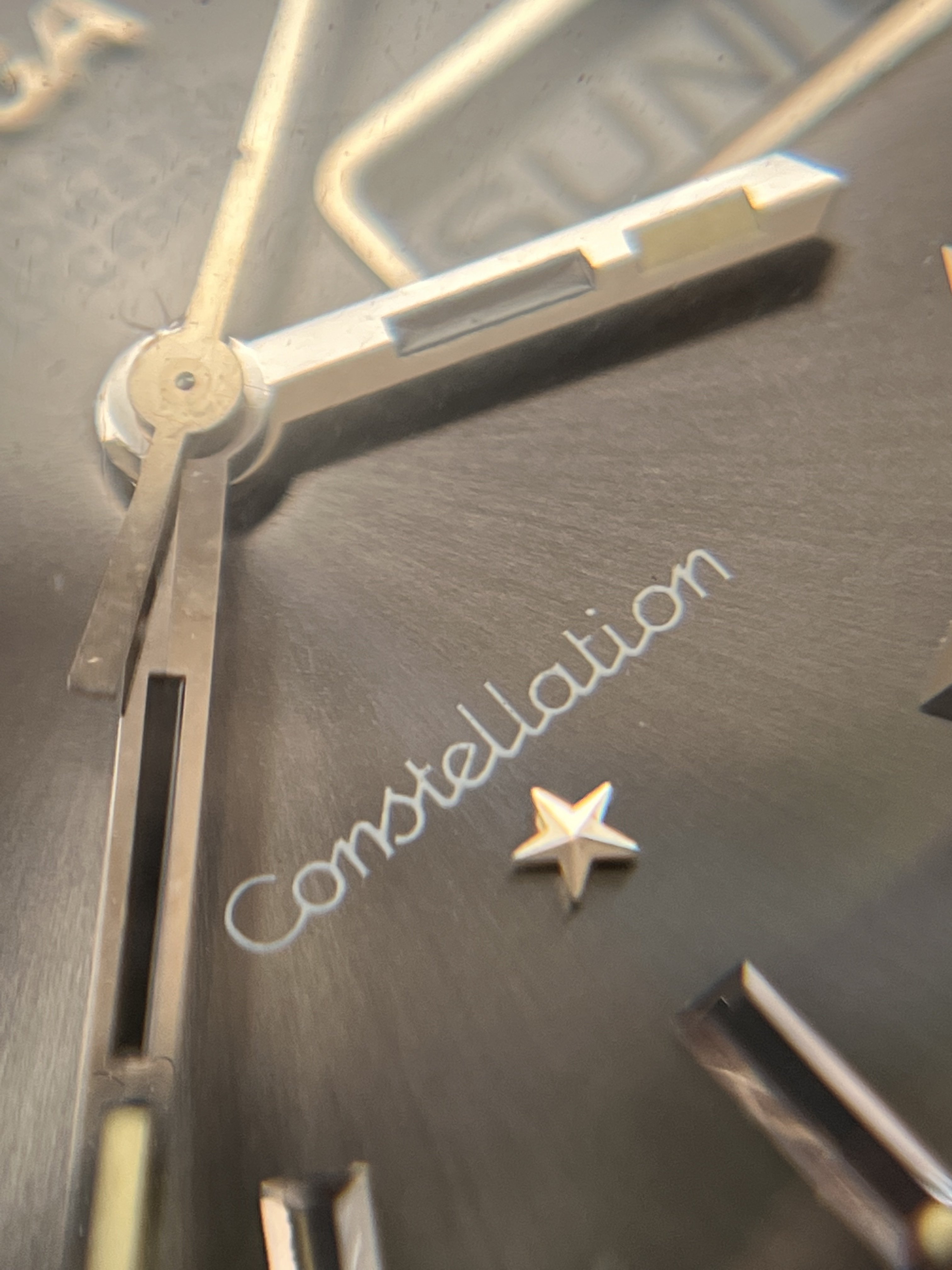

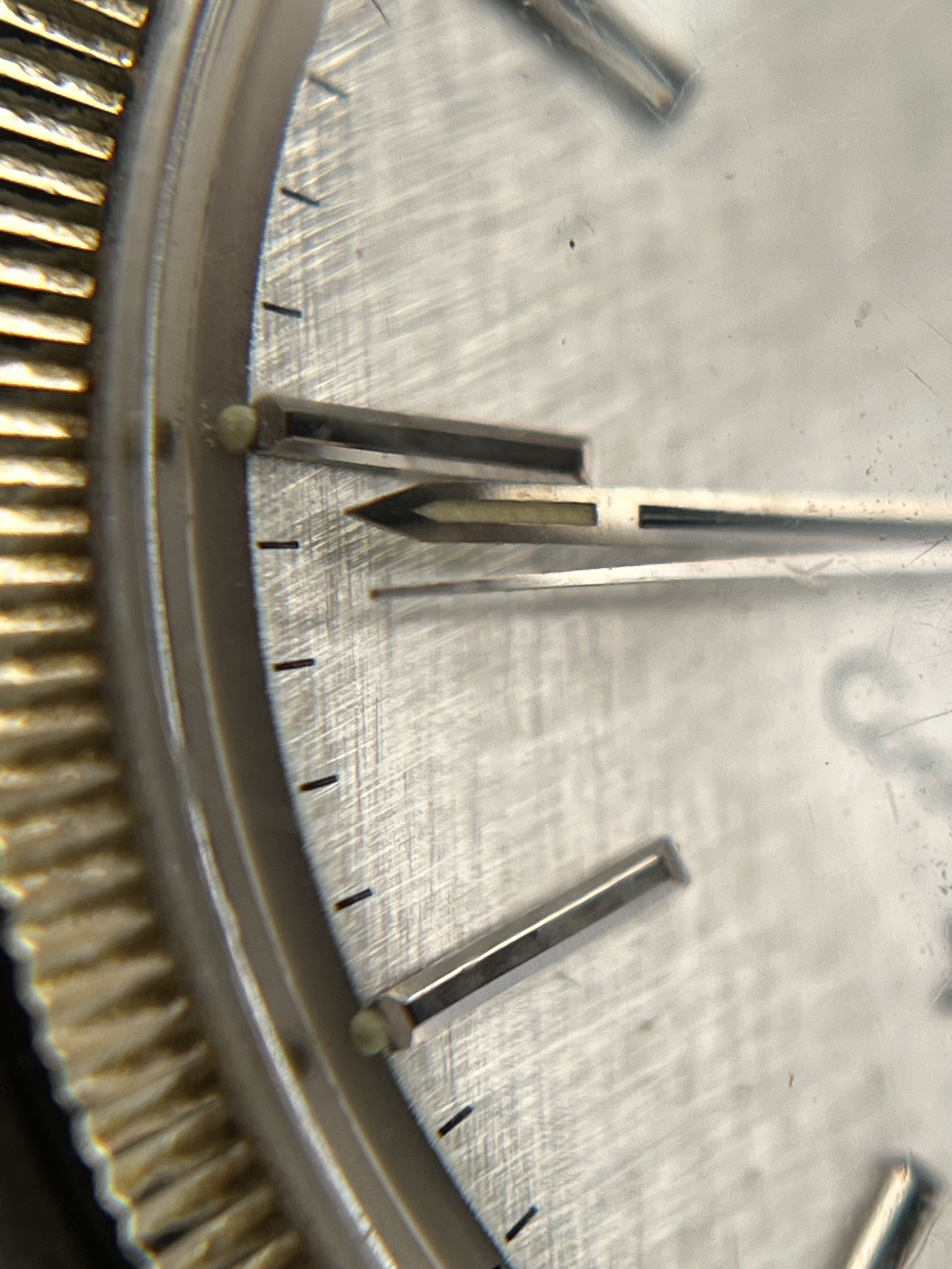

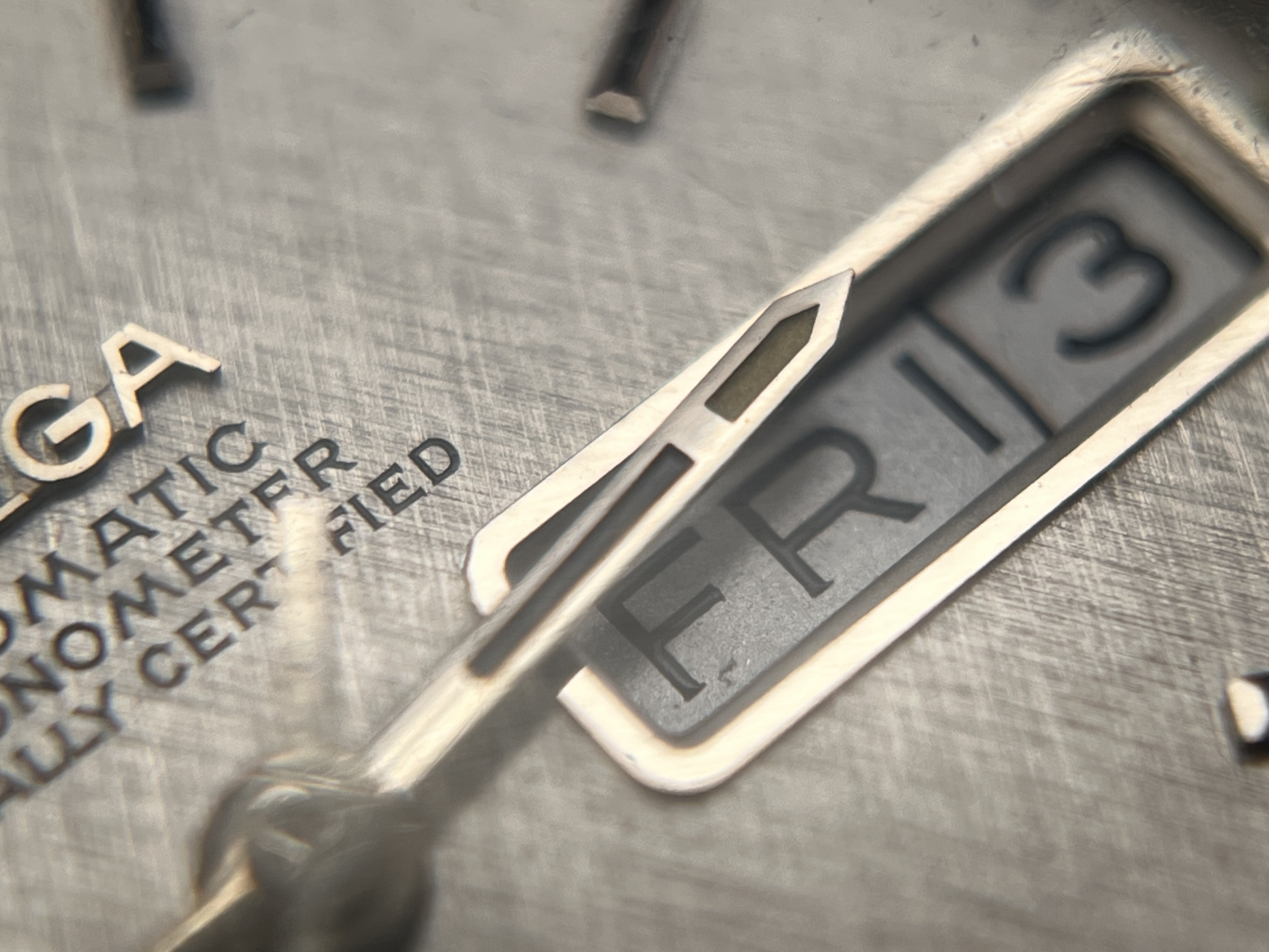

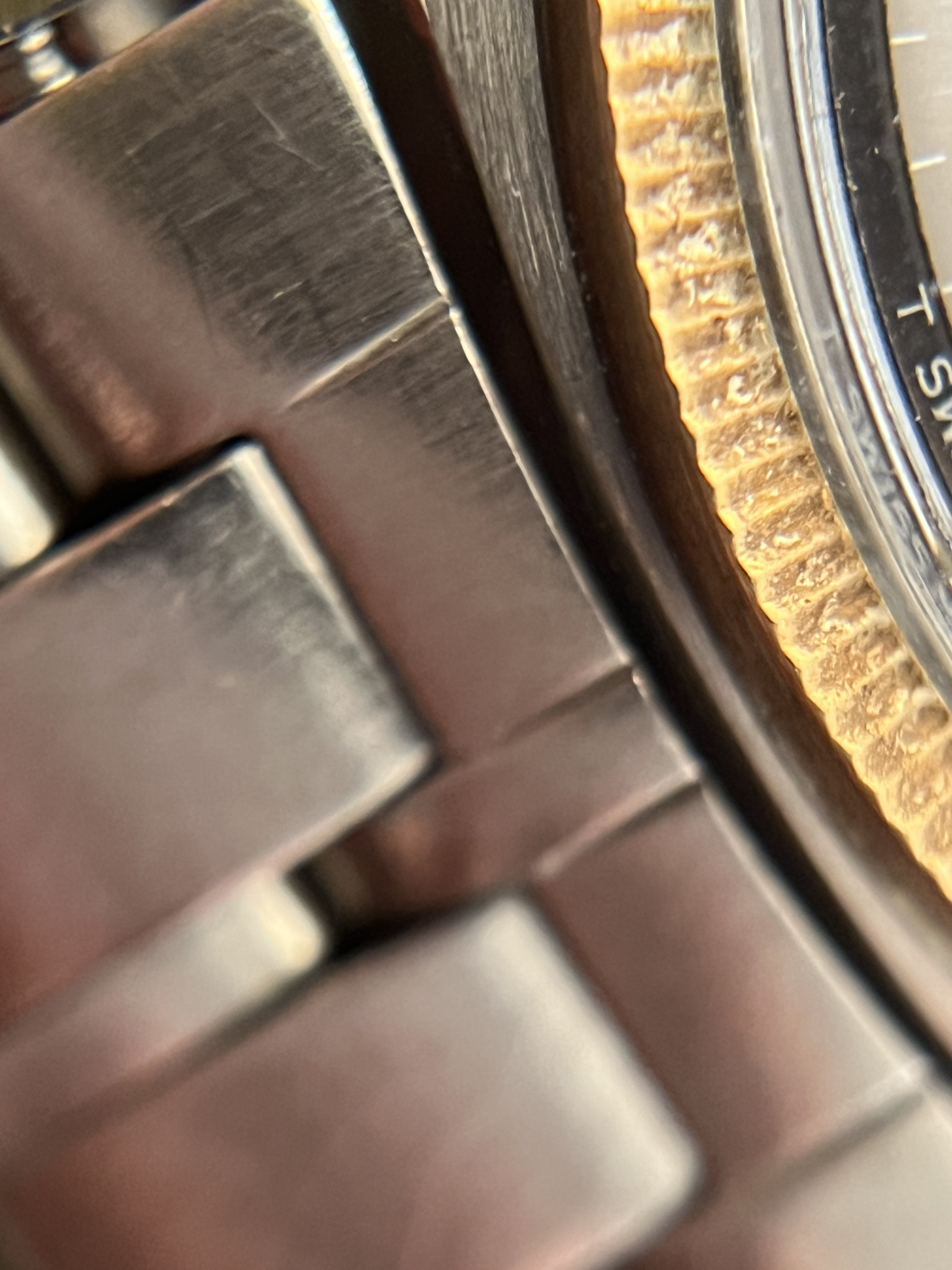

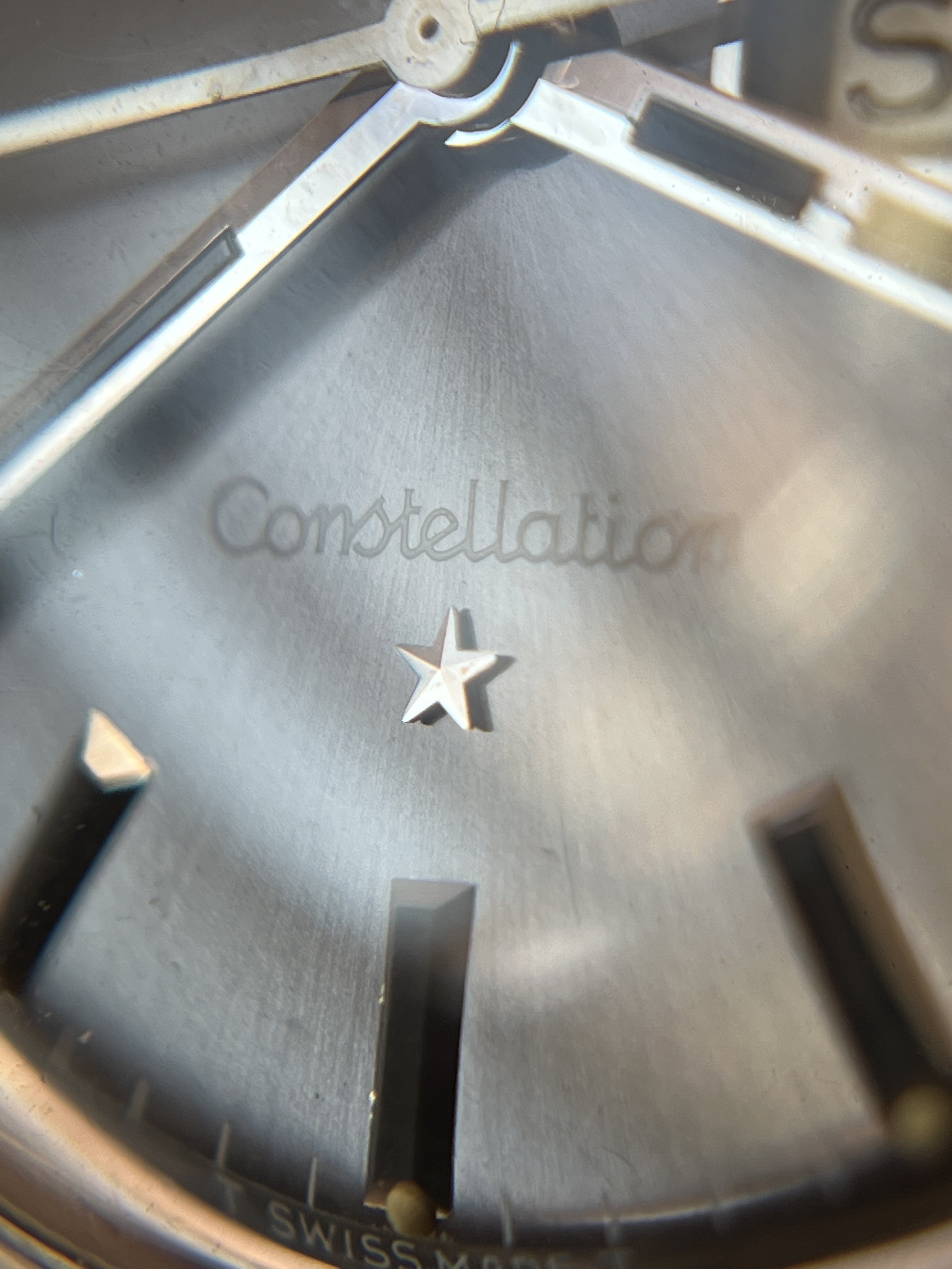

Not home right now but coincidentally took these photos before I leave, a new lens - proof that @MtV could’ve pushed Apple out of business, if I figured out external lenses would never buy an iPhone Pro, iPhone’s own photo system is just a nuisance on new devices
236
2,038

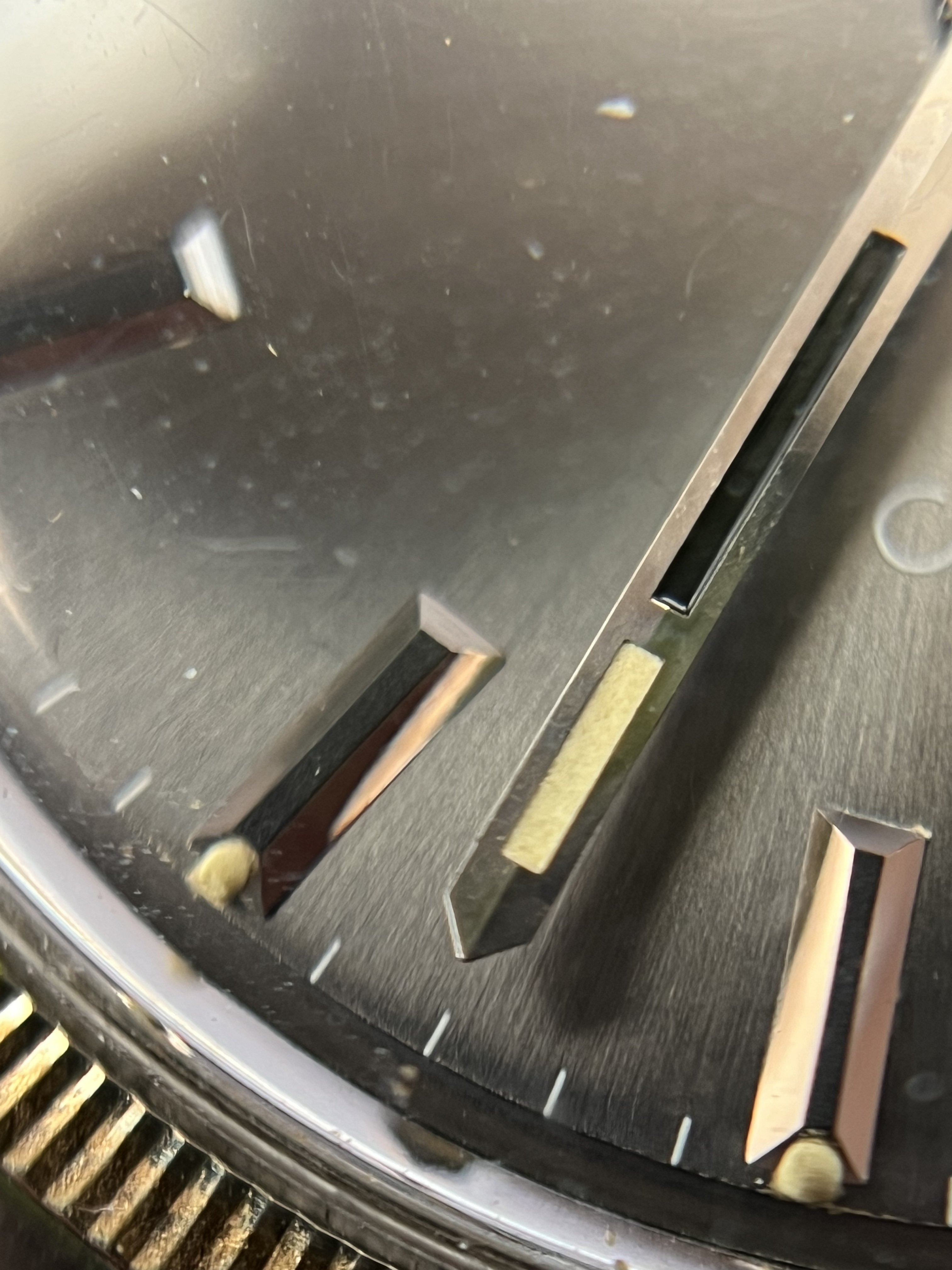

Thanks! It's so hard to tell, but the ones on the second dial sure look like inserts. I'm going to see if I can rig up a way to get good photos of mine with my phone and a loupe, haha. I have a 166.010 that I am pretty sure has inserts. Maybe I'll try to compare those to my c-case markers.
2,684
3,168

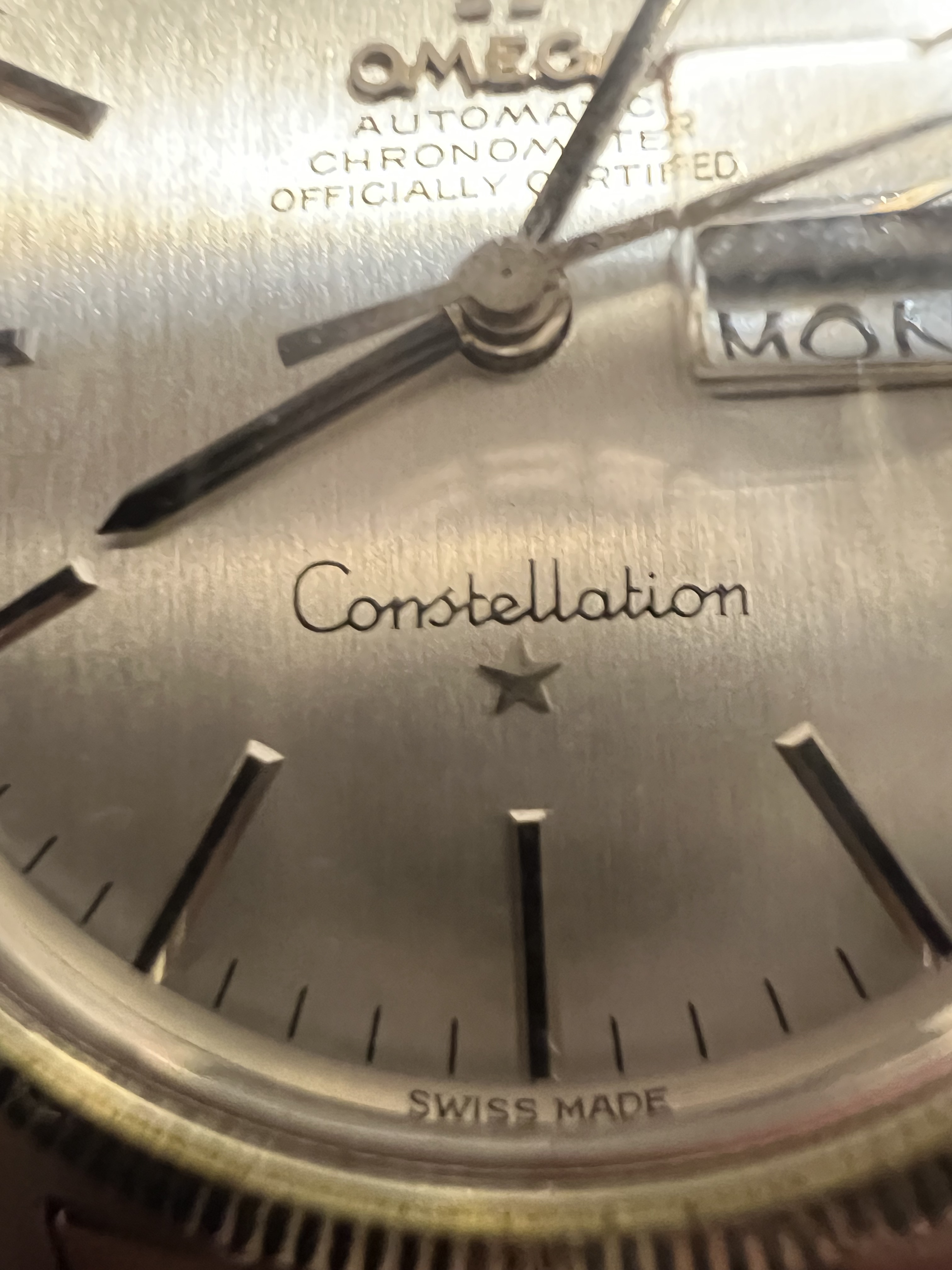

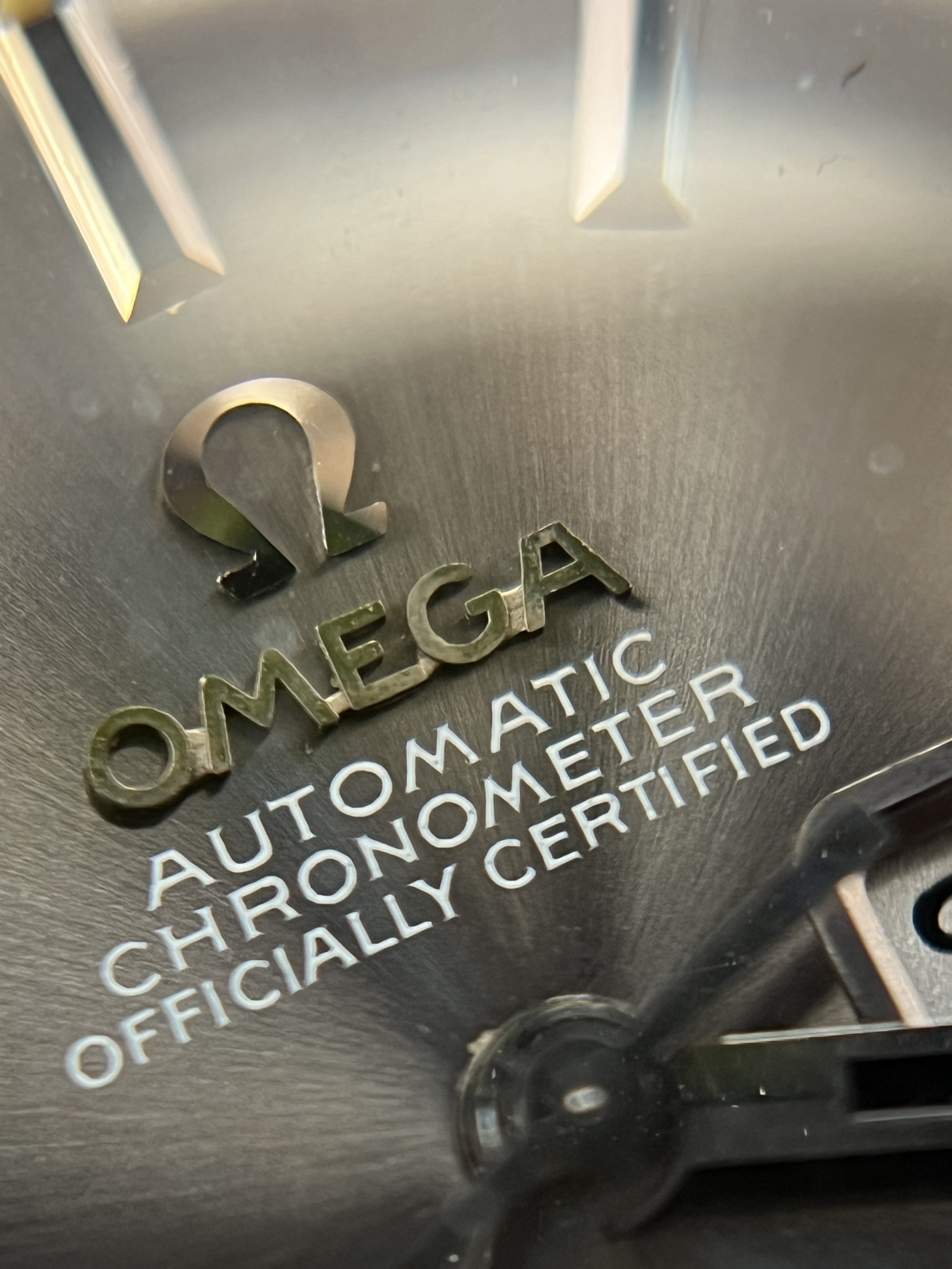

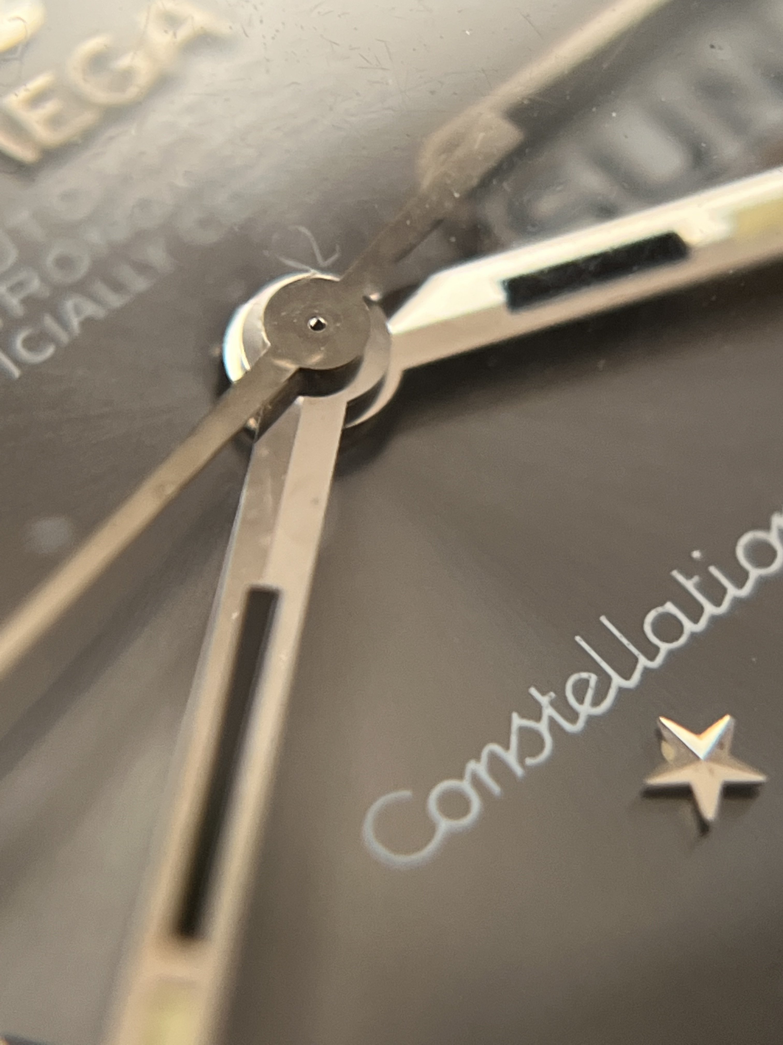

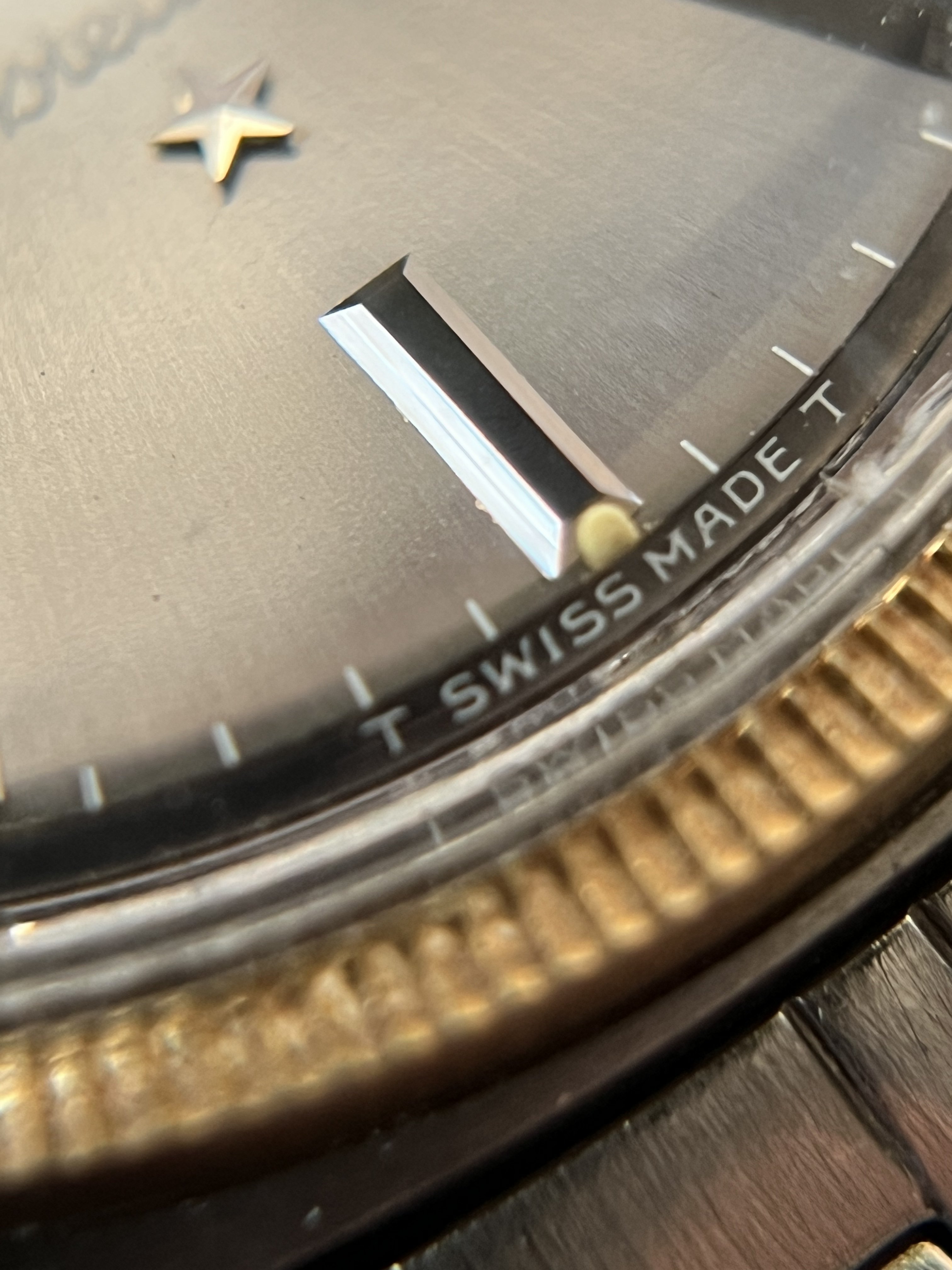

As far as I observed it’s overpaint on non-lume ones and underpaint on lumed ones, I can share a photo soon
236
2,038
Oh, so its a lume vs non-lume thing. That makes sense. All mine are non-lume. Thanks! and it would be cool to see a photo whenever you have time.

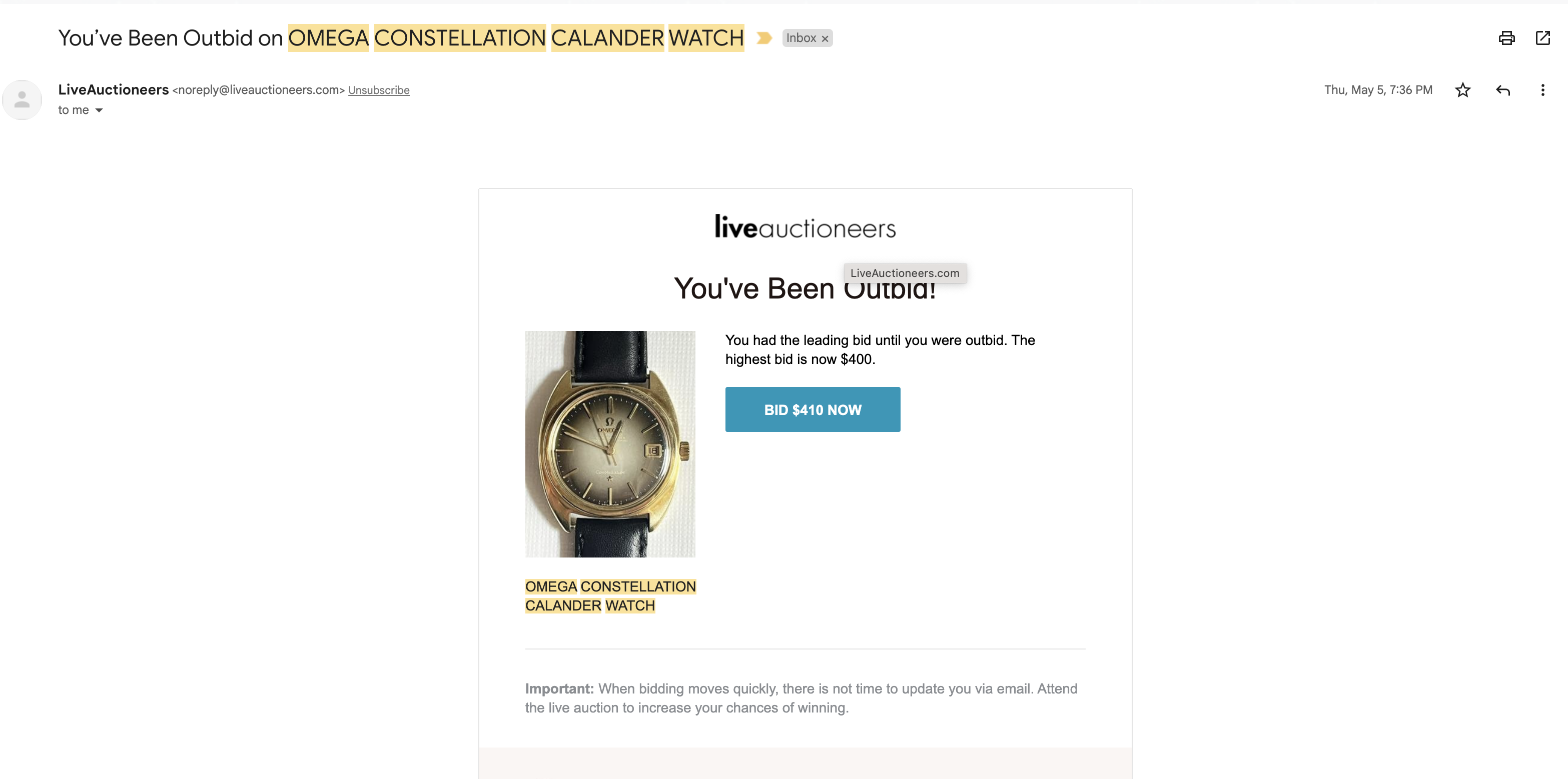

Be careful though as they possibly shill bid and relist when they win, I don't recall why my original bid was low, but I guess the wrong crown, the dial damage up top on the edge (a chip), and the case condition

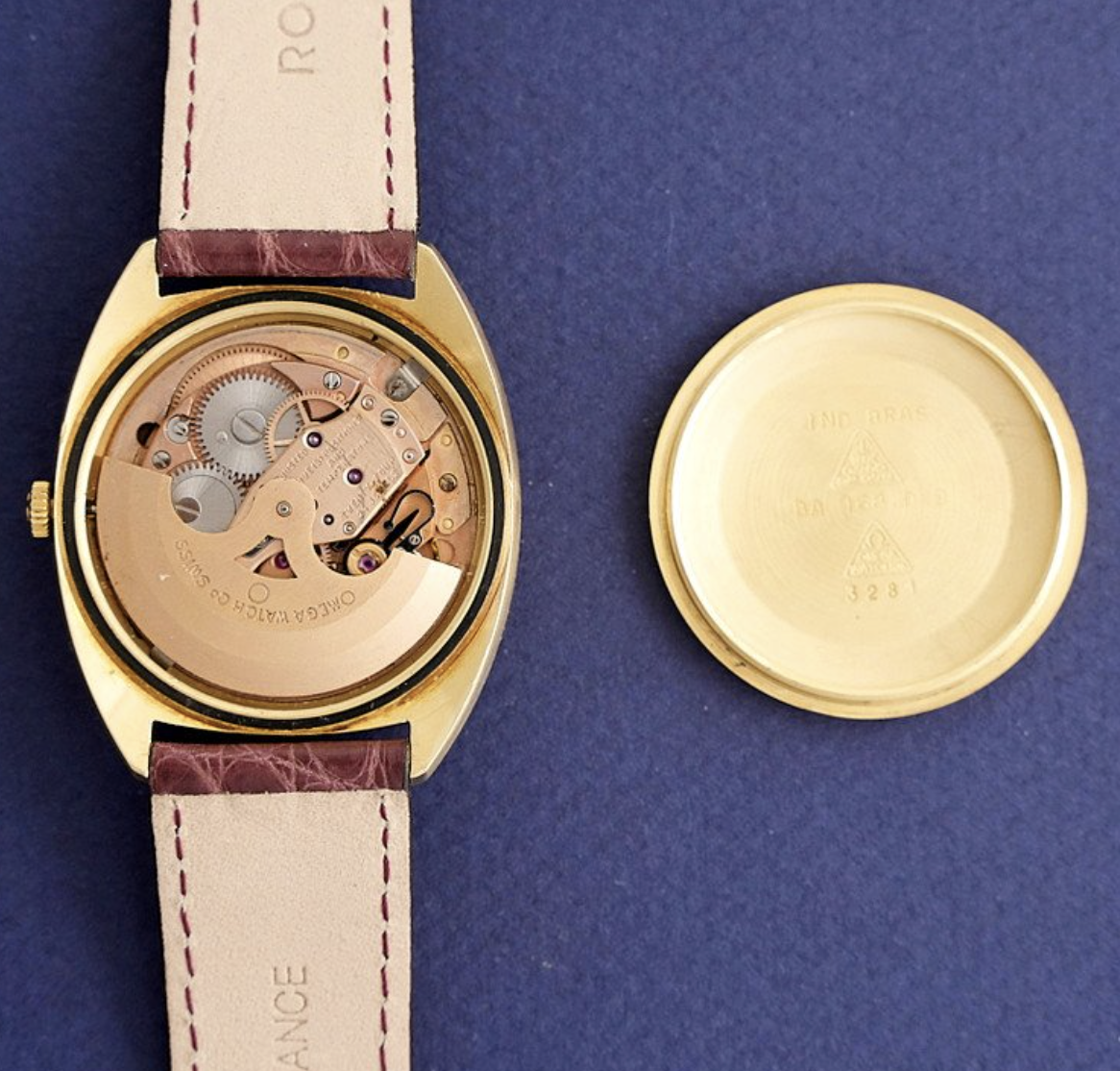

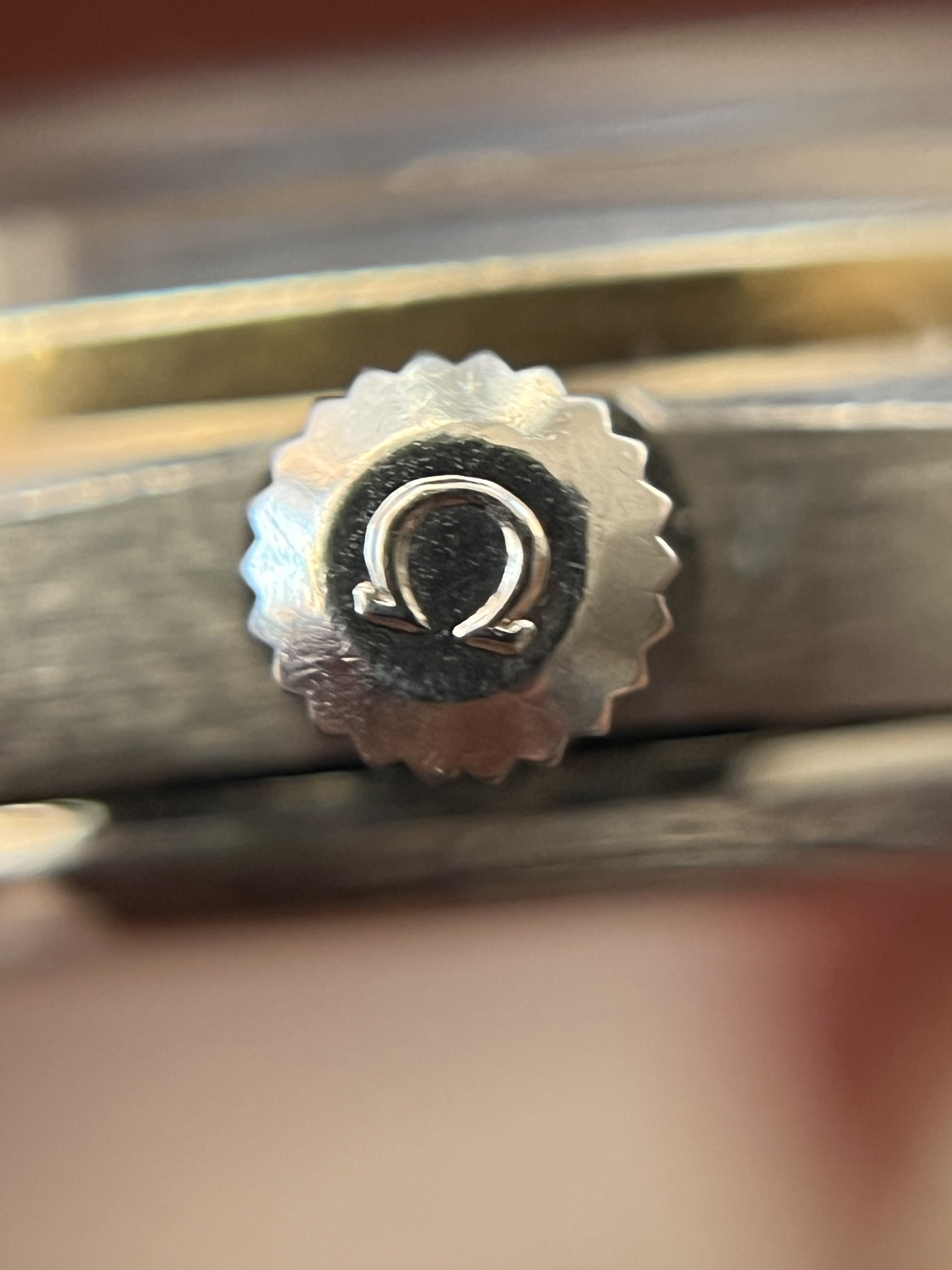

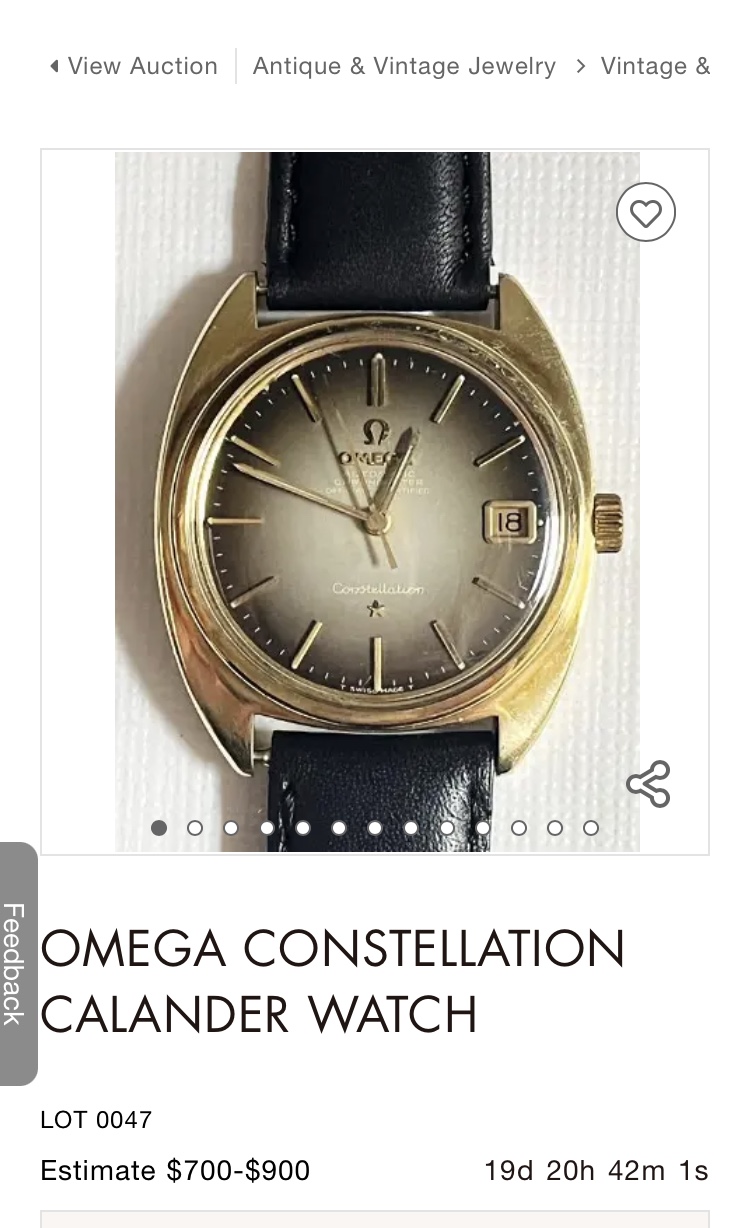

Just stumbled onto this while looking for something else entirely

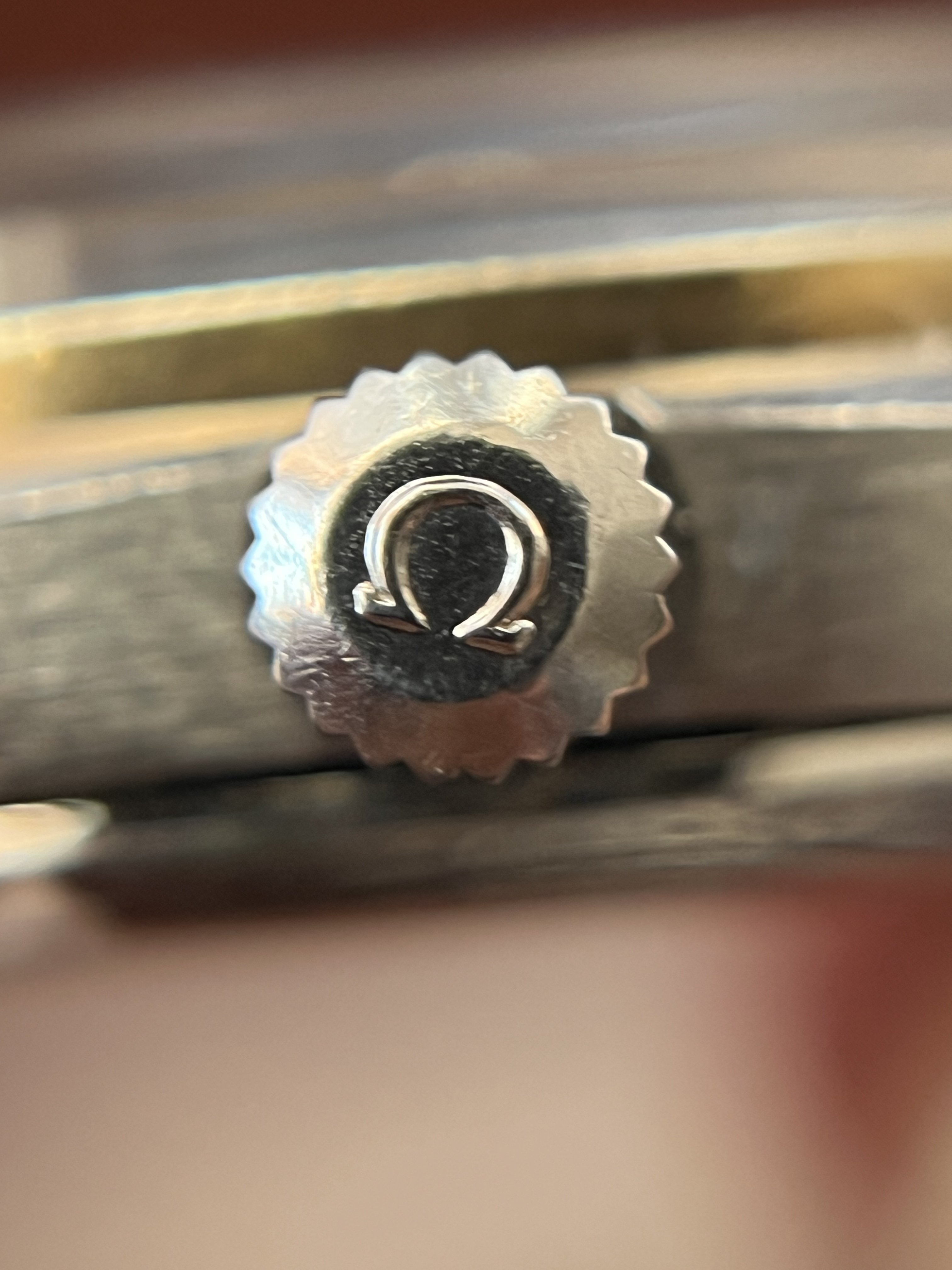

It says "BA 168.019" on the caseback, pretty unique. As @Rudi99 pointed out, seems to be a Brasilian case that made its way to Belgium
Sadly the price is super high and the crown/crystal is wrong
