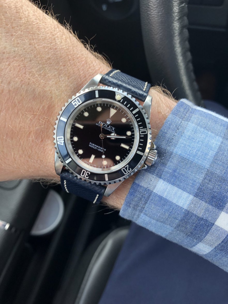

Hello all,
I’ve had my 1990 14060 for a little over a year now. No issues and it’s running like a champ BUT over the last few weeks I’ve noticed the bezel has become a booger to turn. Yes I use it almost every day I wear it. Just curious if this has happened to anyone else? Is it possible for dirt, wabi sabi, etc. to get stuck underneath? Worth taking it to get removed/cleaned?

Do you swim/dive in salt water? I often find that if I dont rinse my dive watches after being in the sea the bezel will often get difficult to rotate. I rinse under a warm tap and turn the bezel a few rotations whike under the running tap. Does the trick for me.

I actually was in California and swam in the ocean with it in early September! By golly I think you may have just hit the nail on the head. I’m going to try it.

You should always thoroughly rinse your Sub in warm water after swimming in any water but especially the ocean. Even pool and lake water should be washed off of it. Rinse it from all angle to insure that you get water flowing under the bezel. This should help. If you still have difficulty turning the bezel there could be some sand or dirt lodged beneath the bezel and it can scratch the parts pretty easily. Then remove the bezel and spring and carefully clean them.

Just an update - it definitely helped. Also - it’s really hard to turn a soapy bezel while it’s having water poured over it so do this with caution. This bezel has never been quite as smooth as my uncle’s brand new no date sub but I figure that’s because mine is almost 30yrs old.

just remember what you are trying to do is disolve the salt, not wash it out. More water, less soap would be my advice. Also dont be tempted to use any oil etc.
