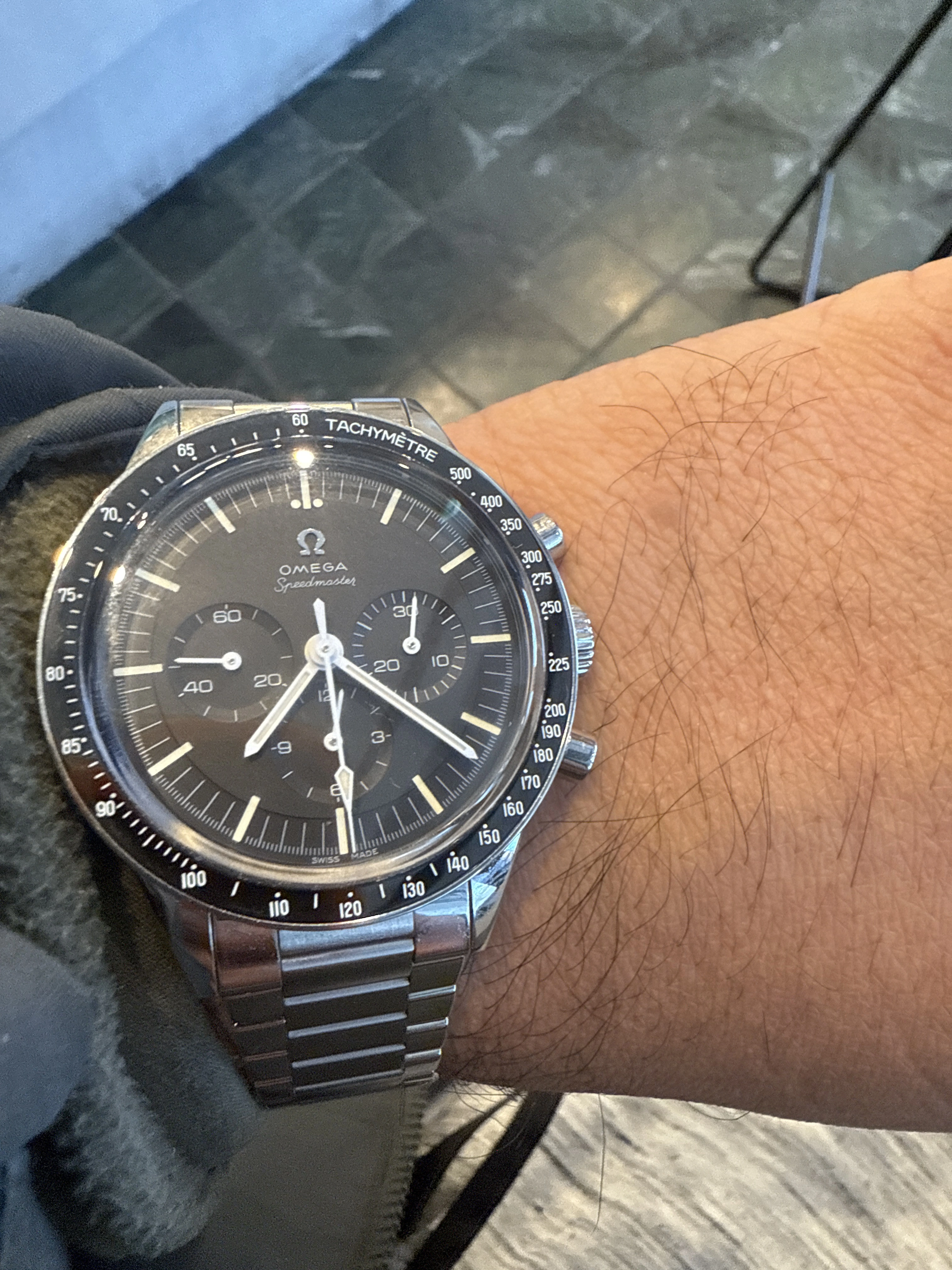

I have a 2025 Ed white in steel but I noticed it is a bit harder to wind ( I need to exert more action) than my speedmaster hesalite. Omega boutique has mentioned this can be normal but they have no means of testing this against other watches due to its rarity. Can I please ask if this is normal design of this watch?

Not normal, imo. A Speedmaster without the crown guards is usually easier to wind since you have better finger access to the crown to wind it. My Ed White from 2021 has always been easy to wind, and I've never heard of anybody saying they found it difficult to wind. Surprised you find it more difficult than a standard Speedmaster with crown guards. They often loosen up with wear as the seal gets some wear.

I find it more difficult to wind, yes. But I’m told this is normal, due to the new crown/gasket configuration.

I’m not sure, but 321 Ed White is the easiest one to wind among my Speedy.

Maybe the grease (Fomblin) on the gasket in hour crown is old or gone. Regreasing with Fomblin is something any decent watchmaker can do for you in 10 minutes. I would first investigate this?
