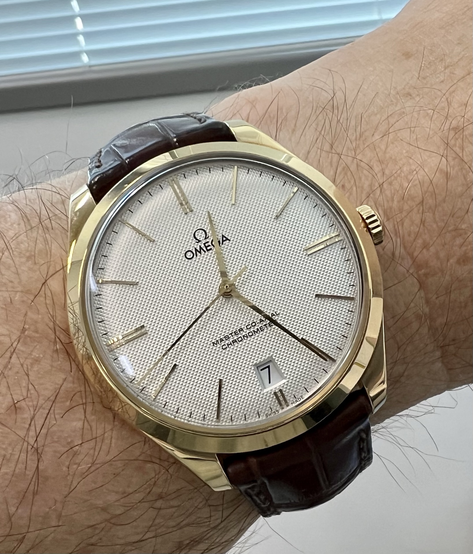

My Tresor got a strange bug: some time after winding an hour hand stops moving. Meanwhile the minute and seconds hands continue to move to the end of the spring charge and show exact time
This watch has been with me for exactly 7 years.
I will bring it to SC but interested to know what type of damage is this. Has anyone else experienced such phenomena?

It’s a beautiful dial I really like it. Don’t see many modern waffles.
3,427
10,366
That is a beautiful watch! Hot dang! Dial, hands and markers all perfect.
140
208
I’m definitely guilty of it, but this is a perfect example of the fact that Tresors deserve more love. There are some BEAUTIFUL ones out there, just like this one. Glad it’s back home.
