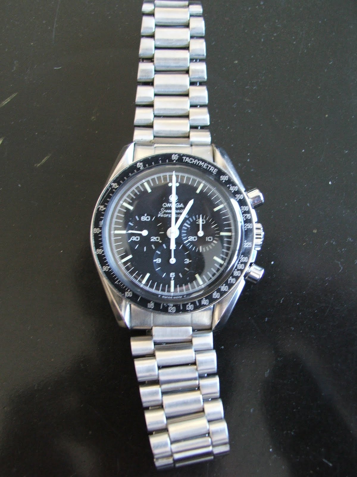

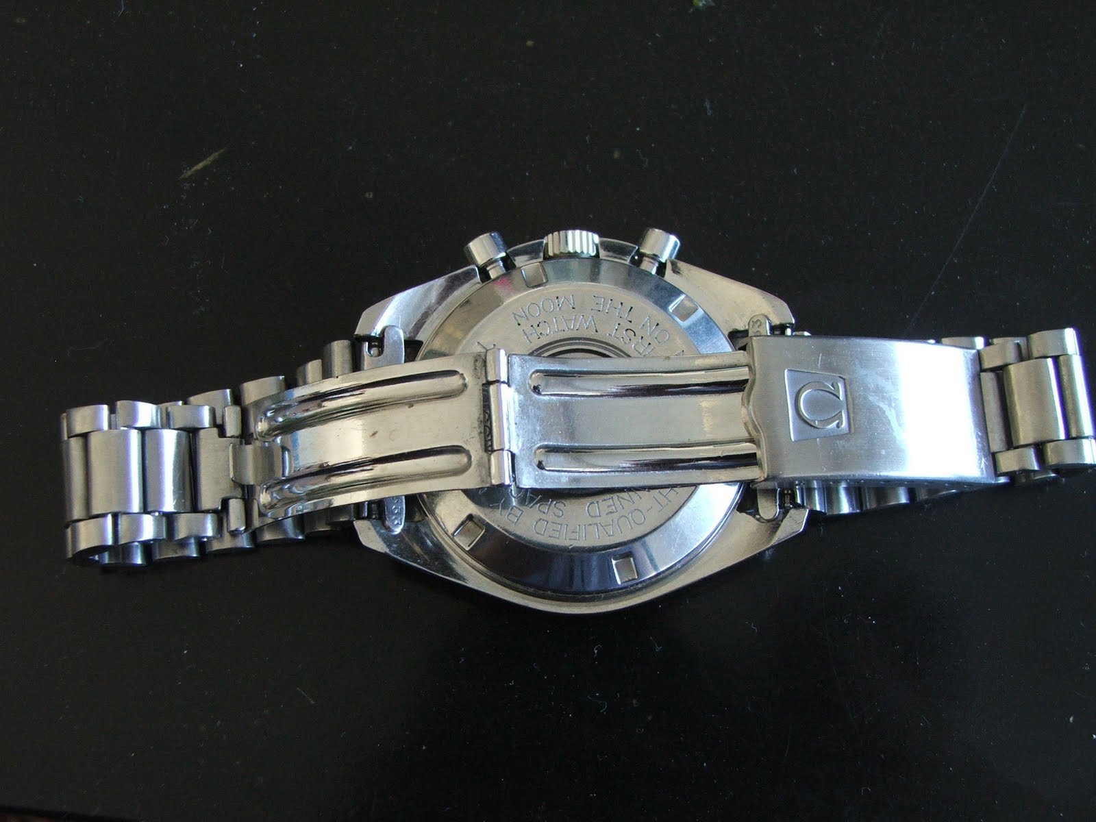

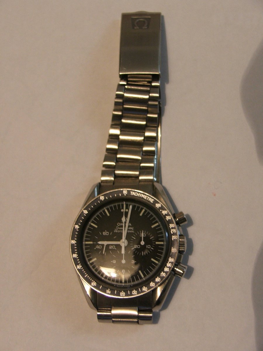

  8. Ilan Apr 6, 2011
    8
    Here is my Speedy Pro....
    Trev likes this.
  9. dsio Ash @ ΩF Staff Member Apr 6, 2011
    26,923
    32,599
    Nice, Cal 861 from early to mid 70s?
  10. Ilan Apr 6, 2011
    8
    Yes! it is cant date it exactly it was my late father's watch, i remember it ever since on my dad's wrist, I loved this watch since i was young....i started wearing it latelly so I'll always carry a recollection of my dad with me.
