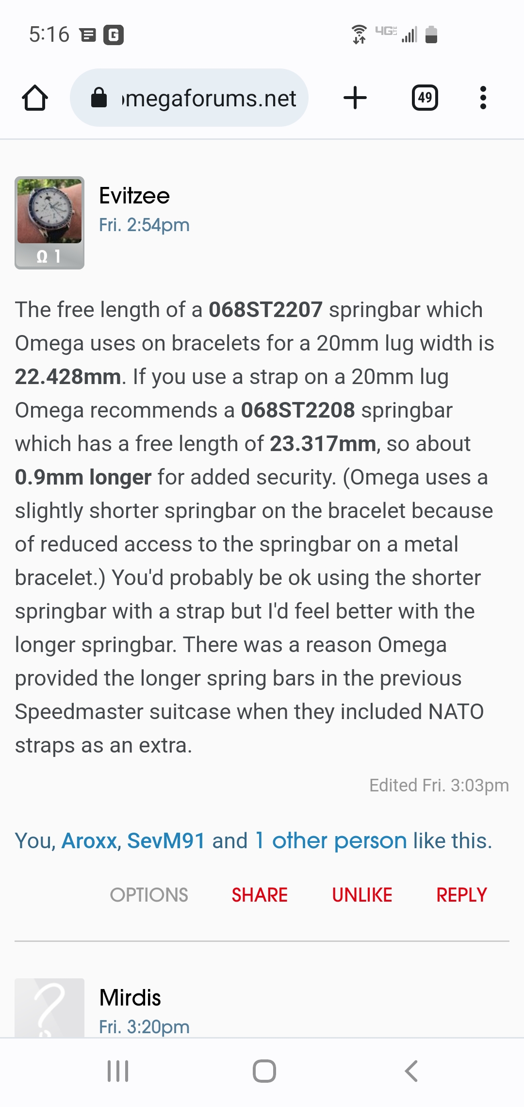

I have the '57 Trilogy Seamaster and want to (finally) try the NATOs that came with it...
just use the bars that are holding the stock bracelet or is there some springbar juju I need to be aware of?
Asking mainly because I've searched here and found a thread where someone said for a NATO you may require a different length bar than the bar in your current bracelet (which makes zero sense to my brain because while I'm swapping a bracelet for a NATO I am not altering the width of the lugs ~ be a cool superpower though) and another post whereupon someone else said "for NATOs you *must* use curved bars".

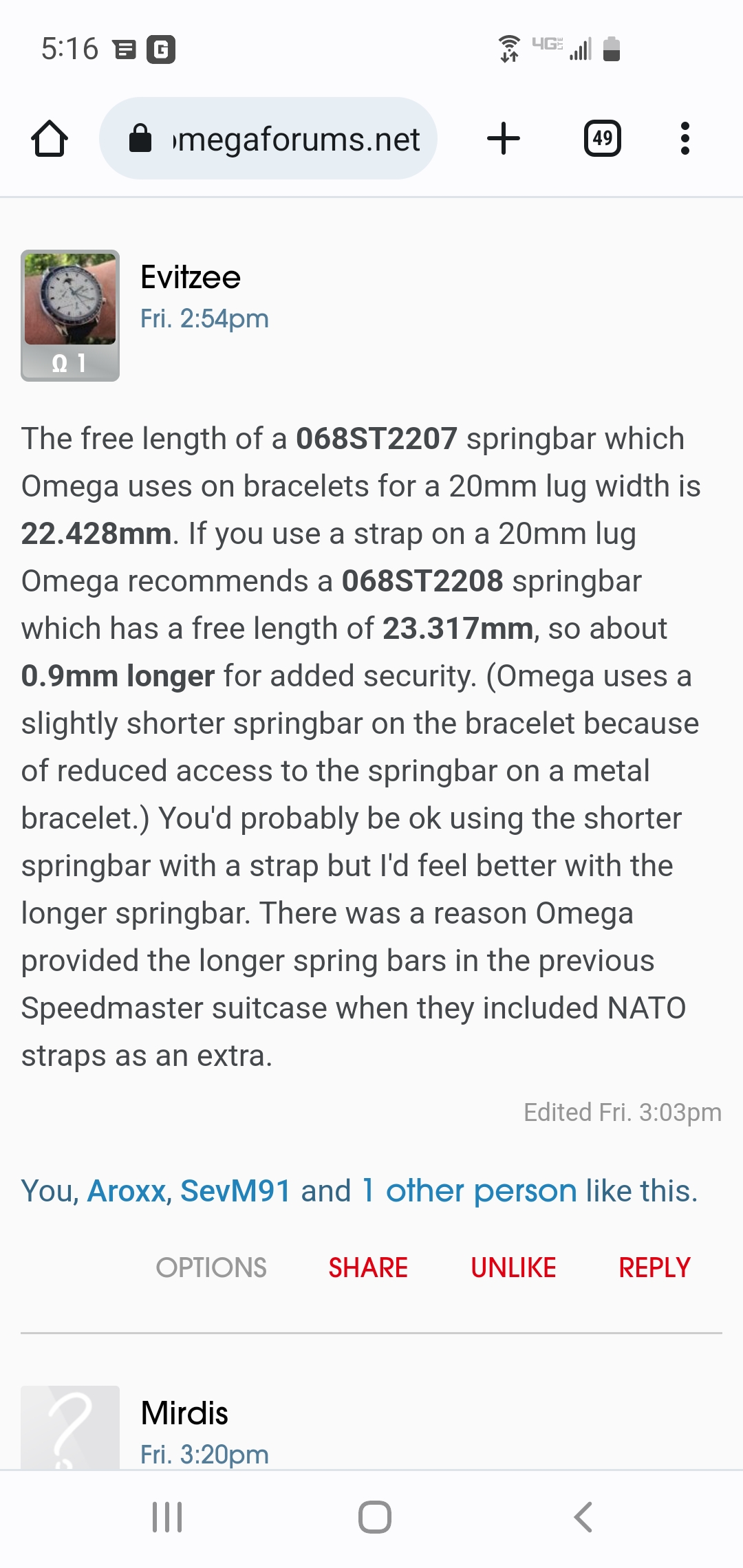

Omega has you covered. Unscrew the cap on the aluminum spring bar tool in the Trilogy kit and you will find new, longer springbars for use with the extra straps.
Another example is the Ed White 321 which still comes in the old style Speedmaster suitcase, along with the extra NATO straps. The Ed White has a 19mm lug (like the Trilogy), but Omega provides separate 068ST2207 springbars in the kit for use with the NATO straps. The 068ST2207 are the recommended size for 19mm straps.

My Trilogy had 2 extra sets of the 2206 in the springbar tool which are the same length as the ones on the bracelet, so ordered additional 2207's at the AD.

Mine had 2 extra sets of the 2206 in the springbar tool which are the same length as the ones on the bracelet, so ordered additional 2207's at the AD.
Spoke to the OB nearest me earlier this evening and was met with a rather stern manager who said, "Sir, I have been this boutique's manager for nearly six years and I've never ever heard that there is even the tiniest difference between a spring bar for a bracelet and a spring bar for a strap be it NATO or otherwise."
