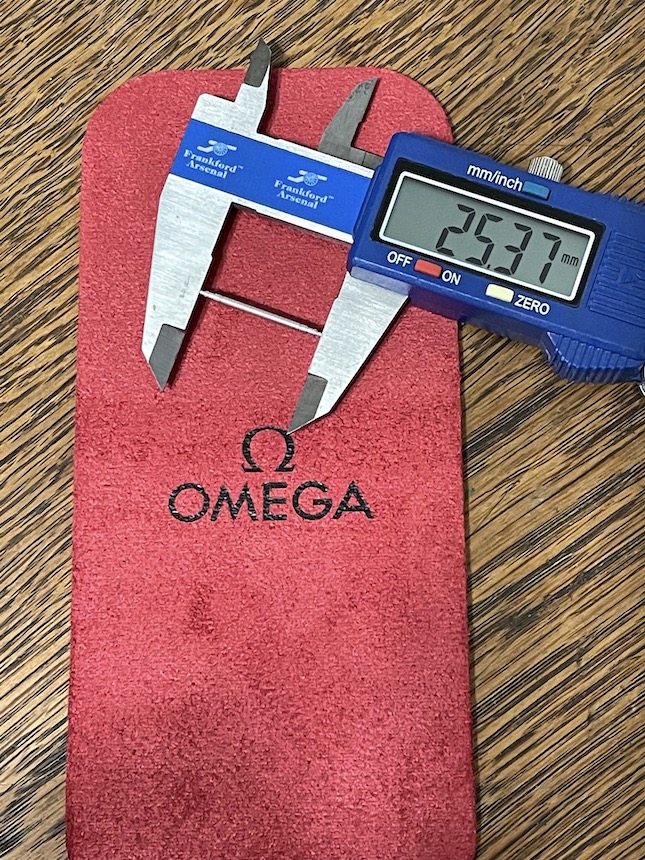

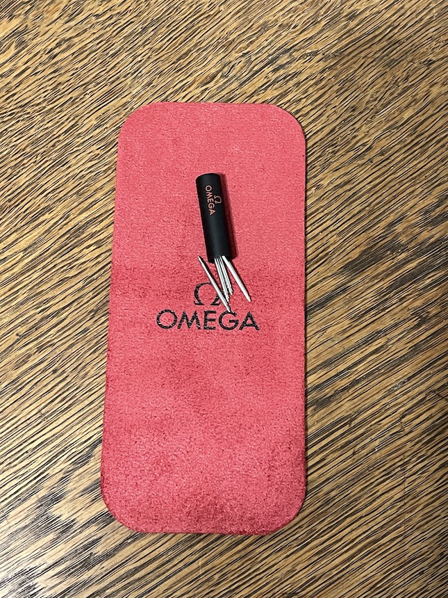

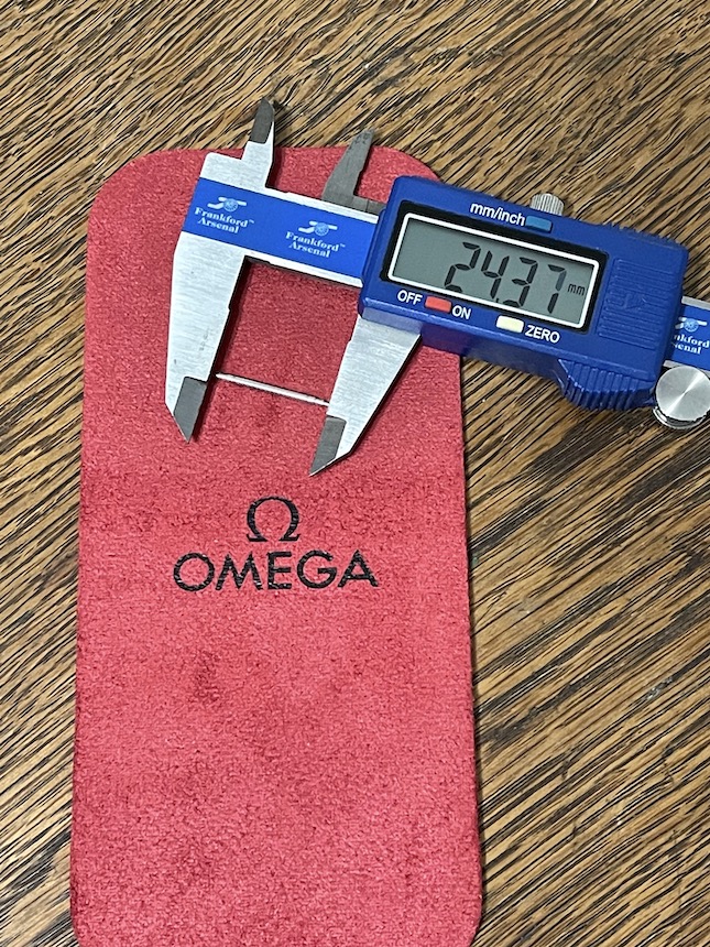

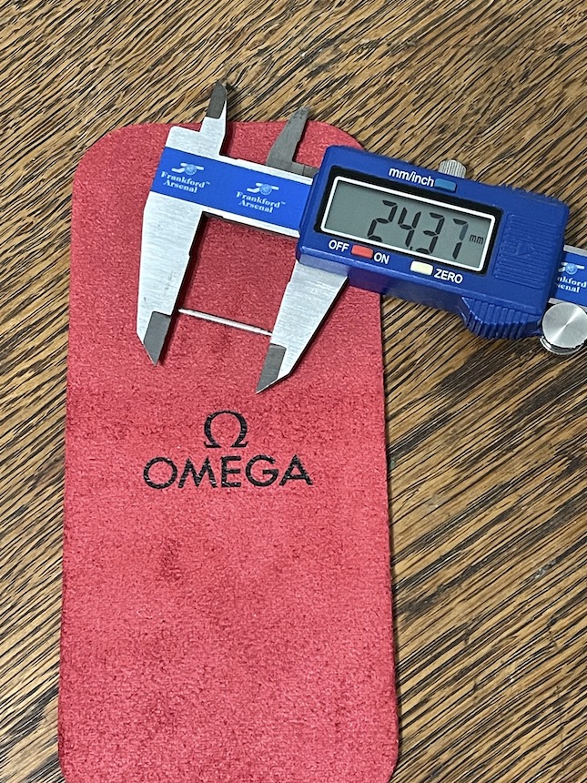

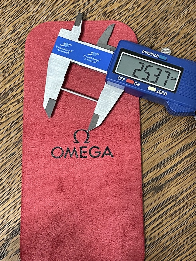

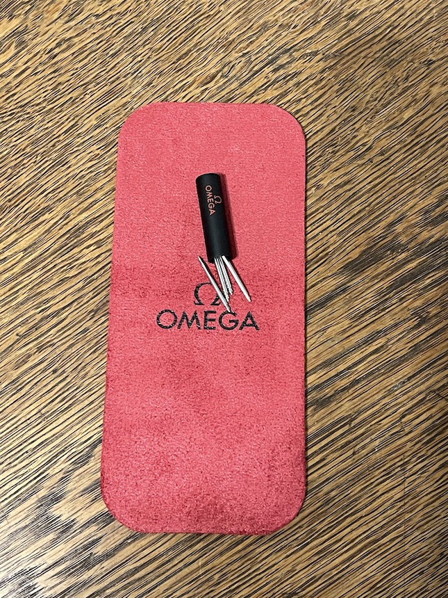

NATO arrived. I was expecting something like a padded envelope with the strap and a small plastic bag with the spring bars. Surprise, here is what arrived. So, do I use the long or shorter spring bars for the NATO strap on my 21mm lug PO?
6,487
31,960
Long.
