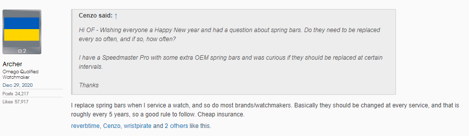

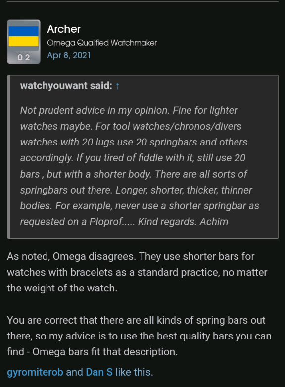

Please someone
Photos
https://omegaforums.net/threads/psa-springtime-for-springbars.56537/#post-697812

Wow! I have a super basic question on this - Is there an advantage to keep using the Omega spring bars for my 300M? I've had speedy for decades, but I never actually took them off bracelet, so I've never really thought about it.

I'm sorry - I might not have been super clear - should I keep using Omega BRAND springbars versus [ insert random brand here ] 20mm spring bar.

Why not, these aren't expensive so no need to go after market.
