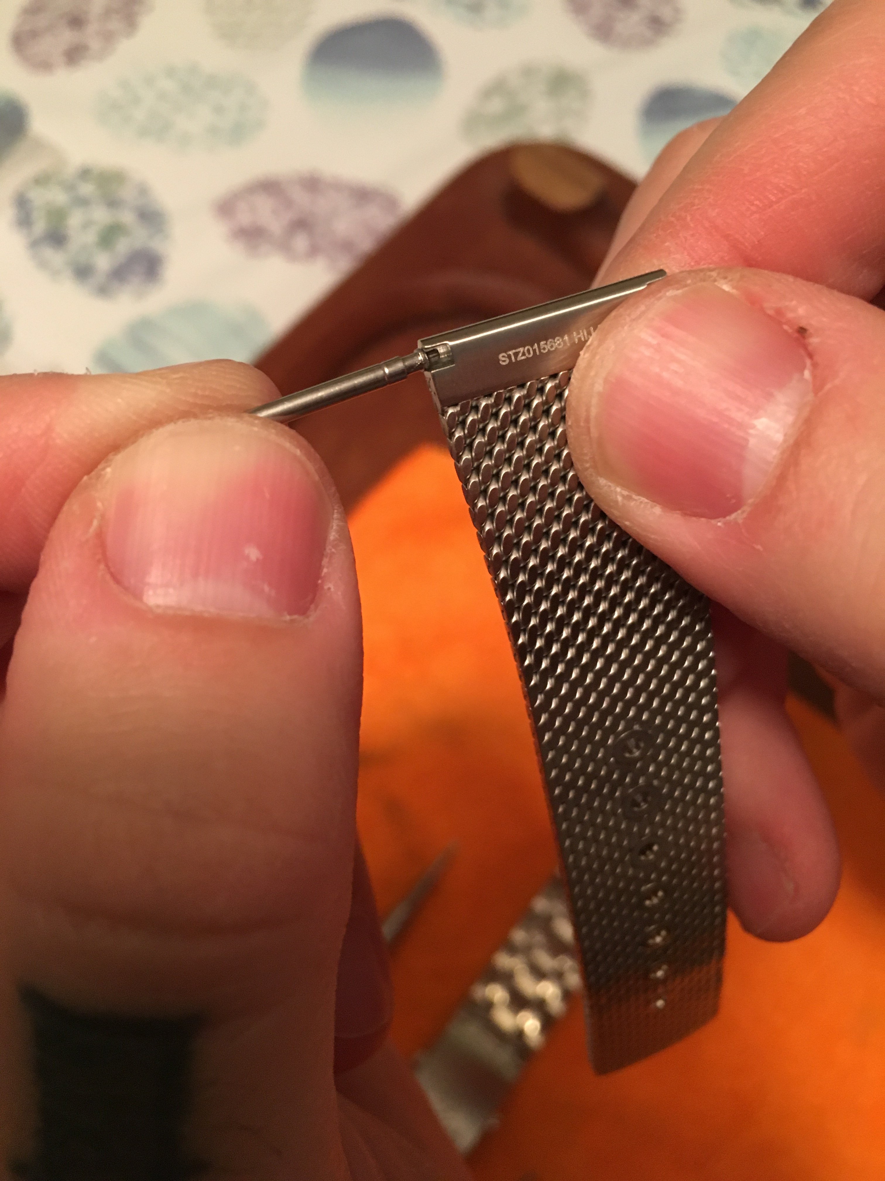

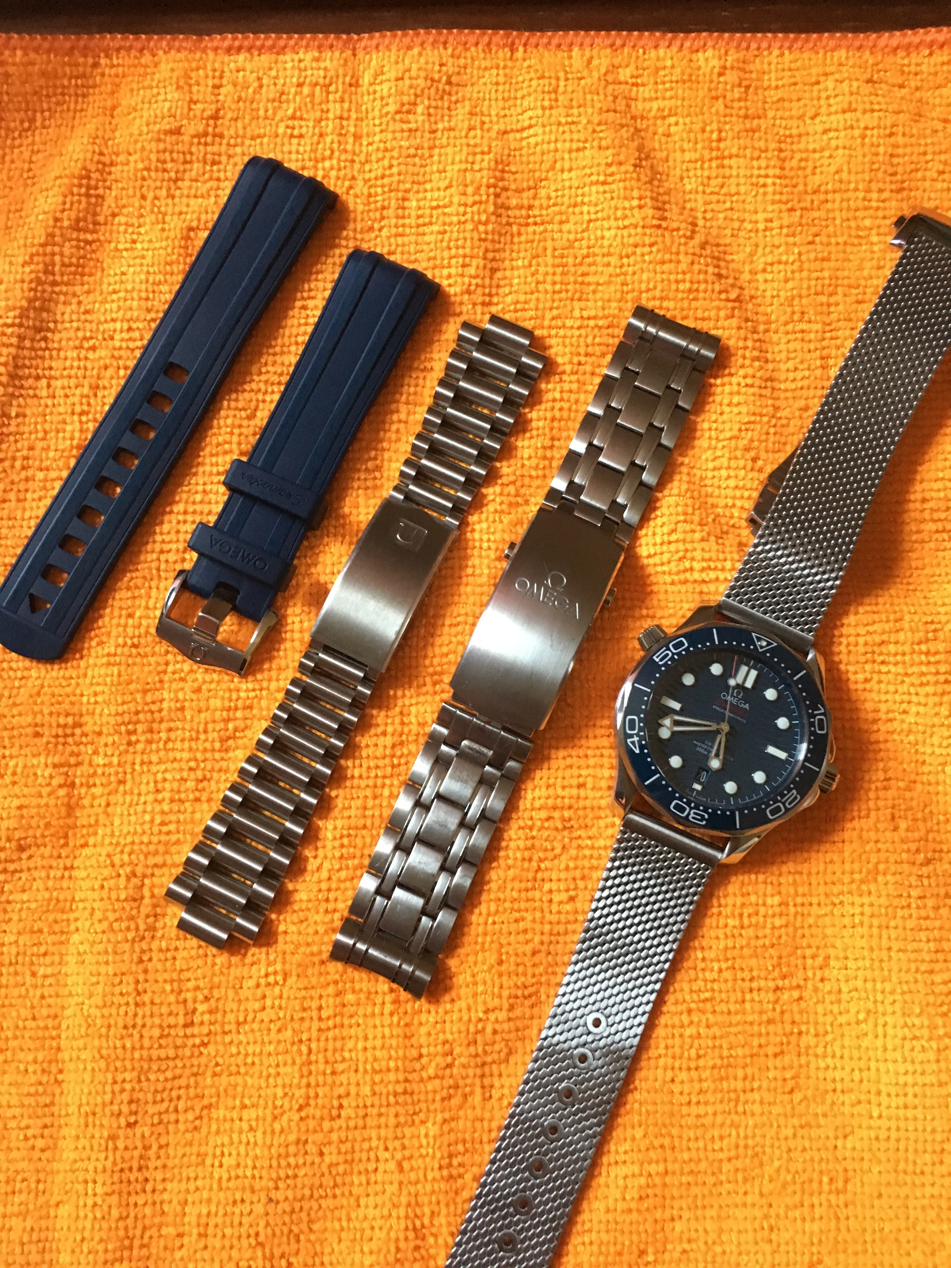

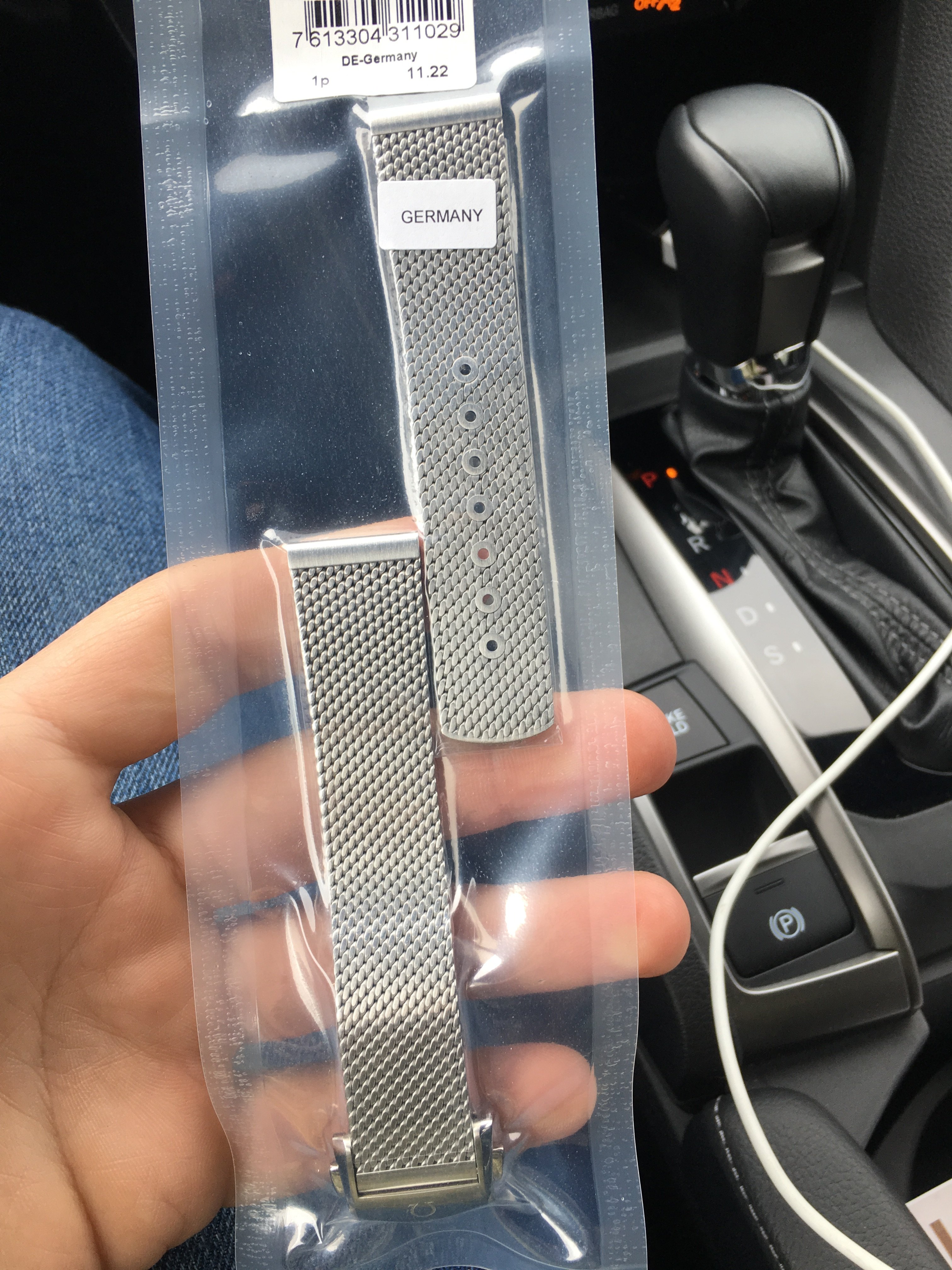

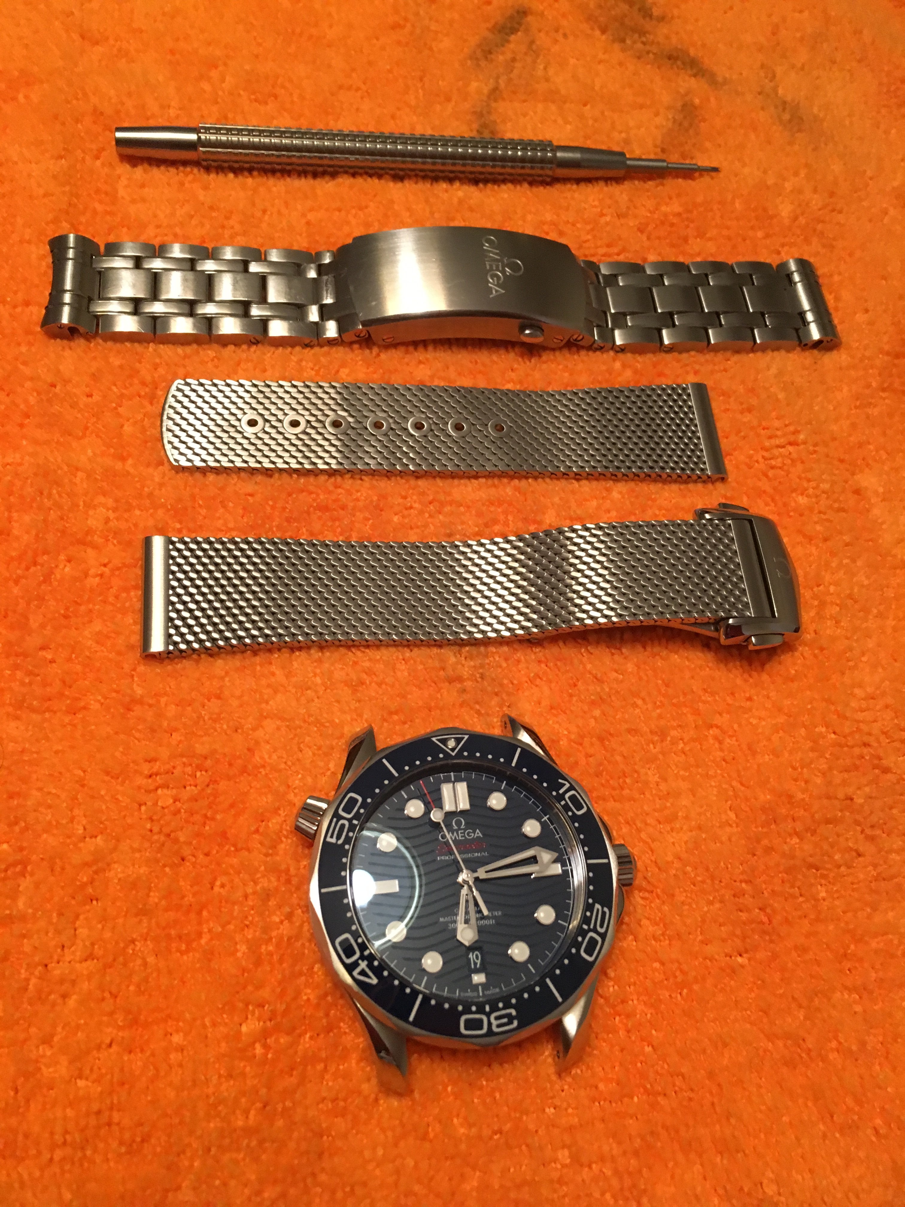

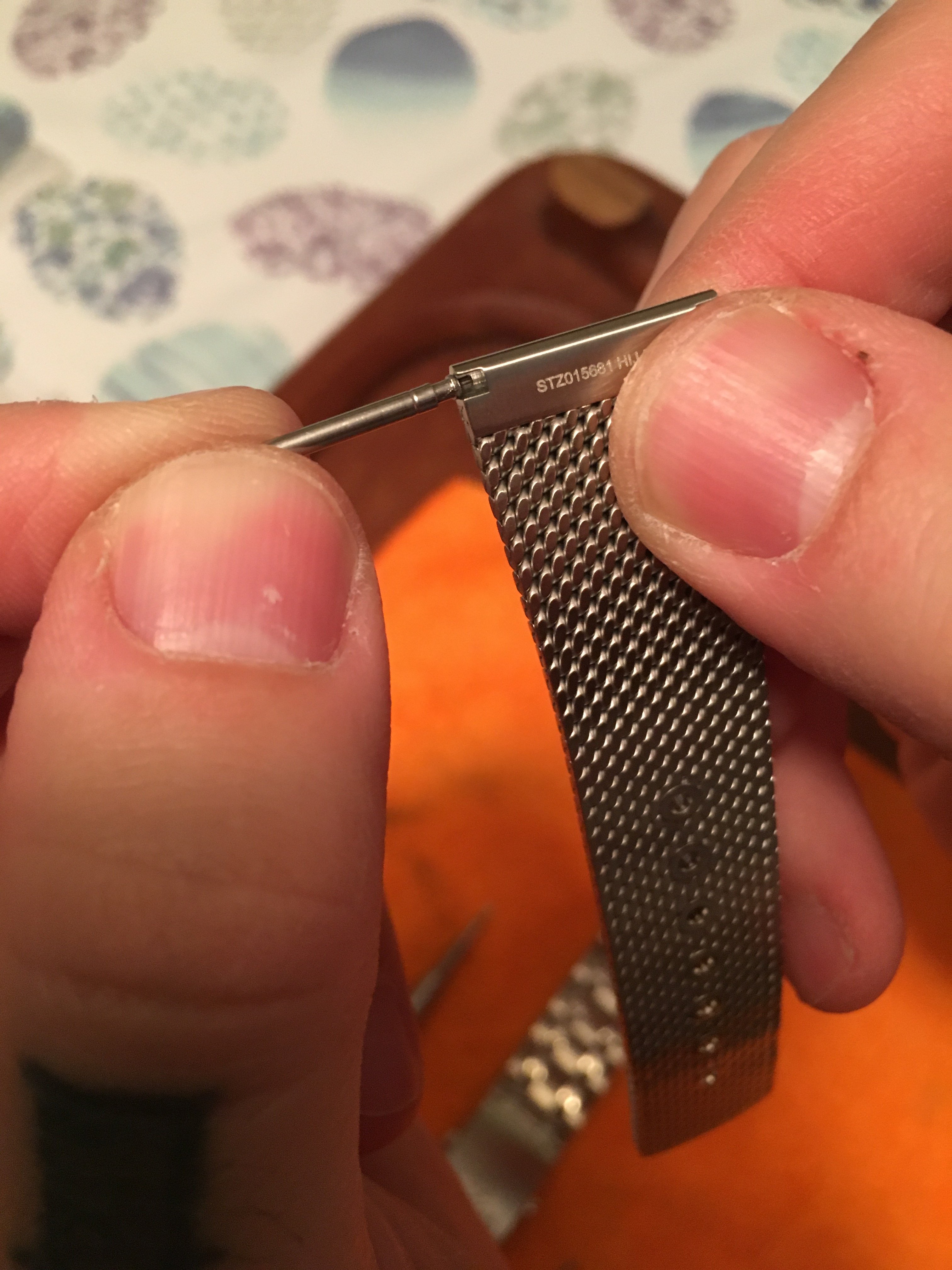

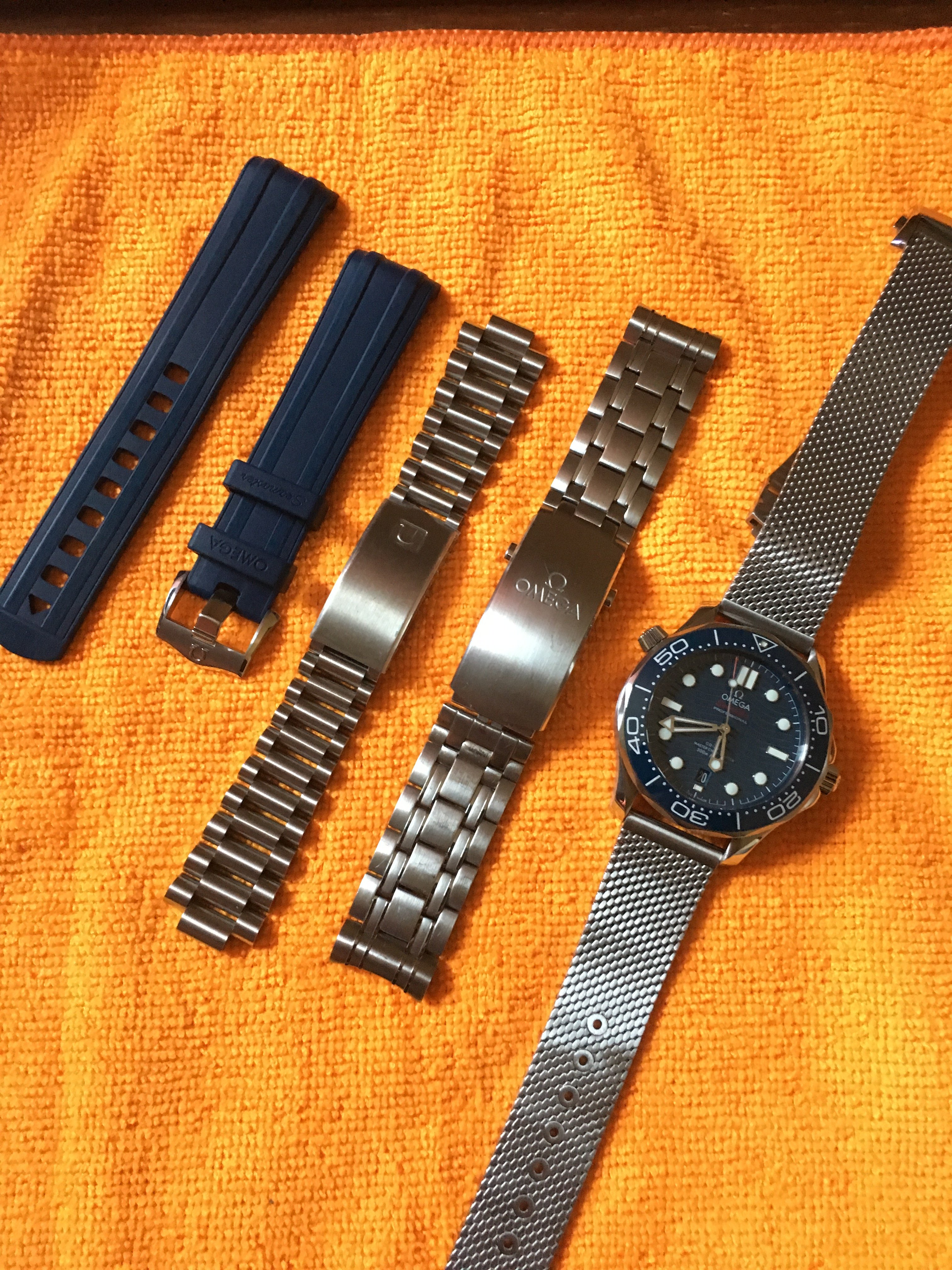

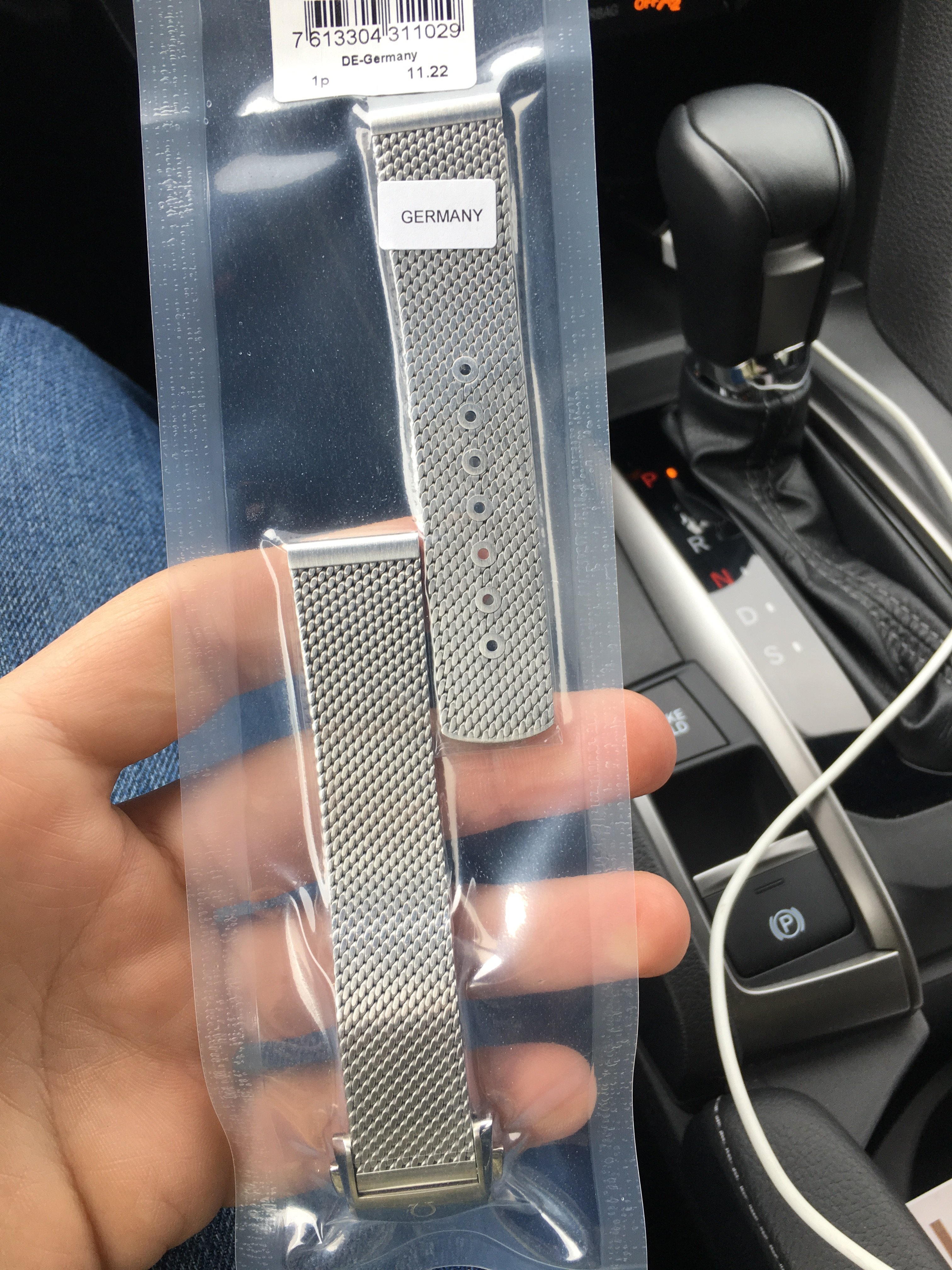

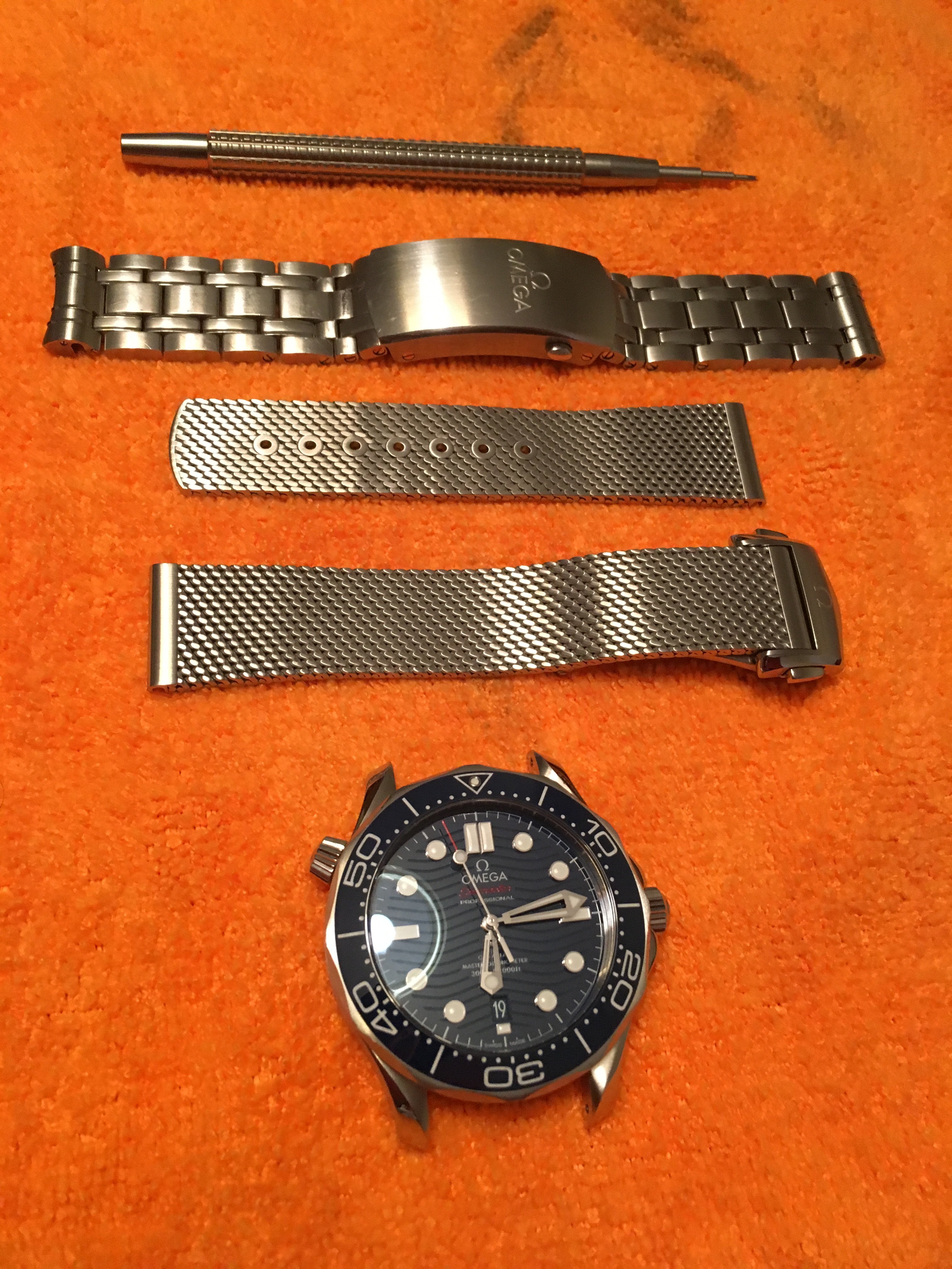

Bracelet arrived today and it is beautiful. But I want to warn fellow members who may buy this bracelet that I now know why it was mentioned that it Dosent come with spring bars.... it’s not a length issue but an outside diameter issue.
The bars that come with the watch on the typical seamaster bracelet or the rubber strap are too fat to slide thru the Milanese end link tube. I tried every omega and sundry other no name springbar that I had on hand and none had an outside diameter that would pass thru. The stock omega bracelet bars wouldn’t even make it past the first shoulder.
I texted with my guy and he said come on back and he’ll find something suitable, it’s my own fault for not letting him mount the bracelet before I left the store, They were soon to close for the day and I didn’t want to keep anyone, it was my fault for showing up near closing time and I also frequently change straps and I rather enjoy tinkering. So I’ll head back tomorrow and get it sorted out
Shame on omega for not selling their bracelet with bars to match, I can understand not providing bars for a strap or bracelet that uses common springbars, with the assumption being that there must currently be a strap or bracelet on your watch head, so just reuse what you have.
This Milanese very clearly takes a unique springbar, to spend hundreds of dollars and not be able to use the product straight away is unfortunate.. I would have gladly paid for and ordered the bars at the time of ordering the bracelet. My guy at the AD also had no idea that it took unique bars and I don’t place any blame on him for this, there is obviously no attentions or warnings in the omega parts catalogue to add the correct bars when ordering the milanese bracelet
I will attach some photos of what I have now and tomorrow hopefully we can add a photo of the finished product lol
Hope this helps someone down the line, I love this forum it is always a source of knowledge for me

Measured the inside diameter of the Milanese end link tubes with some gage pins at work, they are .061” which is 1.55mm.
So i checked online and you can purchase 1.5mm by 20mm spring bars from several sources and that’s exactly what it’s going to take to mount this bracelet up
Just thought I’d update this thread with some real numbers to help fellow members/enthusiasts like me who drop by to learn

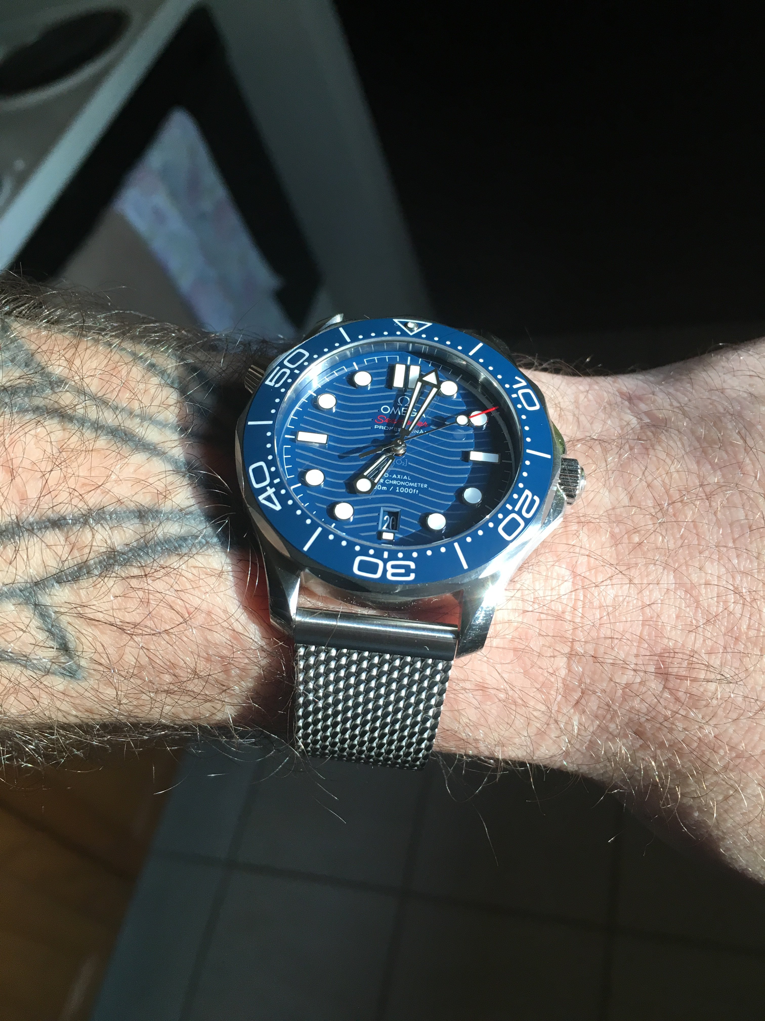

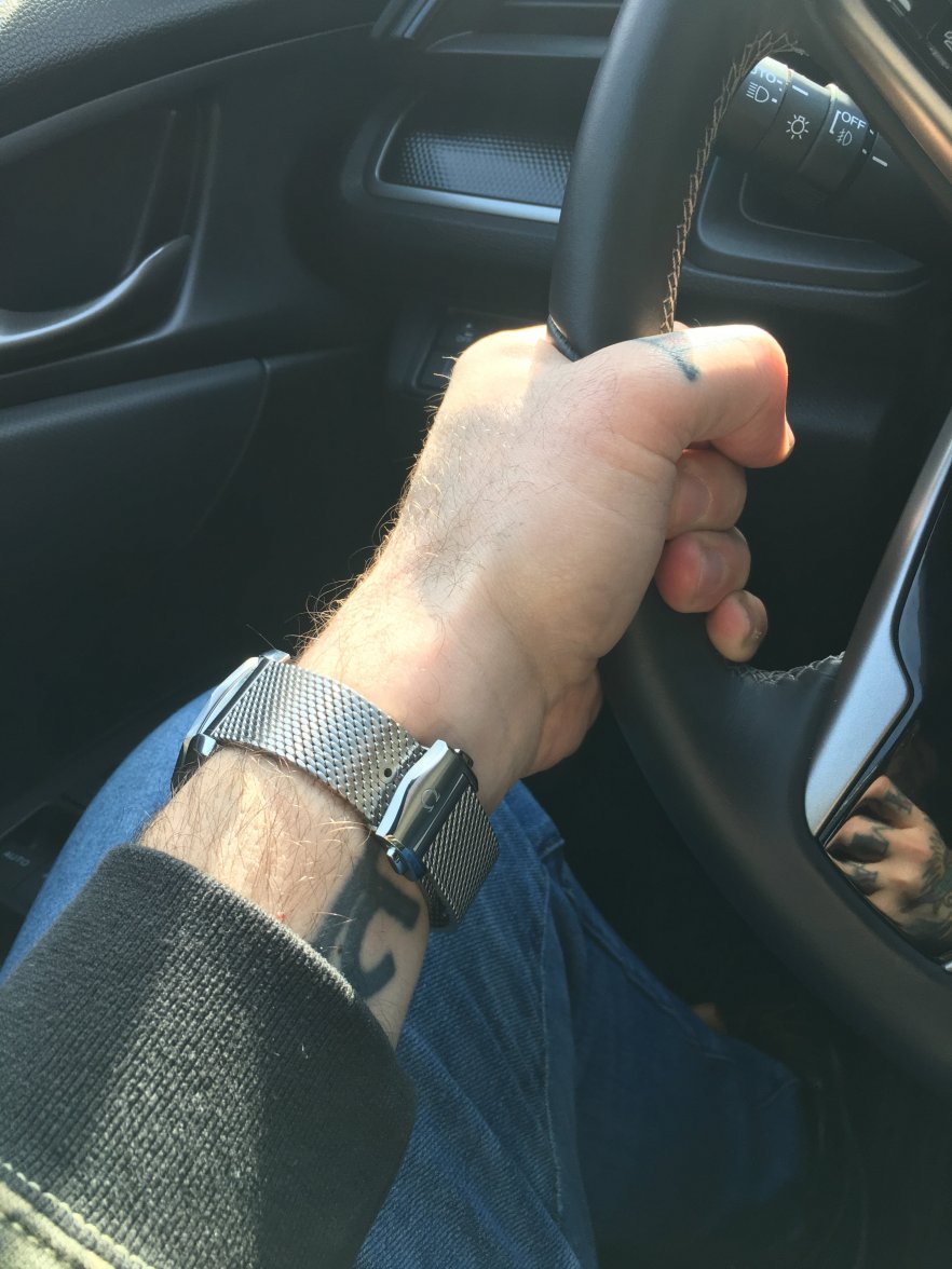

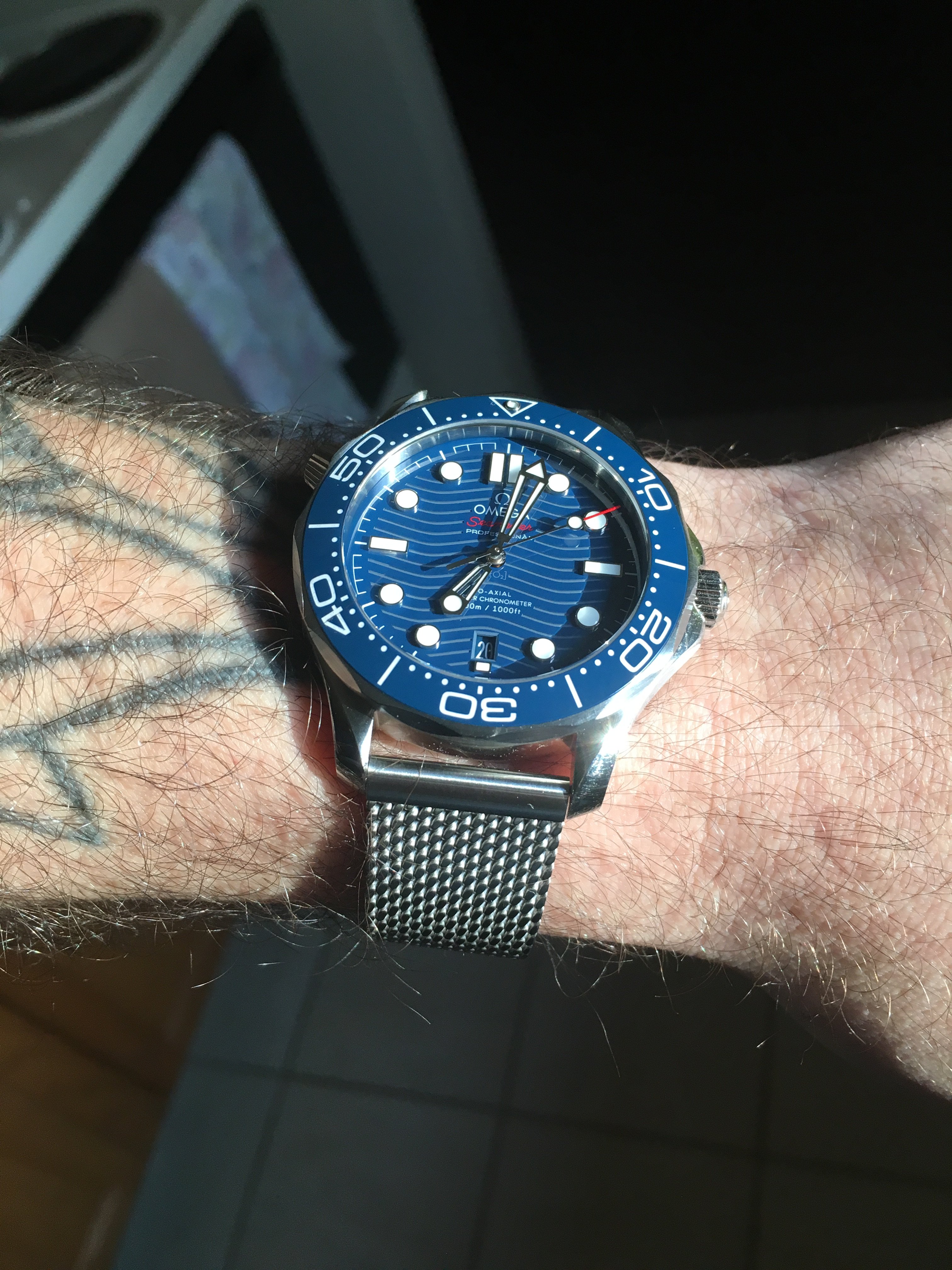

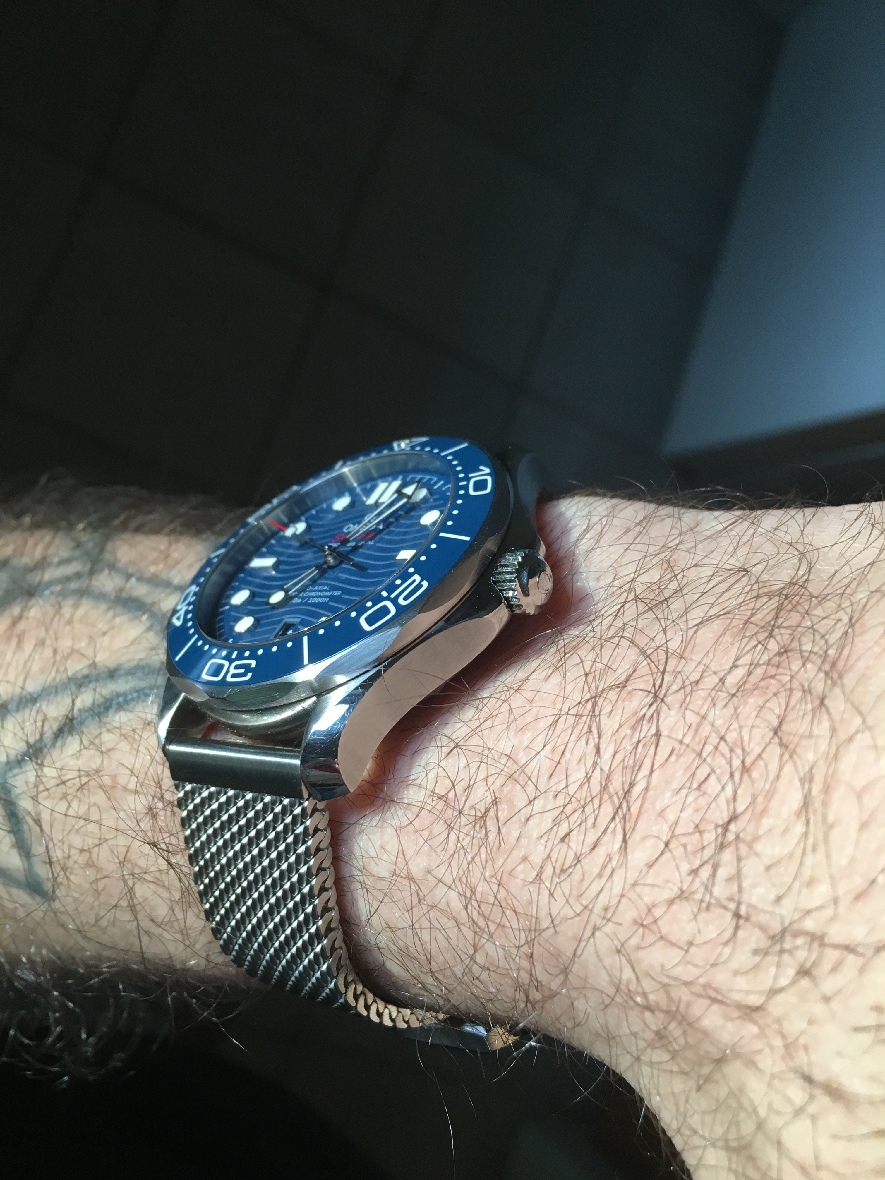

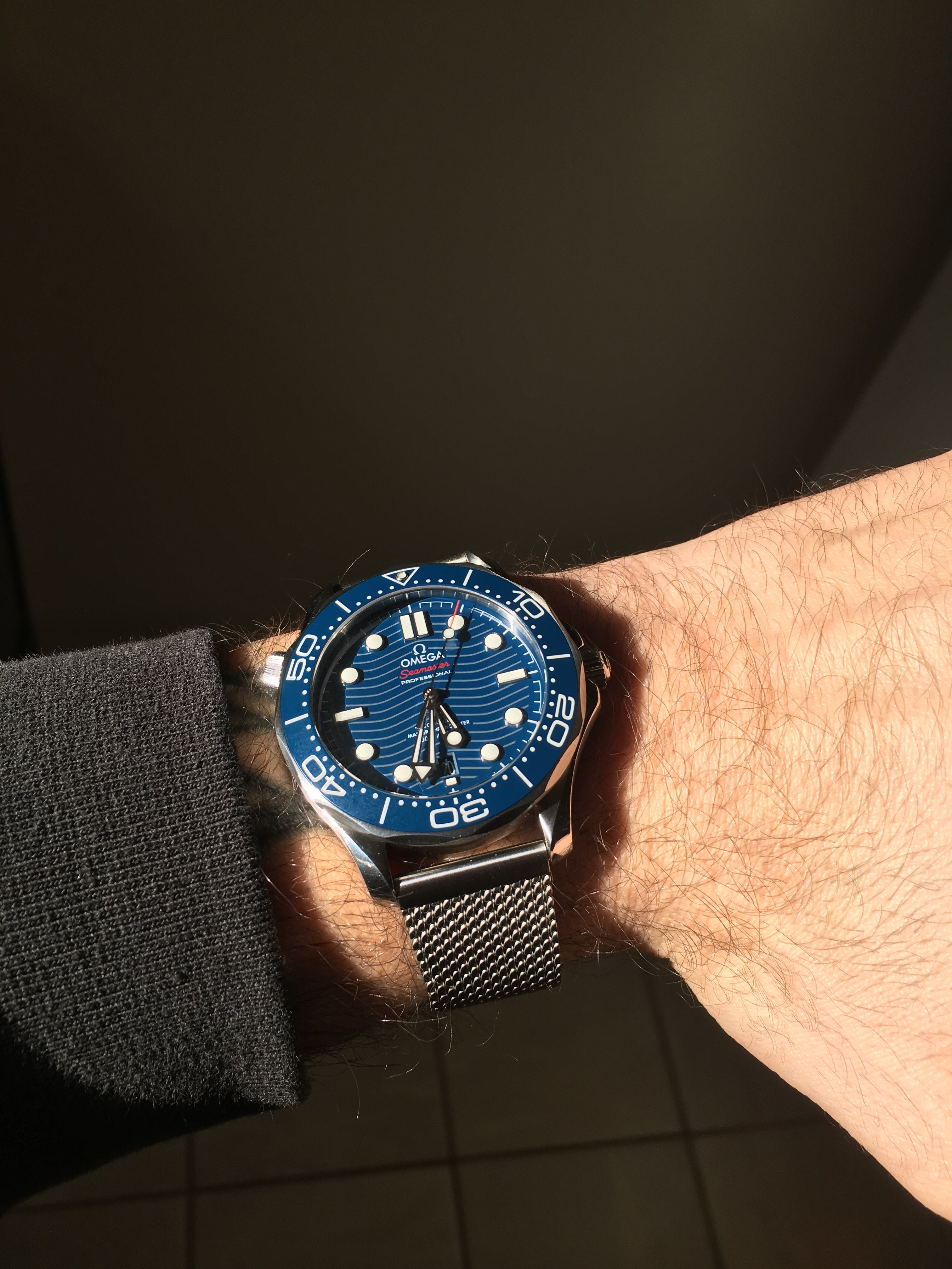

Got it all mounted up and I am loving it. I could my man at the AD also was into it because after I put it on and sized it for my wrist he asked to hand it back over so he could try it on his own wrist!!
He made the comment and I do agree that this would be such a cool option for the stainless 300M diver line in place of the standard “Bond” 9 link bracelet.
In my opinion if Swatch/Omega is willing to “risk” their status and image by really taking a turn from the Rolex approach, why not go all the way and allow even MORE customization at all levels of their catalogue. I think this hobby can be so much fun or it can be a total pissing match.. tho I suppose this can also be said of a lot of hobbies
Some photos.. I will probably make a full thread post about the bracelet after wearing it for a few days/weeks
