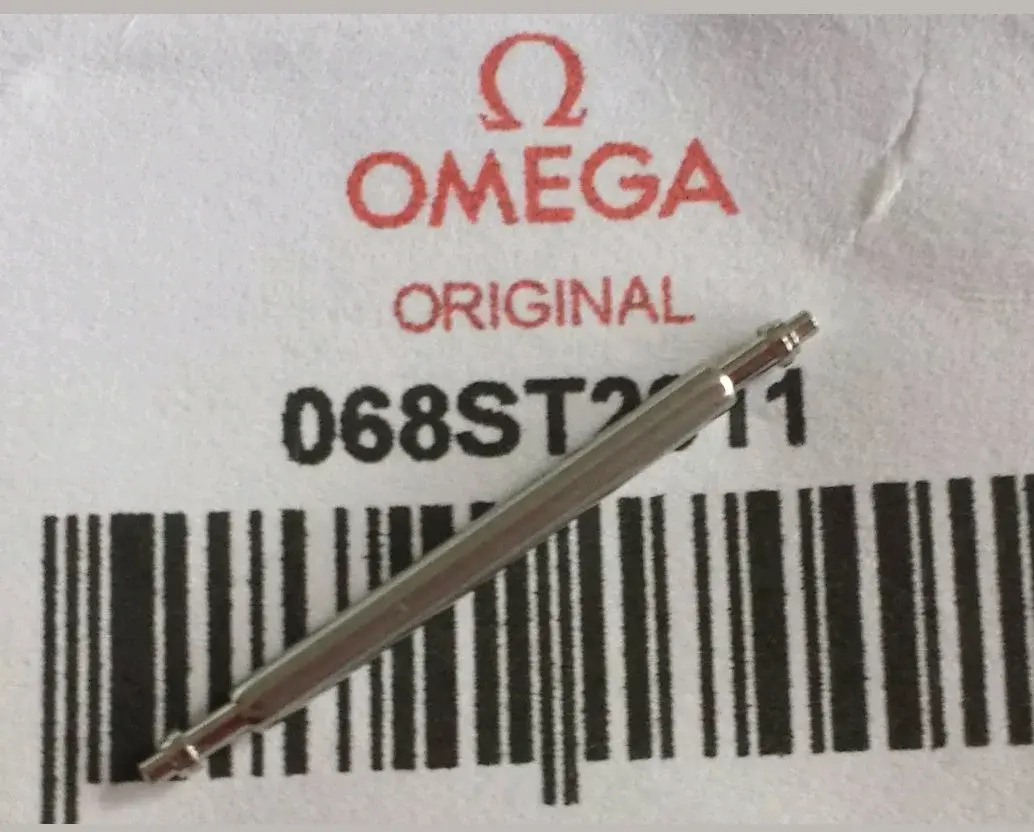

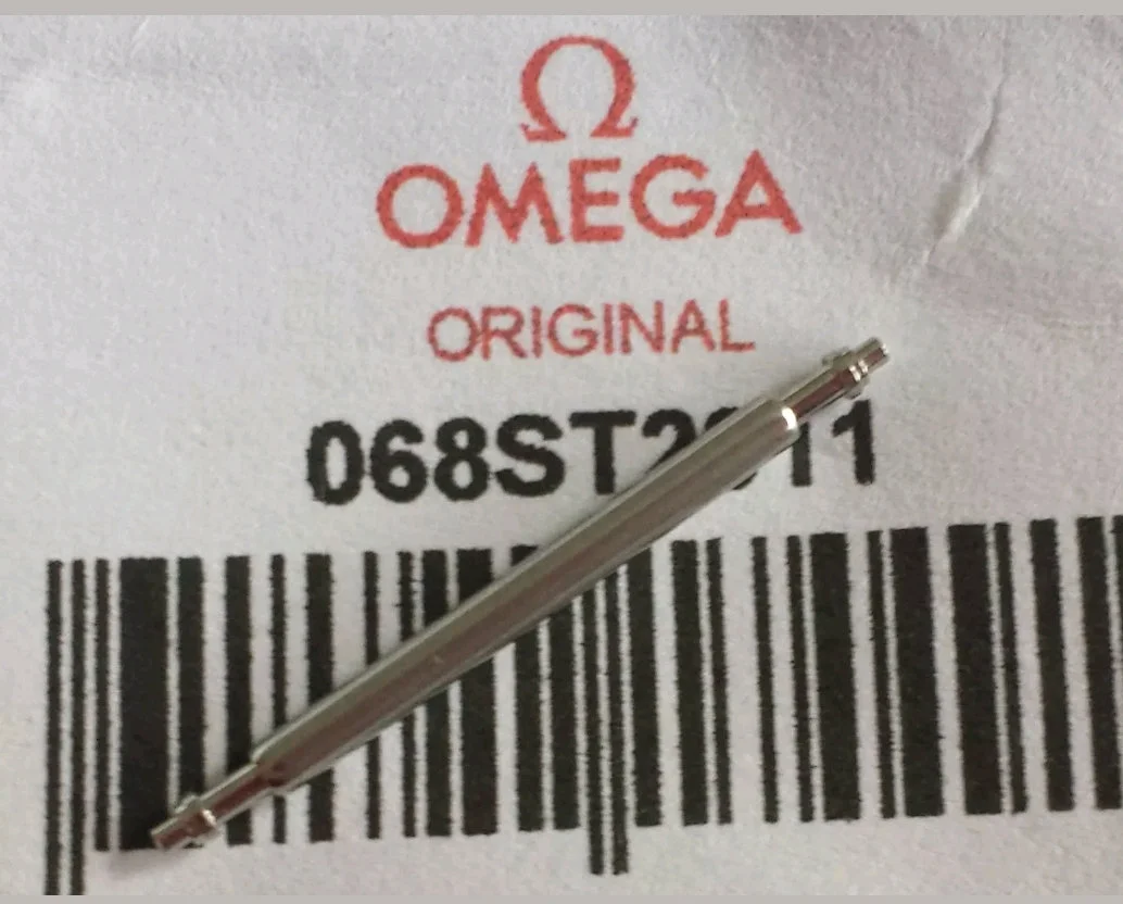

Partsno on the packaging looks spot on to this number. Your AD should have access to the Omega intranet so ordering the correct springbar shouldn't really be a problem.
