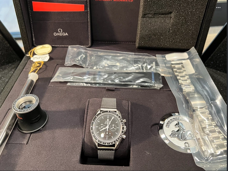

Has anyone tried one of these on a speedy 3861? I’m thinking of trying one out.

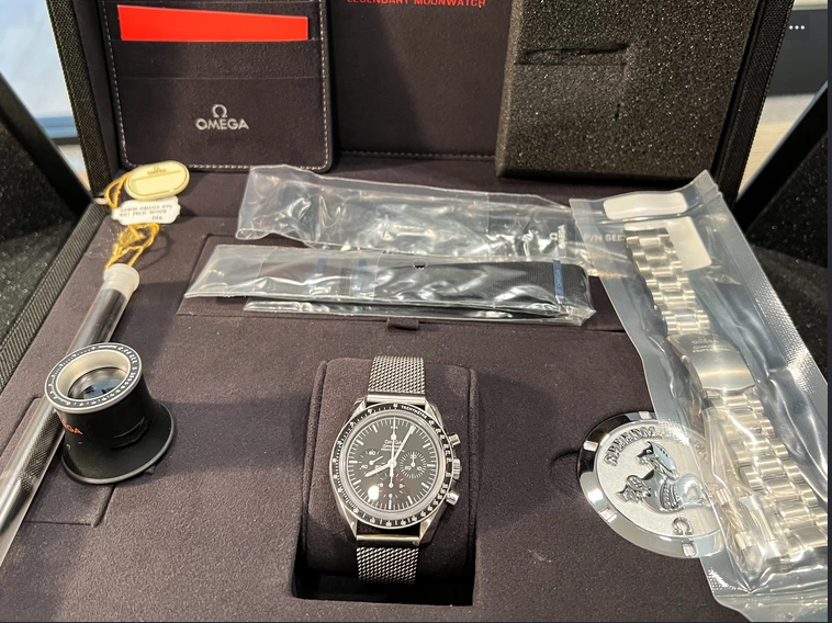

....and from an old for sale thread over on reddit (no great pics unfortunately, but another view)

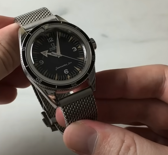

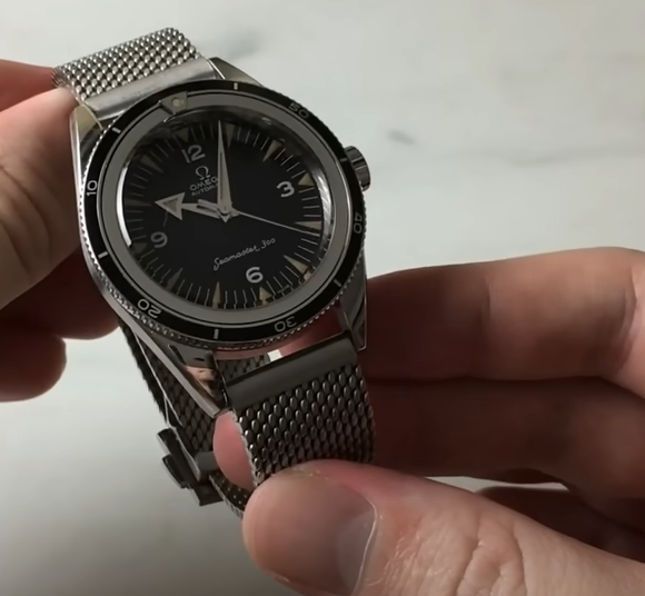

and here it is on a '57 Seamaster Trilogy from this youtube video:

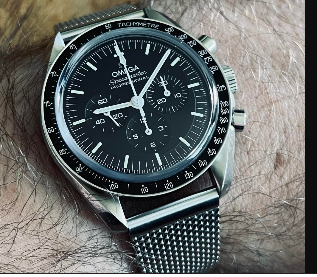

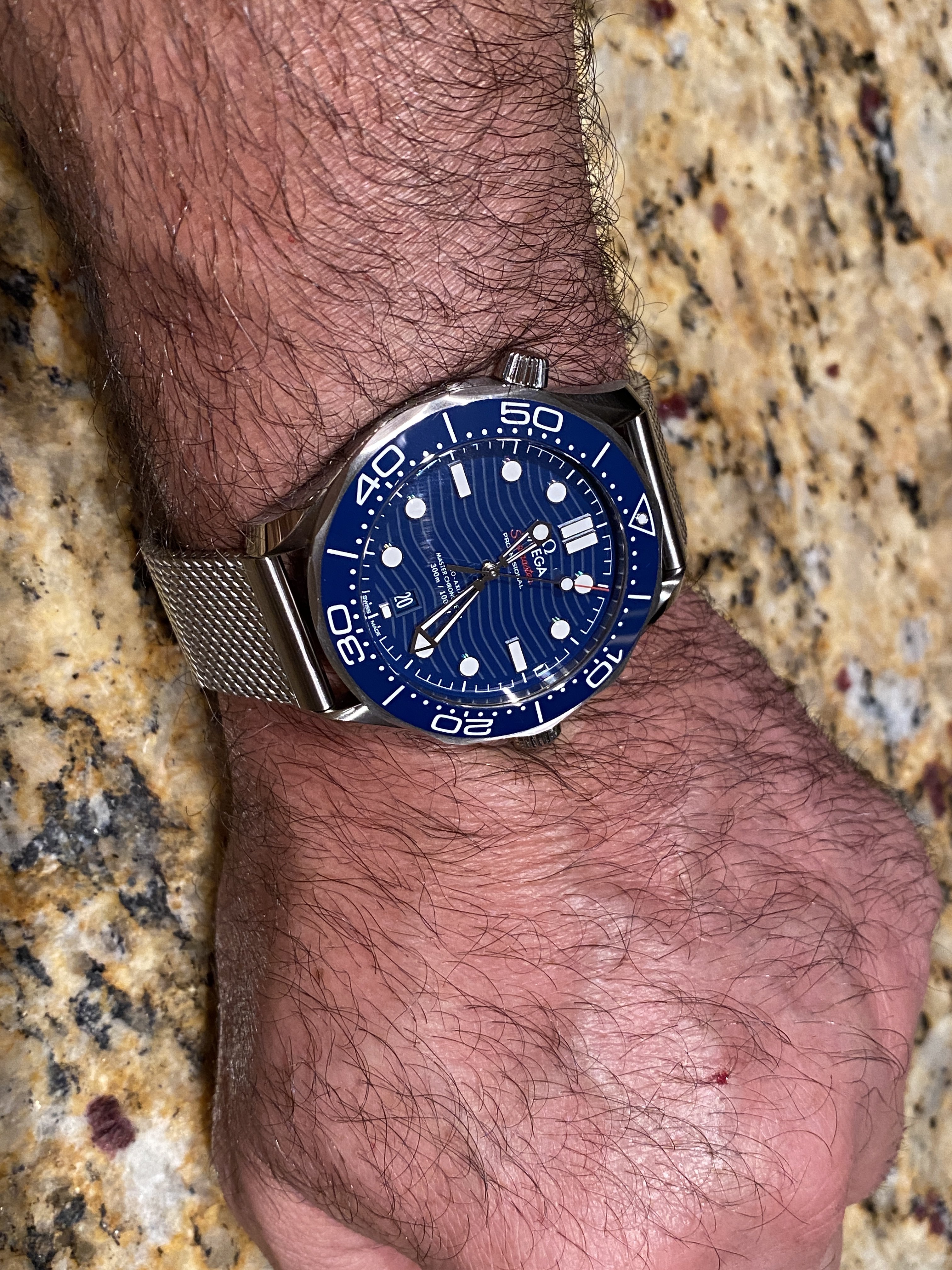

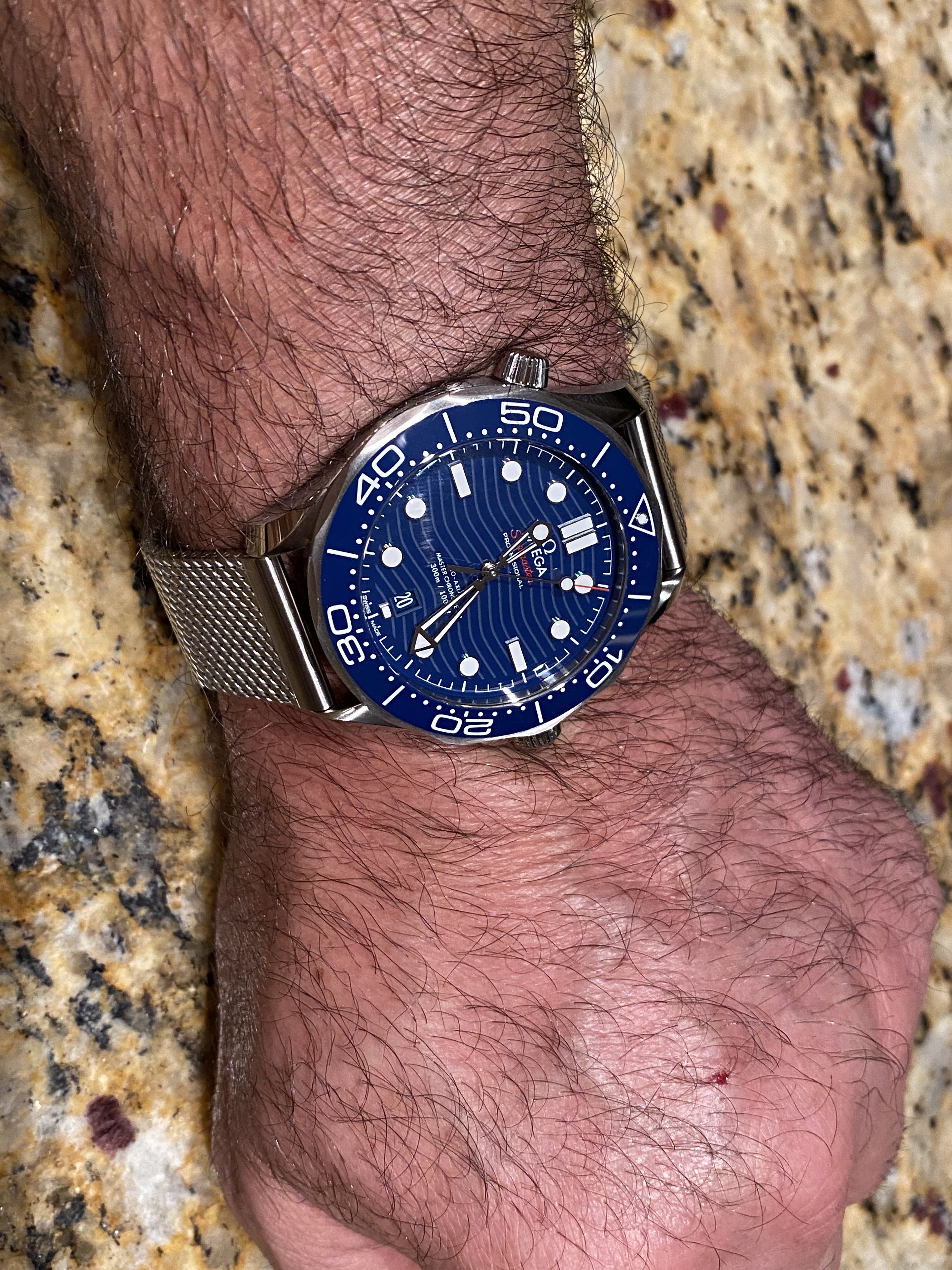

I had the exact same idea....I love the look of the 60th Anniversary 007 watch but find the animation on back sort of silly and gimmicky.

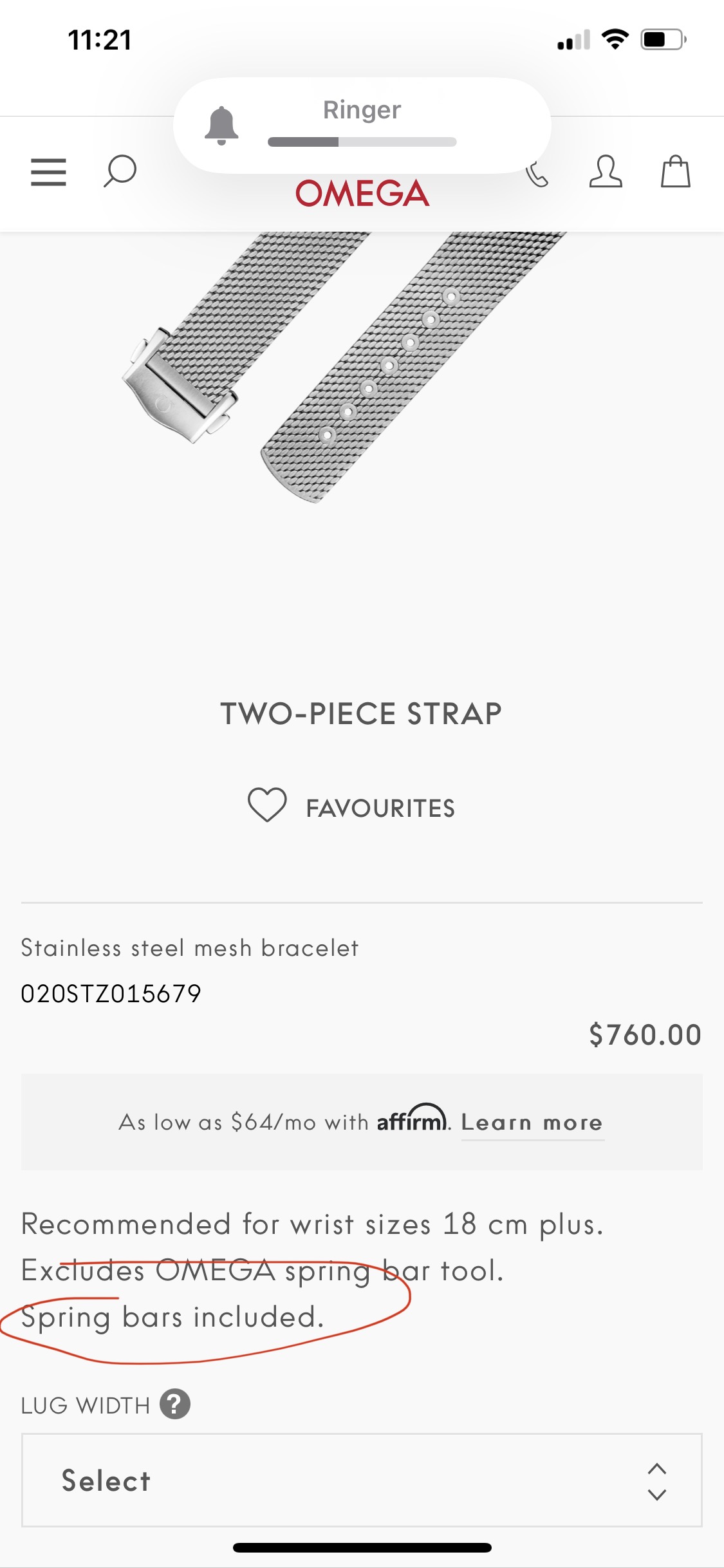

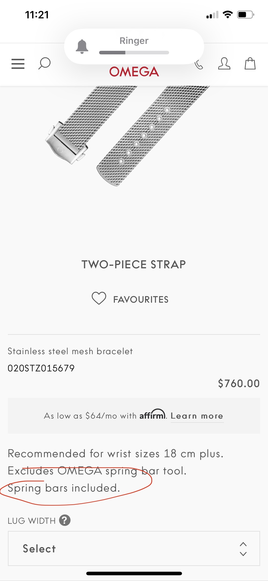

I bought the blue 300M and stainless mesh bracelet, which clearly says comes with spring bars, but they were not included....maybe old stock?
Of course, the standard spring bars were too thick, so for now I borrowed them from my NTTD watch and will get it sorted tomorrow.
I'm not sure of part numbers, but the 20mm steel mesh uses the same exact springbars as the titanium NTTD mesh. I had the same problem and visited a boutique. That's what they told me, and gave me two sets of the proper springbars. No problems since...
11
37
Correct. I have currently borrowed the spring bars from my NTTD.

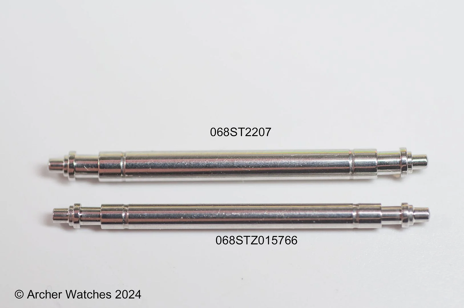

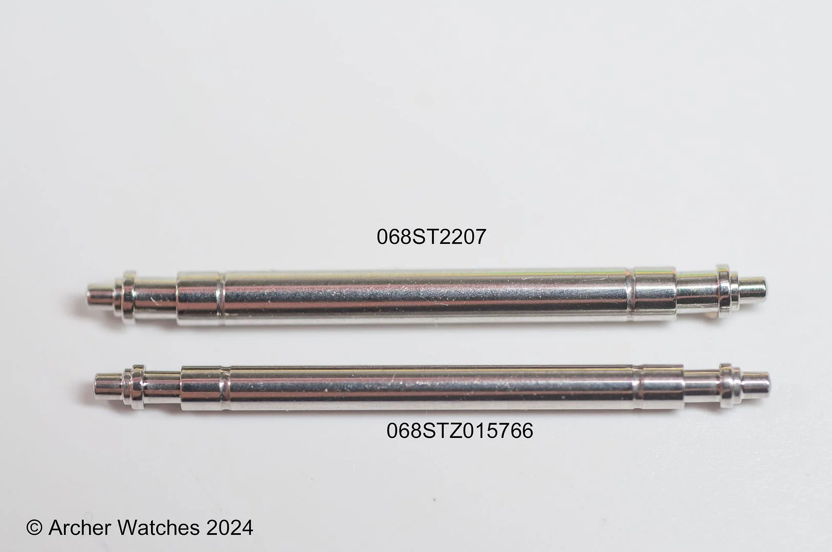

@Archer can you please help with the Omega reference / part number for the 20 MM Titanium Milanese bracelet of the NTTD 210904422001001 ? Know they are 1.5MM thick, understand numbering starts with 068ST
Thanks
Francisco
2,477
3,867
Thanks
Francisco
* cough * 068ST2107 * cough *
3,425
6,593
Thanks for replying. Just found in a sales ad from an AD that the model for the springbars is 068STZ015766; wonder if the ones you indicate above (068ST2107) are identical ?
2,477
3,867
No idea what the 068STZ015766 is, Archer would have to look up the part number on the ExtraNet
30,302
78,233
068STZ015766 is the correct spring bar - the 2207's will not work...
