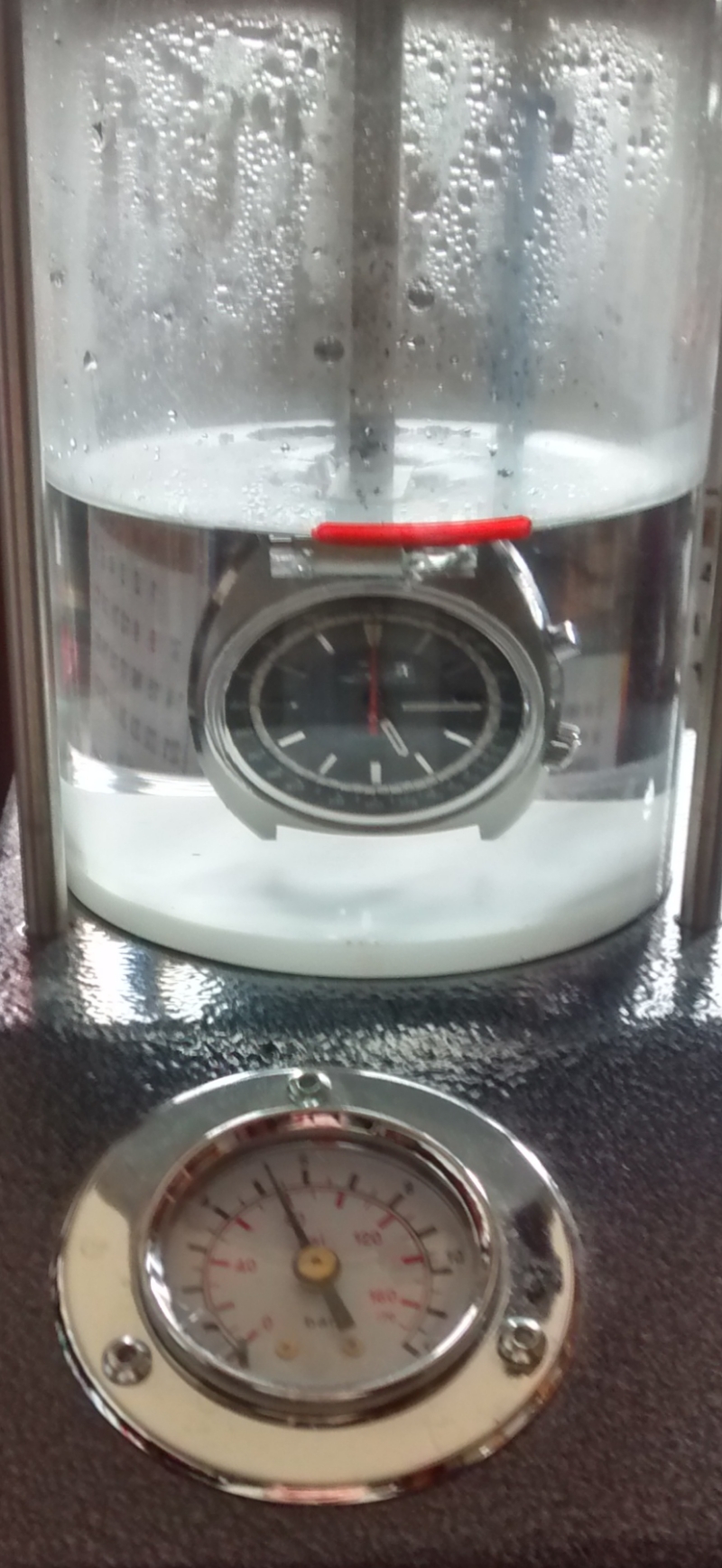

I have a few kits, they go by the name "Micro O'ring kit" and there are two boxes with I think 24 various sizes. There is also a flat o'ring kit and a "D" and "E" one for Japanese cases.
All the best,
Rob
Top tip, thanks Rob. Once I knew what I was looking for, I found them easily on the website of a Spanish supplier I've used before. Am not sure how I missed them to be honest.
Have this 145.0007 Chronostop that would have needed a €70 new pusher. Just taken it apart and sealed it so it passes a WR test (does have a new Omega crystal, crown and case seal) easily. Here coming down from 10 bar. Now it's properly usable again.
Now, if I could just find a supplier of a shorter strap that fits the original deployant clasp, I'd be even happier. At full adjustment, it's still a little loose on my puny 6.75" wrist.
Cheers, Chris

Well done Chris, glad you found the o'rings and that allowed you to fix the pusher and save some serious money along the way.

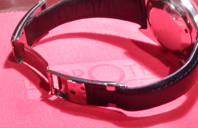

They're a bit odd these.
Each strap piece tapers from 22 to 14 and has thick padding except for the last 25 mm or so where its thinner to fit in the clasp. The fixings are riveted on the end and have a mechanism that engages in the side of the clasp when you turn the screw in it. I suppose they came in different lengths with only the thinner part designed to be in the clasp. On this side it won't go in further due to the thicker part stopping the clasp closing and on the other side it's all the way in but the thicker part causes the clasp to sit slightly open. It's wearable but doesn't feel secure.
I think I just need a different length and will keep looking.
Regards, Chris
306
523
Hmmm, interesting design.
I wonder if you picked up a simple thin style strap and could make it work, the lenghts vary also and this may allow the flexibility you need in the sizing to find one that you can adapt.
Good think is that the prices are reasonable, so it's not too expensive to do some trial and error...
Rob
