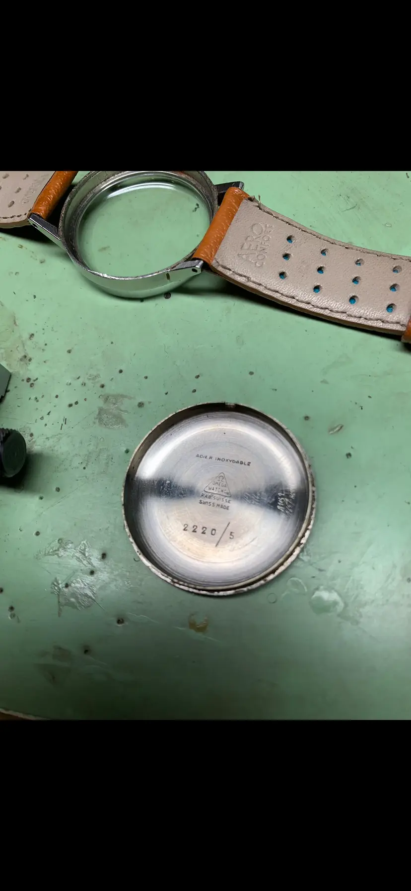

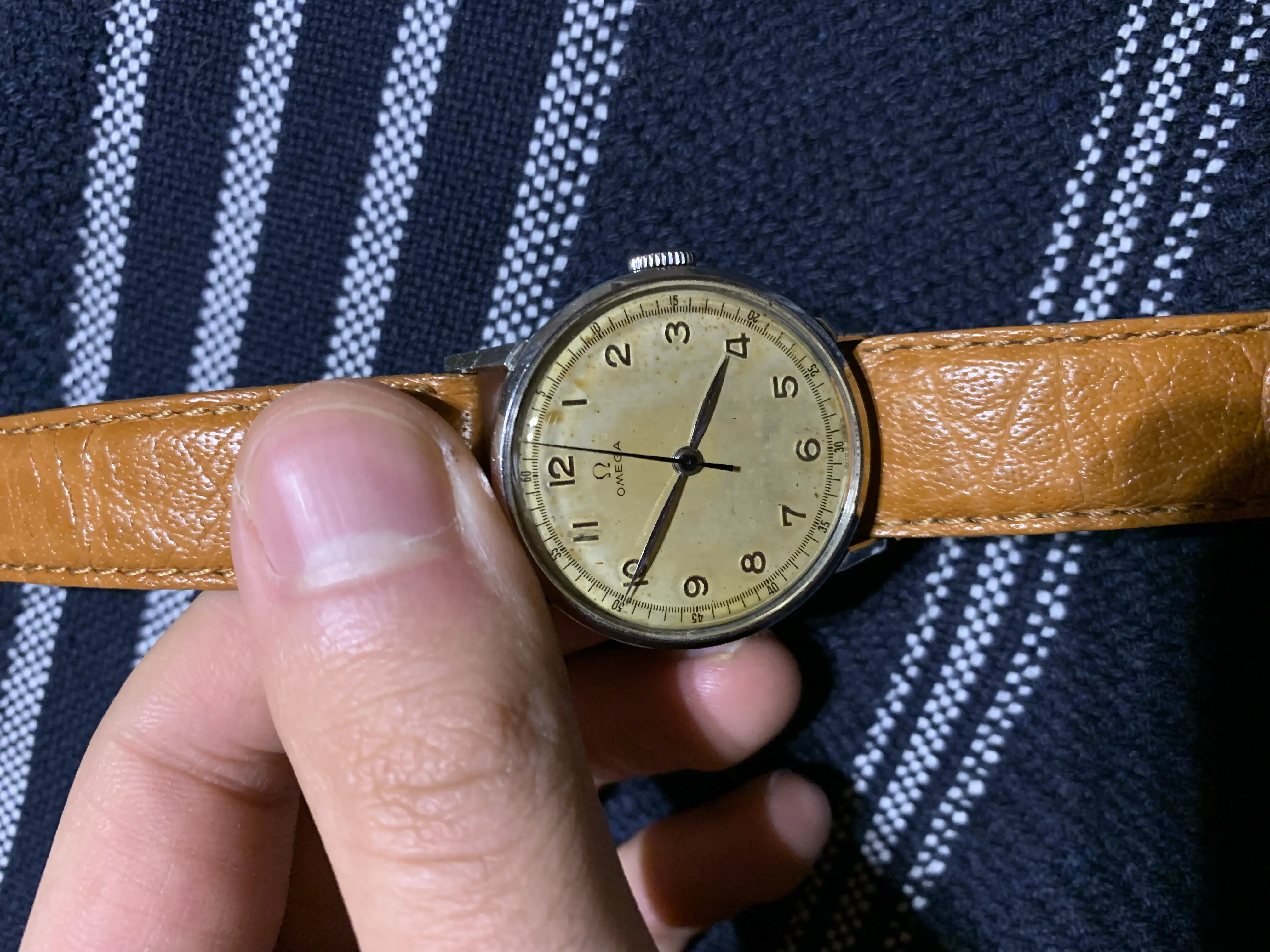

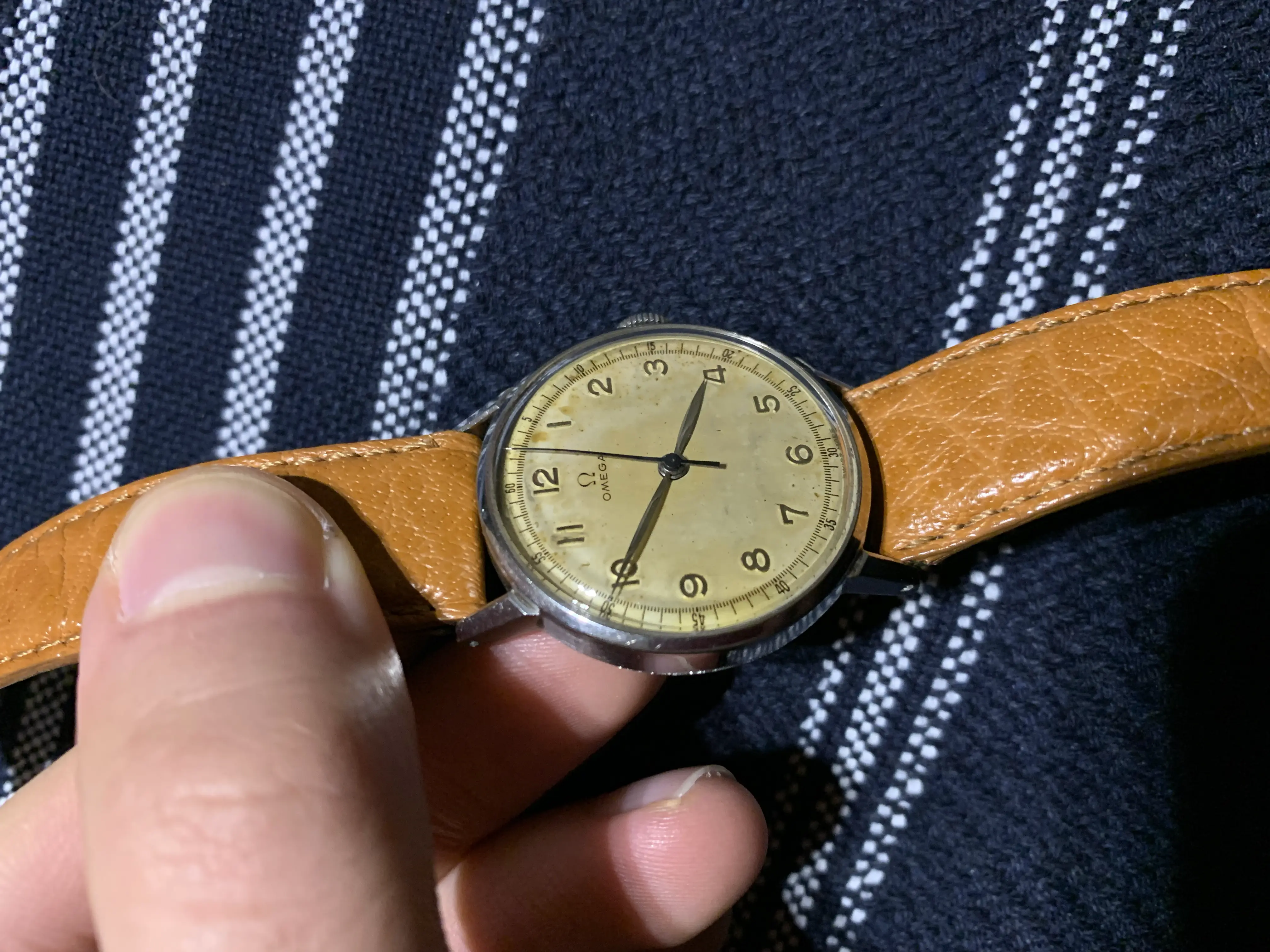

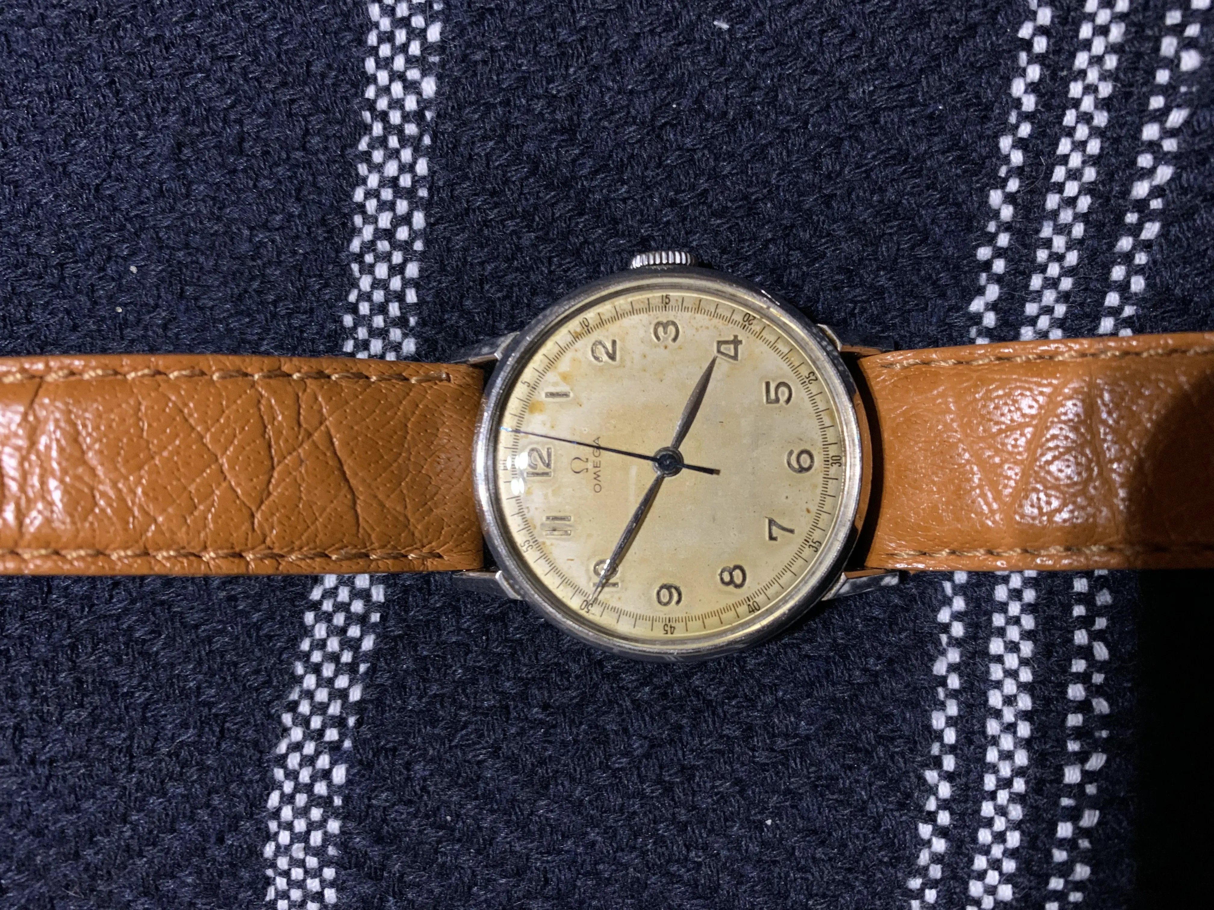

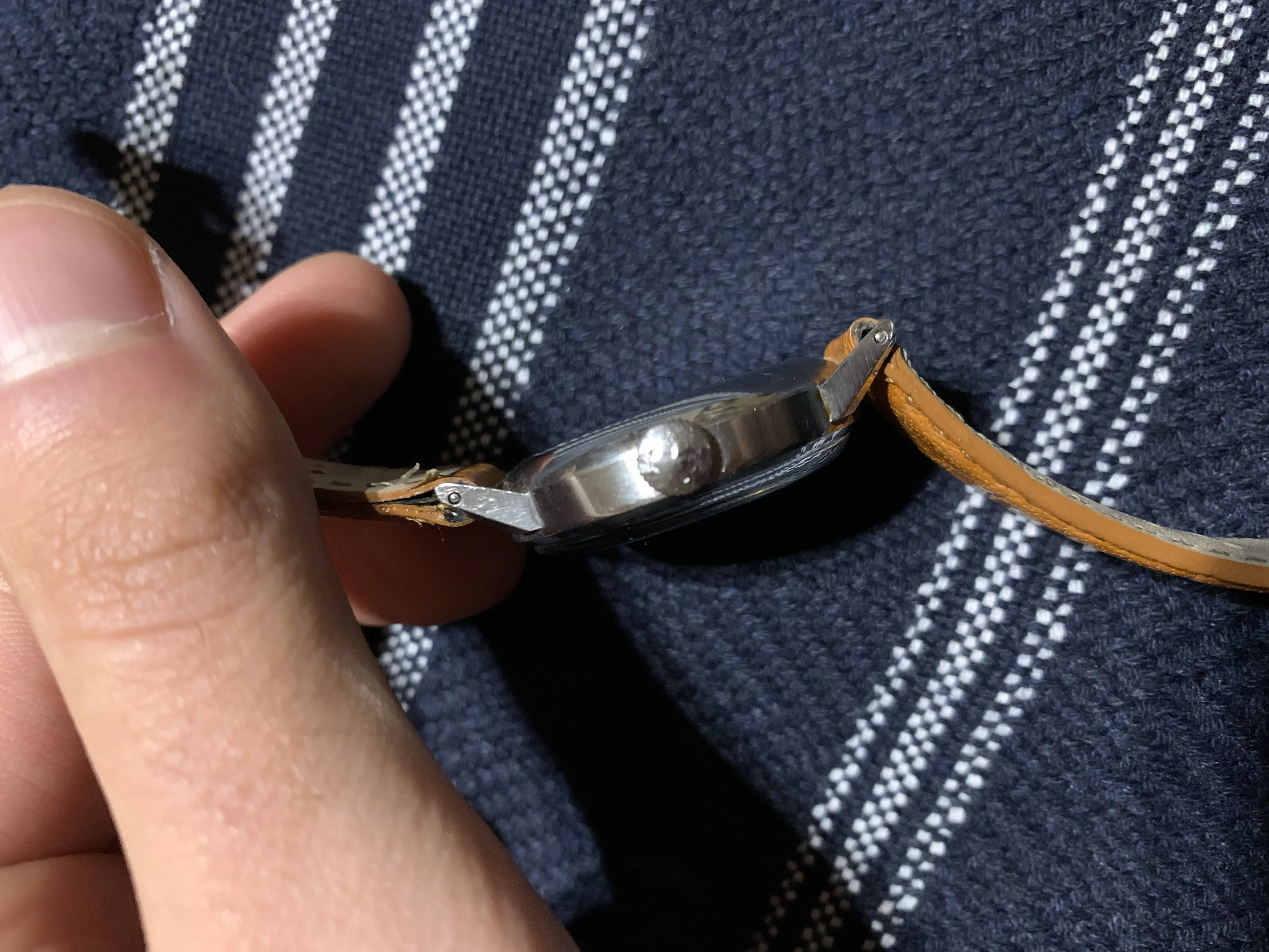

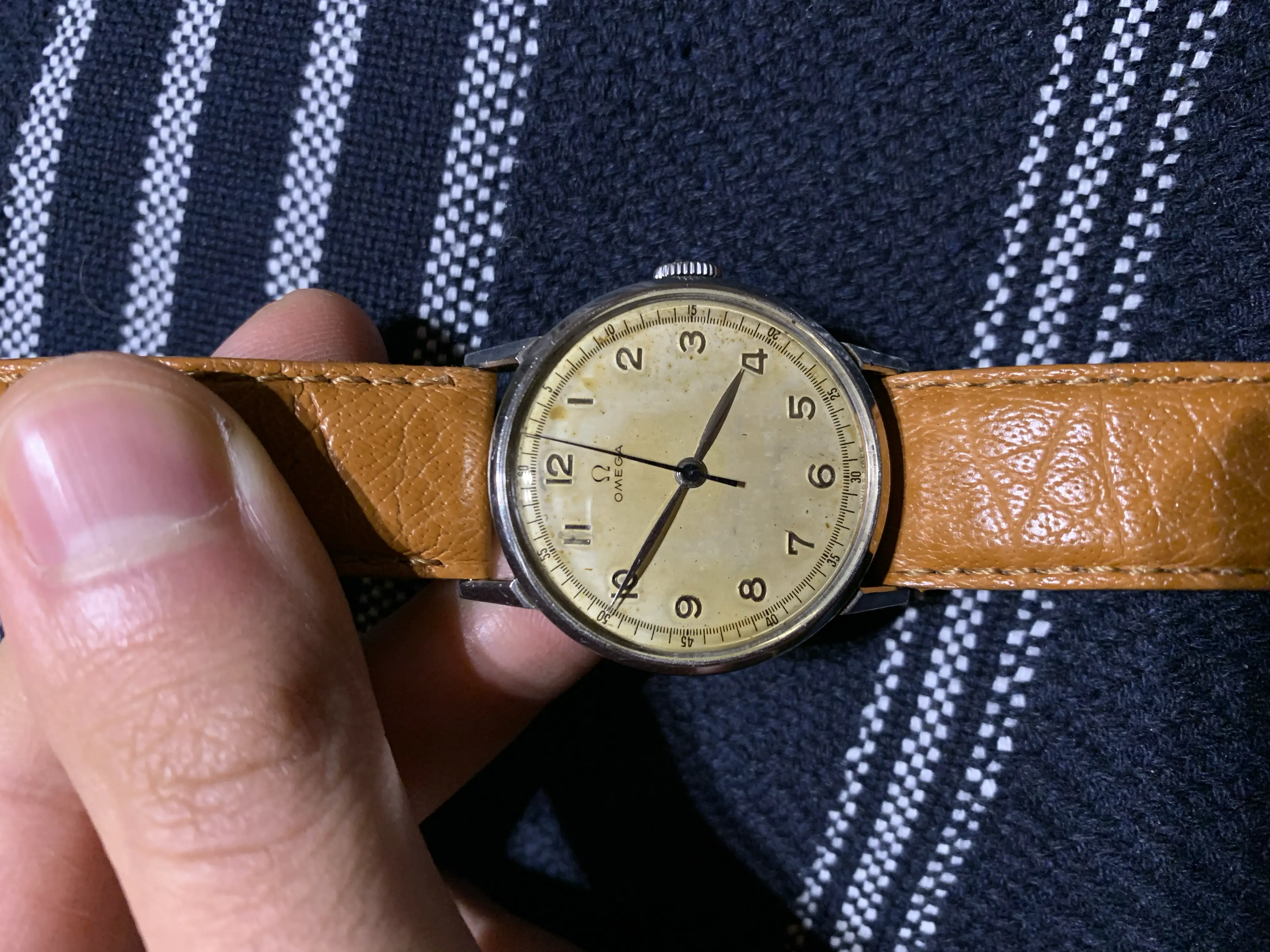

Hi everyone,

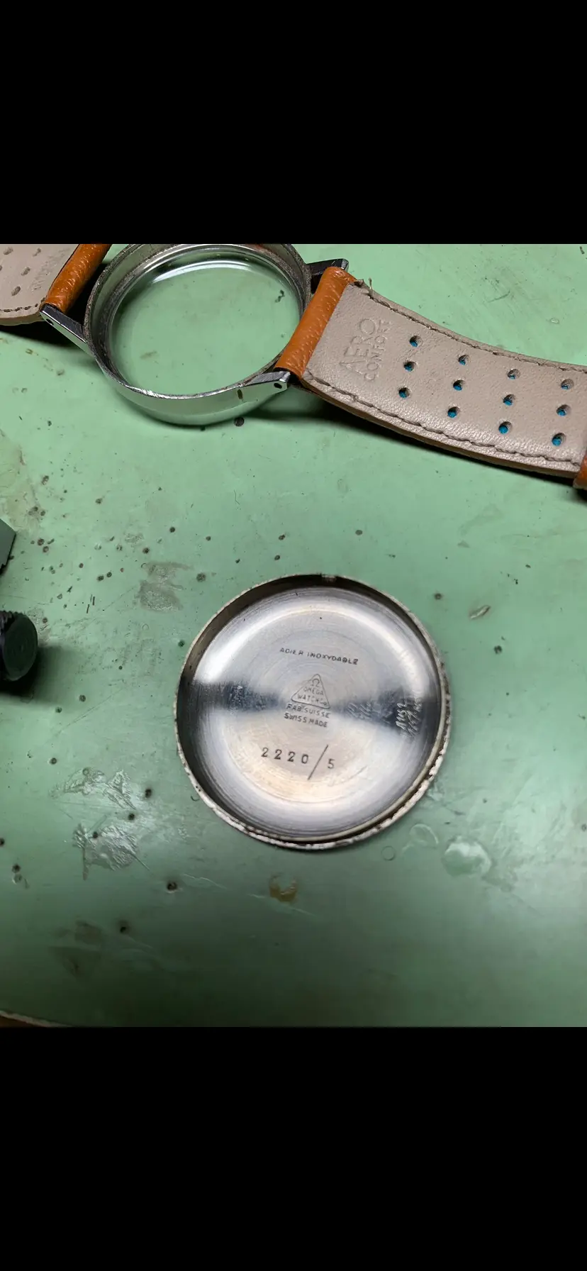

I purchased an Omega Medicus from the 1950s (I believe) in a vintage watch store in Amsterdam back in 2022. Unfortunately, after some time, it stopped winding properly, so I decided to investigate the issue. It turns out the watch has suffered water damage from the previous owner. The reference number seems to be 2220/5.
The repair costs are quite high, and I'm unsure if it's worth it to fix it. Given its current condition, I’m curious about what the watch might be worth as it is, and if it would increase significantly in value after a repair. The watch hasn't been serviced recently, and the shop didn't have information on when it was last serviced either.
This is my first vintage watch, and I don't have much experience with these types of timepieces. I'd really appreciate your advice on what you would do in this situation. What are my options here? Is it worth getting repaired, or should I consider other alternatives?
Thanks in advance for any insights!

Nice watch.
Repair is always part of the vintage stewardship. This is a good basic 30 mm three hander, without any extras. In some ways one of the better watches made. These movements are easy to work on.
I'd love to find more in junked condition myself. Have not seen too many listed as of late, which means people are holding on to them.
As for value this is subjective. Service/repair, really adds nothing to the value. Such is the cost of ownership.

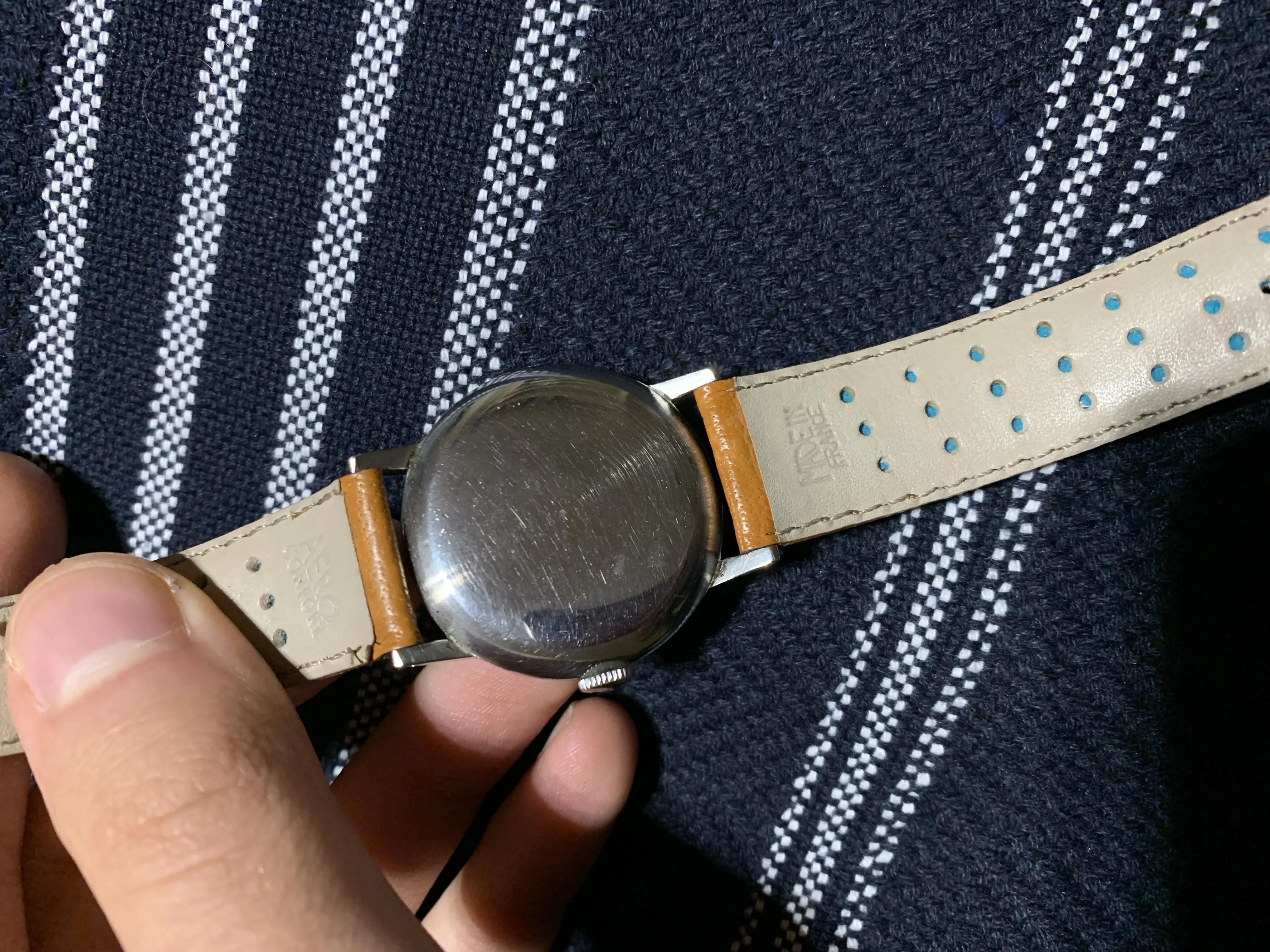

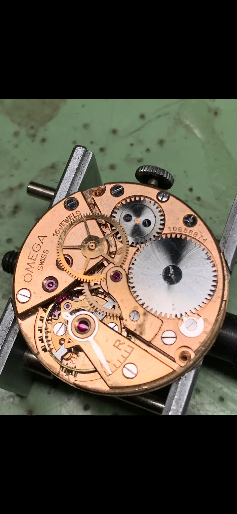

It's not a medicus because it has a cal.30T2SC, not 23.4SC. the serial number dates to around 1946. Both of these things can be found with a quick google search!

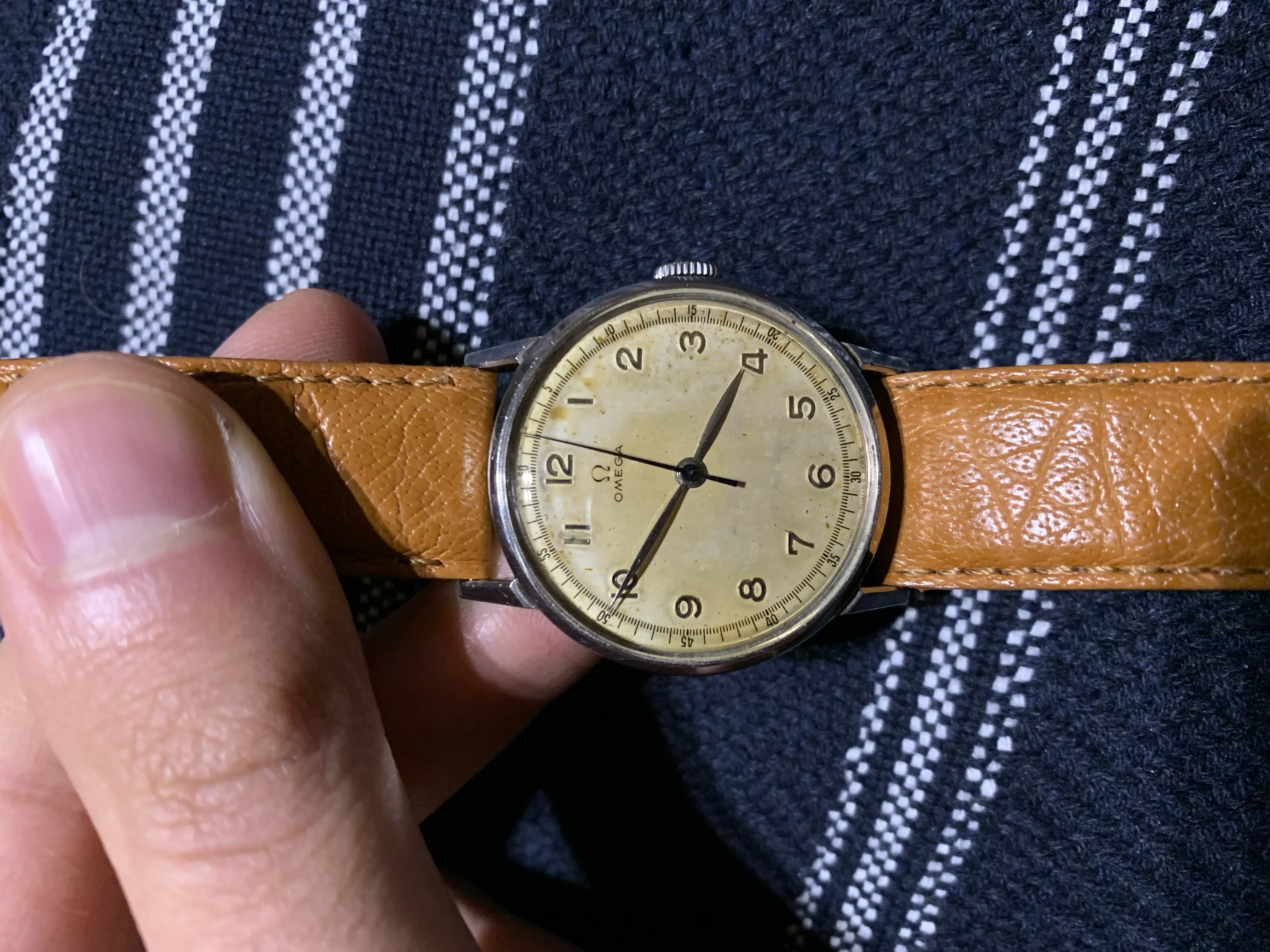

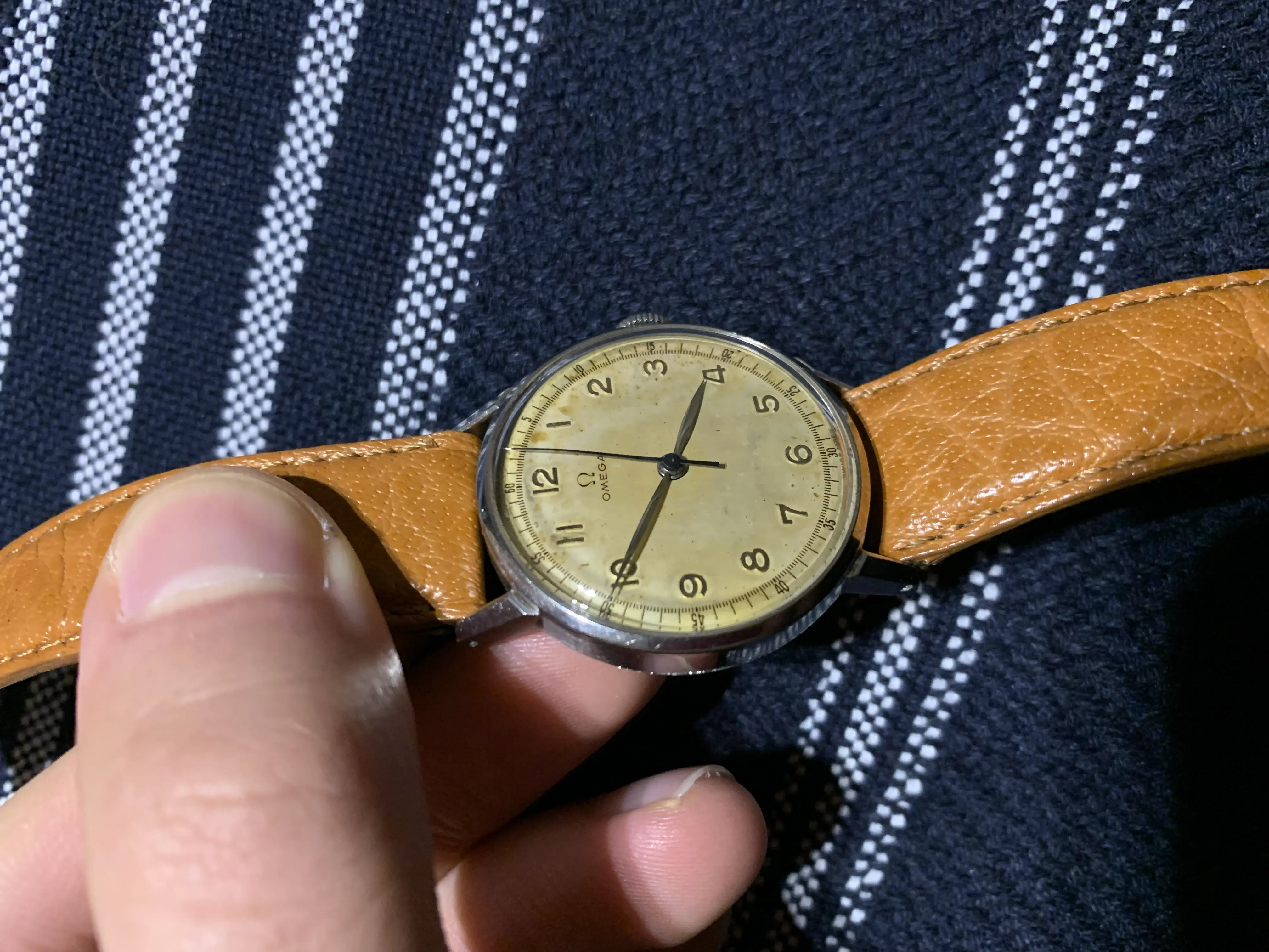

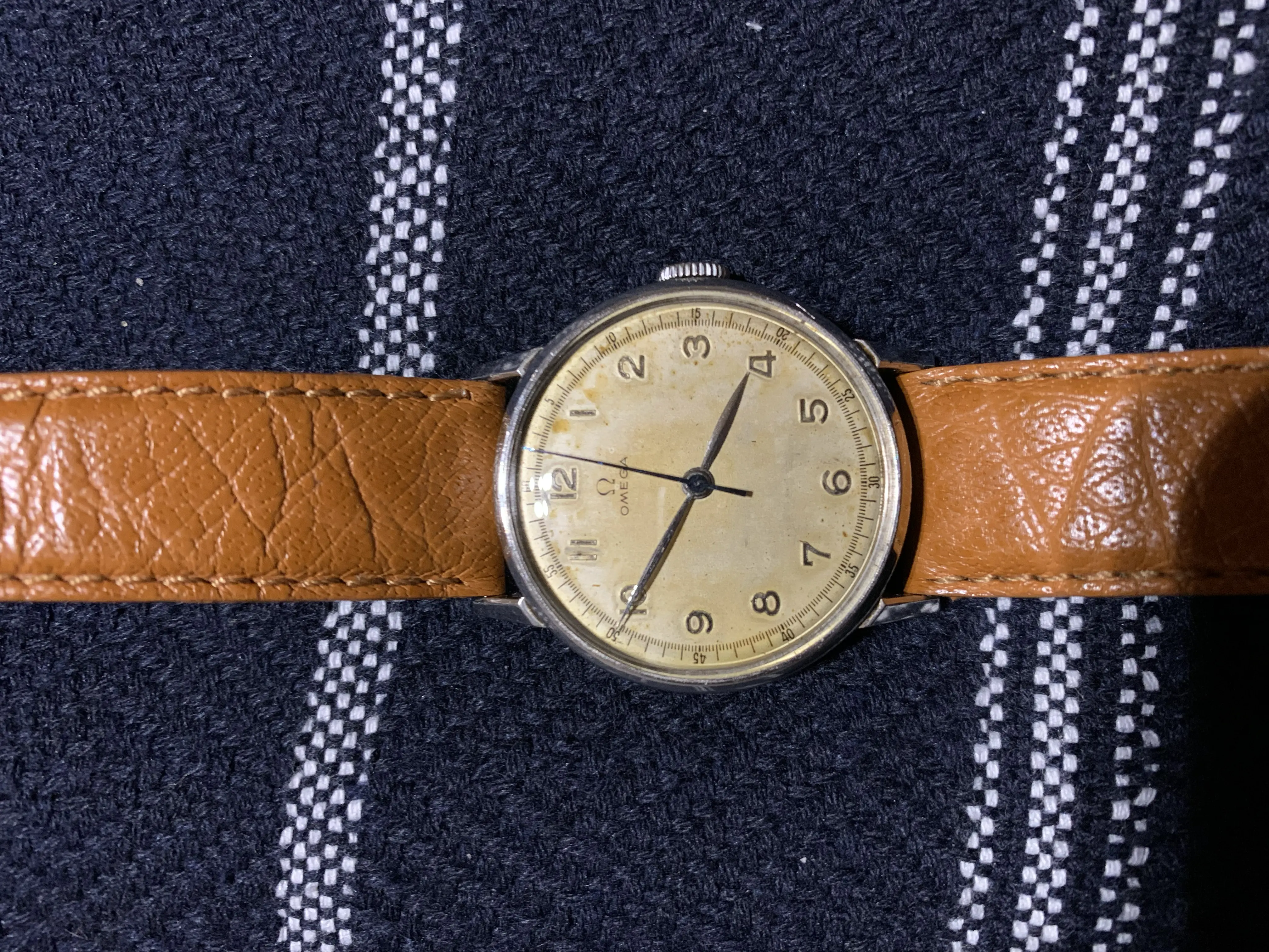

There's a bit of moisture damage on the dial but that's expected for a watch of this age. I don't see much evidence of serious water damage in the mechanism. Without good closeups of the dial, an idea of how much you have in the watch and how much you've been quoted for repairs, I can't give any advice on whether the watch is worth fixing.
All I can say is to shop around at different watchmakers to see if prices vary.

I'm not clear what "stopped winding properly" means. Given the age of the watch, it could be something as simple as a broken mainspring; they do wear out eventually. My watchmaker routinely replaces the mainspring as part of a basic service, so it's not something expensive to replace. The movement looks to be in pretty good condition to me, though, of course, we can't see the keyless works that could also be implicated in winding problems. I don't really see any major water damage. There could always be additional problems lurking beneath, but I would think around $300 USD would be sufficient to restore the watch to fine running condition.
As for whether or not to keep it, I'd ask you if you enjoyed wearing the watch. If so, and if you can afford the cost of a service, then I would advise you to have it serviced so it can be enjoyable again. If you didn't really get much pleasure from the watch, then you're better off selling it without a service. You would be unlikely to recoup the cost of a service in the sale.
