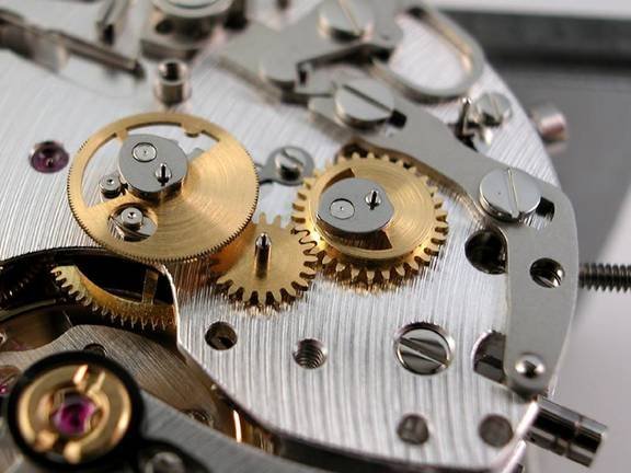

The gear that carries the chronograph minute counter is indexed every minute as the spring loaded jumper that indexes the gear, clicks over a tooth. It happens only once a minute, and if you are able to hear it, it is indeed a surprise to me!
Thanks for this, I think I understand, and this happens without the chronograph running? I was under the impression that this would be isolated generally - again, no expert, just trying to understand your comments.

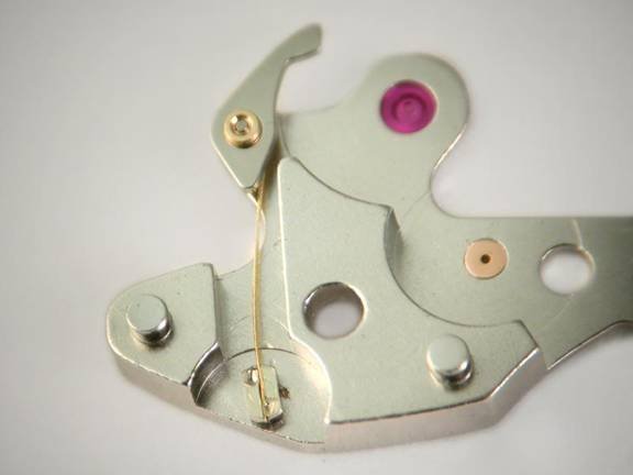

So I take it it's the right-handmost wheel (with cam) on this pic, shown without the spring loaded jumper.
And the underside of the bridge showing this spring and jumper?
If so, that spring looks like it would be low tension and the snap I hear sounds more akin to a higher tension spring, more akin to a yoke spring or something - please take this with a huge pinch of salt...
i just thought I'd try to hear it and it happened about 15 seconds past 0 (running seconds) and didn't happen again in well over 2 minutes, again it seems more common when placed dial up.
Yes, that's what he's talking about, but it's not the source of your sound. That spring only "clicks" when the chronograph is running, and then only once per minute.

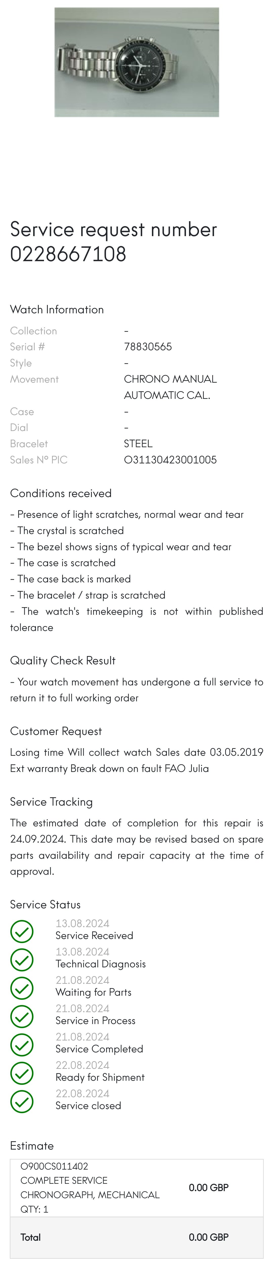

So a bit of an update on this, the watch recovered slightly and then started losing about 20 sec a day, whilst I steeled myself for the £850 service costs, I happened into the OB at the Metro Centre in Gateshead, on chatting to the charming Phoebe. She said it would likely be covered under warranty.
As it was bought online, the card turned up undtanped and undated, but luckily I keep the sales receipt for it in the box... and wouldn't you know it, the warranty expired 5 weeks earlier... 🤦
Phoebe let me know that there is a slight leeway on warranty, typically 6 months and to call Omega SC, which handily is about 5mi from my home. A call into them and they confirmed, they would cover it under warranty, and best bit, I could take it in myself!
So I dropped it off and spoke with a very helpful associate, who advised lead-in for service work was 12 weeks, and warranty 6 weeks. They also told me that their service centre is moving to a purpose-built facility and likely to open next year, and it's likely they will allow visitors... so I out my name down for that!
Anyway, surprise, surprise after just over 2 weeks, I was advised by their CIS system that my watch was repaired and ready for collection, apparently having received a full service....a quick call confirmed and and I was off to collect.
The watch was received cleaned, albeit unpolished (as this is not warrantable work) in their nice new service case. I had asked them to advise the issue, and the response was low amplitude, likely to lubricants drying up, unsure how likely on a 5year old watch, and being a warranty case, there were no parts received back, a tad concerning how quick the process took, but can't complain for the saving made!
It's keeping good time, possibly gaining a bit on the wrist, and doesn't make the clicking sound any more, at least as far as I can ascertain!
