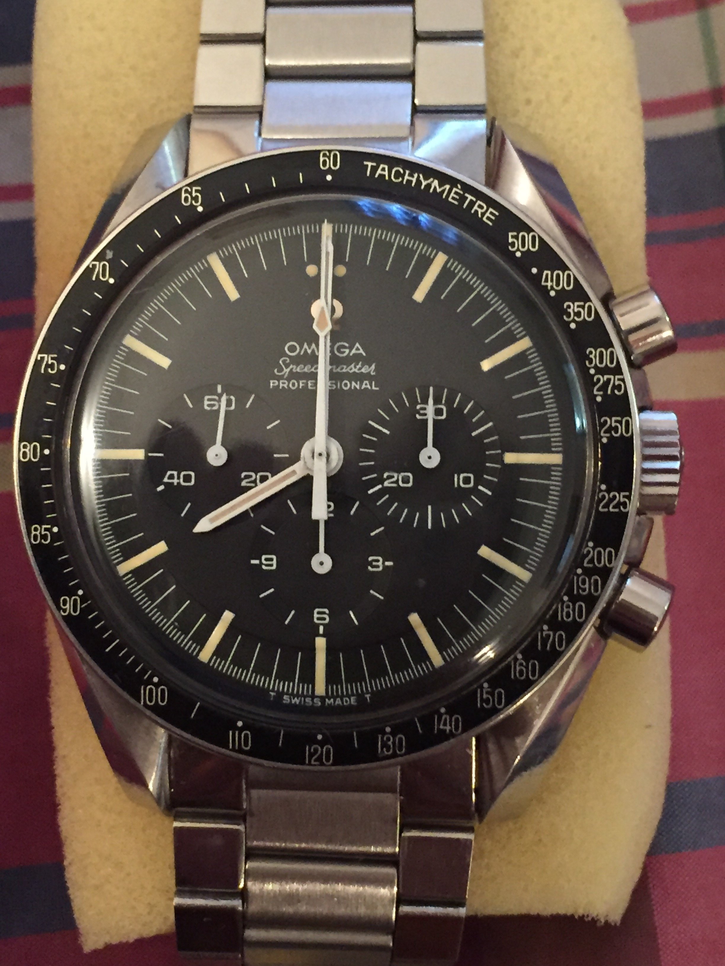

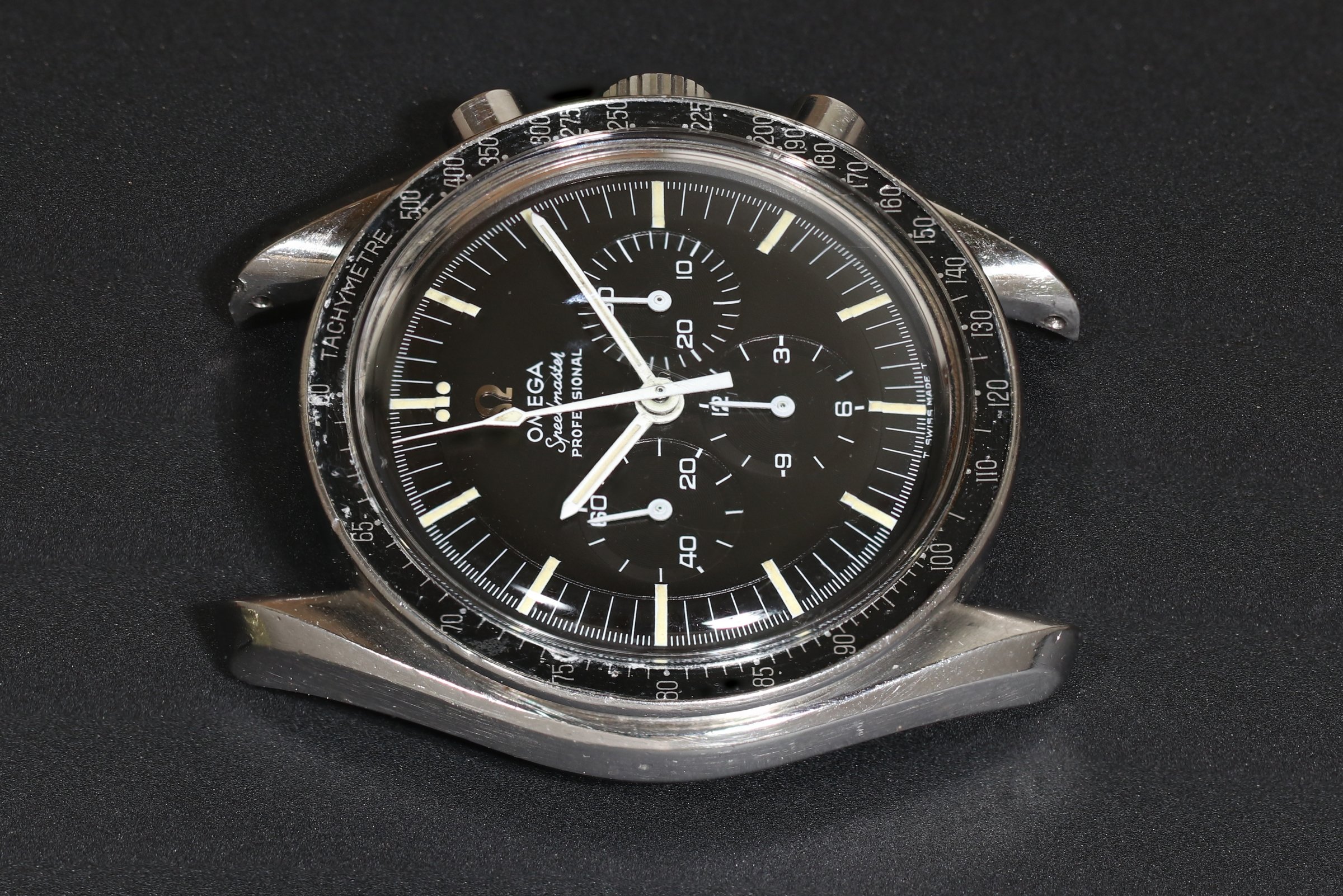

The first step is to identify it.
Dial is long indices, Applied Metal Logo and stepped.
Pushers are standard size
Asymmetric case.
So we can see if it is original specification it is a 145.012 or a Transitional 145.022-68....
We can see its a Transitional.

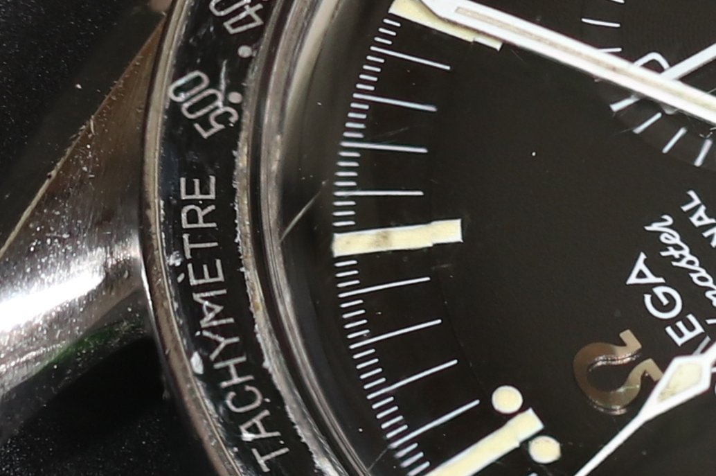

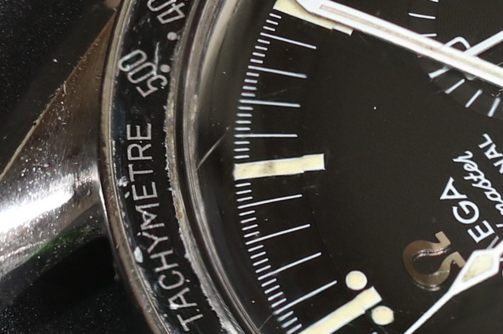

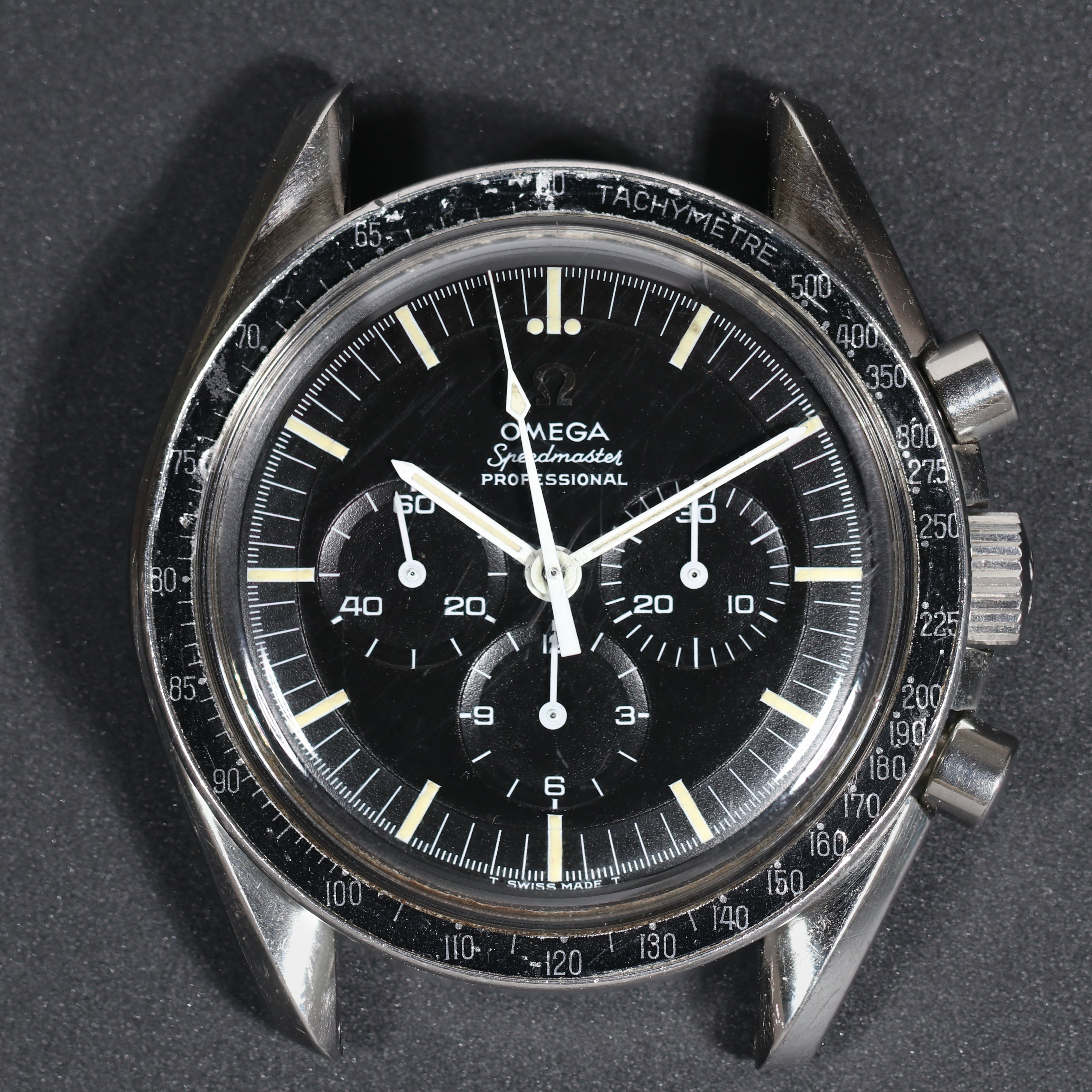

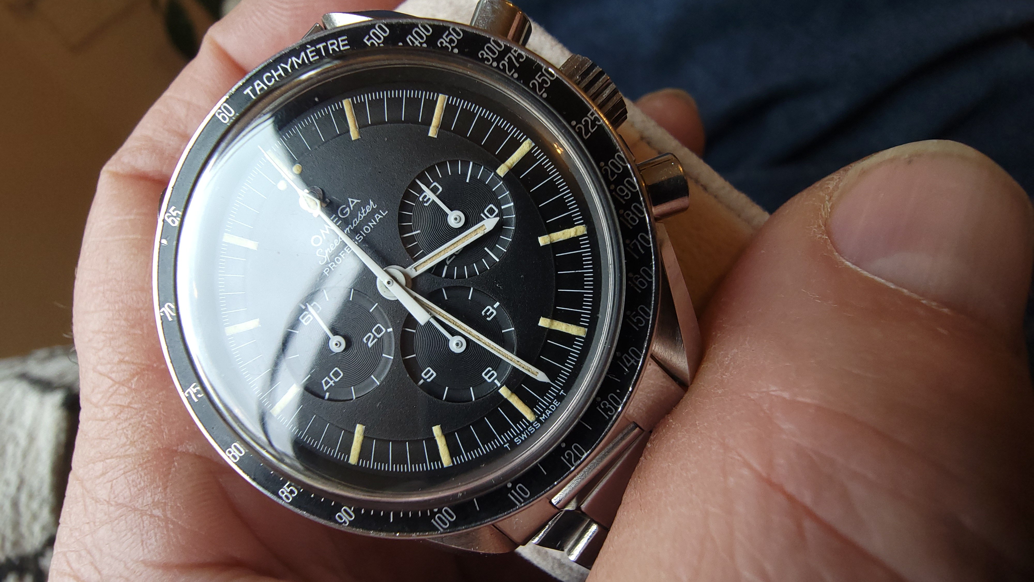

The interesting thing about this watch is that it photographs better than it is in real life.
The bezel looks better in this photo than in real life. There is a dent at 75/80 but that isn't the issue, its the general decay that looks more of a snowstorm than it does here in the photo.

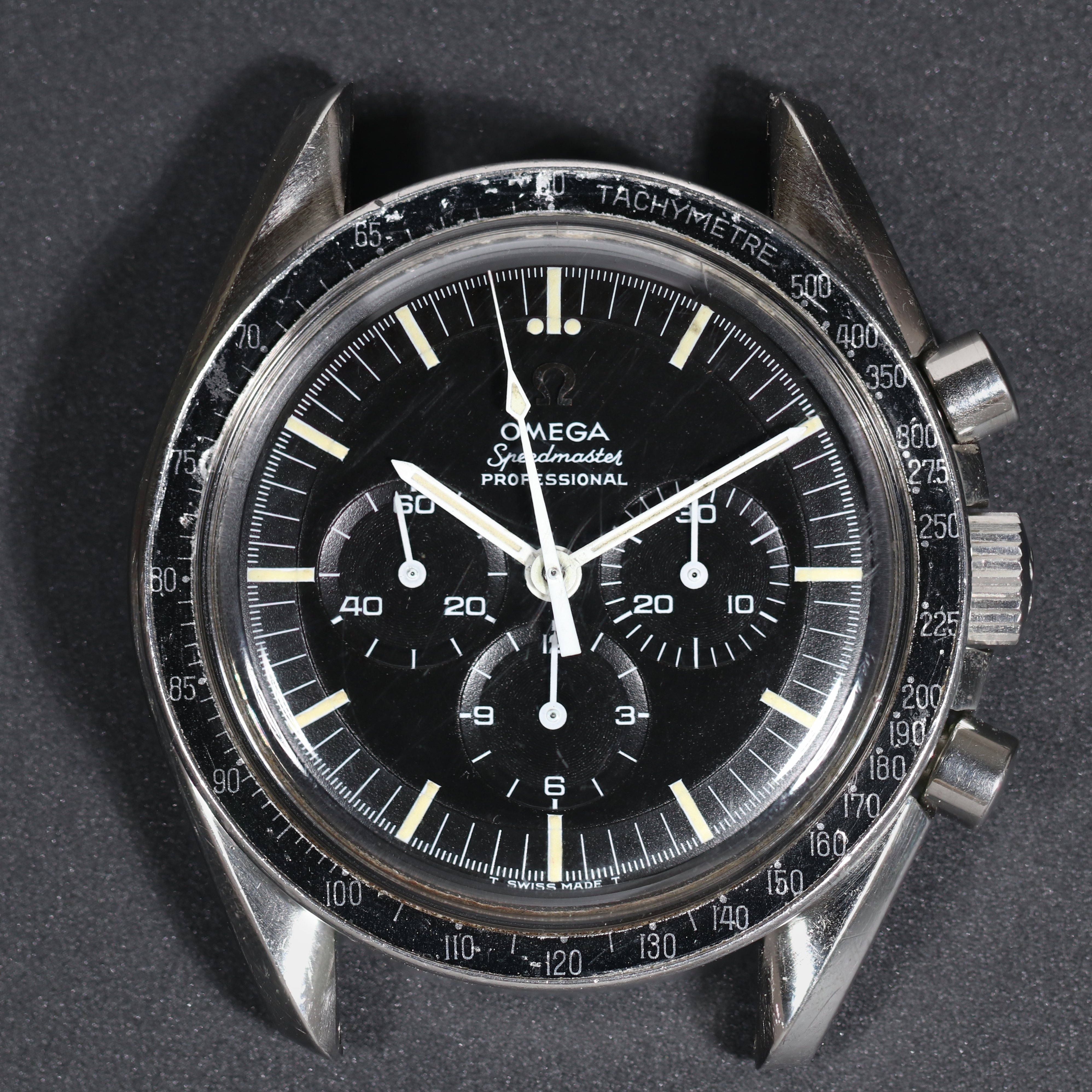

The dial, however is fabulous - except for one issue. There is a dark mark on the once o'clock marker, and that is the only thing i can find to fault it. By my grading, that stops it being an "Excellent" dial, but it is a "Very Good+"
Here we can see the dial, which is flawless, except for the marker. Any other marks you might see are on the (original Vintage) crystal:

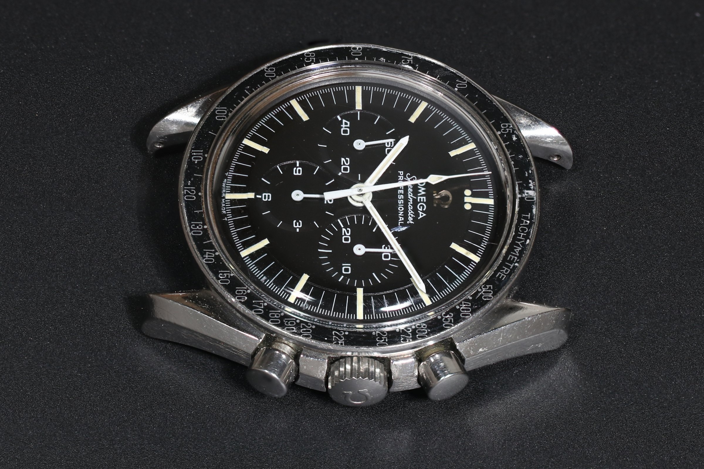

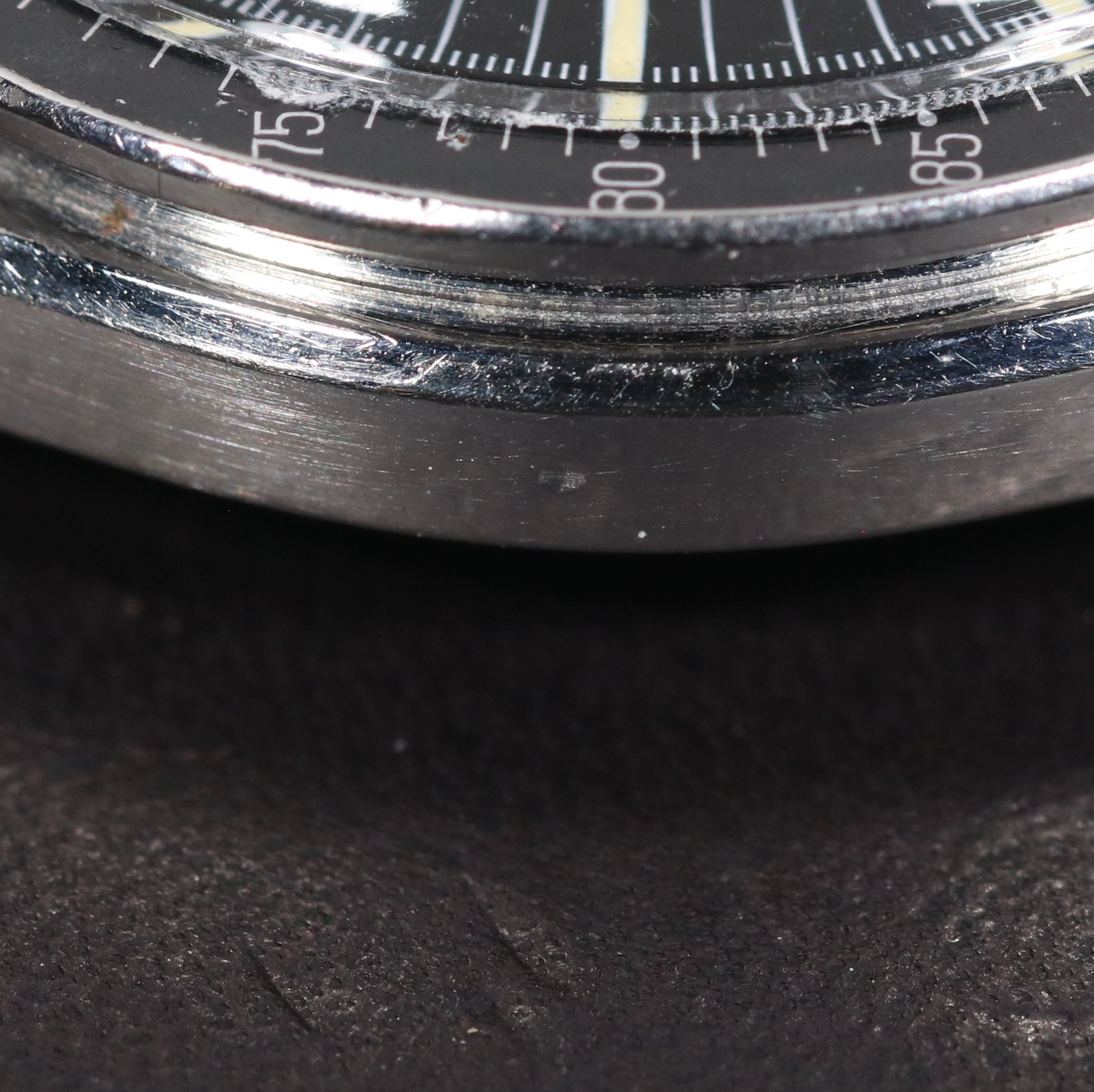

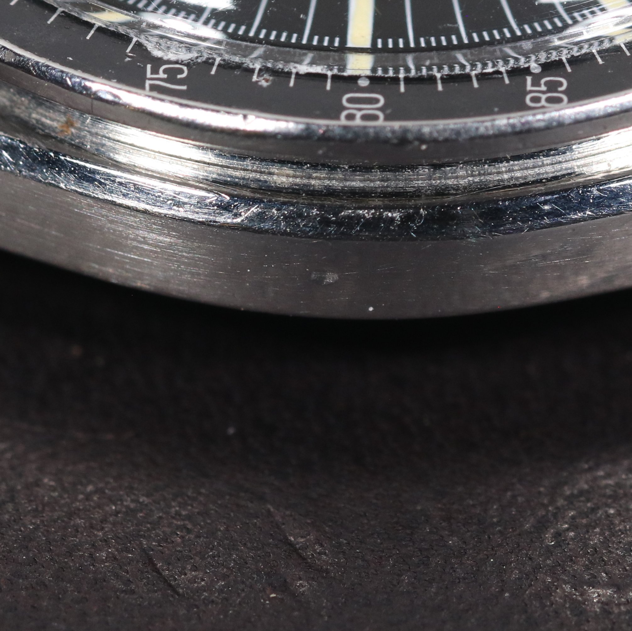

The next issue on this watch is the case. It has been polished, so that the outlines are no longer stock.
Subsequently it has acquired some damage, one of which is unsightly and irreparable. A sharp ding right in the middle of the case band:
That little ding is deep - too deep to polish out and lasering would require an entire case refinish. So its here to stay.
The photo below clearly shows the loss of definition along the lugs, from the previous polish. As I mentioned, this doesn't look as bad in photos as it does in real life. This is the first time I have had this where a watch doesn't look as good in real life, at least where no deception is intended.

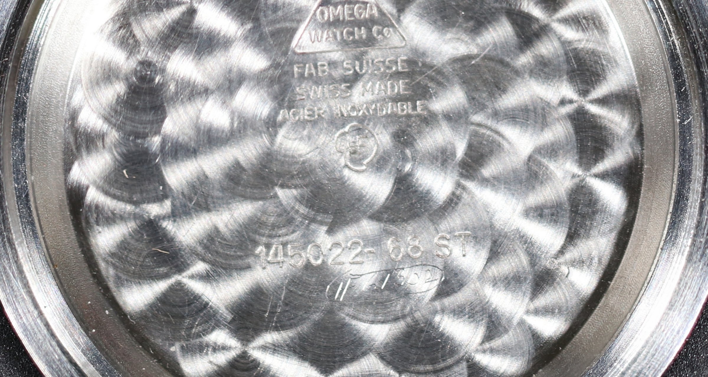

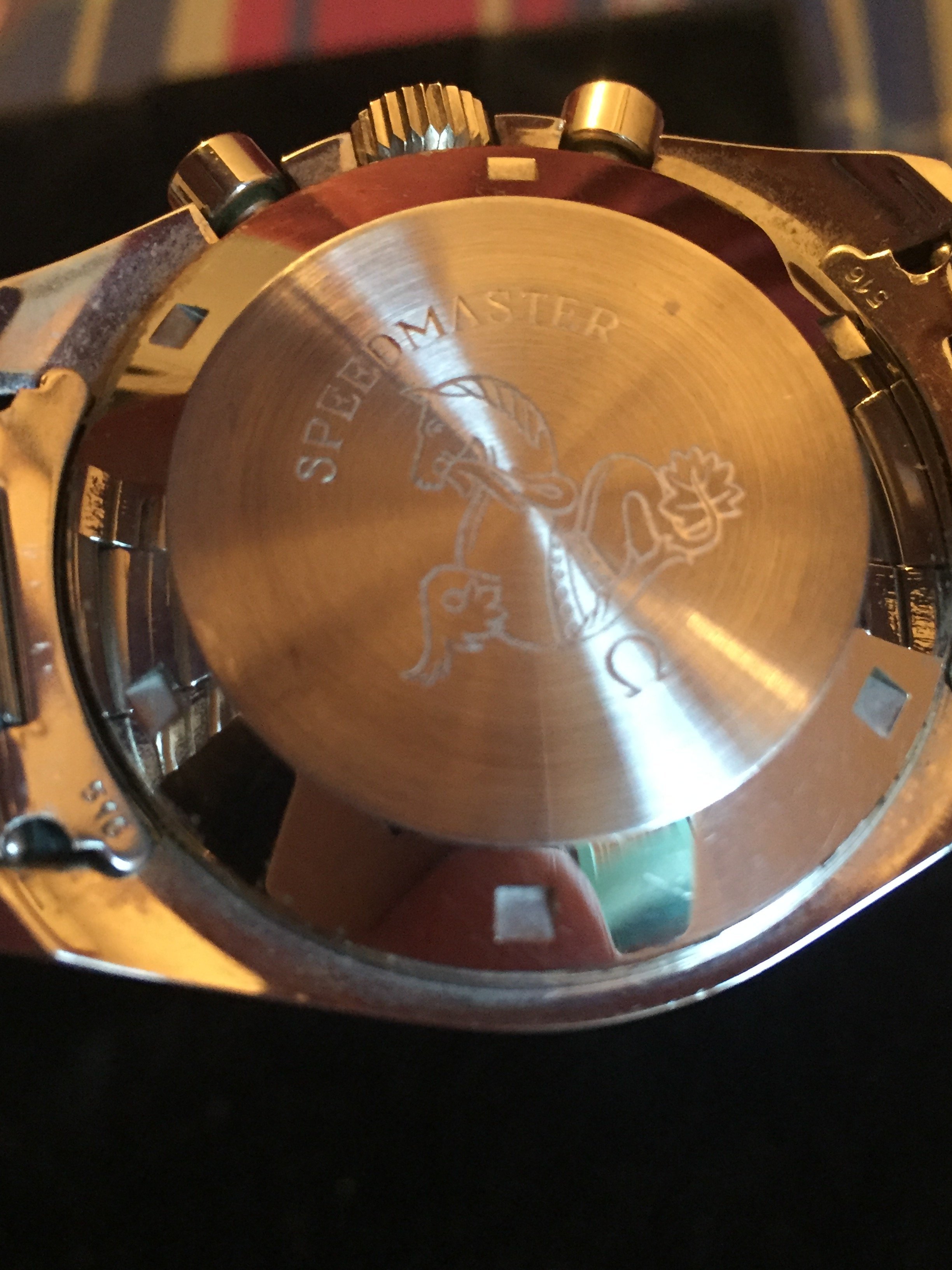

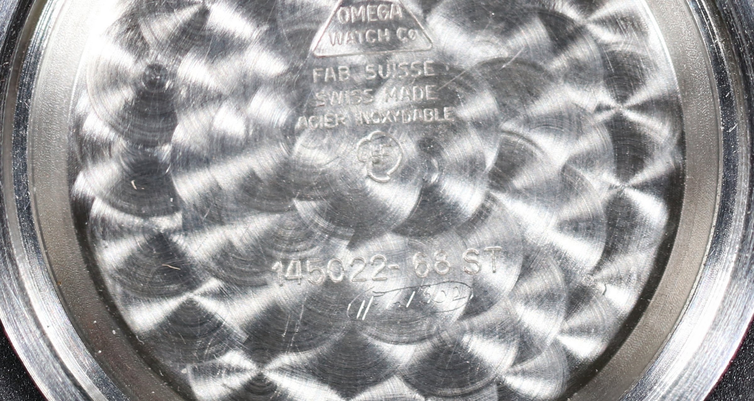

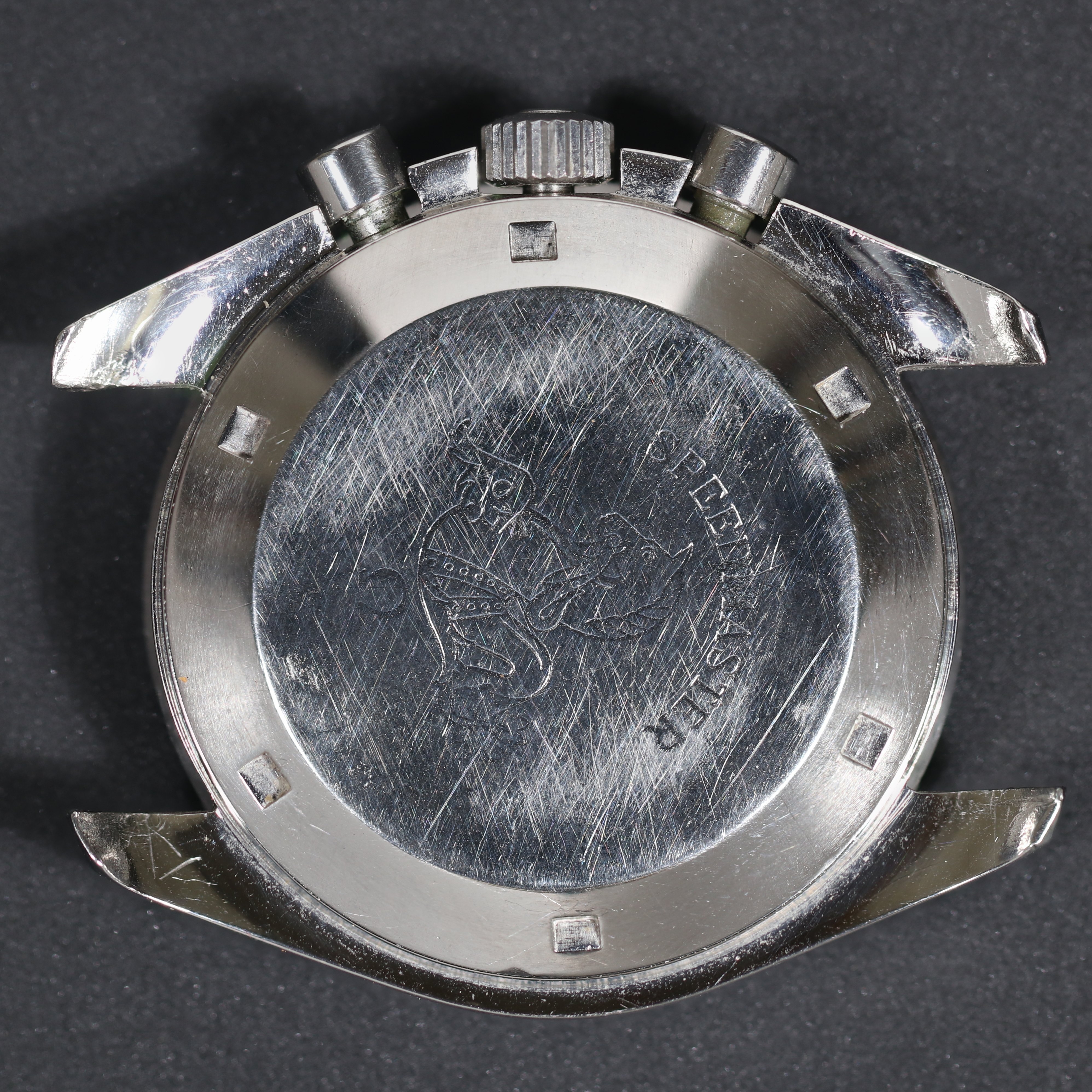

If we flip it over we see the case back has some cross hatching polish - why? Sometimes I see this when an engraving has been removed, but this doesn't look deep, and I cant see any vestiges of engraving - perhaps just carelessness.

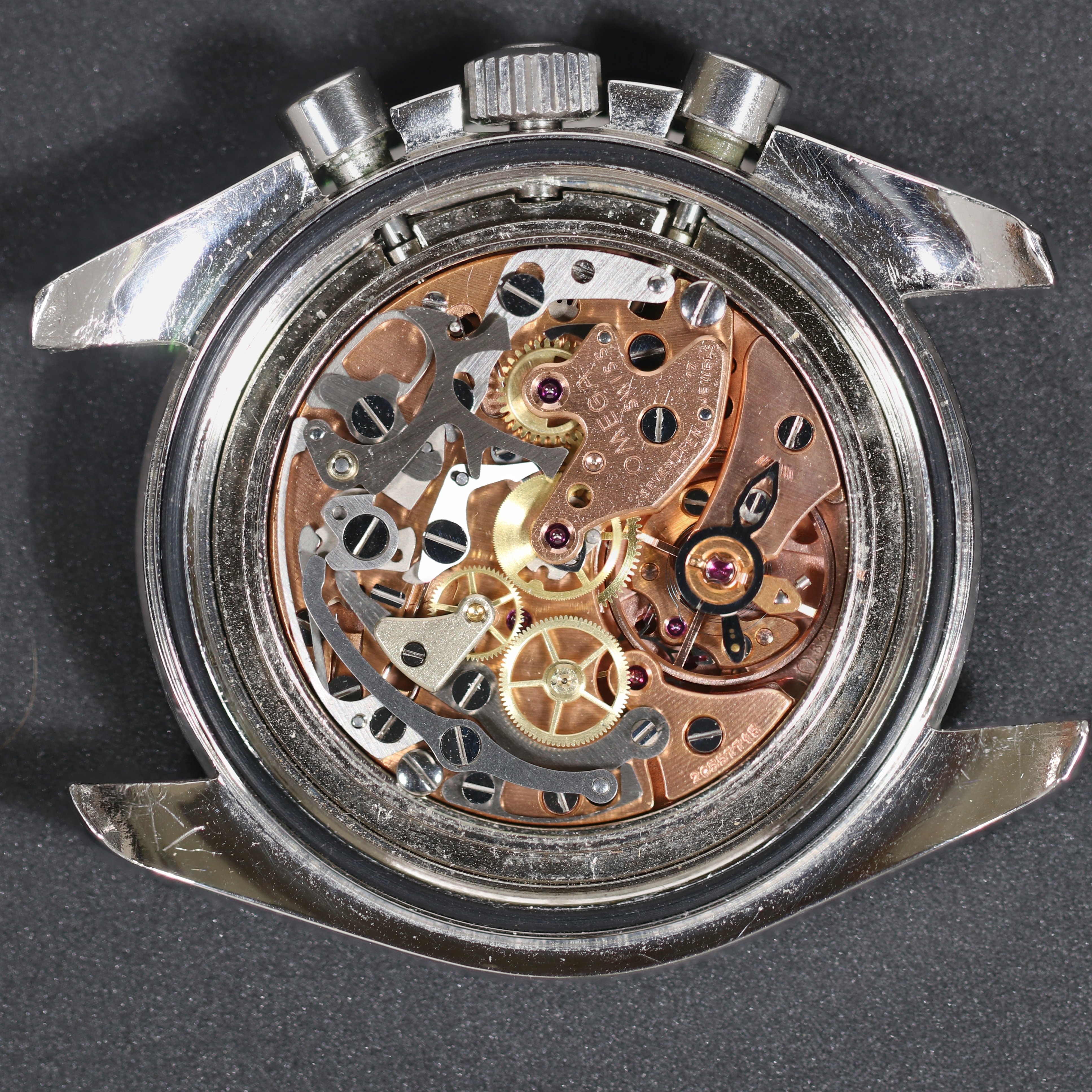

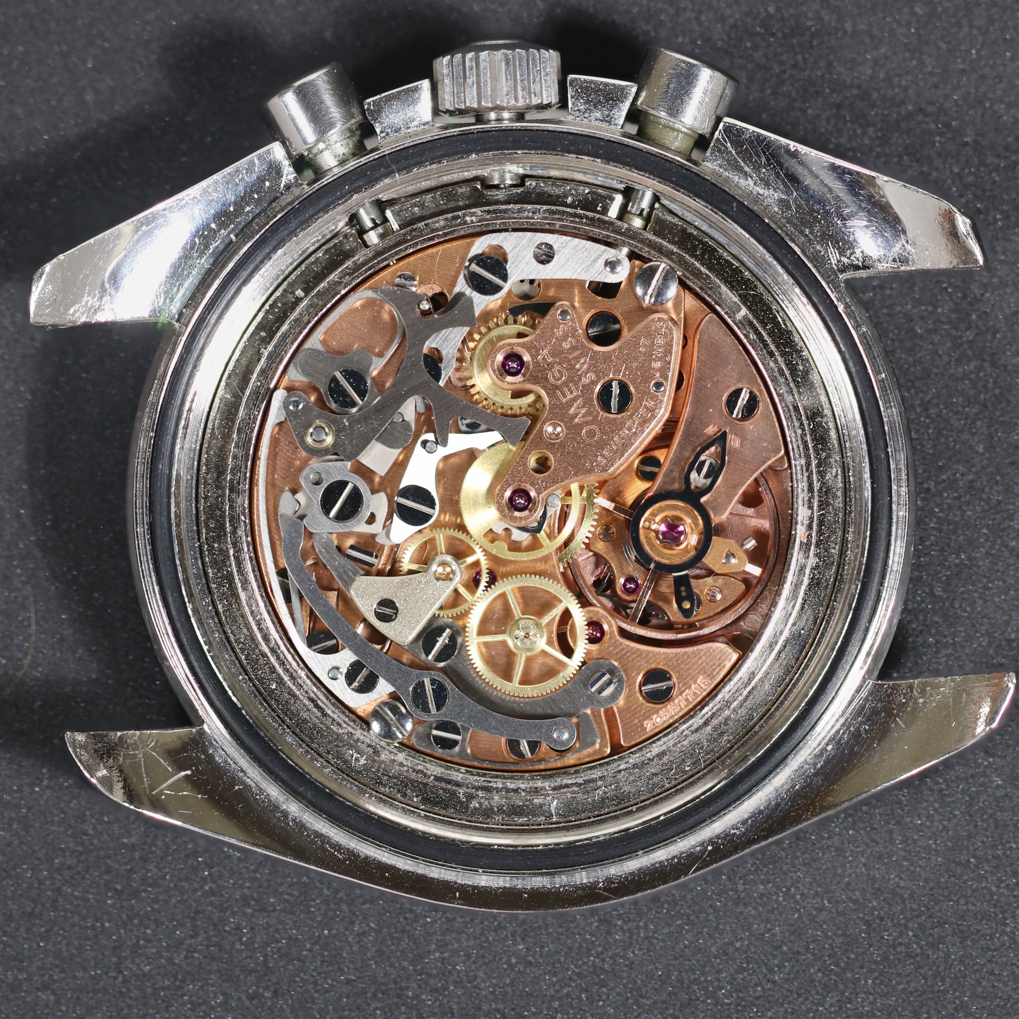

The movement is ok - its not excellent, as we see several screw heads damaged.
While we are looking at the above photo, we can see the crown looks a bit off to me, and may not be correct - I will replace it with the correct crown, and one of the pushers is dirty and the other clean - I would rather have two matching pushers, so that's on the list.

Polish the case back. We have to be super-careful not to lose the definition of the hippocampus or the circumference of the flat.

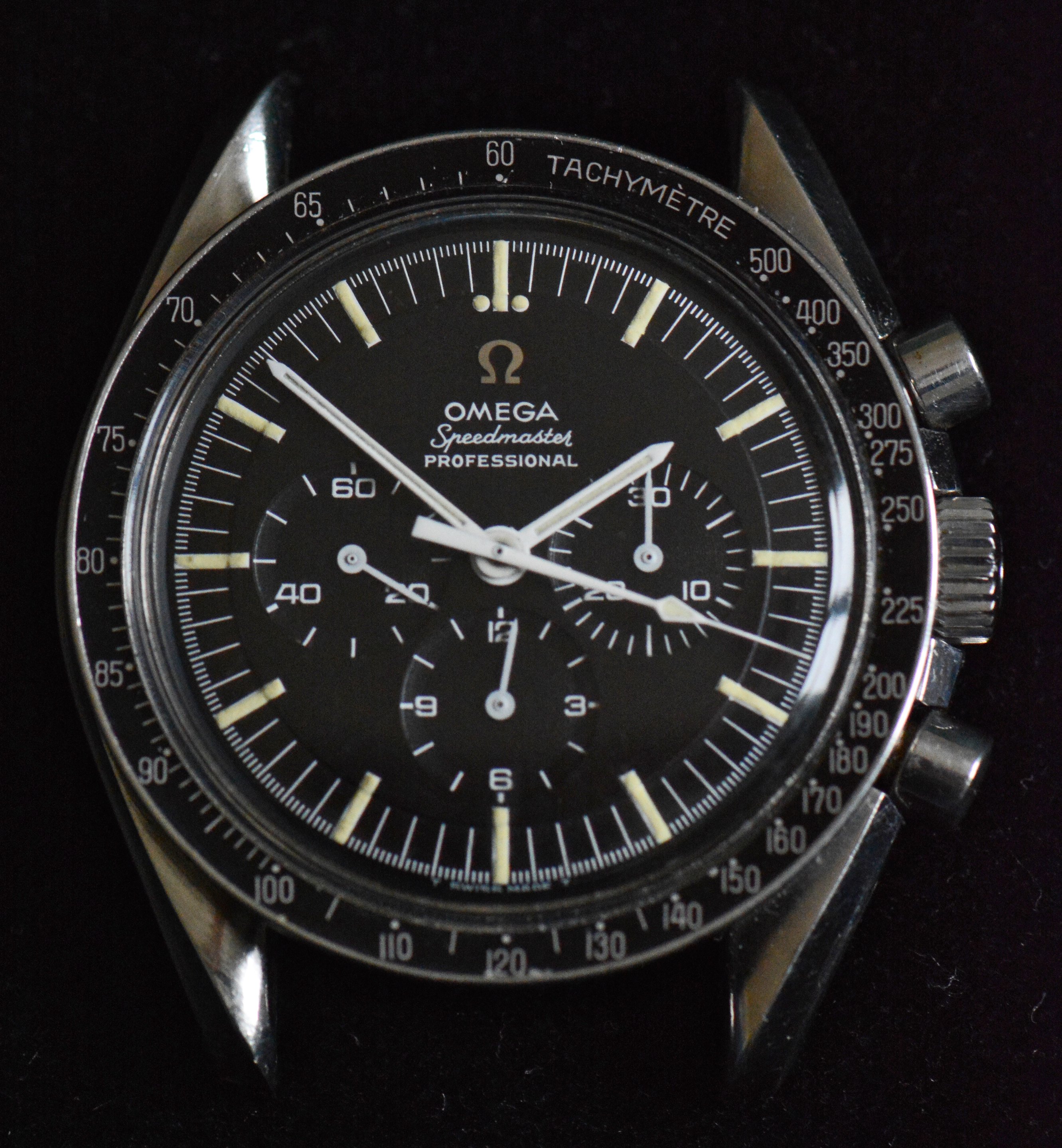

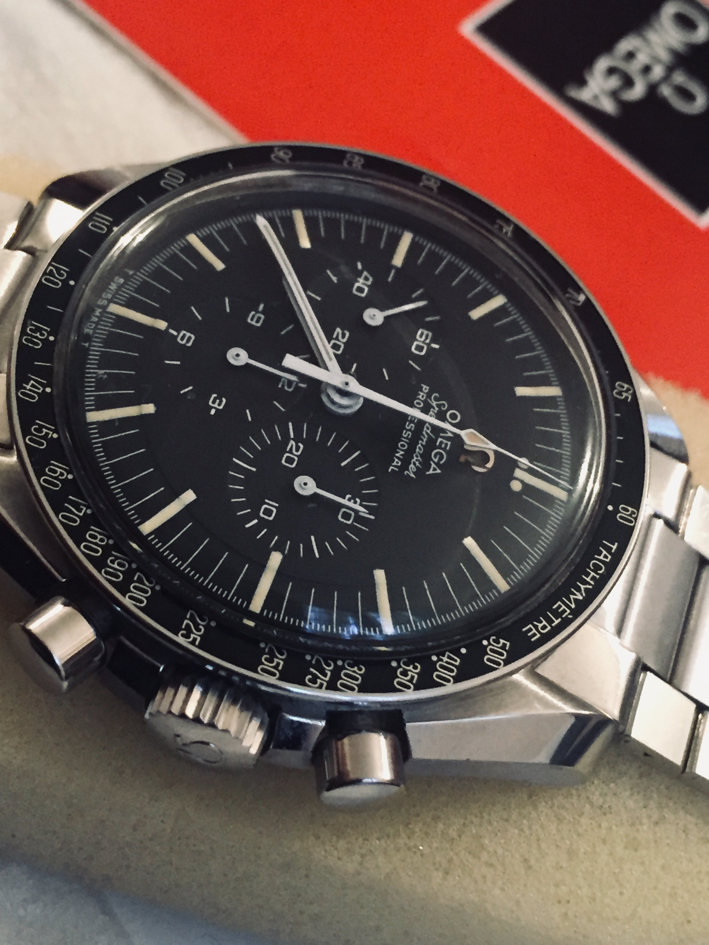

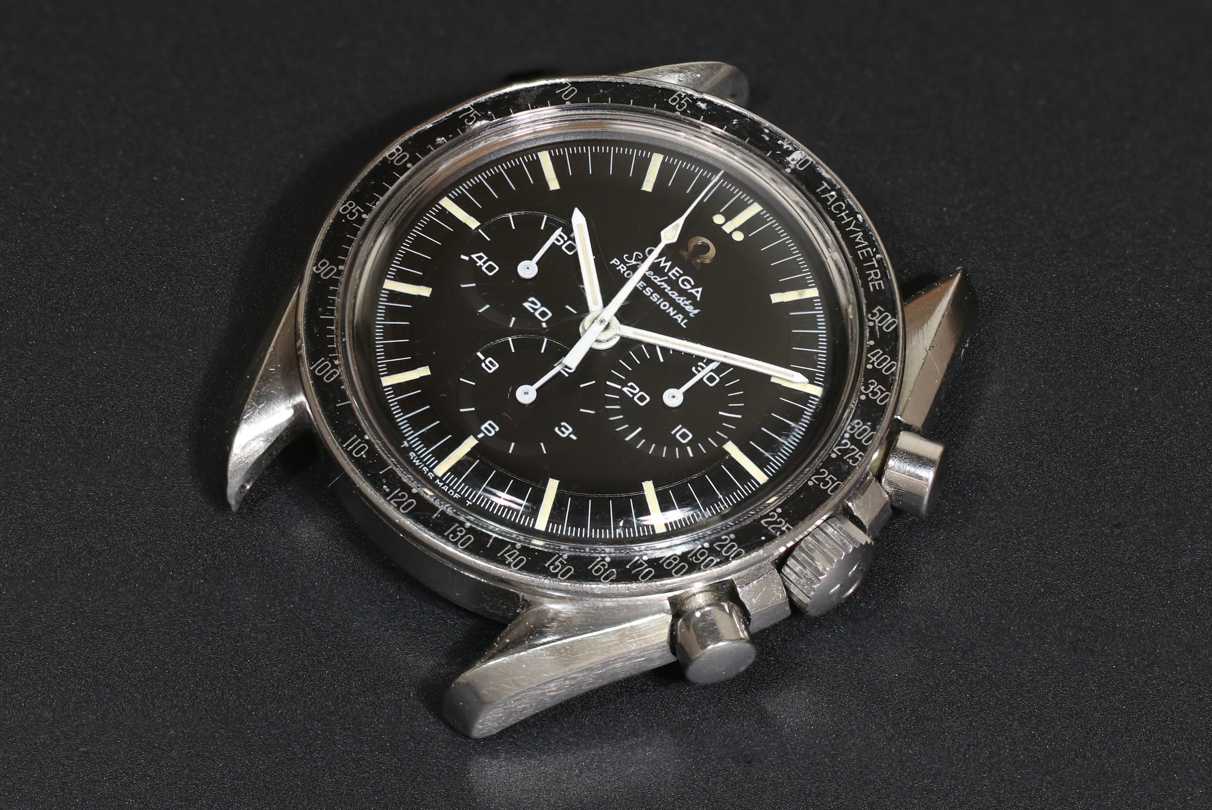

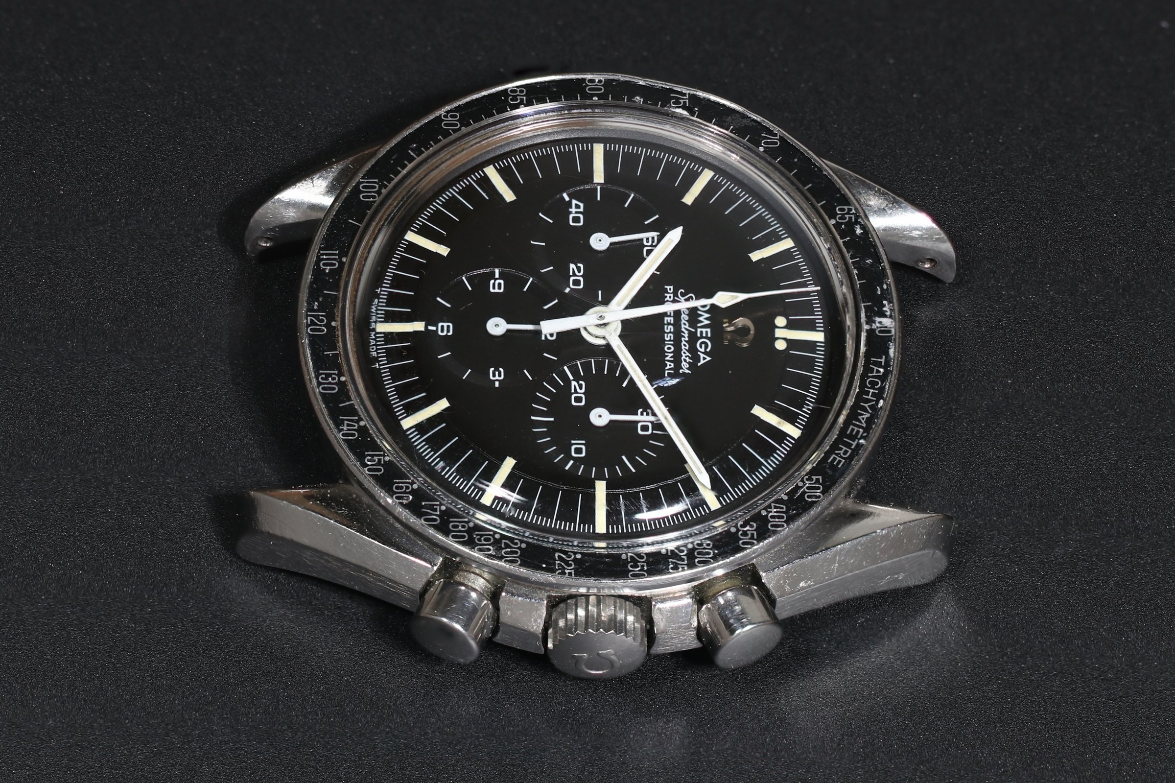

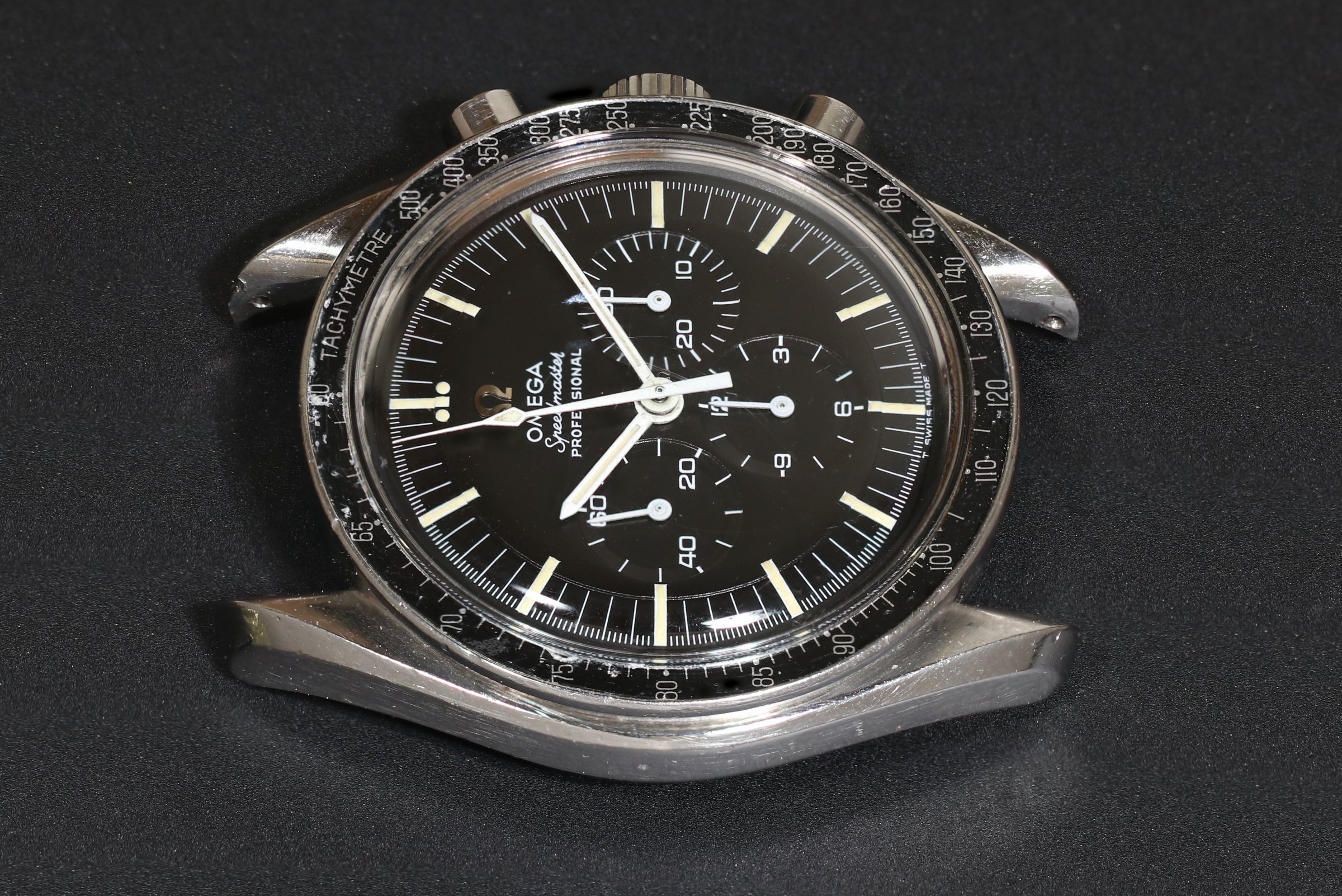

For comparisons here is one sold recently for comparison on OF for CHF7500
Everything about this one is better I think - maybe the dial on mine is more attractive to me, but an infinitesimal and arbitrary judgement.
Certainly I can safely say the value is much higher, with the bezel being so much better and the case being clean.
Which is what this hobby is all about. I must say this one deservedly sold quickly - with the right combination of attraction price and condition.

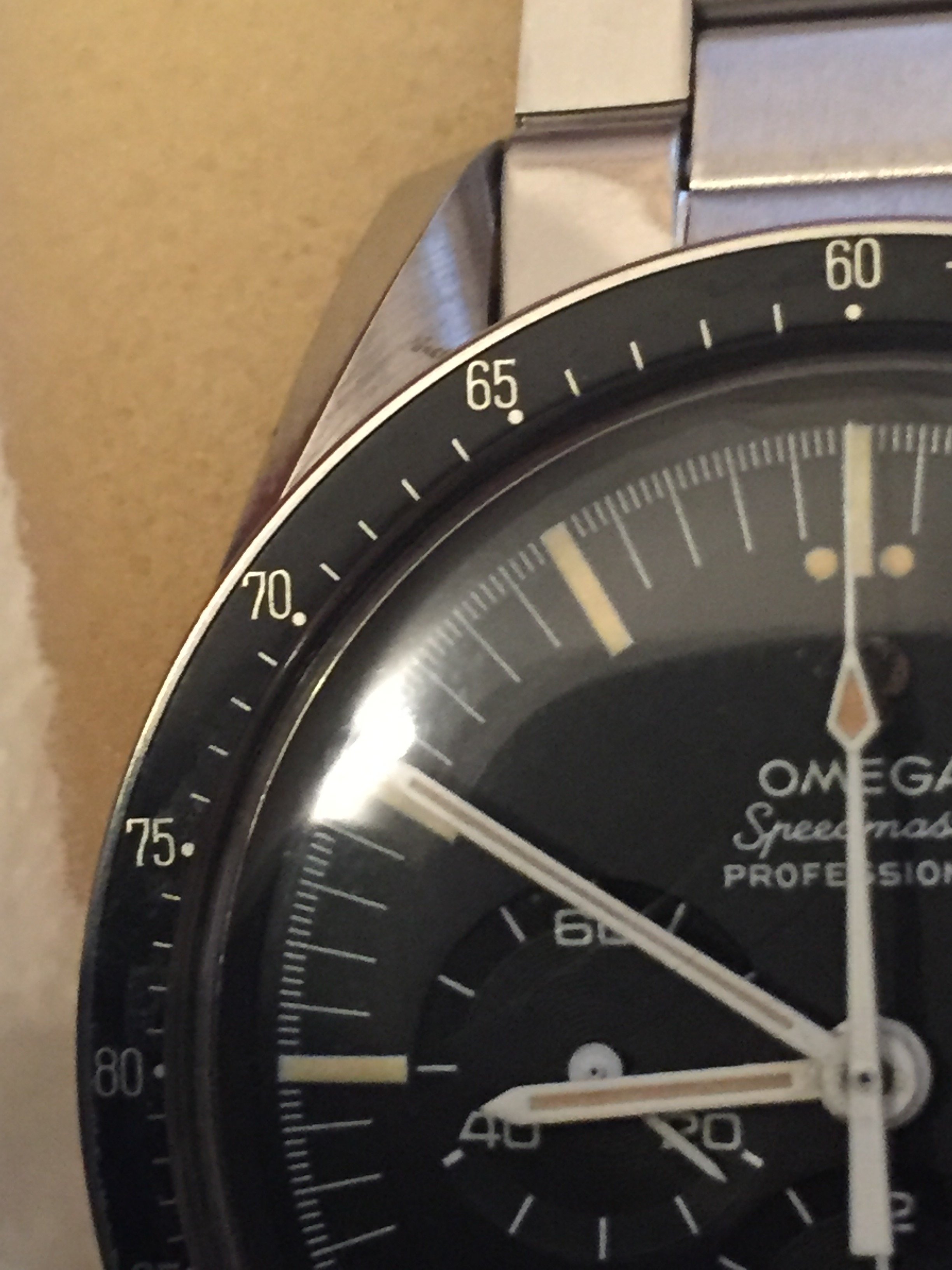

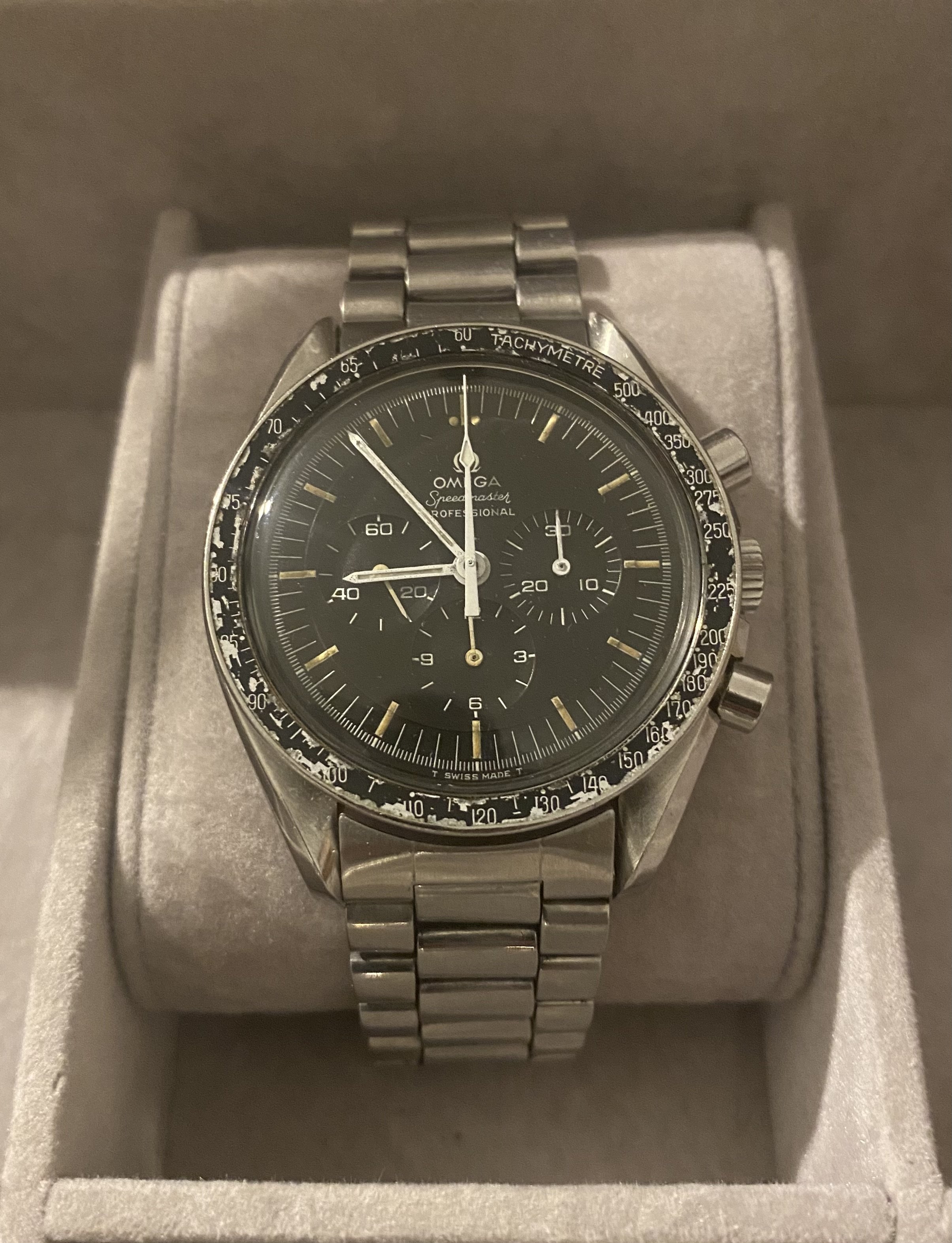

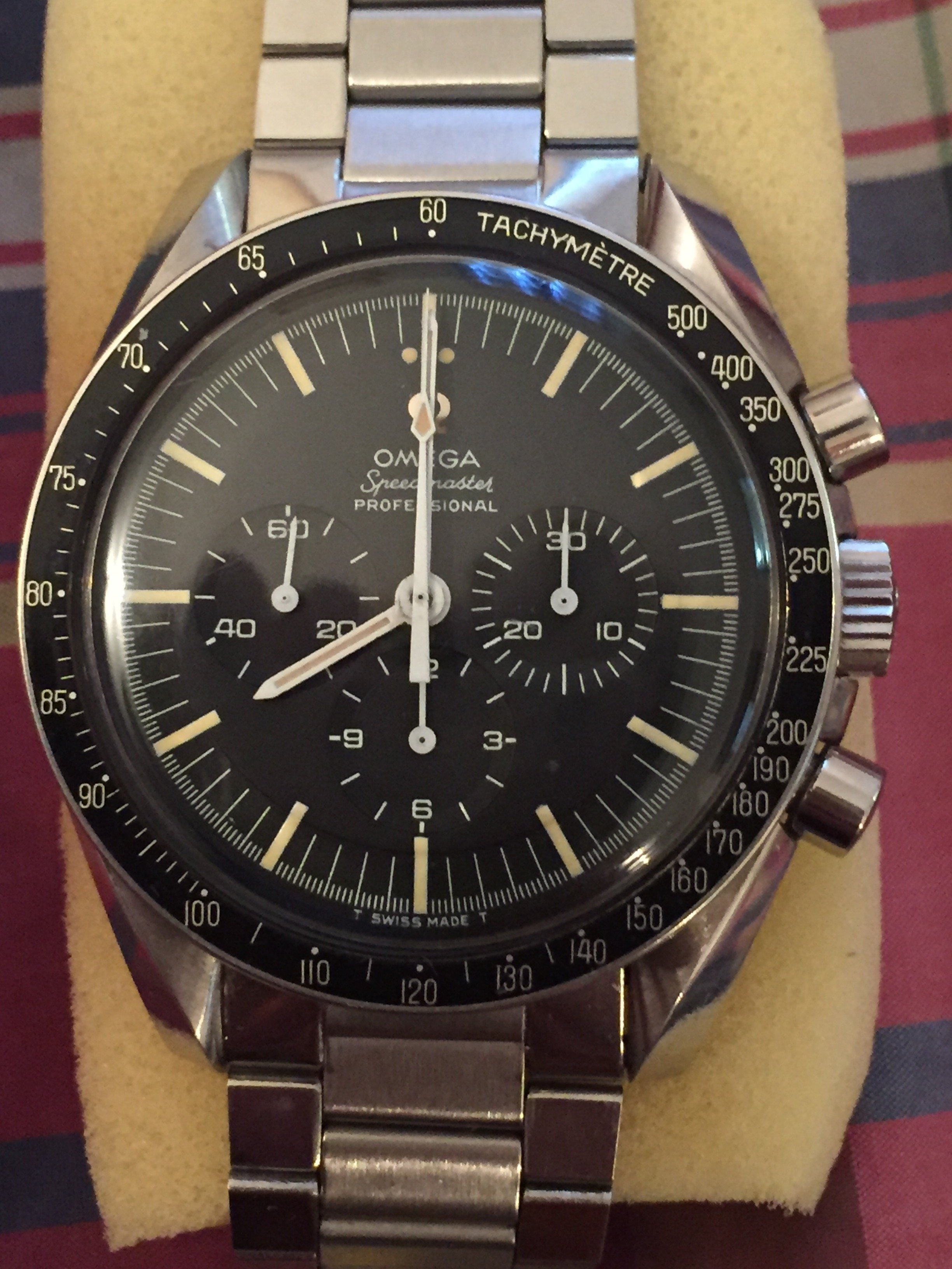

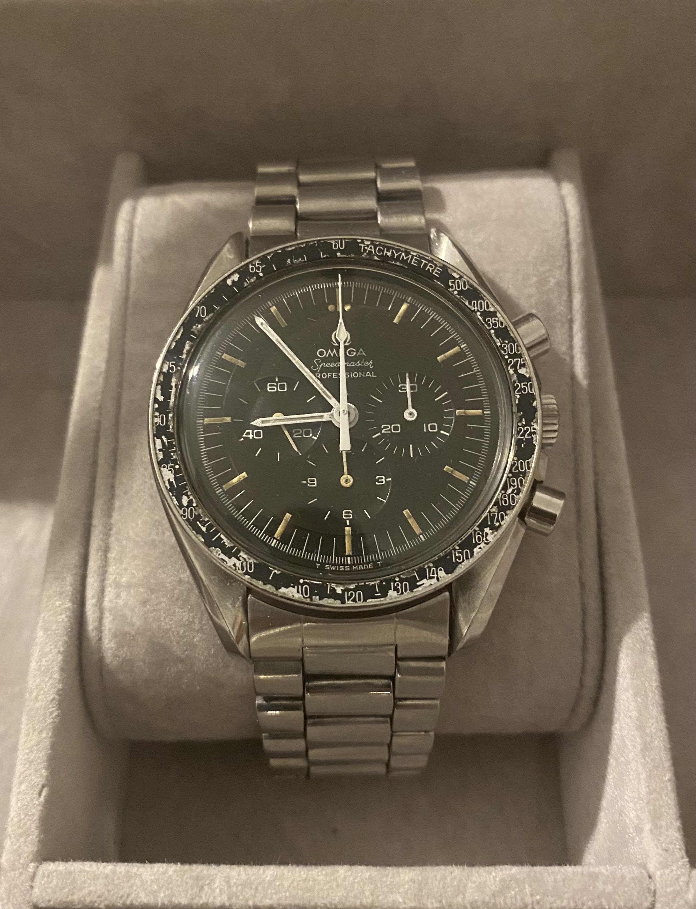

Also, I’m always curious about the impact of a poor DON bezel on an assessment - I have a couple of 145.022 69s, one of which has a poor DON bezel. While the bezel certainly detracts from the appearance of the watch, could it be argued that a poor DON is preferable to a very good replacement DNN? Picture below is of the 145.022 in question (I think it looks better in person).

If you have a GOOD watch with a POOR bezel, just start with the value of a GOOD watch and subtract the difference in value of the bezel. There is an active market for loose bezels, so that's an easy adjustment to make.

Thanks Dan, I can definitely see the logic in that approach - also when it comes to vintage watches it highlights the role of donor watches in improving the desirability of a watch by replacing tired parts.

I think you always need to be flexible and make adjustments to any price guide. In this case, the bezel is probably the easiest adjustment to make because bezels are frequently sold loose. Other things are much harder, e.g. how much to deduct for a polished case or minor lume loss.

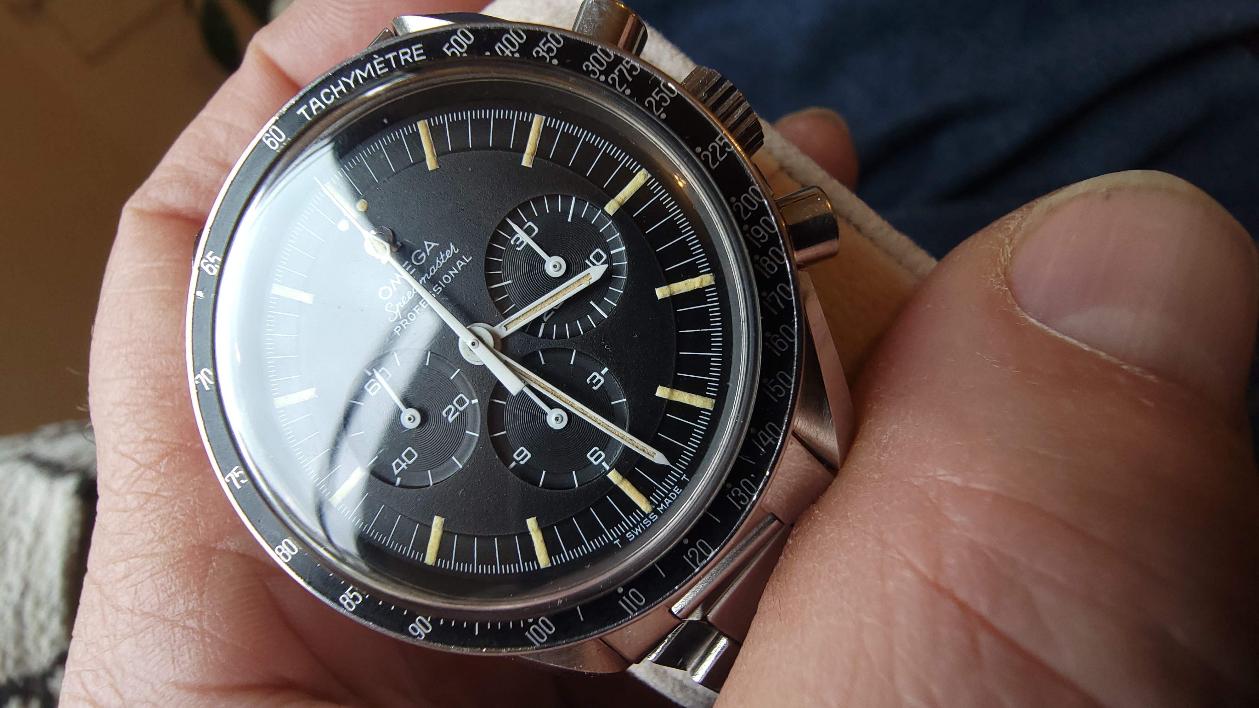

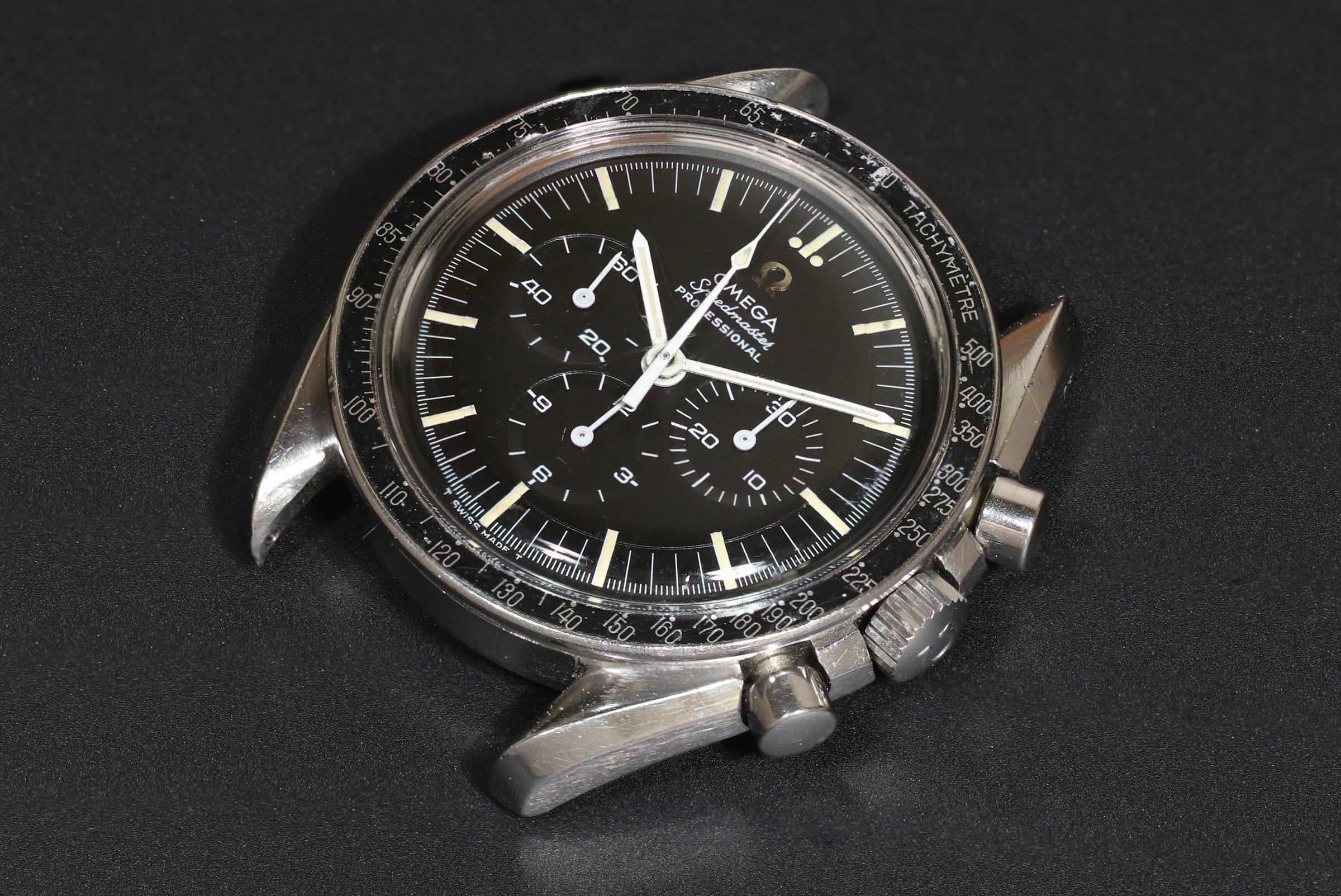

For comparison again... here's a transitional that I picked up in auction a few years ago that I considered in excellent condition with box and papers. Probably has dropped in value, but, you just don't find many time capsules these days.

Don't get better than yours.

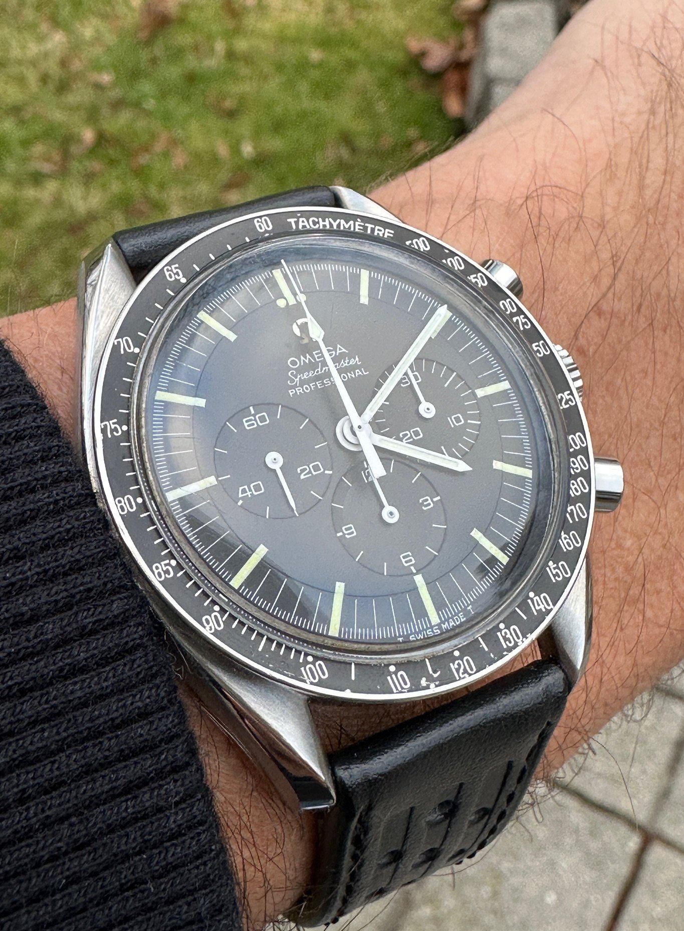

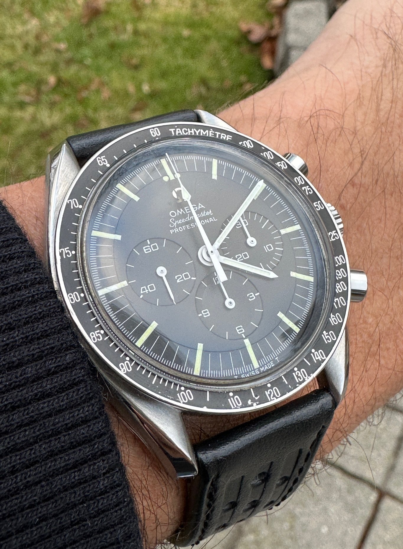

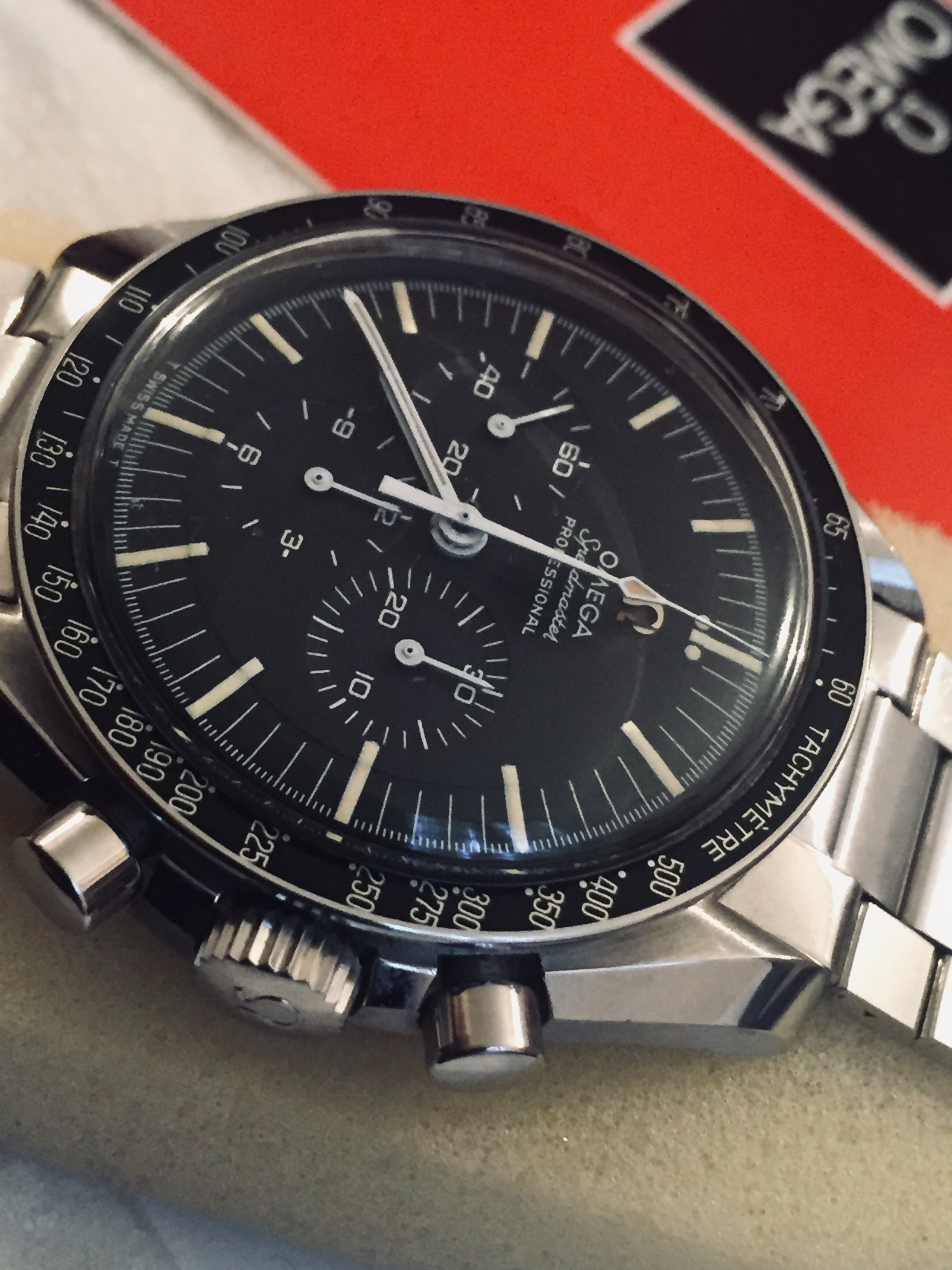

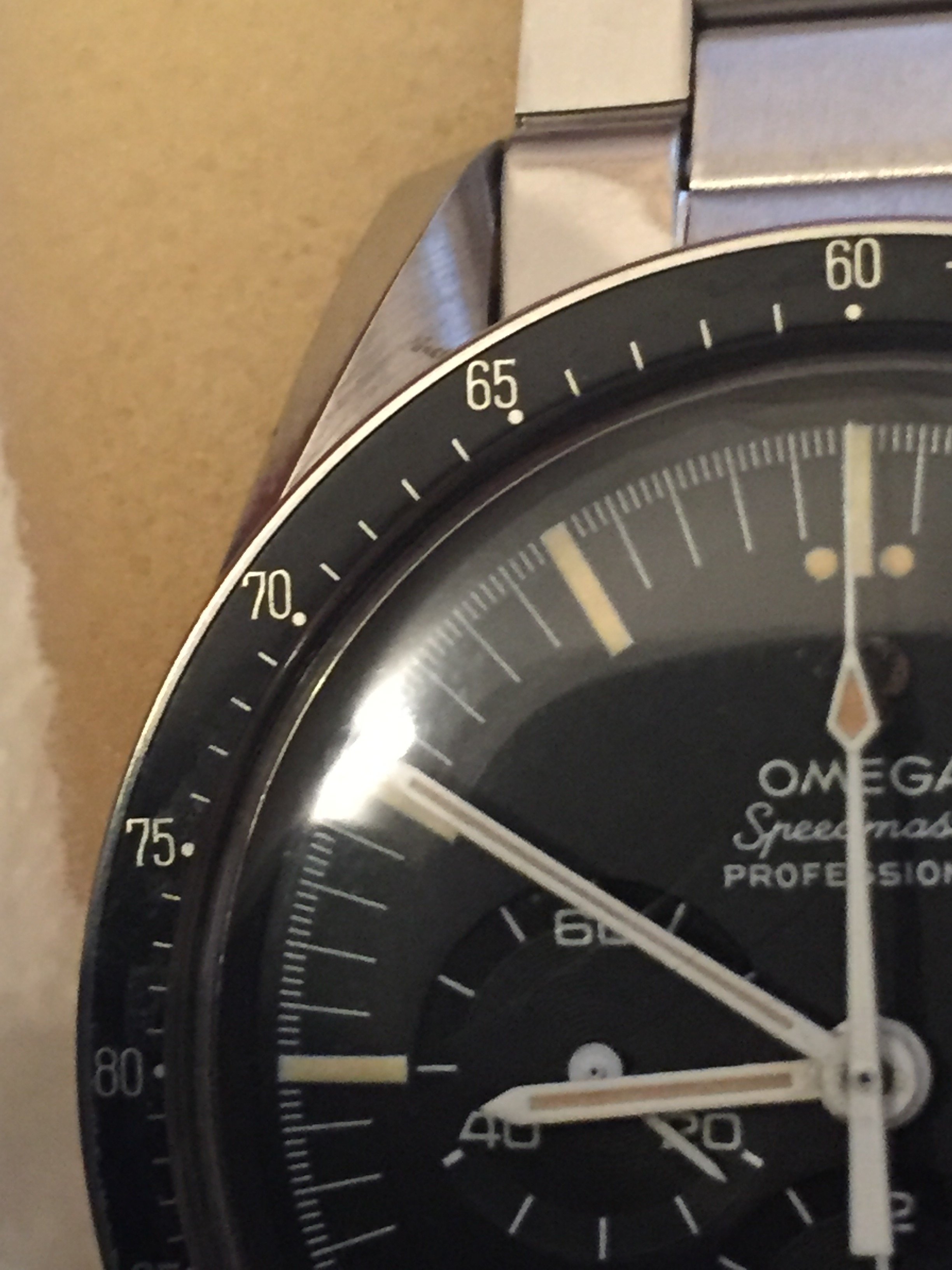

Hard to capture the dark dial but here's my recent capture.

It’s a beauty, and you perfectly captured a gorgeous dial and patina. Enjoy and wear it well.

I don't know, I think they look better in person. 😁

Thank you for this write up and wonderful photos. It's interesting that the case does not look so bad in the photos, but is actually much worse in person. If it were not for that one side-angle photo you posted that shows the rounding and loss of definition on the inner lugs, I would think it had been polished, but not terrible overall. Mental note made for future purchases.

Great analysis. I completely missed the polished inner lugs. Probably because I'm so focused on the dial and bezel. Good to know for future purchases.

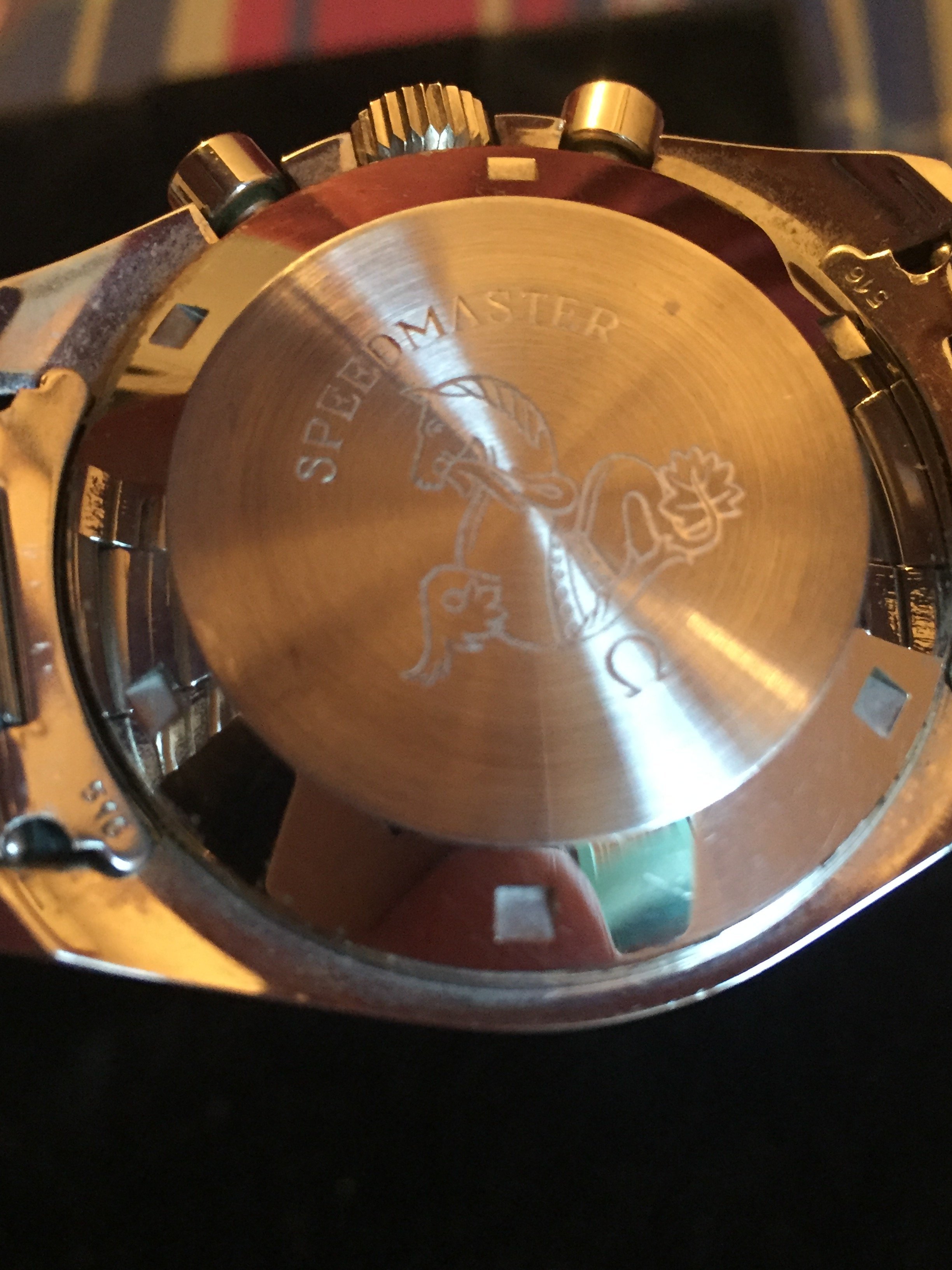

I too think an average Transitional makes an above-average daily wearer. The previous owner of mine sent it to Swatch for service and it came back over polished, less lumed, and newly handed. Unfortunately, the gentleman proceeded to misplace the original parts.
Still looks quite presentable on wrist, though not as presentable as your example.
