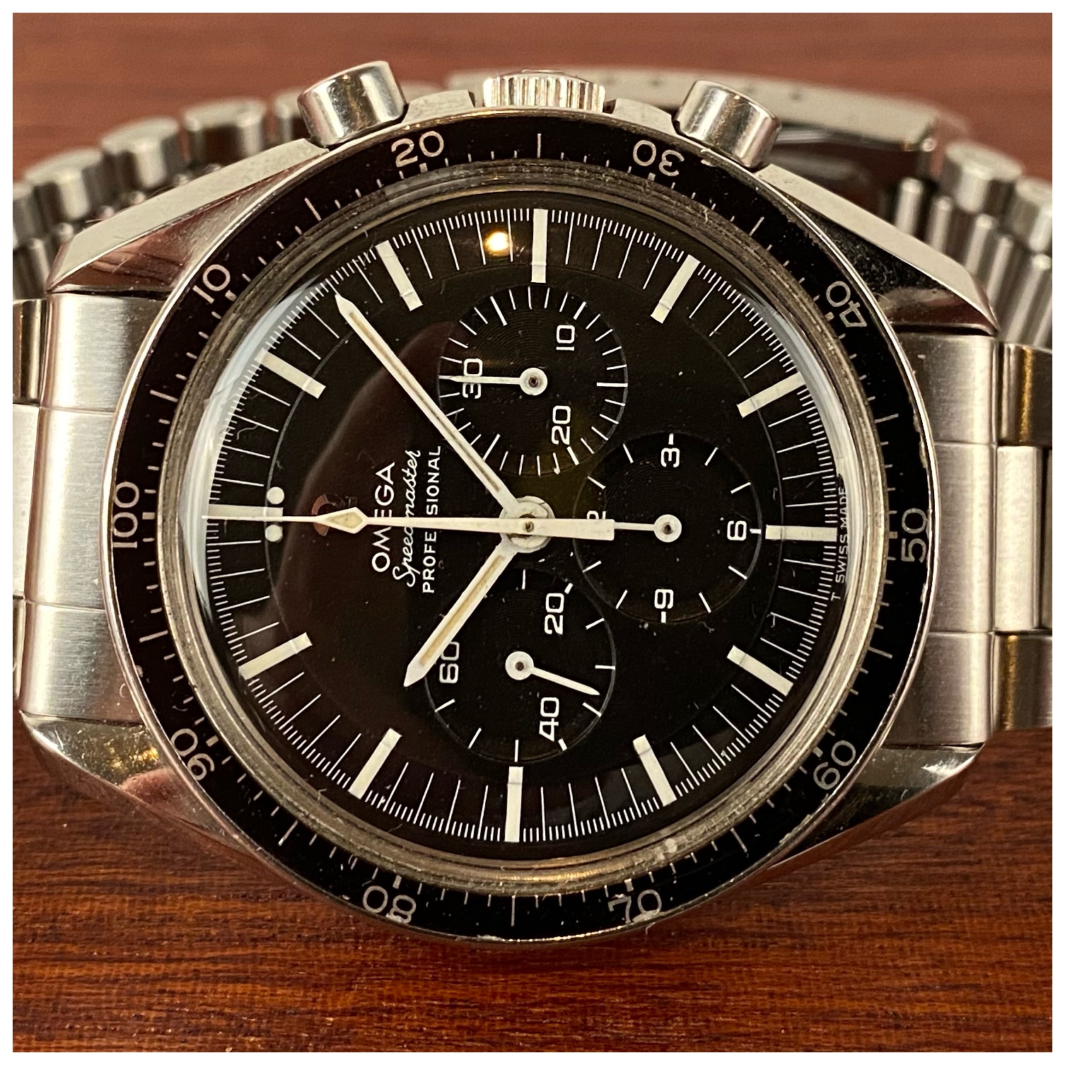

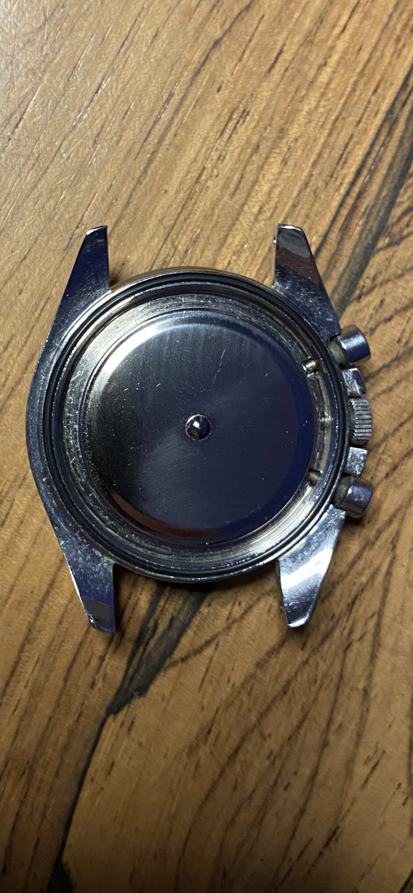

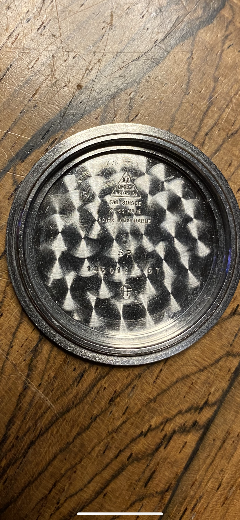

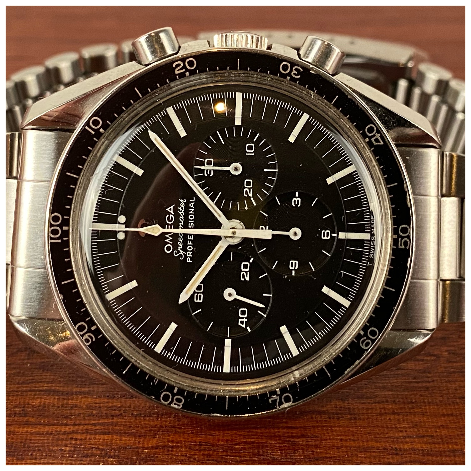

Hello,

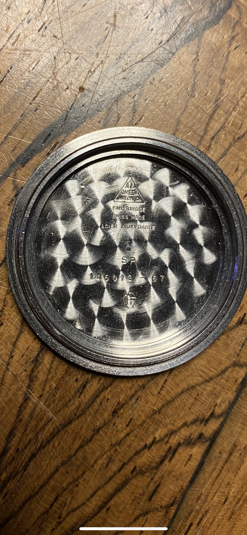

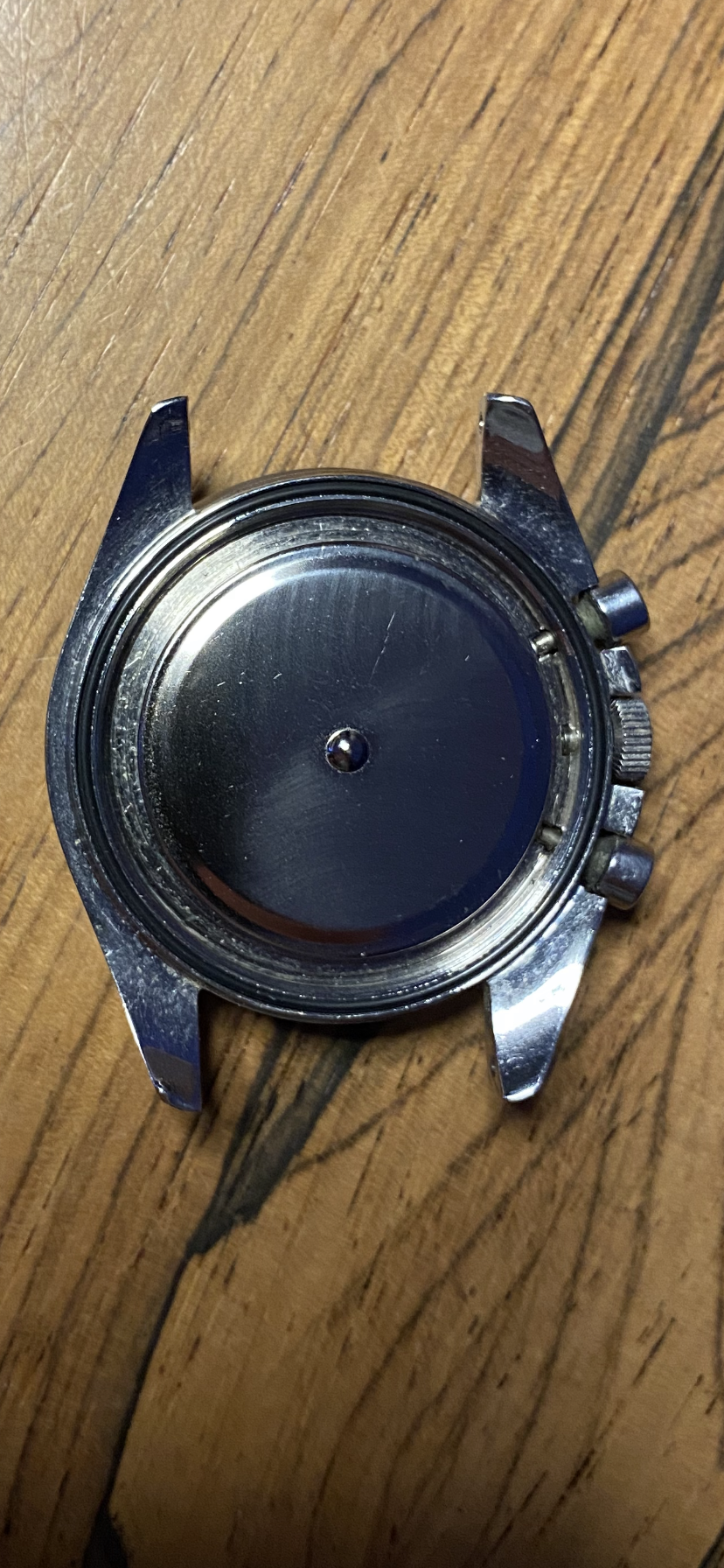

I just got this piece. Was told to be a 145.022-68, but the caseback says 145.012-67.
I think it may be the last one?
Where is the serial-number located?
Hope You all can help.

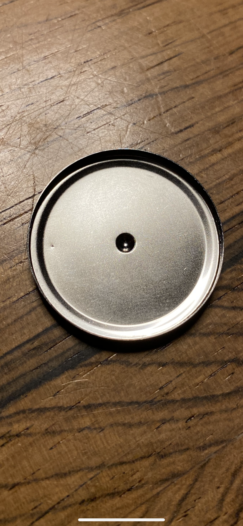

It could be either one based on the serial number but a 145.022-68 would have an inner caseback marked as such. Need more pics but my guess is wrong caseback
10,804
16,814
If it’s got an 861 then the caseback is wrong. Or the movement has been swapped. The bezel make me suspicious too. This may well be a Bitsa.

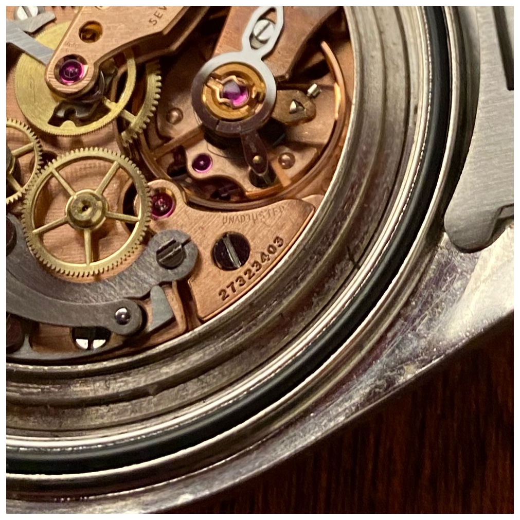

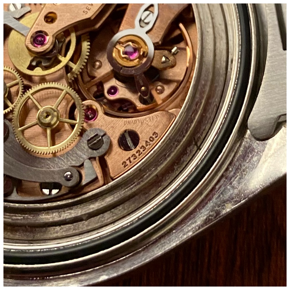

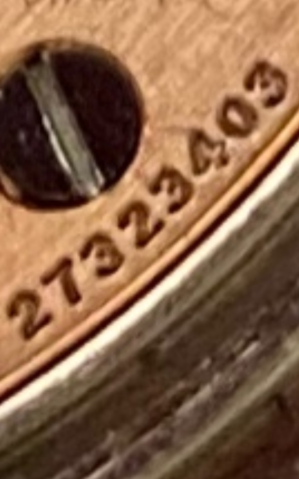

Thanks, but where do I find the serialnumber?

@Enoerik You might want to look at that thread....
TLDR:
Its an amalgamation of parts... And the guy that sold it to you most likely knew.
The movement is for a 145.022, the dial depends and we need to see the back of it, the case back is wrong for the movement.
There was another reference between the 145.012-67 and 145.022-68

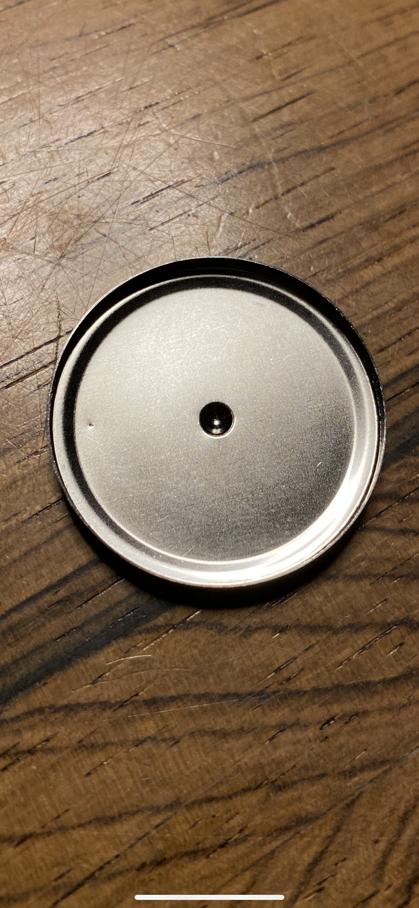

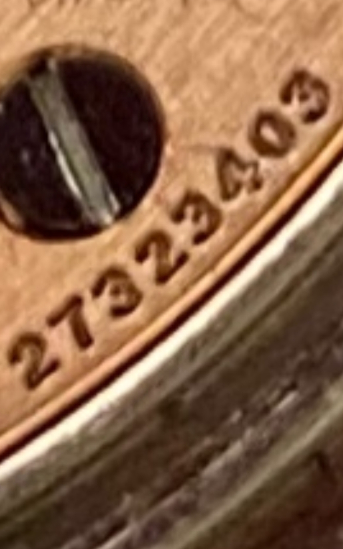

The dust cover doesn't have a serial number.
It's the 7 digit number engraved on the movement.
Edit: I mean 8 digit number.

Thanks, it sounds like the guy I bougt it from.
May I enquire how much you paid for this beauty?
905
2,489

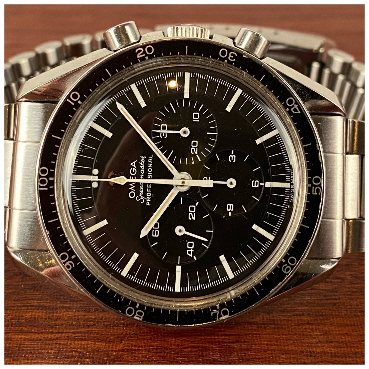

A good question asked on the other thread, so i repeat it also in this thread.
Can you please post a picture of the watch set to 06:00?
There seems to be some confusion going on in the other thread, so would be great to know who actually has the watch in their hands, OP or someone else?
