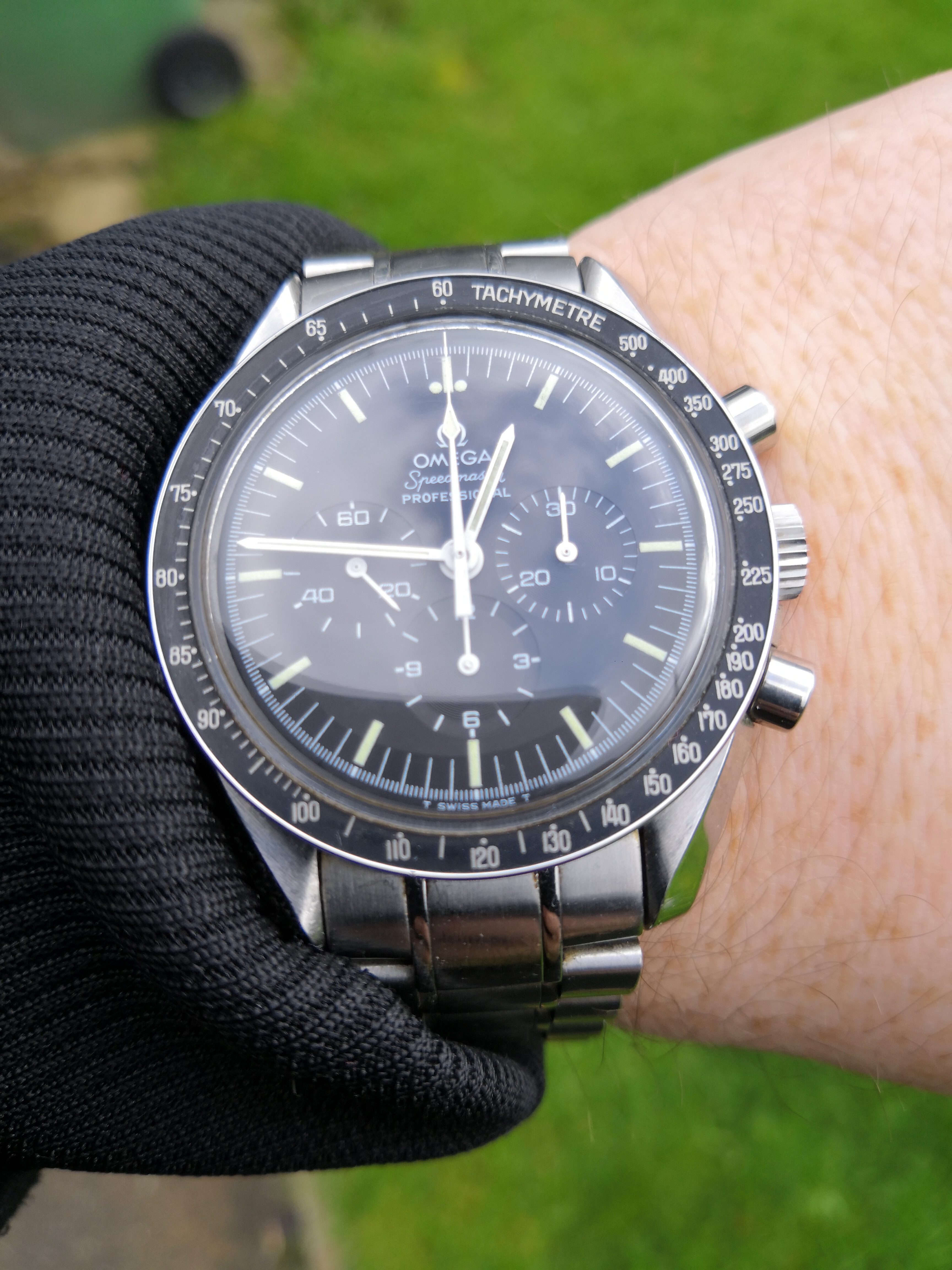

Here is the link to the watch the OP posted above:
https://paul-sanders-nvrx.squarespace.com/new-products/1978-omega-speedmaster-moonwatch-145022
The watch looks legit (without later replacement parts) to me.
As far as I have learned, in the past, OMEGA used to mix up parts or use for current production what was at hand. Why not in case of the 145.022-74?

that watch is clearly a a -78 with the wrong caseback. That is not a period where that back could appear on that serial number and dial.
hands also appear missmatched....

There is another 145.022-74 with 39,92 mio. serial and C3 dial on C24:
https://www.chrono24.com/omega/vintage-speedmaster-moonwatch-145022-74-st--id10405838.htm
I think it's highly unlikely to find two -78 with wrong casebacks and similar design whithin ten minutes. But it's possible, obviously.
So, including the OP's watch, there are at least three -74 with a 39,92 mio. serial number and a C3 dial.
I wonder how many watches with similar characteristics does one have to see, to consider them being legit?

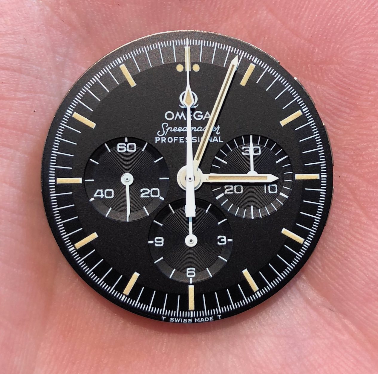

Many 145.022 that got a dial exchanged during service would most likly have been fitted with a C3 dial between mid 77 and 1990. This dial has been used for a long period and is not a really good indicator in my opinion.

With the 145.022 I posted, it seems as if it’s really just an issue with a mismatched case back, not the dial. As was pointed out earlier in this thread, a C3 dial could be seen in a Speedmaster with a mid/late 1977 production, which is the estimate for when that Speedmaster was produced. The problem would be if the Omega extract came back with an early 1977 production, which would indicate that the dial might have been replaced at service.

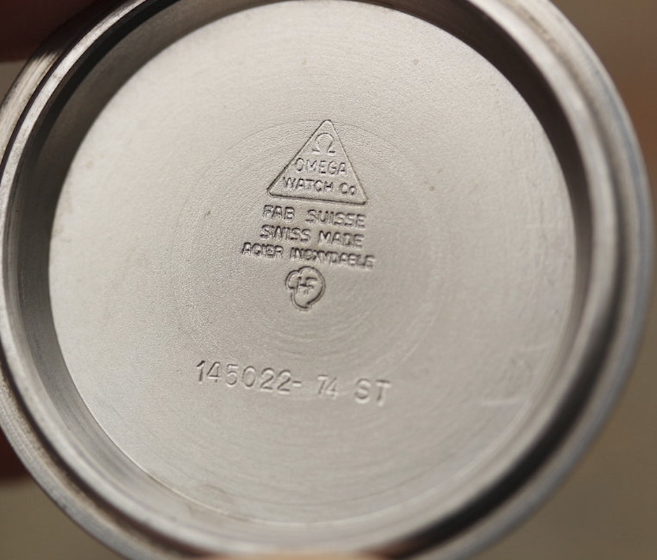

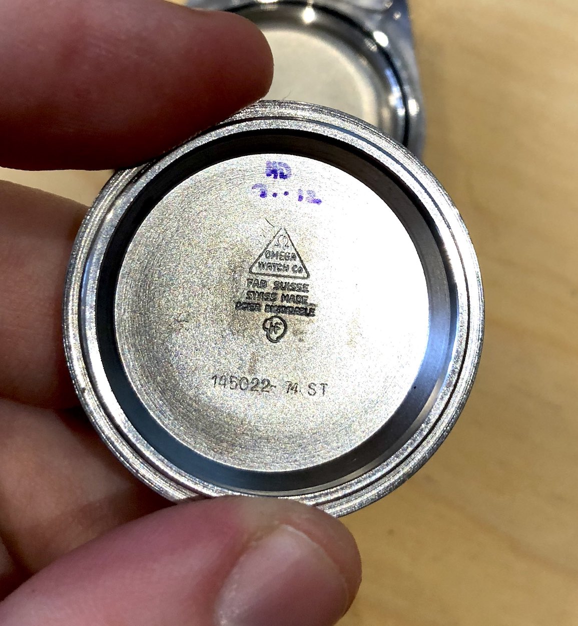

Looking again to the first foto of the caseback, I'm thinking the -74 is done later on. Font looks different and the "-" is not accurate. In the second foto of a members caseback it looks different. As well in my 74 it looks as it was made in one step:
But it is HF stamped on OPs caseback. As far as I remember 74 was the last made HF cases, isn't it?
Good observation about the engraving looking different. Not sure what to make of that.
Regardless, it would seem the watch should have a 145.022-76 case back anyway.

Here is the picture of the caseback you posted above. Looks different as well / matches that of your watch.
212
566
Yes, the engravings look a little different between those case backs and the other one posted by bikehomero, but I don't think we can expect modern-day machine perfection in the mid-'70s. Also, these -74 case backs were engraved/stamped over a period of a couple of years, so presumably there could be subtle differences.

Wasn't the requested one this one? The above is in my opinion in the field of normal, this one, however, not:
Yes, that's the case back on the 399229XX serial watch with the C3 dial at the beginning of this thread. I agree the "74" looks a little odd, but perhaps it was just a sloppy engraving. Not sure.
