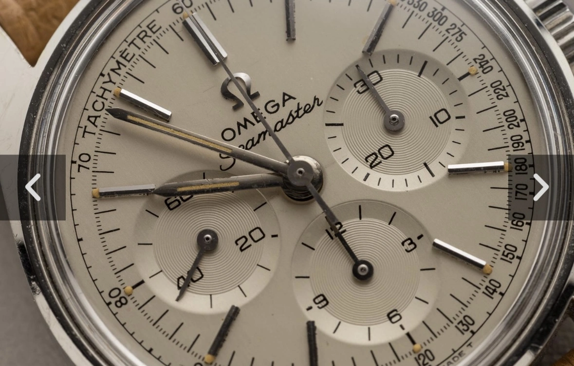

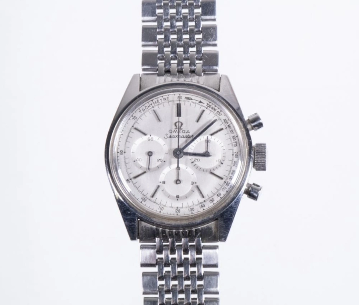

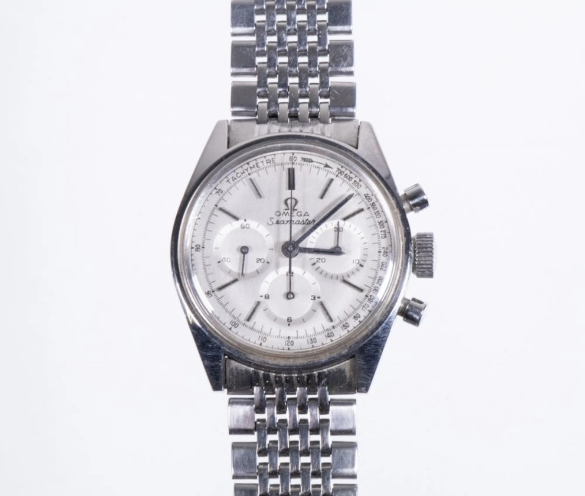

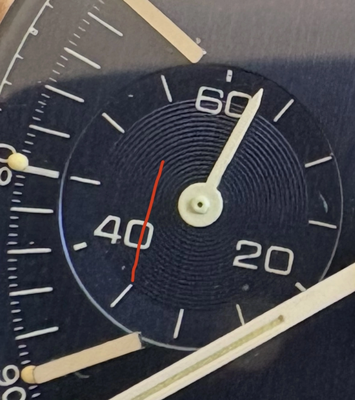

Hi Folks, recently this 145.018 was posted in an auction catalogue.
I follow this reference and while I think it’s a nice example overall, something about the dial seems strange.

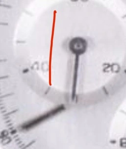

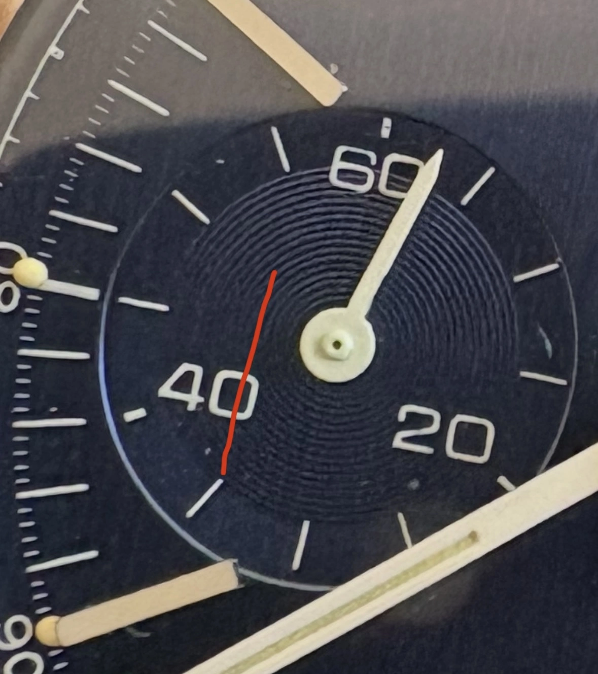

The indices of the sub dials seem smaller than in other examples. I am
Comparing it to my 145.017 / 860 but the same seems to be true for the 861 examples.

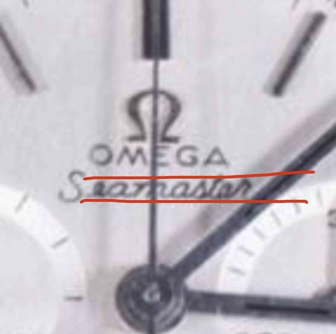

The other point is that the seamaster writing seems a little odd. I know there are both variants with the soft and the edge capital “S”, but the proportions seems strange.
Maybe this is just not such a common but still legitimate dial version, I just can’t find any single
Reference online and that seems strange.
What do you think?
Marcel
98
64
Maybe below the spacer ring. The outer circle of the Tachymeter scale seems wider than in other examples. But why?

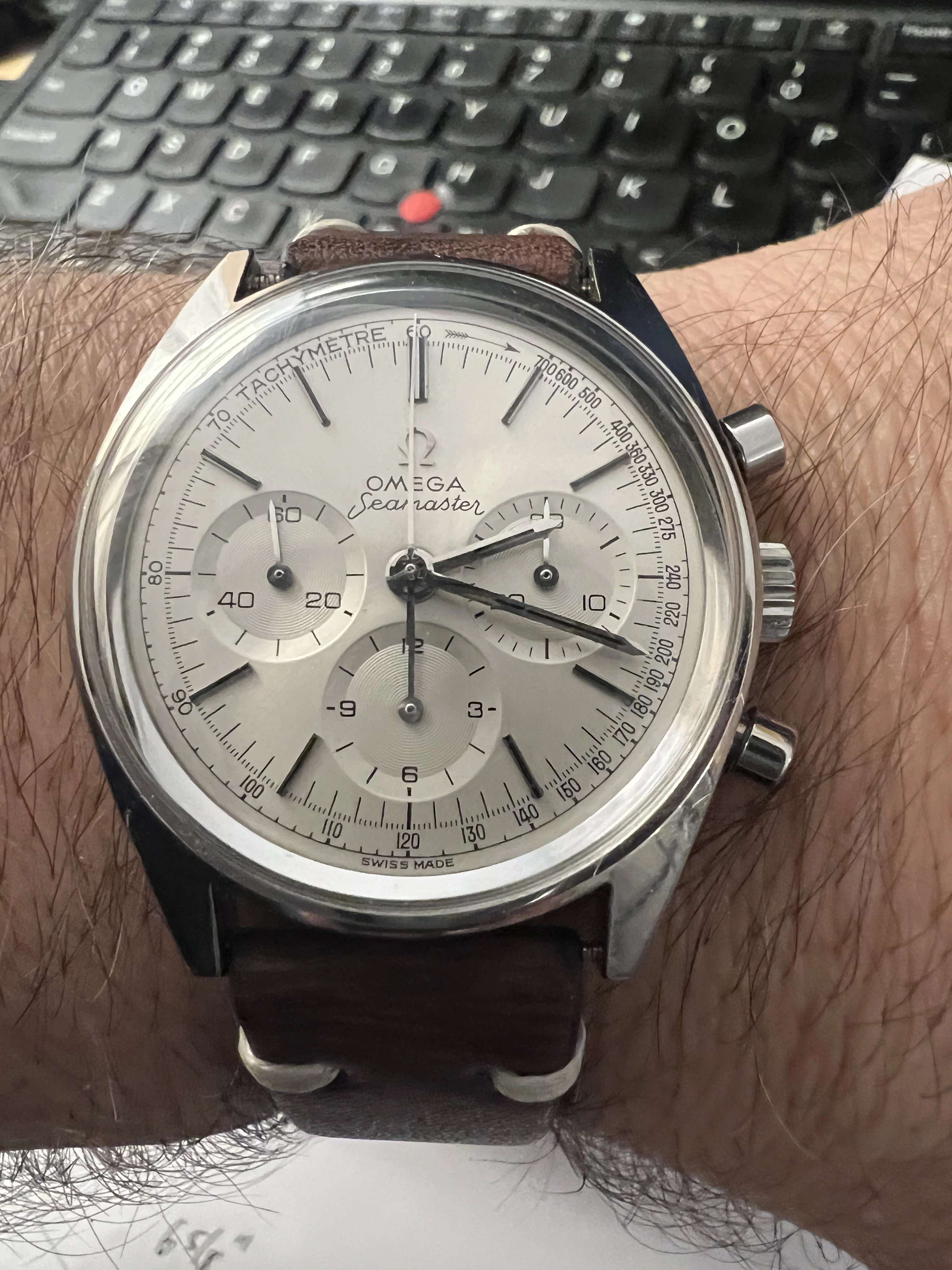

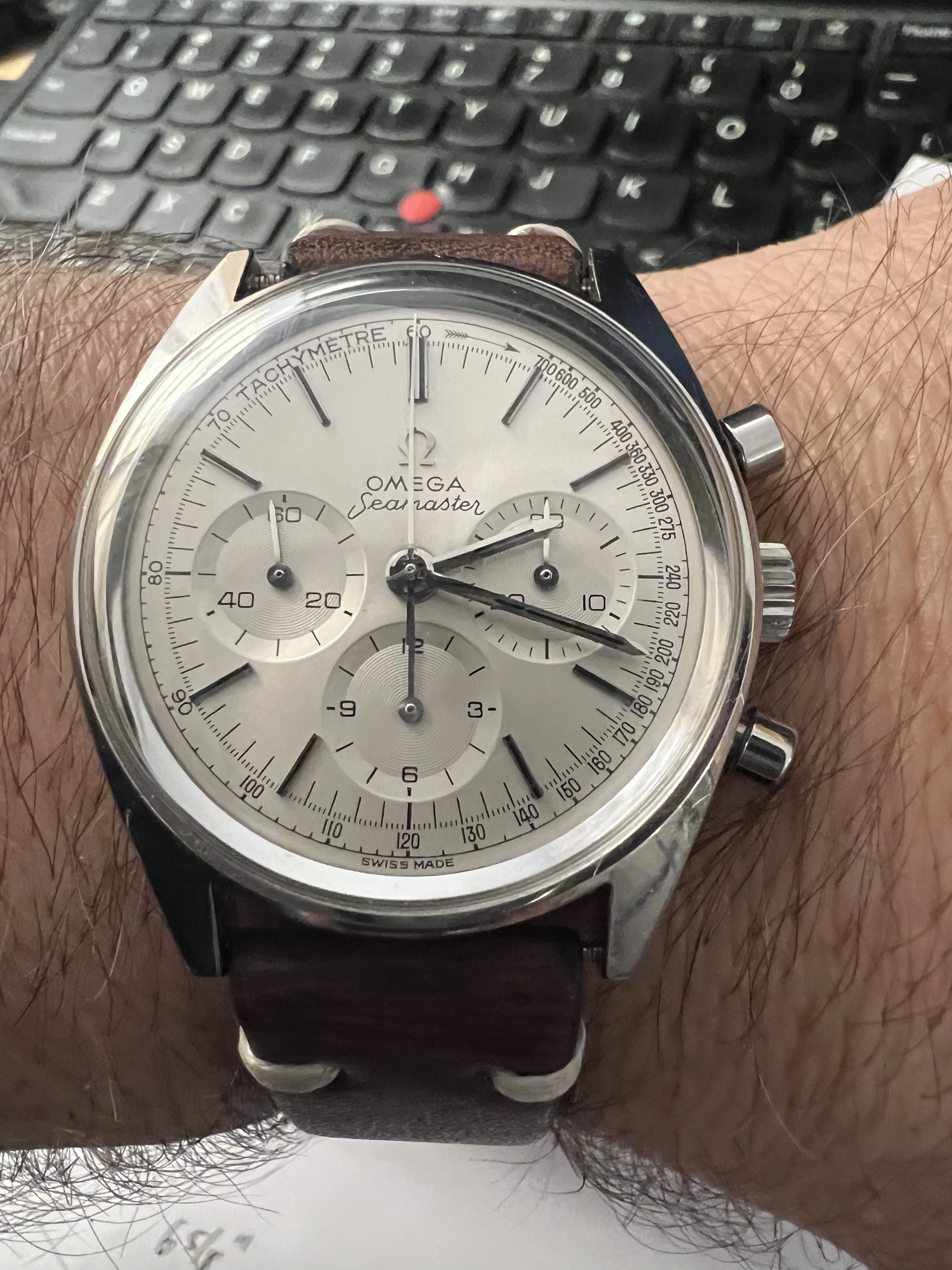

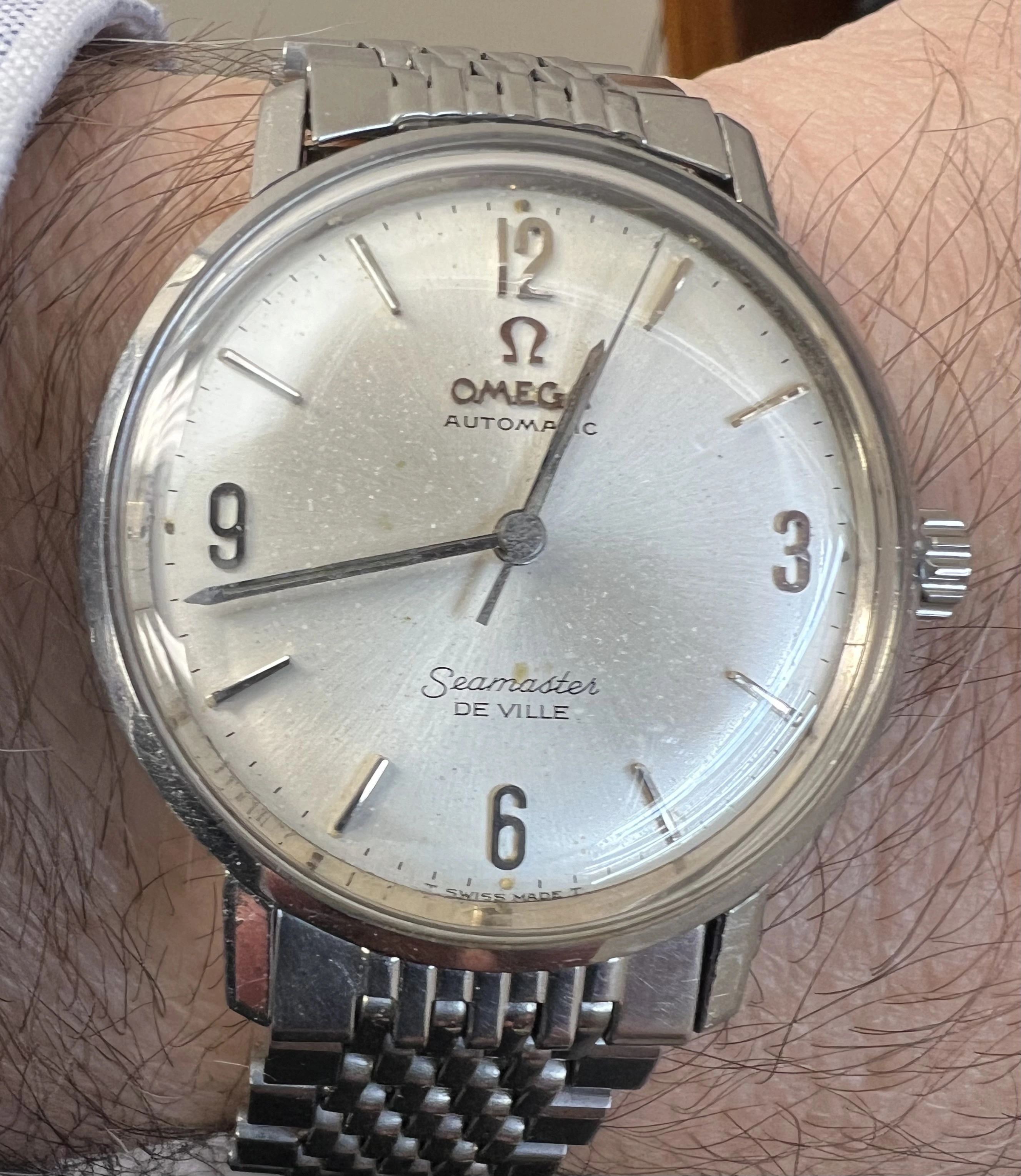

One I had (wish I still did) to compare dials
883
2,787

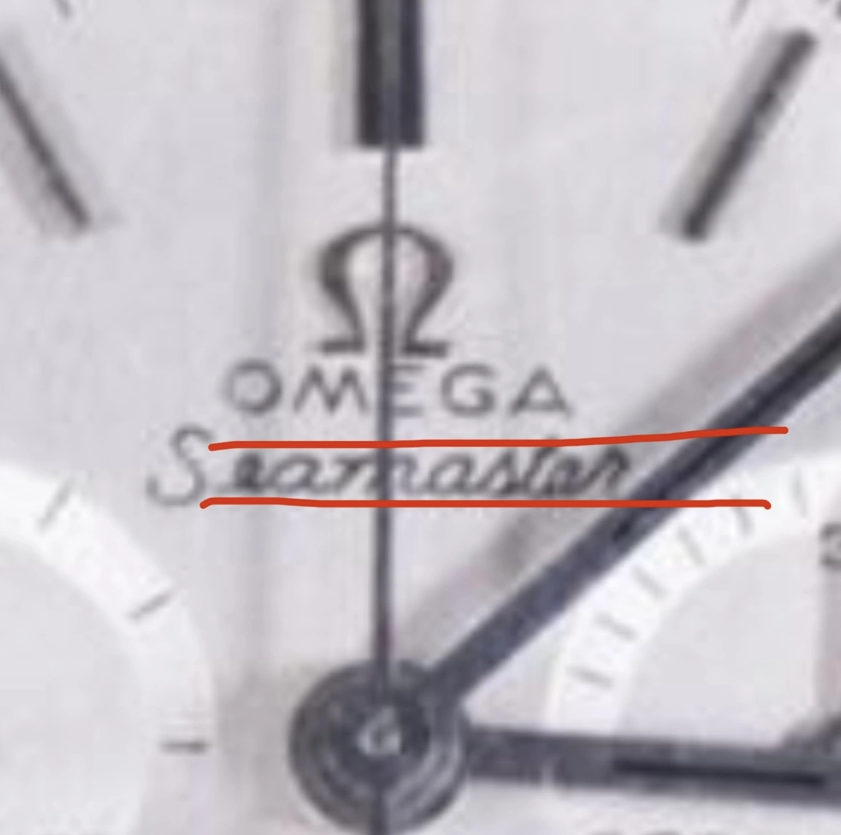

Im with you. I vote redial. The S in Seamaster is the big thing I can't get over.

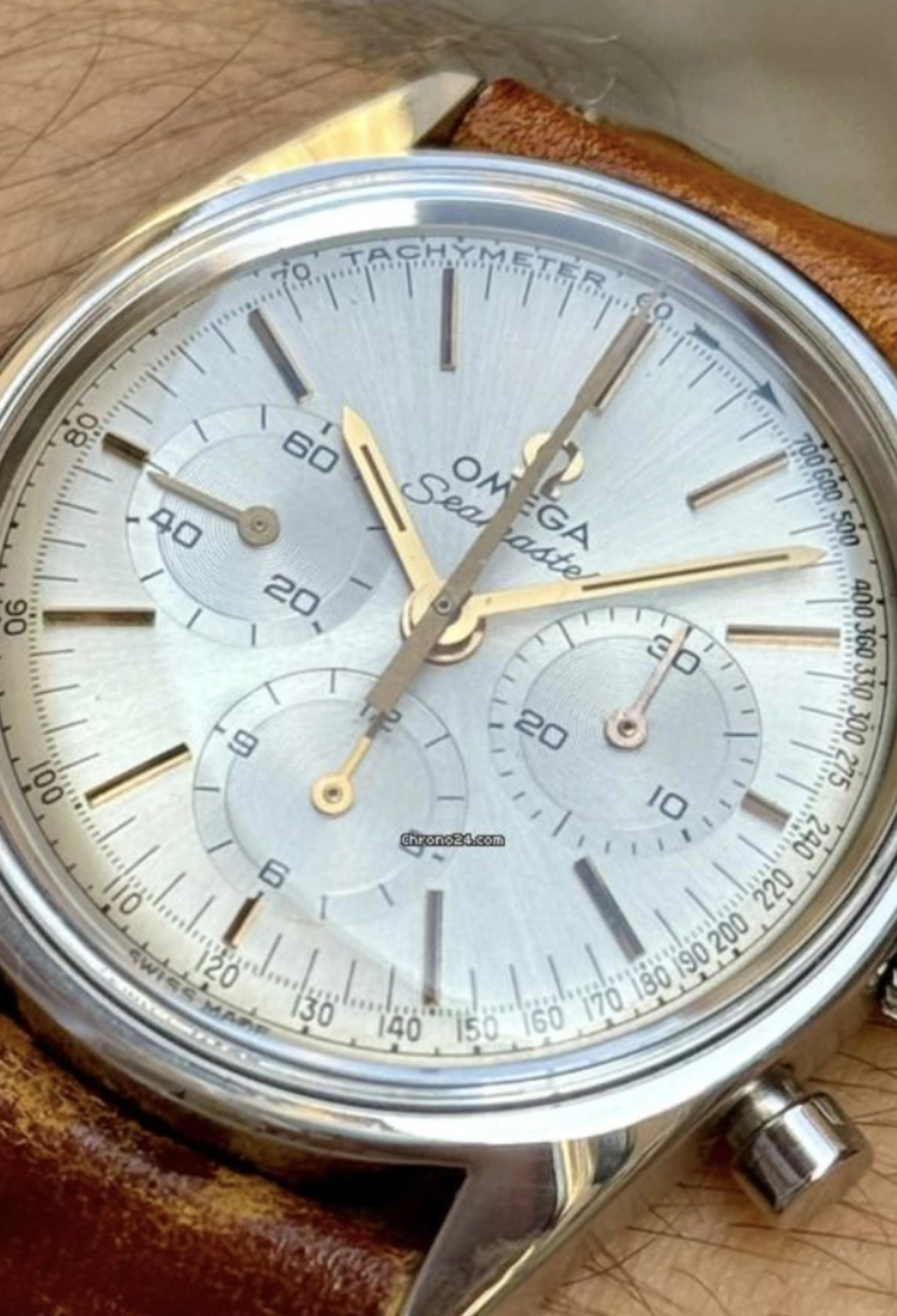

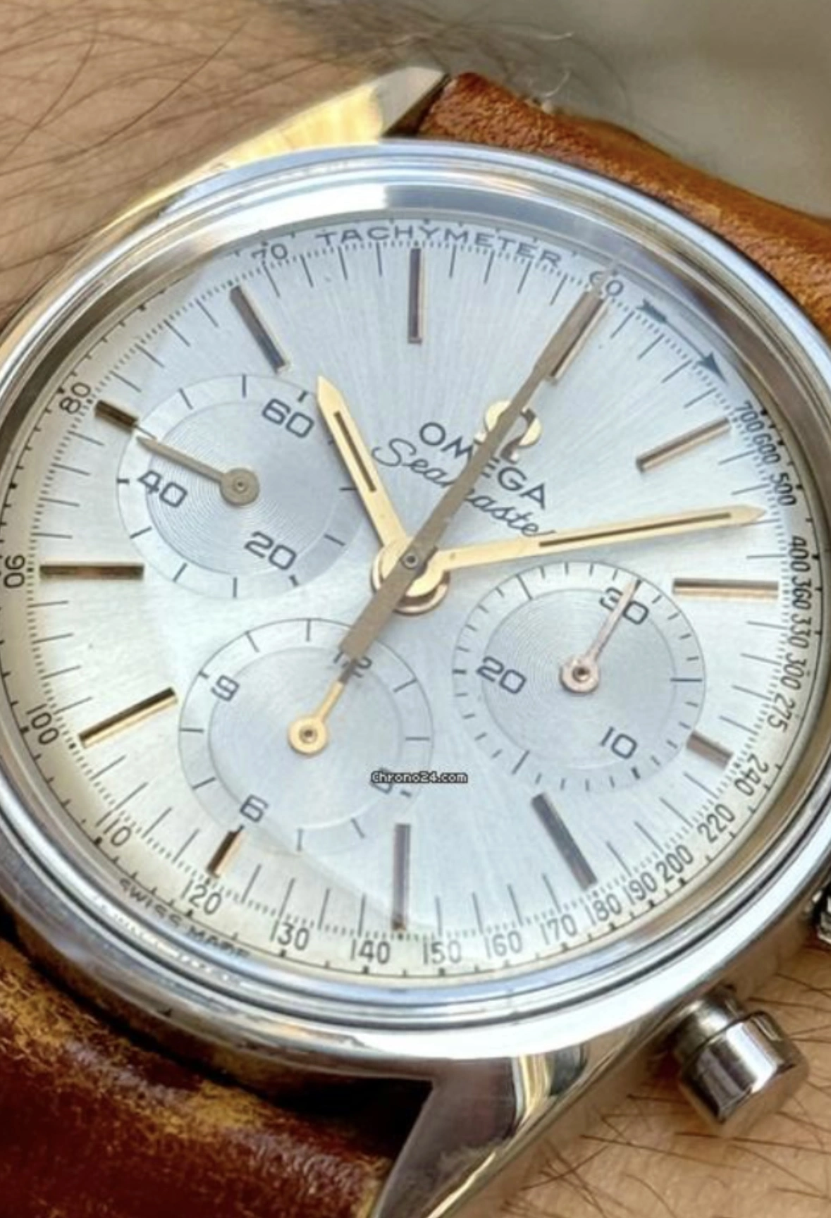

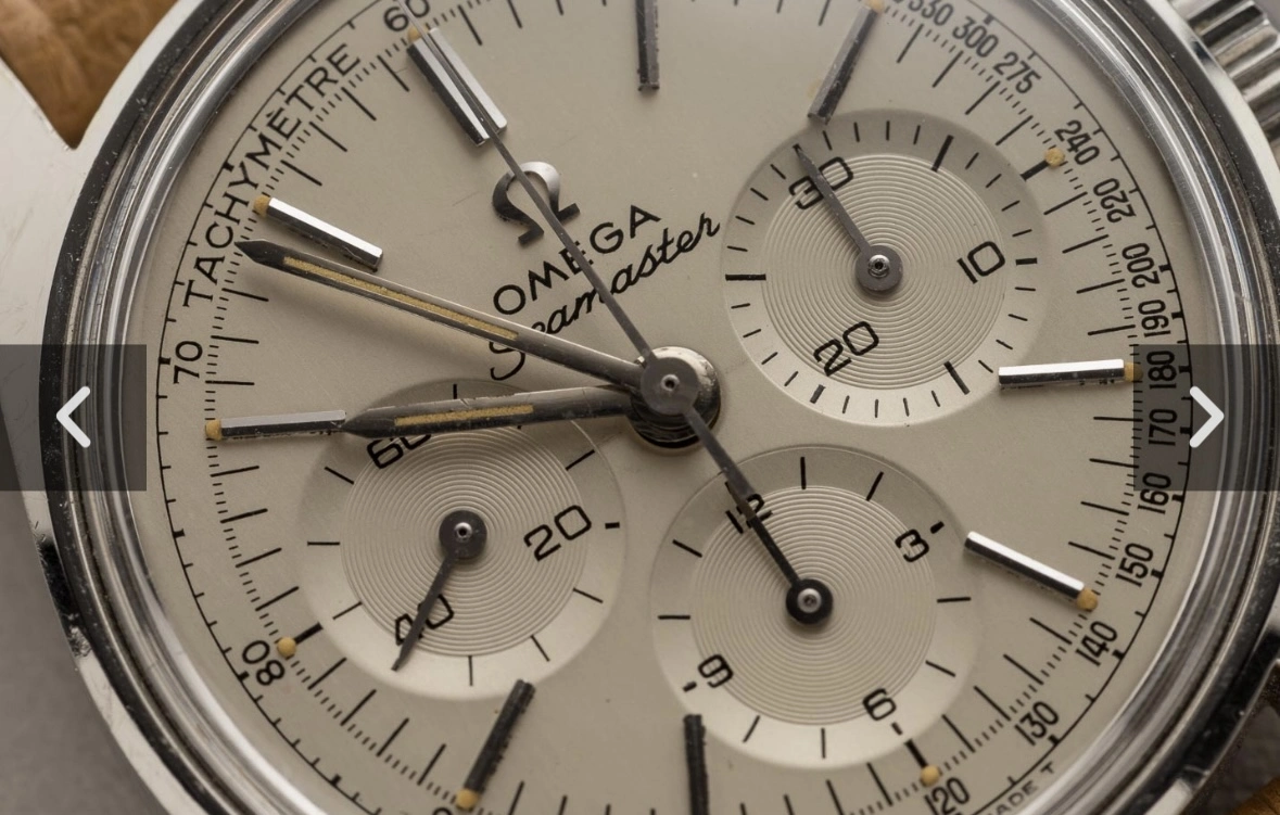

I think yours is a later model - versions with a round S do exist. But they all have larger indices - here some examples I found on the web:
10,506
16,413
They also all have Swiss Made which was my earlier point...
The OP watch is a slam dunk redial.

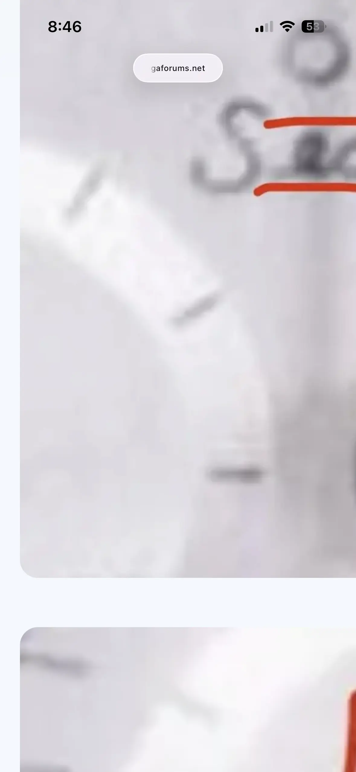

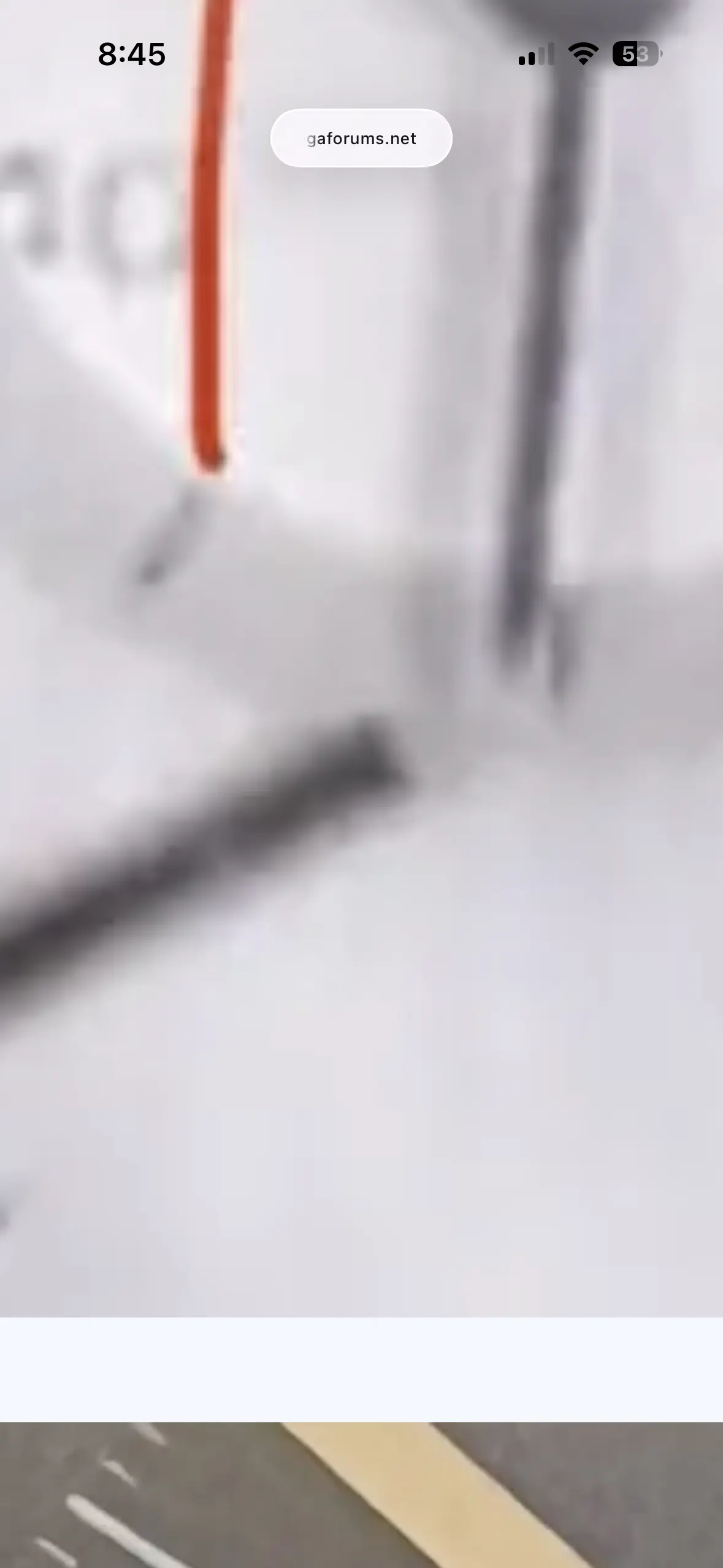

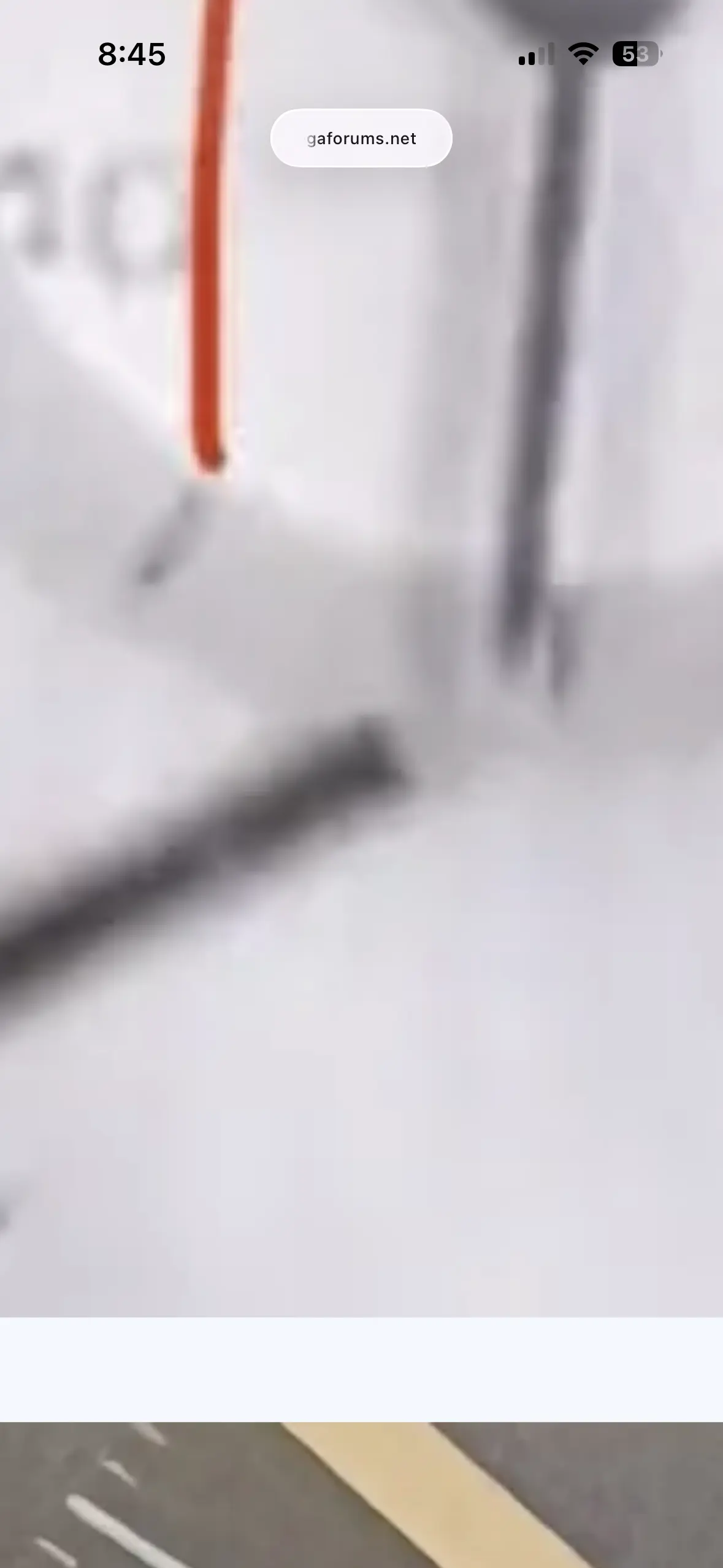

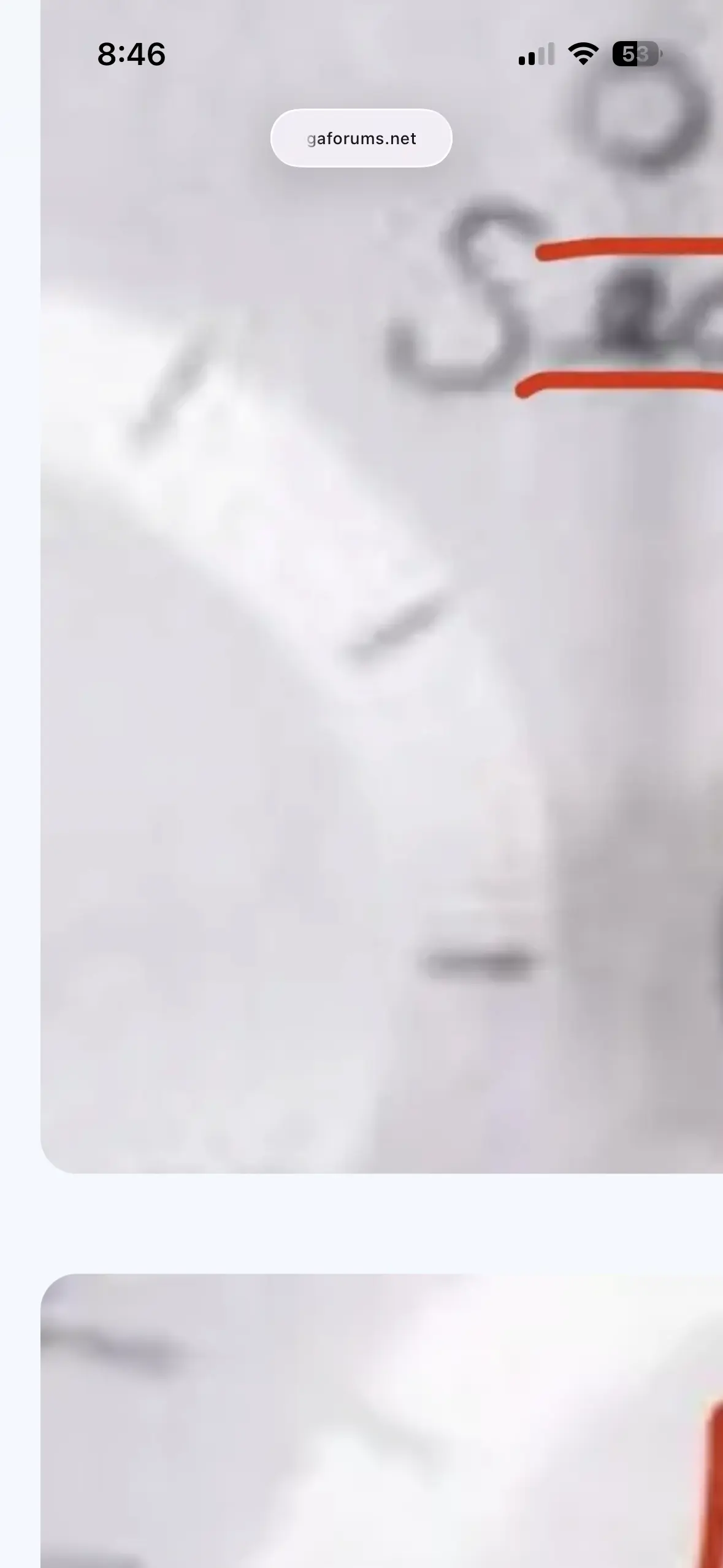

Yes and the overall writing of “Seamaster” is in parallel (horizontally) in the other models, the letters don’t get bigger towards the end.
I personally have never seen a remake of such a complex dial so I still find this odd.
18,235
27,554
I stopped looking when I saw these details.
