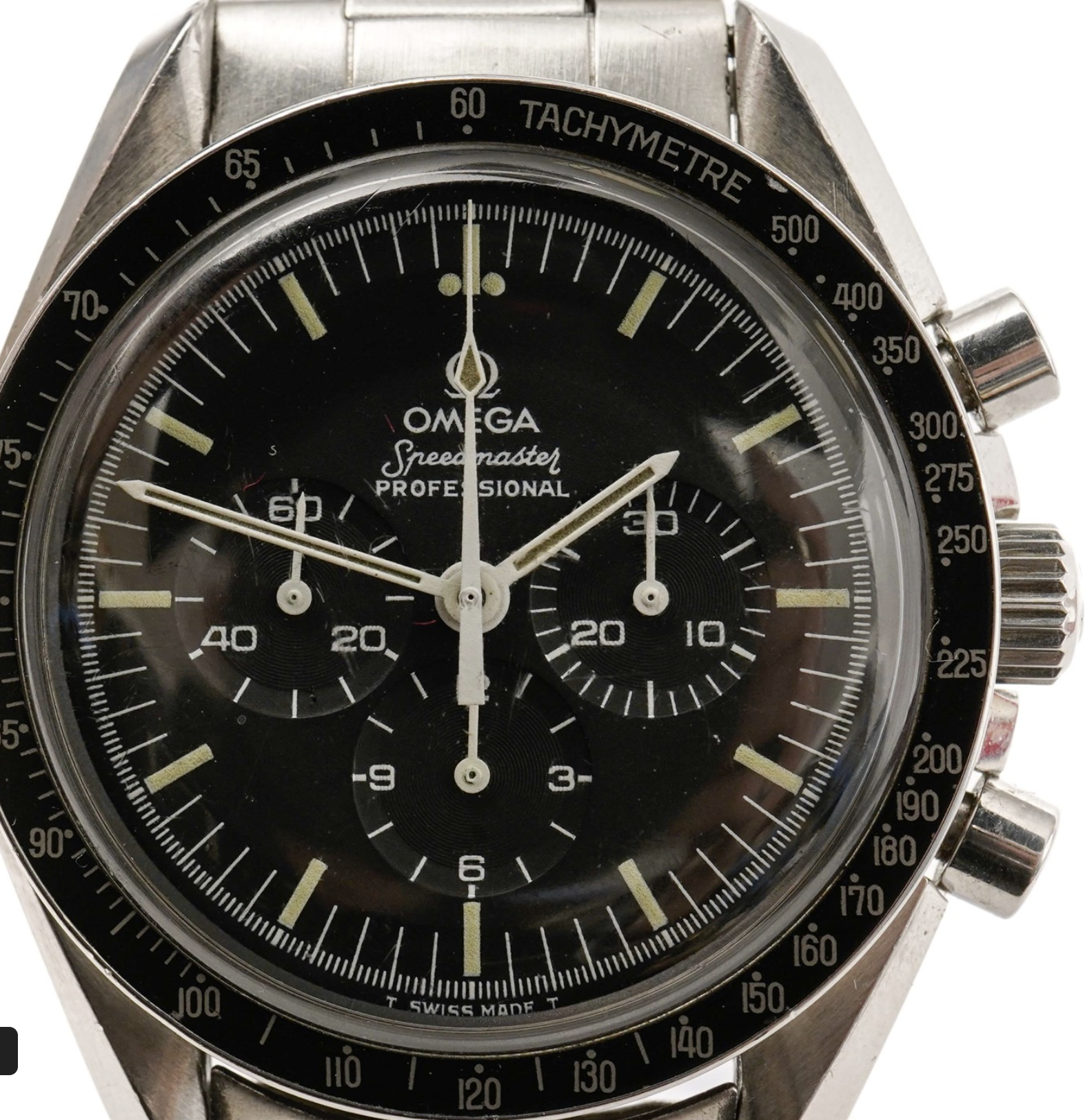

Update, I pulled the trigger.. Bought a '77 145.022. It's in great condition:
1. Unpolished case
2. Serial 3992XXXX - places production August 1977
3. Correct dial, hands and bezel - in very nice conditon and colour
4. Correct bracelet - in really nice condition, with spare link
5. Correct red box with its outer beige colour cardboard box, again in very good condition
6. Orginal receipt from 1978 with warranty card and owners manual

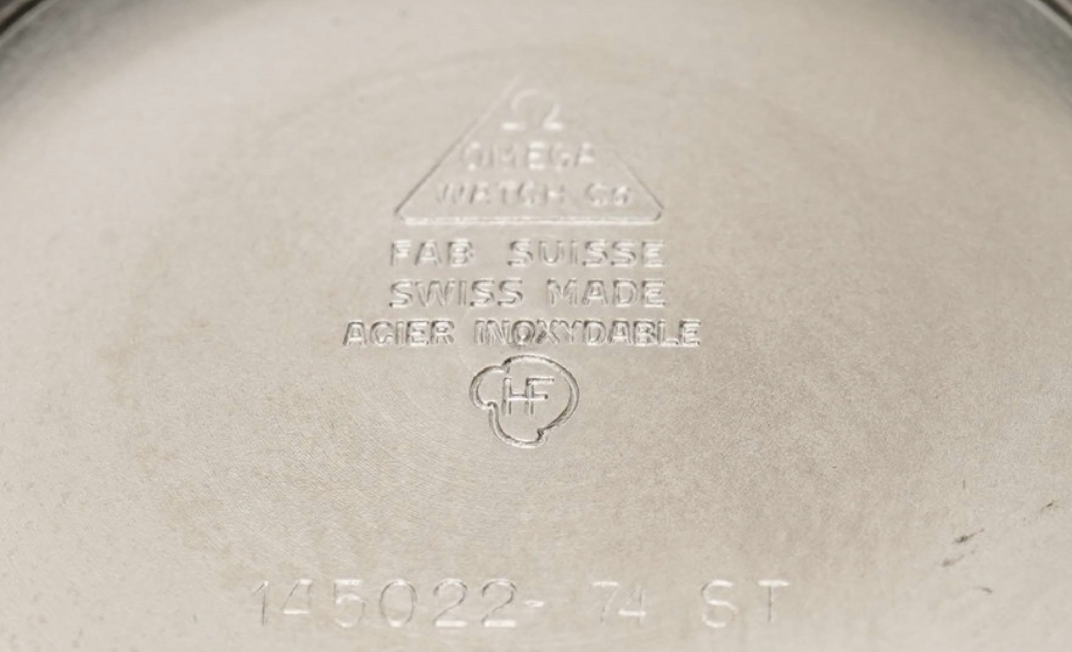

The curious item is the caseback, as it has 145.022-74 ST stamp, however, as the watch is very good condition, I'm thinking that the case back is as it was when bought new...
1. Unpolished case

extract will show production post September 77. Also the caseback is not original. Mostl likely accidentally swapped at service. A late 145.022-76 or -78 as denoted by the drop S dial would never have a -74 caseback.
The sales receipt is early 78, can't wait to order an extract. The cashback must have been swapped very early on as the patina matches the rest of the watch..
What makes you think that the watch is not a -78?

Congratulations on the watch! It is a nice one and I wouldn't be too bothered by a swapped case back.
'The bible' places the watch as a -76 with a C3 dial, however, appreciate that the book could be out of line with the most recent extracts.. As per @wagudc, not too bothered with the case back.
