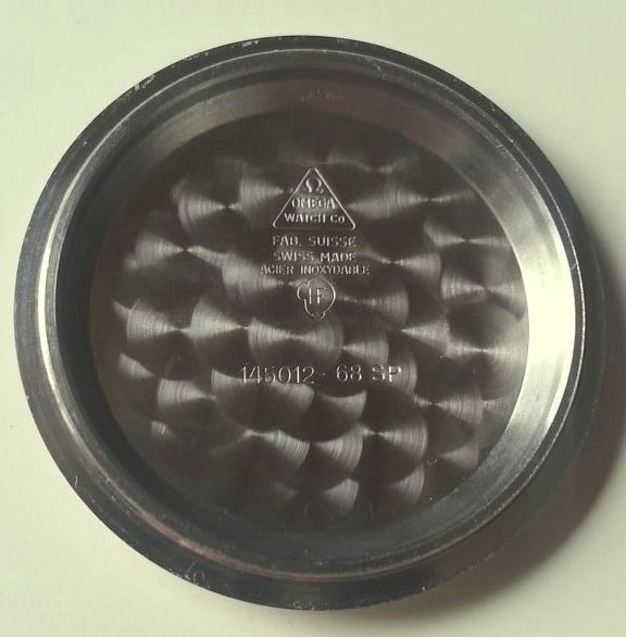

Speedmaster 145.012-68.....does it exist?
212
670
Yes, the reference 145012-68 is quite rare
For me the range of the serial movements are approximately 26553xxx and a small number of 27320xxx
You can find dials with applied or printed Omega logo
I prefer the bezel with a dot in the diagonal on 70

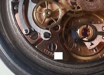

I had requested more photos of it a few weeks ago. Serial is #2607
