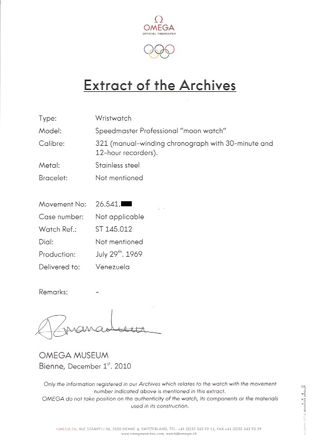

I know that the 145.012-67, containing the last of the 321 caliber movements, were produced in 1968 but is there actually a reference 145.012-68?
I even know of a 1969 145012 馃榾
35,774
40,051
The delivery dates are often like that, they don't line up with the caseback, as the casebacks were stamped when they were made, but Omega couldn't know when those casebacks would actually be used on a watch. Its not uncommon to have a 105.003 Ed White with a delivery date in even the '67-70 range though the caseback is many years earlier.

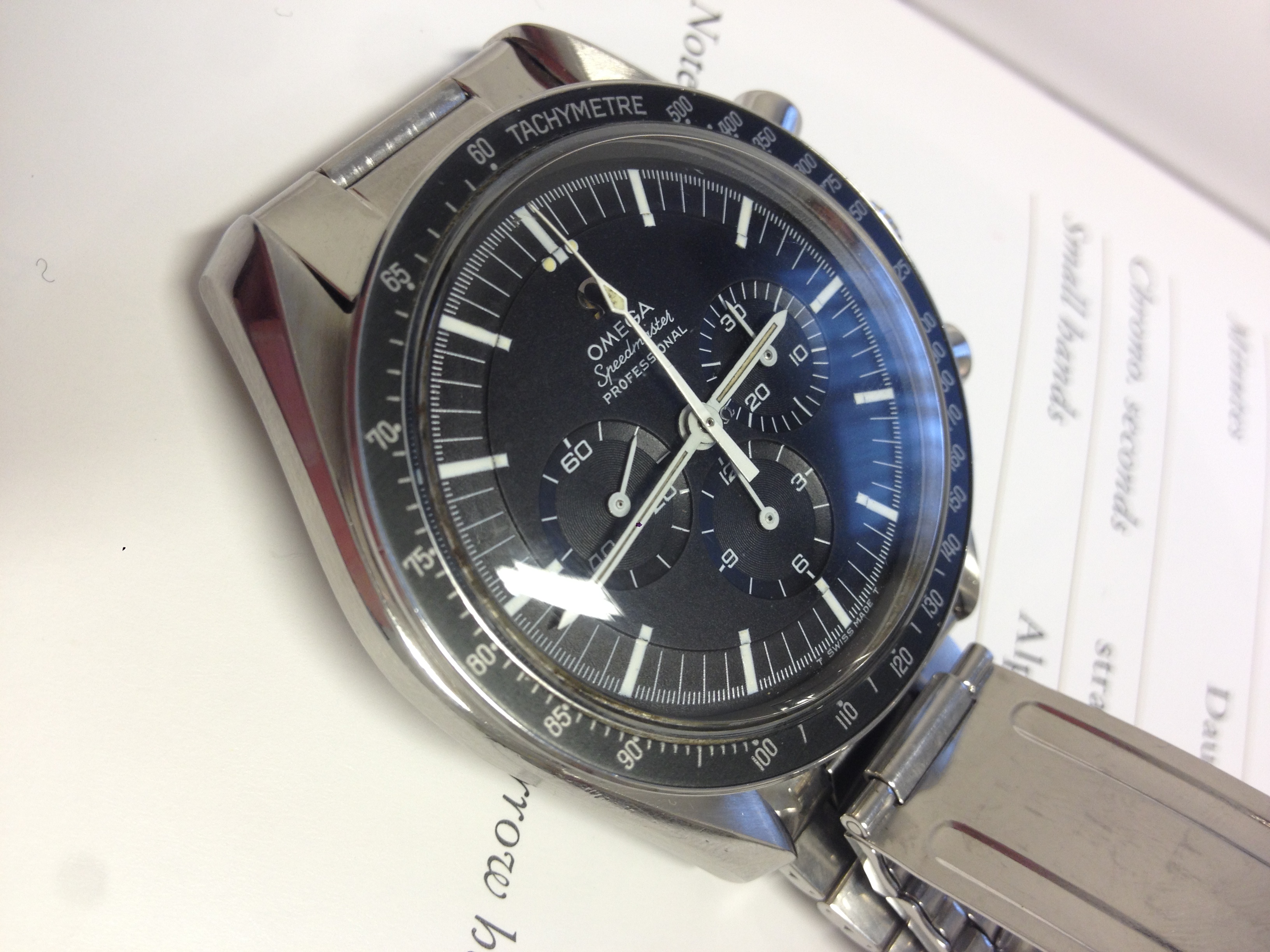

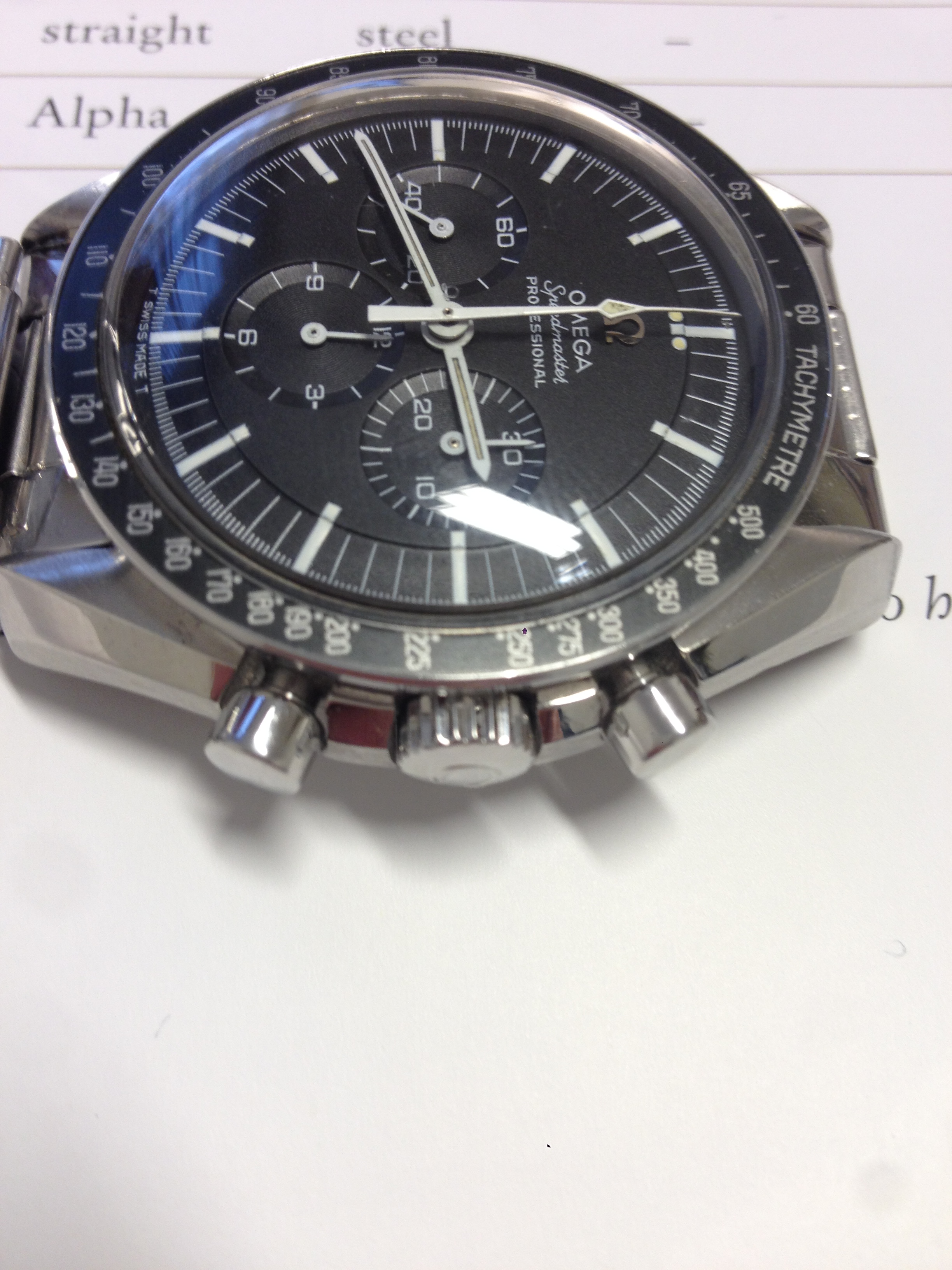

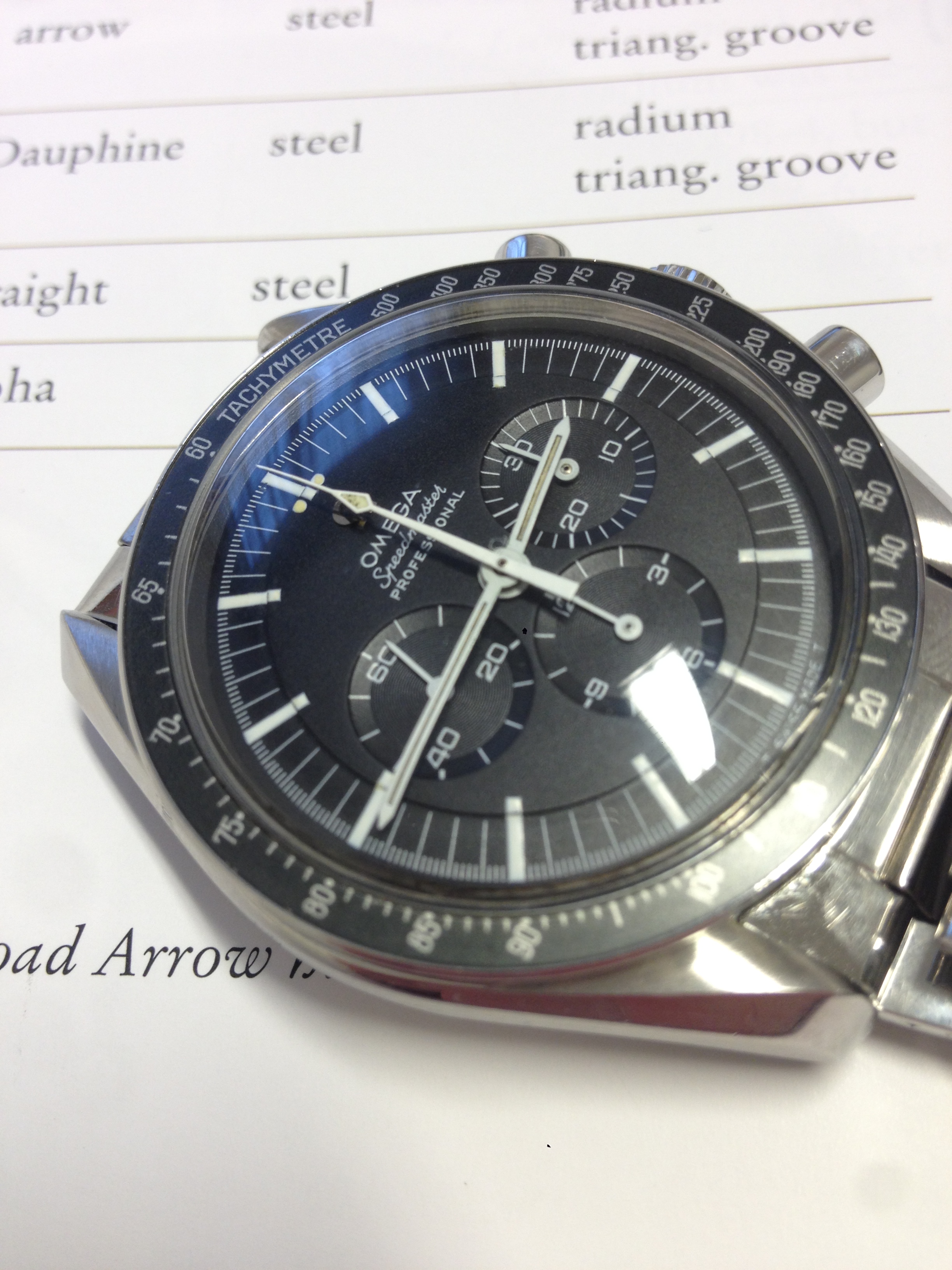

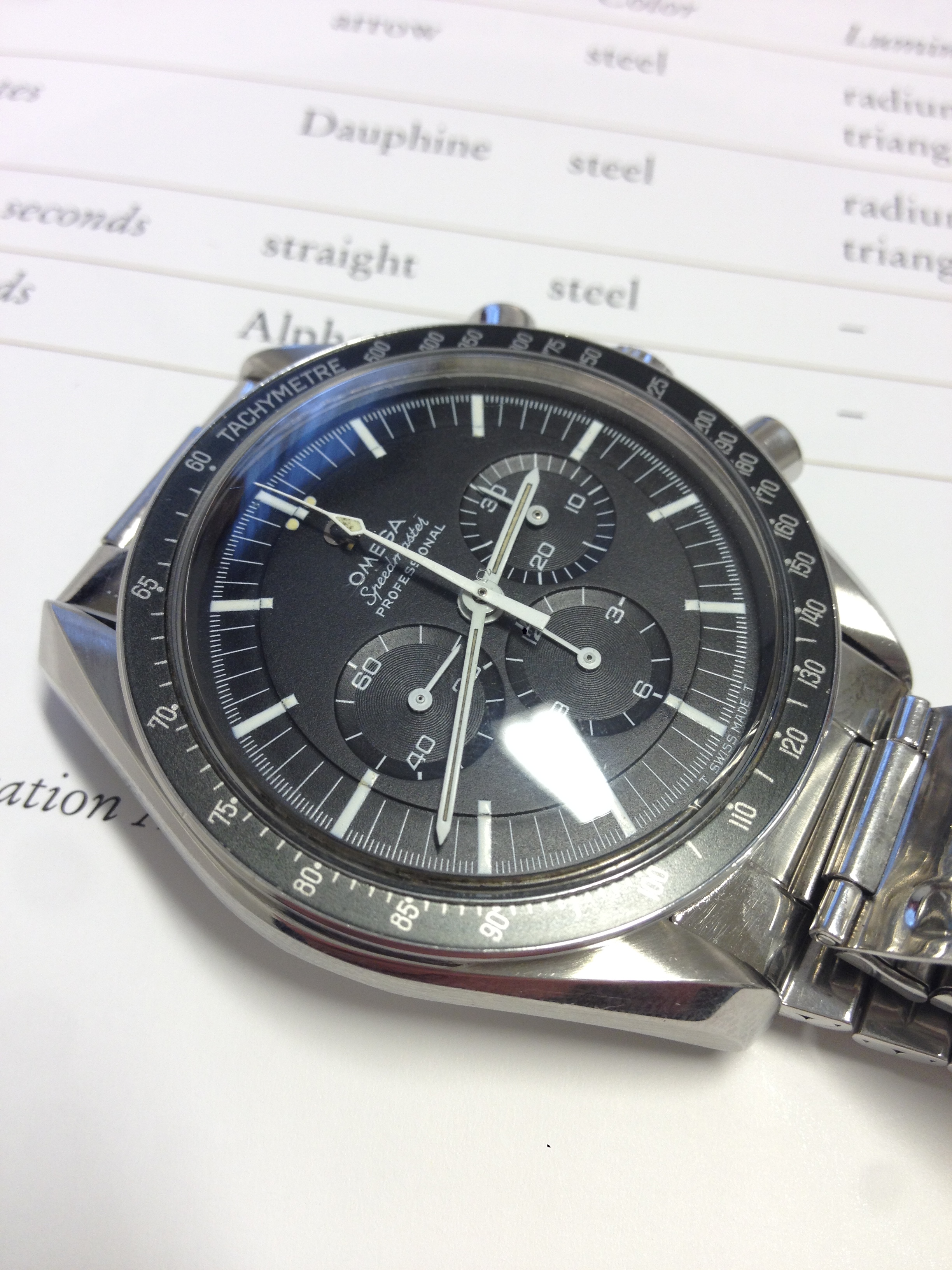

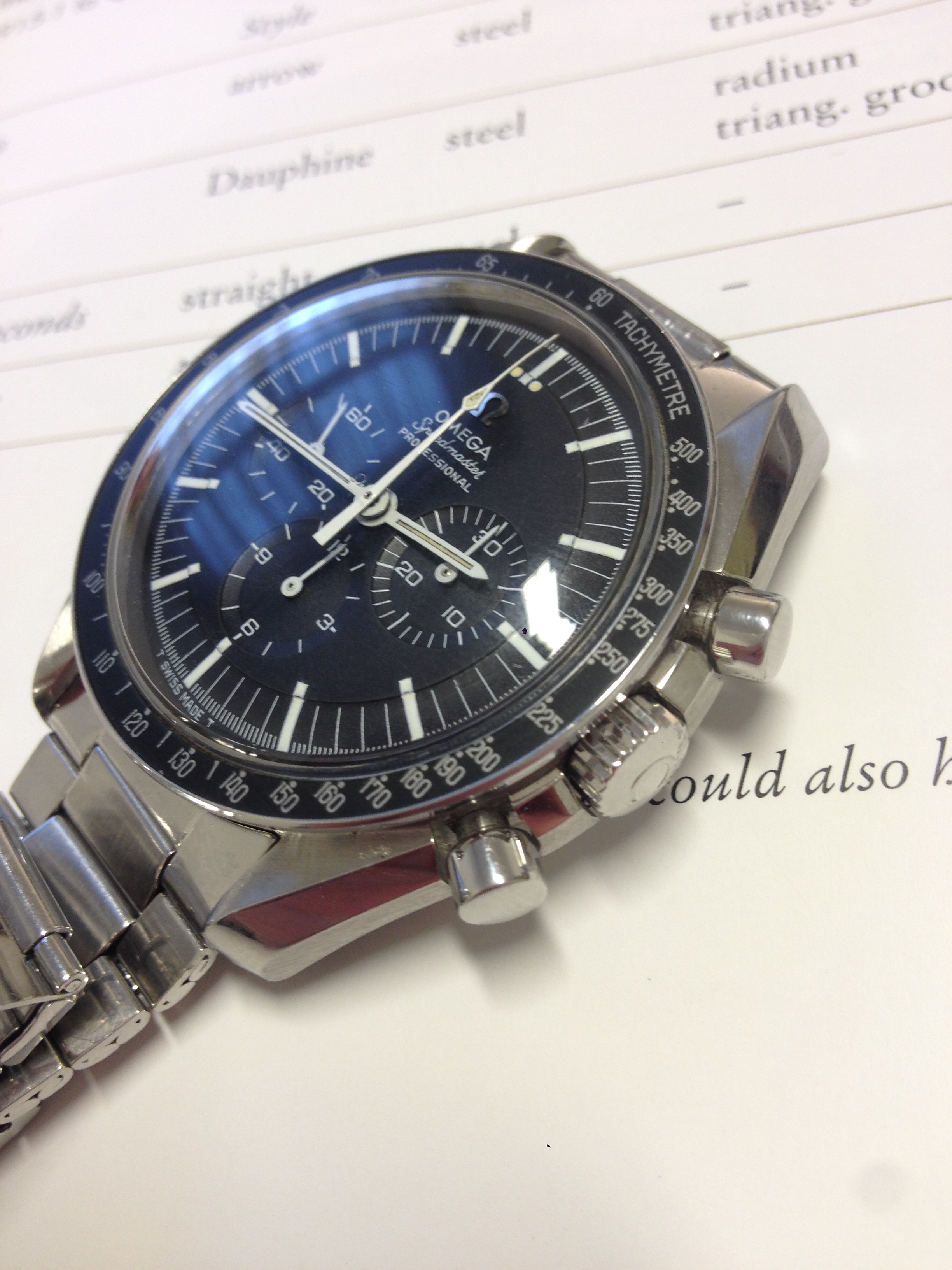

Hello everybody,
I've bought a Speedmaster 145.012-68 (confirmed by the Extract of the Archives) and it's produced on the 13th of November 1968.. I think it must be one of the last 321 watches....
Here some pictures... it's not 100% correct (i think) because of the DN90 bezel and it has a 145.022-69 caseback. The dial doesn;t have any lume at all....i've read somewhere that there are more 145.012-68's without lume....why is it?
5,376
24,550
Hello everybody,
Is the movement 27m?
I would expect to see that number for a -68.
Also the last 321's released by the factory were in 1969 that I have seen, and I would not be surprised if there was an extract for a 321 in 1970 but I have not seen it with my own eyes.

Hello everybody,
Hi. Nice watch!
Can you share any more details on the watch? In my experience, the extracts don't usually include the sub reference. For example, my extracts only says 145.012, but makes no claims about -67 or -68. Does yours?
402
1,203
Goodevening,
The serial number is 26.554.139. And it's correct the Extract only says 145.012 without the -68. I think it must be a 145.012-68
5,861
16,802
Goodevening,
I agree. Good luck finding a correct caseback. A 145.012-68 caseback sold on eBay a while back. Not seen very often
