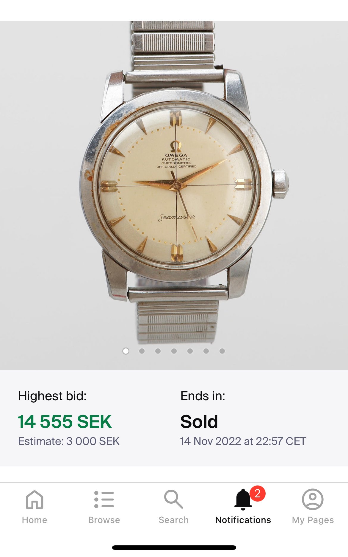

Sold at Swedish auction site in Nov 2022 at 14500 SEK plus 22.5% provision. Maybe it can support your insurance valuation

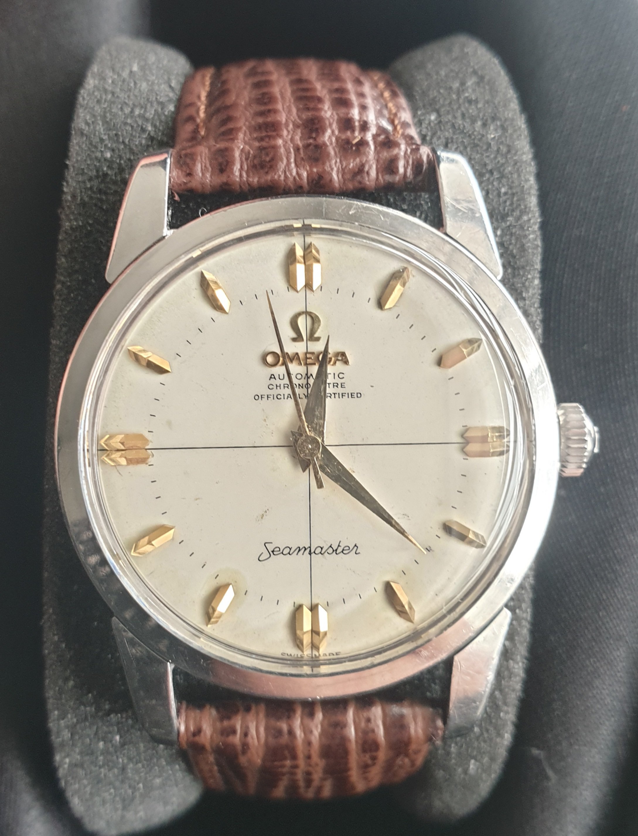

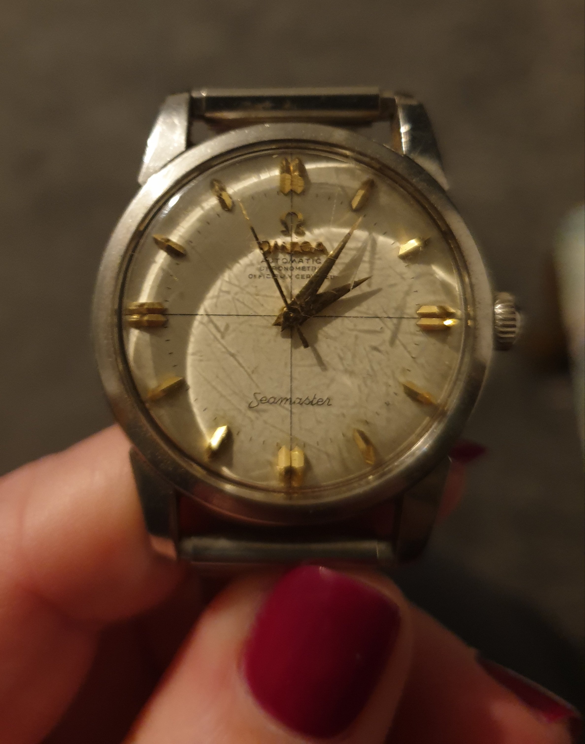

So watch arrived back today from Mitka. Looks lovely and now works. Many thanks for recommending Mitka.
Can't give it to him before his birthday in May so no photo with it on his wrist, but here are the before and after photos.
