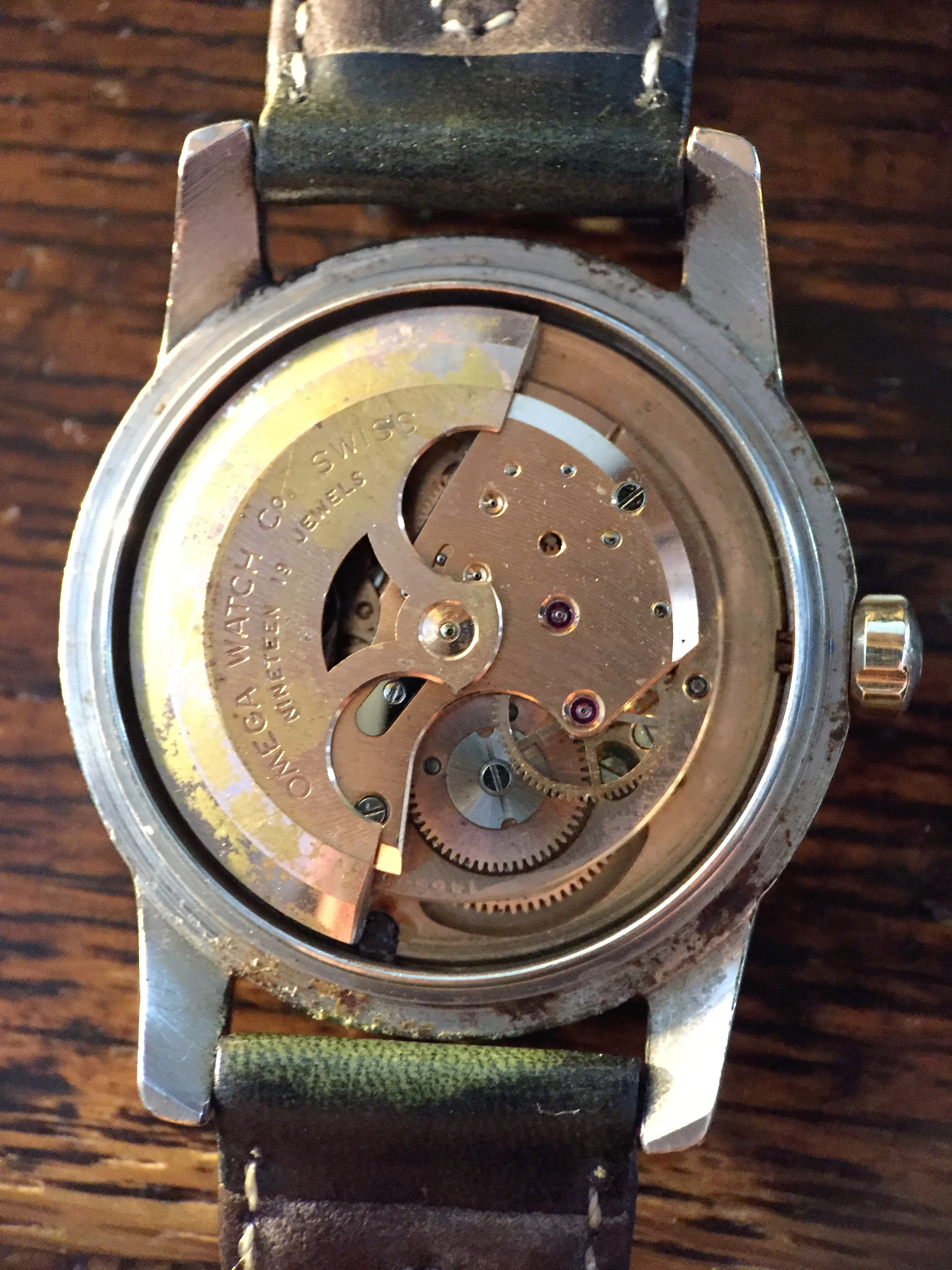

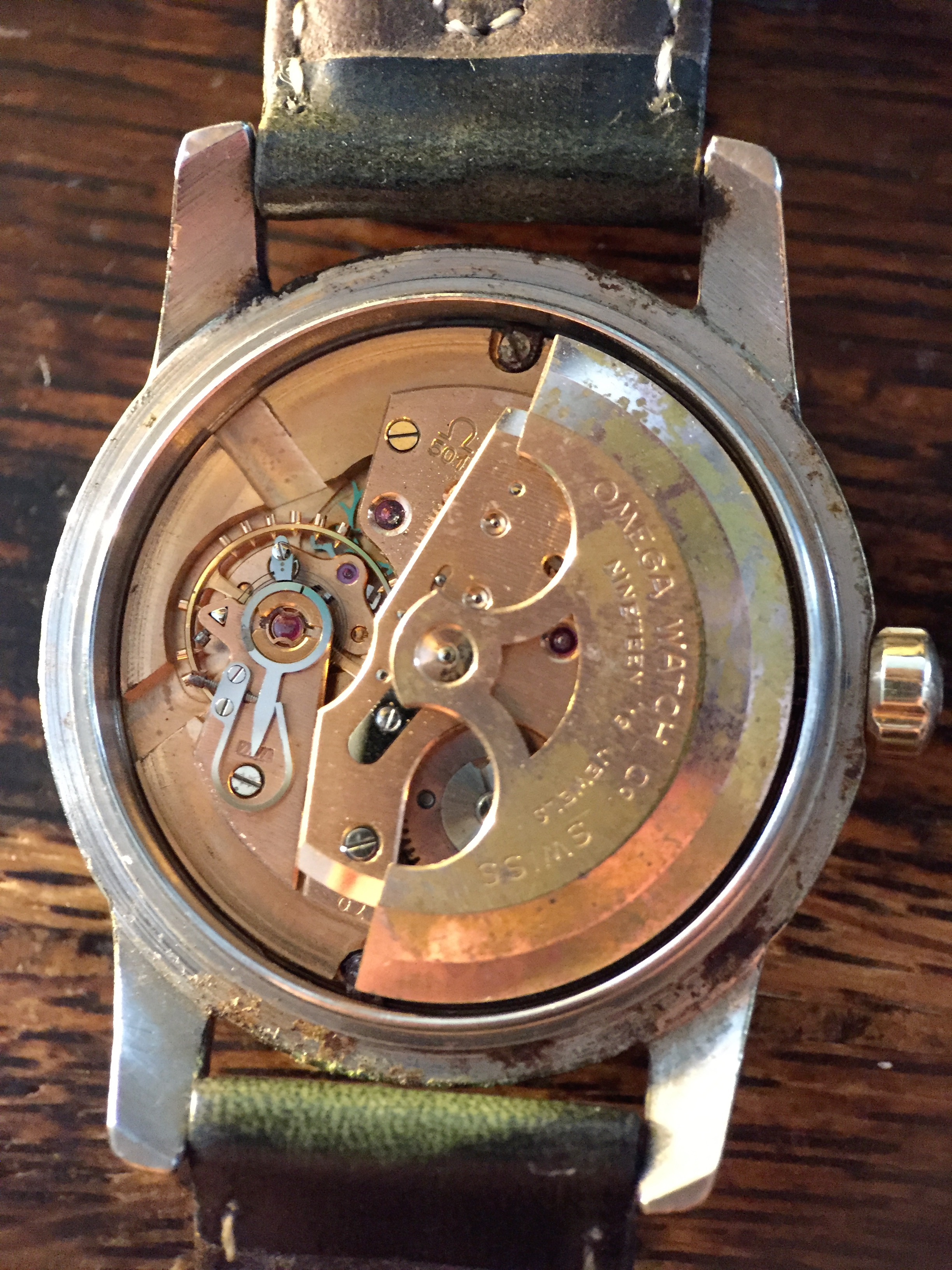

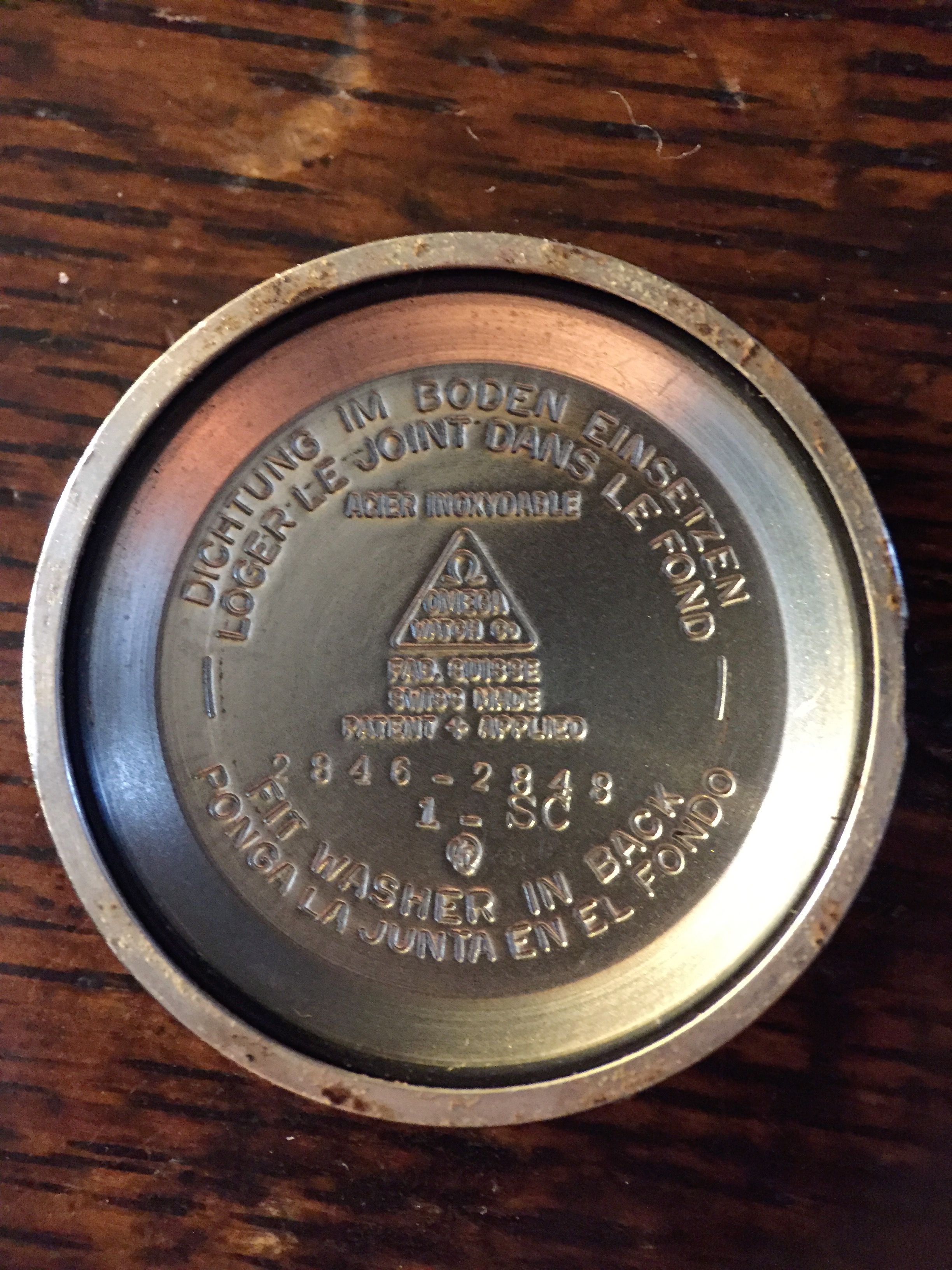

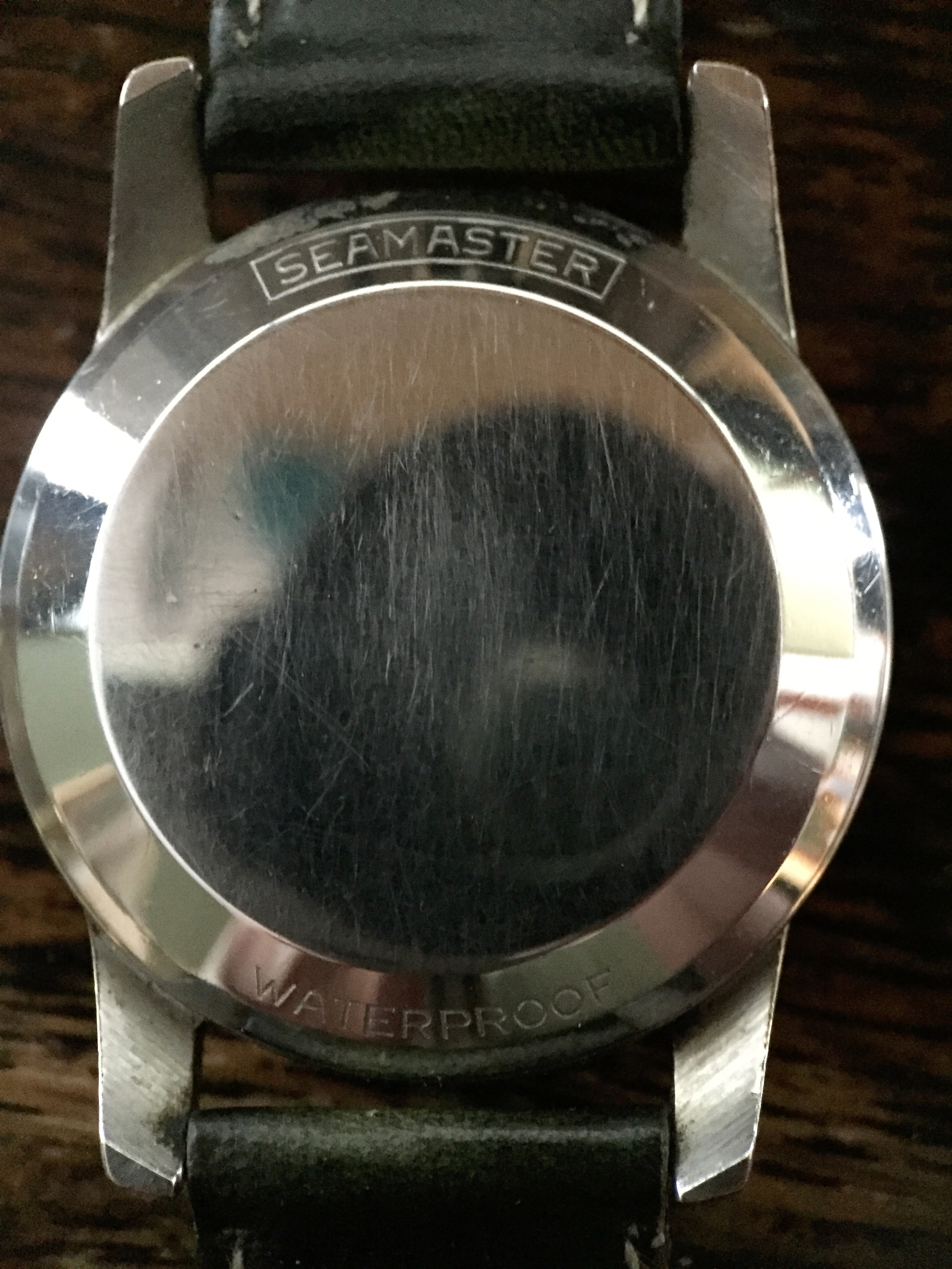

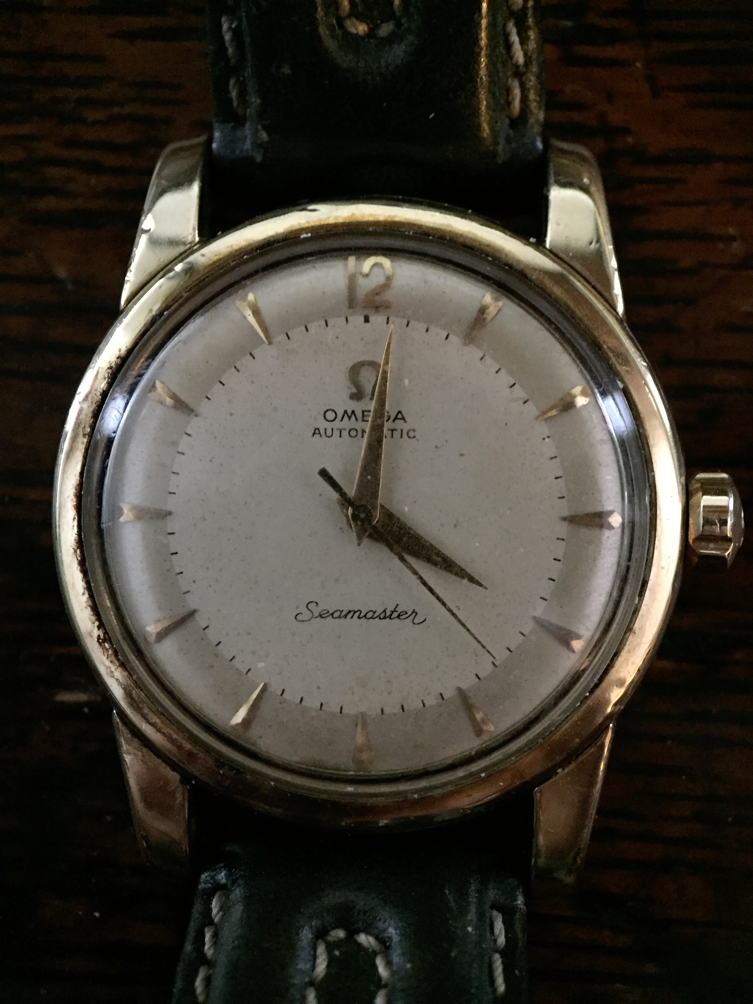

Hi everyone,

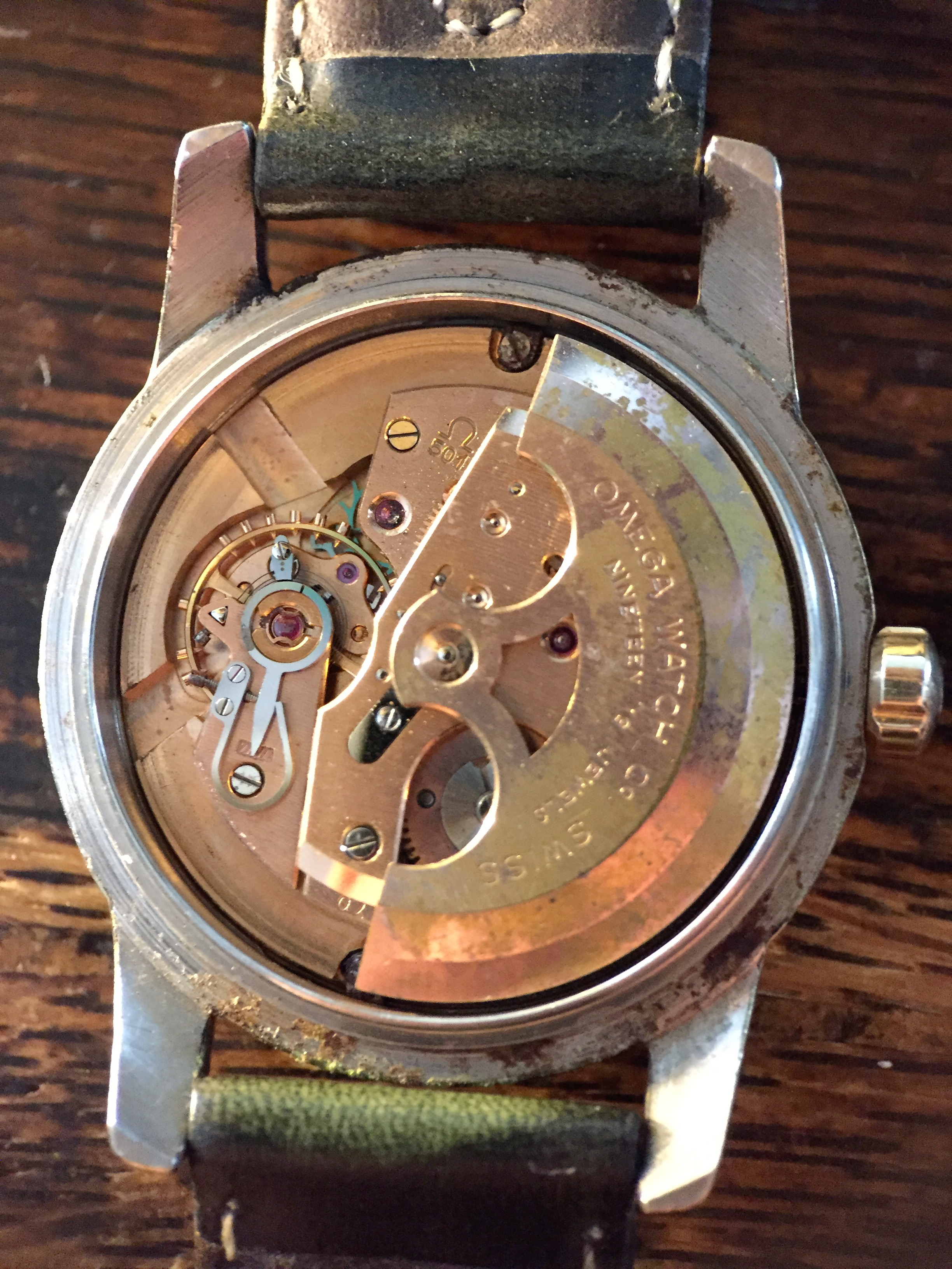

I'm new here but I have owned an OMEGA watch for a long time.
I'm not sure of its exact model. With the pictures I'm sending some may be able to identify it for me.
It belonged to my grandfather. I have a vague recollection that he bought it when I was born in 1956 to celebrate the arrival of his first grandchild and that he intended to pass it on to me one day. When he passed away, I was still too young a teenager to receive such a valuable watch... so it was my father who wore it for a while, until I became more mature... I don't remember exactly when he gave it to me but it was about 45 years ago. He too is gone now.
Over the years I had it serviced a few times at the Birks store in Montreal.
It was my daily watch until about 15 years ago, when I put it aside because I didn't find it accurate enough anymore. It still seems to work but I don't dare to use it without a very good maintenance.

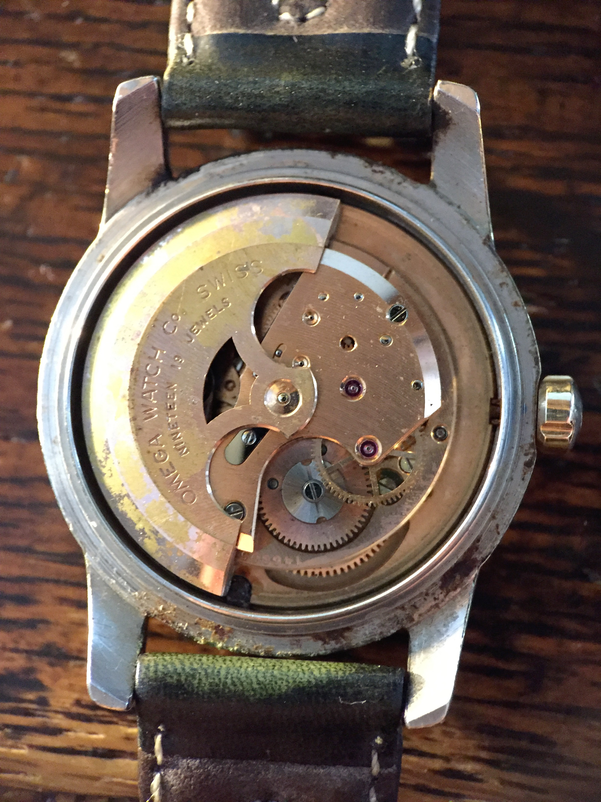

On the pictures you can see unfortunately that it has suffered... probably from humidity. I hope it is not too late to put it back in good working order. I expect this maintenance to be expensive, but I just hope I can afford it...
I have no intention of selling it at all. On the contrary, I would like to pass it on to the first nephew in the family, when the spring of my life has finally come to an end...
I'm thinking of taking it to the OMEGA service center in Montreal (https://www.omegawatches.com/fr/store/storedetails/8262) when I go there for other things in a few weeks.
What do you think, is it in too bad a condition to be salvageable?

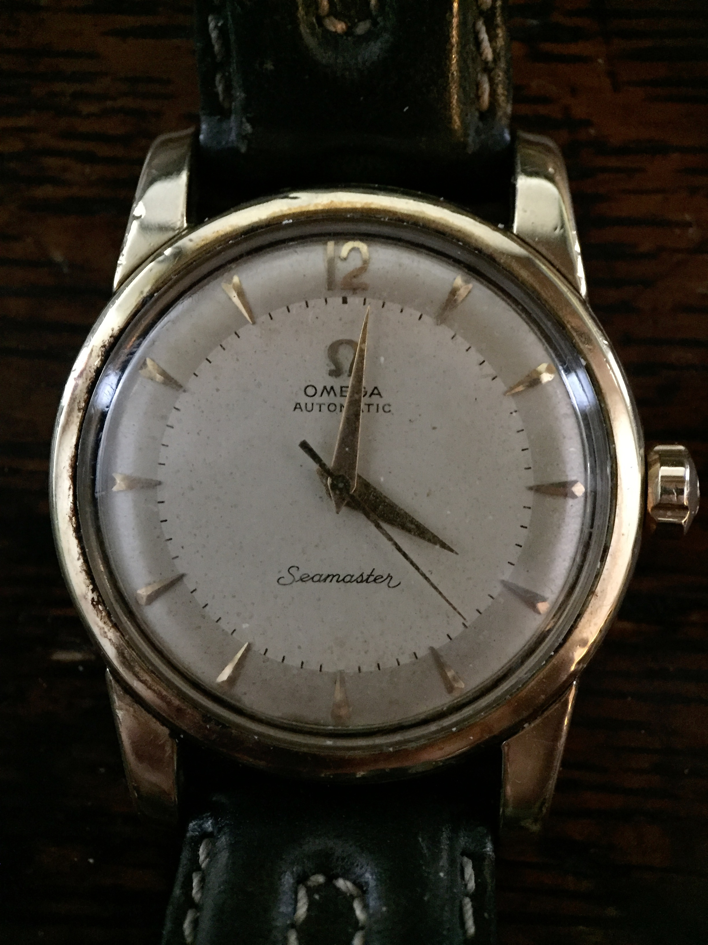

From the pictures you provided, the case looks to me like a gold shell on steel case. As in two-tone. If it is a gold shell case, it should be possible to do an excellent job of bringing the original appearance. BUT, you don’t want to turn the job over to someone who will do a heavy handed job of aggressive polishing. If the finish can be brought back 50 to 75 percent (rather than made perfect). I think you would be happy with it.

@Canuck
Thank you for your answer.

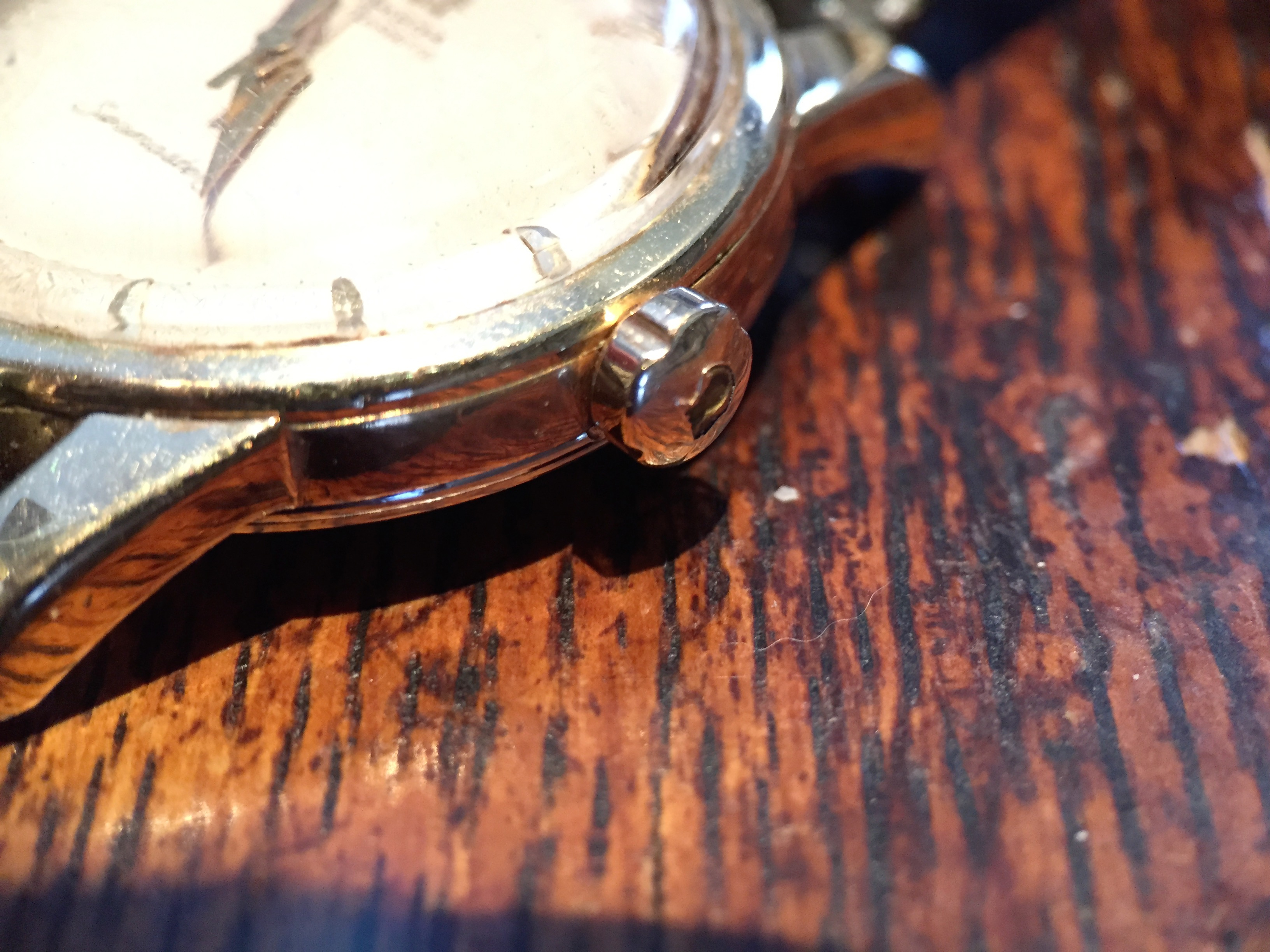

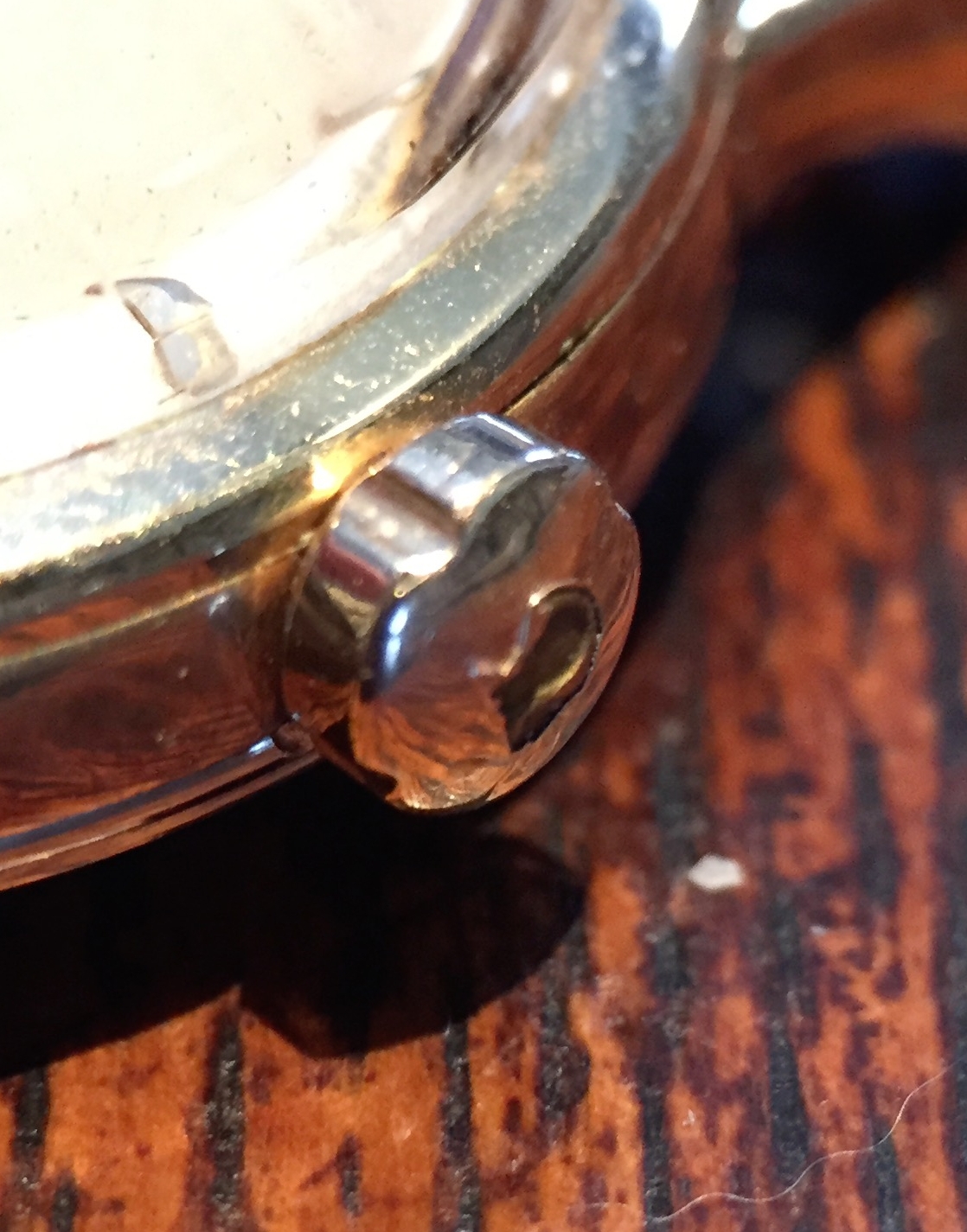

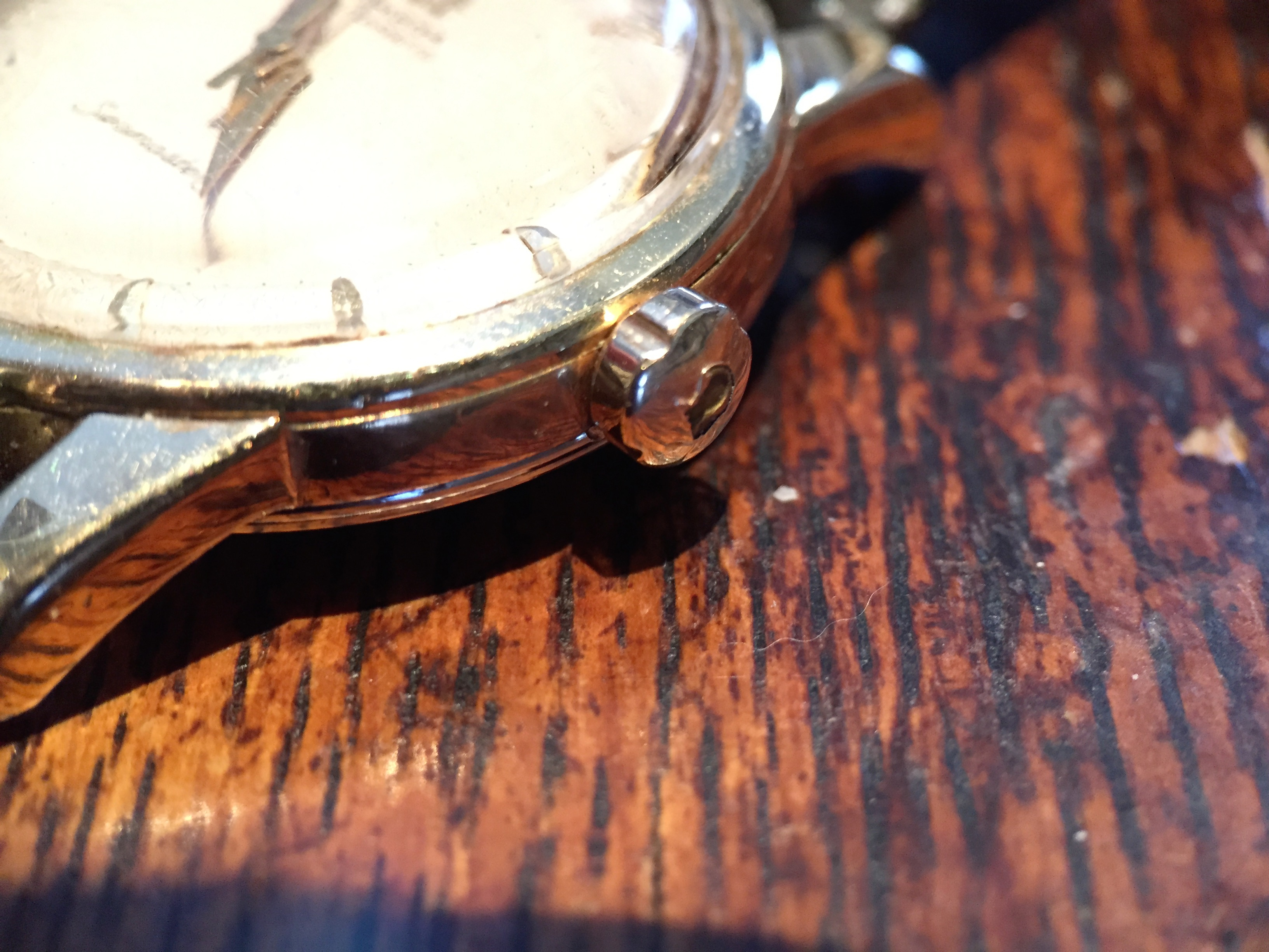

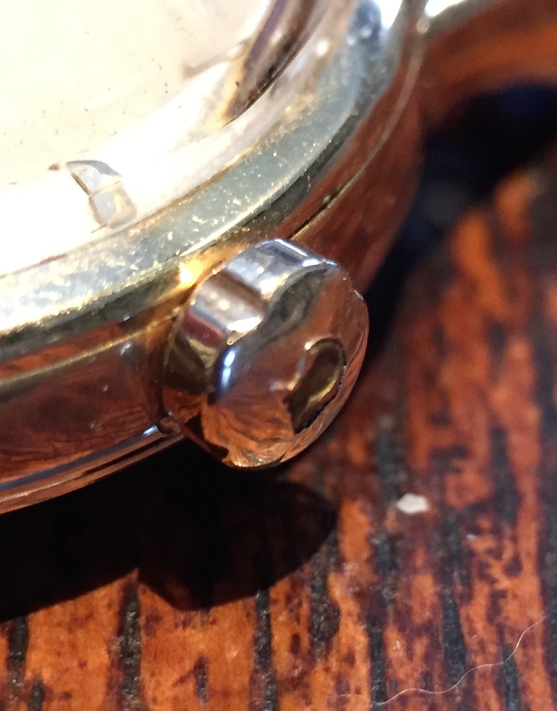

Yes, it seems to be a watch with a gold shell applied to a steel case. The reading I did seems to indicate that this was a common process of OMEGA at the time it seems to have been made. One can easily see that a section (plate) of the gold covering is missing at the level of the letter "Ω" in the middle of the crown.
I don't know exactly what model it is, nor what year it was made.

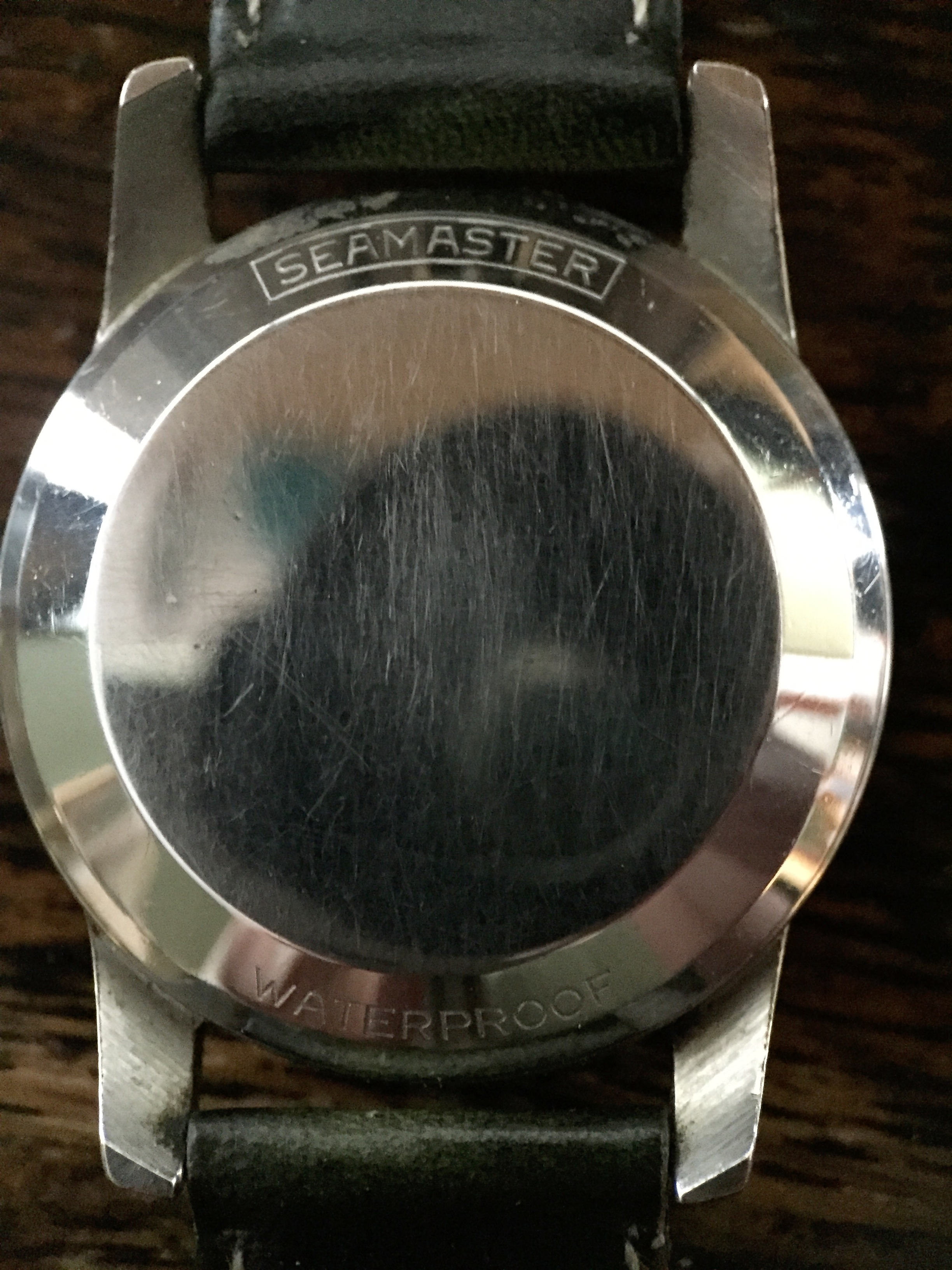

I'm a little concerned about the amount of corrosion that can be seen on the back of the case as well as on the mechanism screws and their anchoring in the case.
The cost of the repair worries me a bit... I am ready to make a financial effort but my resources are still limited.
Do you think that the OMEGA service center in Montreal is the right place to have the type of maintenance and polishing you suggest?

From a functional point of view, there’s nothing wrong with that watch that a good service wouldn’t put right. It’s very dirty and a clean up wil make a big difference.
Don’t expect it to be waterproof. Leave the case alone except for cleaning - no more polishing. Personally, I’d do my best to keep the crown, even with the wear.
You’ll be happy, I’m sure.

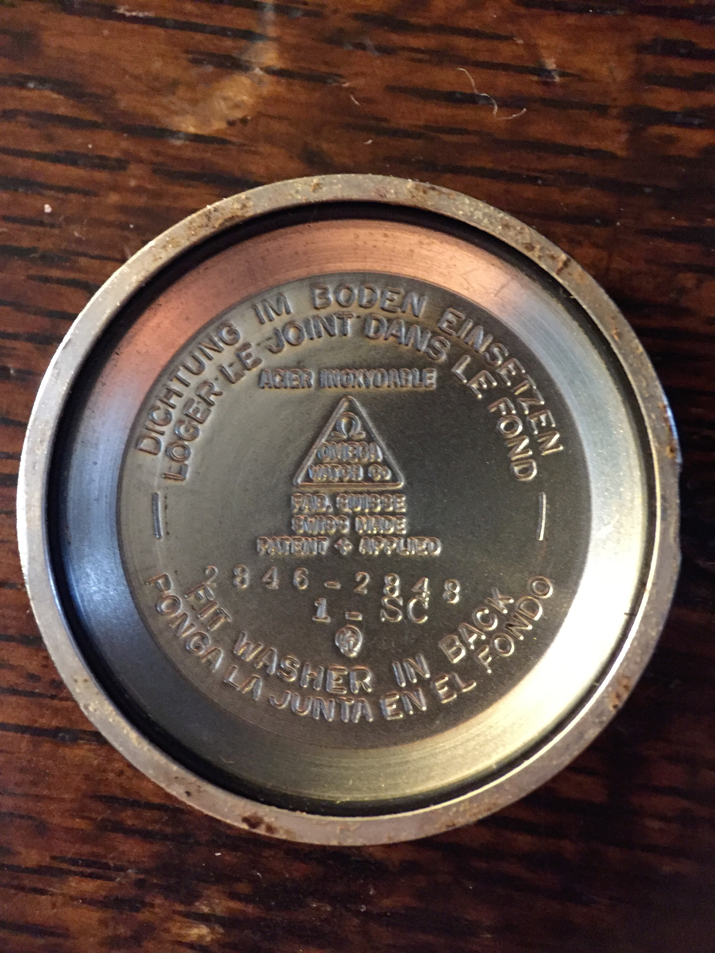

The reference number is 2848. I think it will clean up well with some attention by a good watchmaker. The corrosion on the case is likely to be superficial, and some of what you are seeing is just dirt. Some parts in the movement are discolored, which does not affect the functionality of the watch. However, it does suggest that there may have been some water intrusion, so some repairs and replacement parts may be needed. I think it's quite difficult to know the exact cost in advance, but I'm pretty confident that your budget will cover it.
In your place, I would feel more comfortable identifying a particular individual to work on my heirloom, instead of handing it over to the anonymous techs at the factory store.

The cosmetics could be a possible money pit, but if you don’t mind that it shows some wear: Don’t give up. Cal 501s were produced in large numbers and even full spare movements without rust are available on eBay regularly for less than 200$. As stated above, a service by a watchmaker can be had for a couple hundred USD, too. I hope this’ll make it an affordable project for you - the story is certainly worth it.
