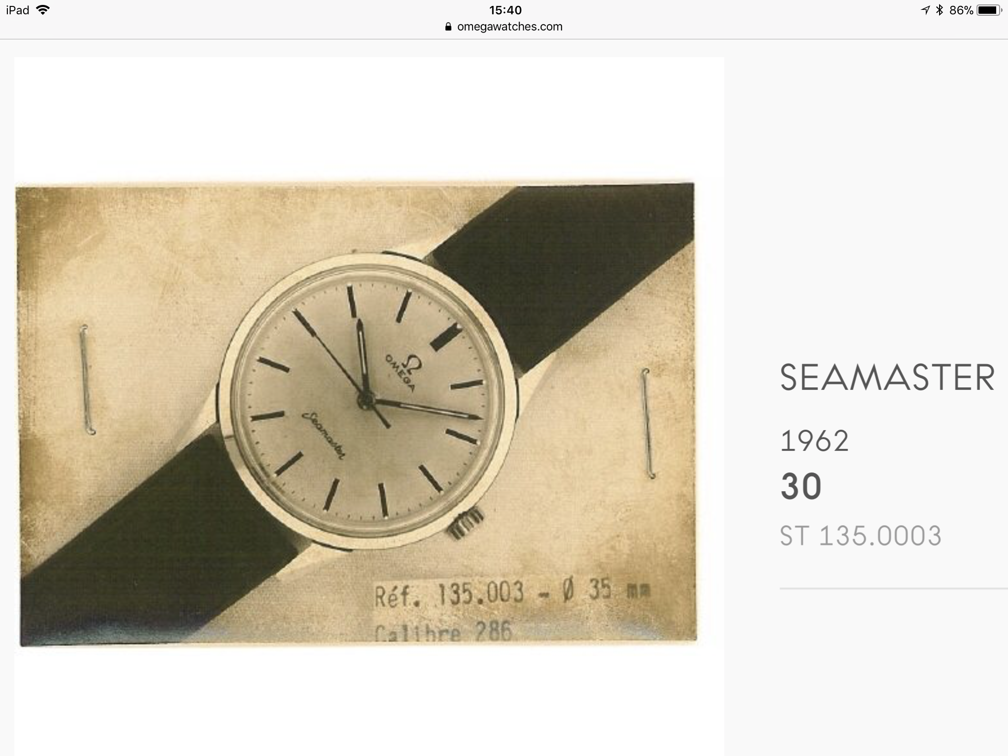

It is serviced and comes fully serviced with 1 year guarantee and 30-day returns. Little bit polished but otherwise really nice condition imho. With some negotiating I might get it for something in the range of 850 Euros.Overpriced or reasonable?
1,325
1,870
Looks pretty good to me. Searching the Omega Vintage database i go this
Lug definition looks sharp, and i cant see anything wrong with the movement ( but i am no expert here)
1,727
5,960
I used to have one of those SM30s...they're very nice watches. As you say it is polished, and mainly that's been done due to that caseback - it's been gouged out before with tool marks and dents, which suggests some previous attempts opening it unprofessionally and the odd drop onto an abrasive surface.
For that condition I'd say it's overpriced. @Henneth have you had a look in the Private Sales Forums yet? All of these will be priced fairly and are solely held by fellow members on the forum :>
