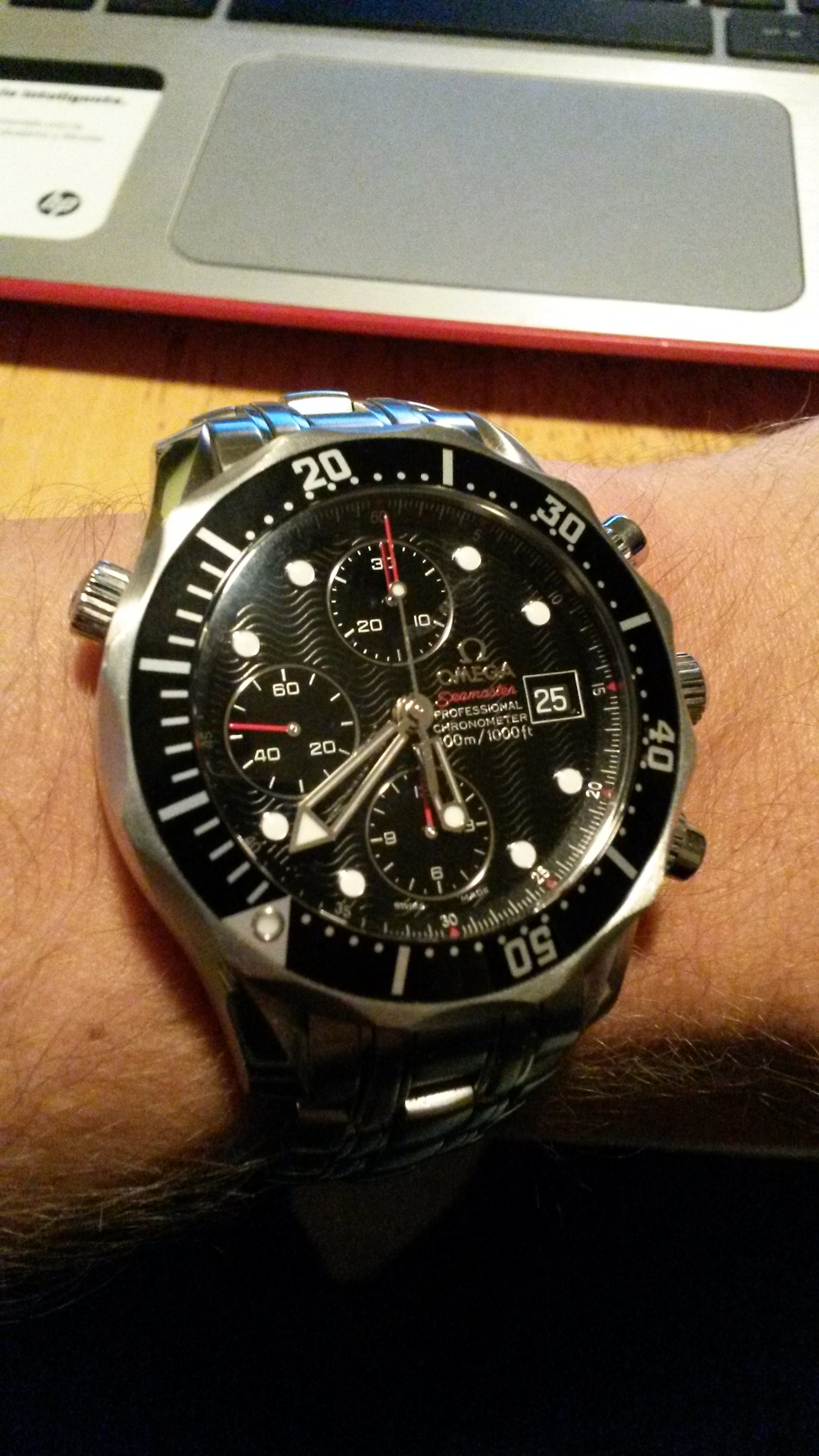

Hi guys,
I just bought my first Swiss watch, it´s an Omega Seamaster cronograph from the mid-2000´s. The guy that sold it to me is a collector of Swiss watches, and he advised me that you should only use a fine watch´s cronograph once, to test it before buying it, and then never again. Is anyone on board with this guy´s line of thinking or should I be free to use it as much as I want? For me it defeats the purpose of spending a lot of money on a watch if you can´t use it for what it was made for.

Use it as much as you want mate, what you have there is a Calibre 1164 which is an upgraded ETA 7750, one of the most durable and reliable chronographs ever made. Also one of the easiest to service and maintain, don't hesitate to use the watch and the chronograph.

I will say though that its likely about 10 years old which means it probably needs a service already. Even if its keeping good time it doesn't change that fact, it needs to be cleaned and lubricated to prevent wear. Get a quality independent watchmaker to do it and then use it as much as you like until its next service is due.

I use my chrono's dozens of times a day...everyday...and never have any problems, that is what they are designed to do, be used. Whoever told you this is not knowledgable about watches.
As already mentioned, your well overdue for a servicing, probably 5 years overdue.
If the watch is a keeper best to have it looked at before it gets damaged from lack of lubrication.

Hi I have the same watch. It's an absolute beauty. I have my chrono on as I like the sweeping hand.the watch keeps great time. Don't think the guy knows what he's on about.its a robust piece so enjoy it

Thanks guys for your input! The watch had never been opened before when I bought it, so do you still think that it´s due for a service?
The reason I know that it hadn´t been opened before is that during the transaction I insisted that I have a jeweler open it up to prove it´s authenticity, and the guy all but threw a hissy fit saying that since it had never been opened it´s worth more, and the second it gets opened it goes down in value, so if I decide not to buy it after opening it he would now have a less valuable watch. He showed me how the two red dots on the back aligned perfectly which means it had never been opened. Since I insisted that I wouldn´t but it unless I had it verified, we struck a middle ground where I paid him for the watch but he stayed in the jewelry store fore the authentication. Well the jeweler opened the back to show me the movement, told me it´s the real deal, and put it right back on.
Thanks Noelekal for the comments. It had never been opened before I bought it. During the transaction I had it opened for around 30 seconds to verify its authenticity. Do you still think it´s due for a service? There was not a scratch on it and previous owner says he wore it in rotation if that matters.
128
64
It doesn't matter on the usage, the oils in the movement will age and need changing - just like your car. It's a worthwhile investment to insure years more of problem-free running.
