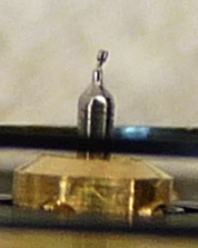

Result of wearing an unserviced watch regularly:
