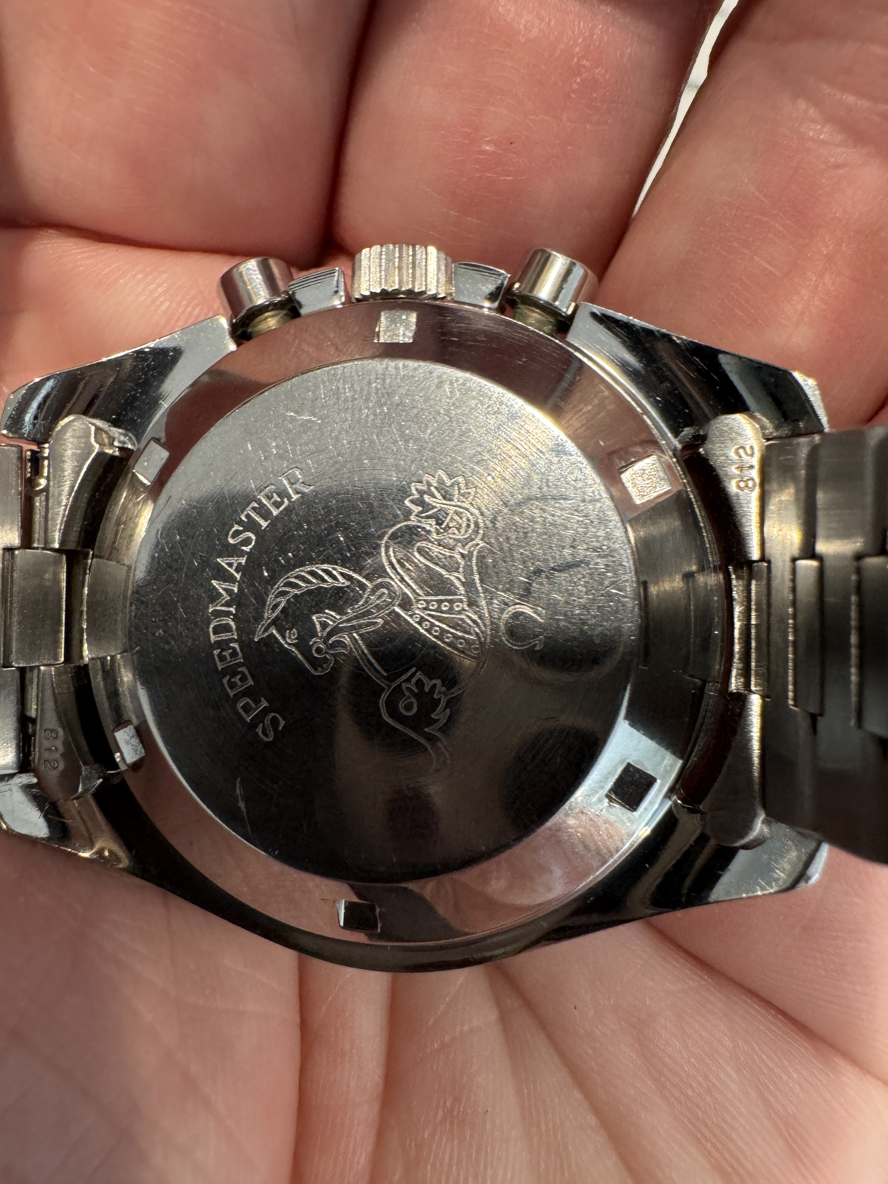

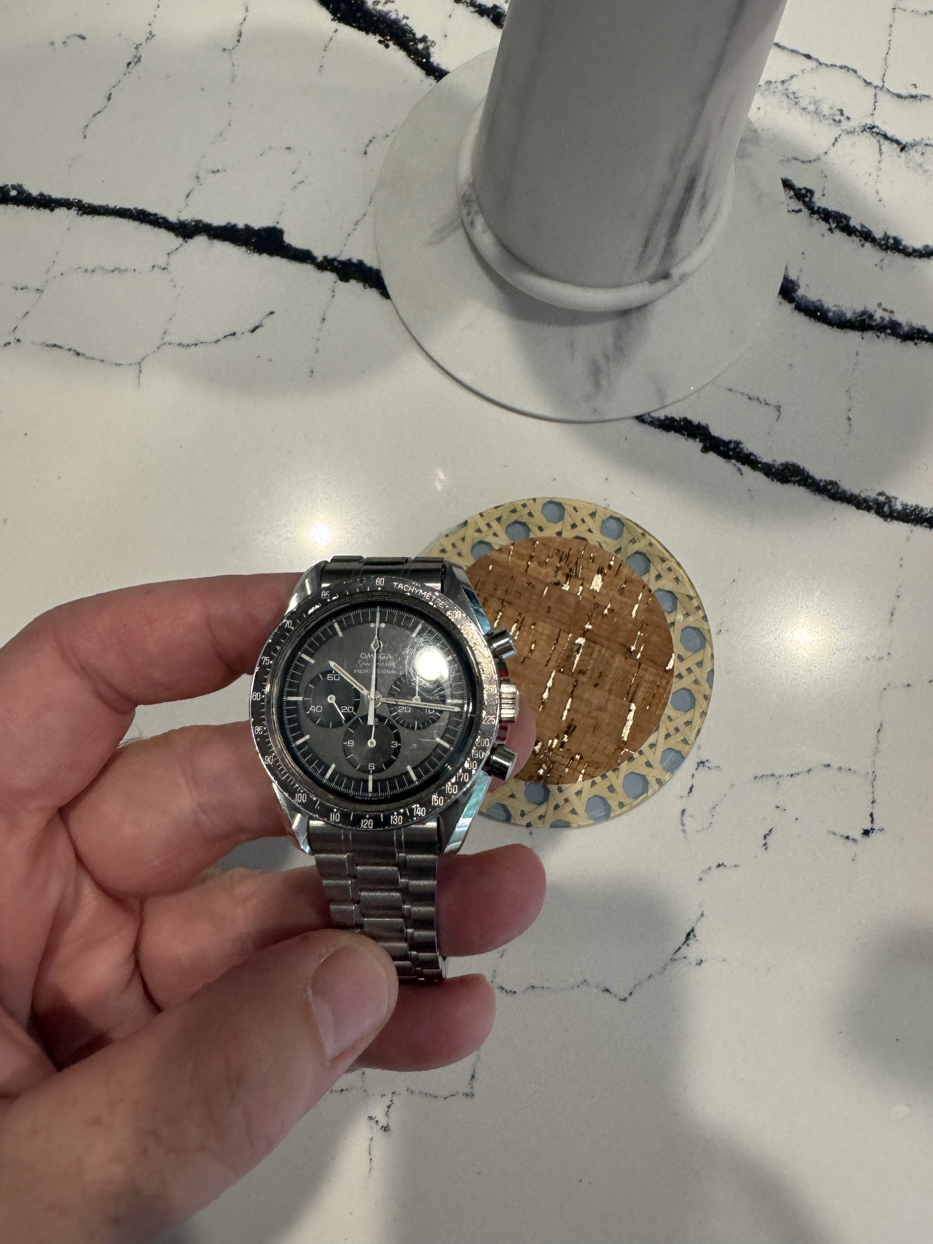

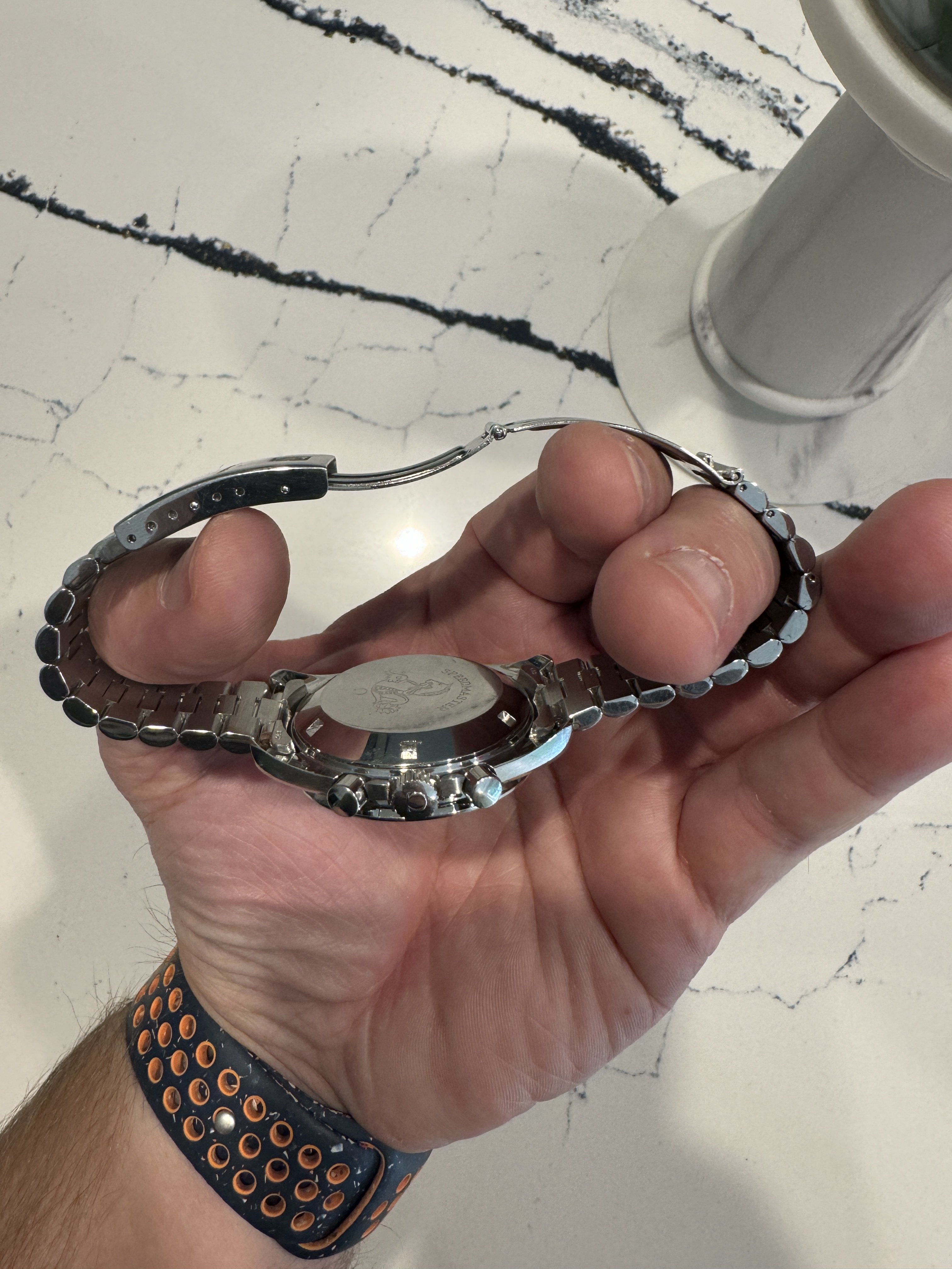

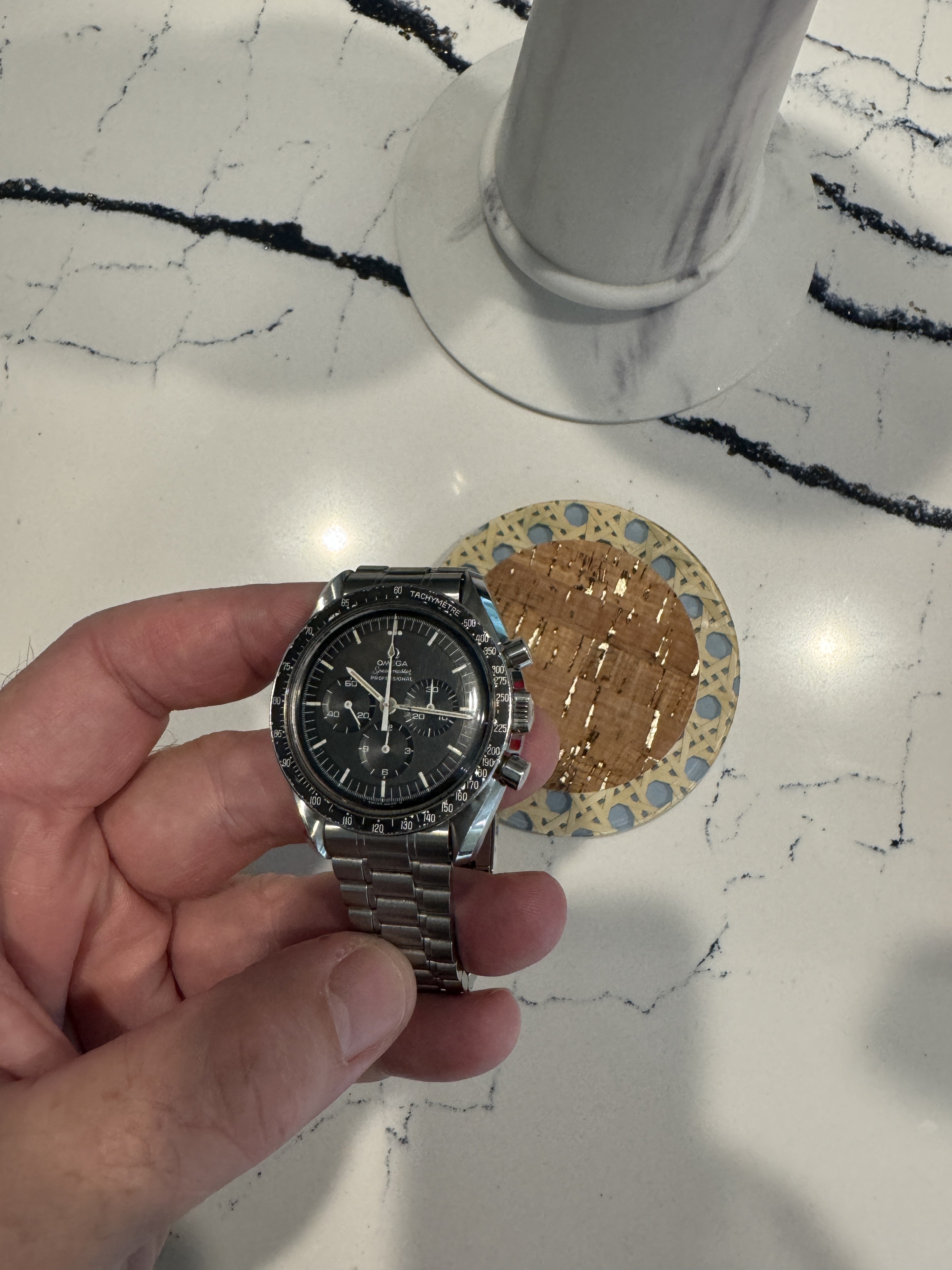

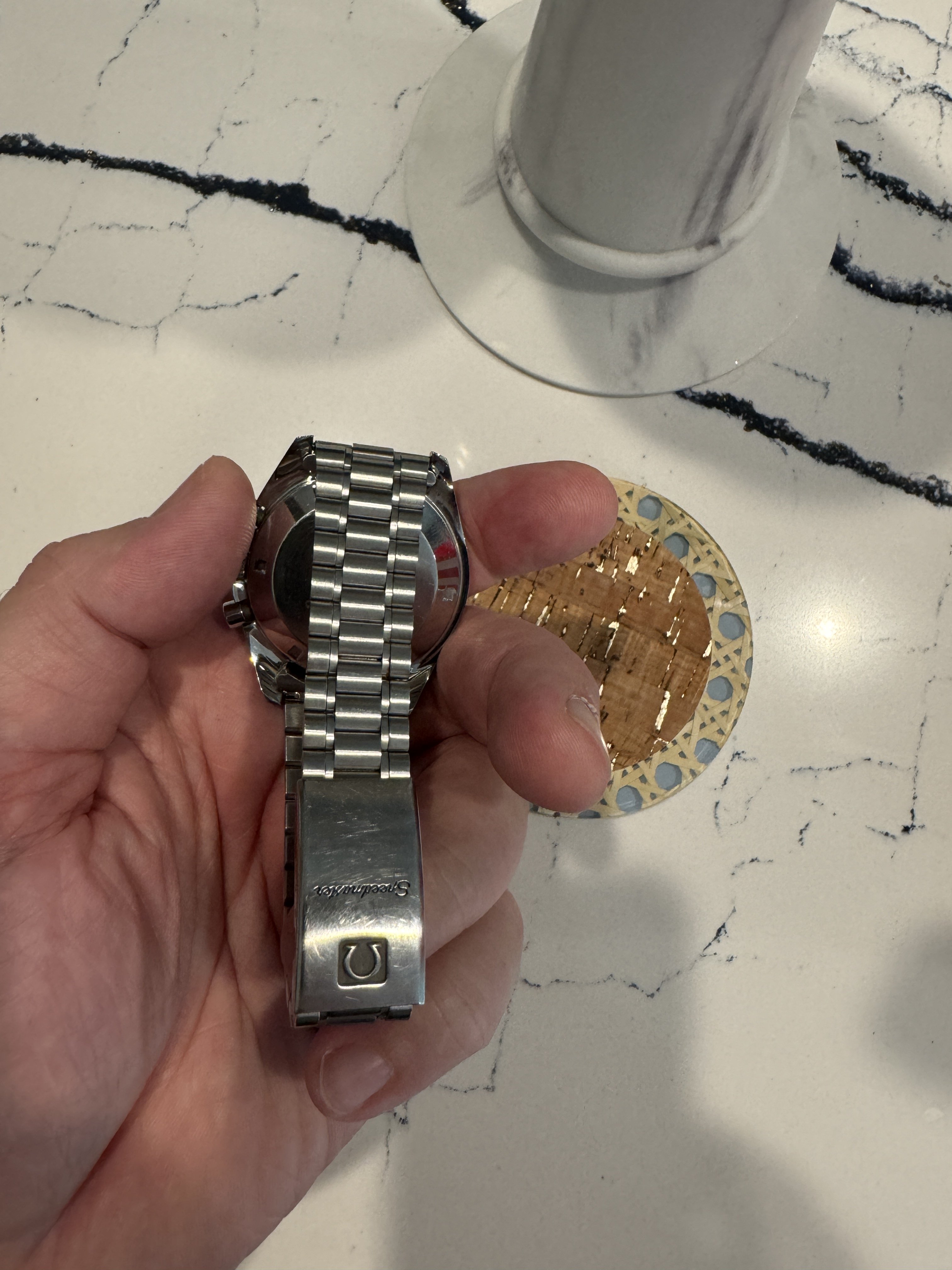

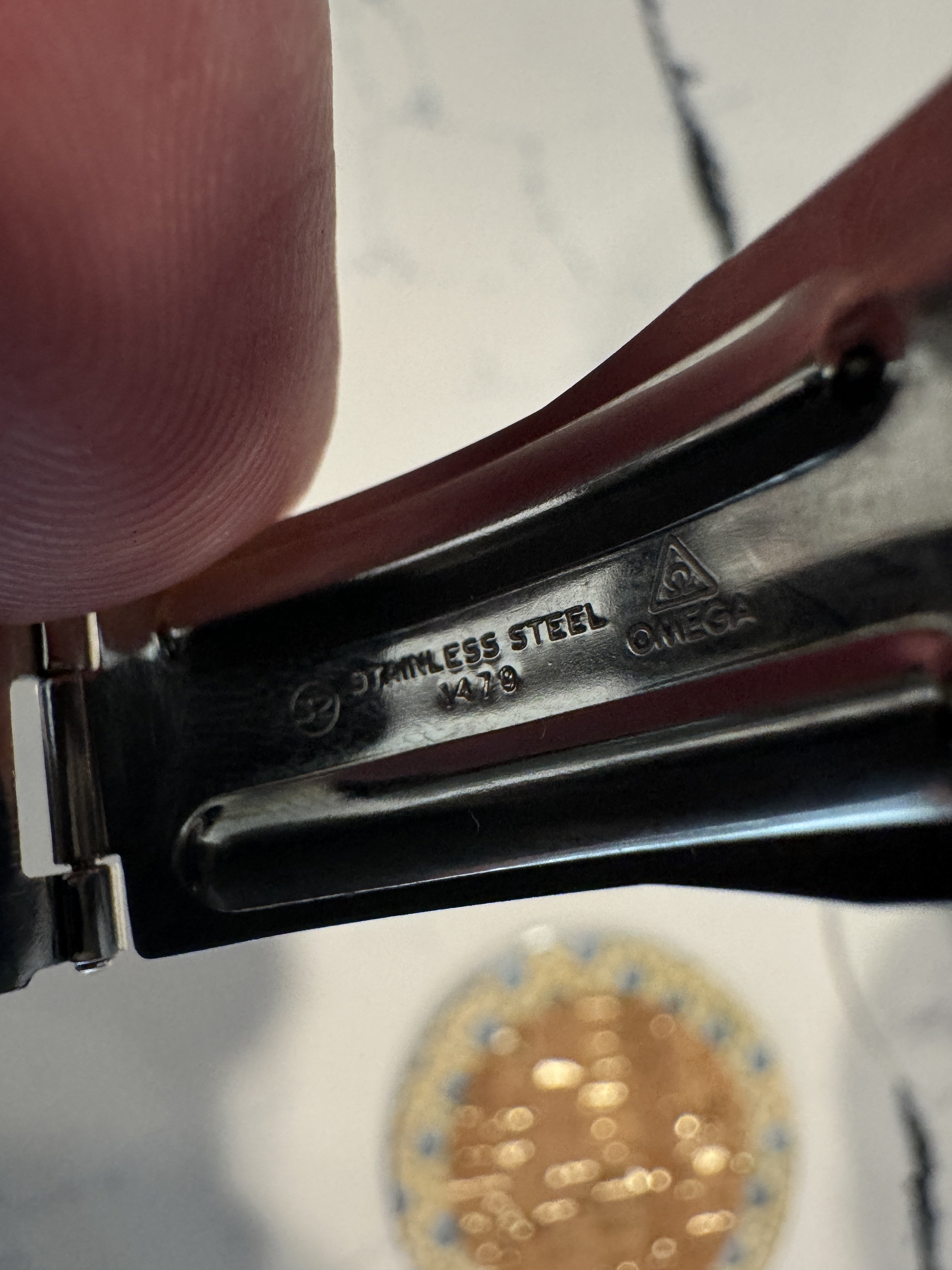

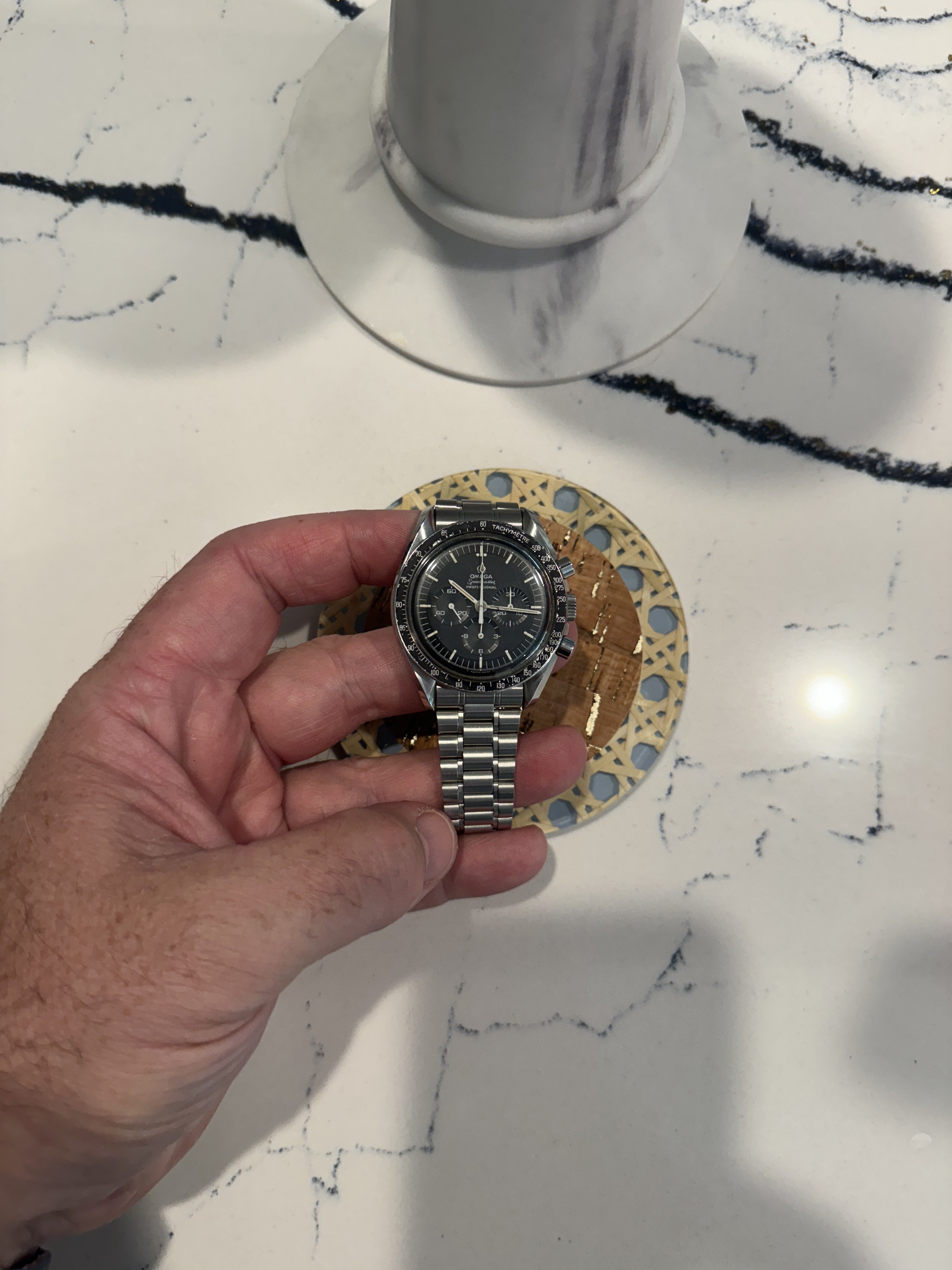

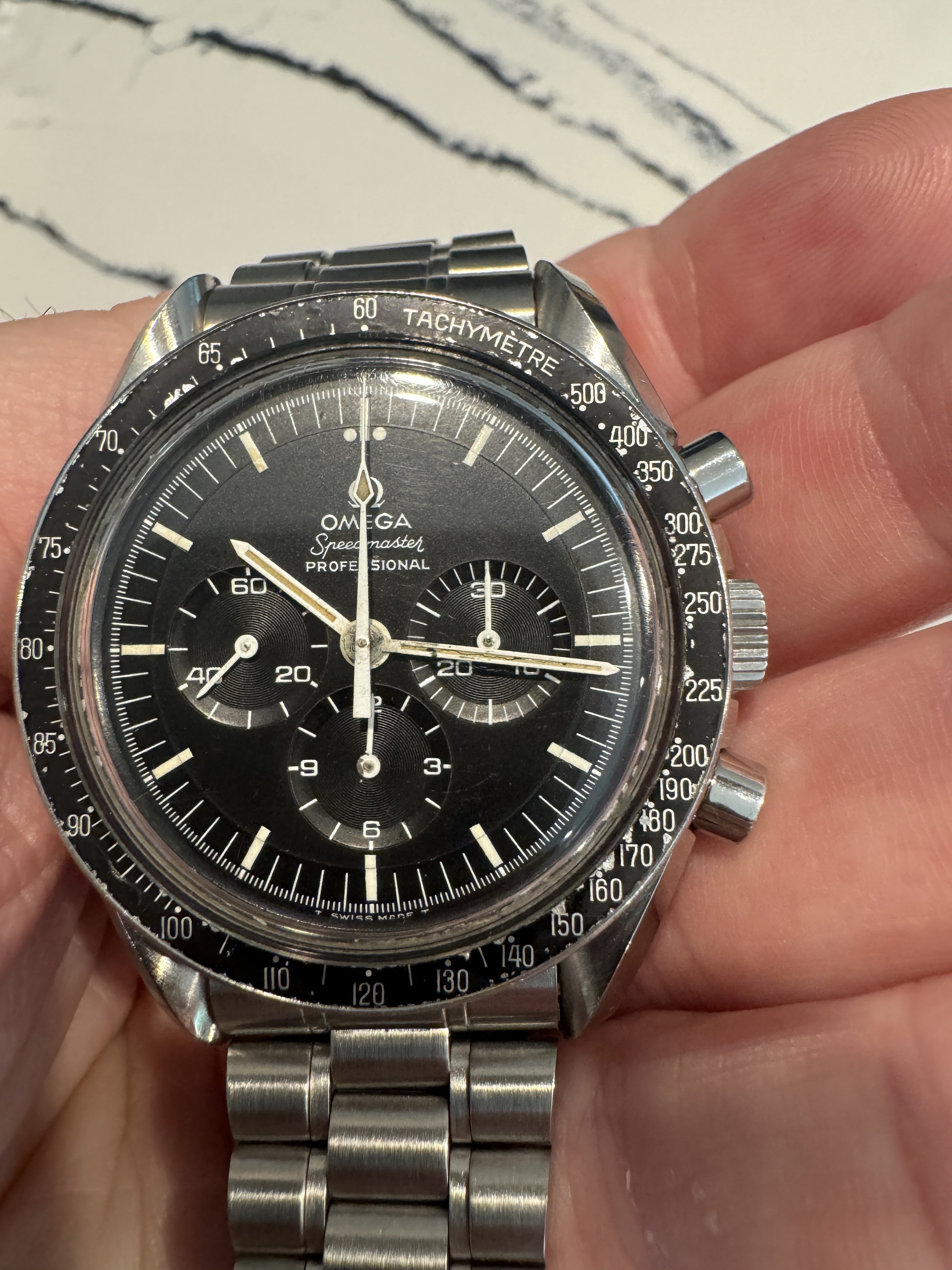

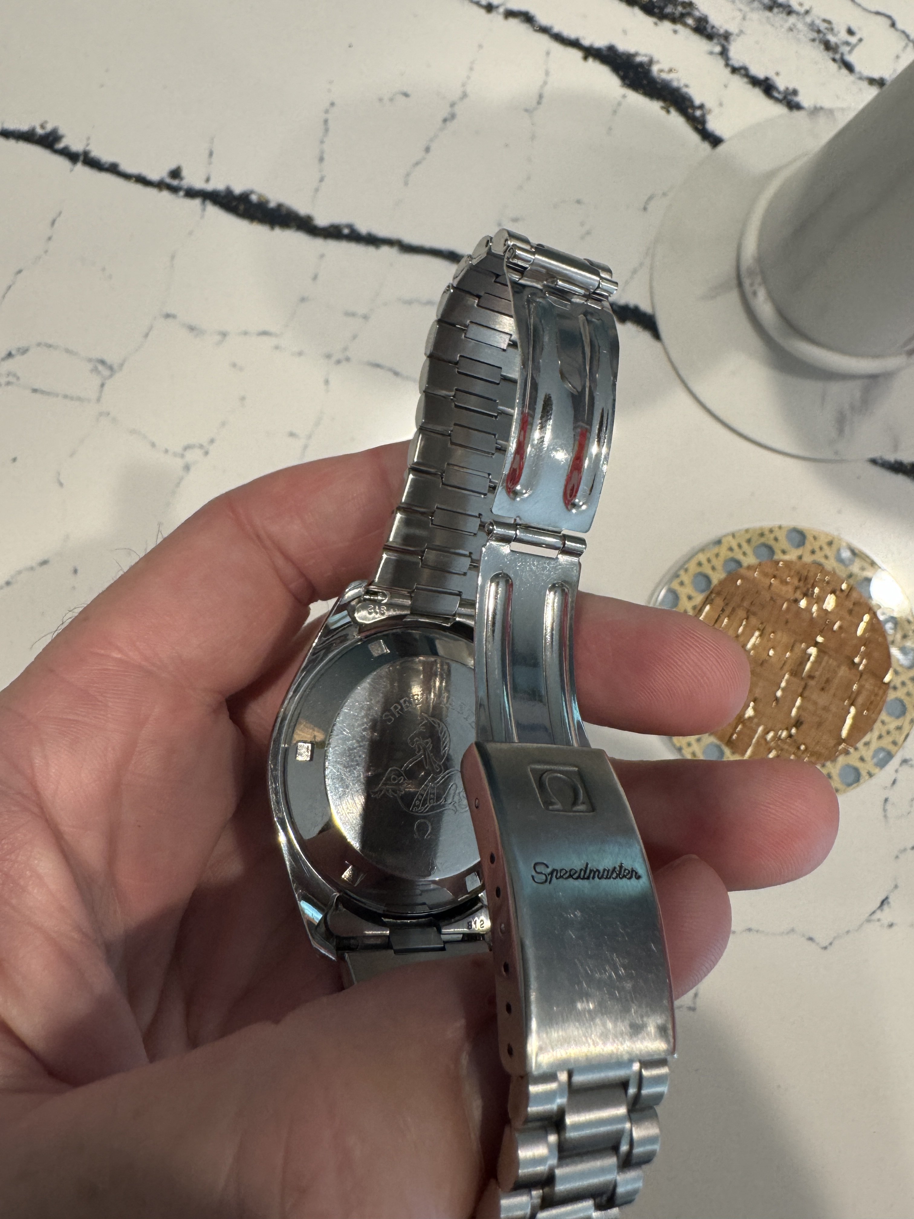

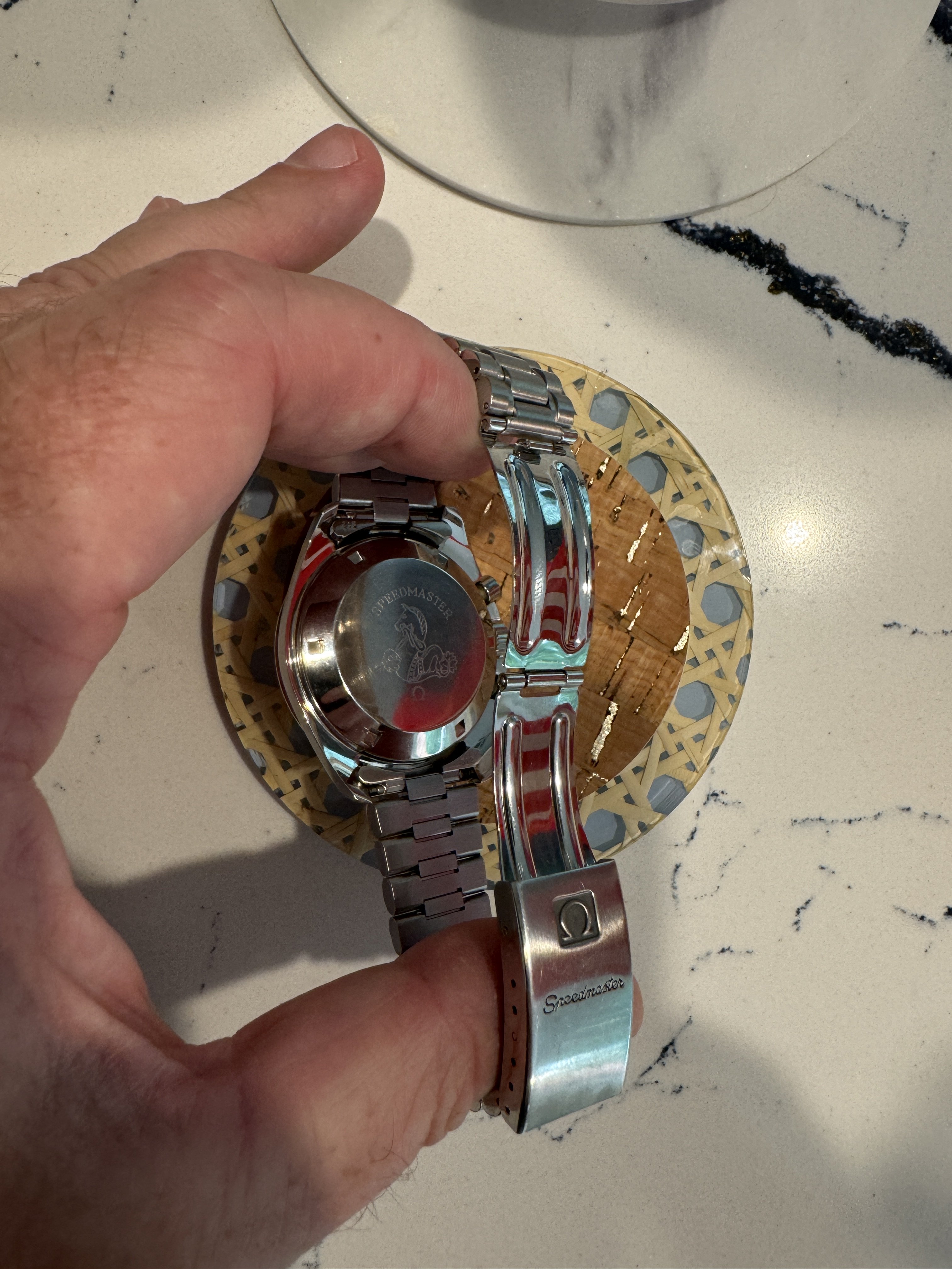

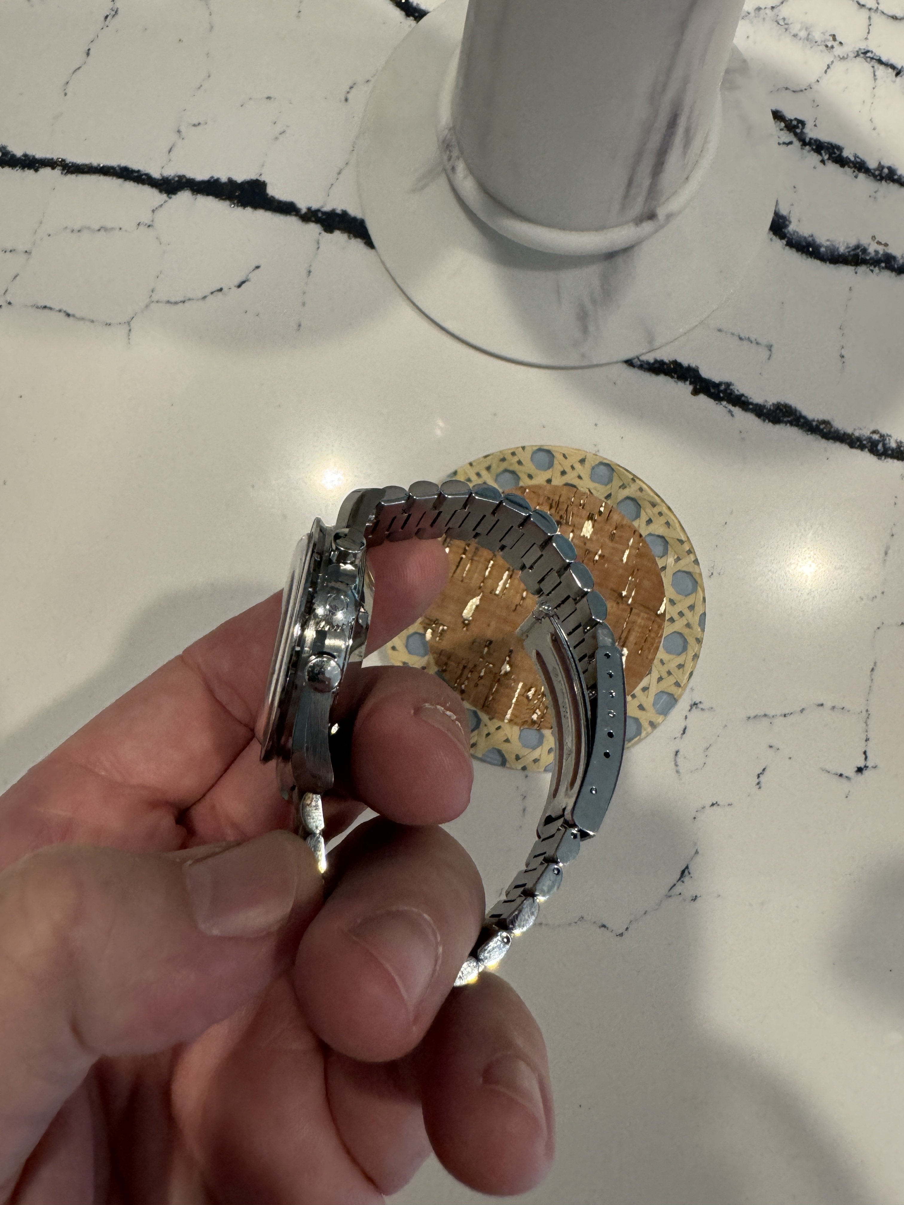

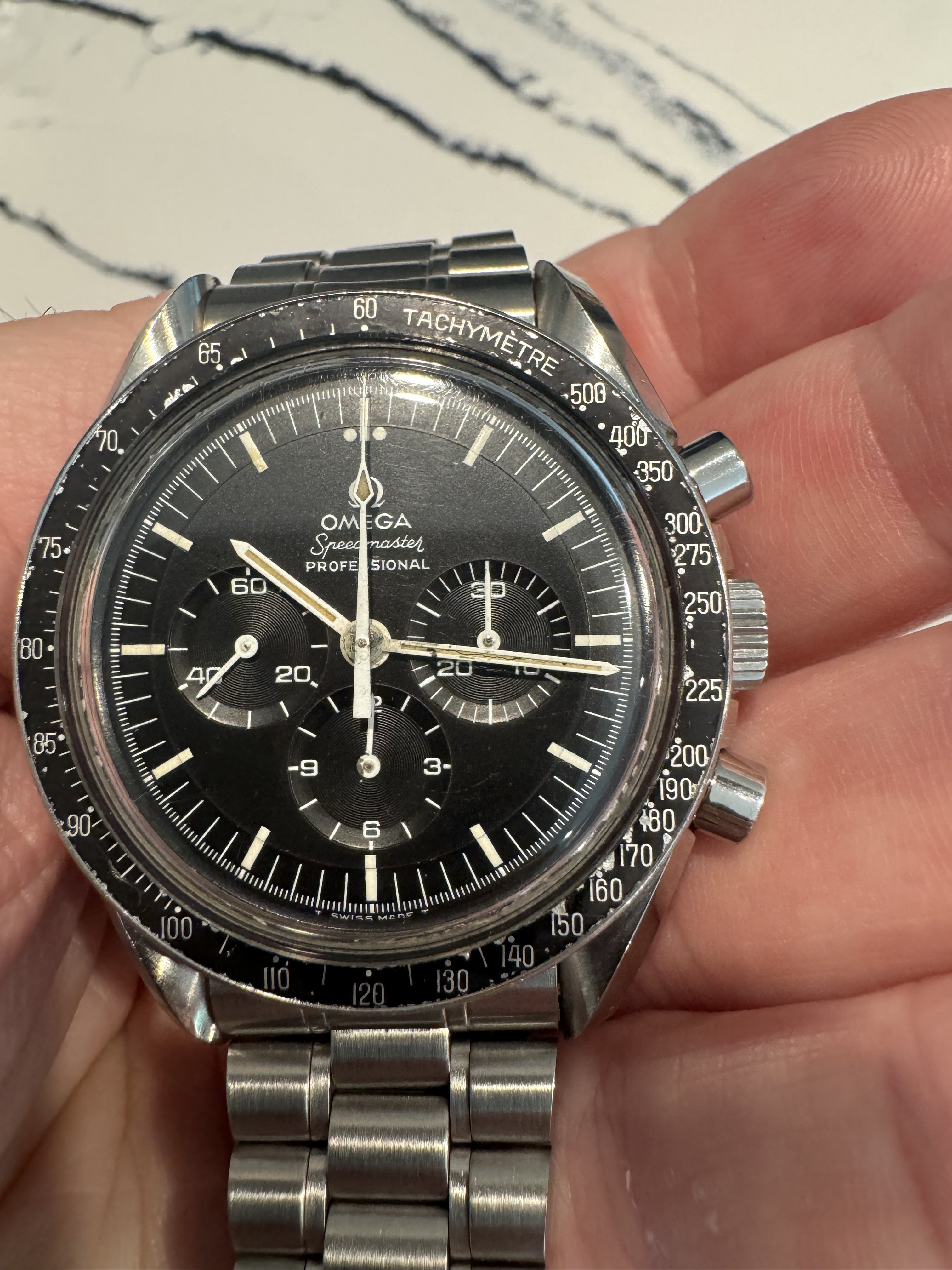

Based on your photos it’s a -69 861 pre moon but it’s not untouched. The bracelet is non original, an 80’s replacement.
The bezel is correct but clearly worn.
The case seems pretty sharp which is good.
The dial looks original but seems to have lost the lume (either that or it’s very pale).
It’s not a watch that you need to be overly concerned with wearing without insurance. I’d say given the average condition it’s perfect to be serviced by a good independent watchmaker and worn frequently.

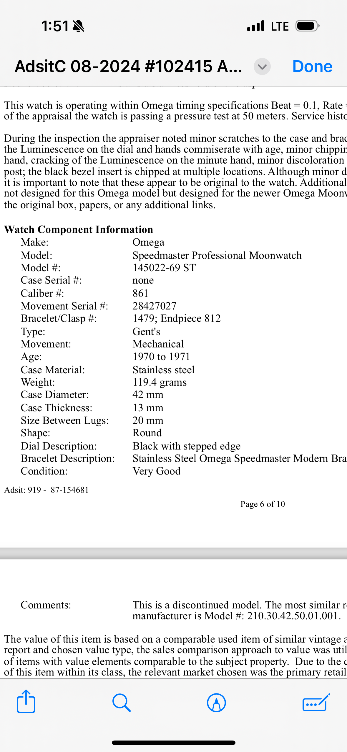

Yeah the hands are cracked in the Lume you can see it with a 10x loop. And the appraisal said the watch band was a later model band. Was not OG to the watch.
They have it as a 1970-1971.
It came back at $5800 appraised. So called insurance and got it added. Had to get an Atocha 8 Reales added also. So 2 birds one stone.
They pressure tested the watch also. Passed.

It’s a -69 reference, likely produced in 1970 as it’s quite an early serial. Because of that there’s two scenarios:
1) the bezel was replaced at some point as a 28m serial should have a dot over ninety bezel.
2) the serial number has been recorded incorrectly by the appraiser or the movement has been replaced.
Given the above and the overall condition, I’d say the valuation is high. More like $4k.
Still a lovely watch to own and wear.

It has a dot over 90 bezel which is consistent with the 28 mil serial.
13,563
23,515
Wow you’re right, my eyes are terrible on a small screen without glasses.
Apologies OP, scrap the nonsense about the incorrect bezel. 5800 is still too high though. 4000-4500.
