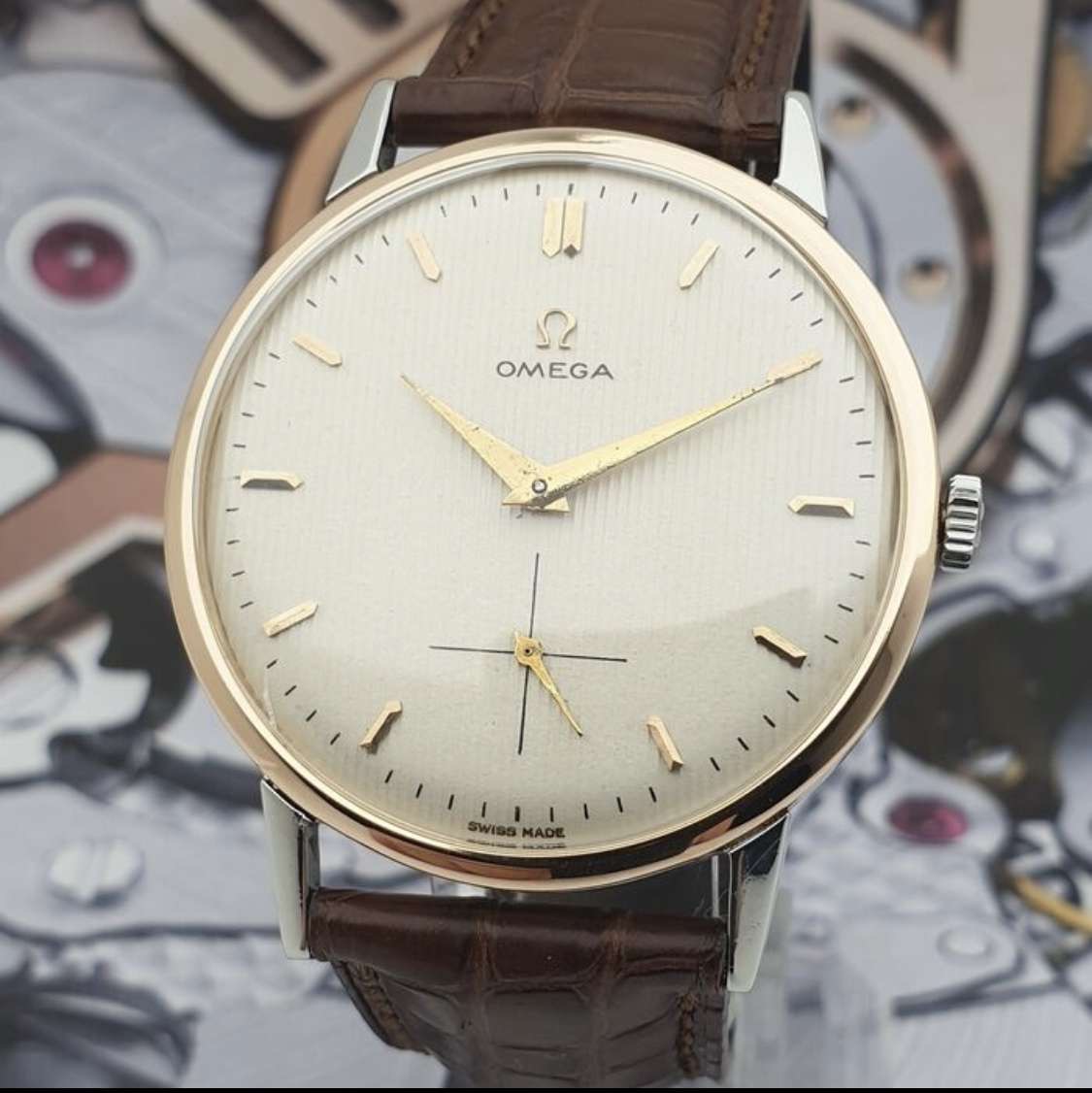

Should I have passed on this 1944 Omega 2272-1?
12
7
Hello again,

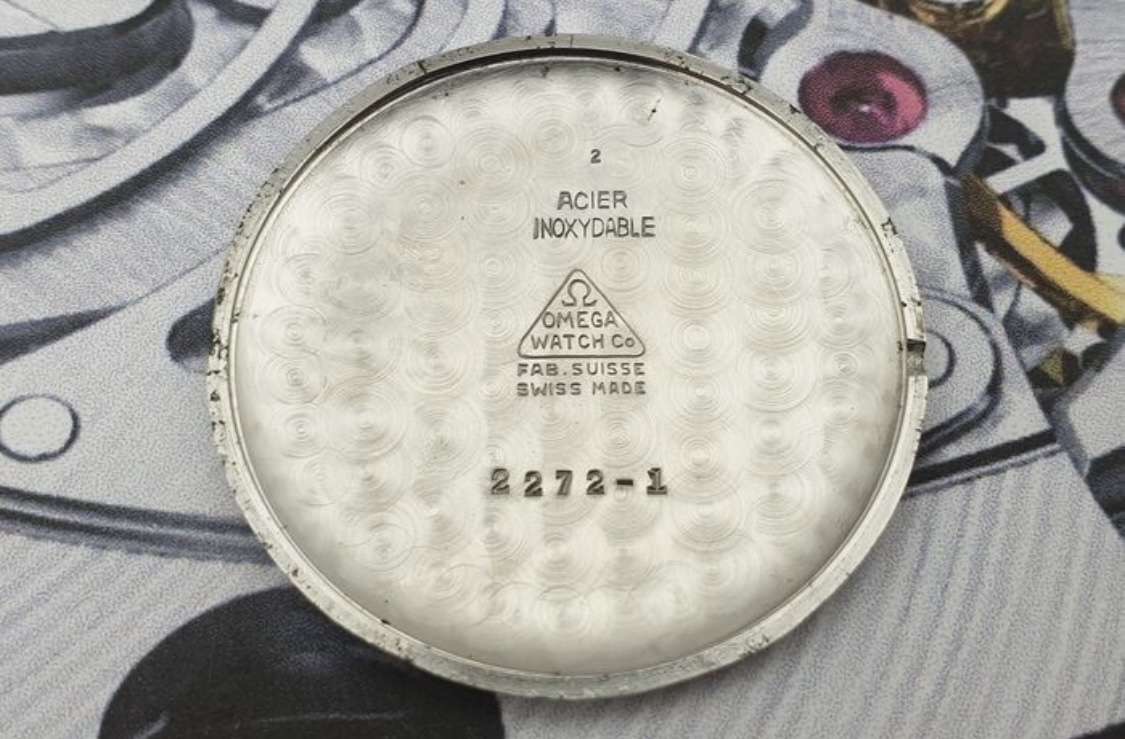

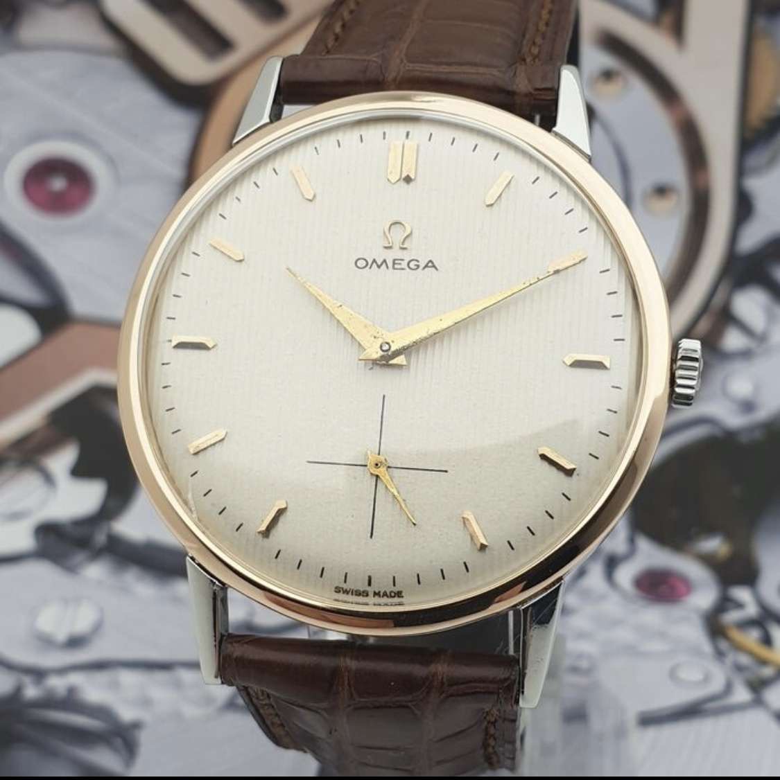

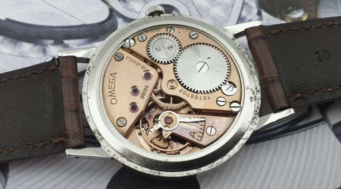

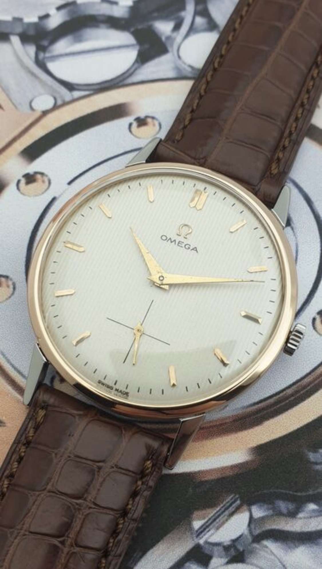

I purchased an Omega Seamaster today. I was also planning to buy this 1944 Omega JUMBO 39mm Ref 2272-1 Cal. 30Т2, Solid Gold Bezel. However I let it pass. The price would’ve been about $1000.
Below are the attached pictures. Should I have purchased it? Was this a steal? The quality looks really good however I don’t know if it was a good purchase. Please let me know and thank you for the help again ❤️

You dodged a bullet.
thank you for replying again XJR. Can you educate me why it was smart to pass? I just want to be as educated as possible on these vintage watches 😀
Took the words right out of my mouth. Terrible re-dial, badly polished, bezel probably not original, regulator position suggests the movement is in bad need of servicing, and other issues. Way over-priced for what it is, and really not worth buying at all IMO.

Bad redial and a good pass.
It would be worth spending time reading various threads on this forum to build your knowledge prior to buying.

Hello, could you please share why it is a redial? I'd love to learn so I can spot such things more easily in the future. Thanks!

Hashes and font is too thick, quality is poor, minute hashes are unevenly spaced.

Ah, yes, I see what you're saying. Thanks for sharing!

For completion I want to add: Ref 2272 does not have a diameter of 39mm (maybe including crown...) - its diameter is 37.5 mm
