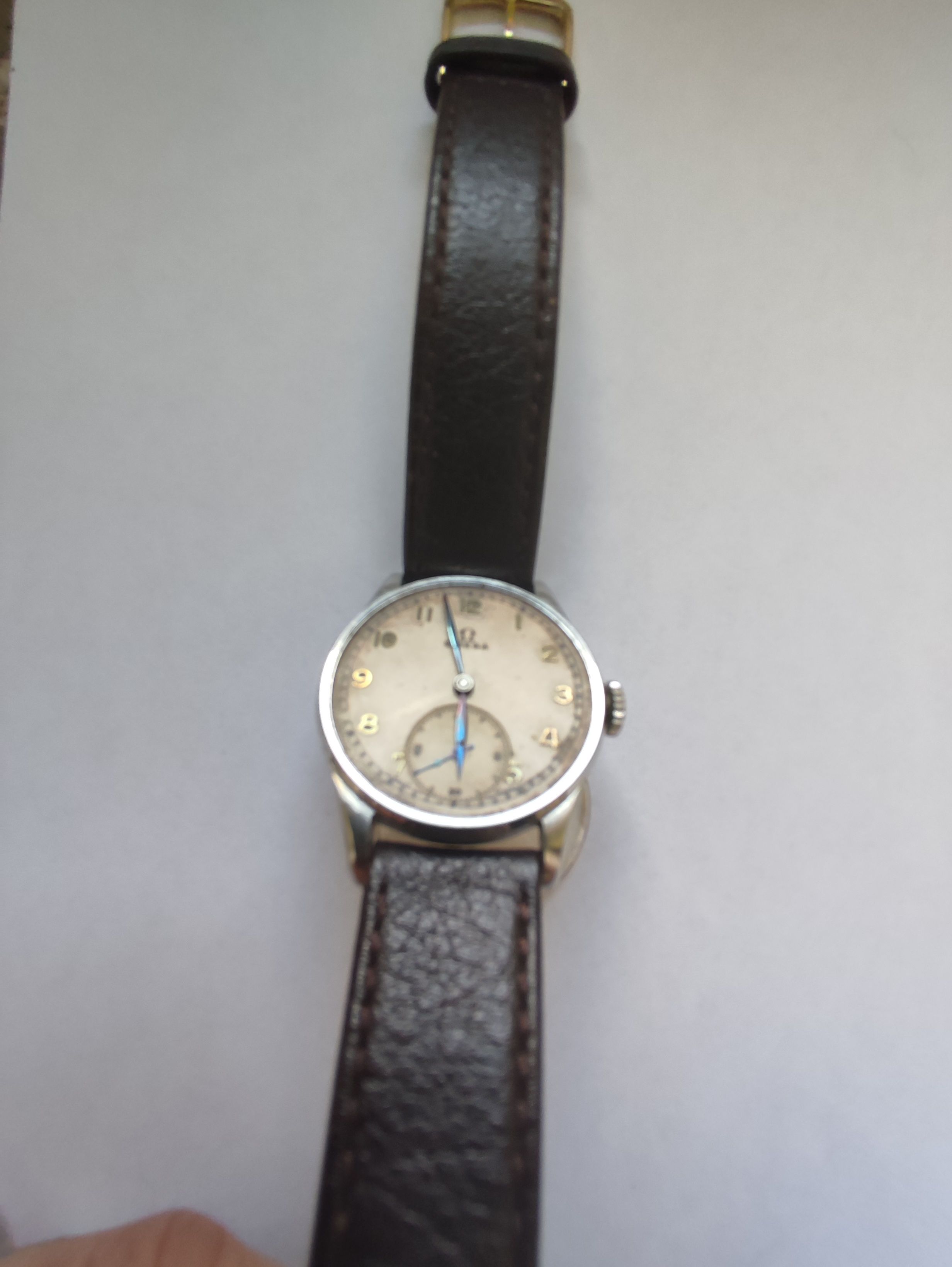

Wish to know what kind of watch I have Omega Military Watch
9
3

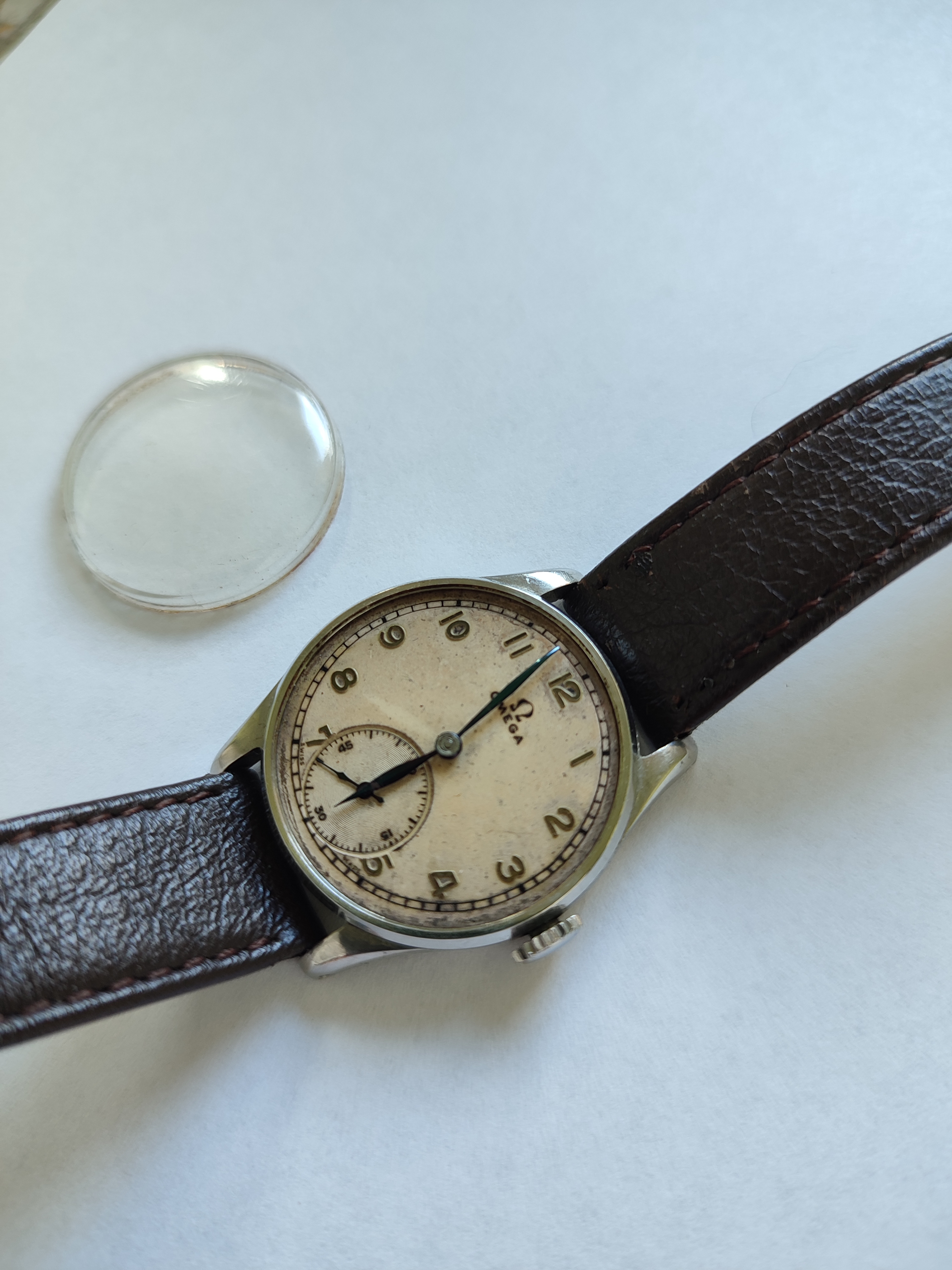

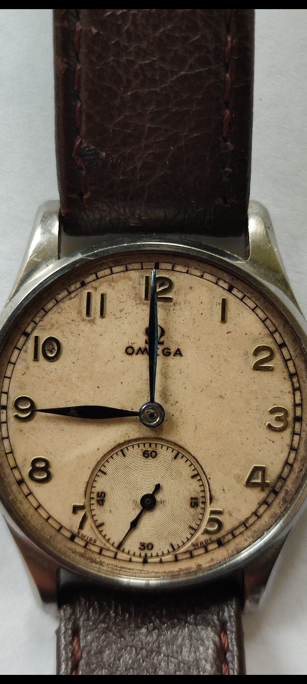

I have this watch after family member - was kept in bad conditions - wish to know something more about it - I'd did not open it
Hope to find help here
6,904
10,769
Don't think it is military. Dial most likely repainted. Most info will be found on the inside of the caseback and on the movement.

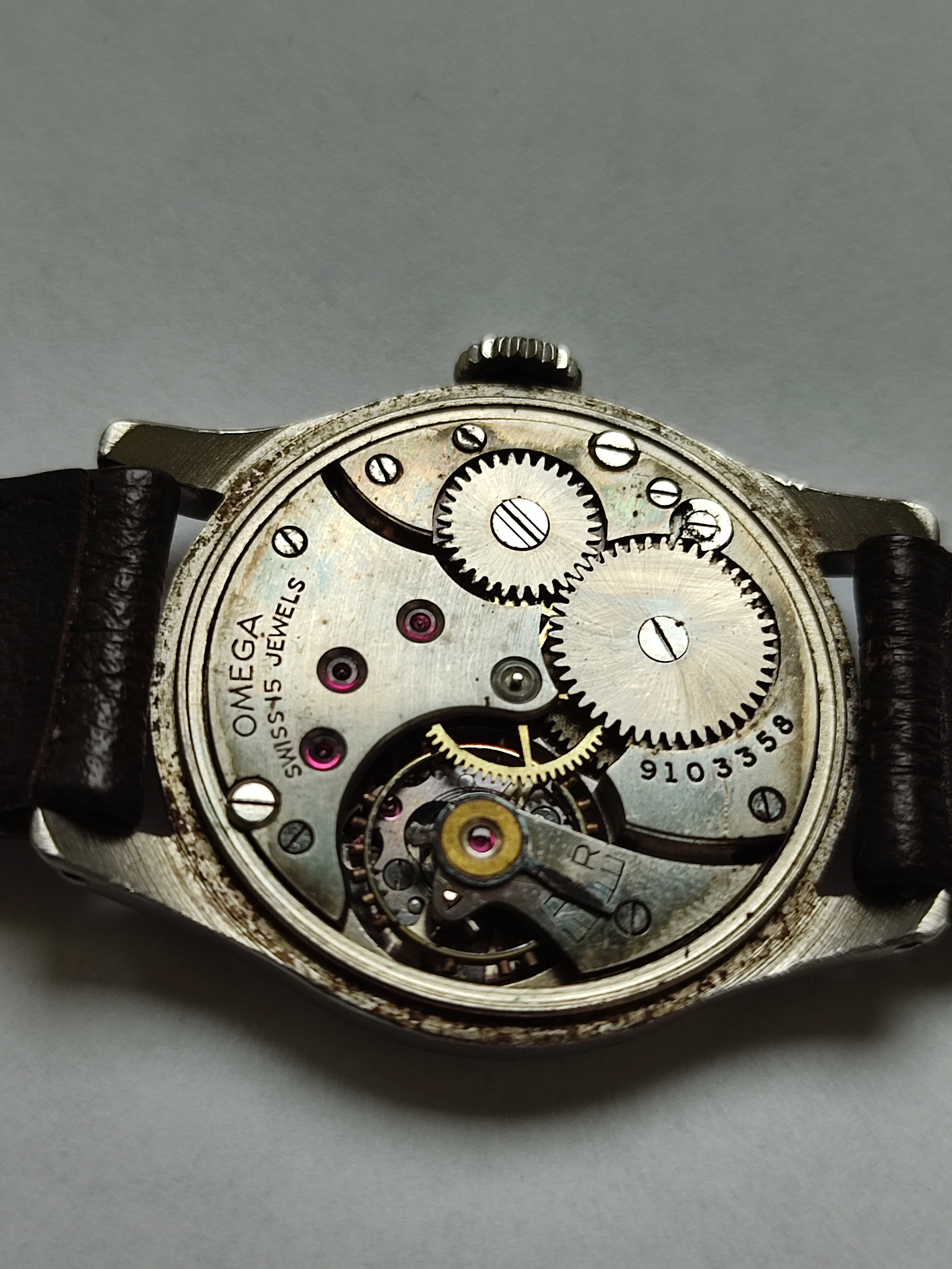

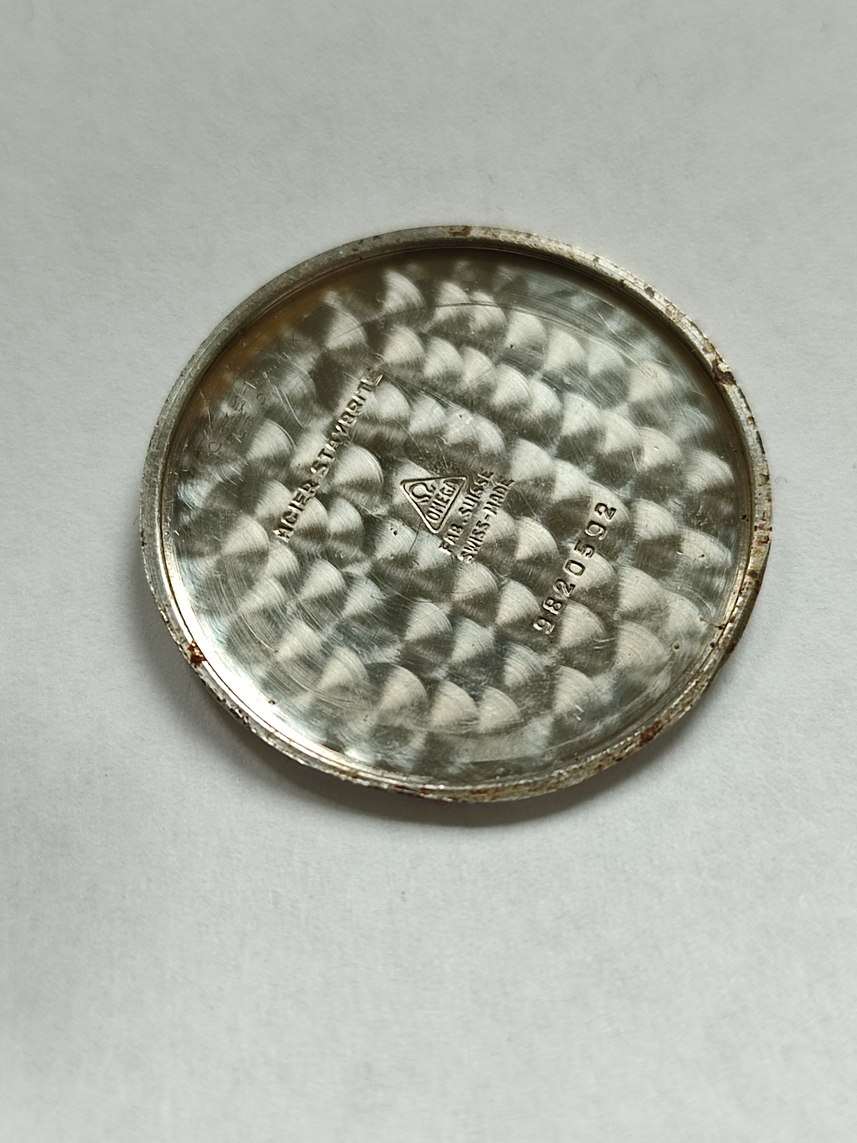

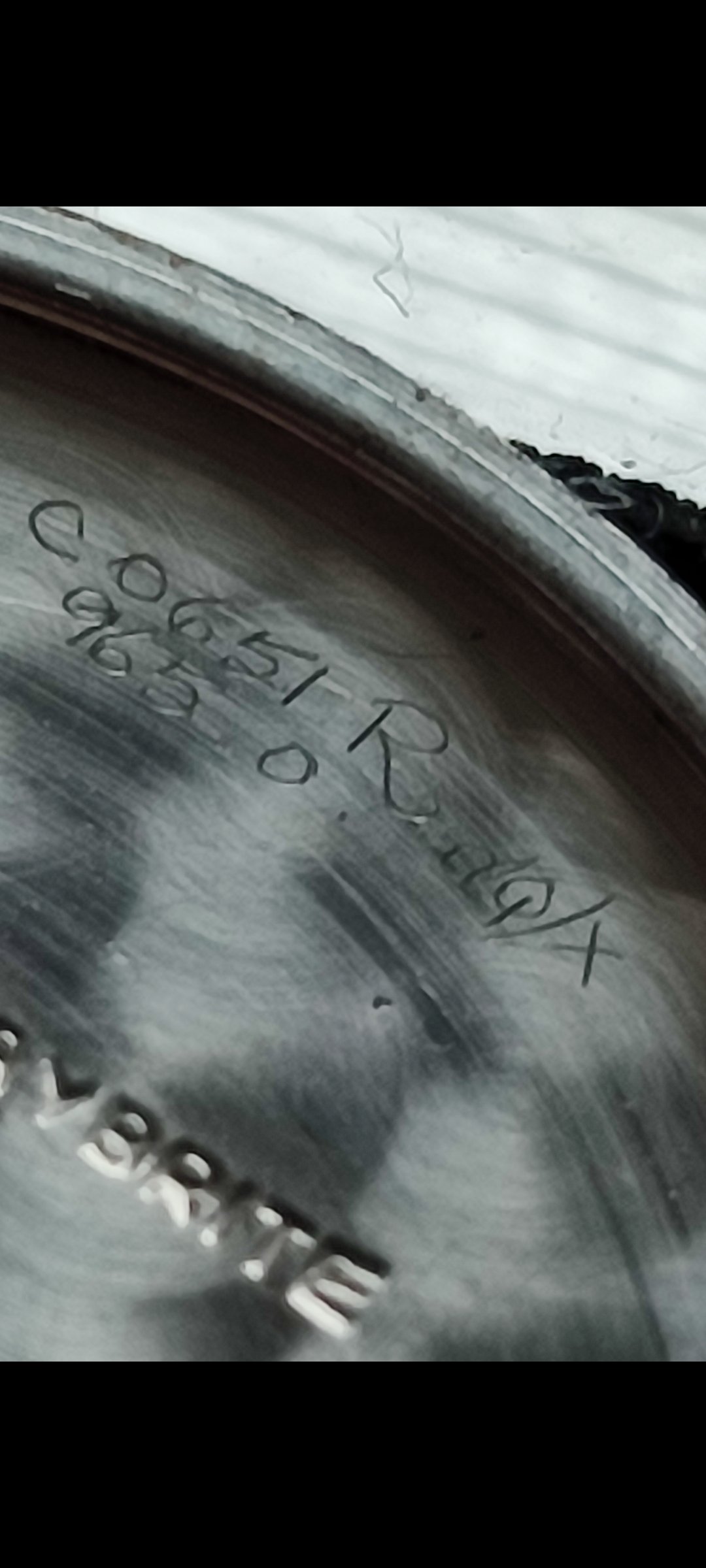

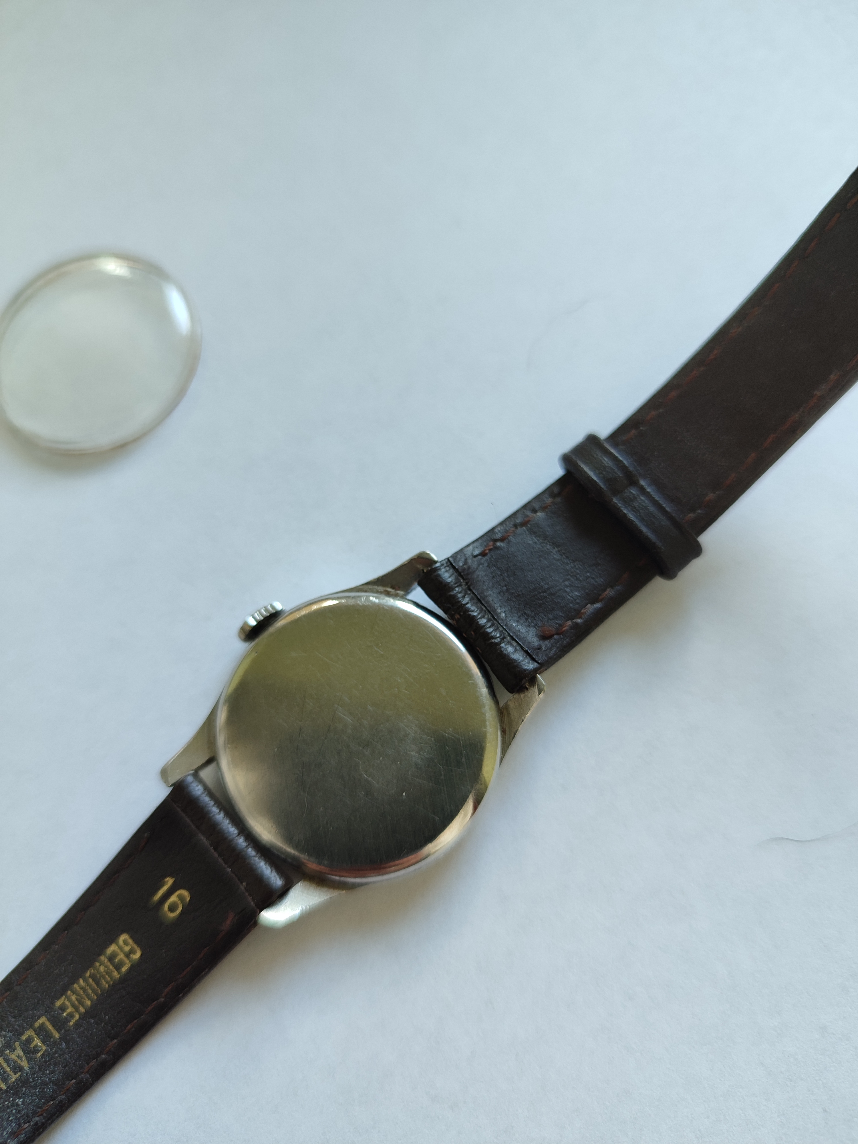

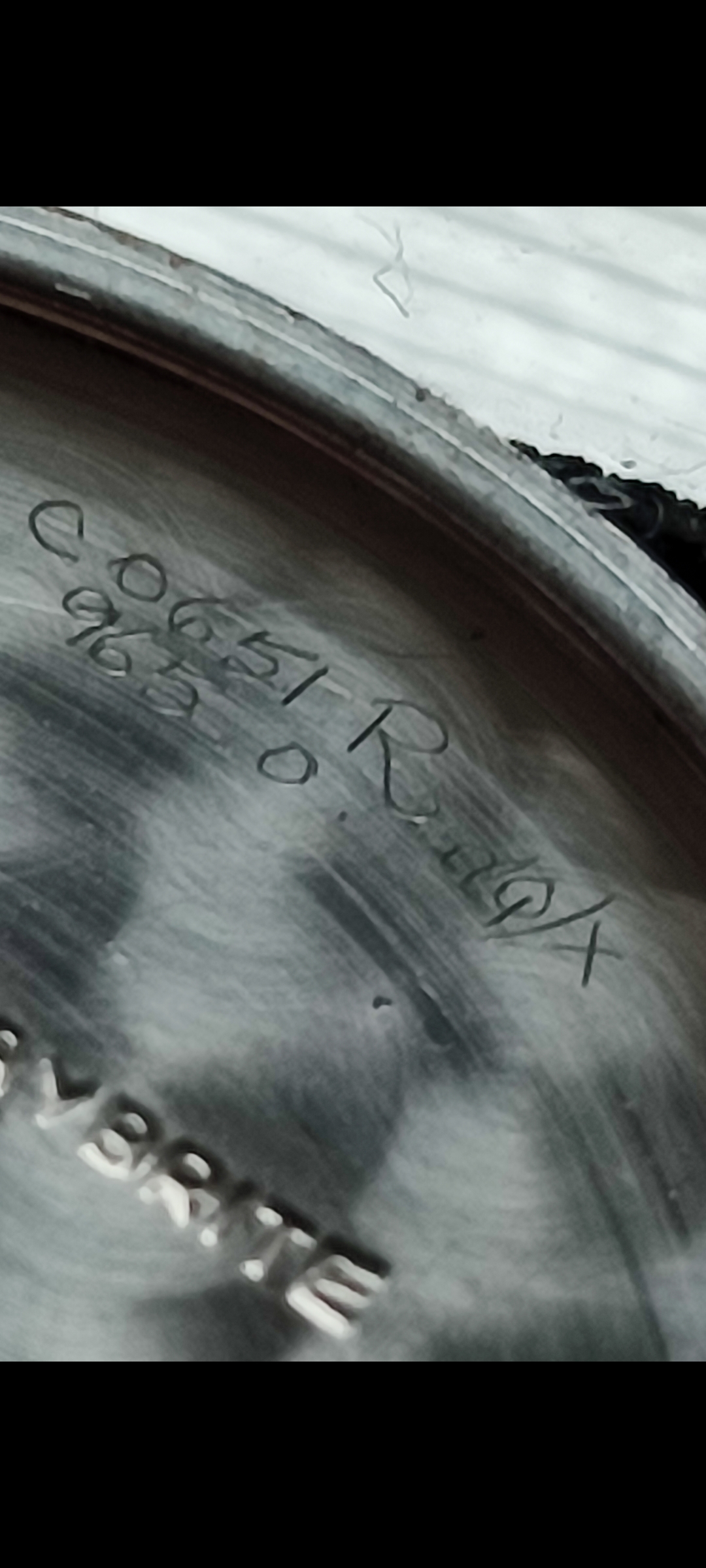

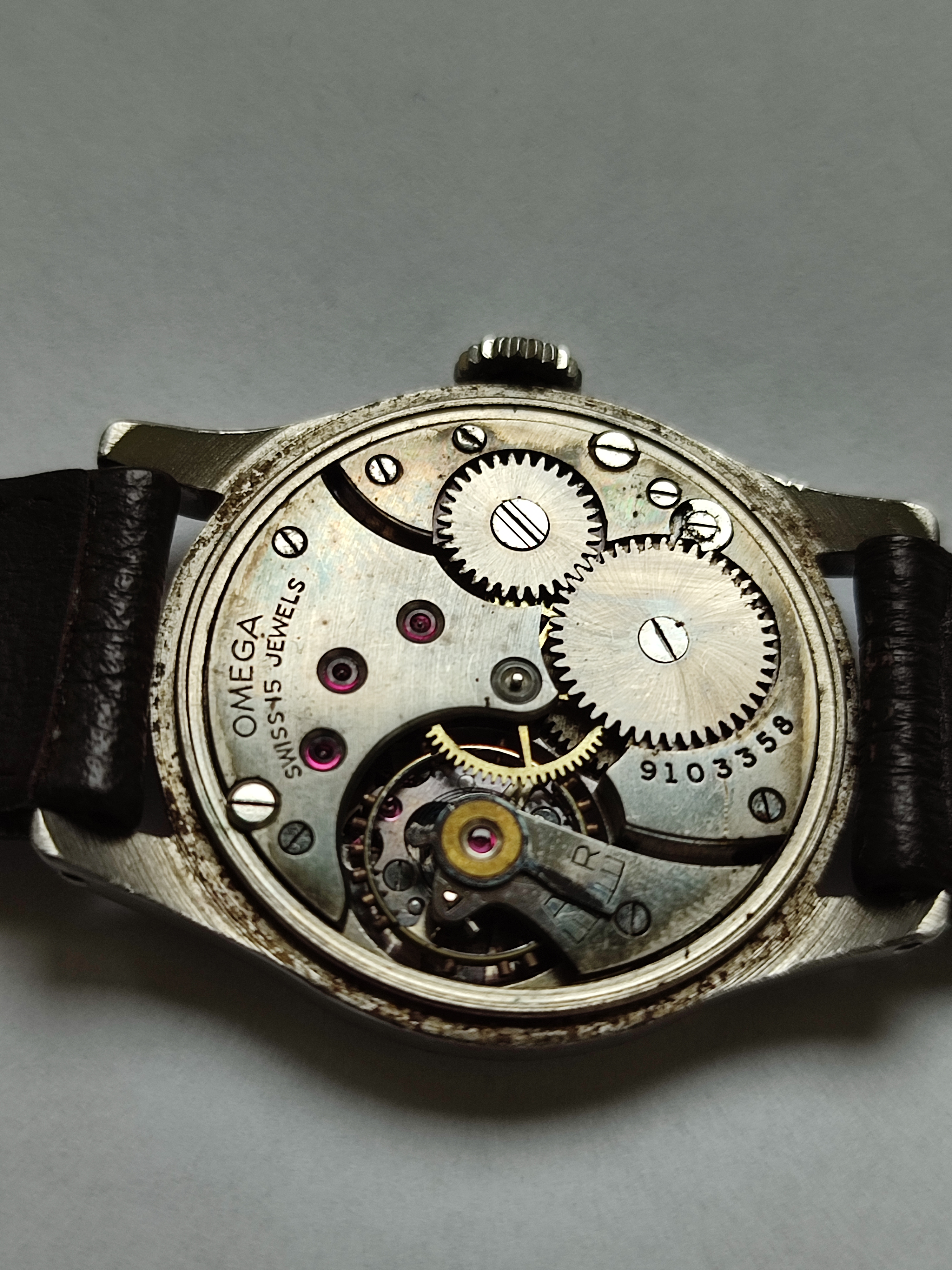

More pictures - also cool find on the back cover from inside
On back cover - ancier staybrite

Actually, this appears to be a cal 26.5, not 30T2.

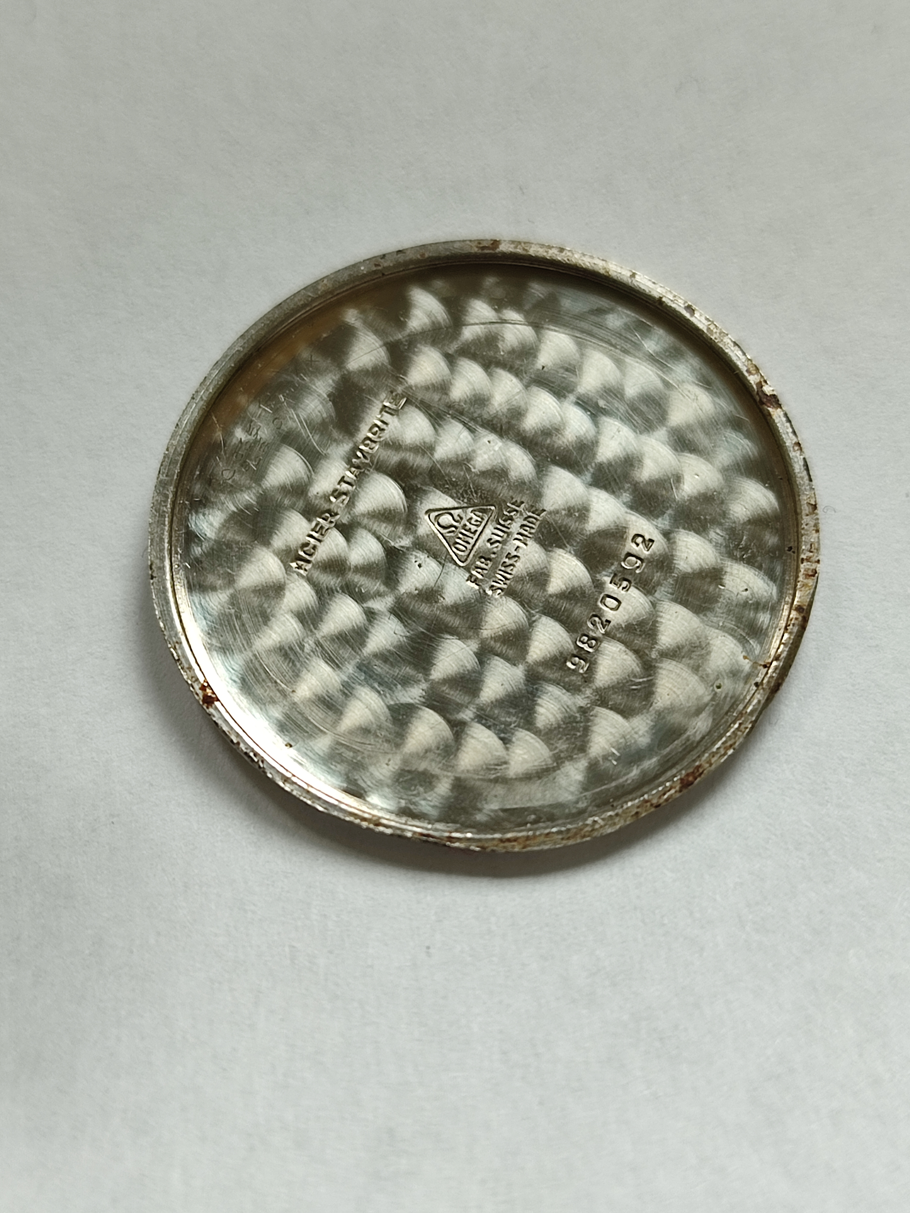

Serial number dates it to 1943,
Is the serial number one on inside the watch or from back cover ?
24,843
55,270
The movement serial is the one we usually look at. I would put it a bit earlier than 1943, personally. Maybe 1939/1940.

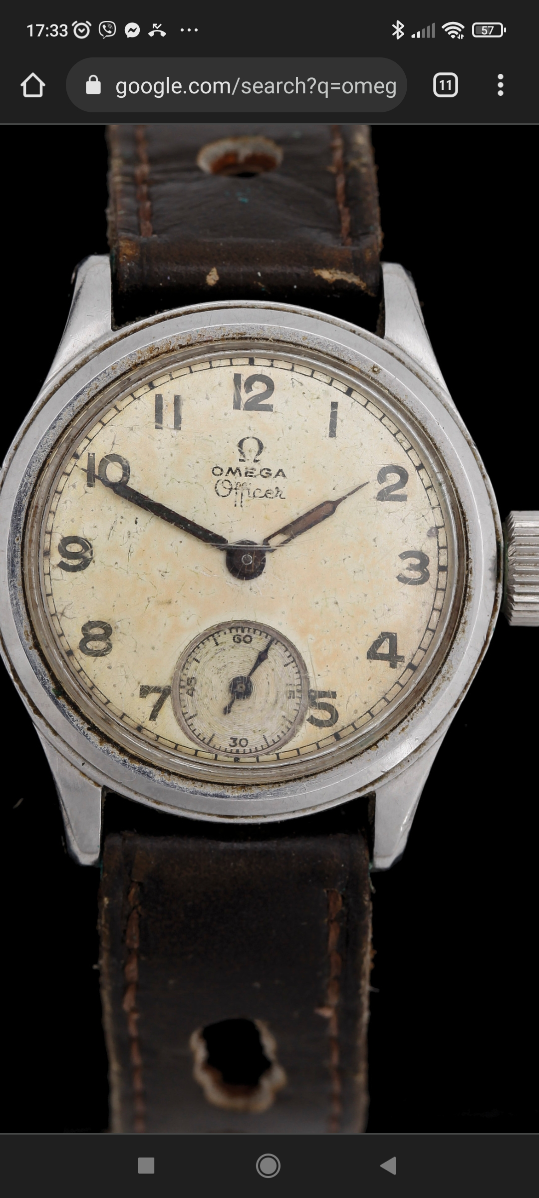

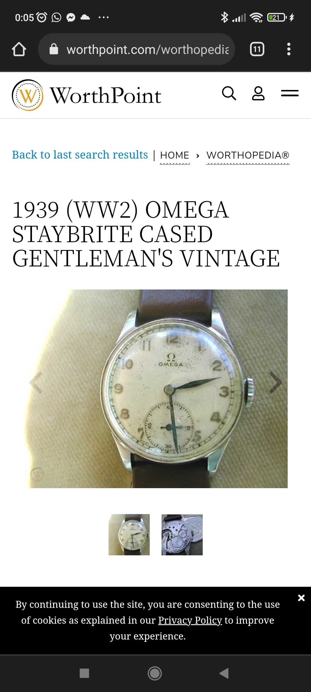

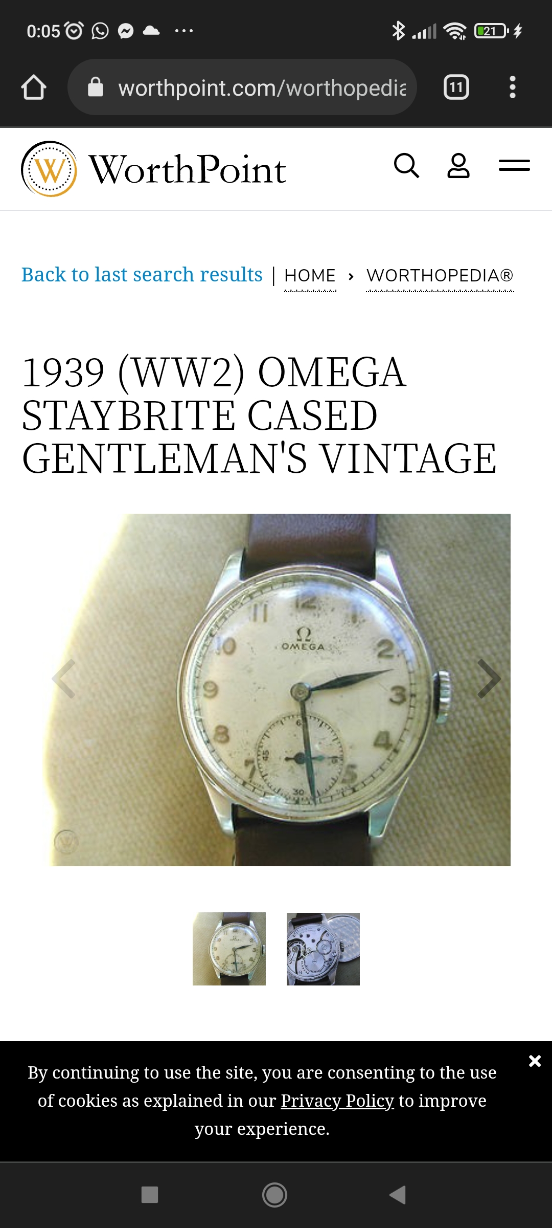

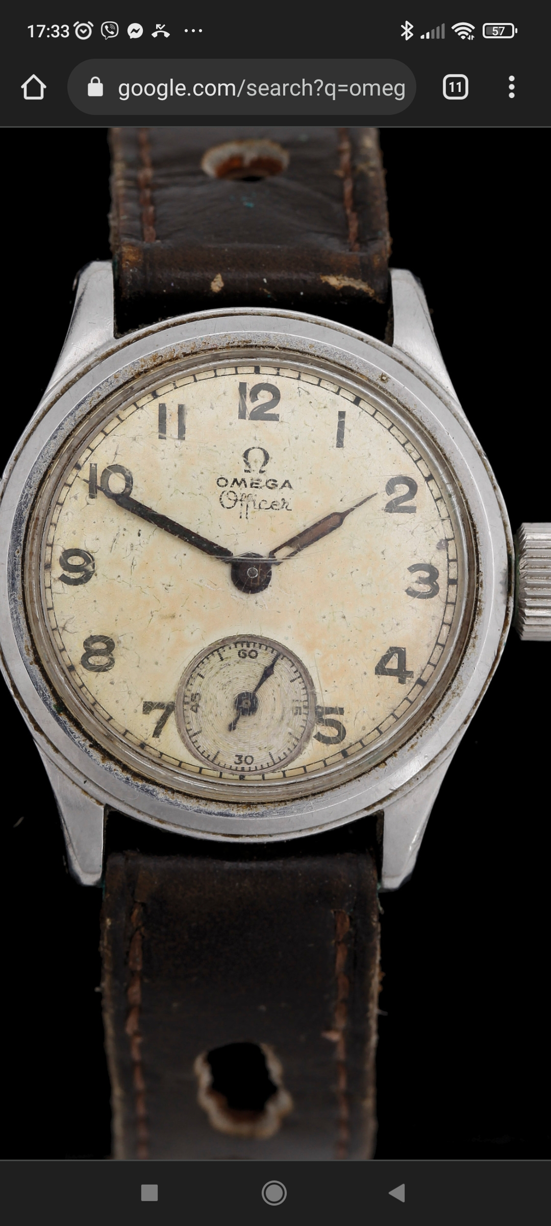

Very similar to this one - but no officer under Omega (Screenshot) from net 😀
5,734
9,520

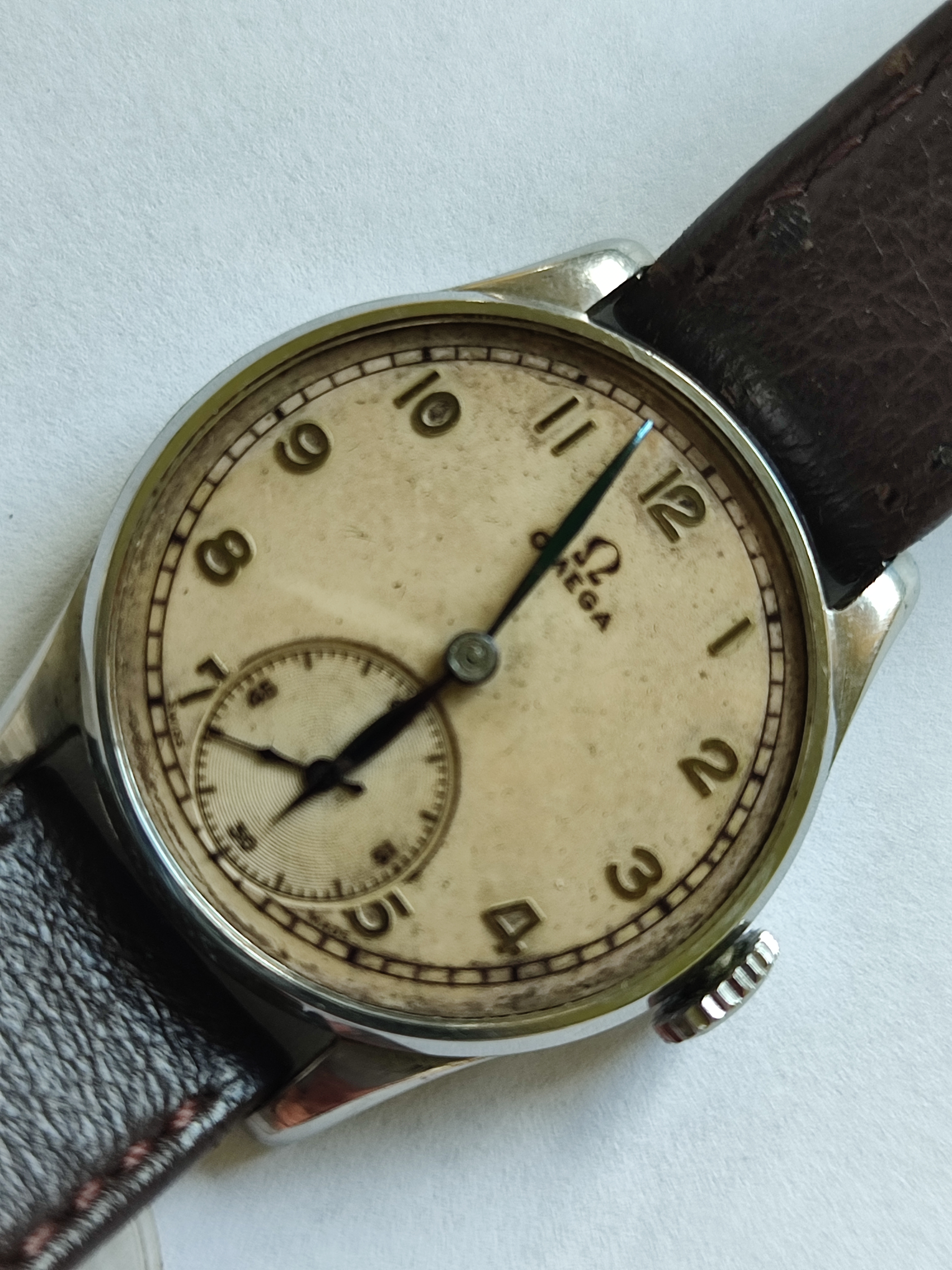

Nothing military here. Why do you think, it was issued ? Just a guess ? Hands look fine. Cool to find markings inside the case back ? Maybe time to read more about vintage omegas...... Watchmaker Marks inside the case back should be normal as service marks from the past. Dial repainted ? Not so sure....looks like an previous cleaning attempt with the wrong detergent and the paint has bled and expanded into the surrounding areas. Definitely need a close up for evaluation. Movement advice
? New girls and guys come here for advice and too often for valuation hopes. Therefore advice given by other newer members should be correct. These are 2 completely different movement classes. Can be important , because parts for older ones can be very hard to find. Rather small, but nice vintage Omega.

Thank You - was my mistake call it Military - some old Polish watchmaker told me that, also watch belong to wife of RAF pilot so that how I started research on it . I wish to just find out more about a watch - not price or value - not important to me now. More off curiosity - I don't think that dial was repainted - actually i found it in really wet environment so that maybe had something to do with that. Don't really know what to do with it - wish to give to someone who can make it good again.

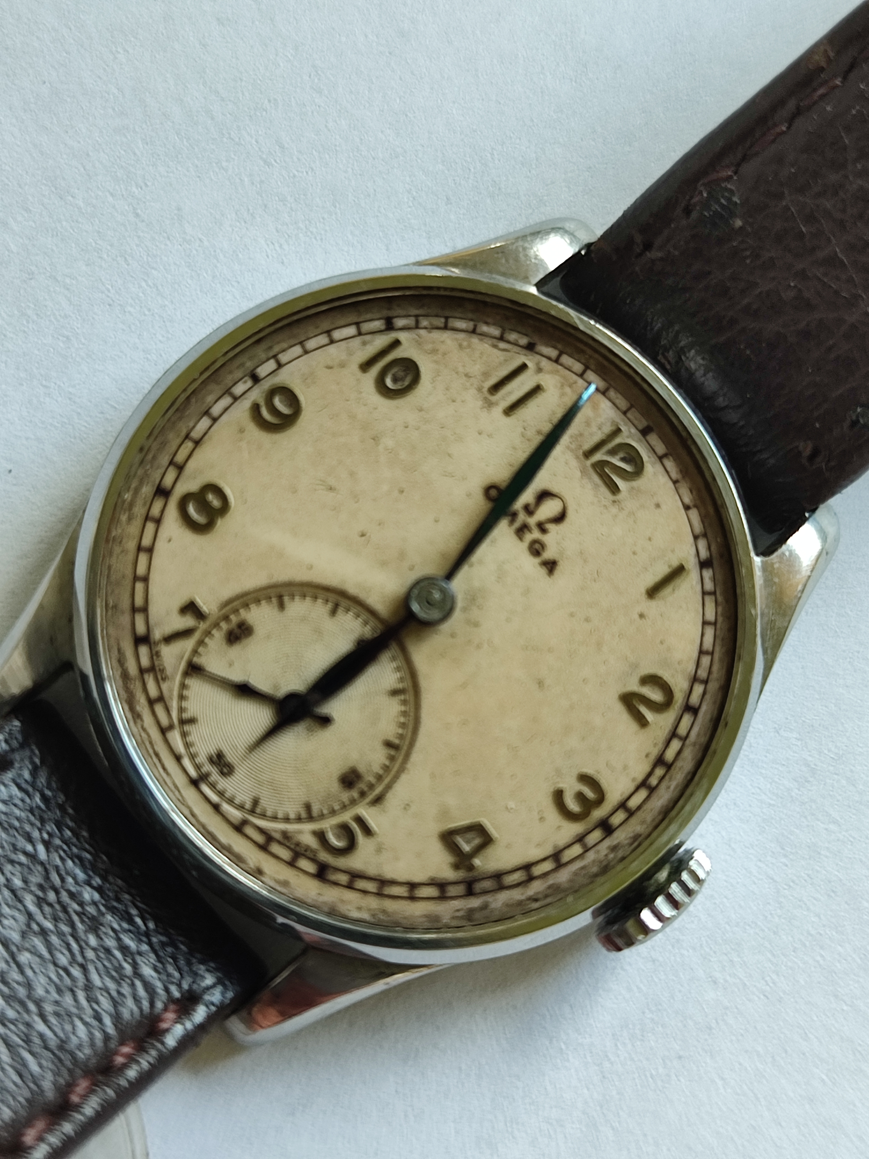

Looks like a CK 2082, here in a 1939 French catalog :
Two of mines (later production : 1943-44) say hallo :
I believe your dial is original.

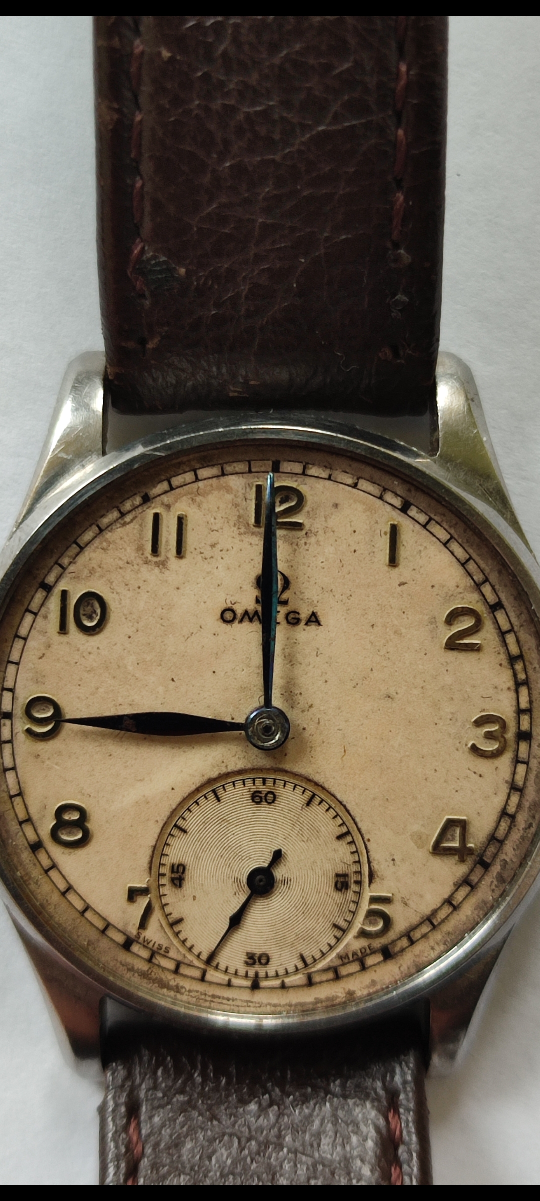

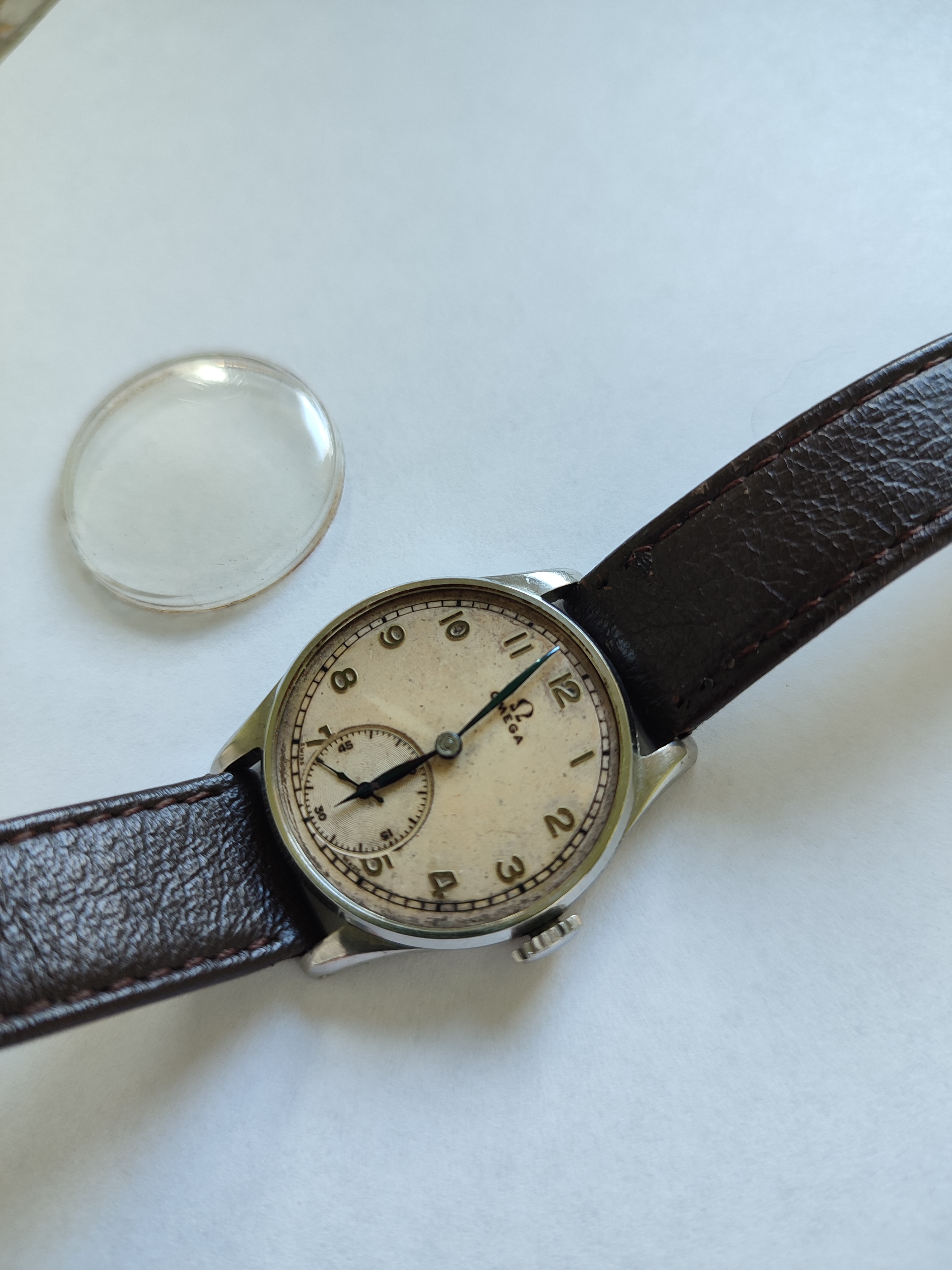

Oh and I took one more photo bit better from the front where is more visible
There are some members here from Poland that may be able to reccomend a watchmaker that could try to get it back up and running. You may want to use the search tool and see if something comes up. As said before, parts are difficult to source for watches of this age, but if you just want it “running”, a competent watchmaker may be able to make that happen. It’s worth investigating.
