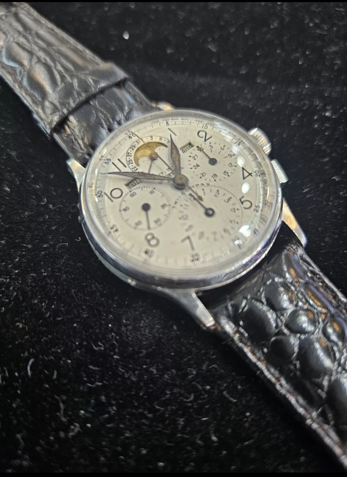

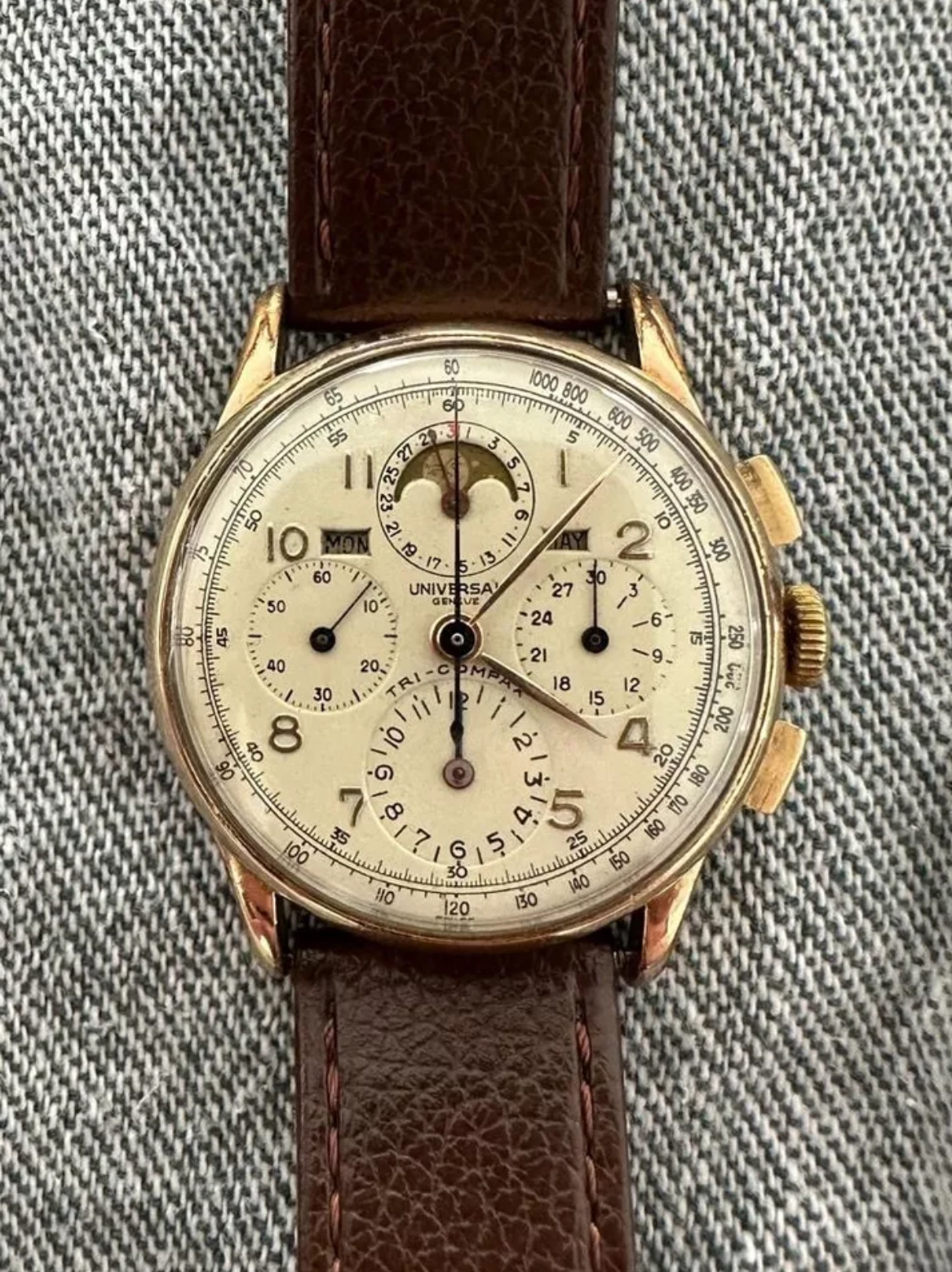

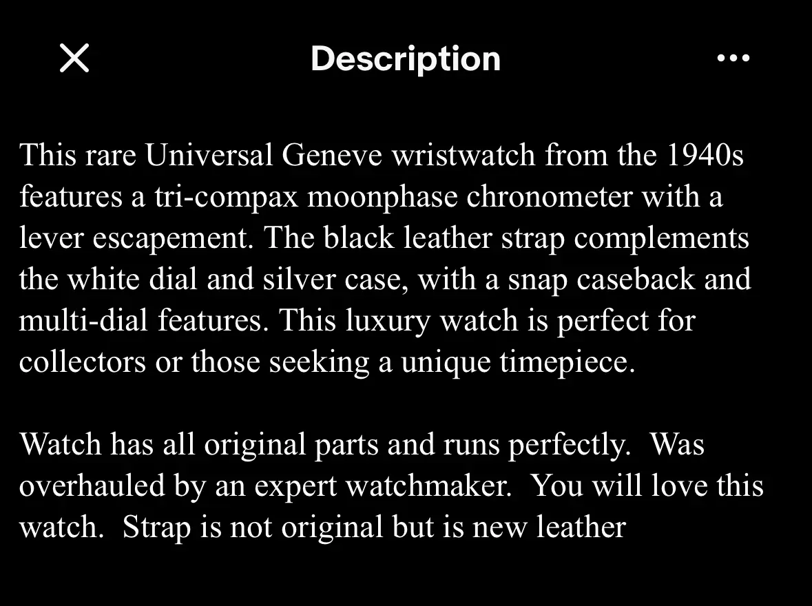

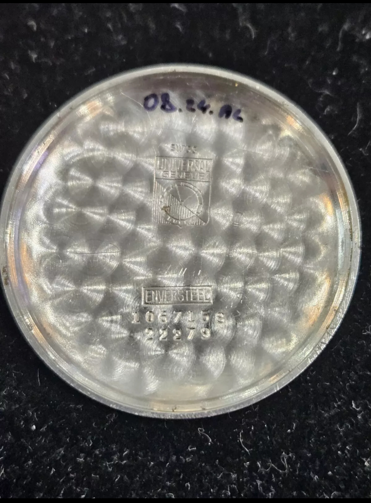

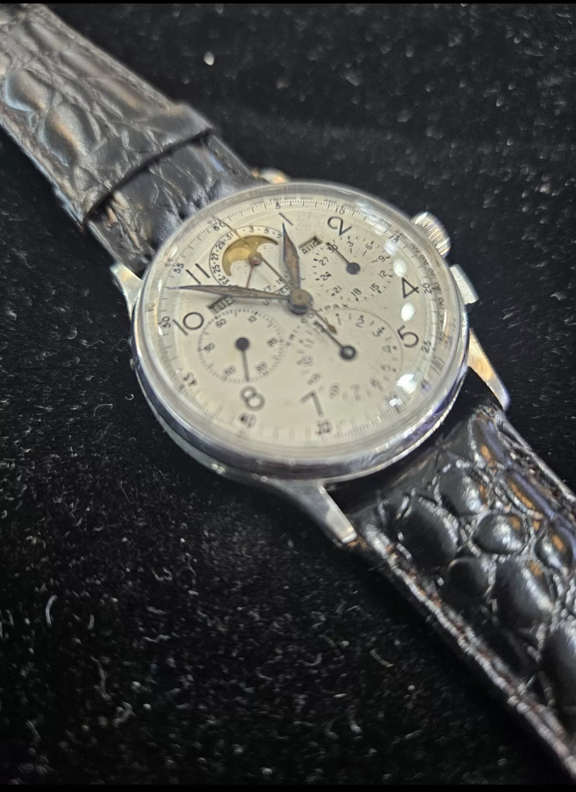

Hi guys,

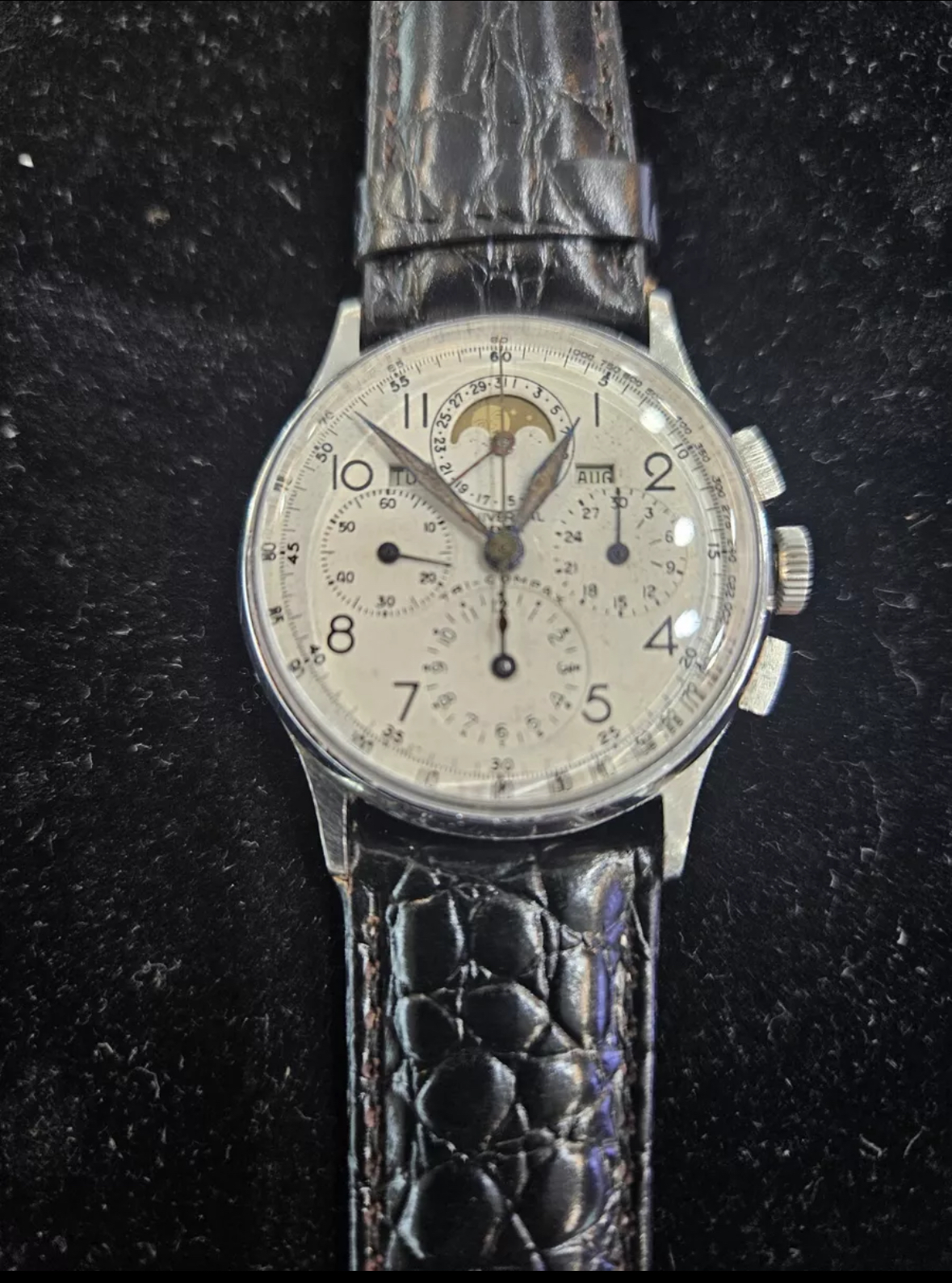

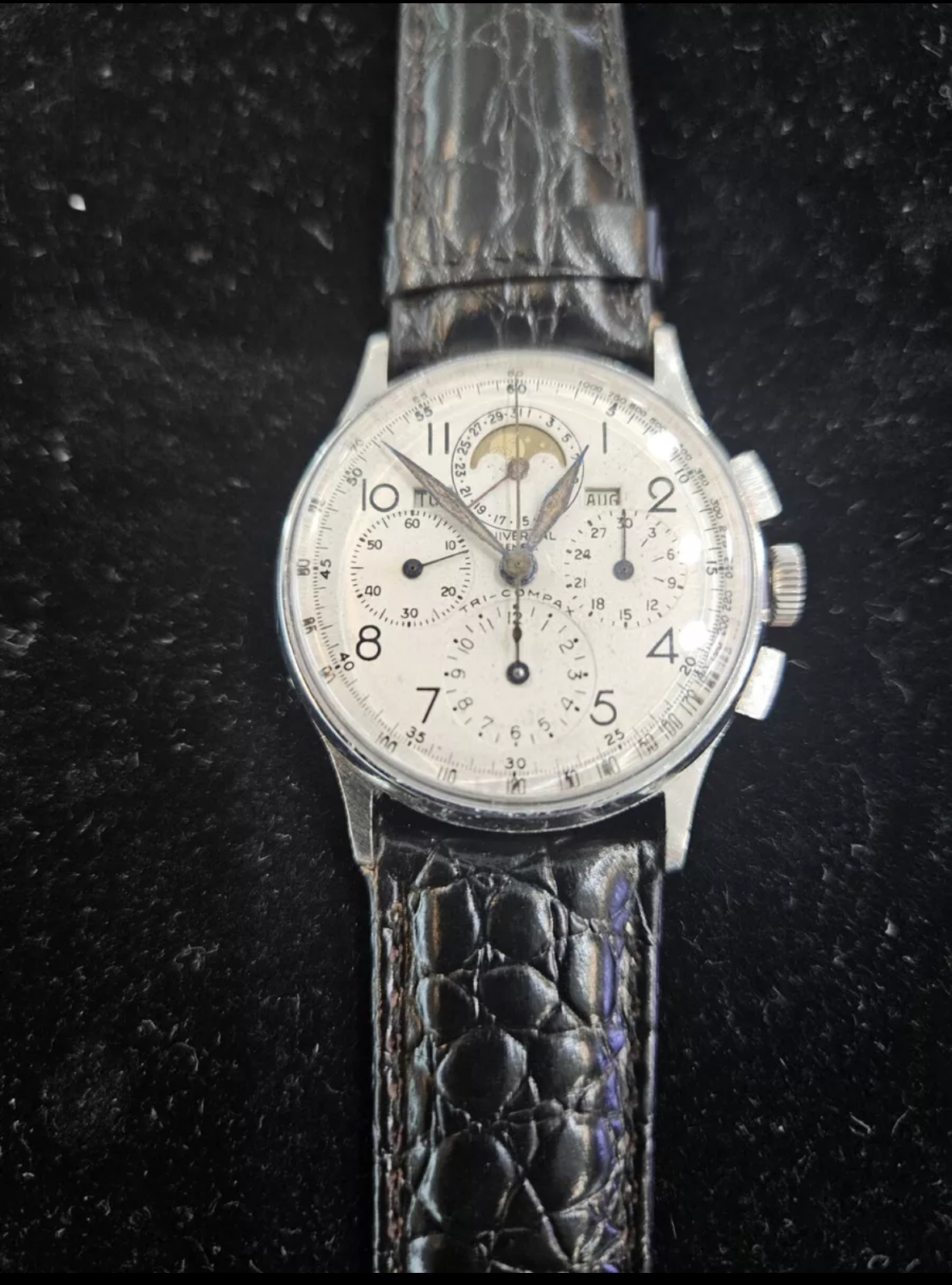

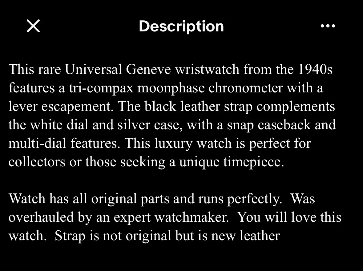

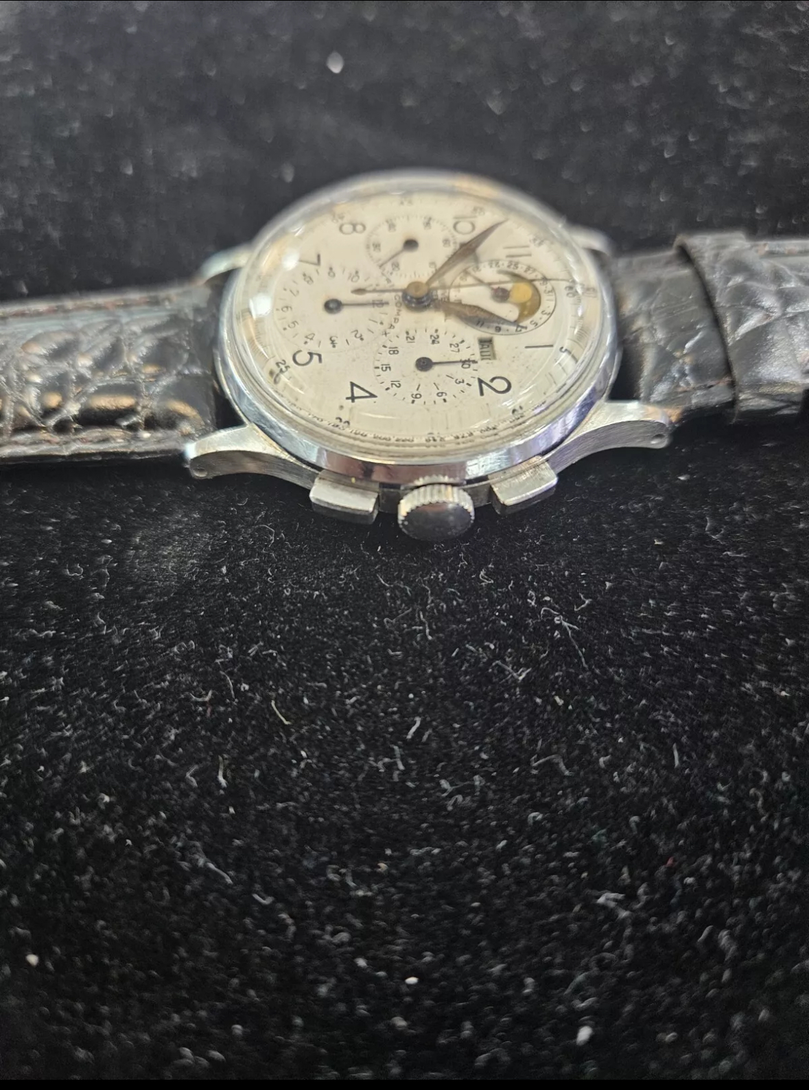

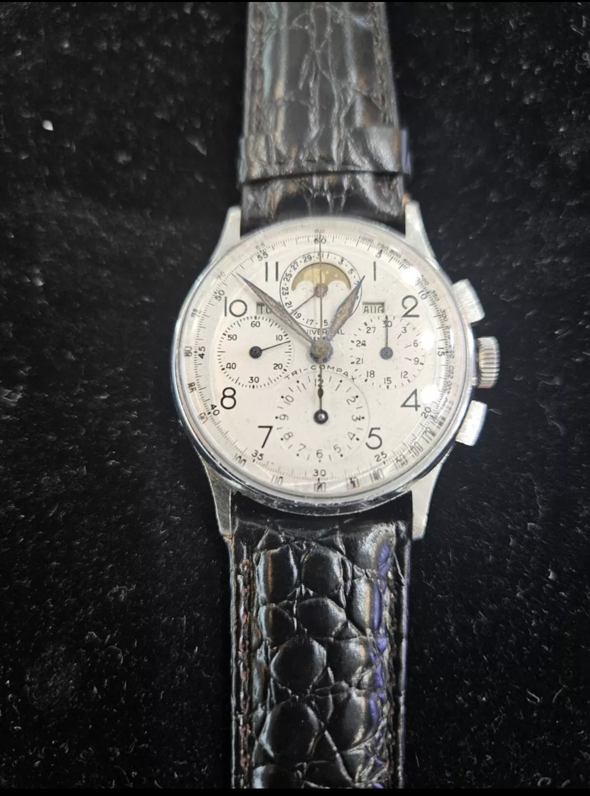

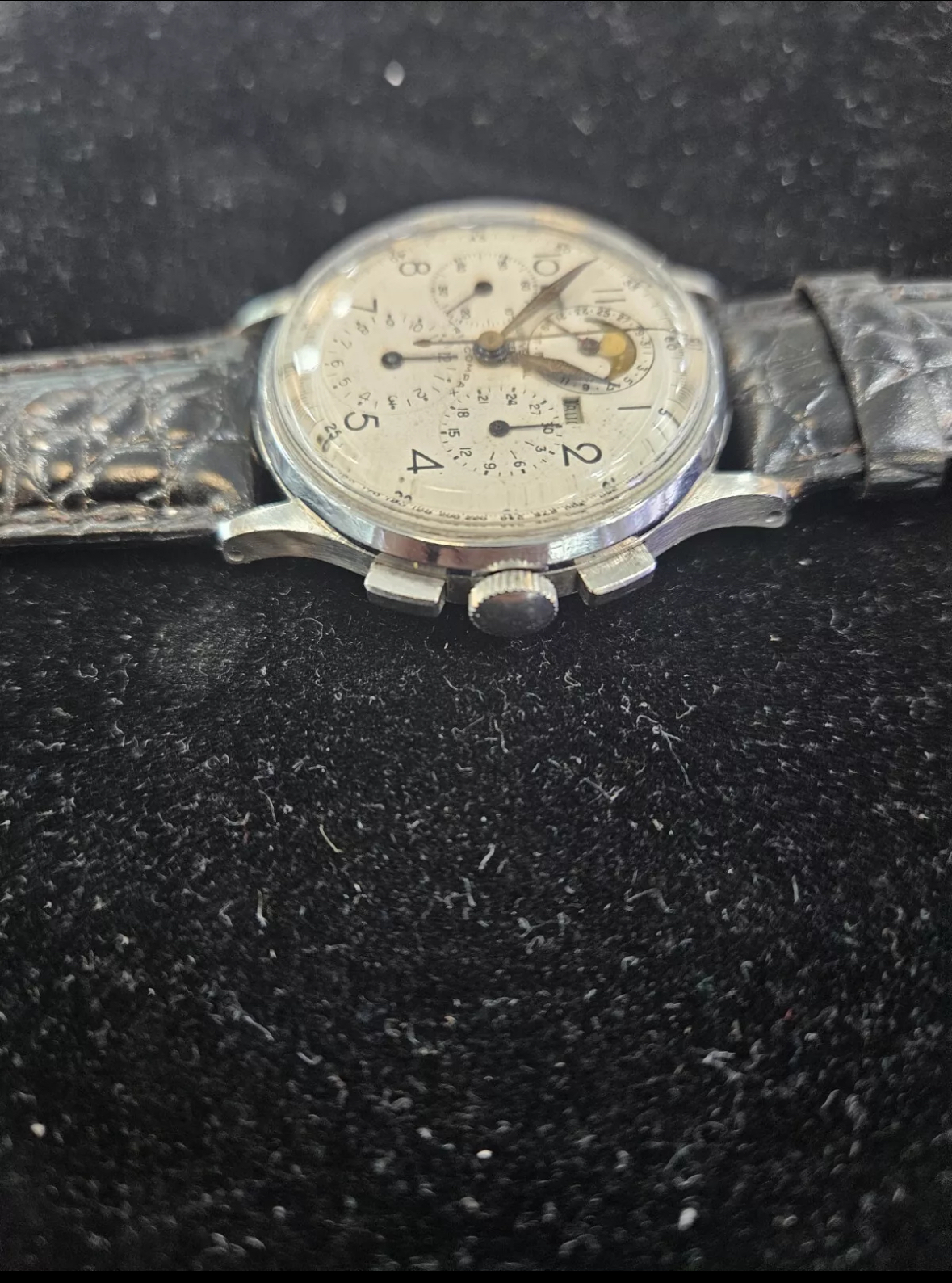

Been looking to add a vintage watch to my collection and came across the tri-compax and haven’t been interested in anything else. Spent the last few days reading all the great insights of the people in this forum and was hoping to get some help on the attached photos/description and if it’s worth it, and if not where would be a good place to find a decent one. Thank you in advance.
1,122
3,943
No because dial was reprinted, unfortunately.
You can't negotiate on this.
906
1,740
Too bad, cool looking watch.
@vujen what gives it away?
I know zilch about these. Since you say it's a reprint, I see a wonky 4 in the minute subdial and the 0 in the 10 looks odd, but maybe it's supposed to?
Second marks in the subdial look a bit eradic.
6,867
10,682
Different fonts in the subdials. Tri compax print does not follow the rounding well enough. Movement is matching fwiw
969
2,365
I'm always very suspicious if the seller parks one of the hands on top of the A in Universal. Redialers seem to be genetically pre-disposed towards screwing up the flat A.

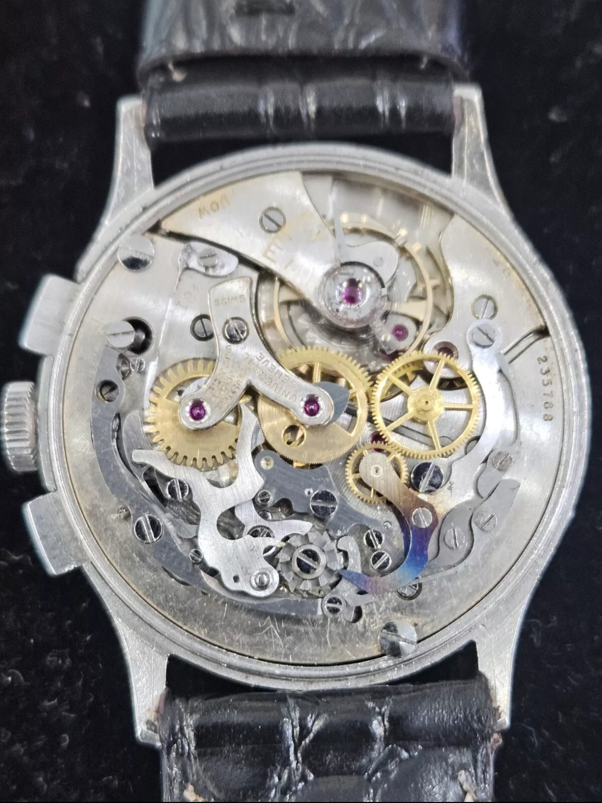

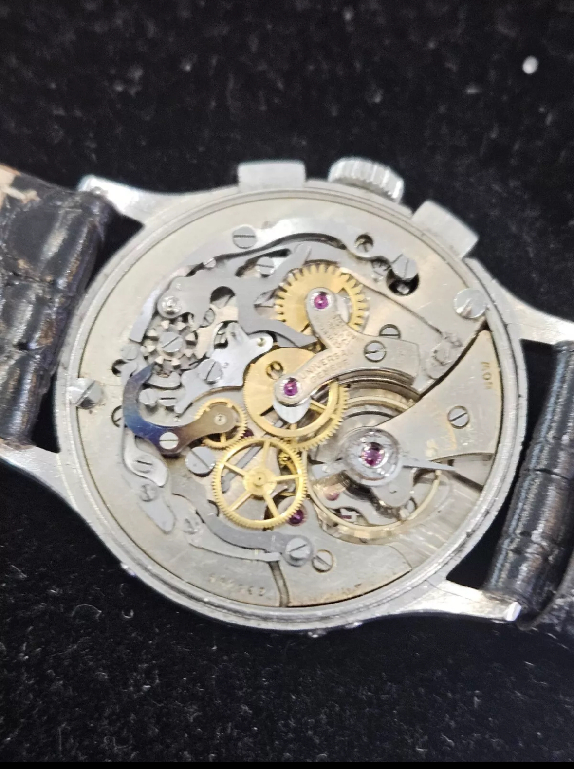

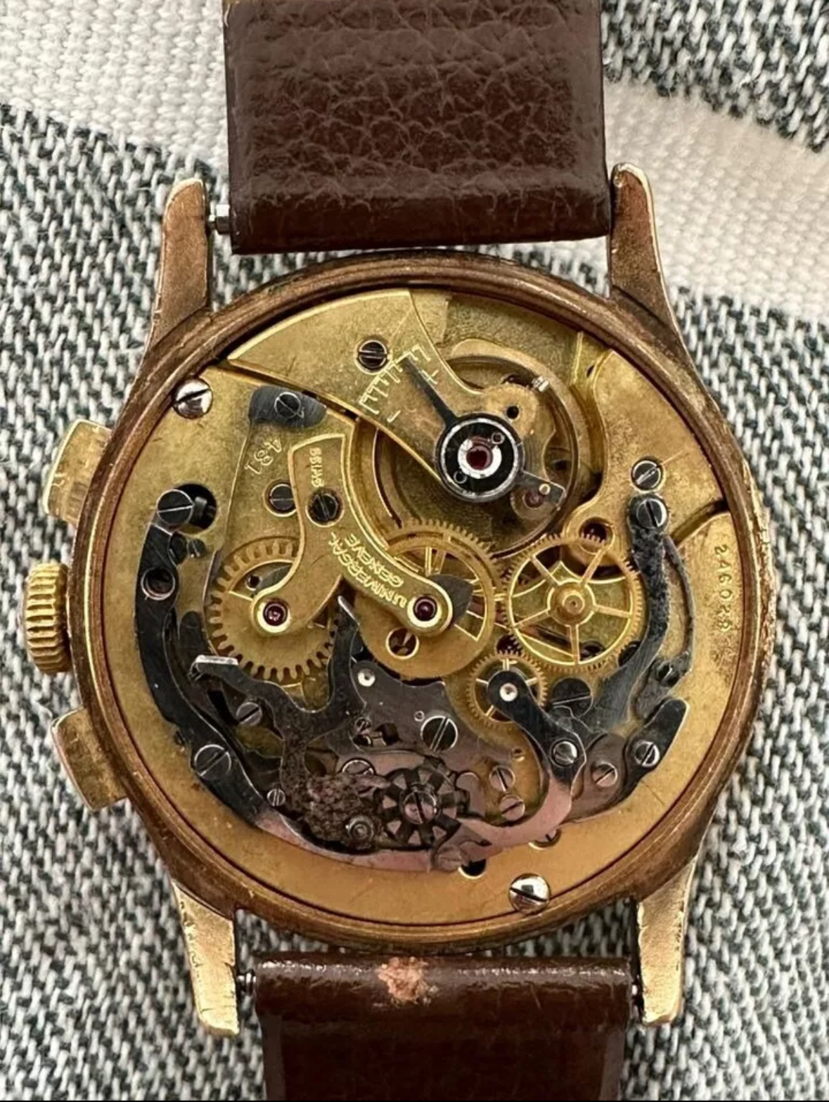

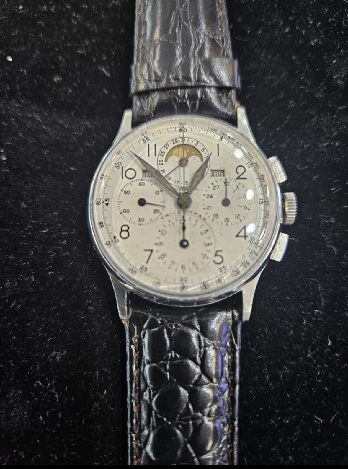

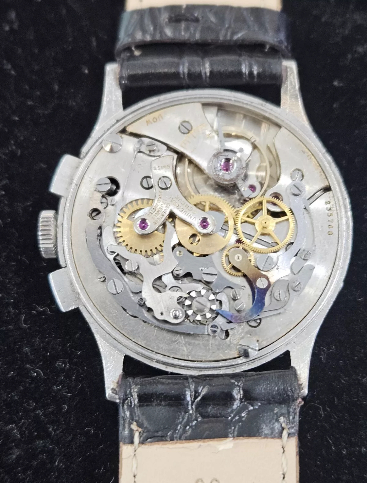

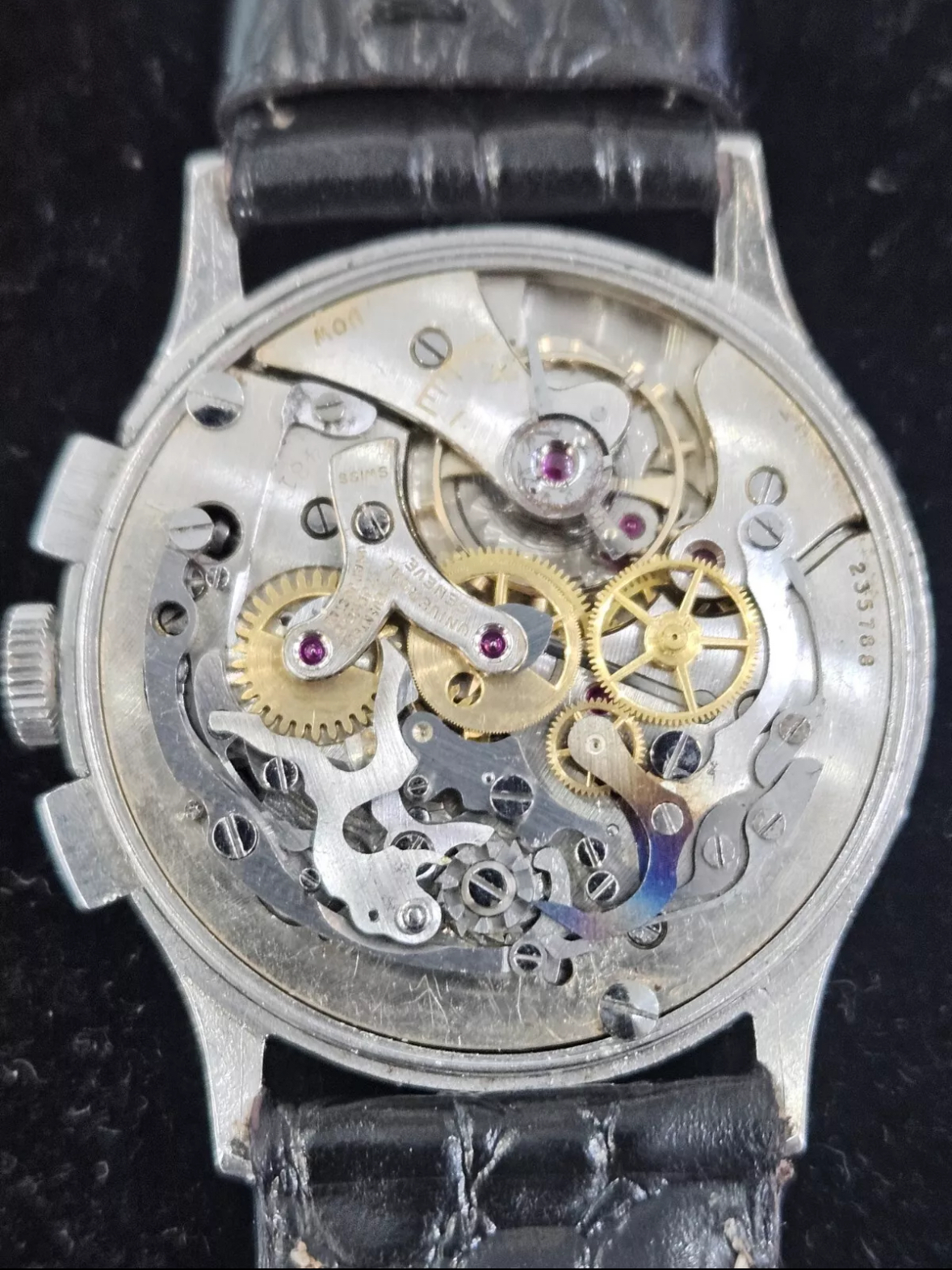

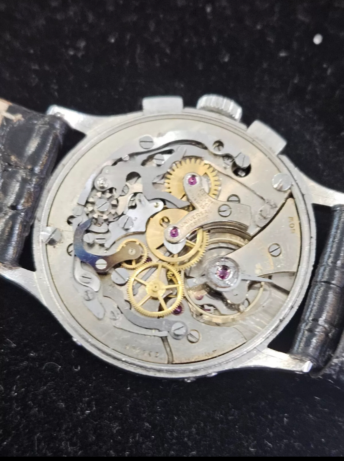

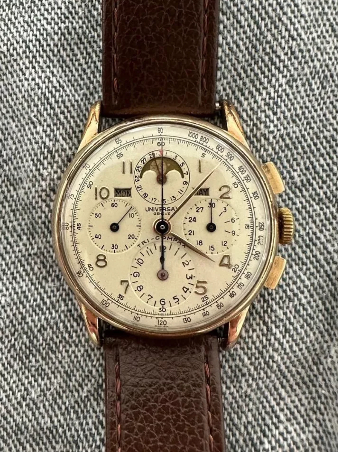

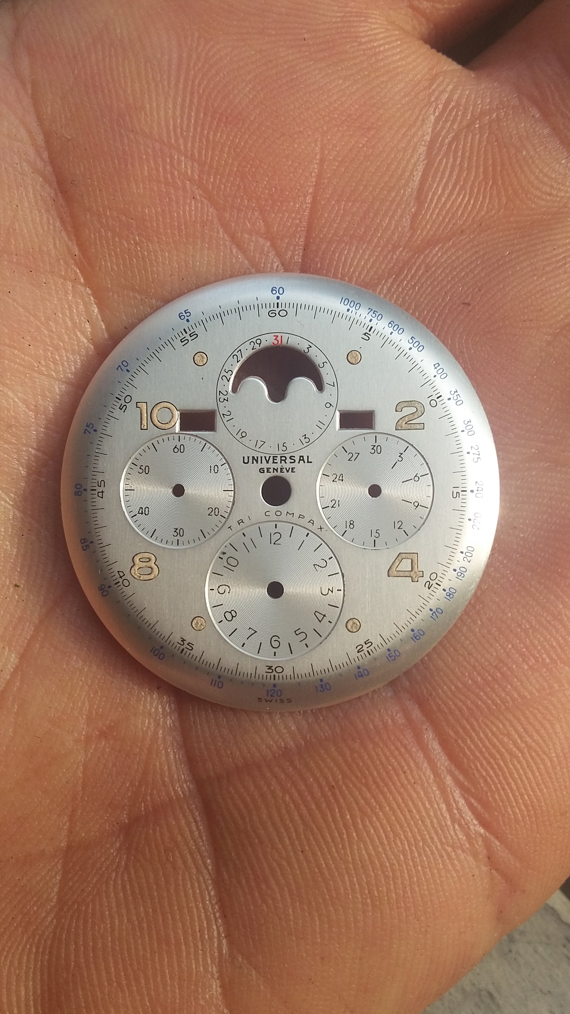

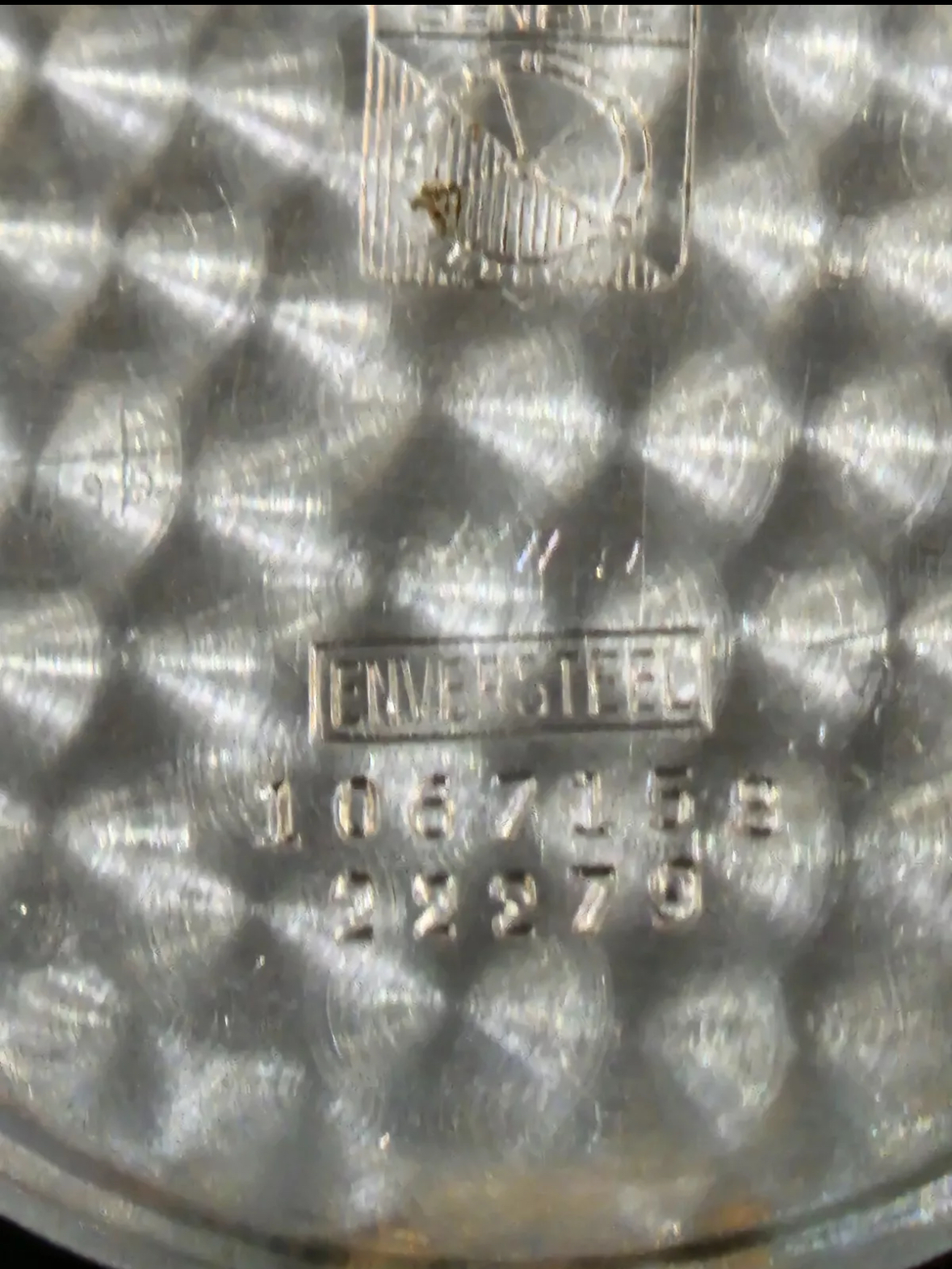

Is this a better example of a dial? Also, what is on the movement at 3 & 6 o’clock positions in the 2nd photo? Is that rust?

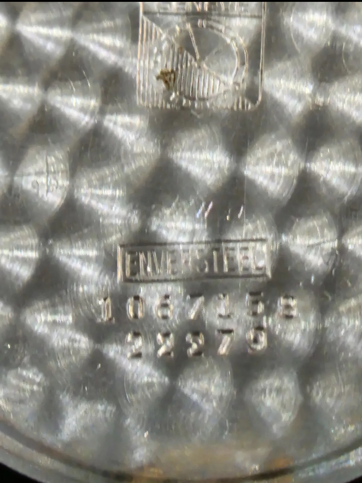

Washed dial, possibly partially redone/touched up outer track, and the springbar pins are filed off. Movement looks terrible. Case is over polished. Need to know ref and sn, more pics. However good hands and original moon. Fonts correct for a dial with original moon.

Read my response again.
10
So getting closer on the dial, but definitely a stay away due to the movement?
6,867
10,682
Also: two tone and probably replated....
