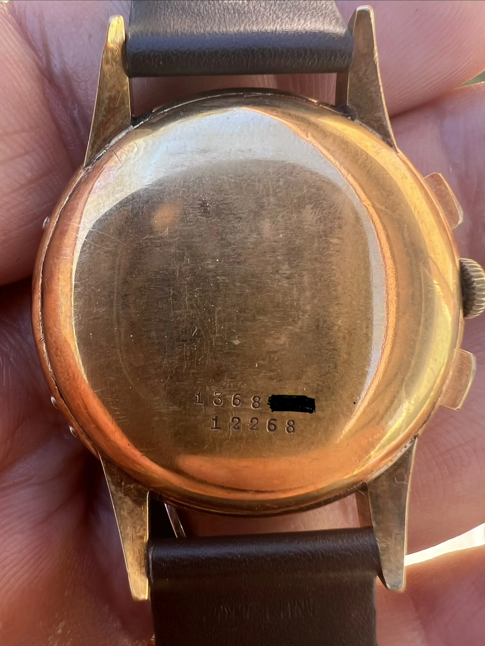

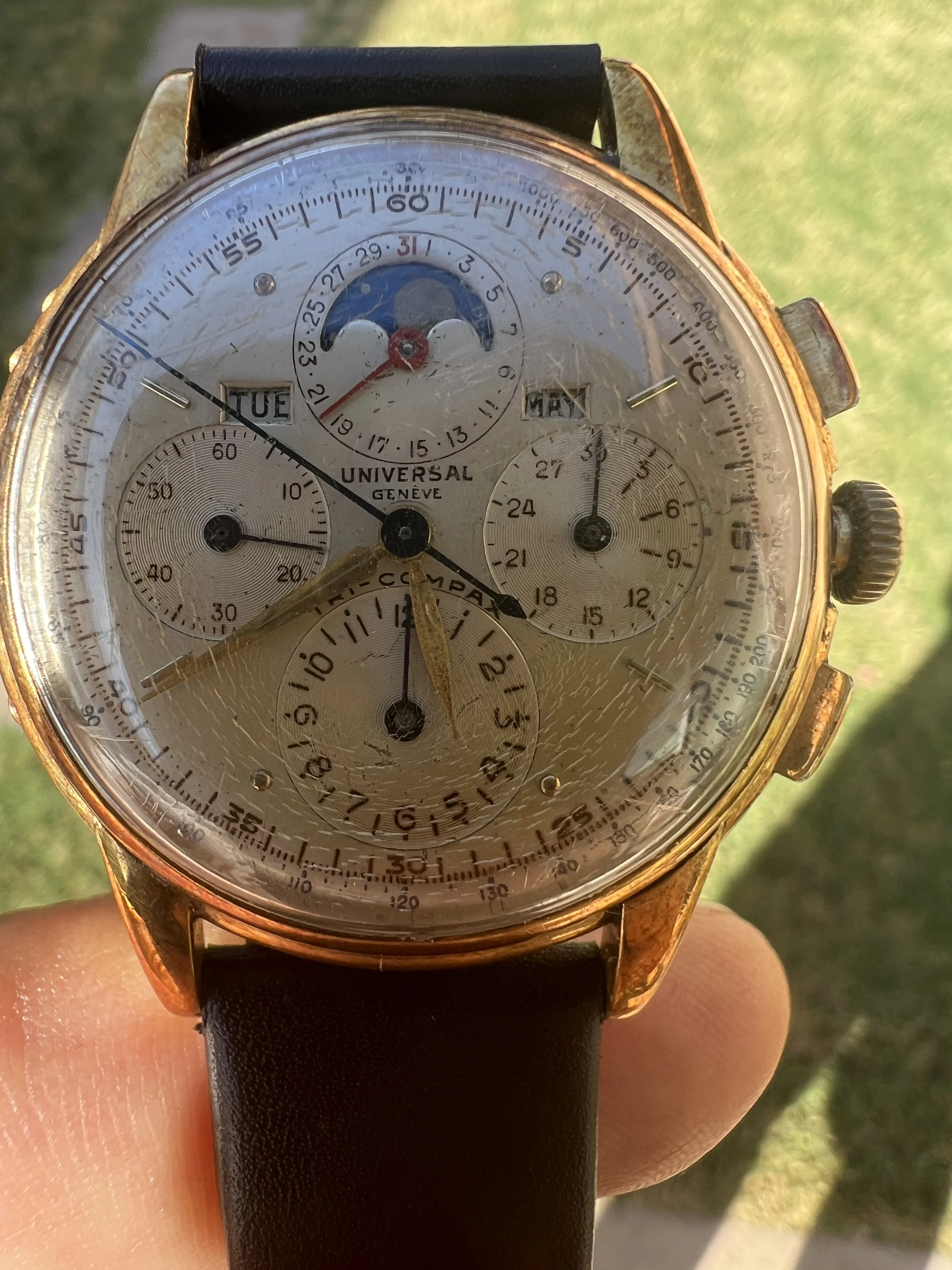

Hello everyone, this is my first time here on this forum. I was told that this was the place that I should come for information. I’m looking for recommendations of a reputable place to bring my UG tri-compax to be serviced and replace the crystal. It also stopped working a while ago, I thought that I “overwound” it, but I was told on Reddit that it most likely was gummed up with dried lubricants or possibly broken. Through some research I’ve discovered that there is a building in San Francisco with several watchmakers in it near Union Square, which one would you recommend?

Side note, your Tri is beautiful, but I think one or both hour/minute hands are wrong? (I can't tell if that leaf hour hand might be stock, it looks a bit odd and I would expect dauhphine, see below) It would look much better with correct hands, and a new crystal.
A quick search for 12268 shows both leaf hands (early case serial) and dauhphine hands (late serial, close to yours), I assume dauphine would be correct. Not sure how easy it is to get a set of correct hands for a cal 481, but I would search and have them swapped at the time of service if you can find something. Even leaf hands would look better than the current mismatch IMO.
good luck, it's a lovely Tri !

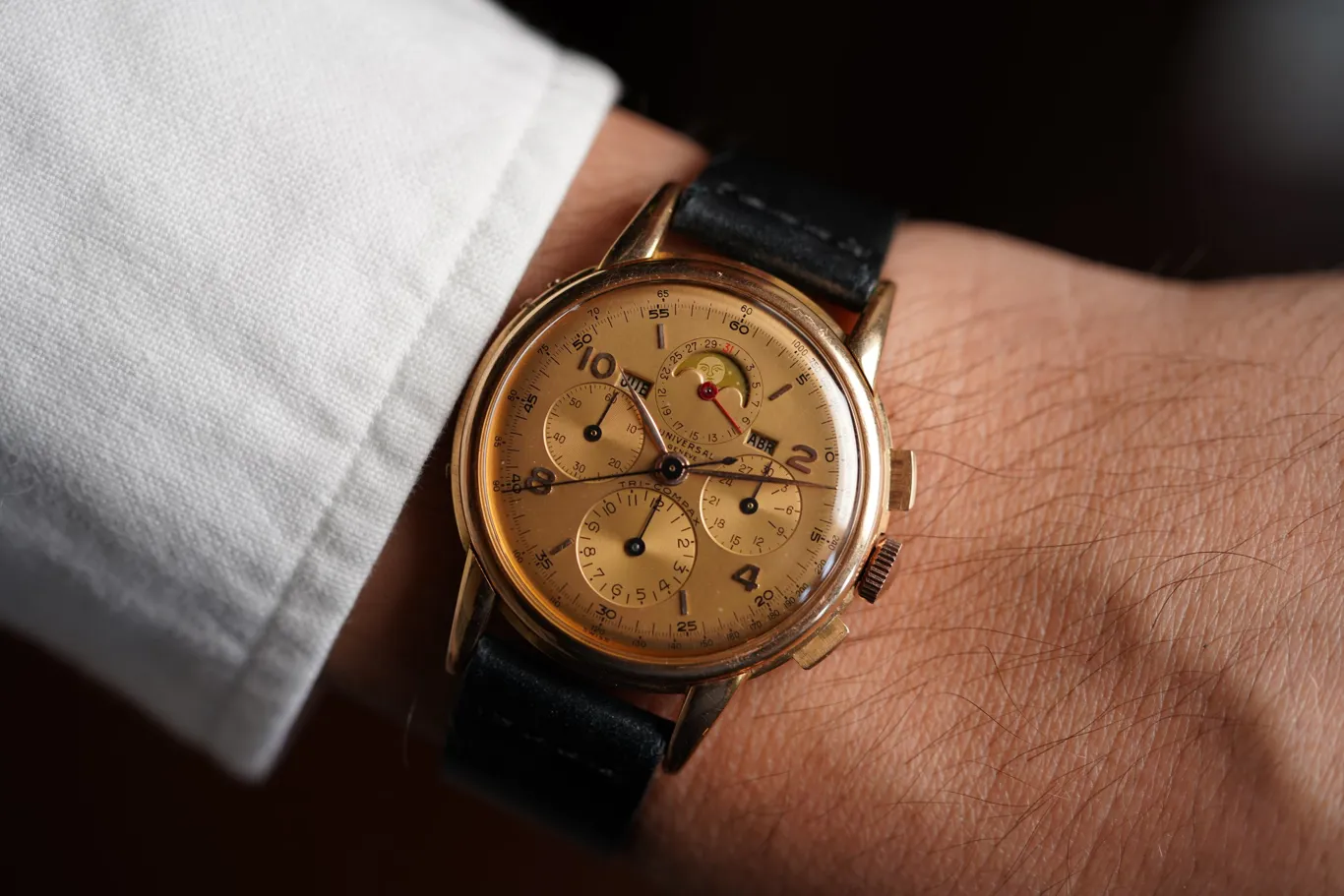

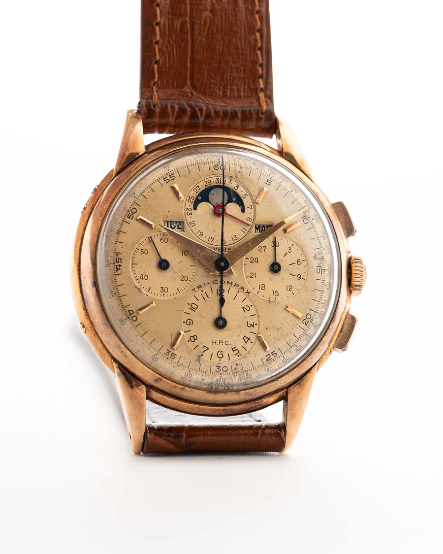

This one is serial 1129206, much earlier than yours....
This one is serial 1410739, closer to yours, also with the faceless moon, and I think a good reference for what yours should be....
