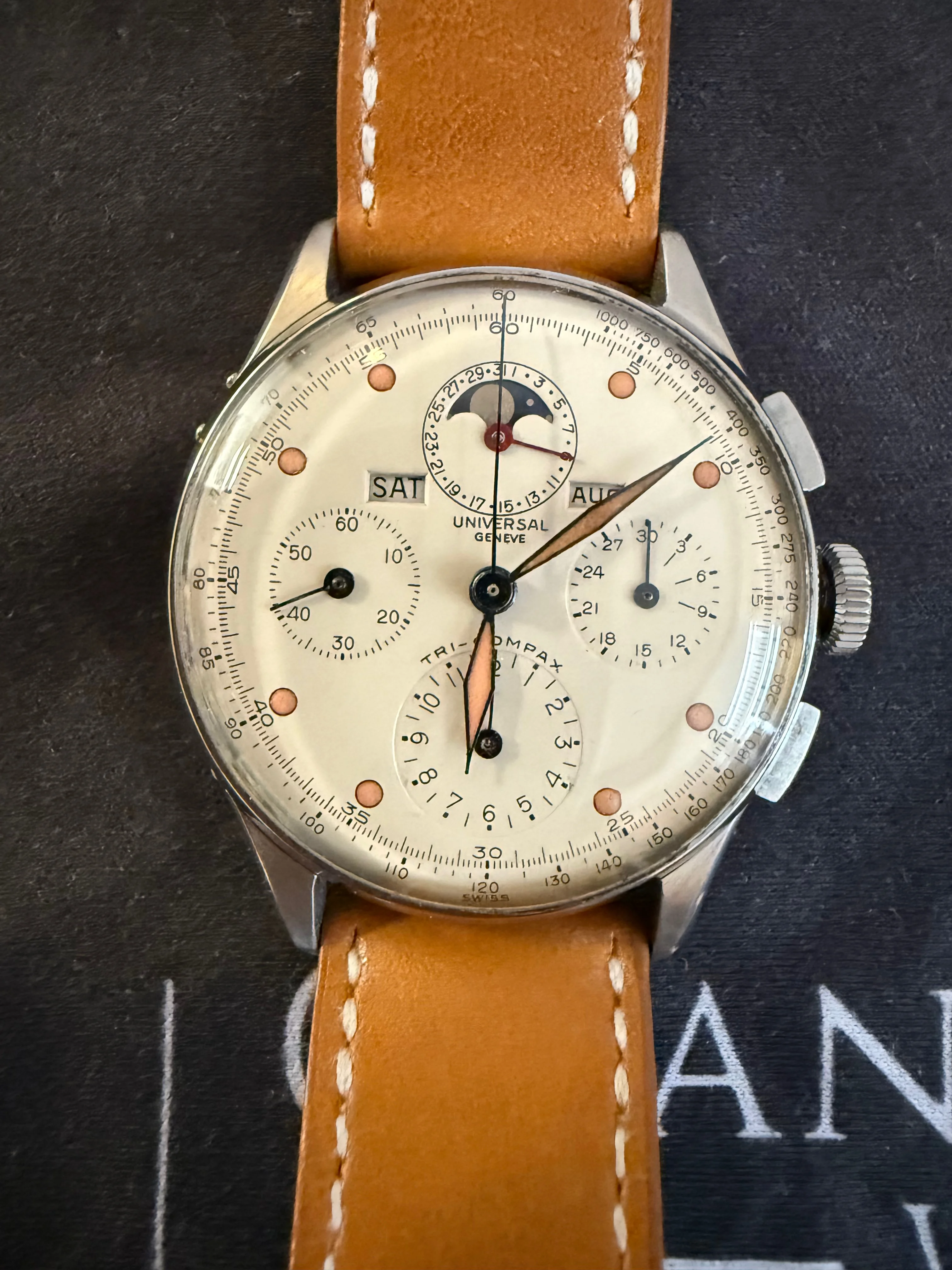

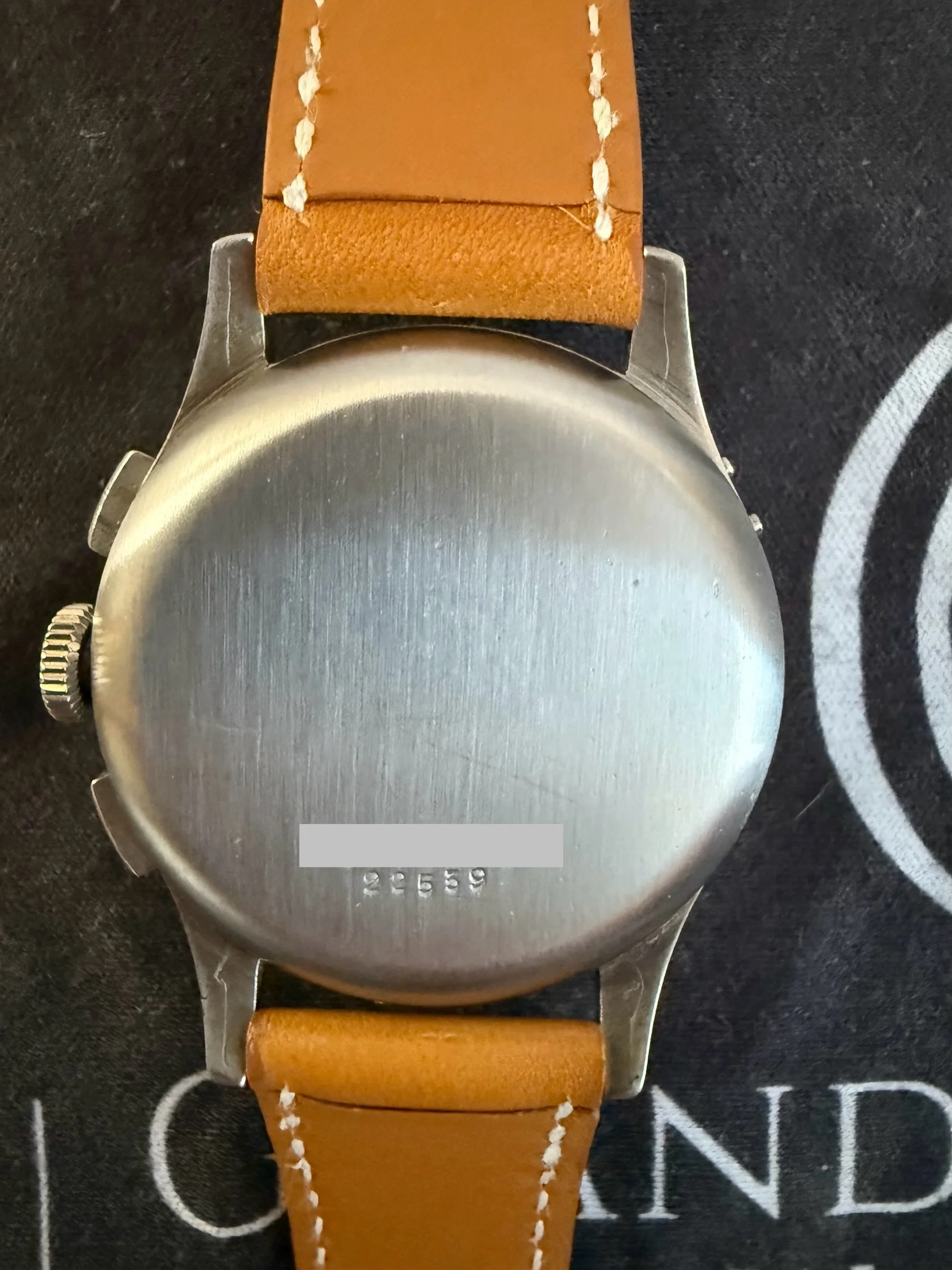

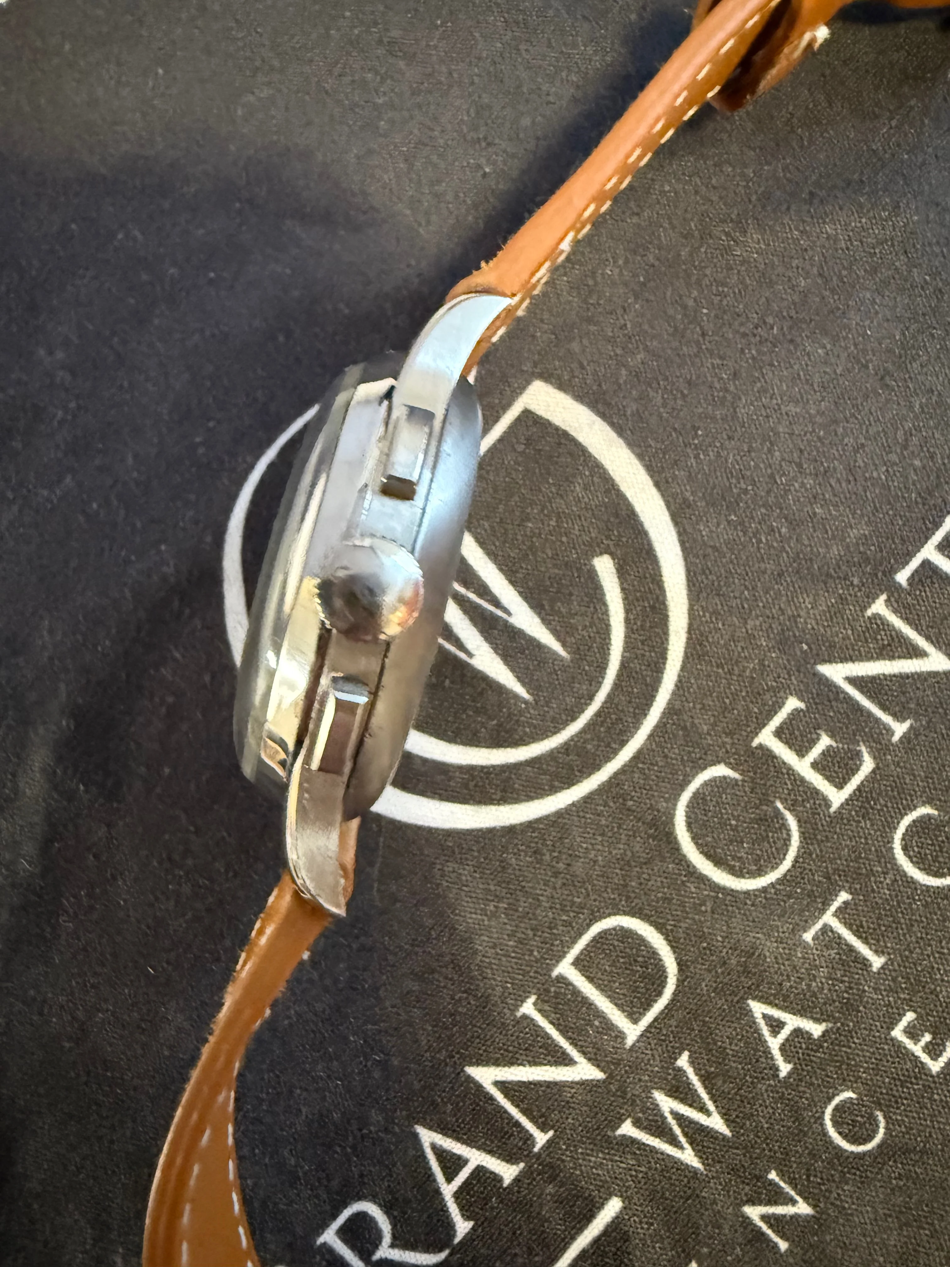

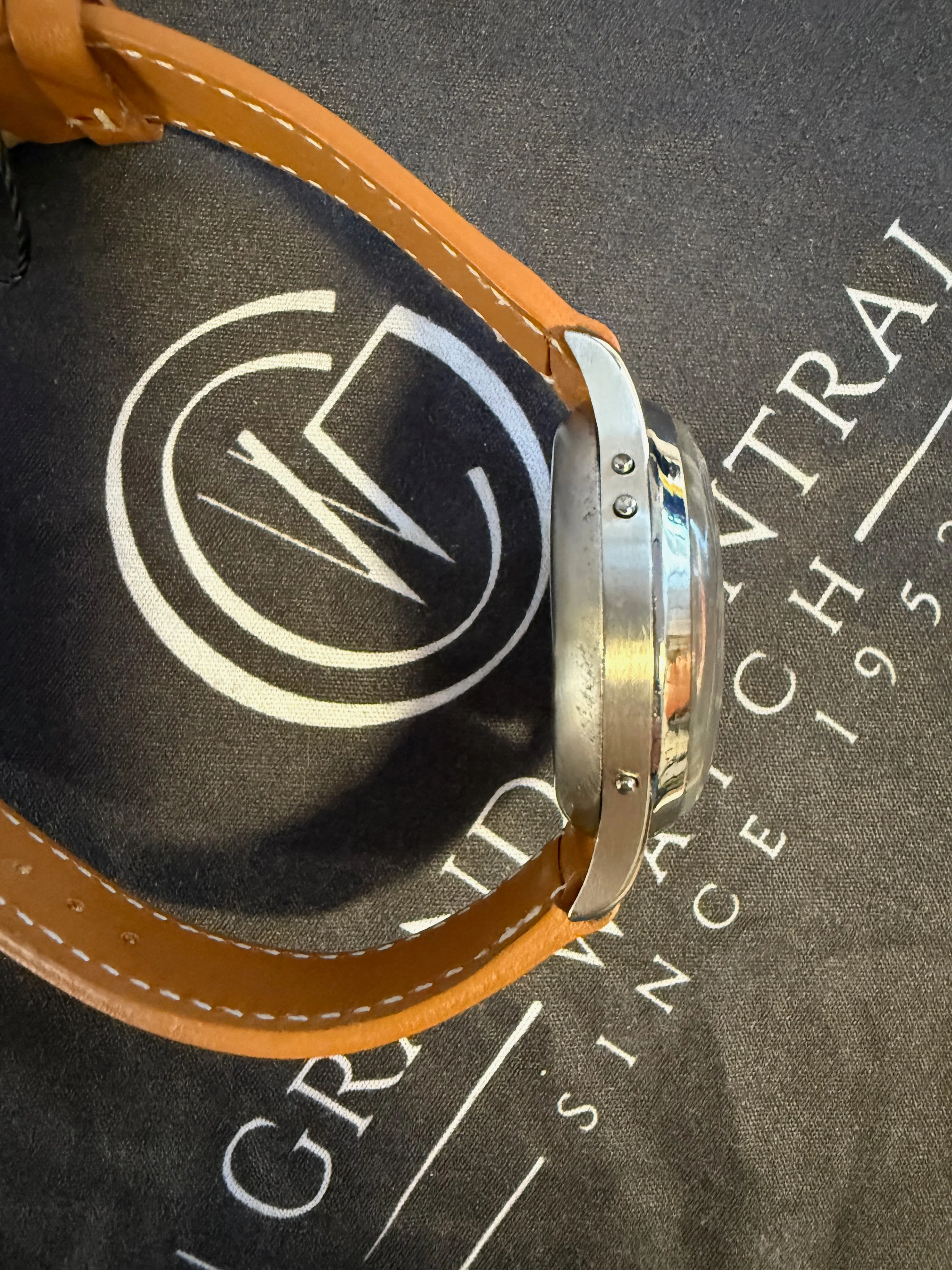

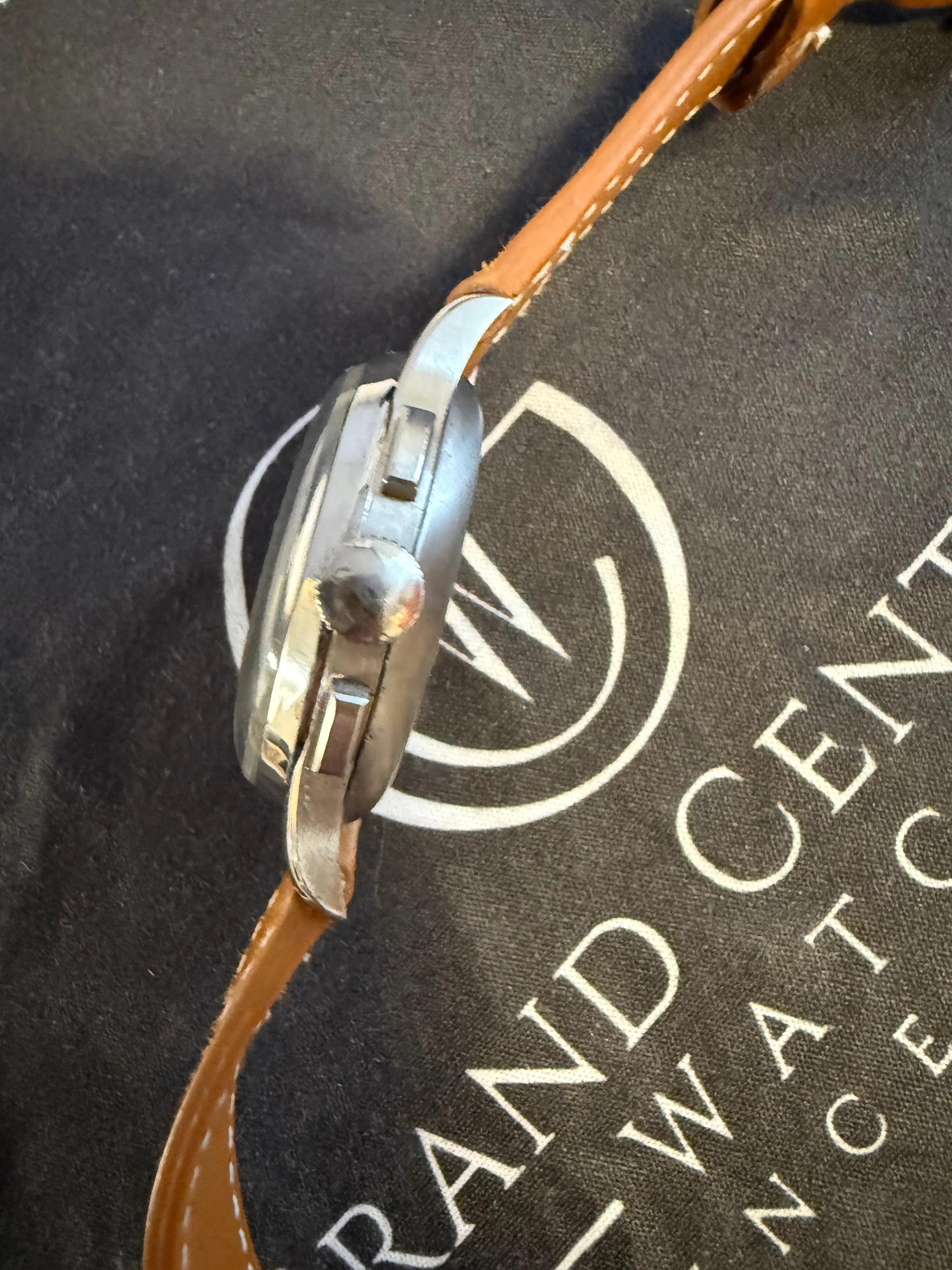

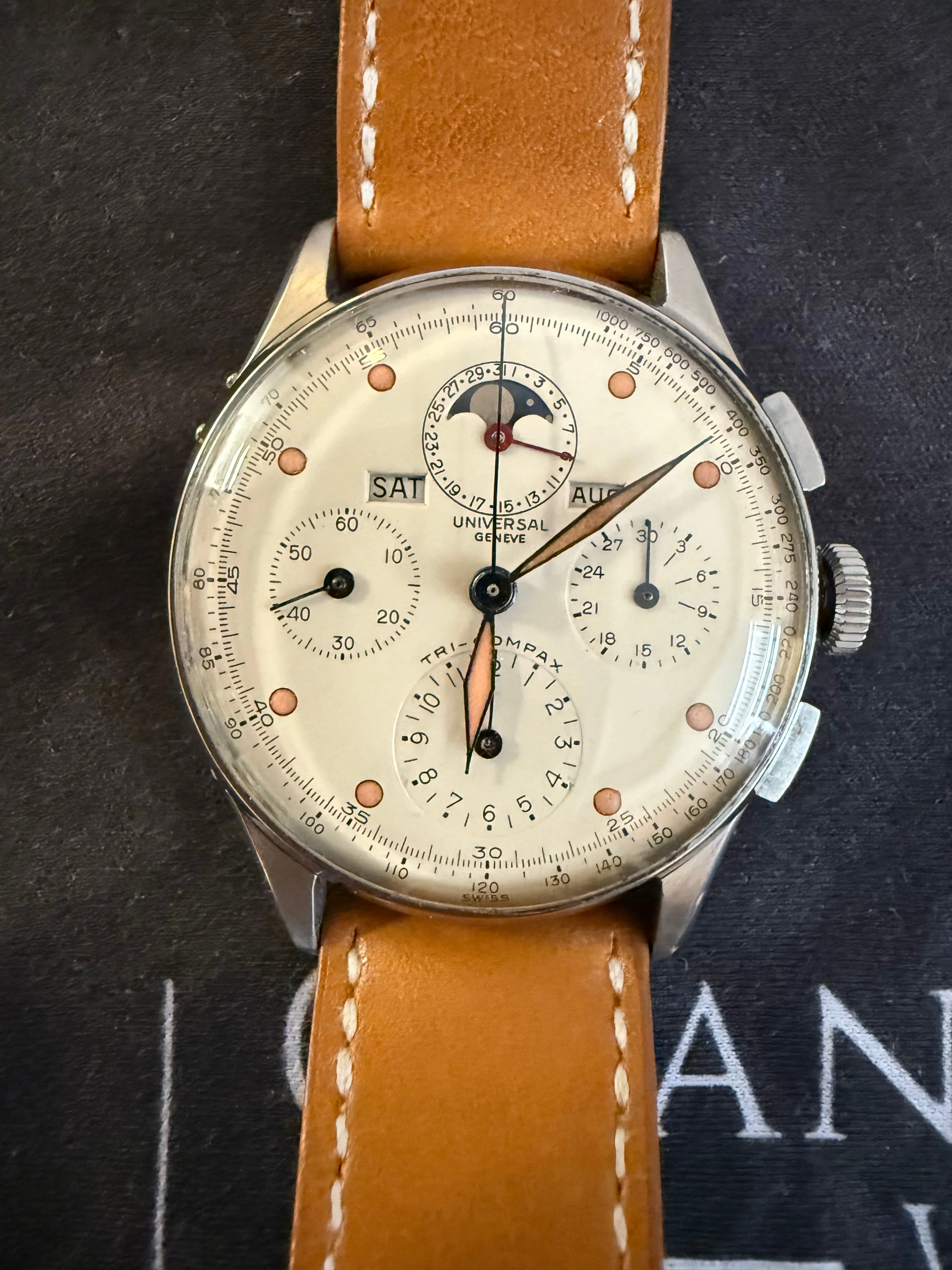

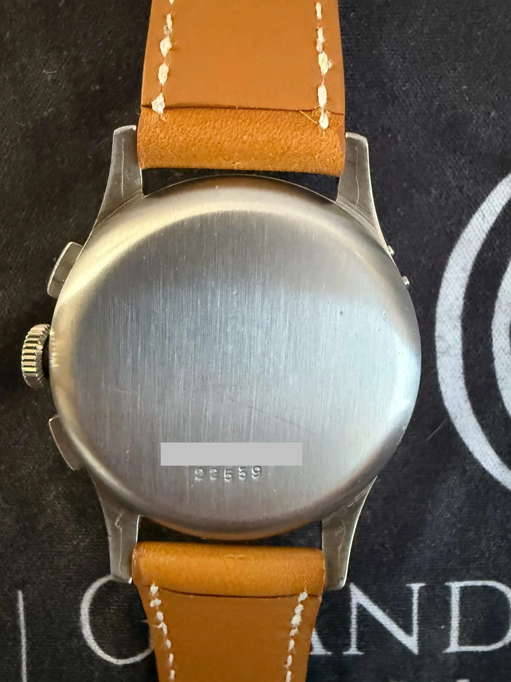

Hi all,
New to this forum and first post on here. Have been looking for a UG Tri-compax for a while now, and finally found one on C24 within my budget. From a US Based dealer in NY.
Ref 22539, no box/papers, dial refinishes. ~8k.
For those UG experts on here - would you buy this ?
Appreciate your input, thank you!
24,839
55,263
The overlap between UG experts and buyers of refinished dials is vanishingly small, I'm afraid.
18
3
Thanks Dan, yes new to this, so wanted to get a sense of what general view is on refinishing - absolute NO, or are there exceptions?
8,884
62,944
The exception would be if you're not a collector.
90% of the value is the dial.
3,719
8,553
Absolute no unless the asking price is below the value of the remaining parts (aside from dial)
18
3
Thank you. That said curious what you think on the quality of refinishing on this one?
14,003
54,319
it’s crap. Move on.
14,003
54,319
Keep shopping and be patient. Just be aware the the resurgence of the brand is leading to another wave of franken watches out there at stupid prices.

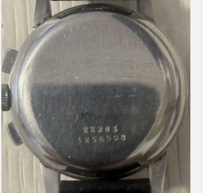

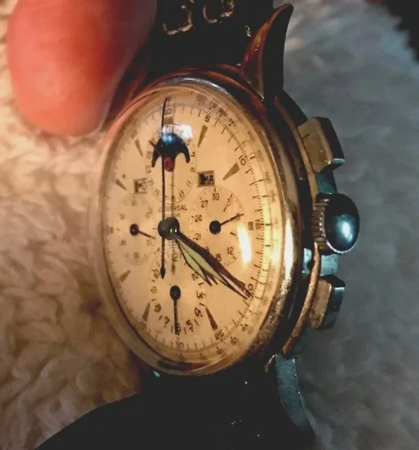

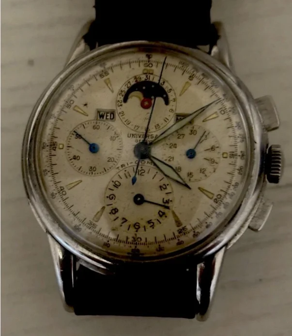

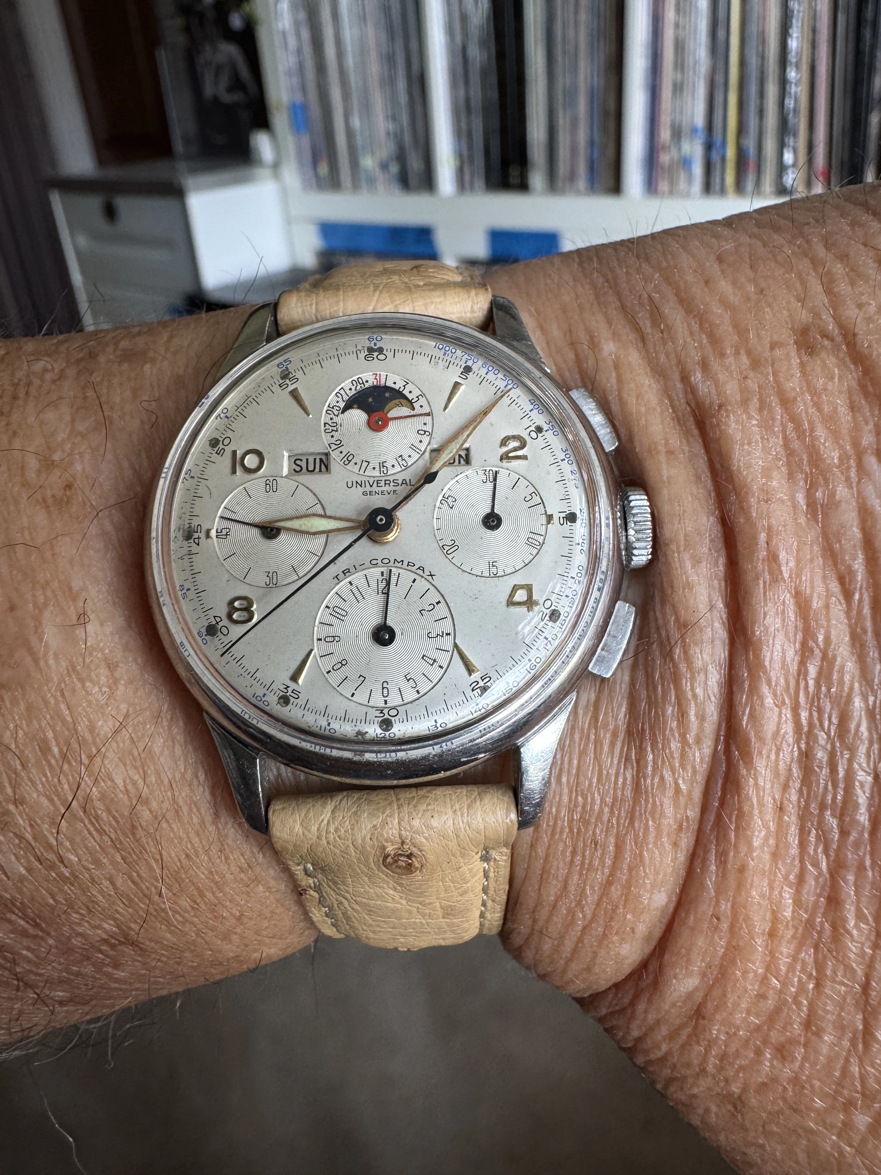

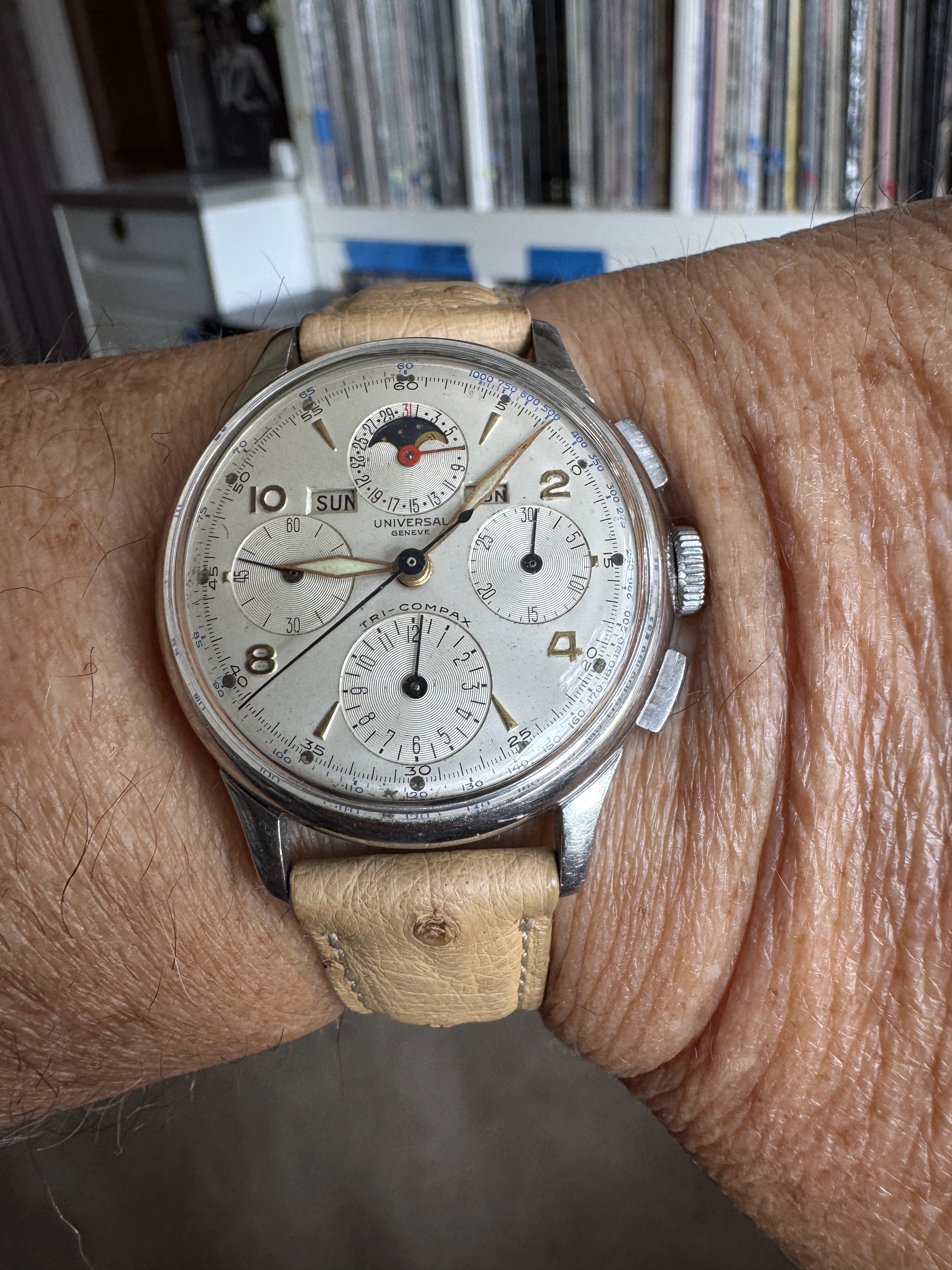

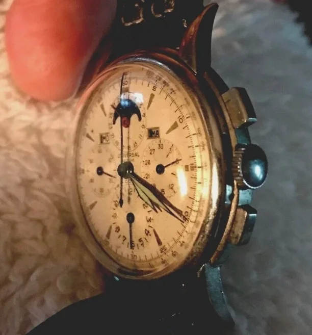

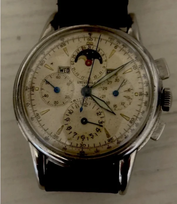

Here's another one. Always wary of e-bay and cant tell if this is a redial (given the dials quite dirty) or even just a fake! But tempted cos i've been searching for a 22283. Thoughts on this?
https://www.ebay.com/itm/2771785774...BSHKKC&hash=item40892171f8:g:lKgAAeSwnSZoR3ee

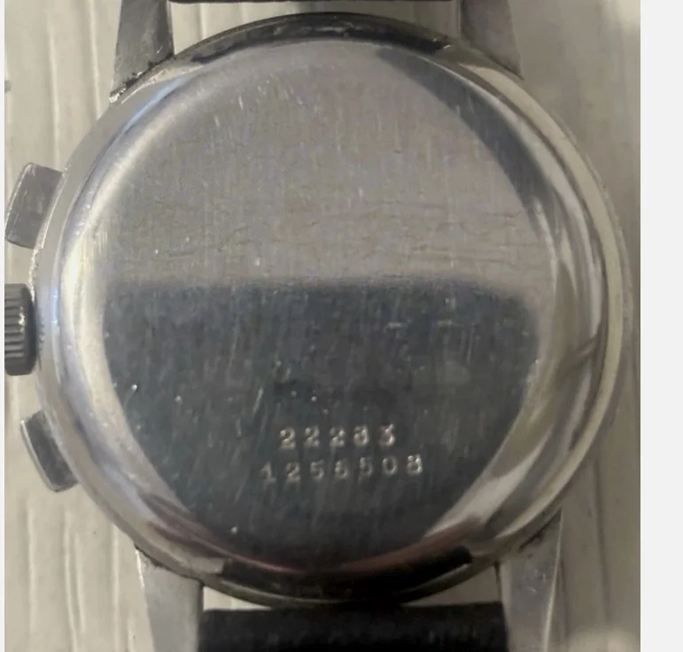

Serial number is quite clear - is it possible to look this up anywhere? And curious if its normal that there's no sign on the crown?
Have also asked for pictures where the moon is more visible
1,128
3,952
very average example, plus in need of a service, from what I see
3,719
8,553
Dial original, moderate condition. Case looks pretty good although upper pusher seems hyper extended? Can't eval chrono reset, did they have it running or it's stuck that way? Moonphase looks replaced. H/M hands not original IMO. Wouldn't consider it at the asking price, not sure at what point I would, because overall it's not super attractive. Maybe partially because terrible seller pics. Might look better, with decent photos, in natural light.
