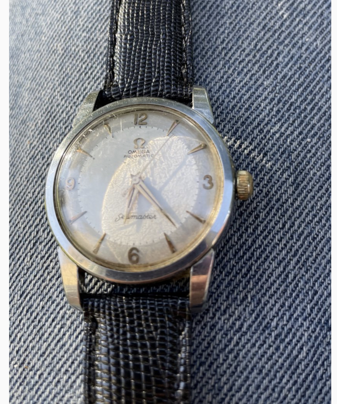

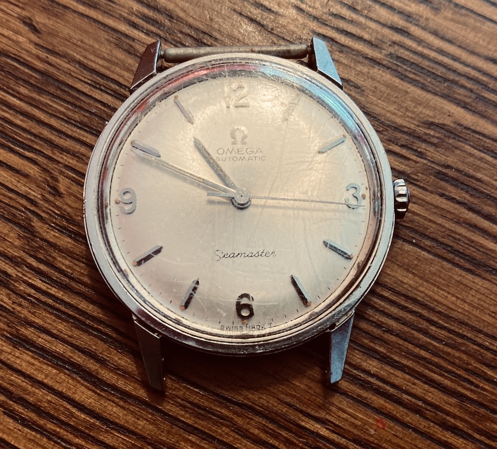

Hi,
I have my father's Seamaster from about the late 50's or early 60's. This was his watch as far back as I remember. He died in 1987 and the watch has been in a drawer since.
I wound it up and it's keeping time but losing near 2 minutes per day. Needs a band and one of the pins.
Can a watch repair man adjust it so it will maintain time more accurately?
Can the crystal be replaced? It's not terrible, but it is scratched a bit. I saw a video[1] of a fellow replacing an Omega crystal with a polycarb (or some such) "crystal" - I assume 3rd party.
Suggestions for Laval or Montreal repair shops?
Thanks!
Alan
Edit: put in photo where the watch is in focus instead of the table ...
[1] YouTube channel: Wristwatch Revival

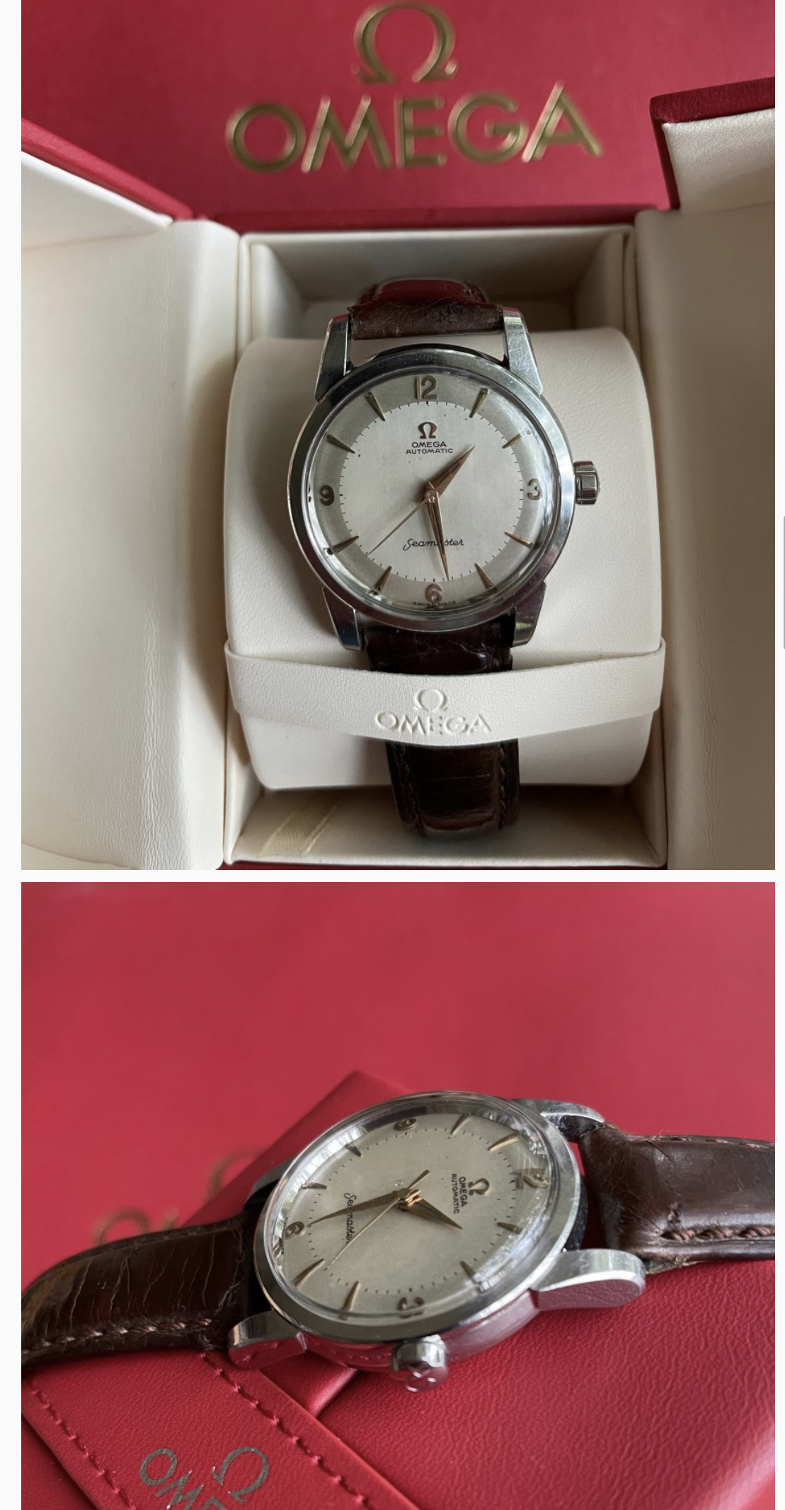

It sure can be fixed. And it will be worth a lot to you since it was your father’s. Check out Precision Horology near Ottawa. Ashton did a great job on mine and came recommended by Archer, who will need no introduction once you spend a bit of time on this Forum. Ashton is also a forum member. @ATracyWatches
Enjoy the watch and this Forum.
Late entry. Ashton sent my watch back with a factory crown, crystal and even a nice Omega box. Before and after.

Just to be clear, the watch needs more than an adjustment. The watchmaker will likely suggest a complete service (a.k.a. "overhaul"), which includes complete disassembly of the movement, cleaning, and reassembly with proper lubrication. During the process, sometimes it is determined that worn parts need to be replaced. Unless there is a crack I'm not seeing, acrylic crystals like your can easily be polished to remove the scratches. If you prefer, a replacement is not expensive. A collector would recommend not polishing the case, since in the process of making it shiny, the nice sharp original edges of the case will be blunted and rounded over. You can buy a generic strap anywhere. You just need to measure the distance between the lugs to get the correct width (probably 18mm).

I'm pretty sure the crystal is acrylic, not sure what else it could possibly be on that watch. As I noted, if you're looking to save money, just polish out the scratches. That's a normal thing to do for minor scratches like yours. Spring-bars are a trivial cost. The watchmaker will provide them.
Having the watch serviced properly will generally cost at least a few hundred currency units. It's the price of owning a mechanical watch. By the way, the site has a private messaging system, which can be used to ask questions discreetly.

I will add, which I tried to express in the email, is that if you want the watch to run right - cleaning some points and lubricating areas - won’t have the watch running right. Timing adjustments aren’t mutually exclusive, everything is intertwined. Honestly, if you don’t want to put money into servicing it, just don’t service it. Leave it as is. You will just be wasting money.

In my experience, a half-hearted attempt to regulate the watch and/or add oil without a proper cleaning will likely provide a temporary improvement at best. It might seem to help for a few weeks or months, but then you will be back in the same situation and out the money you paid. Wasted money, which may be what Ashton is thinking. Adding more oil without cleaning out the old residue and debris is simply not effective. Be aware that some really cheap watch repair places will perform a type of service that cleans the movement (and adds some lubricant) without disassembly, which can actually be worse than doing nothing, although again it may initially appear to have improved performance.
Being budget conscious is fine, but in your place I would be looking to find someone who can do a complete service to preserve the movement against further wear and tear, while perhaps saving money elsewhere, by re-using parts that are not necessary to replace, for example. I would certainly polish the crystal myself, and perhaps you can do without replacing the mainspring, etc.

The lubricants have not outgassed in 30 years - they have become a viscous gunk. This is why the movement needs to be completely taken apart, the pieces cleaned, then lubricant reapplied. One can’t simply just squirt some oil into a few places after opening the back and get it to work properly - doing that will likely make it worse.
If you don’t want to spend a few hundred dollars for a complete overhaul (which is understandable since you are not into mechanical watches), then I wouldn’t waste any money on a half-a**ed “regulation” and just sell it as is.
It's very effective if you want to make grinding paste out of whatever debris is already there...
What I wrote: " If that <old lube> can be removed and new lubricant added; timing adjusted, it may be okay."
The only way to clean the movement of old oils is to fully disassemble it. It's then cleaned, assembled, lubricated, and adjusted. That takes time and money. There are no short cuts.

Take a good look at an exploded view of a watch movement and you will quickly see that this can't be done without disassembly.
