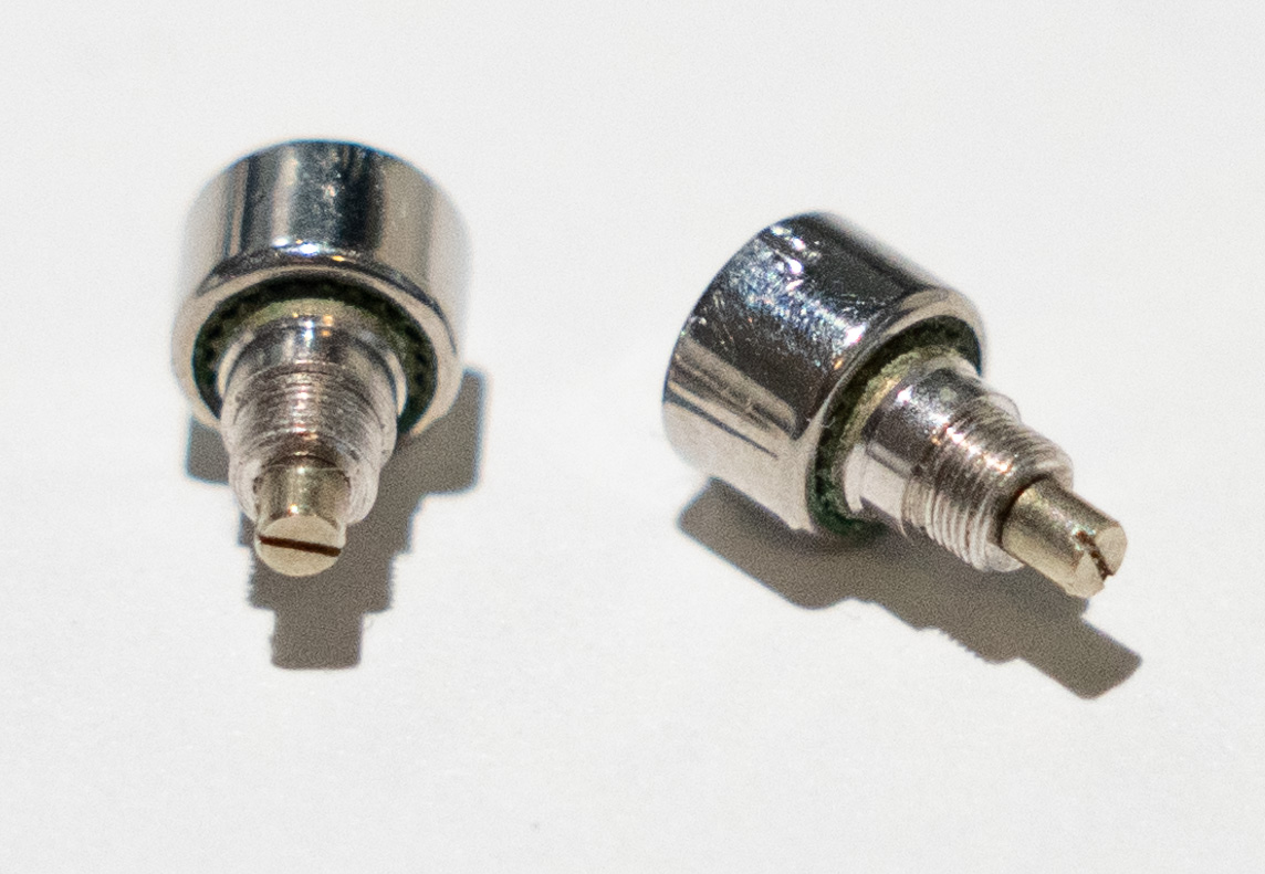

Hello, I did the mistake a while ago to let my Speedmaster serviced by Omega. I was new to Vintage. Omega replaced all the vintage critical parts. At least they sent back the original parts after kindly asking them.
All vintage parts are back in place again, except the pushers. Omega damaged them while replacing them. It seems that the used a pliers.
I'm attaching a photo of the original pushers. The tip that goes inside looks like coated brass. It's not typical yellow as brass but not "silver" as steel.
My watchmaker said that he might be able to restore the pushers. There'll be steel soldered onto the damaged areas and then the pushers will be remodeled. Cleaning and new gaskets etc. All that an expensive procedure.
My question:
Does anybody know if these are really the original pushers and not already serviced ones? I'm just trying to find out if it's worth to get my pushers restored.
Thanks for your help!
Volkan

No difference between the service part and the original as far as the design and part itself goes.
Yes, it is not the original pusher but same/same otherwise. They may already have been changed over the last 50yrs and most would never know. Not an issue for me personally for a -69, I prefer new pushers and crown if I plan on wearing it.
A 105.012 and earlier I would give a different answer but service pushers on a -69 is no issue for me.

Vintage, yes, they look vintage to me. Original to the watch, who knows.
It is one of the most often changed parts during service so if it ever had a service in its lifetime there is a good chance they were replaced. Or not, its just nearly impossible to know if pushers on a -69 are original to the watch. IMO "Could be" original, is as close as you get on a -69 and they are in that category, if they are service replacements they are at least vintage replacements.
On replacing pusher caps; if you go that route I think you would still need to find vintage ones. The only reason not to use service pushers in the first place (for this particular watch/reference) is if you feel that they look too new for the overall look of the watch. If thats the reason then new pusher caps will have the same effect.
Again, just my opinion. I take good seals over original pushers, but I keep the original pushers to include in the event of a sale later.

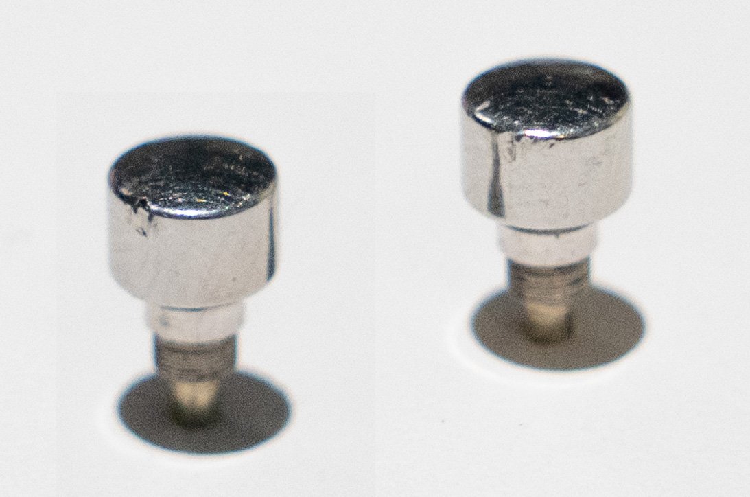

You can see the marks where the pushers have been removed with pliers.
saves time, and is omega procedure as they don’t re use them.

I would not bother to restore pushers on -69’s and later, services ones are perfectly acceptable imo.
Different with crowns as -69’s to -71’s used a different crown to -74’s onwards (slightl generalisation there) so I’d always try and keep the original A1 or A2 crown, accepting there will be an impact on water resistance.
The pusher caps are Nickel coated brass. Your watchmaker won't be able to solder steel on to them.
94
63
Oh ... I thought the caps are stainless steel and the tube is coated brass.
