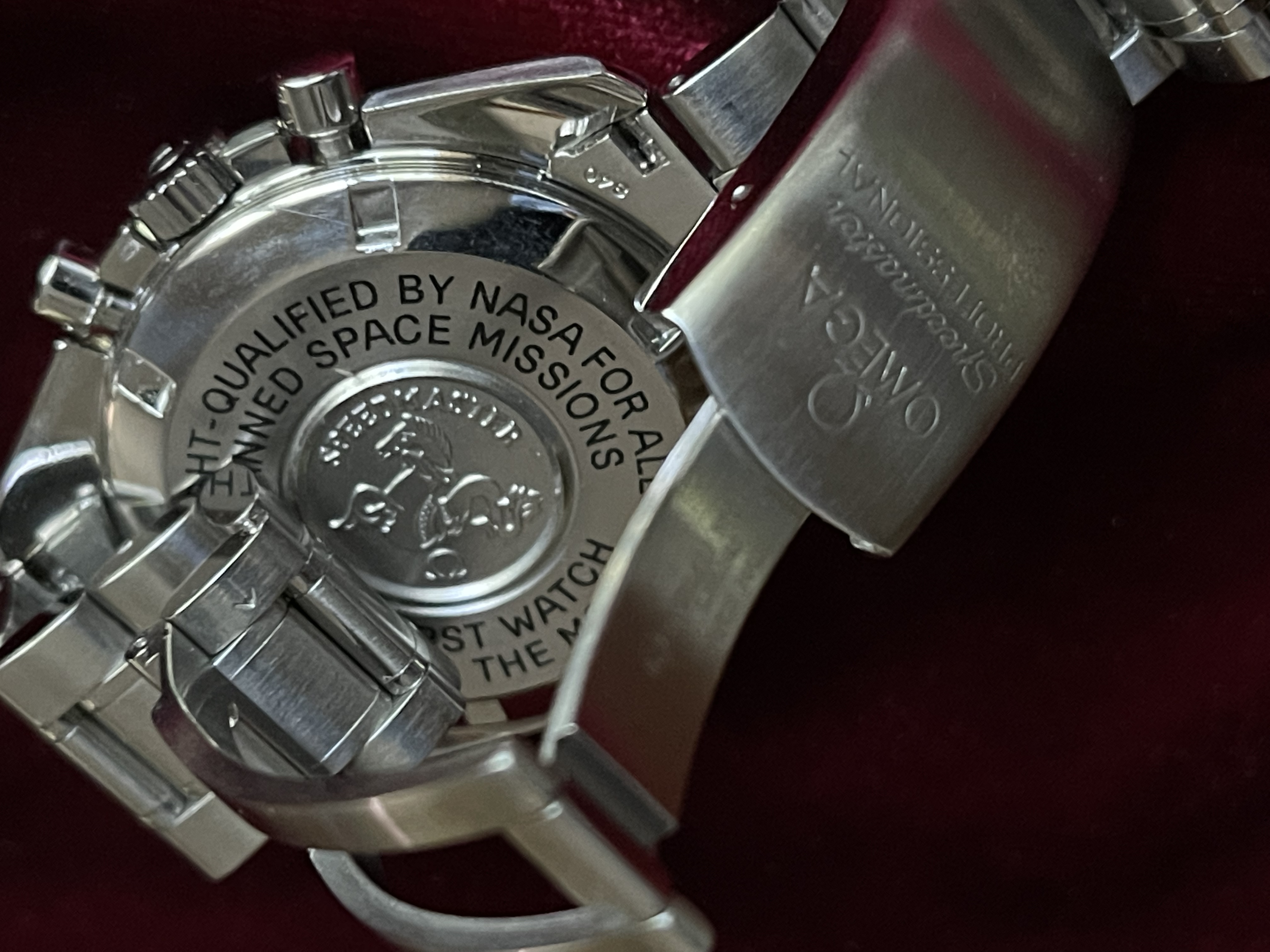

the case back looks suspect to me.

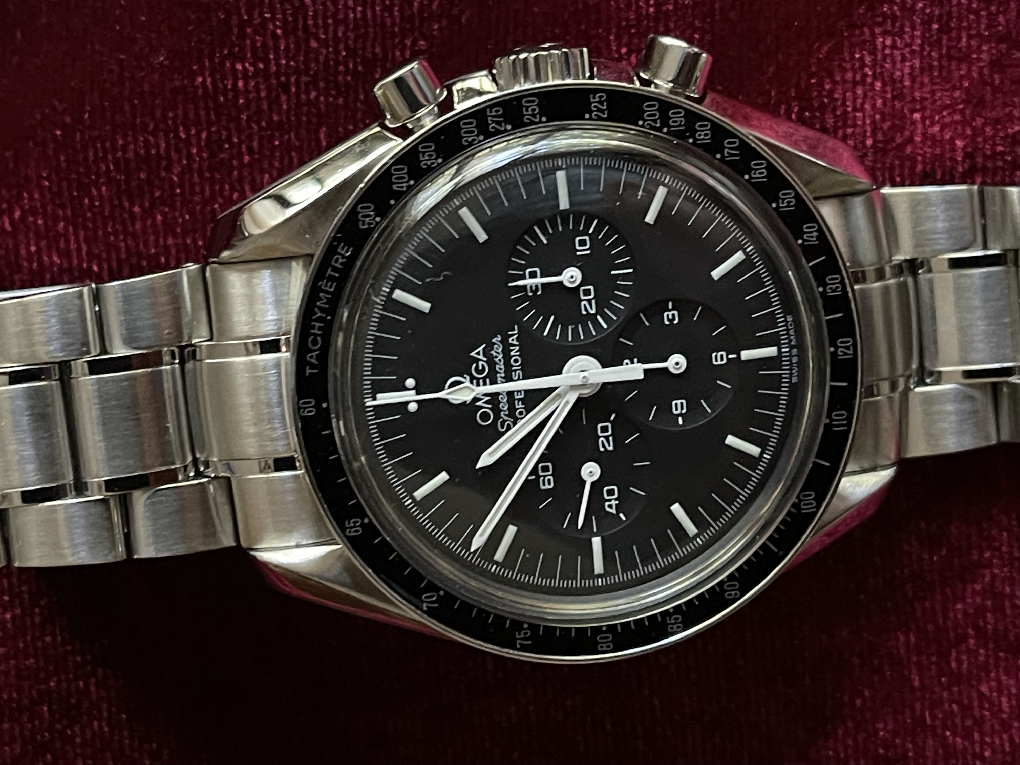

the font looks fat to me and a little sloppy. could be repainted letters, could be a bad photo. the S on "missions" looks like it has a serif, and should be sharper. also the hippocampus looks dull too. as in the bevels should be sharper. could just be worn down. i dunno.
the arrow on the bracelet looks funny too. looks like the lines dont touch --- >
although, i am not an expert either... just wary of great deals. could all be the photos. open the back and compare the movement to a know one.
but if its genuine, and you paid speedy reduced price for a pro, you have done well.

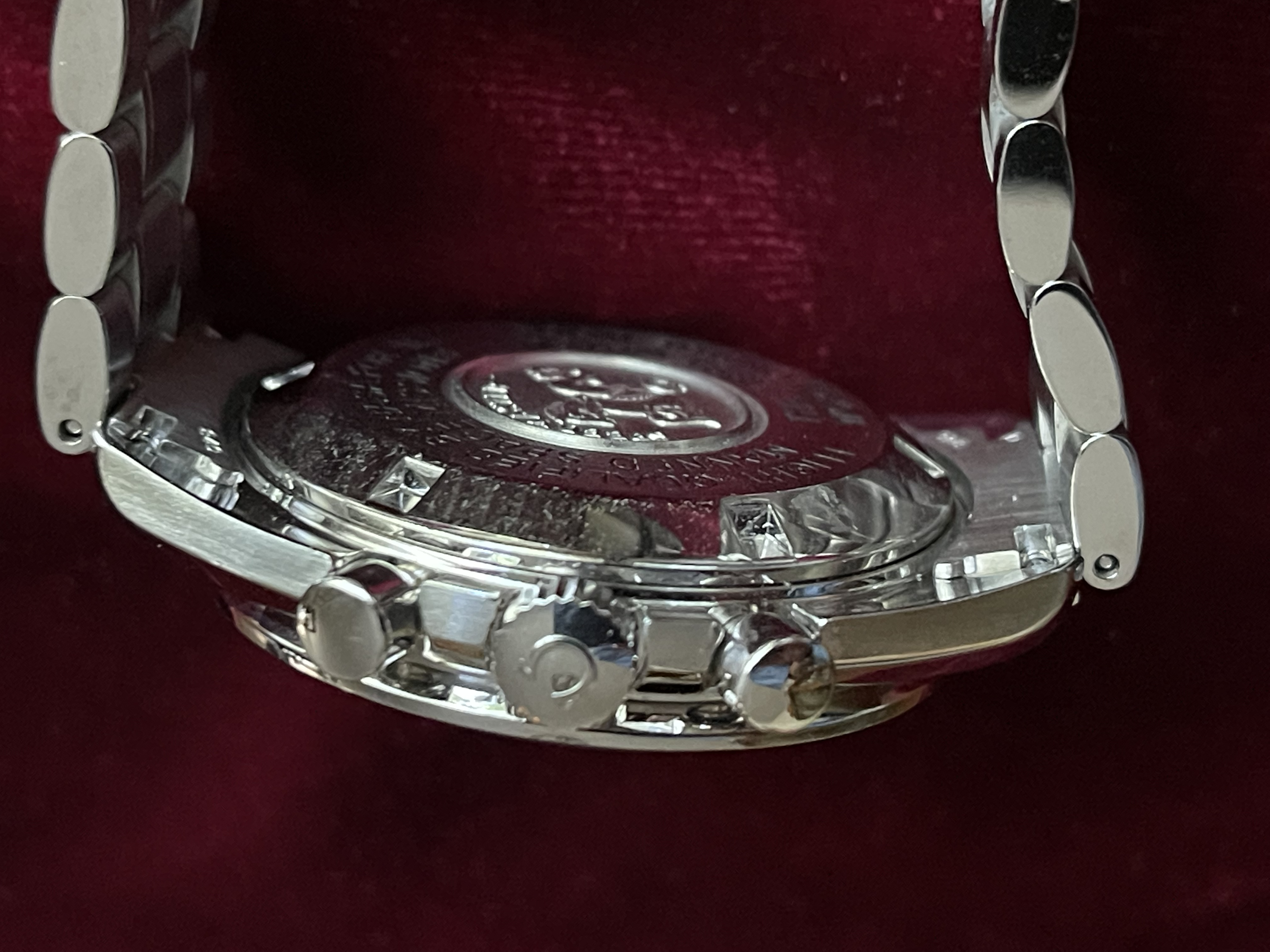

I think that the watch has been lightly polished at some point. Most of the ring around the hippo is sharply defined, with the "master" sideslightly less so; as if the wheel lingered too long in one spot. I haven't worked up the nerve to crack it open yet. Bracelet is what stumped me. Both my old and new Seamaster Pros have release buttons on the clasp. I wondered whether this was a "women's size" Speedy and bracelet combo. The price was very good for a "reduced", so I'm happy either way it turns out.

i know that there has been two versions of the clasp : first without pusher buttons, and later with some

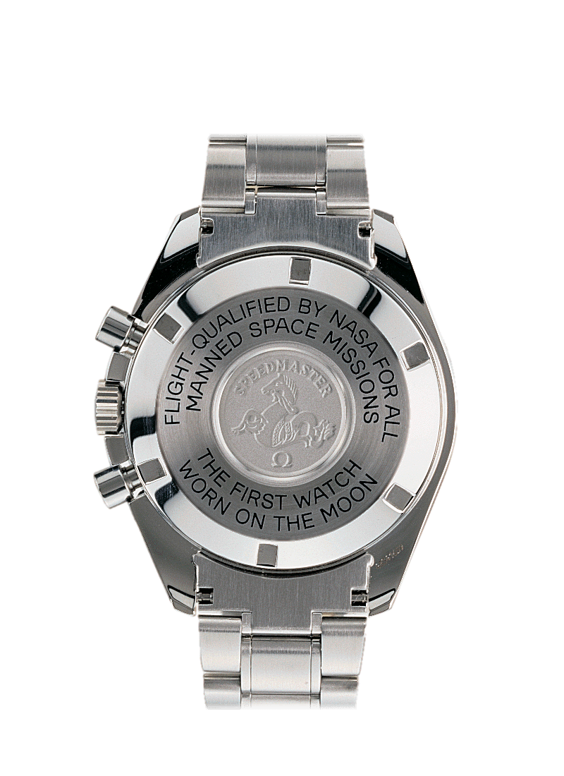

Fonts look like the real one. pic from Omega
Edit : mmh, yes maybe fatter / repainted…

the bracelet reference number is on the clasp. could be 1498/840, 1498/849 or 1998/840,849
the 1498 tapers to 16mm while the 1998 tapers to 18mm.
i have seen both clasps with and without pushers on the 1498

I sucked it up and paid a visit to the AD from whom I have purchased "some items" in the past. Felt like a philandering husband when I showed him the watch and asked for his opinion. Opened it up and louped it. It seems that the watch is a Moonwatch 3570.50, with 1498.840 bracelet (Thanks for that tip Cayohuesovespa!).
I appreciate the info offered by all.
Oh, and I'm REALLY HAPPY with this watch.....
