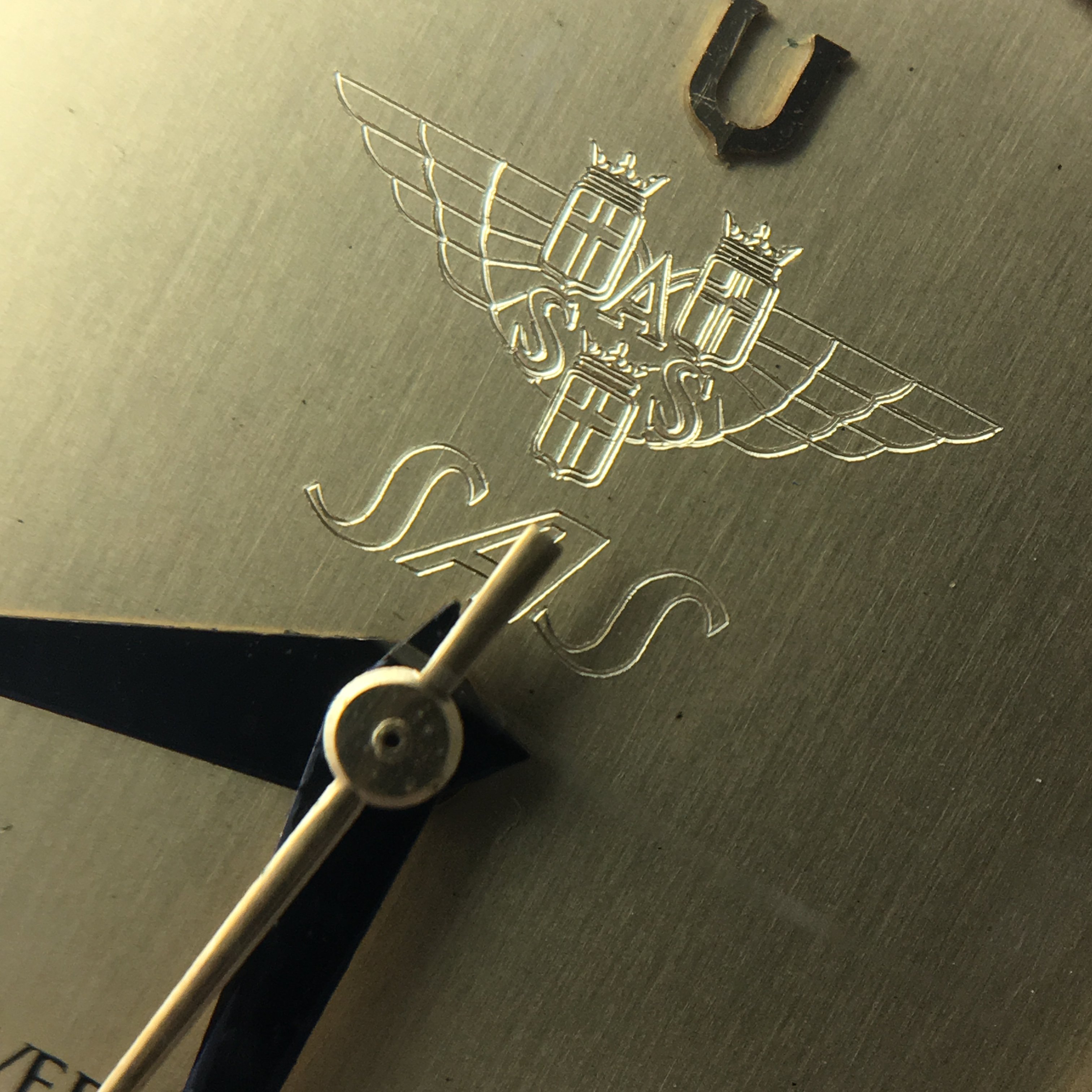

I have to agree with @gop76. I could not be more convinced that the watch is genuine however if there is any chance at all that this watch was fabricated in some way, it was certainly nothing to do with this seller.
It may not have anything to do with the seller; he may simply have been naïve. But really, you could not be more convinced that it is genuine?
Confirmation bias in action, I'm afraid.

The intricacy of the dial engraving is really quite amazing. Please bear in mind that these are highly magnified images.

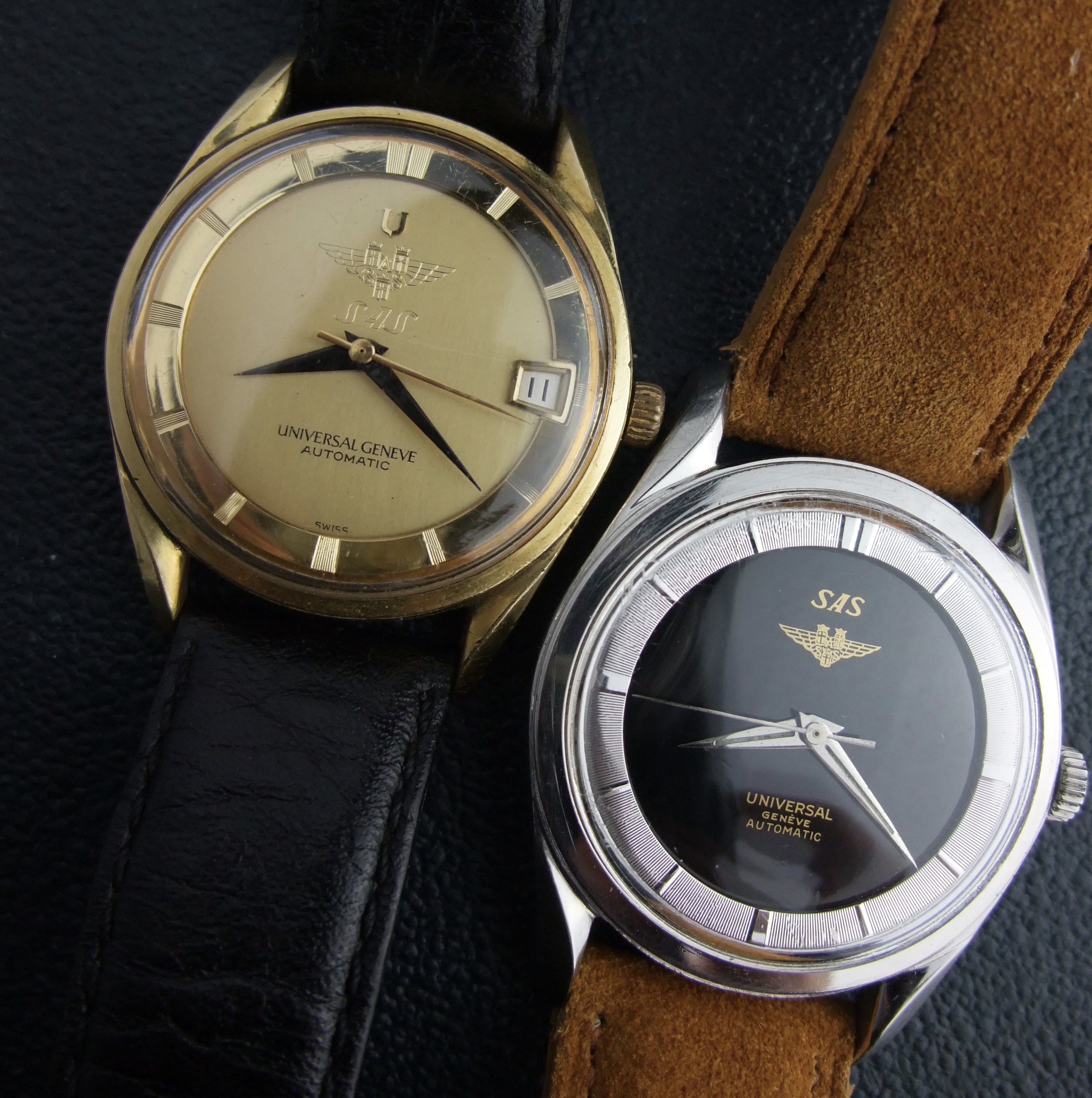

After not seeing any for several years, two SAS watches surface within a few months and both don't have Polerouter or Polarouter written on the dial.
If you were setting out to fabricate an SAS watch (having found a brilliant engraver and done your research on Tore Nilert), you would have thought you would try to copy another example by adding Polerouter and not adding the SAS lettering to the emblem. You probably wouldn't use totally unique UG hands either.
The point, I believe, is that these watches are unique. They were all bespoke pieces produced at the time for a specific reason using the resources available. Perhaps it was decided that the additional Polerouter text would just make the dial too busy?
The fact that two have surfaced in recent months is, I believe, purely coincidence. For all we know, others have surfaced that we on this forum were never made aware of. The fact that I have spent many many hours hunting in recent months, have purchased both of these watches and have posted them on this forum, is why it seems more of a coincidence than it is.

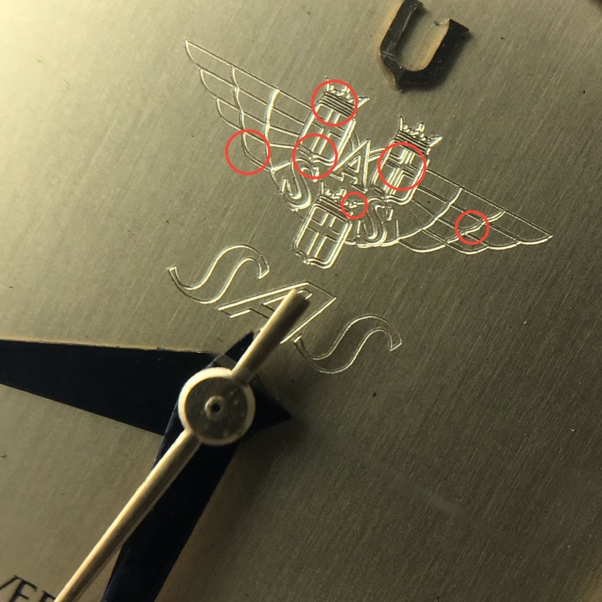

It maybe high magnification but the SAS logos in the 60s dials, were made using a chemical etching process not a mechanical process. Etching gives a far superior finish. therefore I would not expect to see such irregularities and inconsistencies that we see. It looks like logo has been machined on ...
I agree with the uniqueness but the link between SAS and UG was for the Polerouter/Polarouter model.
7,994
28,030
So the collaboration between SAS and UG revolved around the Polerouter model, and yet the very watch given to a high SAS official lacks the model name?
Does that really make sense to anyone?

Also, as mentioned previously, the inscription was applied after the spiral polish, which means that it must have come later.
That doesn't add up, either.
