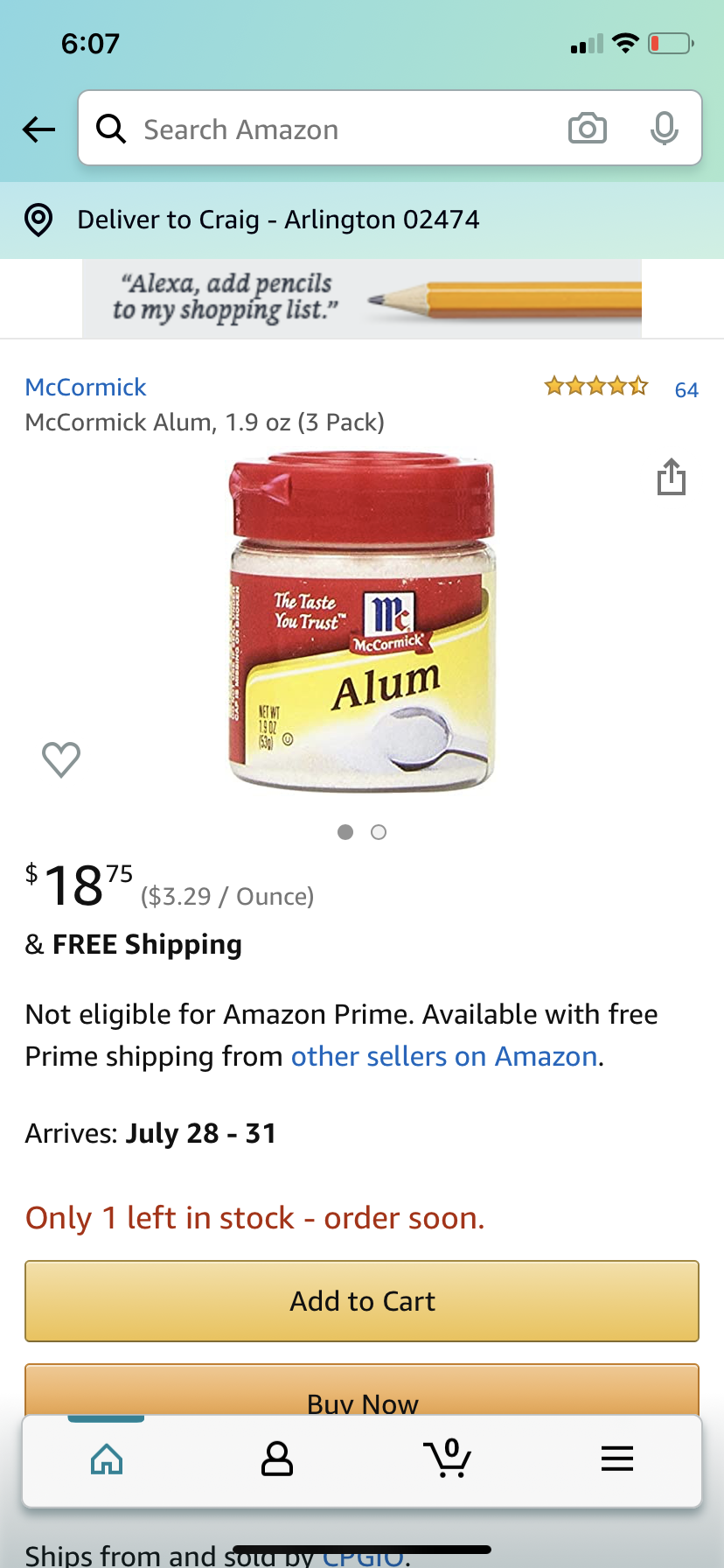

Broke my first stem today. What a PITA.
Is this the right stuff?
Mental note - don’t get this from Amazon
