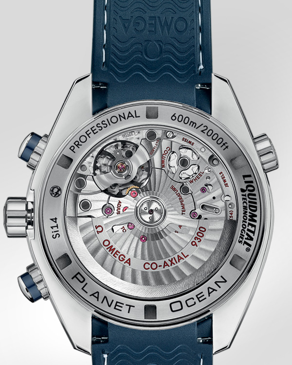

So, much appreciated if someone could chime in here with some Information or point me on the picture below (borrowed from Omega homepage) how he can do the trick.

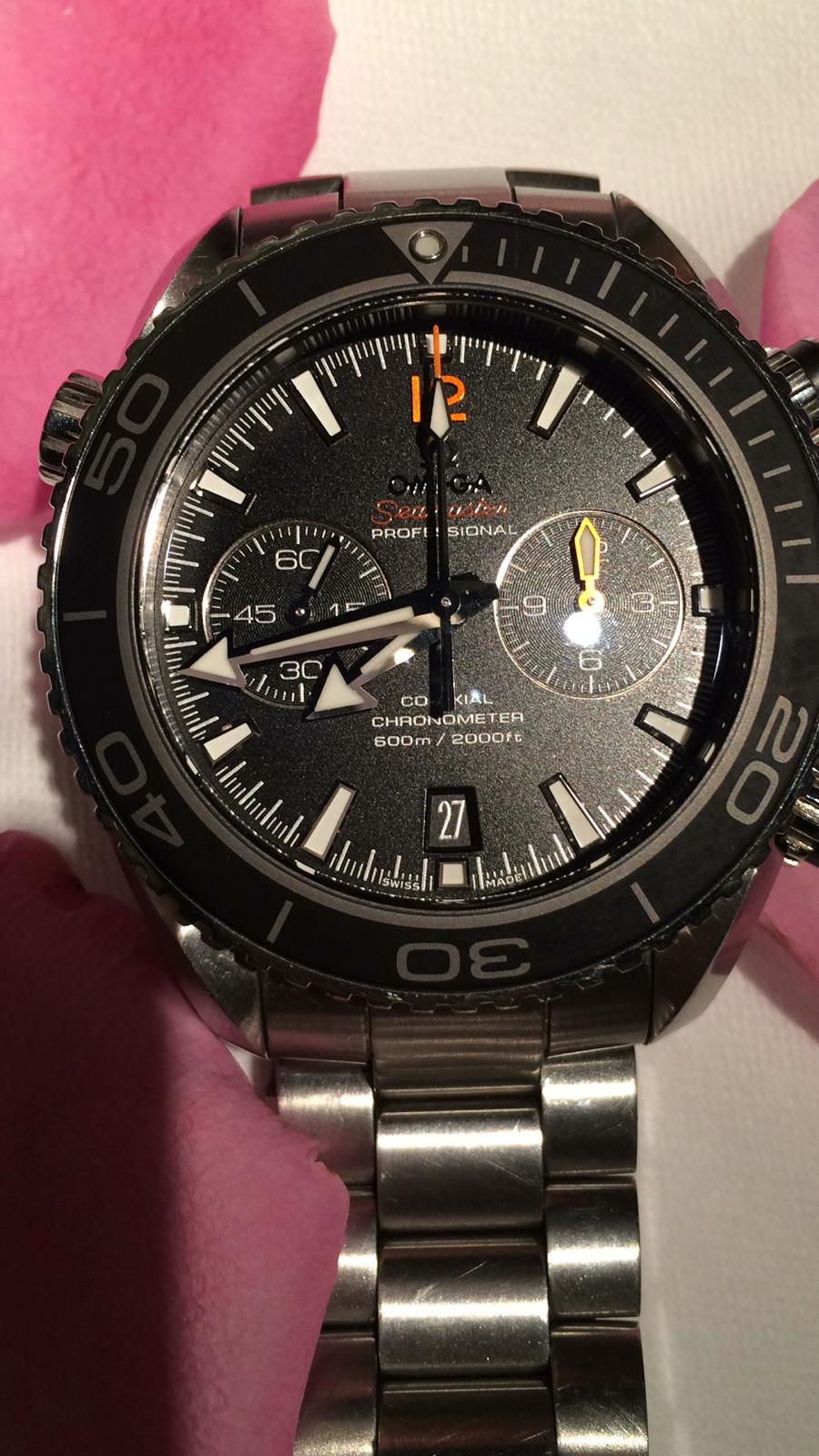

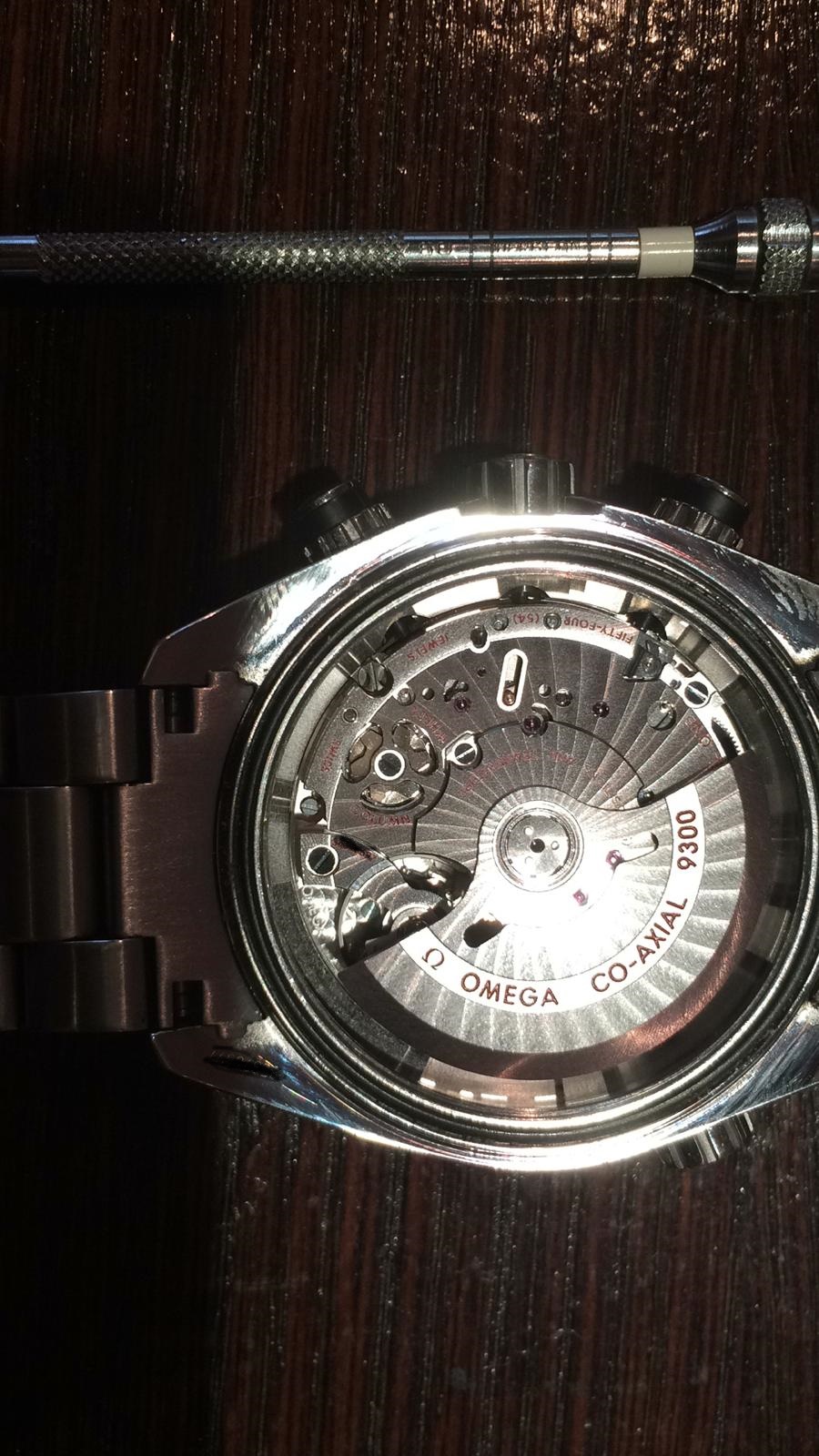

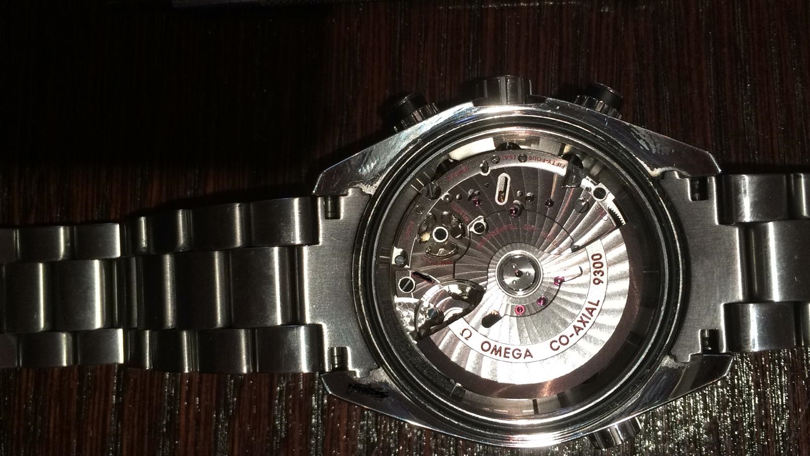

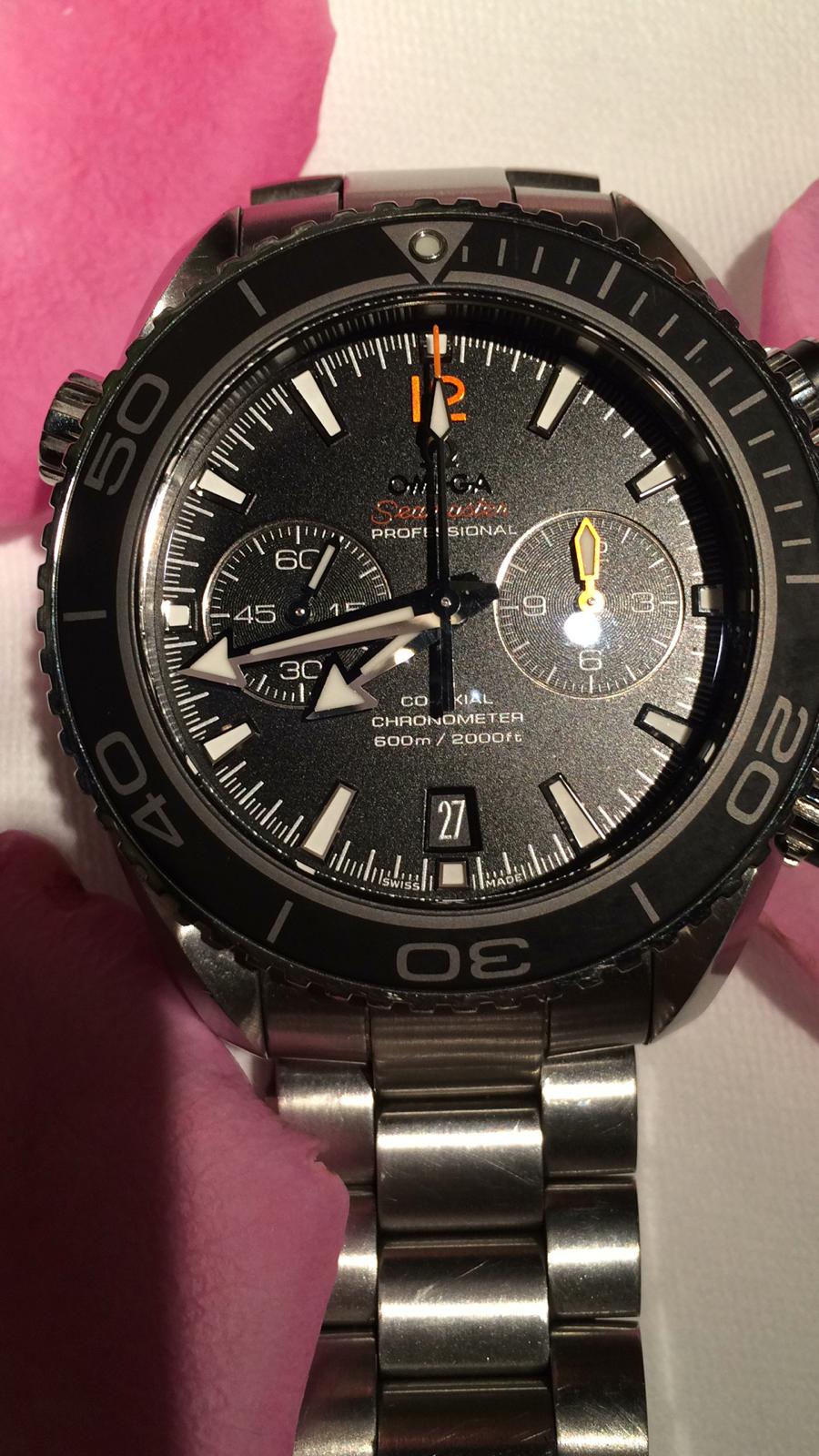

Dear All,
Just heard back with my brother over that weekend what it was with the yellow hands PO. And obviously I was mistaken with this. When snooping through the market he has two different watches shortlisted, the one was the PO which he bought at the end of the day and the other was a SMP 300 Chronograph Regatta (Ref. 212.30.44.50.01.002), and this was the yellow hand beast what I had in mind 😀.
Now btt,
this is his PO (and it also has a yellow Hand on the 3 o'clock subdial 😎)
and we are still looking for some kind support with the position of the pusher to remove the winding stem.
I would be very grateful is someone is willing and able to help us here.
Many thanks in Advance!!
Cheers,
Winny

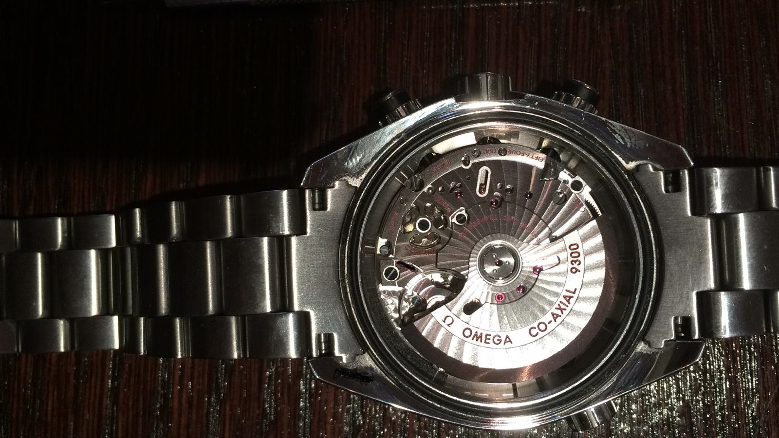

Hi Winny,
Did you receive any answers?
I have the same issue as you
Thank you in advance and also to the community !
Regards,
Didou
792
919
It's the hole next to the "4" in "54". Push a little too much and the setting lever comes completely out, necessitating removal of much of the movement to fix. I'd stick to simple watches and leave this job to the professional.
3
3

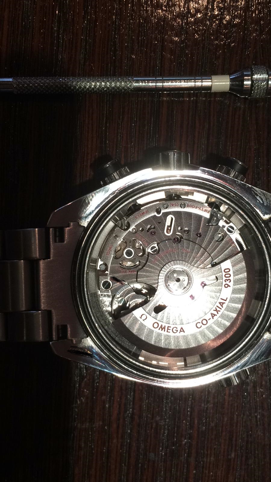

Hi!
Thank you so much for your help.
I tried many times but it’s not working.
Even if I push stronger, I’m not sure it’s this hole.
Maybe an advice on the process in order to push right?
Thank you in advance!
