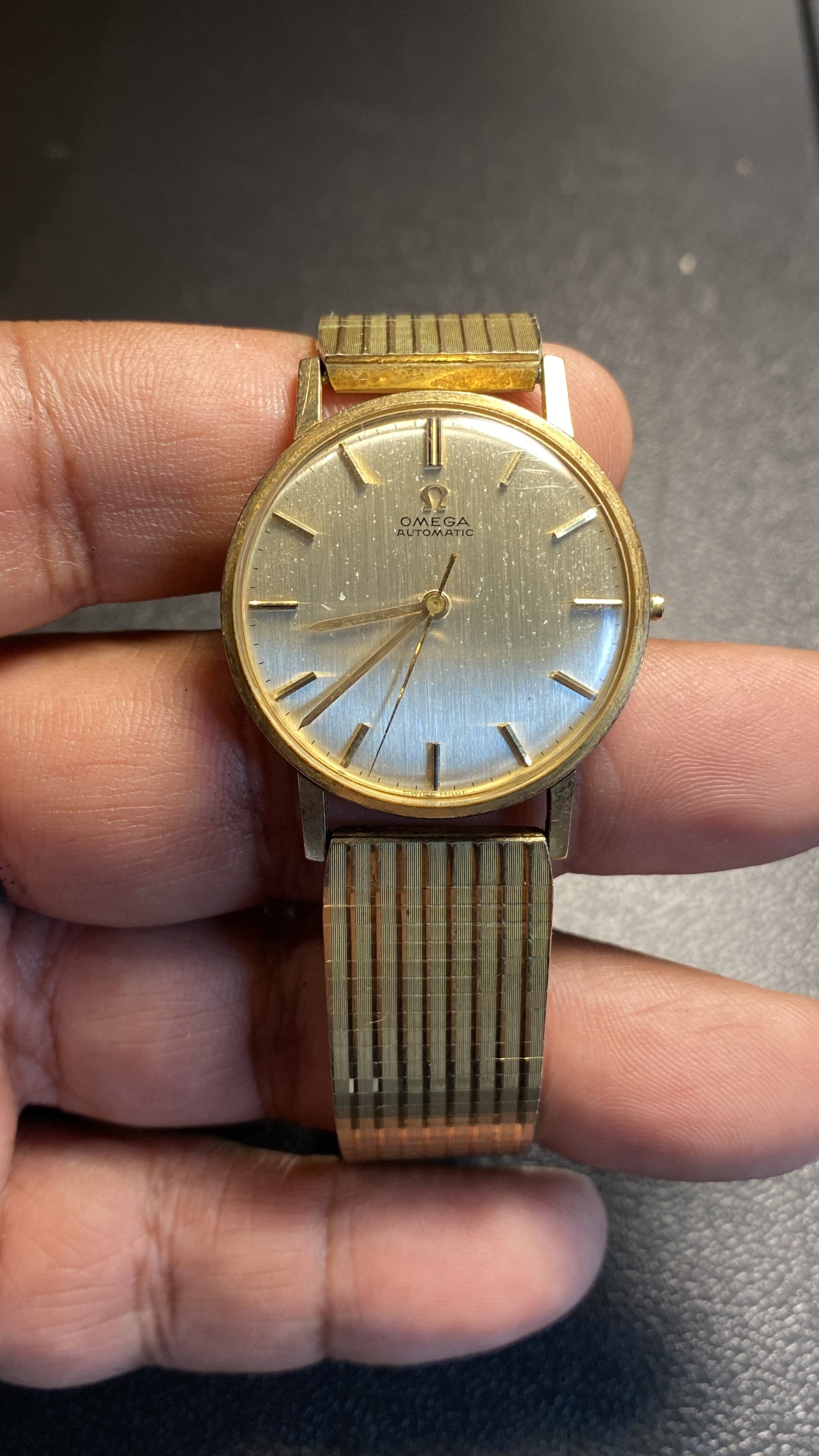

Hello. My first post. Several questions:
1) trying to determine exactly what this watch is
2) how to remove a broken stem
3) learn a source for ordering OEM stems
4) understand if it’s possible to open this caseback
Long version
I’ve repaired several vintage Omegas. But I need help removing a broken stem from, what I believe is, a 1965 Omega Automatic. I’m trying to remove the movement, verify the model, and order a replacement stem.

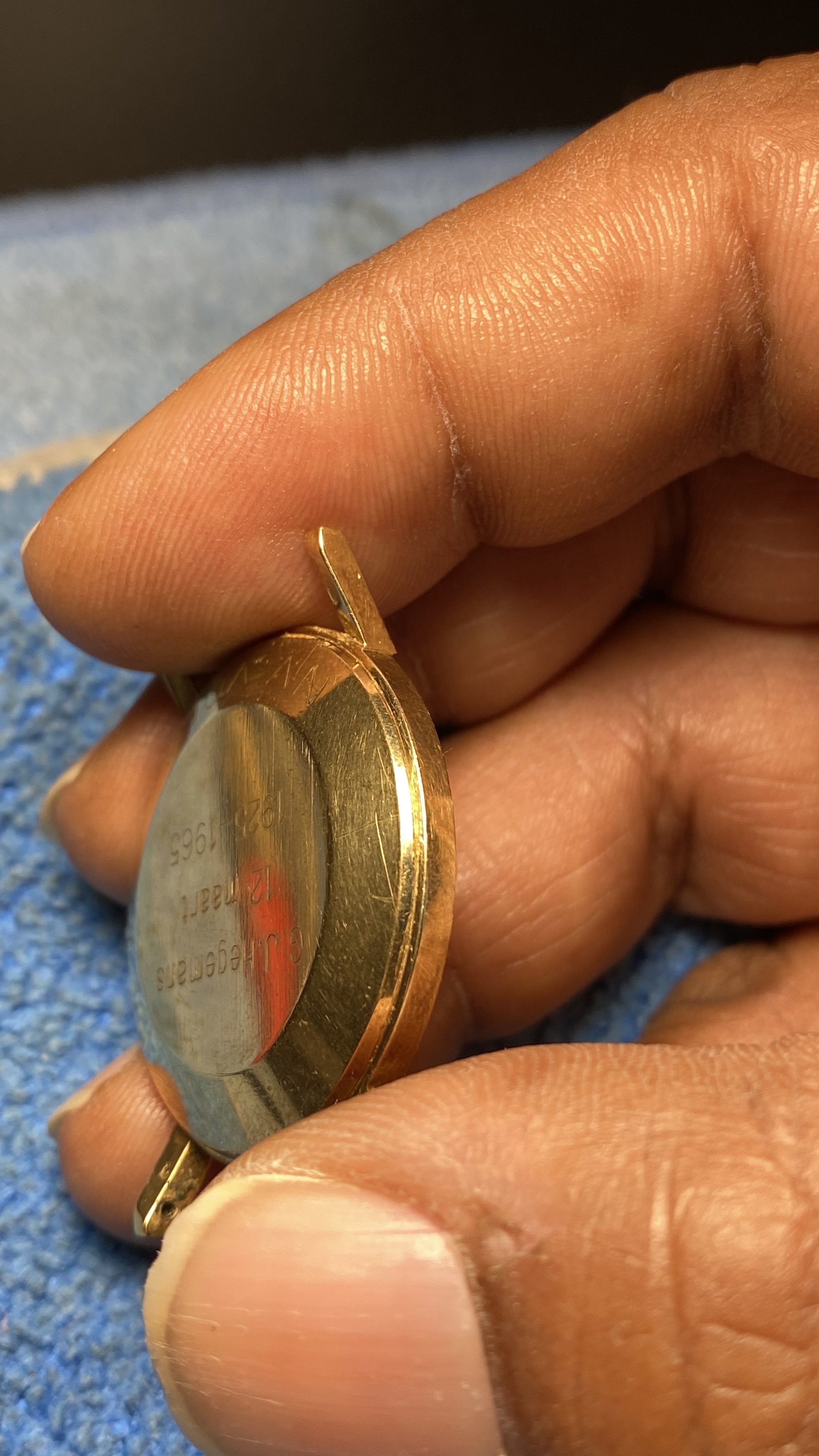

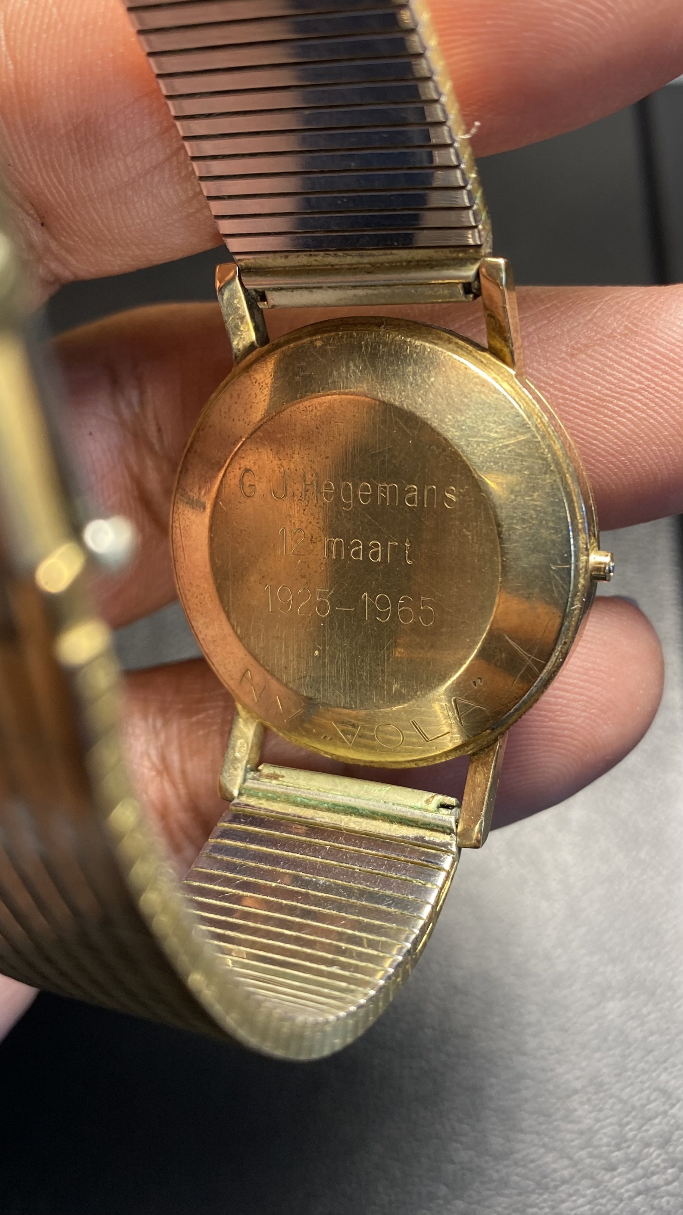

Case and caseback is 14K gold. Watch is 1965. I’ve tried (gently) opening the caseback with plastic and a case knife, but there doesn’t appear to be a slot or joint section between the case and back. I could be wrong, but seems to be a solid mold case.
Any help or advice would be appreciated,
TCM

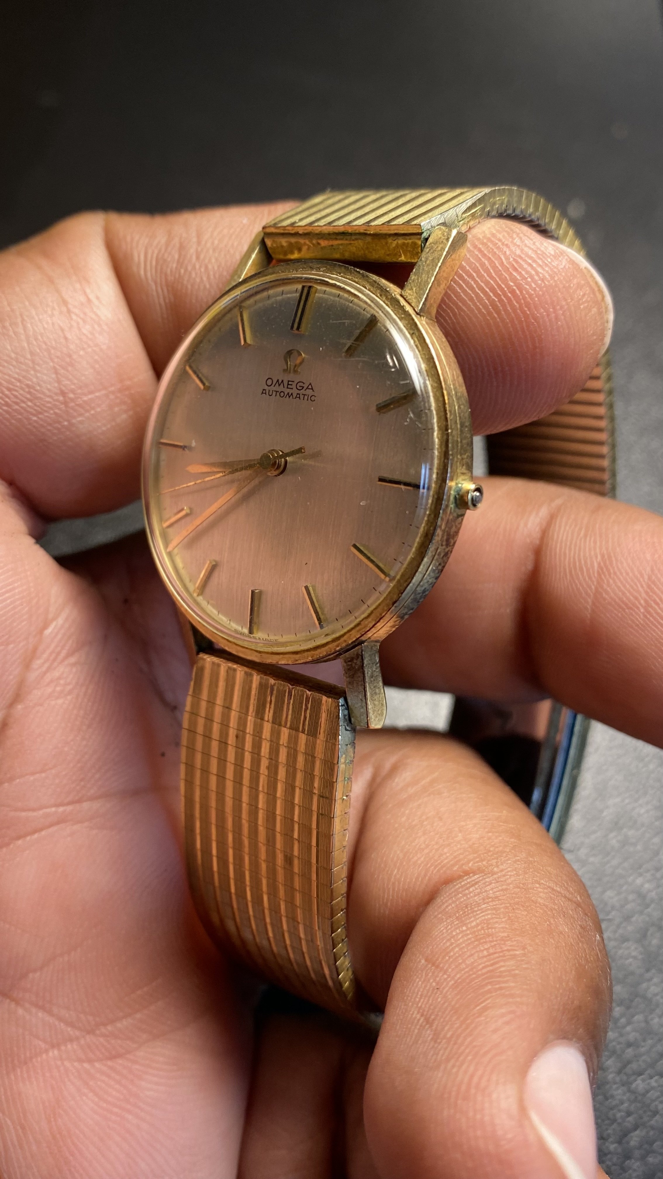

Doesn't look like a broken stem. Just missing the crown. Easy fix
Edit: looks like a top loader. Take it to a watchmaker. Movement is accessed from the crystal side.
Oh my god. I can’t believe I missed that. You’re correct. Looking in the crown (under magnification), it was empty.
Crown screws onto the stem fine.
Thank you!
