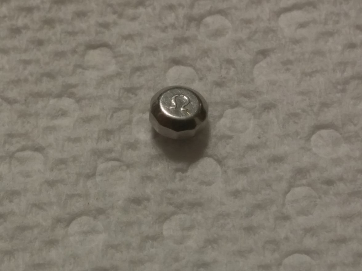

Thanks so much Archer! I've been wondering what to do about my crown with broken off stem within. Didn't want to get a replacement as mine is the original style decagon for my Constellation. Again, thanks so much! I'll be sure to post results.

Alum will not dissolve stainless steel, so it works fine for removing a carbon steel stem from a stainless steel crown.
Is there an echo in here...
Alum will not dissolve stainless steel, so it works fine for removing a carbon steel stem from a stainless steel crown...I've done it many times.

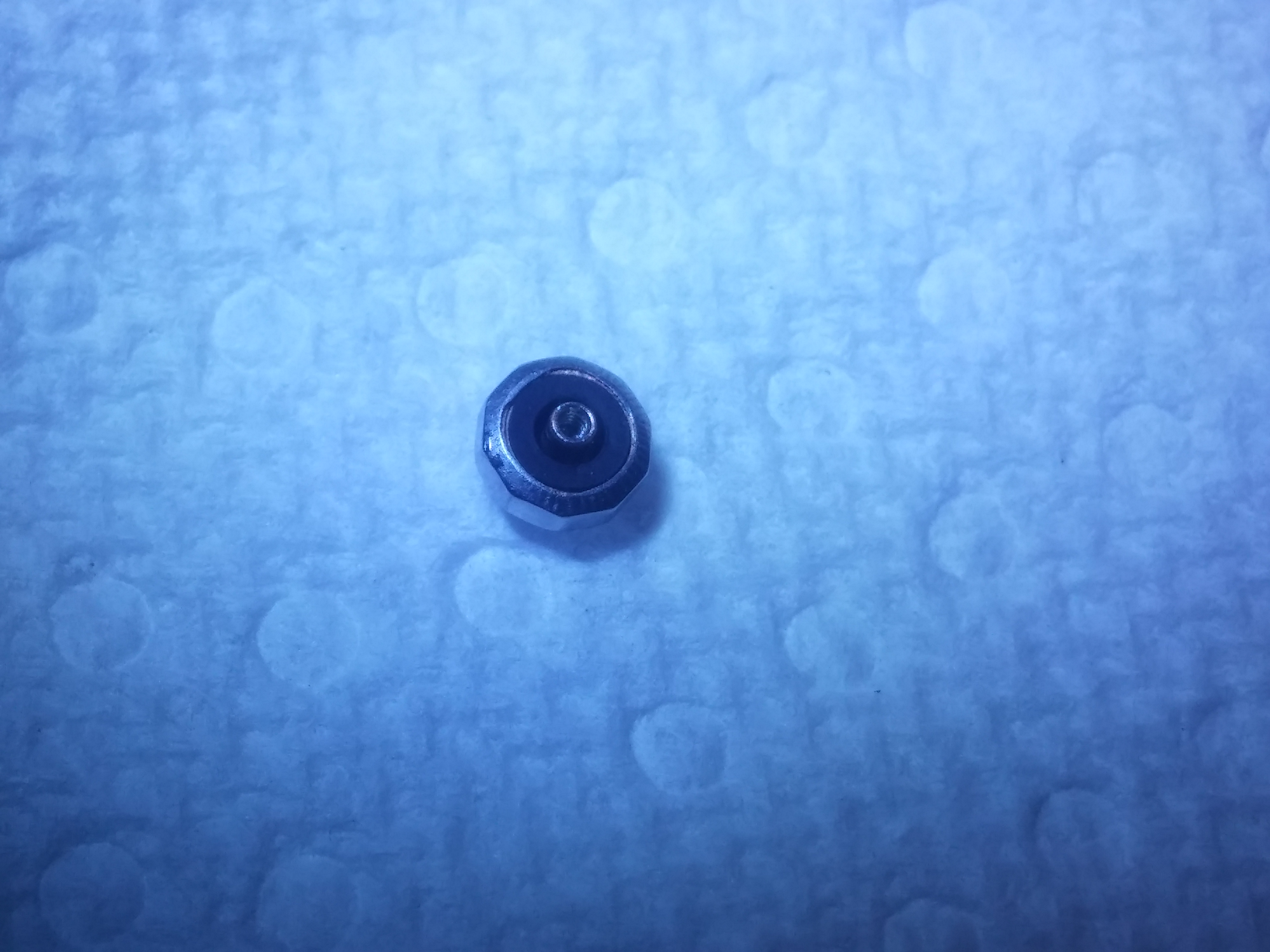

I believe after several days the broken stem has been dissolved. Dose anyone know the depth of the hole in the crown? Mine measures at a little over a millimeter. This is for Constellation 168-005.

Looks clear to me.
Thanks Archer, and thanks so much for the instructions for this method.
