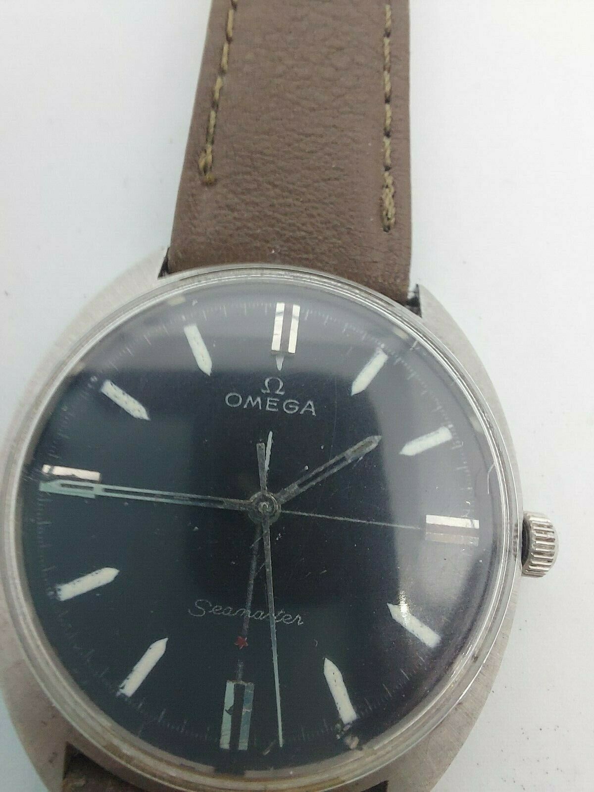

Anyone know anything about these red stars on old Seamasters, some small and low on the dial some quite large, do they have any significance?

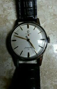

No that's not mine, the one I have is on a black face cosmic, the red star is smaller and set low down on the face

That said the up side down red star on the Cosmic above is a little odd, the stars on Constellations in a similar position are always the right way up irrespective of being silver or gold
