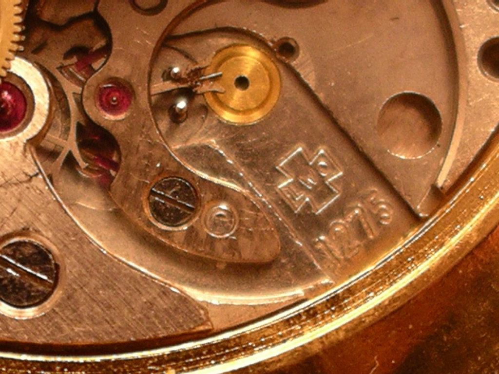

But it's not a column wheel chronograph and not the lemania equivalent to the cal. 320

Depends on what you were after. It's not the same movement as the omega cal. 320 that is in Ash's watch if that is what you thought it was.

I honestly don't see how you can lose at that money, its like Seamaster money for a column wheel chronograph with a great movement. If I didn't have my Calibre 320, I'd just just bought it.
It isn't a column wheel chronograph. It is more a predecessor to the 861 if you look at the movement in detail. The 1270 has an ordinary balance, the 1275 has Kif shock protection and the 1276 has Incabloc.
Omega never used a version of this but if you look at the 127x and the 861, you really can see the evolution and I am sure that many of the parts are probably the same. In particular, both chronos use only two eccentrics and both of these are in the same position.

I wasn't specifically looking for anything. It is a good looking Lemania and I thought the price looked good for a ~1955 gold chronograph. In your opinion do you think this was overpriced for what it is?

That sounds about right. I have got a 1276 to service/mend in my project list and I quite like the movement - it looks well built.

No picture of the movement, so it's a bit of a gamble.

Jesus I must have been seeing things last night, its still cool for the money tbh so if you change your mind on it I'll take it at whatever you paid for it genuinely sorry about that, thanks Mike and others for noticing I genuinely in my mind saw a 2310 even though I wrote 1275 which is clearly what it is 😵‍💫
