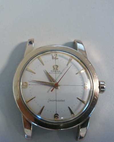

This is a nice 2577 Seamaster pin gold Cap if you could get it for a good "make offer price. A little wear on top edge lugs, but not bad. The watch does not look like it has been messed with. I think think the photos are poor and this would be a nice looking watch. Probably a cal 354 from serial number, can't see the regulator to be sure not a 351

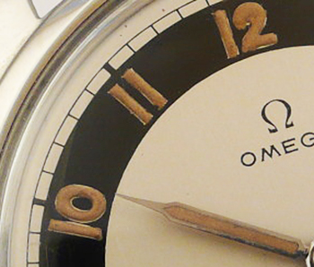

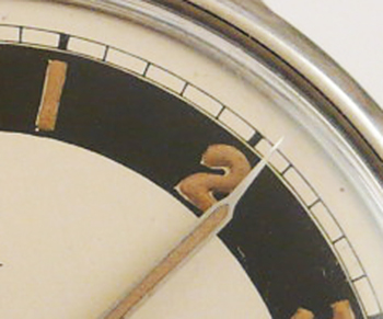

Something is fishy about the lume on the numbers.
I was a bit bothered by the lume too.
Could someone articulate their reservations about the lume? Looking to learn...is it the thickness of it?
Sloppy, thick, no deteriation other then color,
Also I have a problem with the outer chapter off center from the black ring
25,980
27,722
I think the dial was relumed because it's puffy and poorly applied. Anyone can change the color to look vintage with some type of staining agent in the mix or after it's on the dial. The 5 and 7 are leaking onto the subdial too.
You know, despite these imperfections (on high mag), I favor that the dial and lume are original. One sure way to tell, at least about the lume, is to hold the watch under a Geiger counter. These '40s-50s Omegas are pretty radioactive.
That's not foolproof either - there are still old time watchmakers that can re-lume with radium. It bothers me - the dial imperfection plus the replacement crown - if the watch is in impeccable shape why would the crown not be original (especially since the case and movement both look equally nice)? It could very well be that the dial is original but the question about the print and the lume plus the crown makes me want to watch but not bid on the watch.
