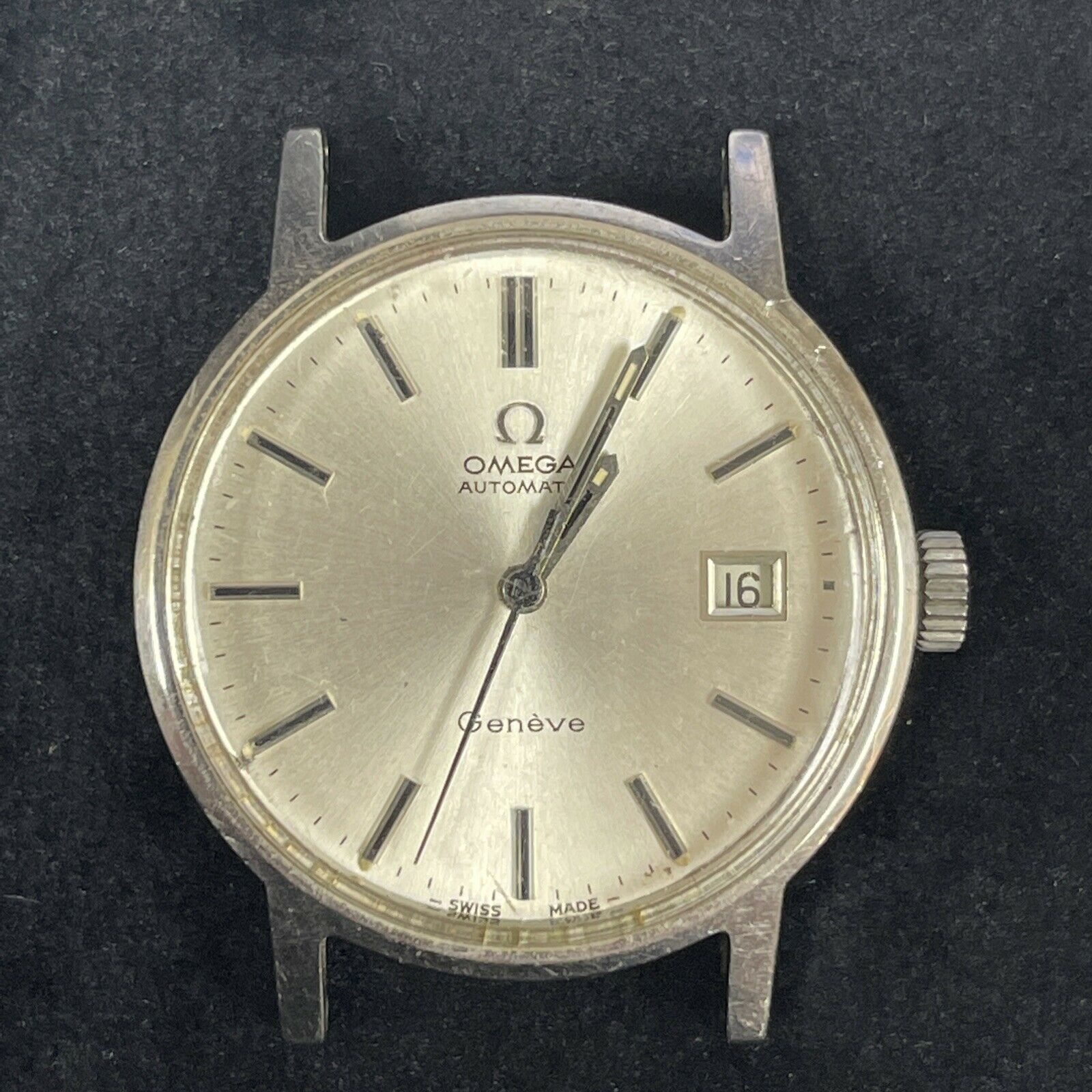

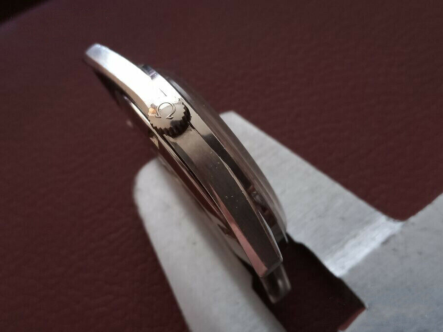

Novice questions: Picture 2 and 3 show a decent sized ding in the bezel, directly above the 1 o’clock position. In other pictures (1 & 4), this mark seems absent? That and a lack of movement or case back pictures make me wonder if I’m looking at 2 watches, and what am I getting? Legit concerns?
Ditto, I believe we're seeing a reflection of the lug in the bezel. This doesn't concern me.
Nice looking hippo on the caseback.
You can always ask for movement shots, and see if you can negotiate price if seller can't provide them.

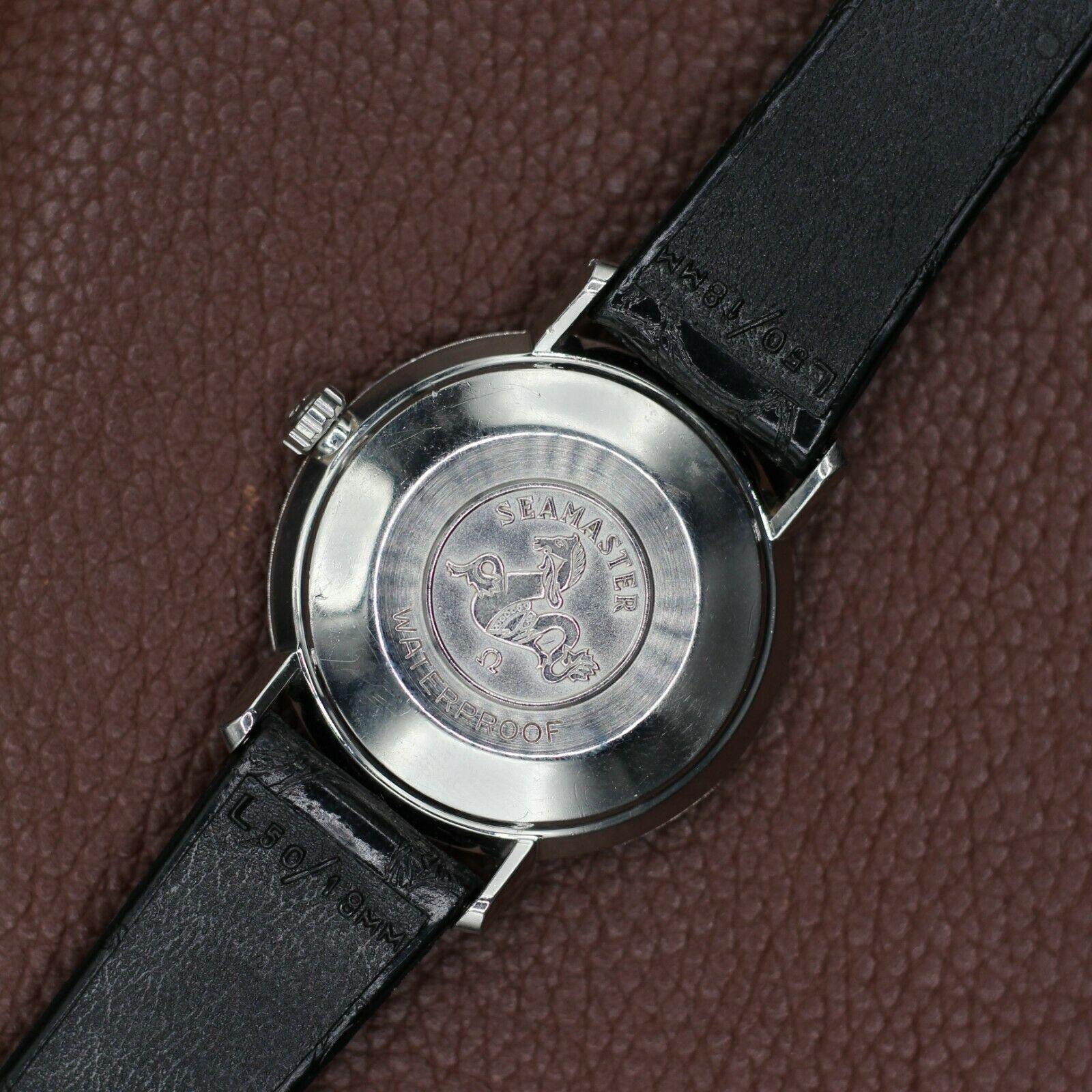

Hello All. Thanks to this thread, I purchased this lovely 1950 2577 Seamaster with a waffle dial. Upon receiving many pleasant surprises. From the ebay seller's photos I, and some others thought the seconds hand was too short, and I also thought there was some fading on the seamaster word due to the angle of the photo. However, the seconds hand is correct and original, the end of it was reflecting light and made it look too short, but it correctly matches the chapter ring. Also, the supposed fading on the seamaster word turned out to be a scratch in the crystal, so I am looking for a new one, but the dial itself is pristine. Extremely happy with this purchase, and my photos can only convey half of its beauty. Will be taking some nicer ones once I get a new crystal installed.

I’d throw a lowball offer at this one and see what sticks, almost qualifies for the dumpster diving thread but Cal 1480 Geneves are still good watches
https://www.ebay.com/itm/294630484270?hash=item449958692e:g:to4AAOSwpv9hp-d2&LH_Auction=1
Clearly you have a lot more experience in then me (joined a decade ago compared to less than a week...) but I thought it had some bad character, the shape of the logo, the position of the date etc. is this just a case of needing some TLC?
35,734
40,028
This is a much later Geenve hence the newer Omega logo and Calibre 1480 movement, there were actually quite a few significantly different looking Geneve models that have very different movements, dials, and even Omega logos but share the same overall case shape and design
3,591
13,541
It‘s set to close to midnight in the pictures, that might explain it, the date mechanism could still be engaged and thus the date disk still moving. This can easily be found out by messaging the seller and asking for a 6am-picture though.
