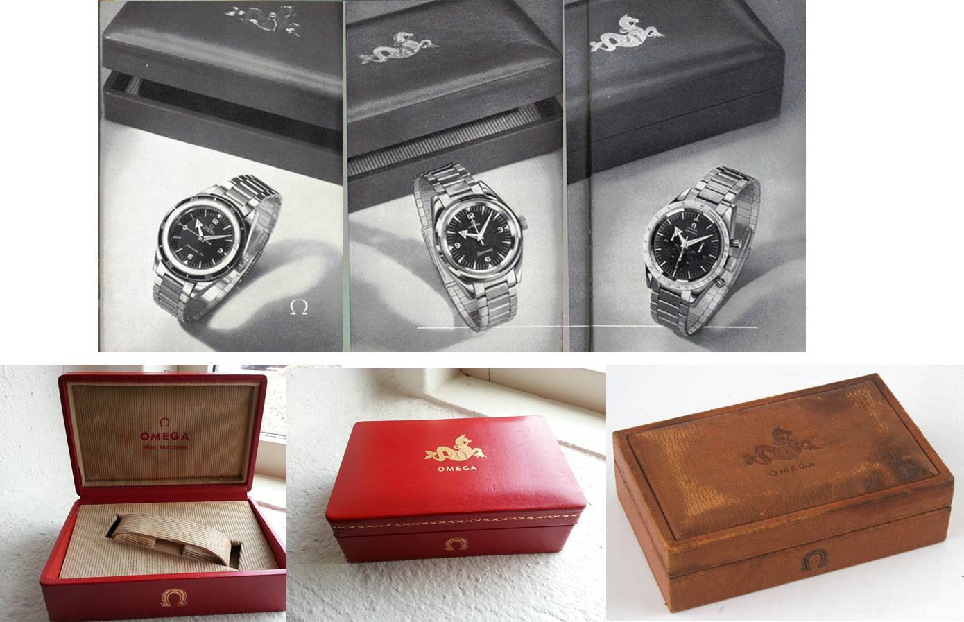

I contacted gatorcpa about this box when it first showed up on Ebay. He thinks it might be for an Omega Seamaster 300, case reference 2913. Check the box out in this ad.
3,095
3,605
65553
I think he's right
592
2,784
Hmm, not quite so. The 2913, 2914 and 2915 all came in the same type of red box with beige velvet inlay (I think!). It looks a lot like the one in the auction, but with some small design differences, for instance the groove in the lid. Here's mine attached in a collage, where you can see the same type of box on all the references in the adds (mine has "Omega" on the lid and the logo on the front. Think mine it a bit later than the ones in the adds, but same type.
But a nice box and have never seen one with almost the same design in brown and with automatic on the inside instead of "high precision". So perhaps, WHO knows.

And the included insert does not allow the box to close properly. And it was not in good shape.
