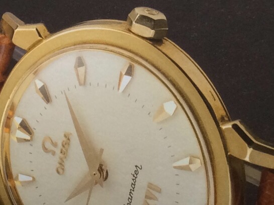

I don't see the error with the crown. Below is from AJTT and the crown looks the same, just polished.

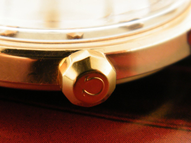

Here is the listed watch crown:
What are the differences?

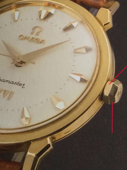

The Seamaster crown in AJTT is faceted on two edges, Constellation crowns (on the watch in question) are only faceted on one, its not polished, they never had facets on the other edge, they are always smooth. The double faceted crowns are nearly impossible to find, which is why a similar but completely incorrect Constellation crown was substituted.

GREAT EXPLANATION!
