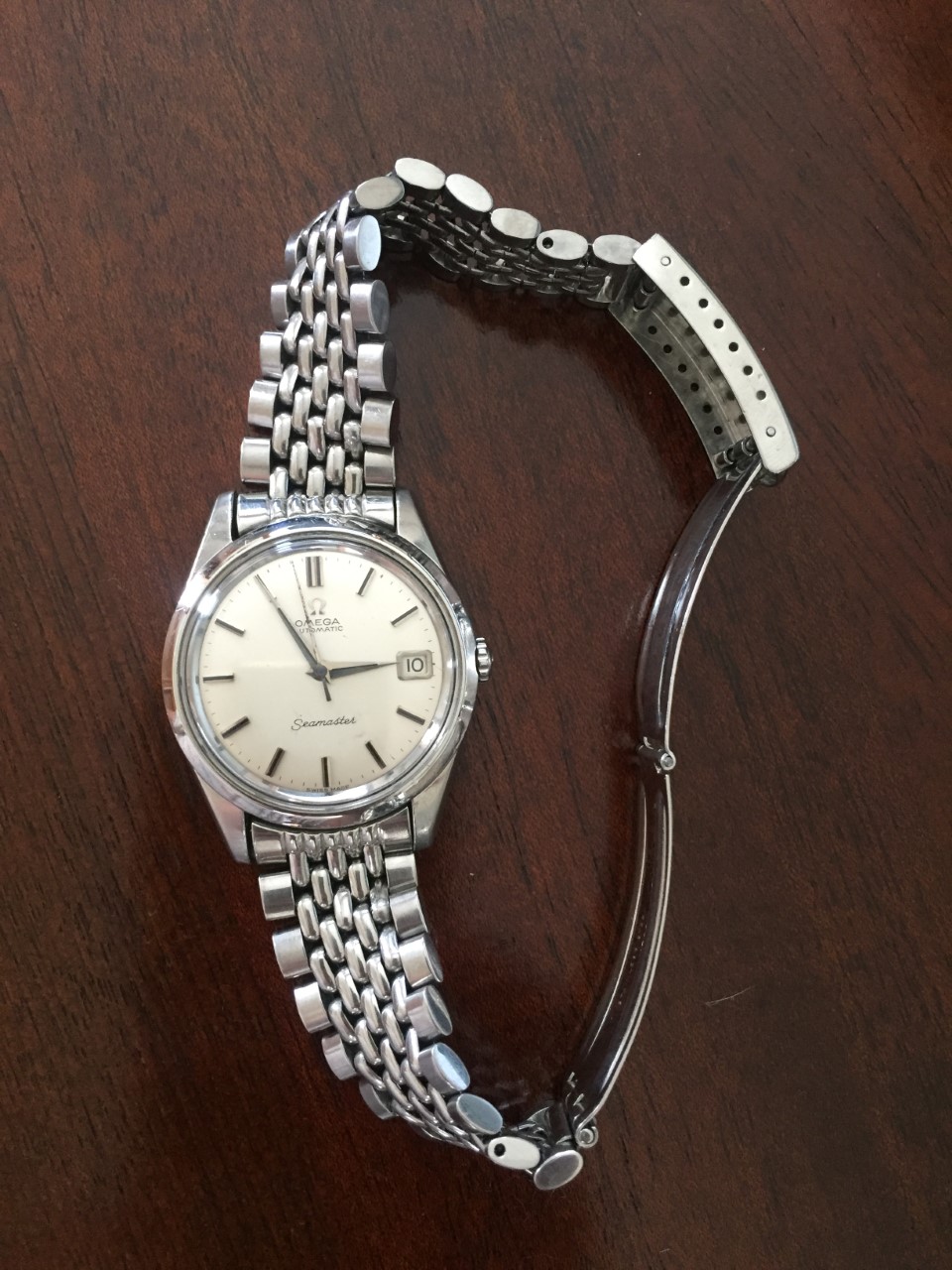

Hoping some resident watchmakers here on OF can chime in here.
I recently received a watch containing Omega Caliber 562 movement with an unknown service history but was told it was keeping time but running fast at around 25+ seconds a day. .Today upon receiving this watch i noticed the hour and minute hands do not move but the seconds hand does sweep.
I took some video footage of the action and tried to run through a full 24 hour cycle changing the time and allowing the date function to roll into the next calendar day but nothing changes, the hour and minute hands still do not move.
I have already started dialog with the seller on what is the best way to correct this. The watch is from Japan so not exactly around the corner from Seattle. Looking online at possible causes there is mention of it possibly being the Cannon Pinion but respect it could potentially be other issues.
How serious could this issue be? Truth be told the watch itself is in remarkable cosmetic condition with the exception of the bracelet clasp, it doesn't look or feel like its ever seen the side of a polishing machine, The dial is perfect for me so the truth is i am hoping the issue isn't to serious so i can actually keep the watch and just send for service/repair without it being overly cost prohibitive. I figured i would already be $200 or so in just for a service. How much should i be thinking now?
I can't be to upset. Its a 57 year old watch but i was hoping it would at least tell the time !!

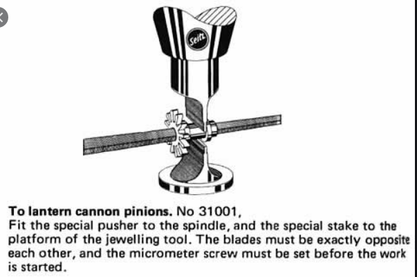

Do the hands feel very easy to turn? Might be hard to tell with the movement still in the case, but most likely thing is the cannon pinion being too loose. At the worst, this would require a new cannon pinion, but most time it can simply be tightened, so no additional cost during a service for tightening.
A new CP would be ~$45...
Thank you for the above explanation, Yes the hands move very freely vs any other i have when changing the time. Hand winding doesn't feel the way it should. I have an Cartier Tank Automatic and a Tag Diver with an ETA 2824-2 and both seem very different to this one when being manually wound from having no power.

It definitely needs a service and i knew that going in, just wasn't expecting the extra issue of the minutes not moving
Like Al mentioned, cannon pinion adjustment is usually not an extra charge during a complete service so you're probably not in any worse shape than when you first bought the watch, since you knew going in it needed service.

I think we need to see the watch in question....
5,631
5,814
Oh too funny, I just bought one of those! Yours is in better condition. Yes, worth the cost to restore. These are not particularly rare or valuable, in my opinion. So, Omega is a viable choice, and I am considering sending mine there as well.
Be aware they don't make that crown any more, so one way or another you're likely to lose it.
