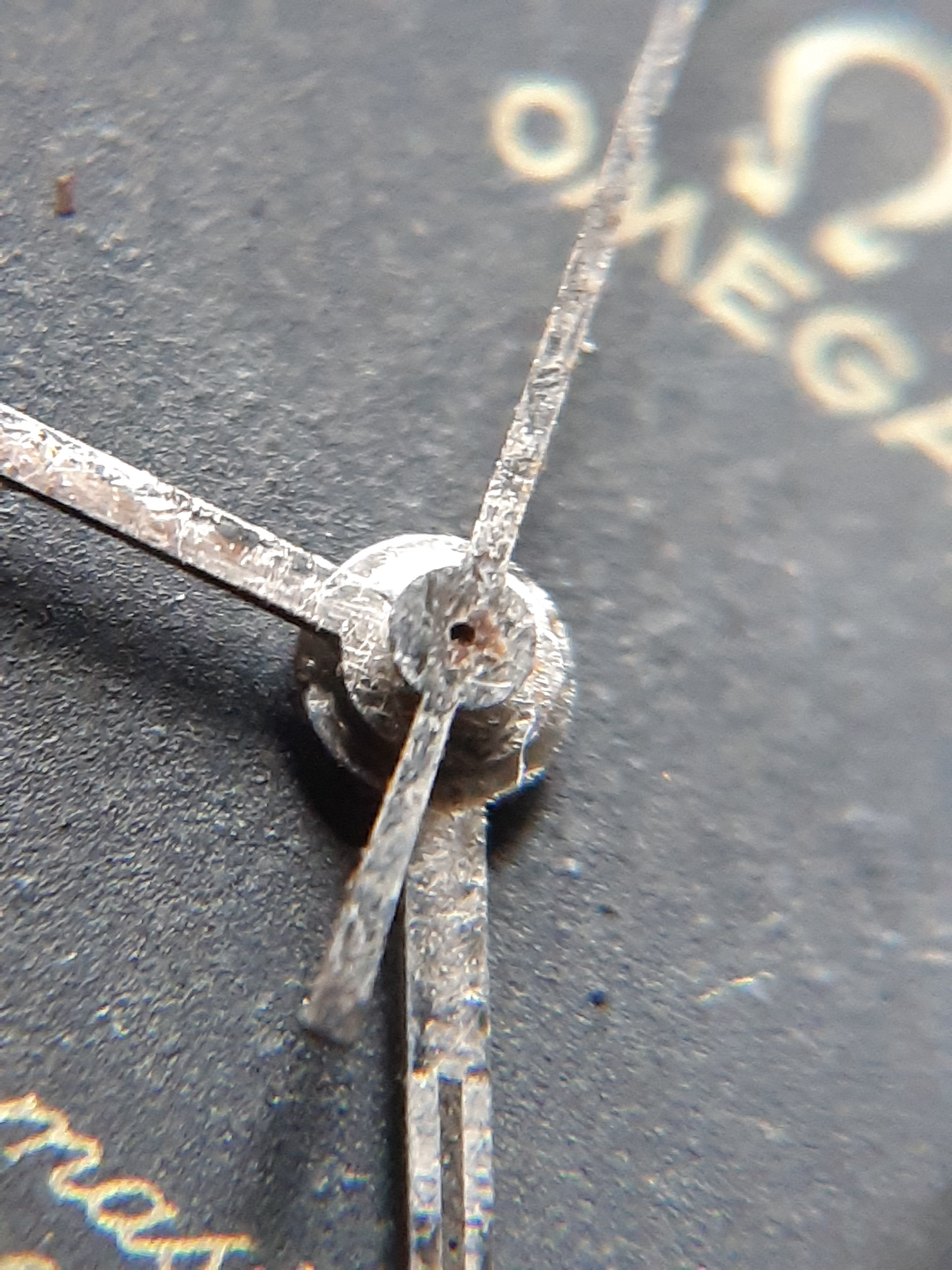

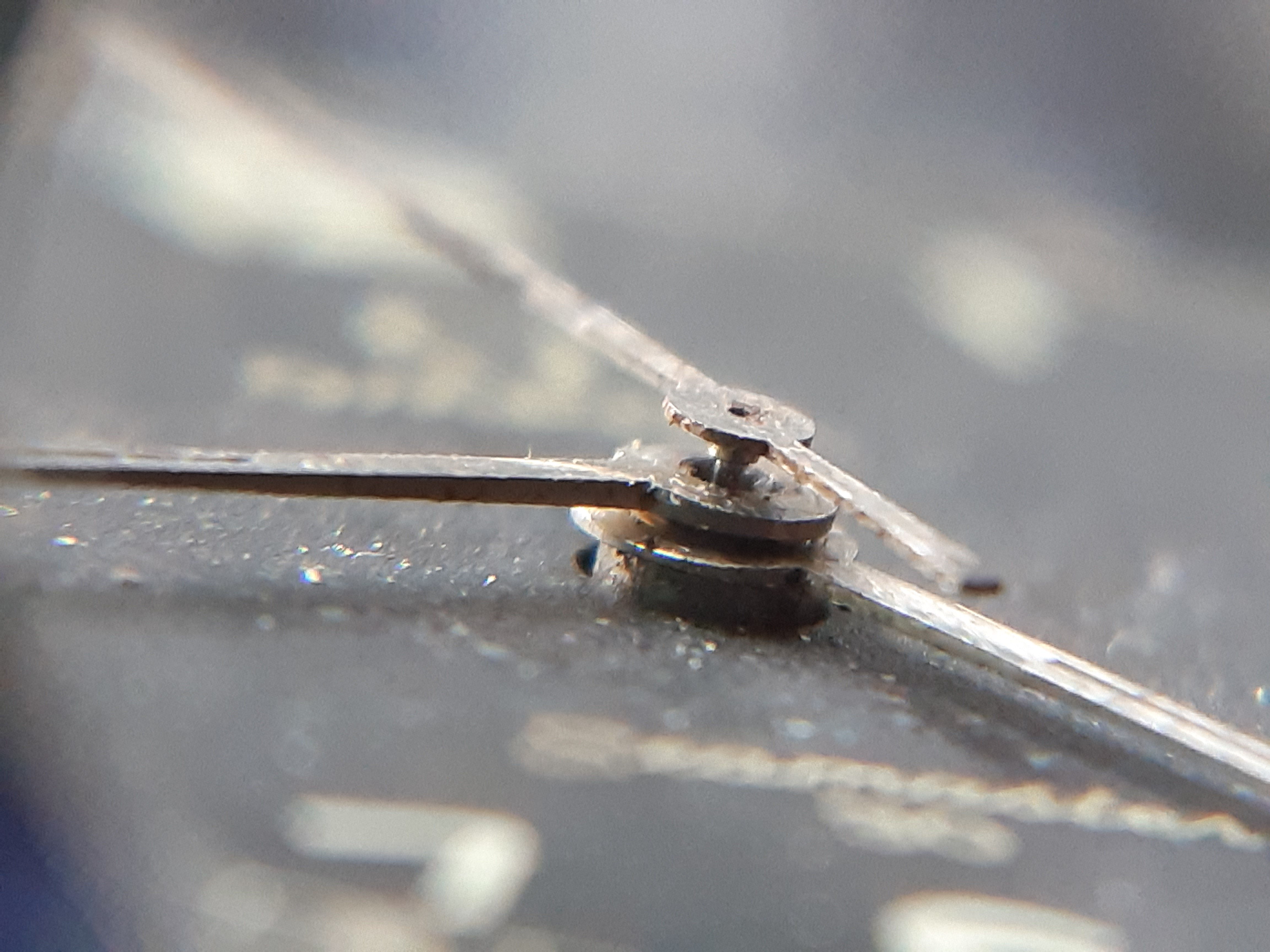

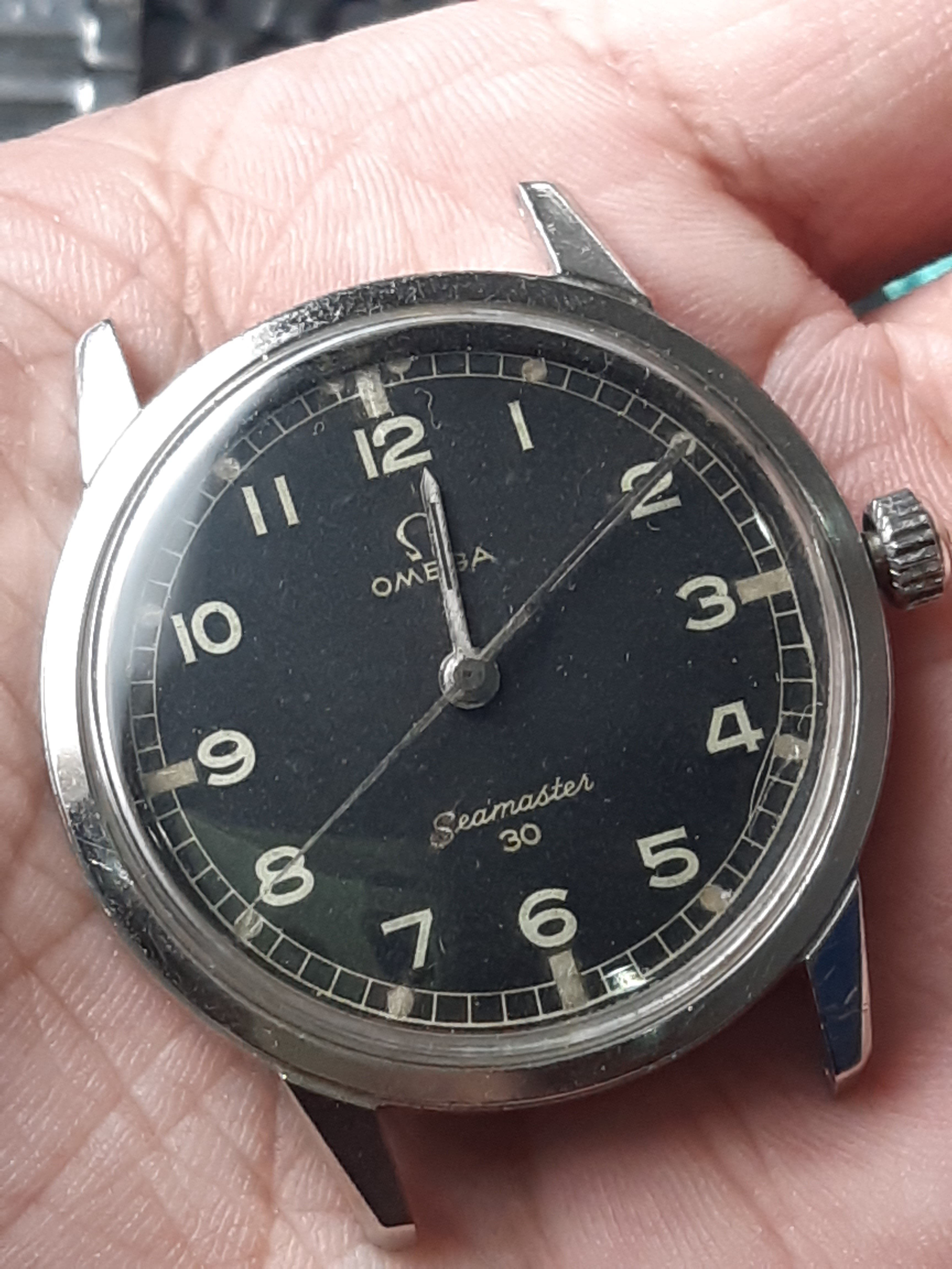

Hi all,
I recently bought a seamaster 30, 135.007-64
It has some issue with the seconds hand stuttering, sometime completely stopped and becoming weightless (pointing to gravity) but the watch is ticking.
Pardon me, i couldn't think of a better way to describe that.
Could it be something wrong with the pinion or the seconds hand not properly mounted?
Thank you.

most probably it has a wrong seconds hand (slightly too wide tube)
87
71
Hi, thank you for the input.
It could be.
But I looked up a several example of the same reference online, the length and shape of the seconds hand seems pretty matched up. Handsets aging also seems pretty synchronized. Please correct me if im wrong.
Based on my observation by looking at the first photo, the gap between seconds hand and minutes hand is rather big, compare to other watches I have, I am not a watchmaker, so I am wondering could it be the seconds hand not properly mounted.

Most likely an experienced watchmaker will be able to tighten the hand on the pinion with a small adjustment.

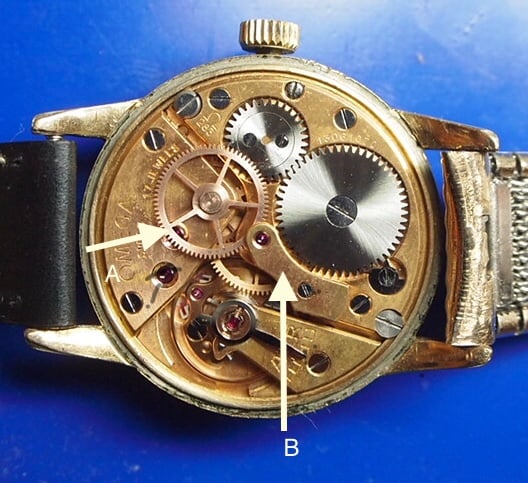

I gather you are fairly new to collecting antique and vintage watches. And that you bought in good faith that it would be perfect when you received it. And that having it checked out by a specialist in the servicing of antique and vintage watches would not be necessary. I suspect that the Omega may have one of the calibers that has a indirectly driven sweep seconds hand like to one in the image I have posted. The problem could be with the seconds hand, for sure. But I suspect the problem might also be in the system in the movement that drives the sweep seconds pinion. The pinion may not be meshing properly with the gear that drives it. The bib that fits over the pinion my be mis-aligned. There is most likely a badly adjusted (or non-existent) tension spring for the sweep seconds pinion. I think you should be looking for a watchmaker. In the image, A points at the pinion drive wheel. B points at the bib over the sweep seconds pinion and tension spring for the pinion, neither of which show in the image. Your problem could be somewhere in that area.

Had a similar issue recently with an erratic/jumpy centre seconds. It was the indirect drive mechanism having incorrect tension as described by @Canuck
This made me think that there is too little friction between the tube and the pinion...
Will get it serviced shortly, this is the same watch with the snapped stem stuck in crown which mentioned in another thread.
I got this watch in a relative bad shape, but price was very reasonable. I guess these damages were done by previous incompetent watch maker, besides the said issues, it has a scratch mark on 4 O'Clock, trimmed tension ring, missing movement holder screws, and a broken crown.
A competent watchmaker is scarce at my area.
So I would try my best to sort it out myself if I could.
Thank you for the details input,

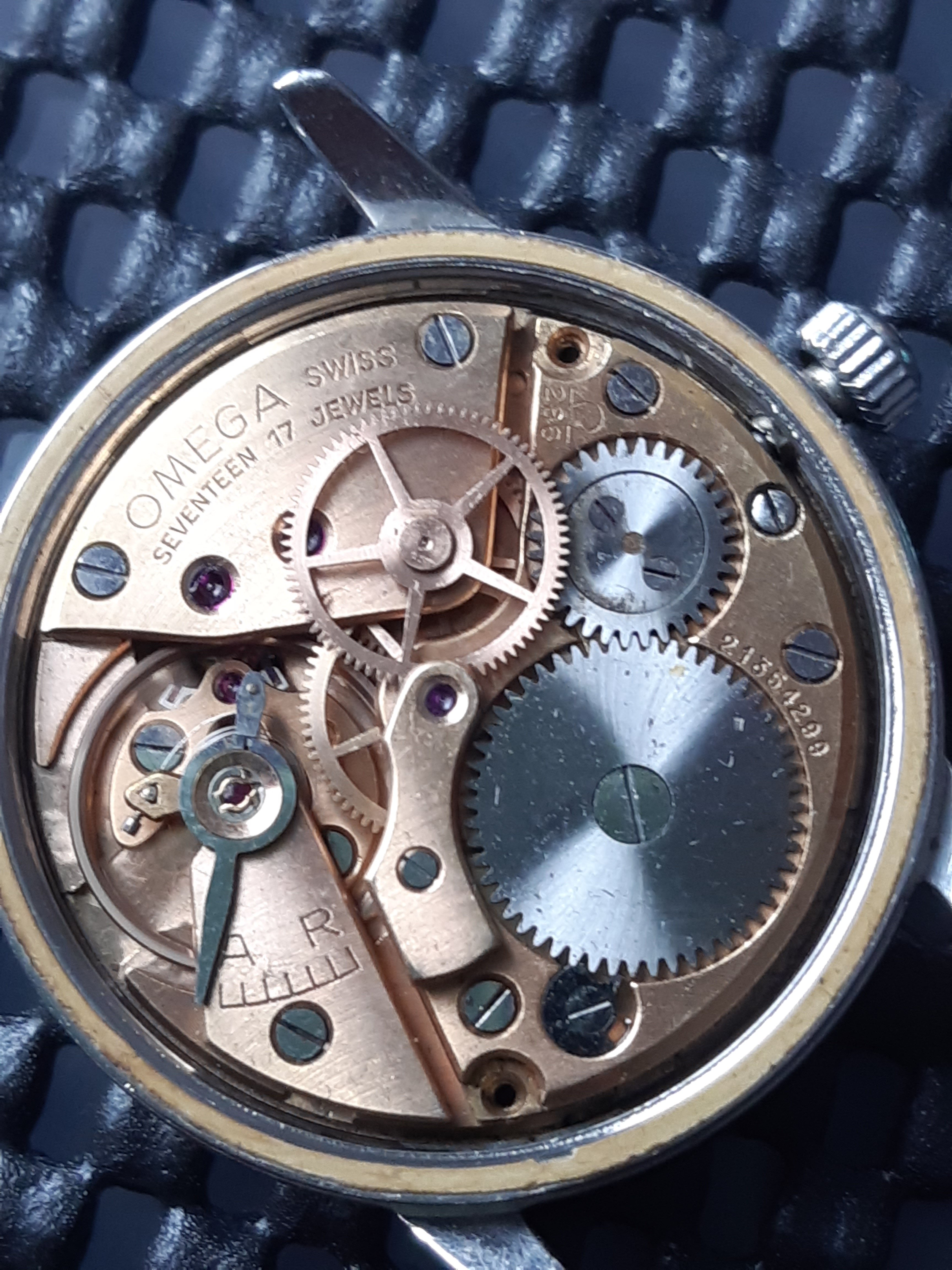

The watch come with Cal 286, likely need a service anyways, position of regulator is pretty off.
Ironically, the hours and minutes are moving and keeping time based on what i tested.
If there is a problem in pinion drive wheel / point B, would the watch still be keeping time?
Pardon me, i am trying to filter out the potential issue.
When watch sit completely horizontal, the hand does run. However, when tilted to certain angle, it sometimes become swinging weightlessly like not mounting on the pinion.
If there is too little friction between the tube amd pinion, can it be fixed?
But at the end, im likely taking it to watchmaker.
yes if the tension in that part is off on a center seconds watch it can do that.
that is at the end of a heart chain. It can be disconnected and the watch will still function.

Hi, You need to adjust the drive wheel because it's loose. The drive wheel must be firmly attached to the Third wheel and rotate with it, thereby rotating the Sweep Second Pinion.
